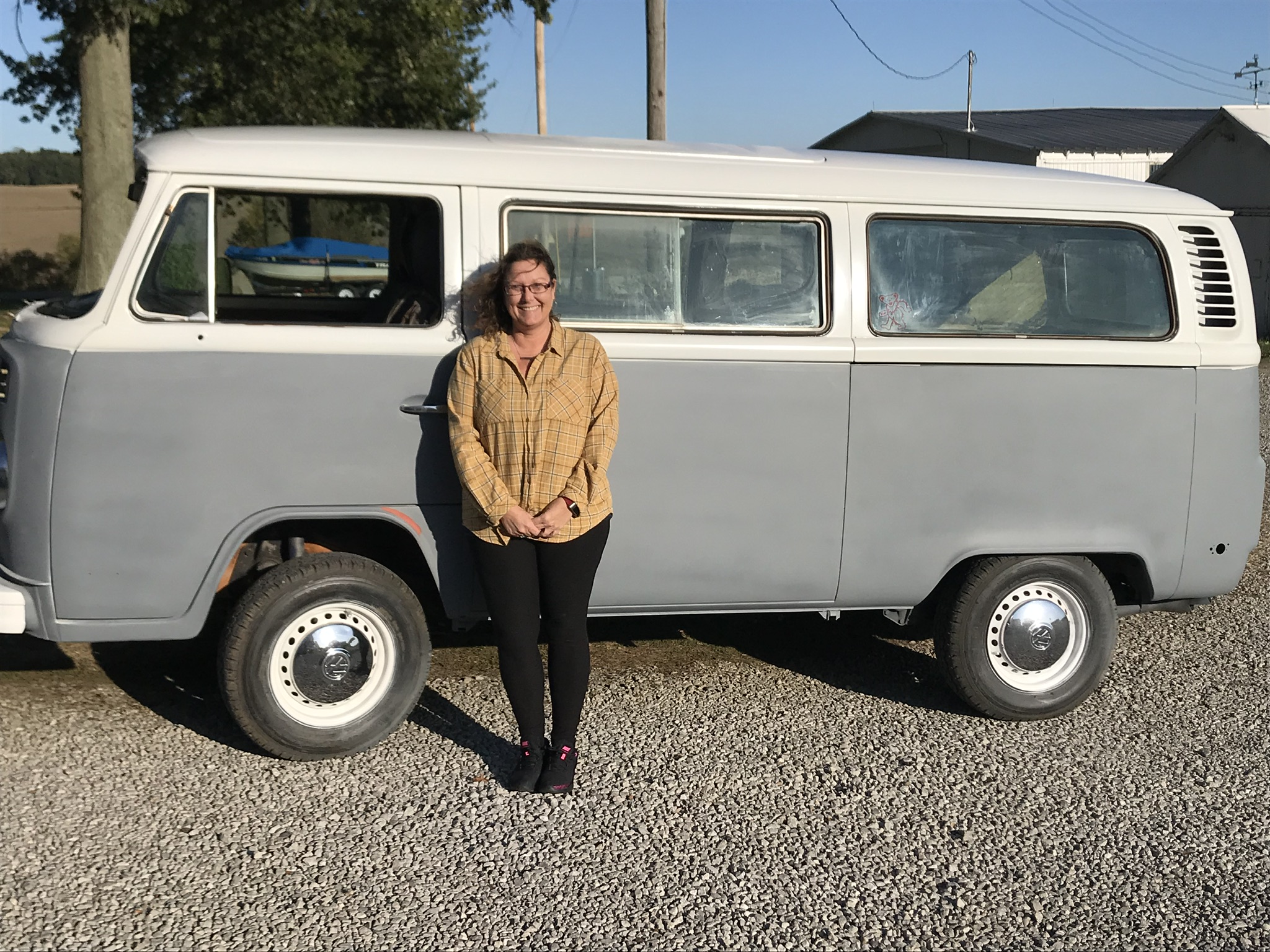

I got a 78 VW motor has been rebuilt but it bogs down between 2 and 3 gear. It is fuel injected. Any ideas??

Beautiful bus Lysa. You probably need to start with a good tune up. Quite possibly ignition timing issue. Not advancing properly.

What's the story behind its history and paint? How long have you owned it?

Thanks for the ideas.. It is hard to find someone around me that works on fuel injection 😔
I really want to get this fixed.. I want to drive her.
I got her last fall and my dad rebuild the engine and did the body work.. the inside is still really rough.
