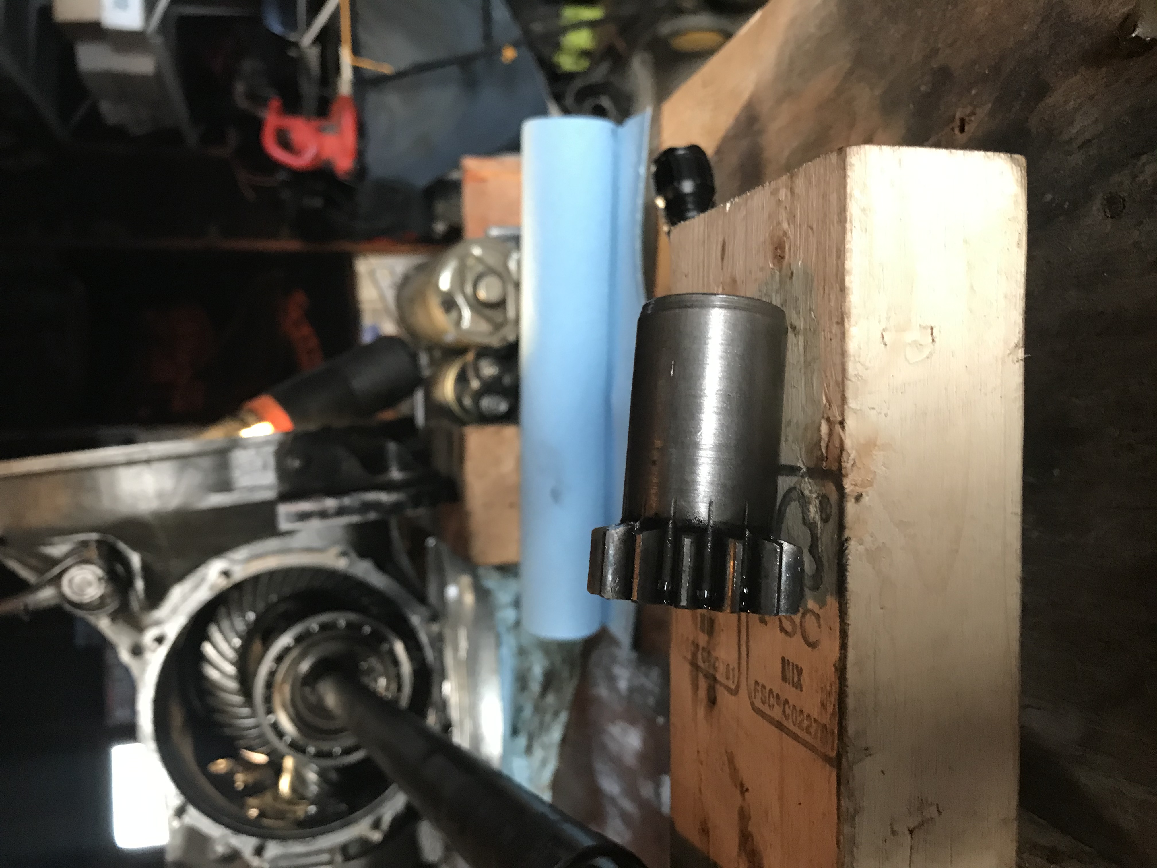

rear transmission shaft
Re: rear transmission shaft
X2 on everything toolbox said! It needs to get torn down so you can get access to the diff housing area. Fix it right the first time.
Replace the failed snap ring too and inspect the input shaft at the snap ring location to be sure it's not damaged.

I decided to pull the tranny and do it myself, you cant learn unless you try. try and find a 7mm stud, weddle ind has them 2.65 stud, 13$ shipping !! when I get the gasket set I will try to put the puzzle back together. thank you all for your input

got it back together, no extra parts, and it spins freely with no clunks !!!! will put it in this weekend .

I put the engine back in and it would not idle and ran hot, par for the course, fix 1 thing break another. I pulled it and took it to bruce, where he found my left intake manifold boot was cracked. I got a new pair in akron today and all is well again !! thanks again bruce for all your help
