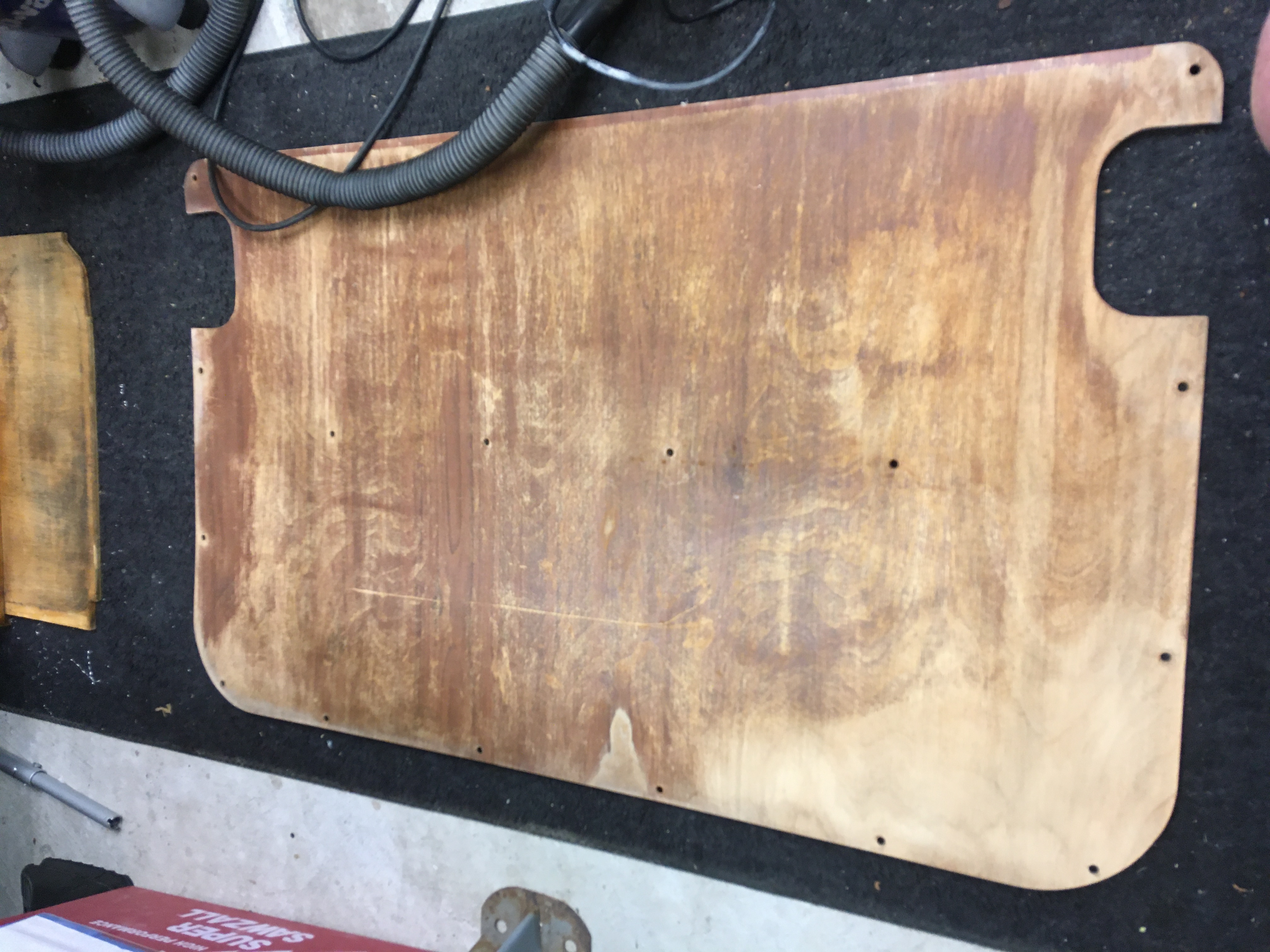

The rest of the wood looked so good I could not leave the sliding door panel alone. There was some kind of oil or ? In the wood that reacted funny with the varnish. It turned white and curled for lack of a better word. Only in the one spot. Sanded it out somewhat, not perfect but an improvement over what
I started with.

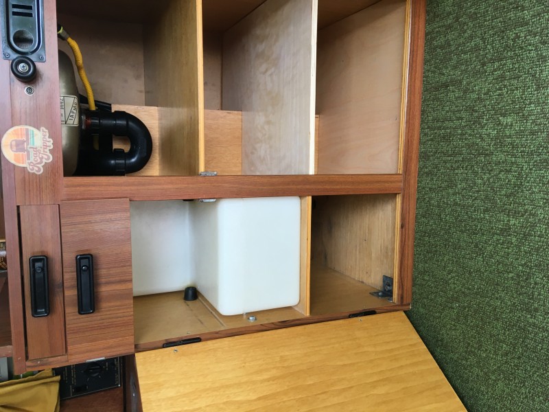

Put the main cabinet back in and replaced the main gas line while I had it out. Was able to get it at Home Depot. The original had 3/8 connectors as was 48” long. Most everyone else only had the 1/2 connectors. Resealed with the yellow Teflon tape and checked for leaks. No bubbles! Also cleaned and varnished the inside of the cabinets. Made a new shelf, one of the ordinal was pretty stained and beat up and made a new very thin bottom panel to cover the stains. I did RE varnish the entire inside including Masonite panel front and back. Also sanded varnished the underneath of the cabinet, no pictures of that. All this should give it some resistance to water.

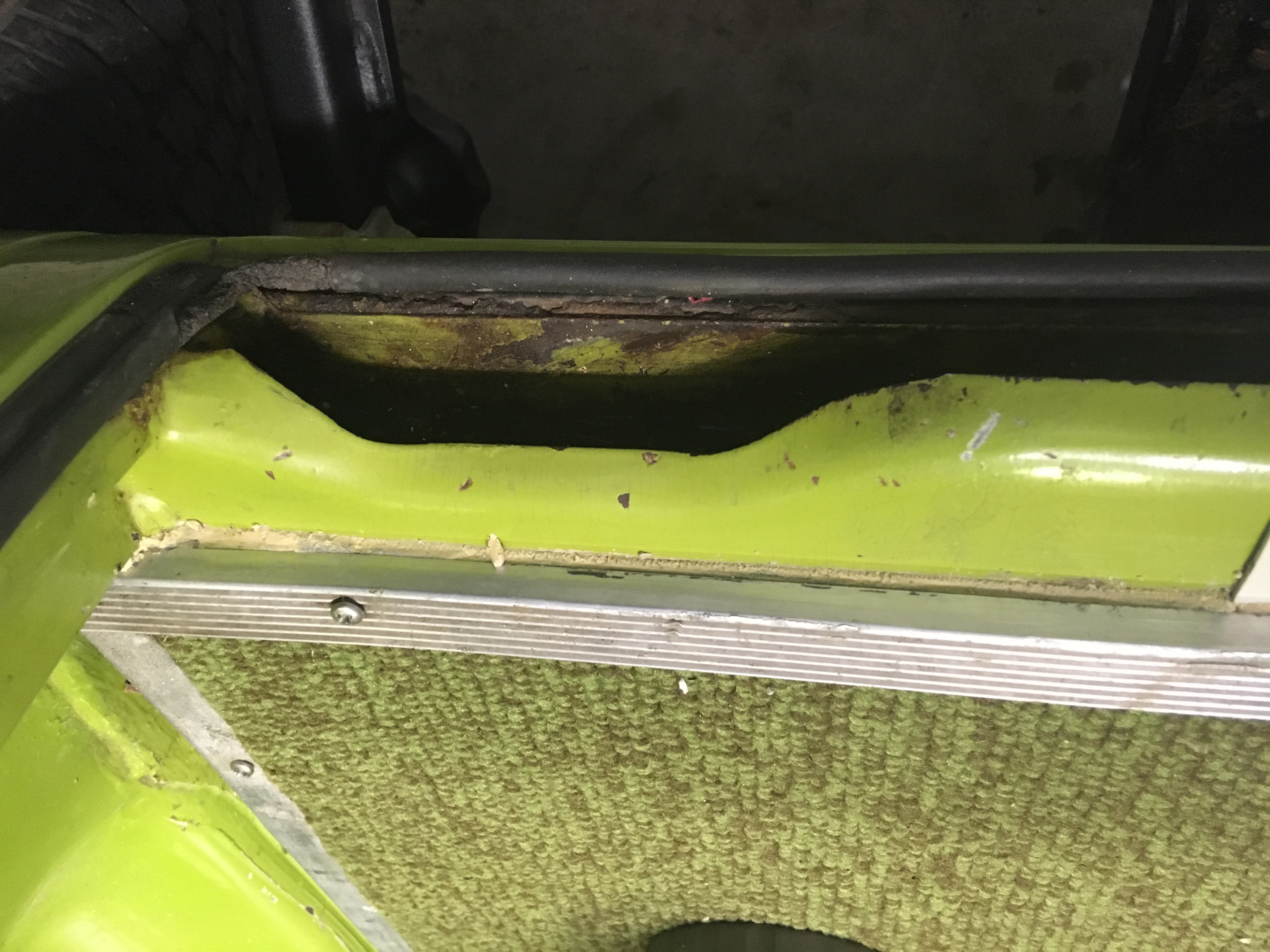

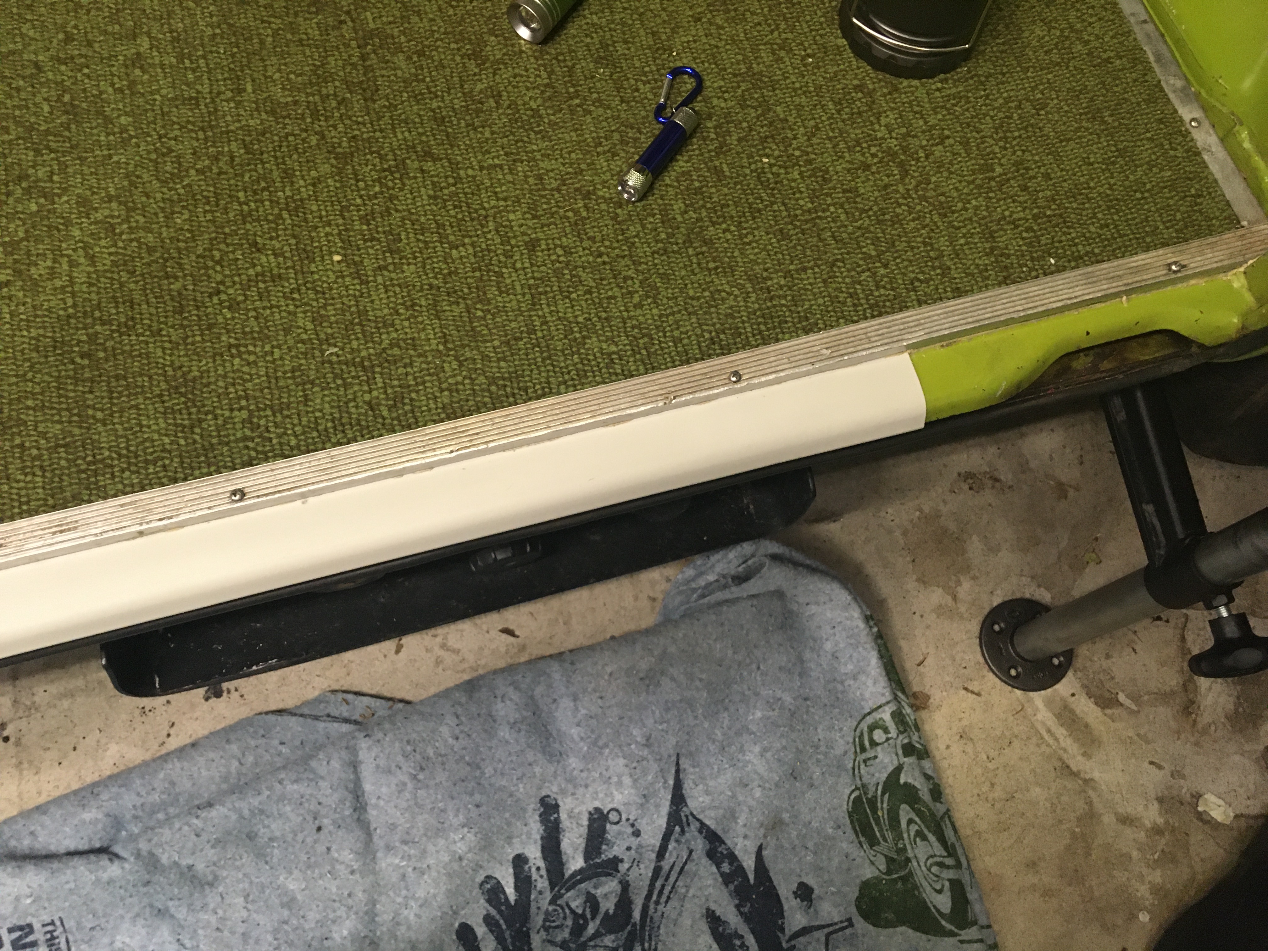

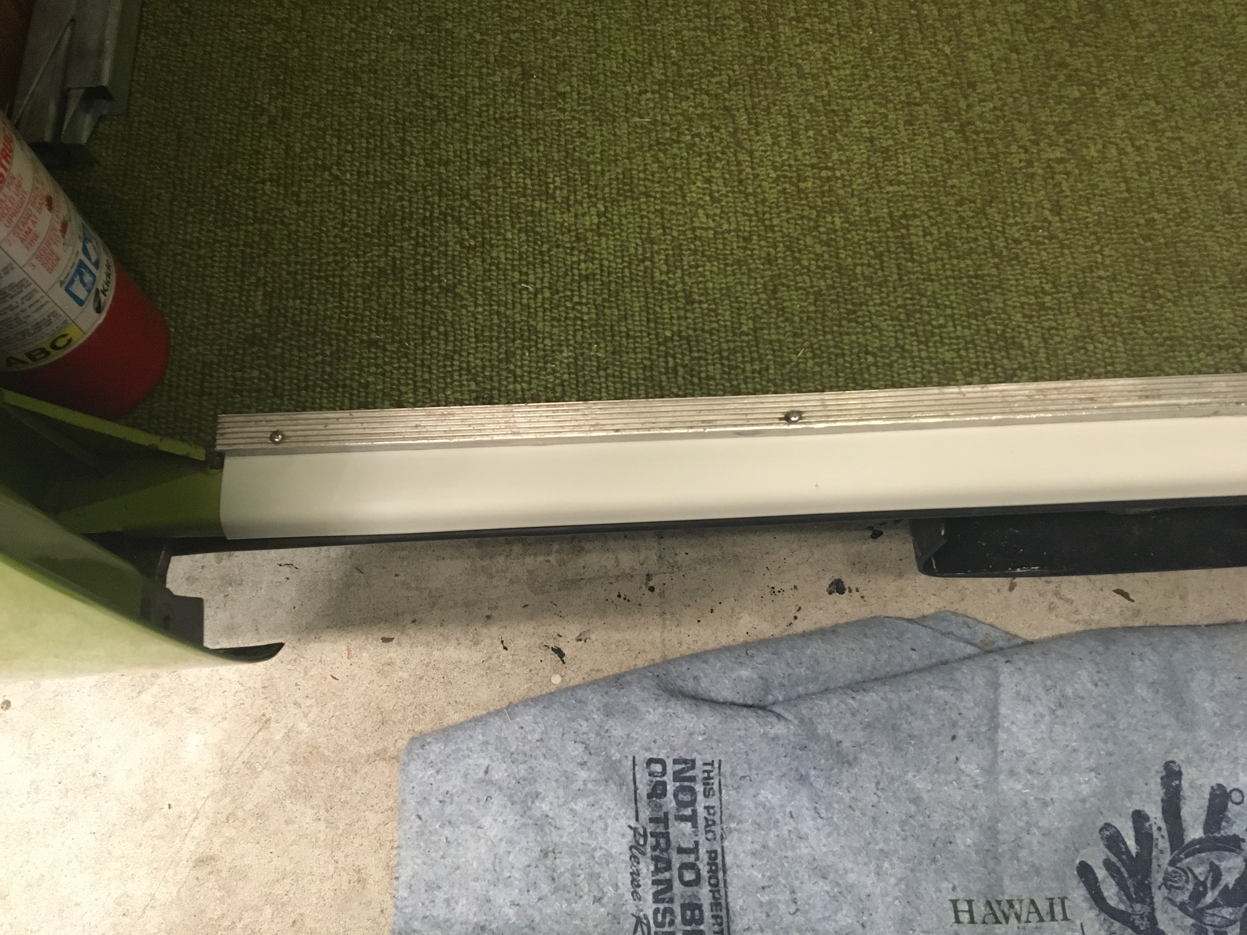

New sill cover finally came in. Everyone was out of it except Bus-Ok in Denmark. He was really nice and responded quickly but took over 25 days to show up. I had kept the old one just in case but was glad I did not have reinstall it as it was roached. When I took off the threshold plate it seemed to have some kind of putty on it acting as a seal. The putty was on the lip between the plastic sill cover and the aluminum threshold plate. I recreated it with some plumbers putty, the ordinal material reminded me of that or glazing compound. At rate I put some on when I tightened it down it oozed out so I think it made a good seal.

Not a repair necessarily buT a useful little item I also got front Bus-Ok as long as I was paying shipping from Denmark. A table leg stand that uses the jack mount. My contribution was a little leg I made from 3/4 in pipe. This way the bottom of the table leg won’t get chewed up.
