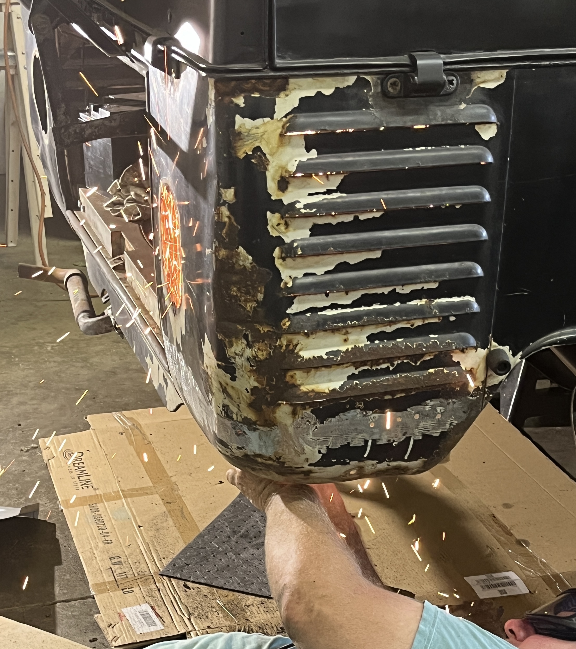

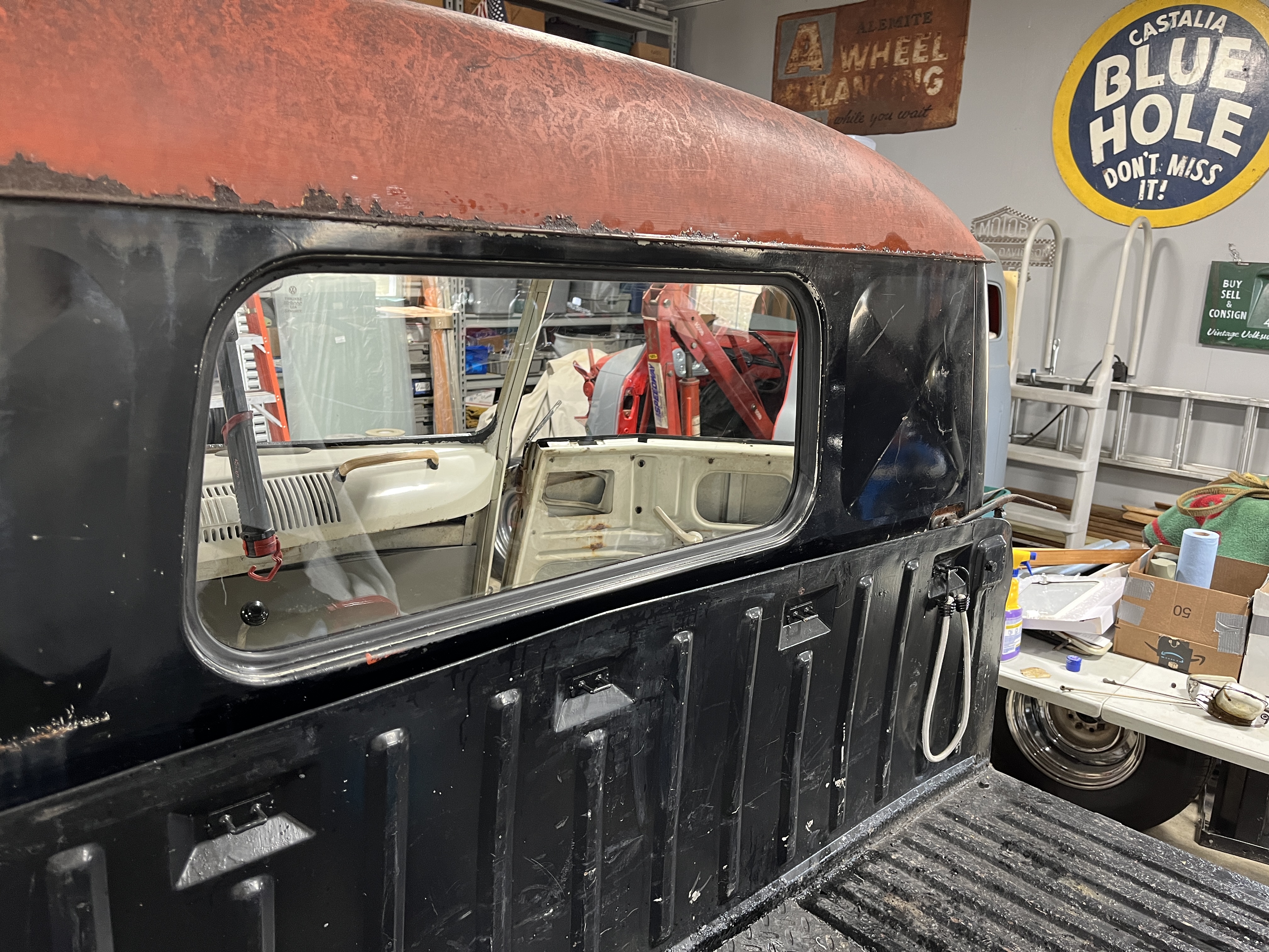

Got some work done on the truck.

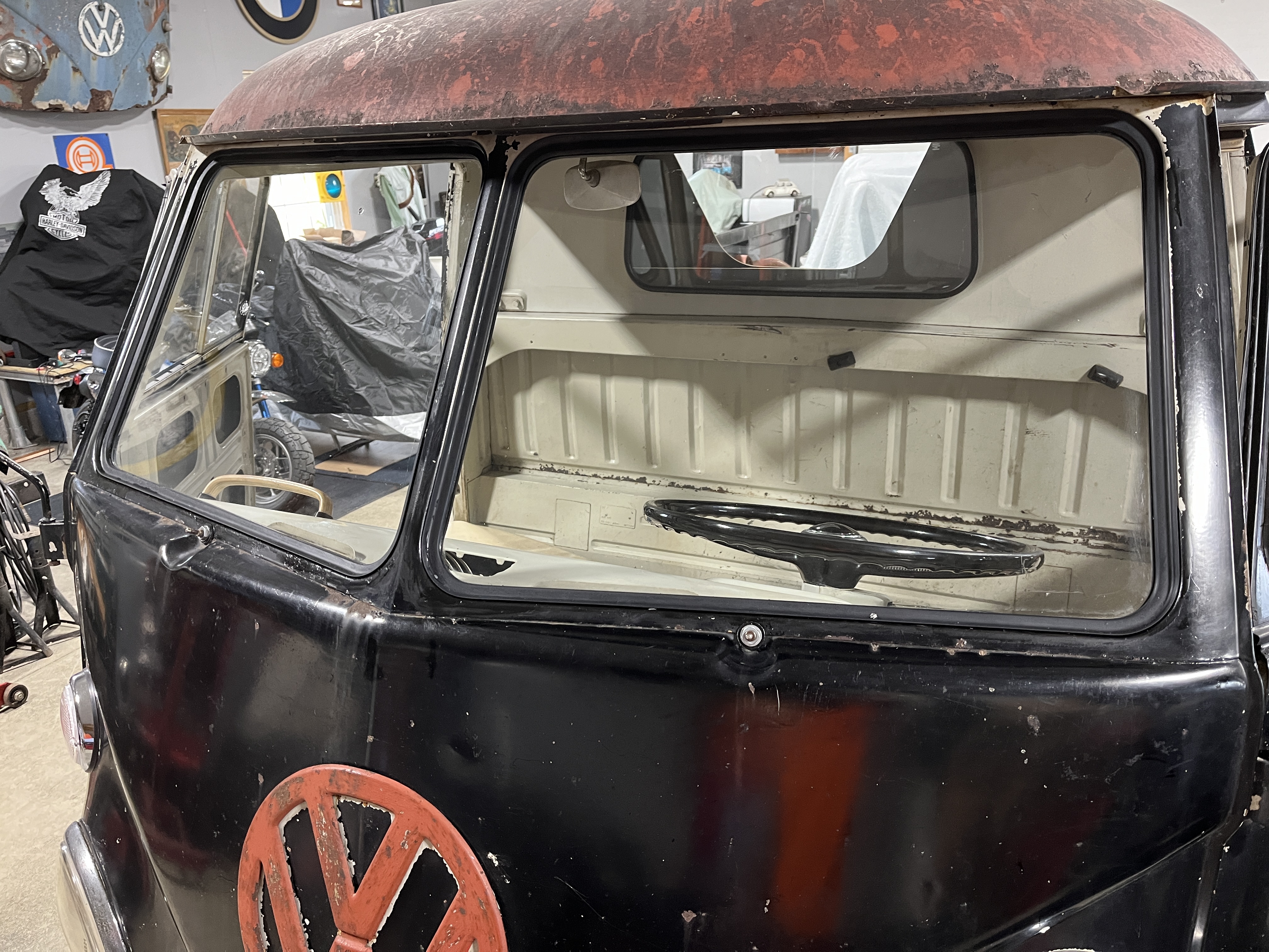

Patched up the holes and rust in the window sills.

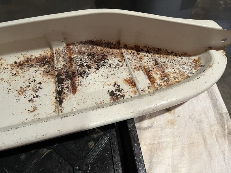

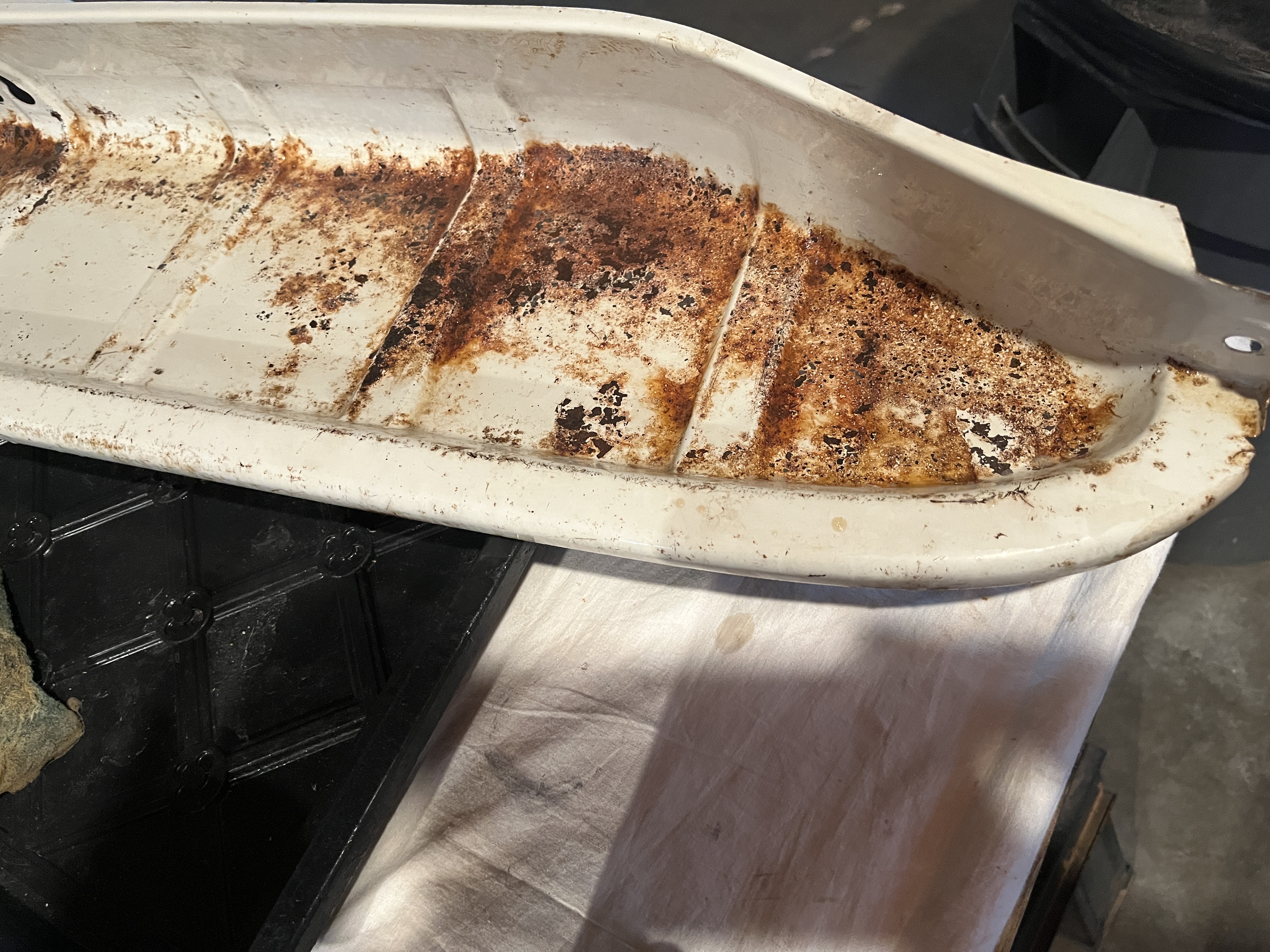

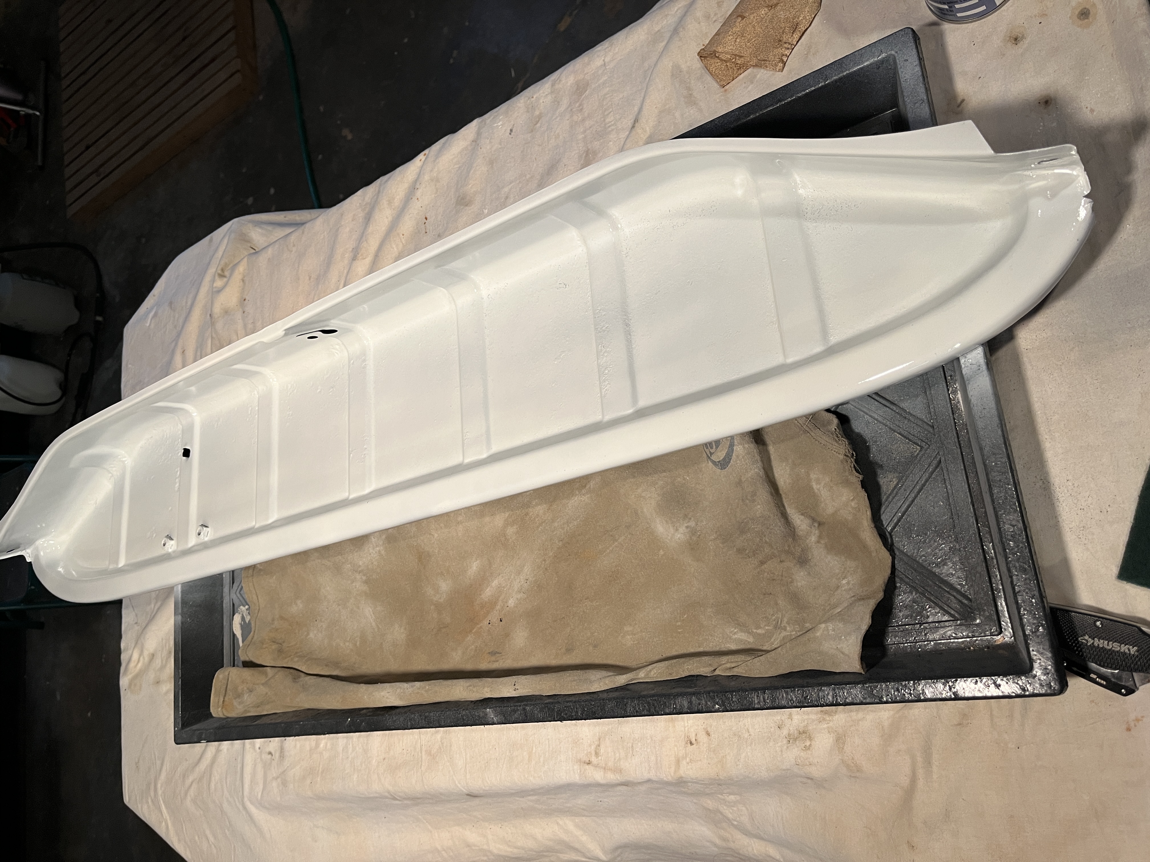

Cleaned, prepped and painted the parcel tray.

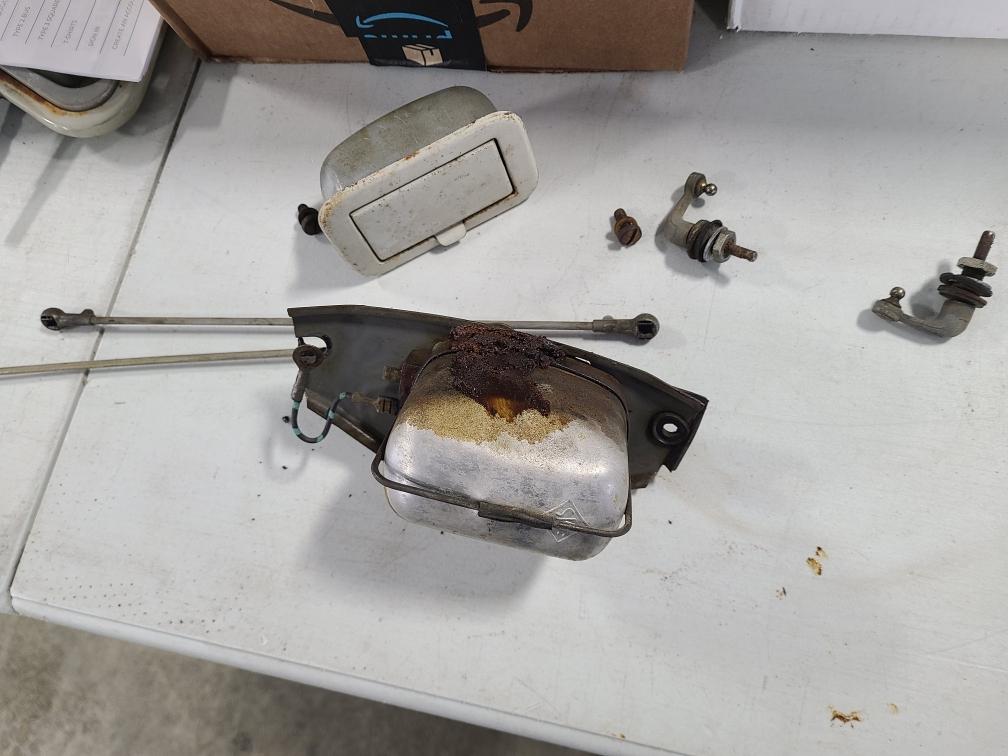

Upgraded the wiper motor to 12v and linked up the wiper stems.

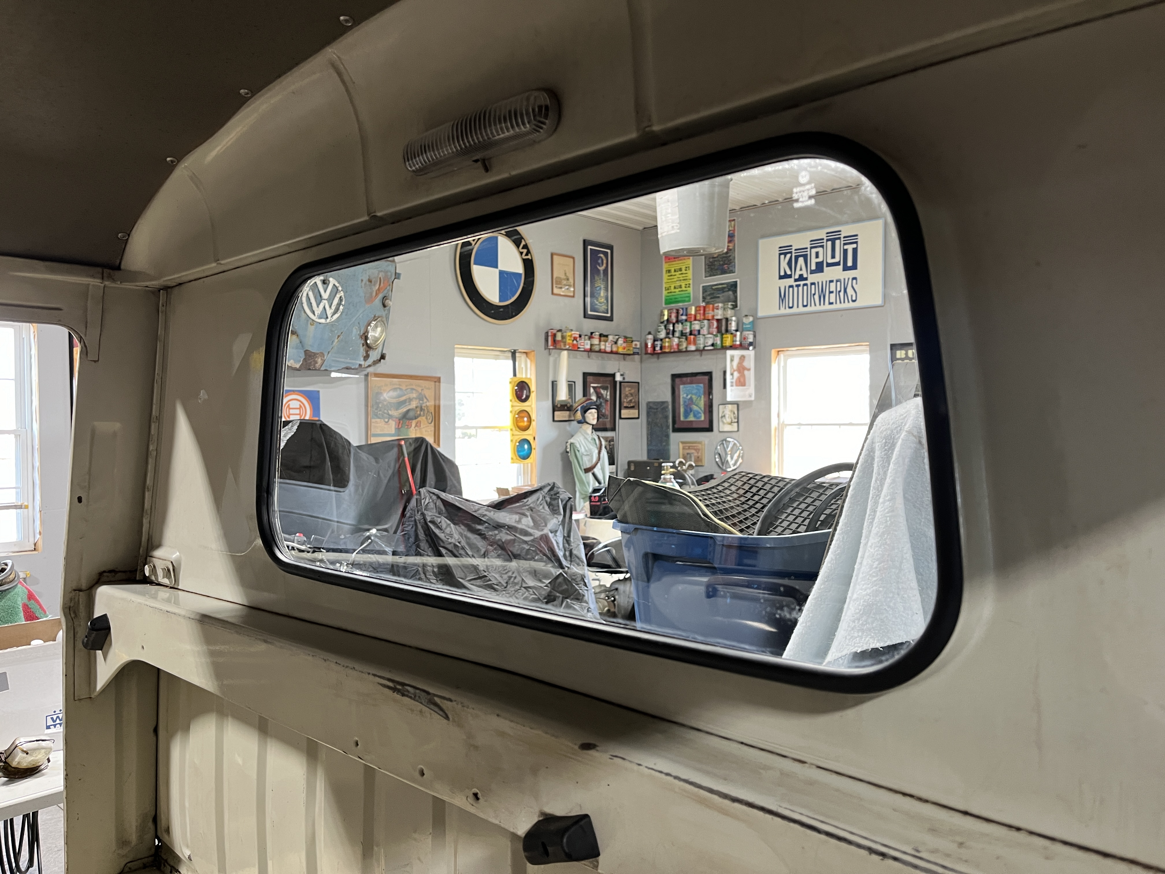

The glass is back in with new seals. Should be dry at least.

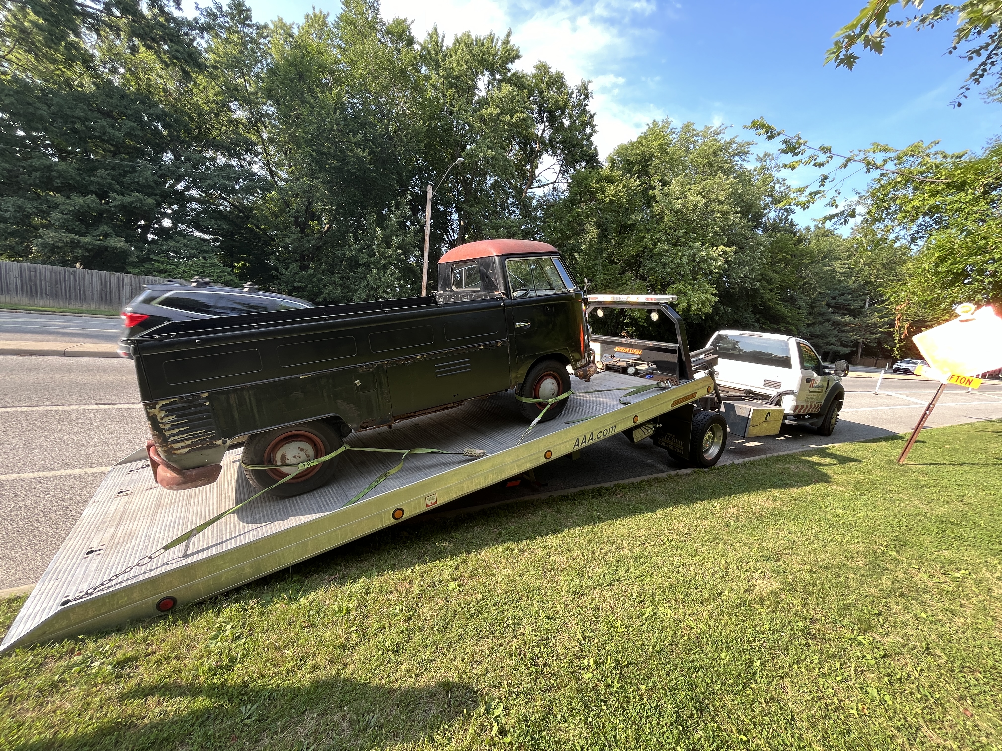

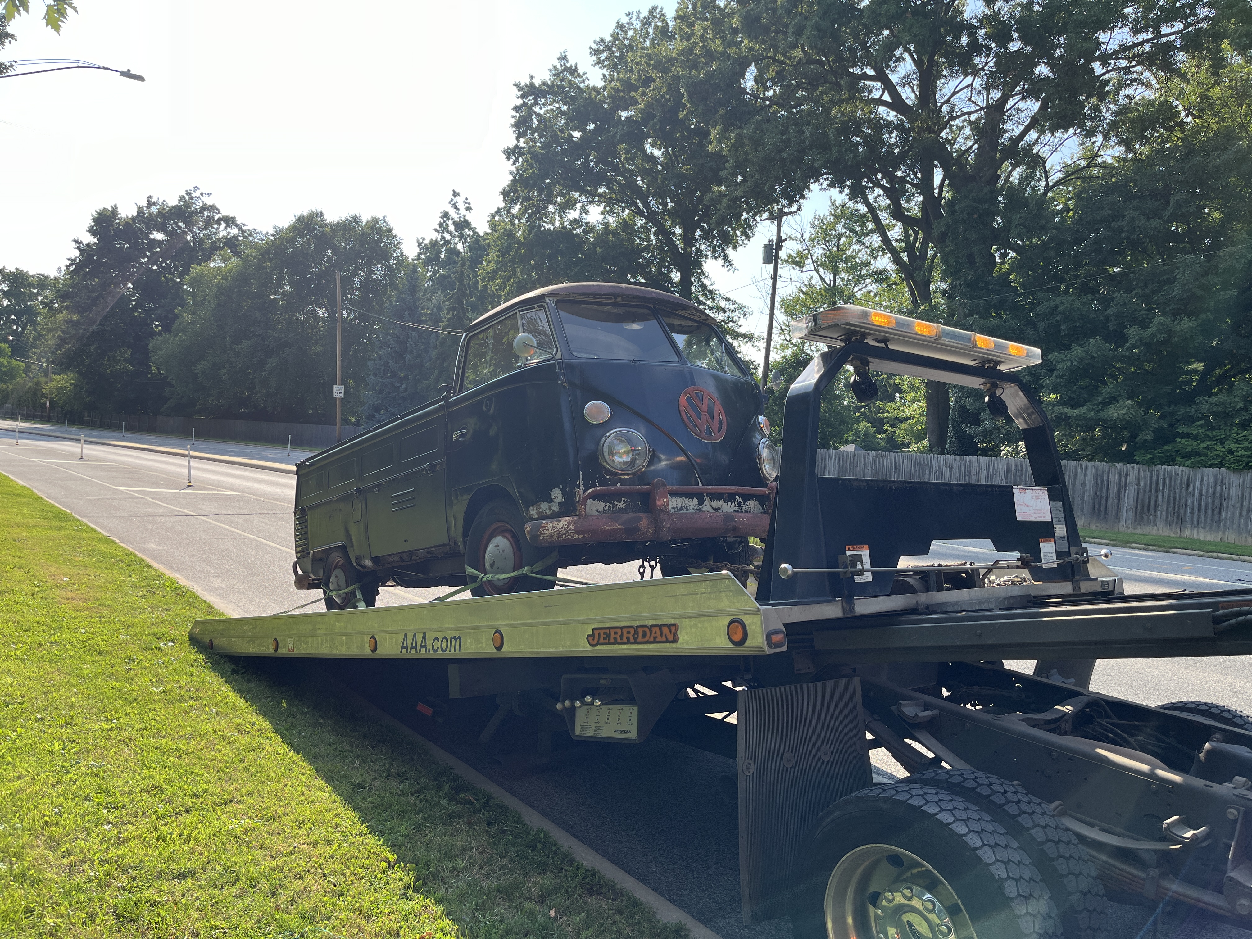

Brought Sanford out for the Vermilion Beach Market, and had to call a tow truck on the way home. It took almost 3 hours for a tow to show up in Lakewood.

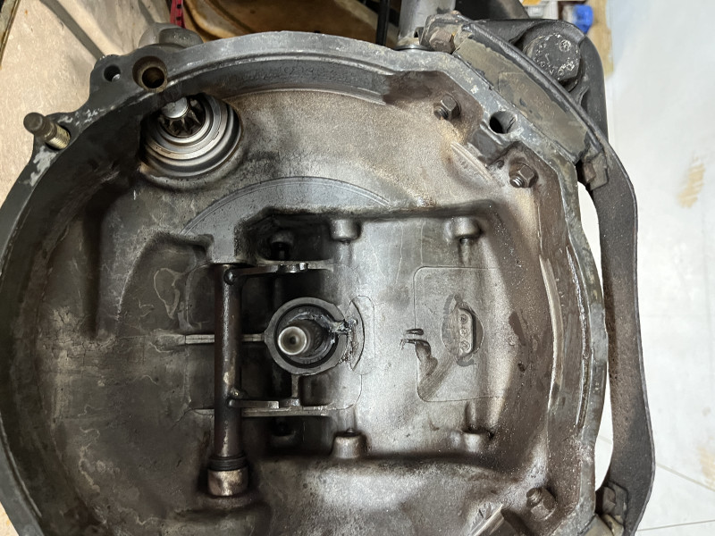

I had him towed to Bruce’s shop. Bruce’s initial assessment said it was something inside the bell housing, so the engine needed to come out. We worked on it today and found the clutch fork was broken. We decided to replace the clutch assembly while we had it all apart. Parts are ordered.
Stay tuned for more.

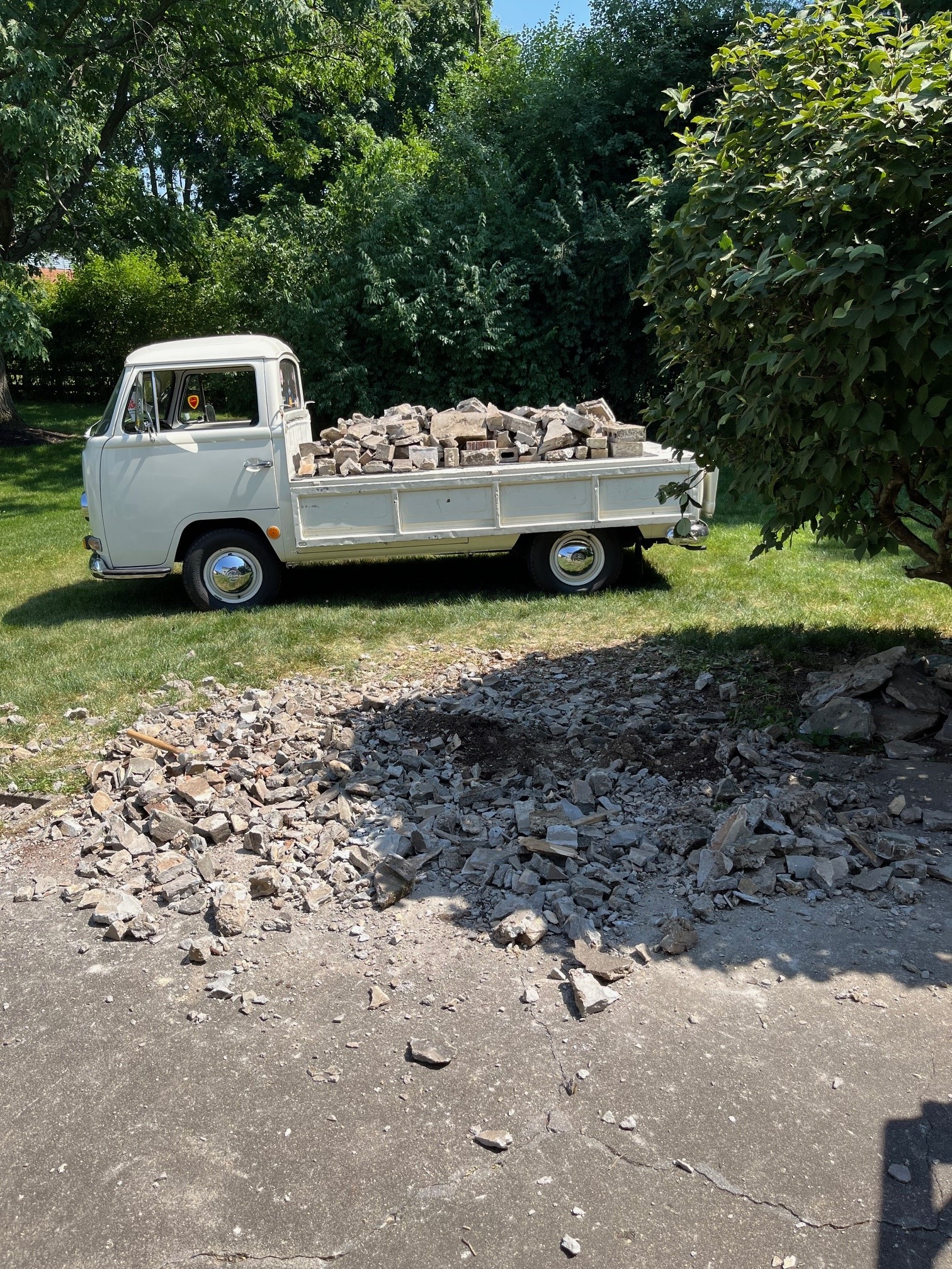

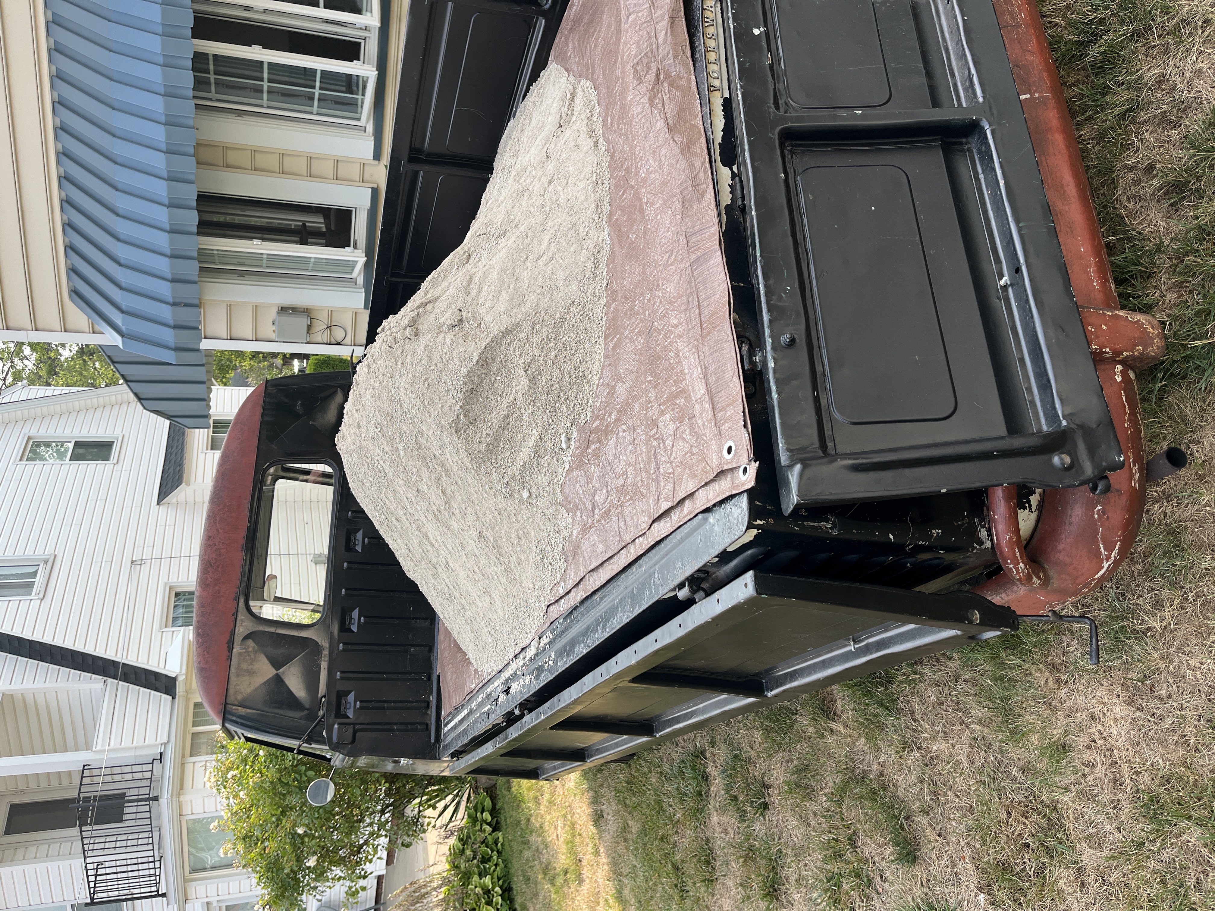

I installed a sandstone patio so I picked up some limestone screening with the bus. He did very well. It was a short trip and slow speeds, but I was happy.
