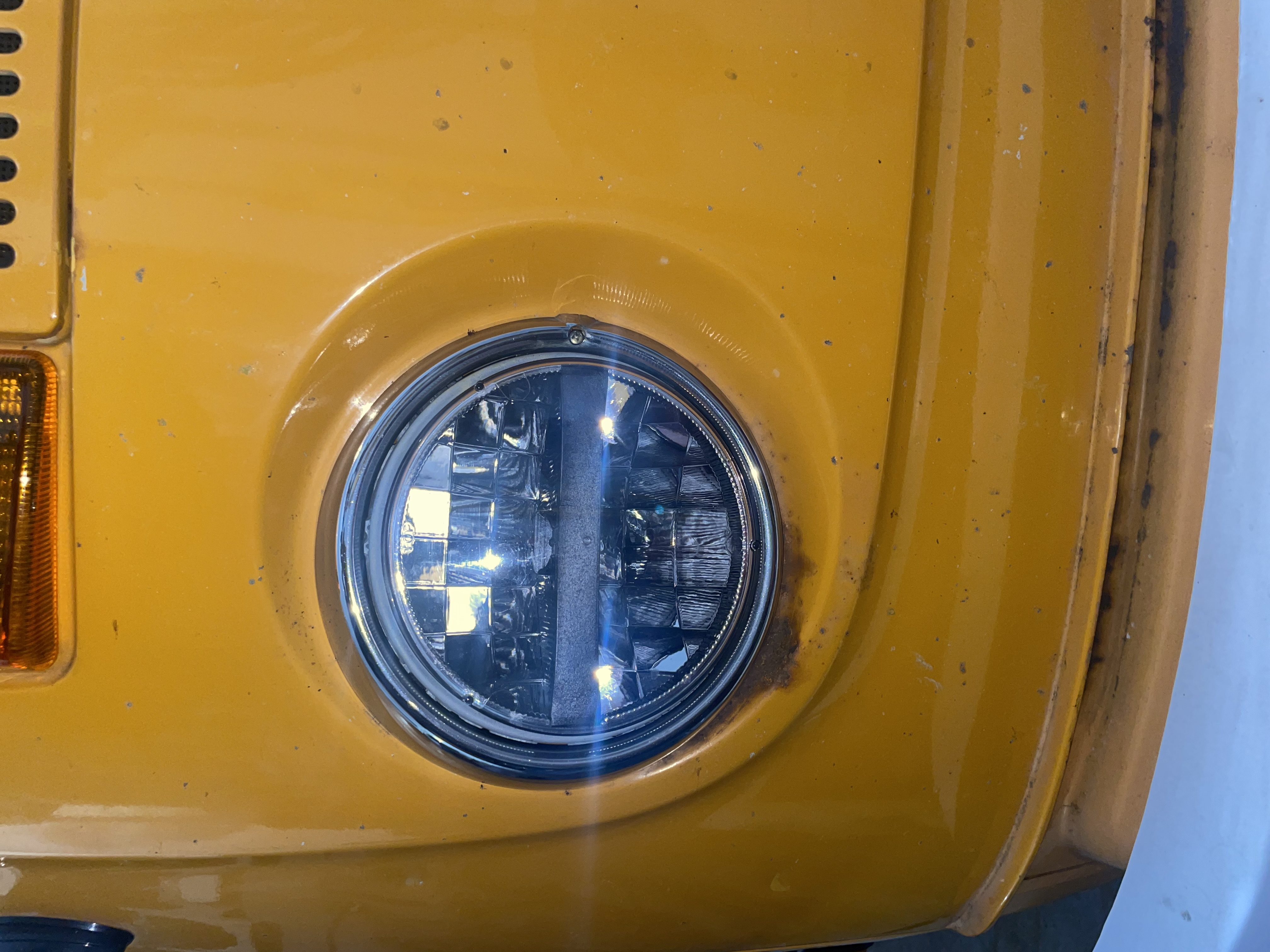

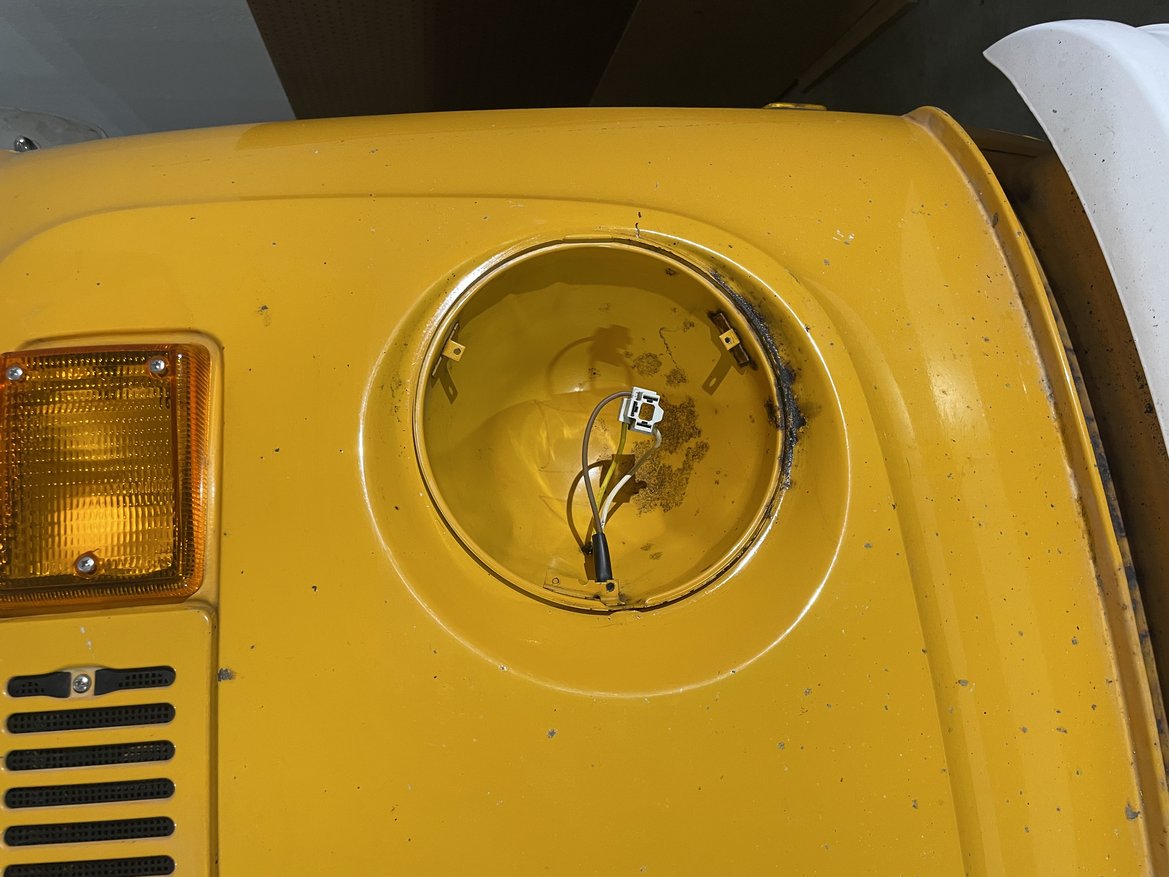

LED headlights from gowesty. Really impressed from my late night drive last week. Found some child labor to help with install.
