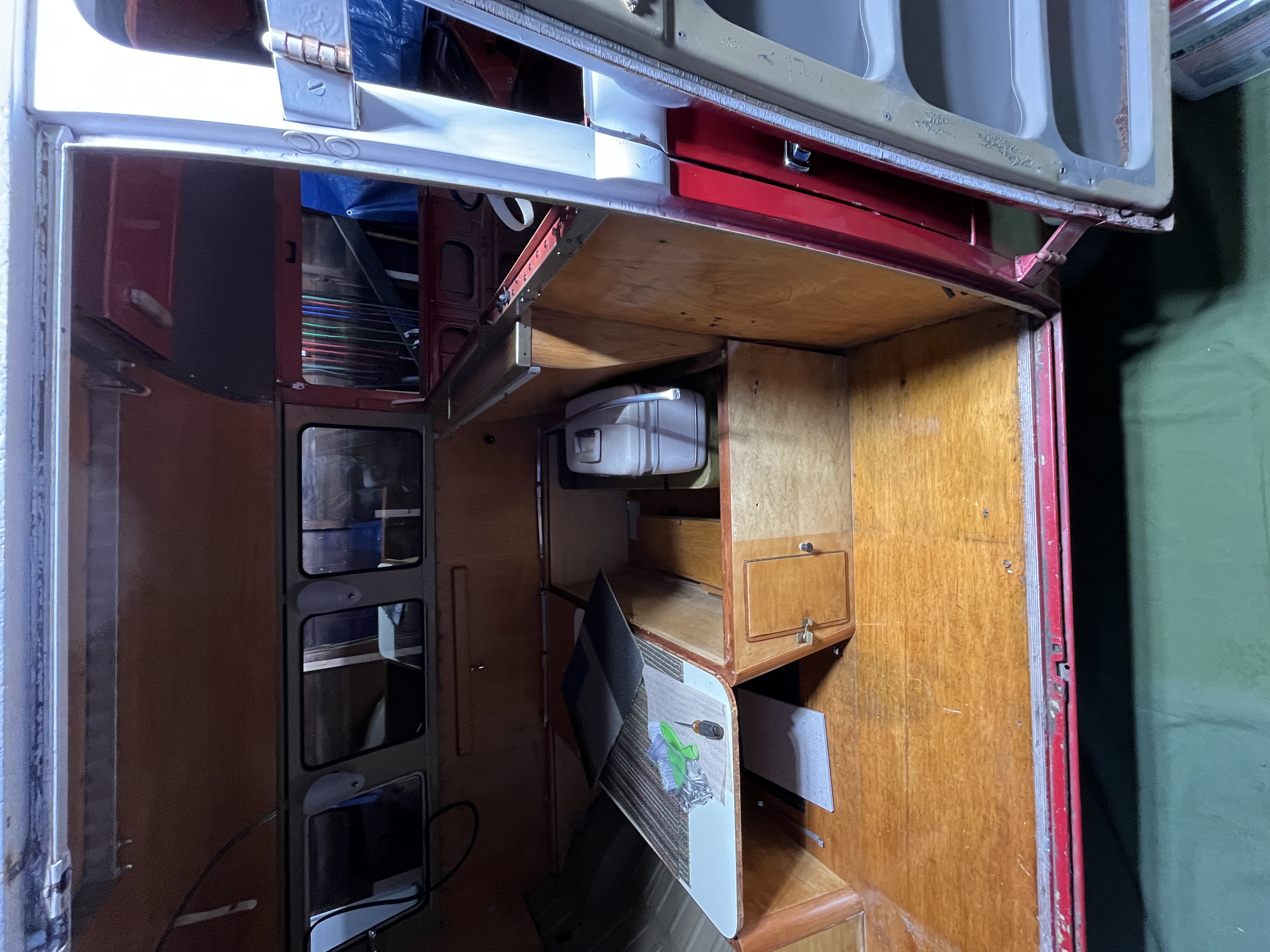

I decided to switch gears a bit in Gunther. I’ll be stripping it down and painting the exterior. I have a contact at Sherwin Williams helping me out with color and paint selection. Hoping to get some spray outs for samples to see how good we can get it.
Ib the meantime, I have been slowing taking everything off of the bus, packaging and labeling all of it. I’m not sure I’ll remember where all of this goes. Numbers, lights, cargo door panels, curtains, mirrors and wipers all removed so far.
I had a helper home from college so I concentrated on some of the work that is best with two sets of hands. All of the windows are out now. We worked on the cabinets but having a hard time getting the two rear most cabinets out. I’ve had them out before, I’m just not remembering the trick. So pause in that for now.
I also did a small area of stripper to see what I will be up against. It’s looks like I “should” be able to get it down to metal. We’ll see how this goes.
Here are some photos.
