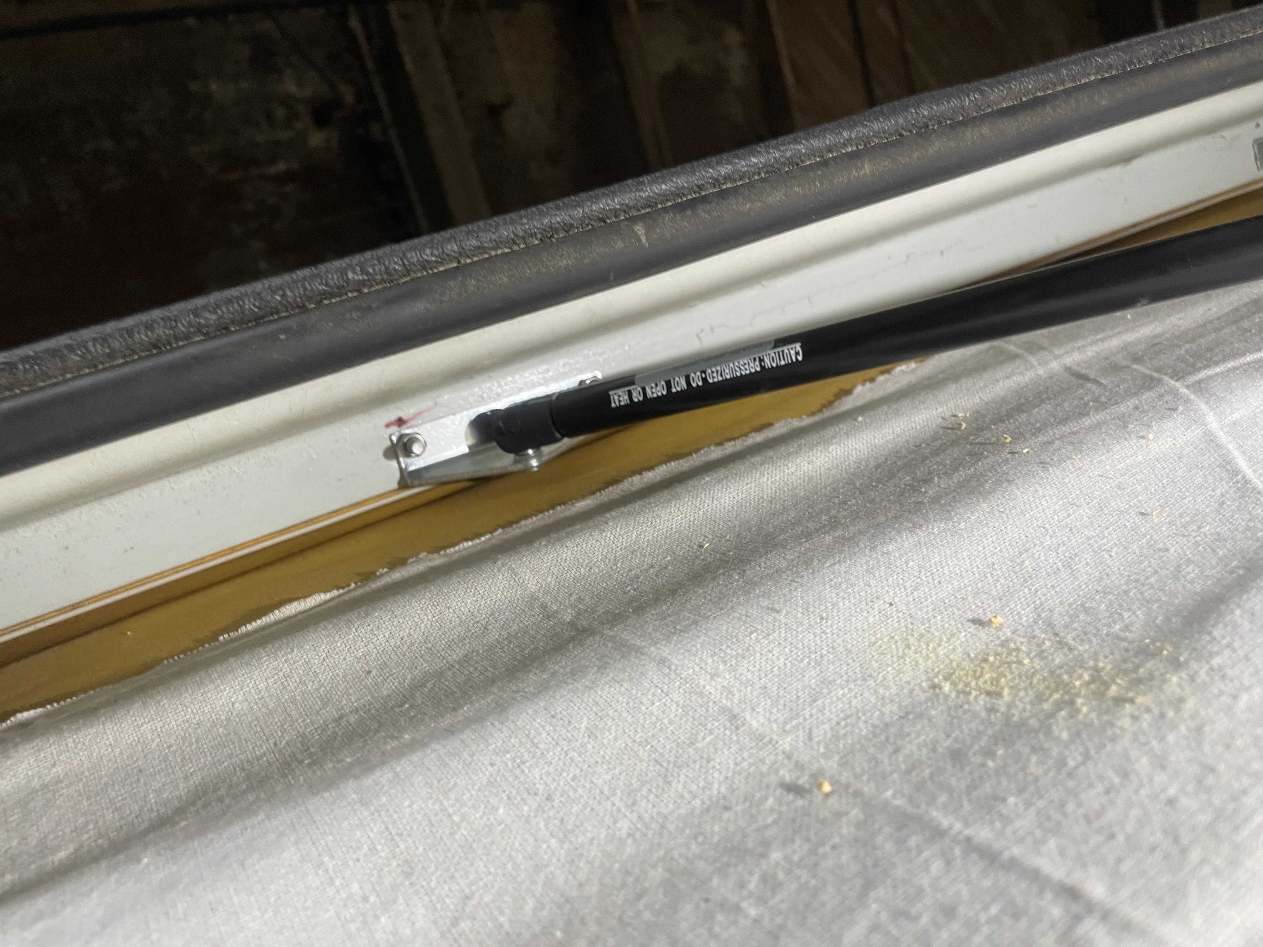

I started by installing the pop-top lift assist kit first. If any mistakes are made I could fix them later. Pretty easy install… The lift pistons use one of the bolts that hold the rear top hinge. Then the top of the pistons require drilling holes through the wood and fiberglass of the pop. I pulled out an angle finder to keep the drill at the same angle of poptop and make a nice straight hole.
I’m happy with the results, the top is much easier to lift. Pulling the top off in the coming days for sanding and painting.

Top bracket placement. Best to get the holes centered on the wooden frame.
Final install
Final install

I like that drill/angle finder trick, thanks for sharing!

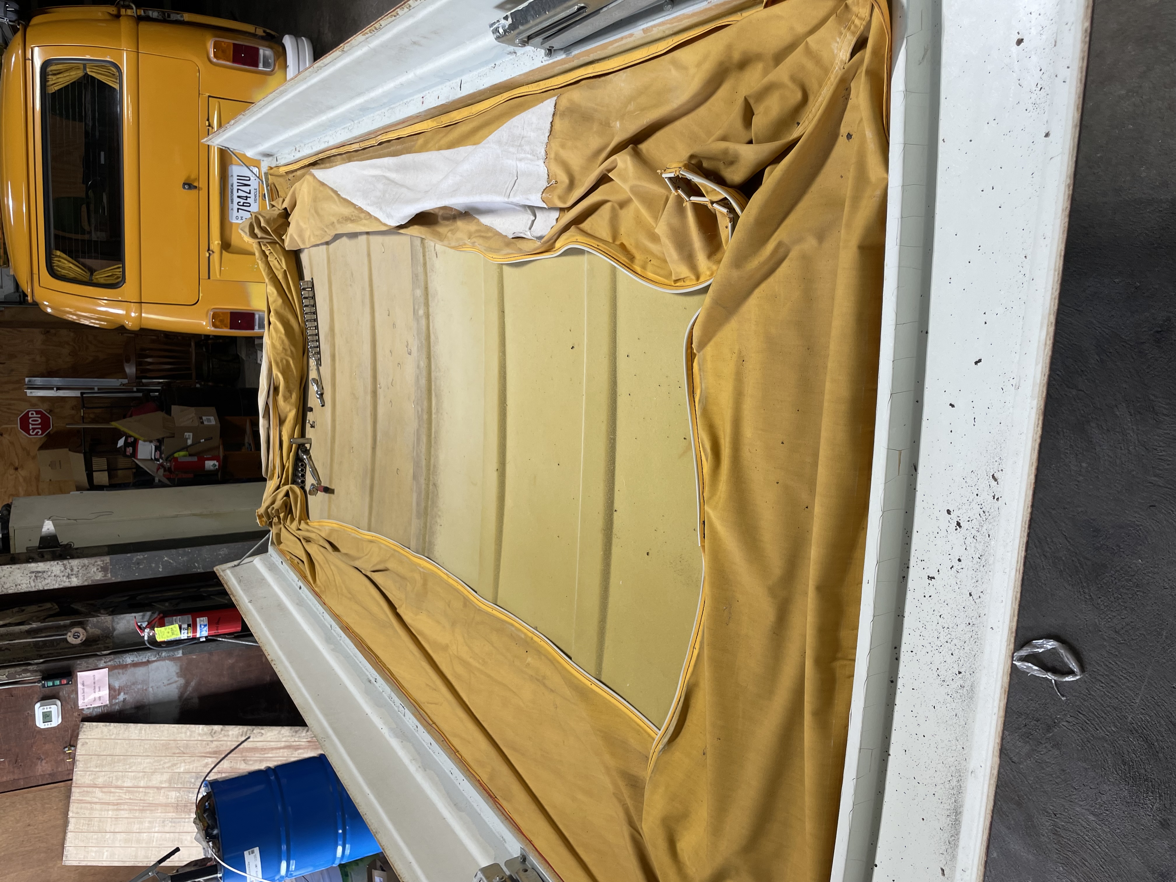

Canvas and parts striped off

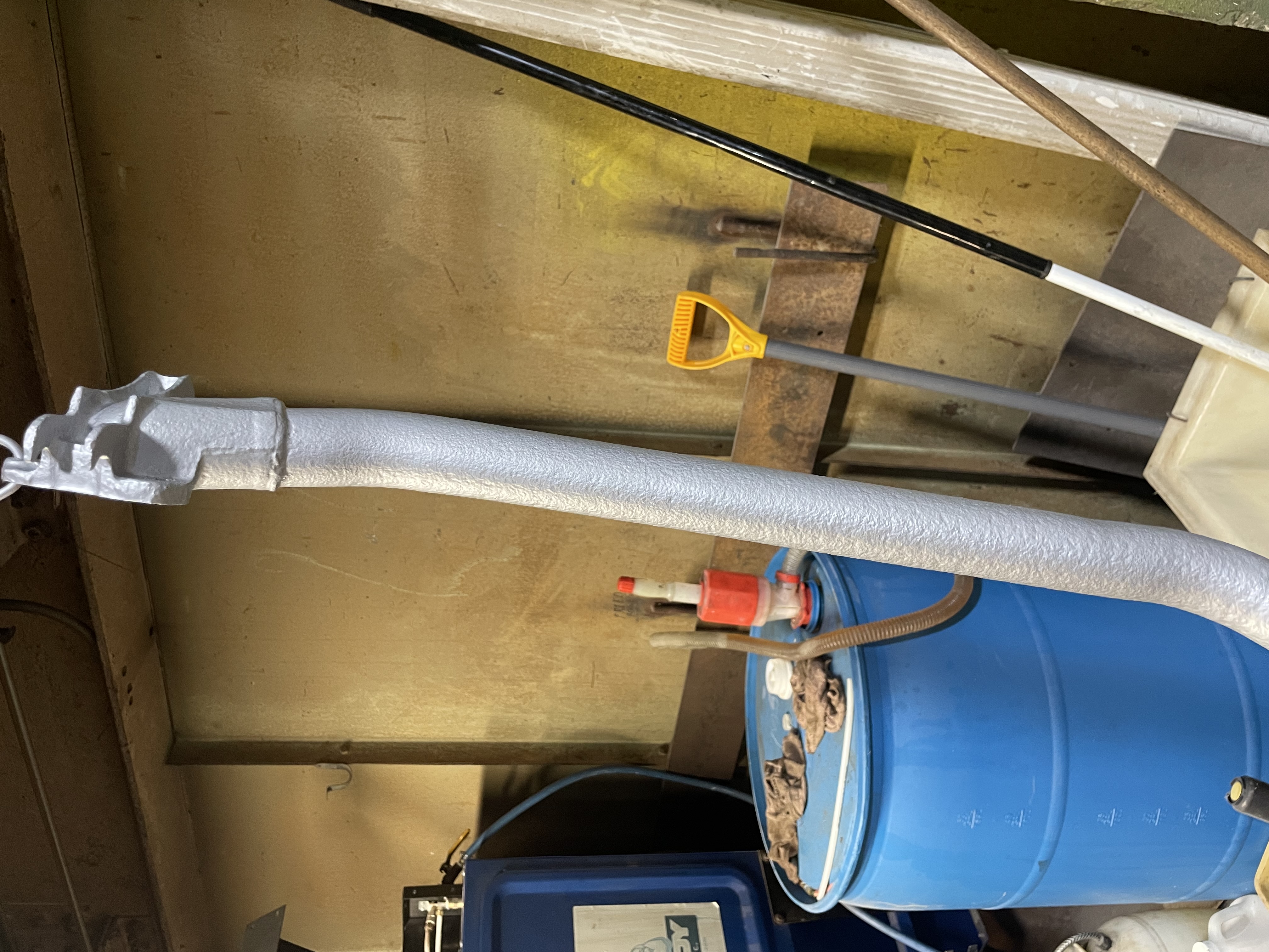

Catalytic delete pipe goes between “Y” pipe and muffler

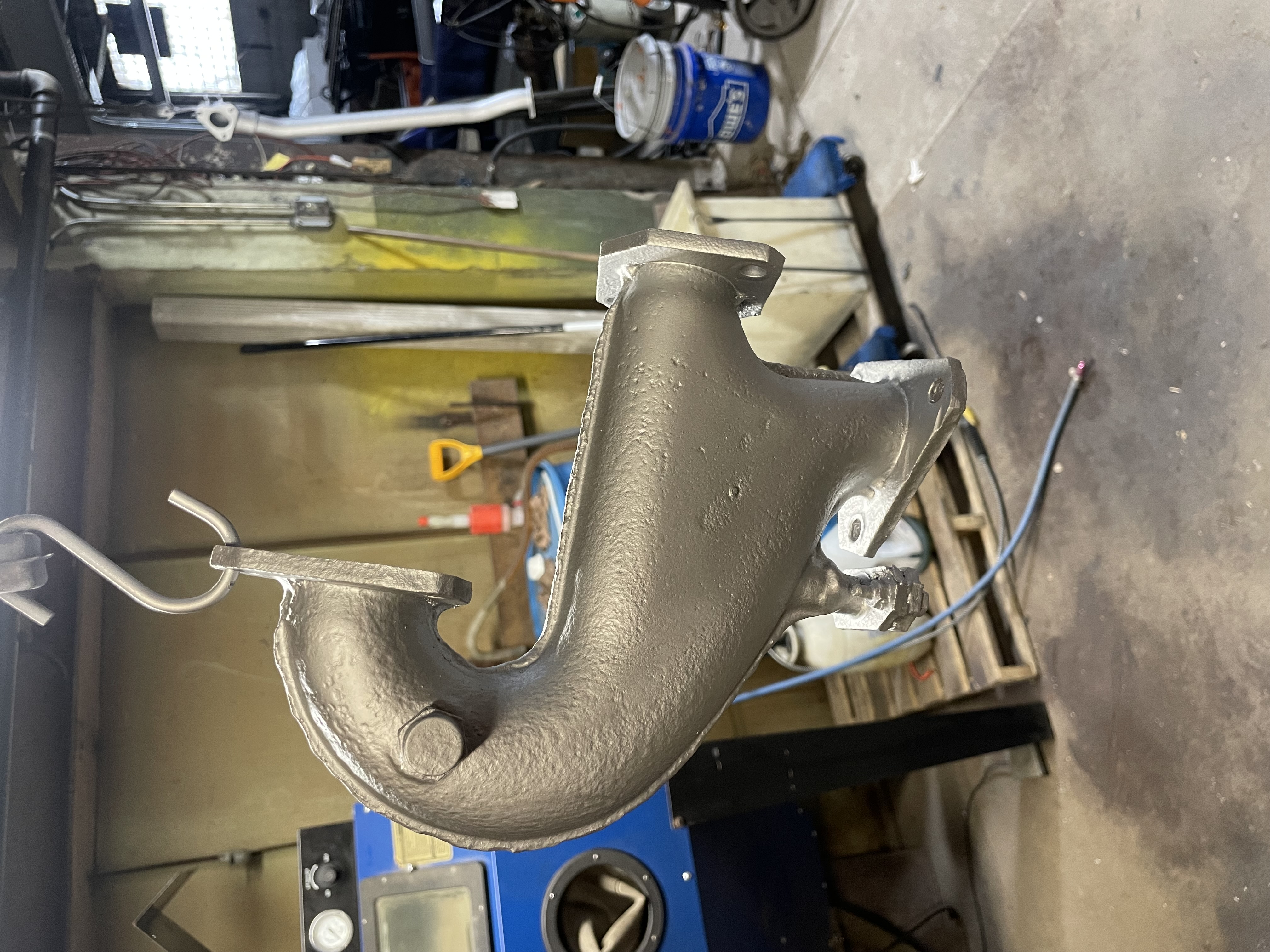

Orginal VW heater box with N/A “F” pipe header
