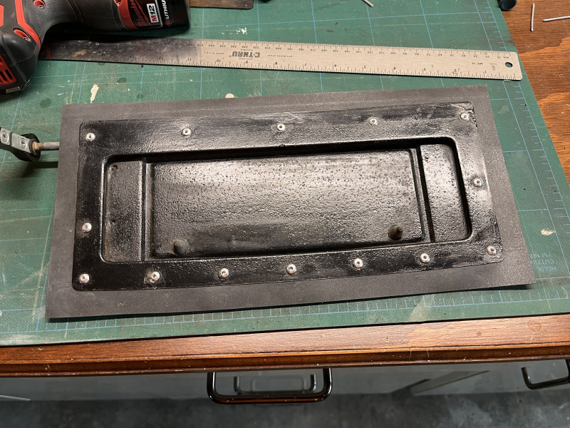

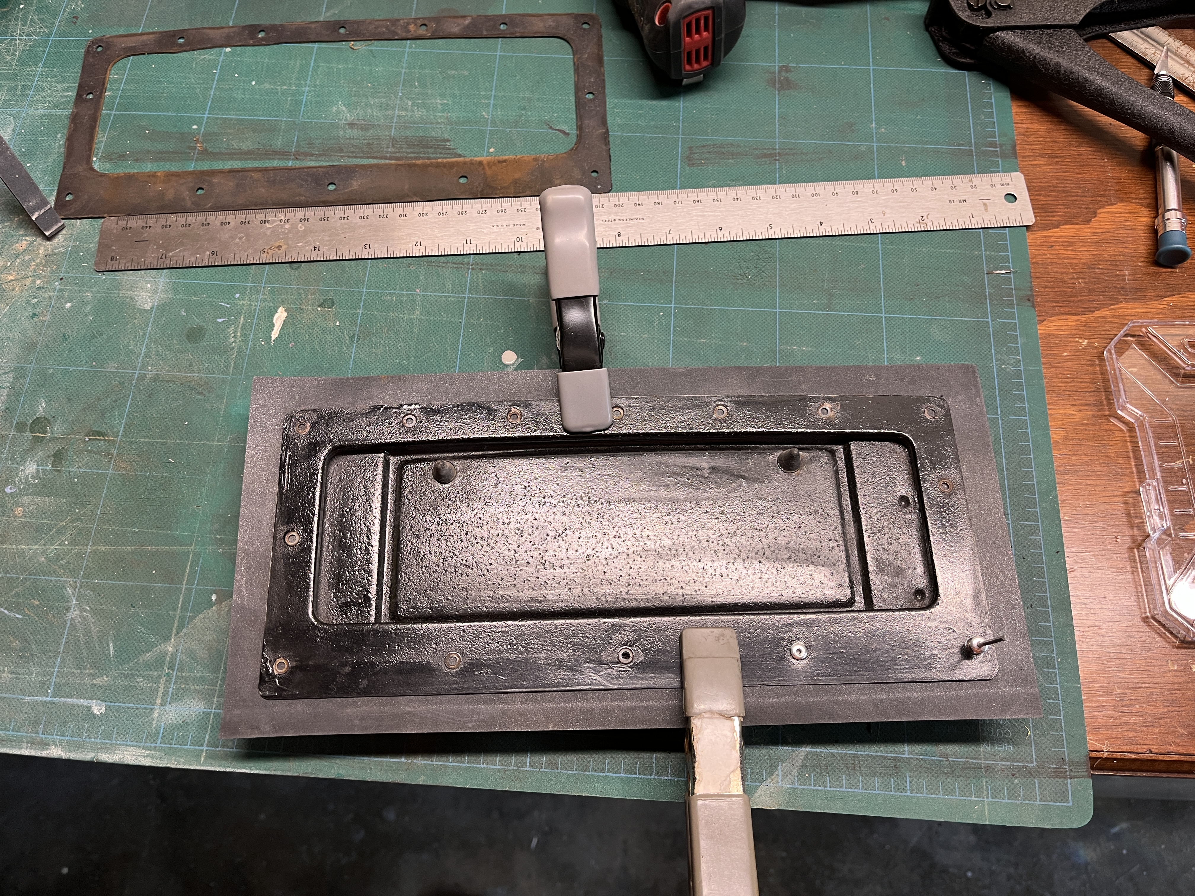

Installed the interior woods panels, fresh air vent flap, the cover and few odds and ends. I Made a new rubber flange for the air vent and re -riveted it back together. It feels like a tights fit so the should help the wind noise. I also added some rubberized stripes to the cover, that should help as well.

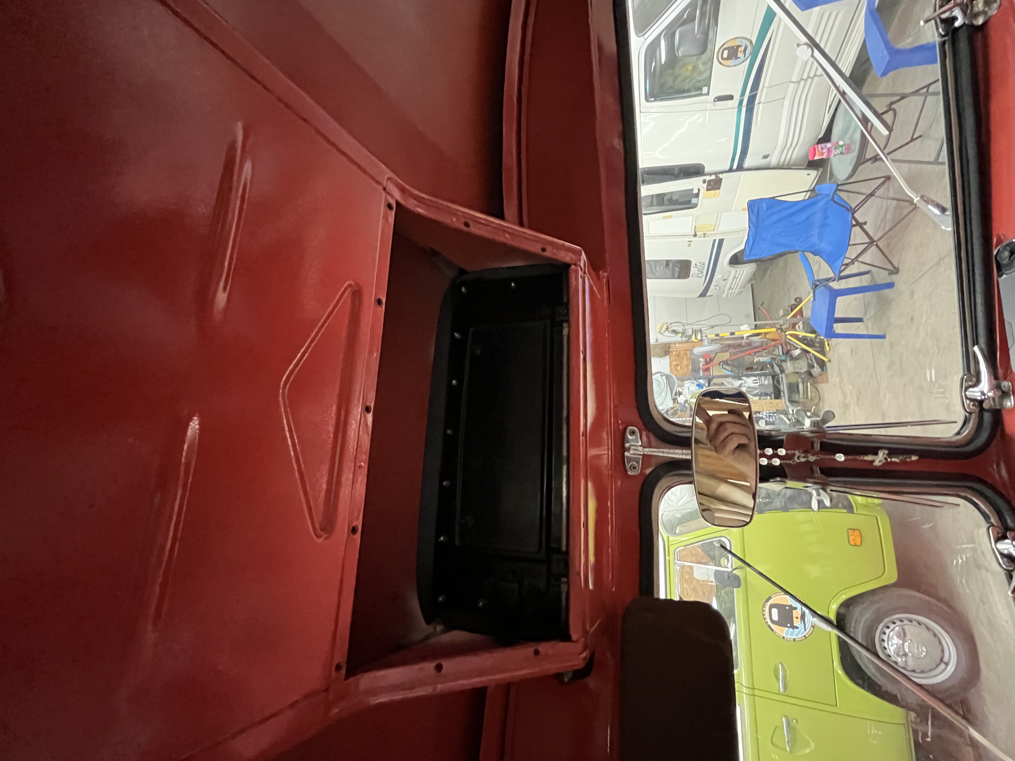

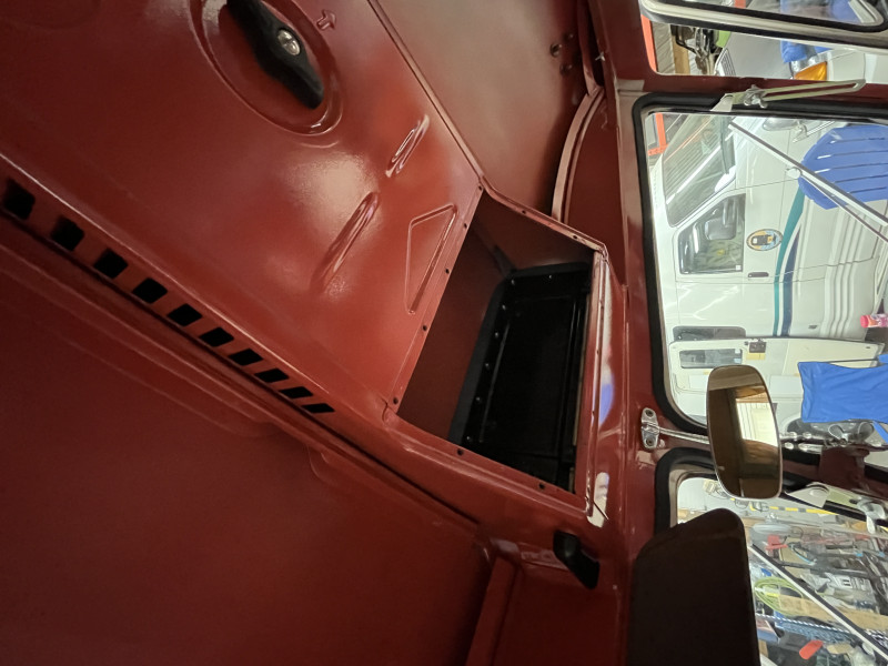

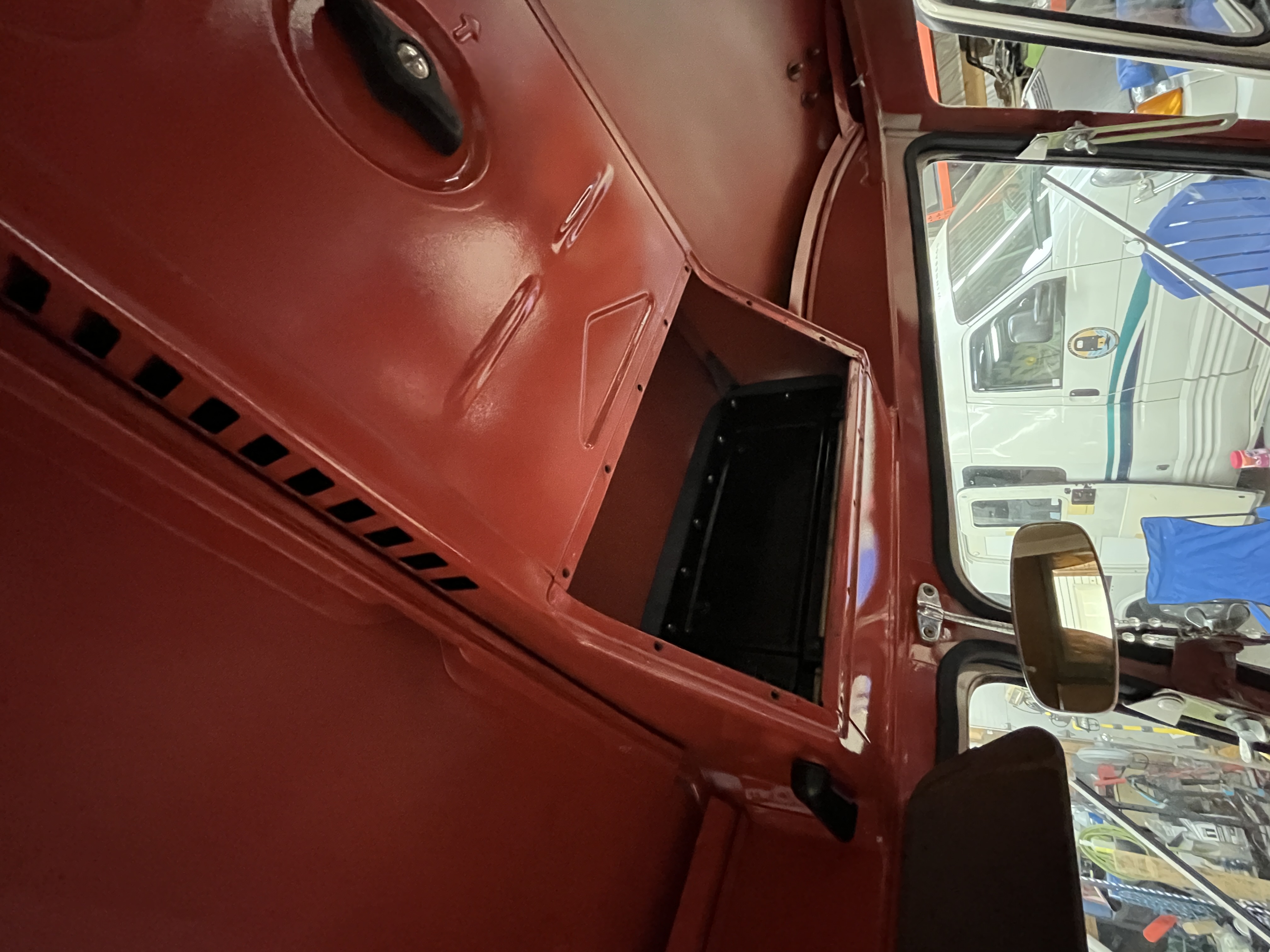

Did you install new foam on the inside of the vent area? It's what the flap seals against. Also a good time to seam seal the freh air box to body joints.Marla wrote: Sun Mar 29, 2026 5:53 pm Progress continues slow but sure.
Here is some info... https://www.thesamba.com/vw/forum/viewt ... p?t=102071
Thanks Ted and I can answer Yes to all of the above. I think
I even painted the inside of the air vent area with rust encapsulating paint before sending it out to the paint shop. I also painted the back side of the cover plate and sealed the inside before assembly. I saw that thread on the samba and another one that gave dimensions for the rubber flap. I made my own from some left over EPDM rubberized roofing I had on hand. The foam inside seemed to be in decent shape so I left that alone. I may regret that decision but we will see.
The foam I used to seal the cover plate was a much thinner, self adhering foam that is used for sealing exterior junction boxes. I also had that on hand and thought it would work. it compressed a little bit and filled the gaps. It seems to be a good fit, we will test it out this summer.
