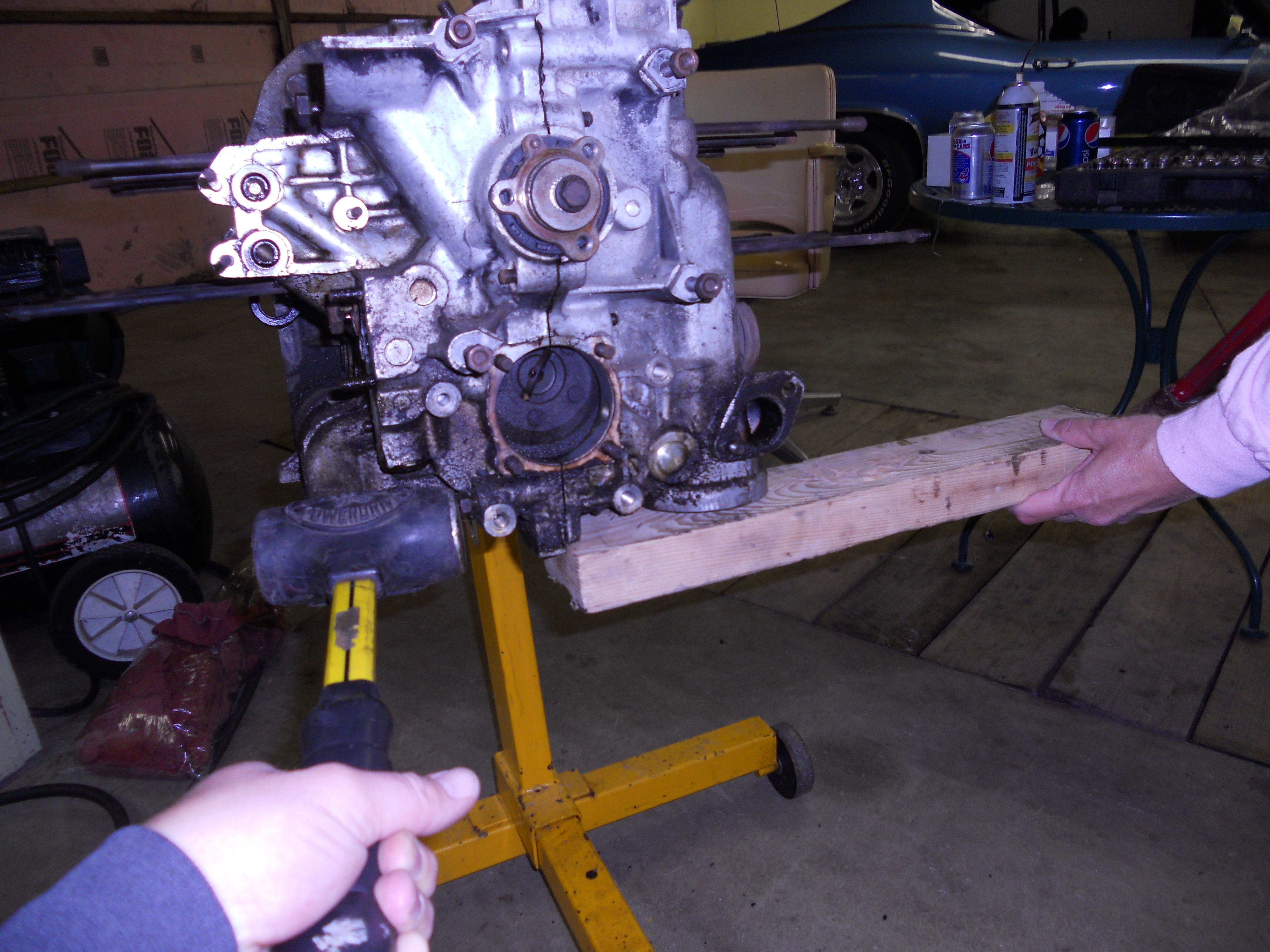

Beginning the split under the oil pump opening.

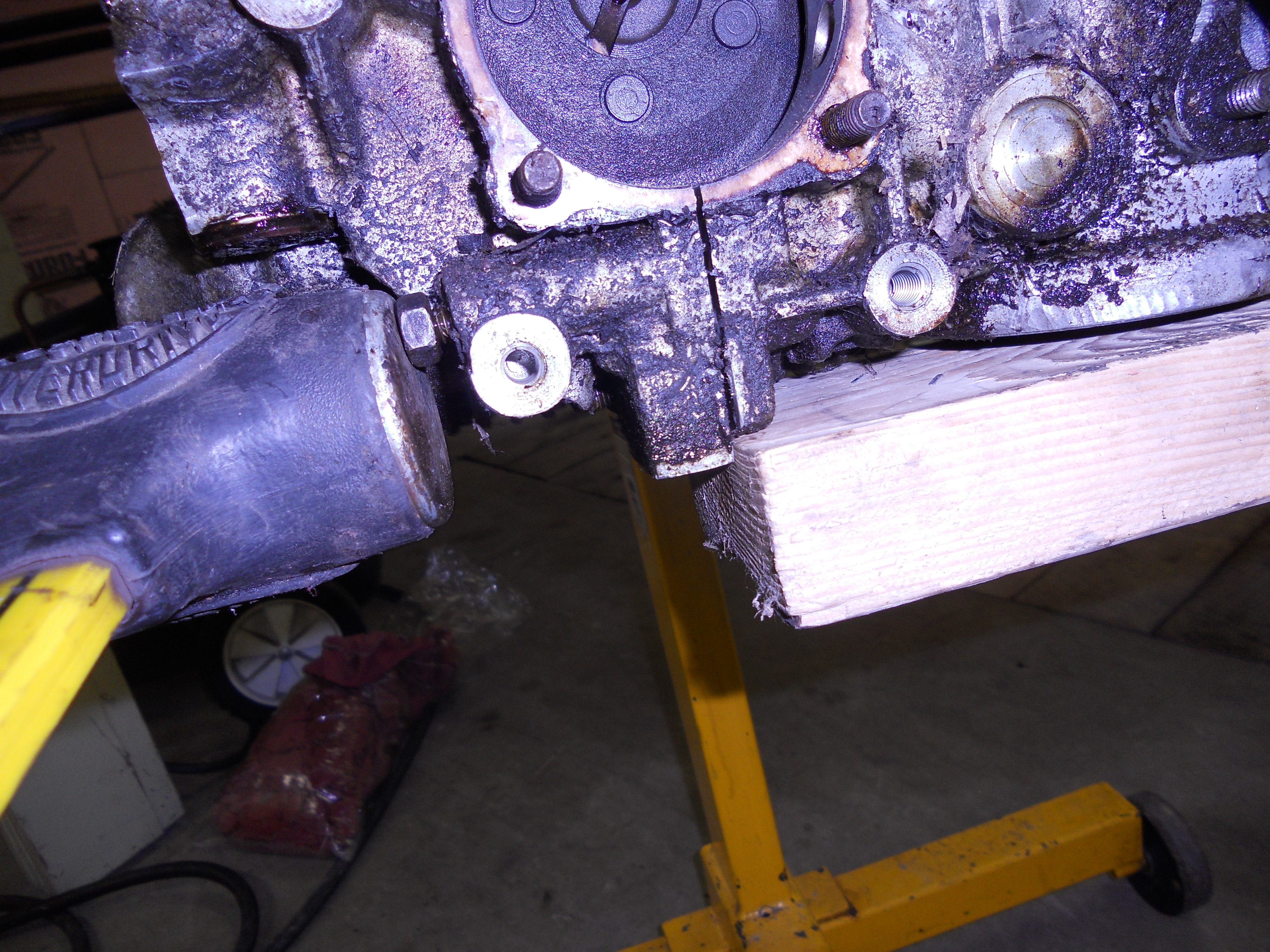

Close-up of split.  Notice the nut on the stud to prevent damaged threads.

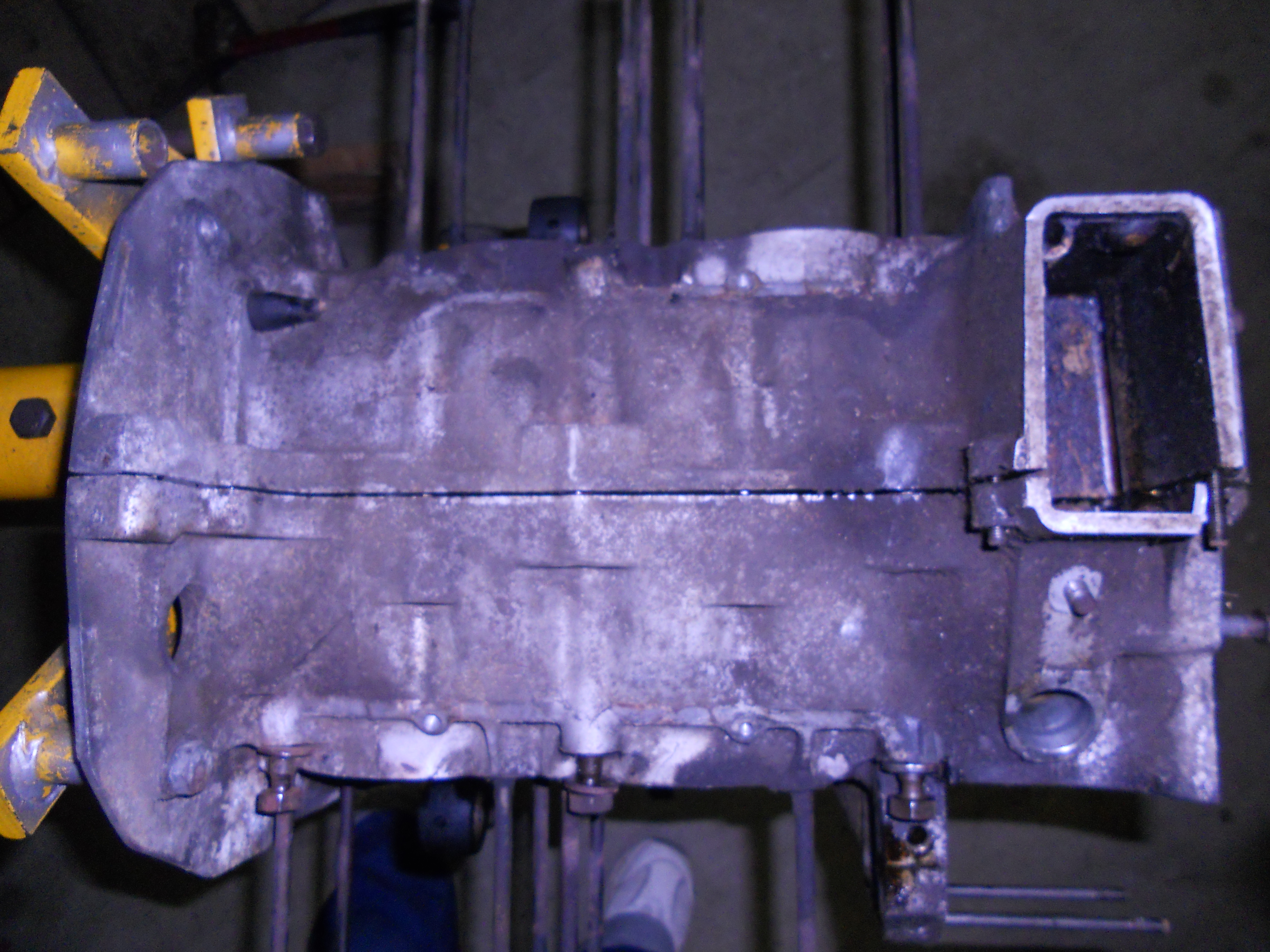

Case as it begins to split.

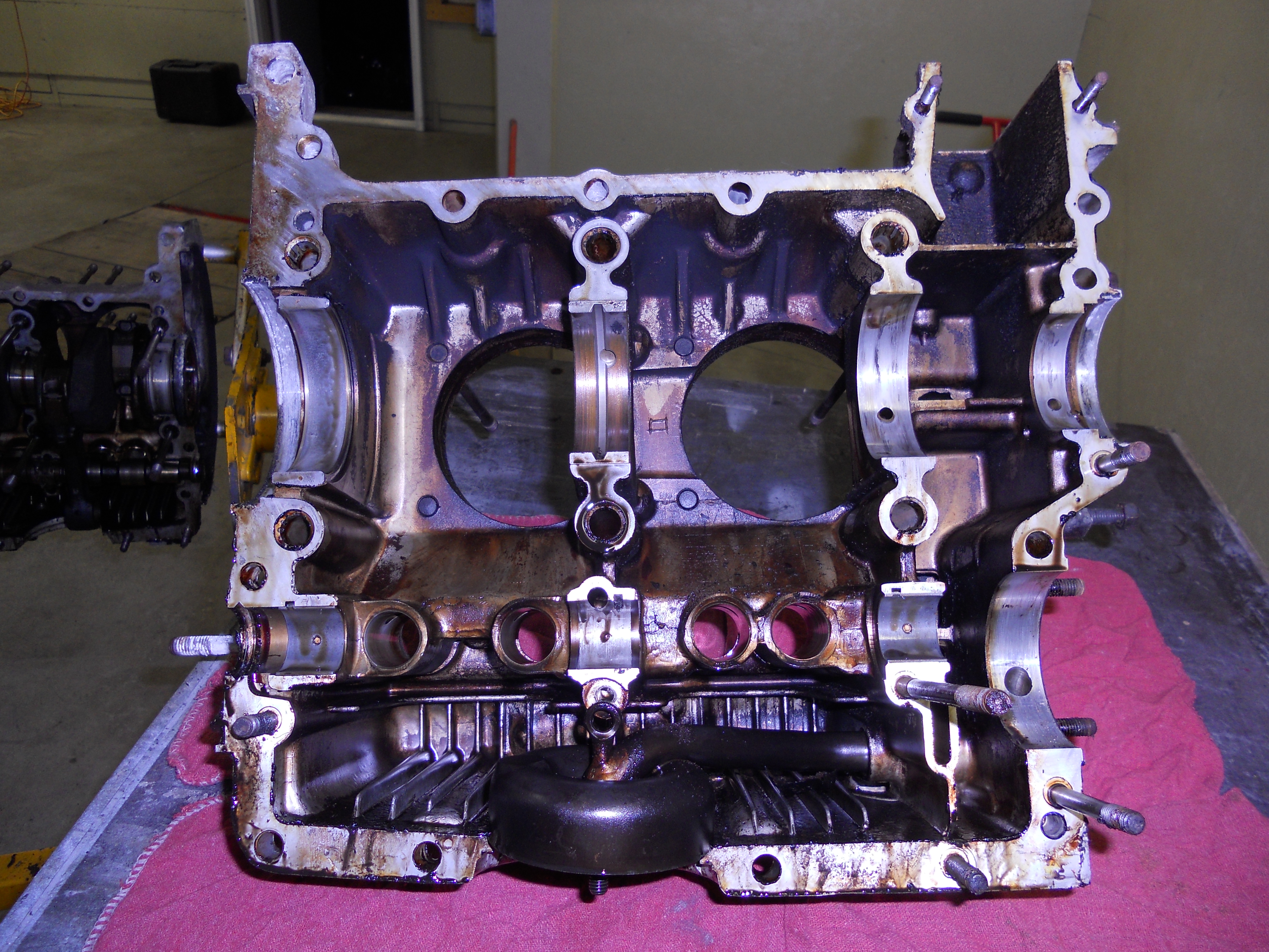

Right half.
Right half.

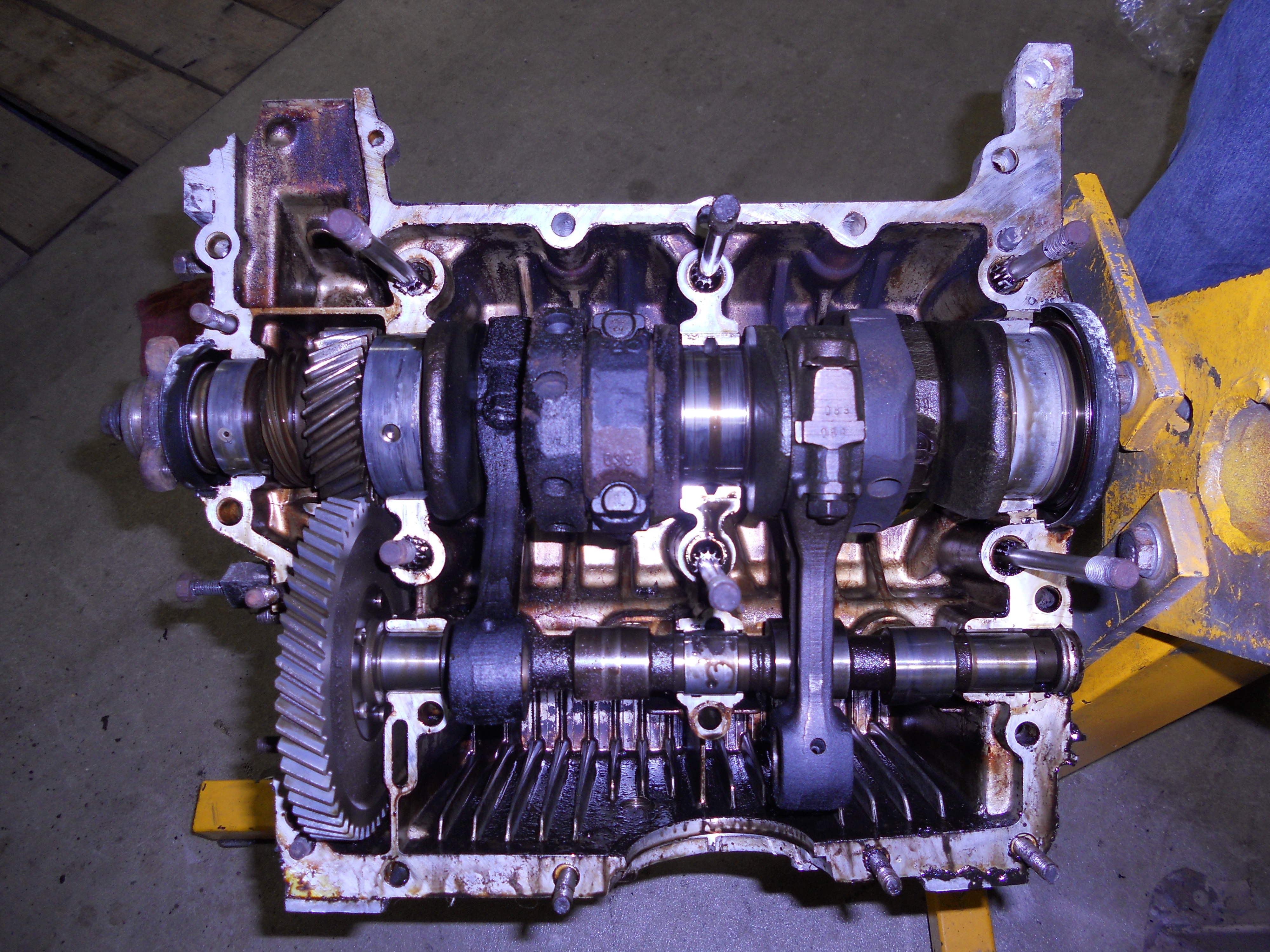

Left half (still attached to engine stand).
