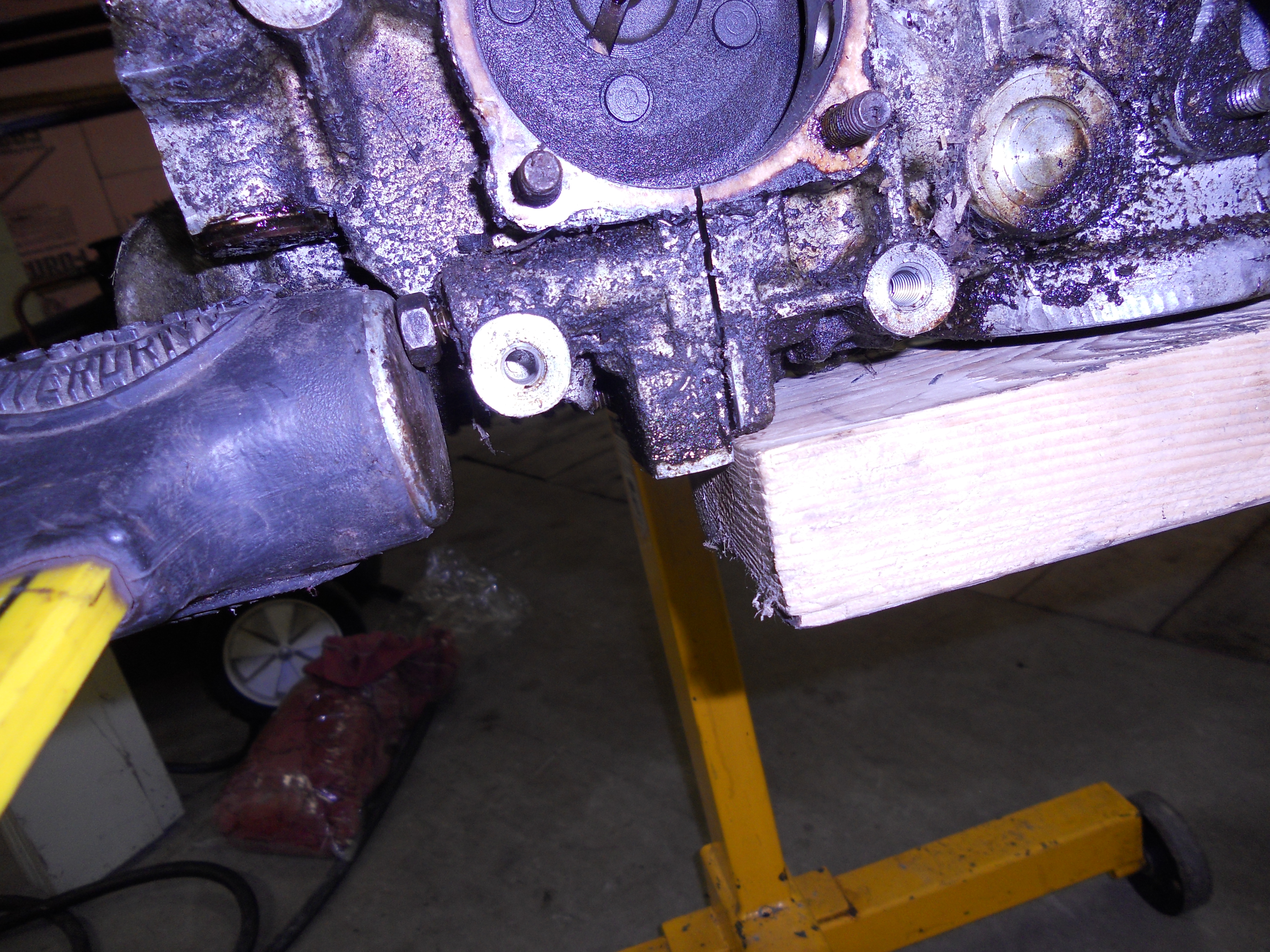

Beginning the split under the oil pump opening.
Close-up of split.  Notice the nut on the stud to prevent damaged threads.

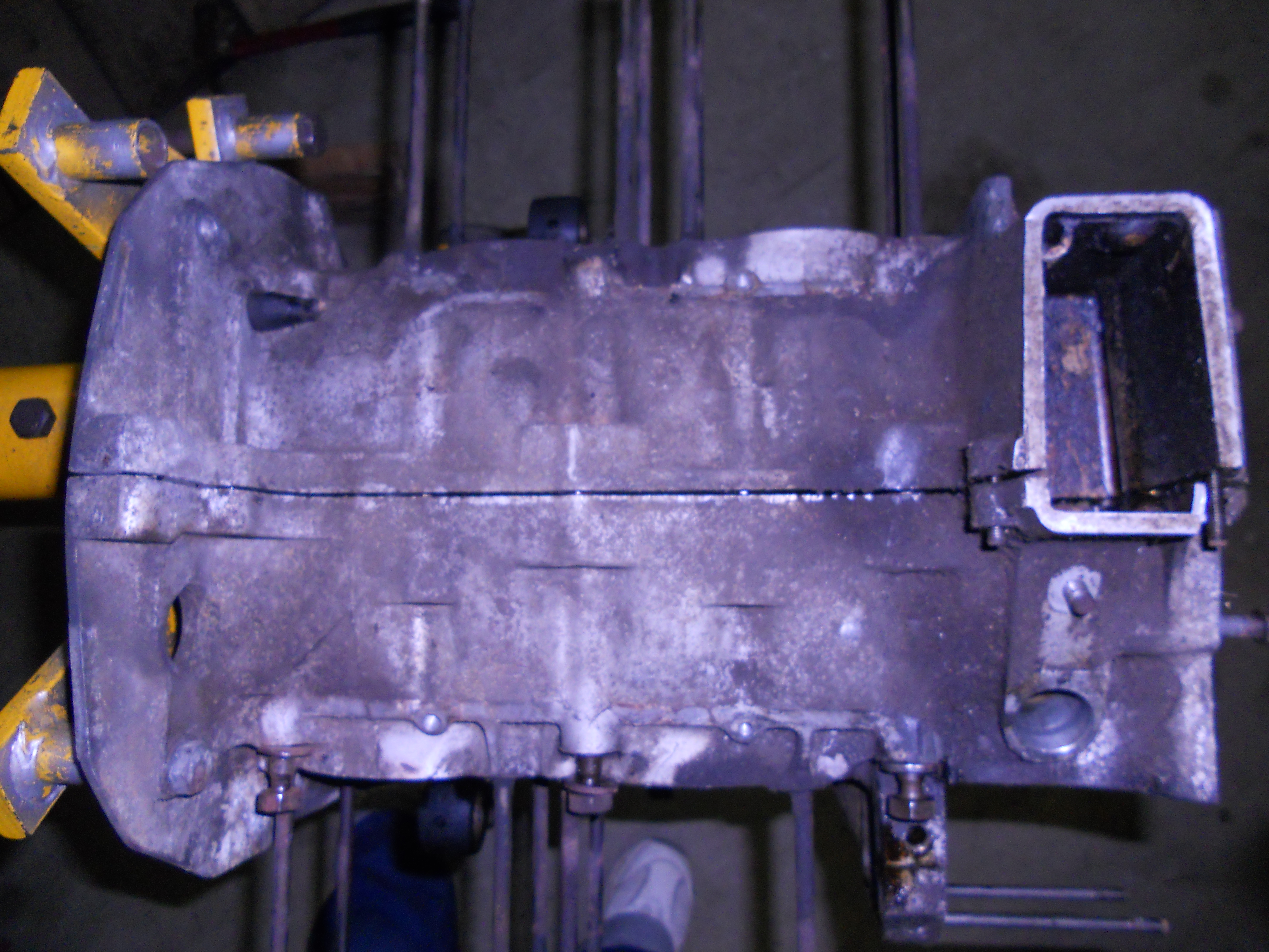

Case as it begins to split.
