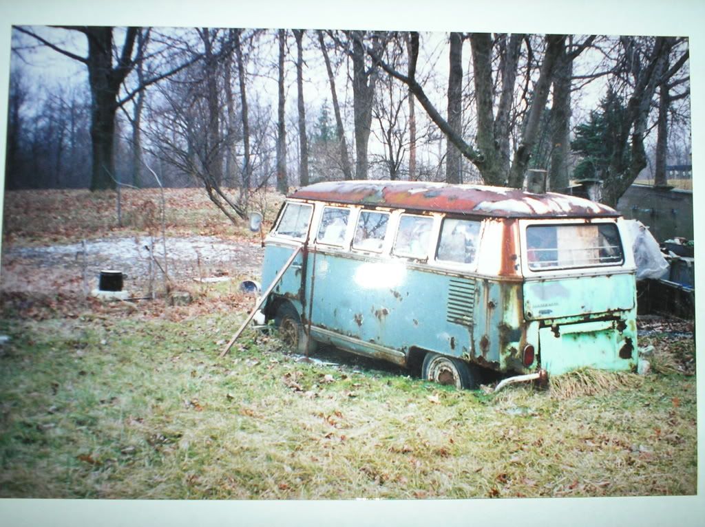

Here are some pics of a 65 Delux walk-thru that I dug out of the mud about 20 years ago.
Now this would be are real challenge for ya. :o :shock:

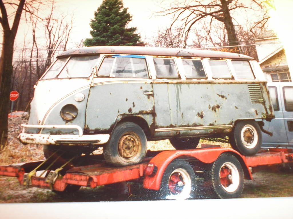

Here is a short list of things that had to be done to date to get this back on the road:
Long trip out west to pick it up and trailer it home
Clean out the interior/exterior including serving eviction notices to the mice
Remove the fuel tank, clean inside, replace all hoses and tank filter
Brakes all the way around, including all hoses, all wheel cylinders, new dual master cylinder (type with adapter kit)
Free up, grease brake and clutch pedals and all cables, adjust ebrake cables.
Replace boots on transmission, drain and refill gear boxes
Sort out a bunch of electrical issues, lights, horn, etc.
Wiper shafts replacement
Front beam clean, grease, swing pin replacement
Add one mystery motor (after the standard checks)
Weld in new metal around seat belt mounts in the front seat area
And a bunch of little stuff I probably forgot about already :shock:

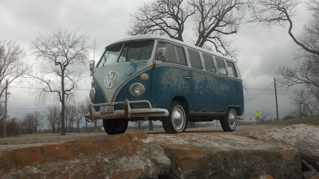

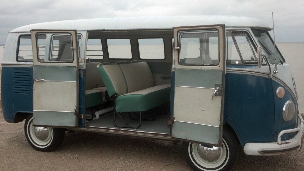

Getting it closer.....

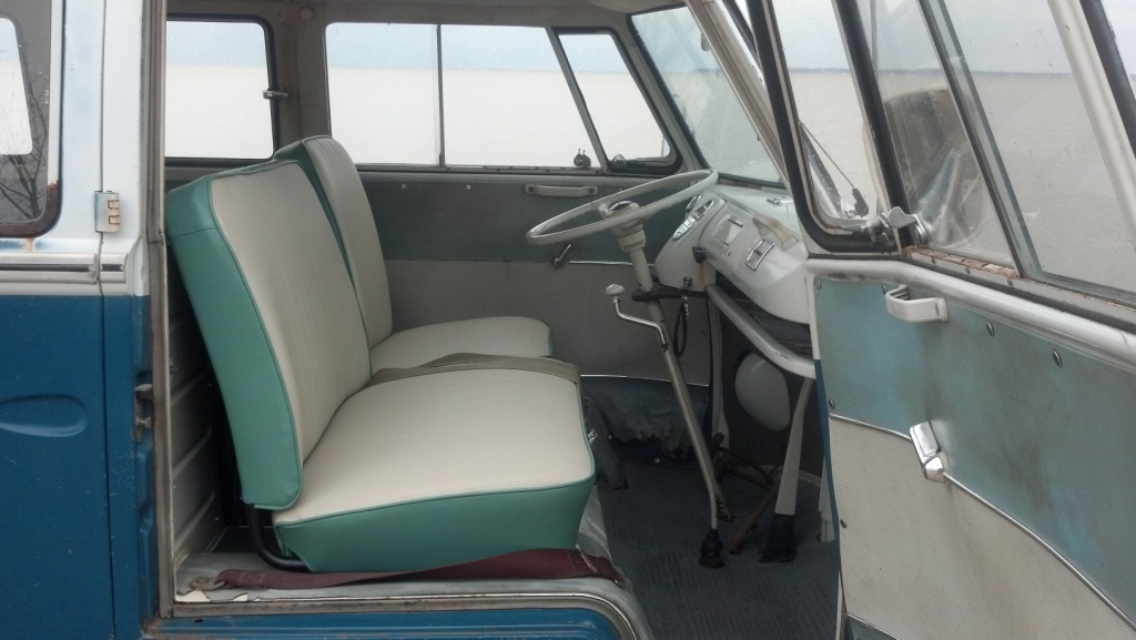

Bill just got the seats all done for me, AWESOME!
Re: 67 Deluxe
Sexy! Great work!
Posts: 1392
Re: 67 Deluxe
Damn, I wish mine was as together as that........ ;)
Re: 67 Deluxe
Ya gotta love a split passenger bus! :D What's up with those ultra-cool whitewalls?
