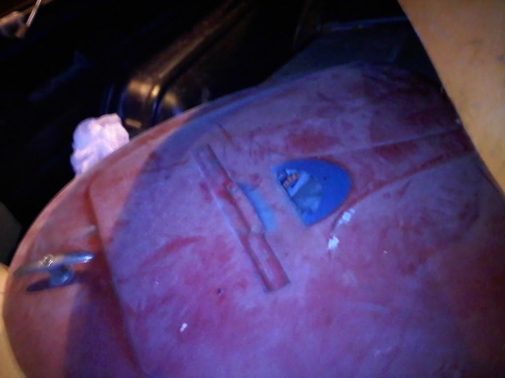

He has a '66 1300 decklid on this car and would like the correct '62 lid. Does anyone know what the difference is? The listings show they are different but the '66 lid fits perfect. I'm assuming it's the bulge near the license light? The PO said the correct original decklid is somewhere in the Cleveland area but did not elaborate.

Re: '62 Beetle Ragtop
I've owned a 58 and a 66 nearly back to back and had to answer a ton of questions about parts interchanges.
I remember this stuff from parting them out because they were rotten SOBs:
58-63 t handle lock and small license plate light
64 it's own special decklid
65-66 push button lock (66 has 1300 logo instead of Volkswagen logo script)
Well now my memory is really kicking into overdrive. I have a red over blue or primer 58-63 decklid somewhere in the barn that's straight with one tiny ding in it to the left of the latch. Don't remember about the hinges or springs, but think they were good. No plate light though. Sean told me to save it for a rainy day before when I posted photos in my apartment hunt thread.
Here it is:
