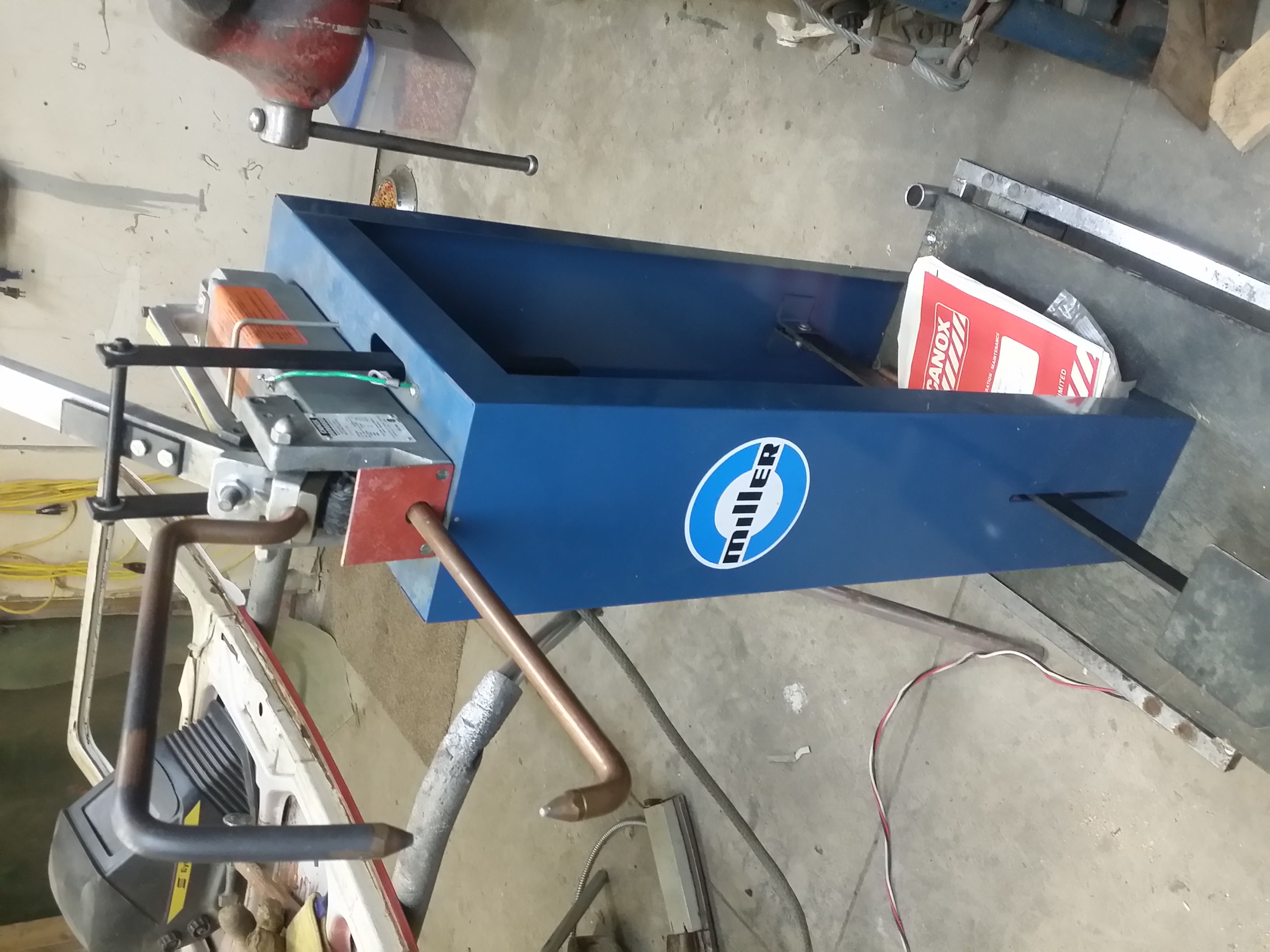

I did pick up a new toy so I better make some progress
