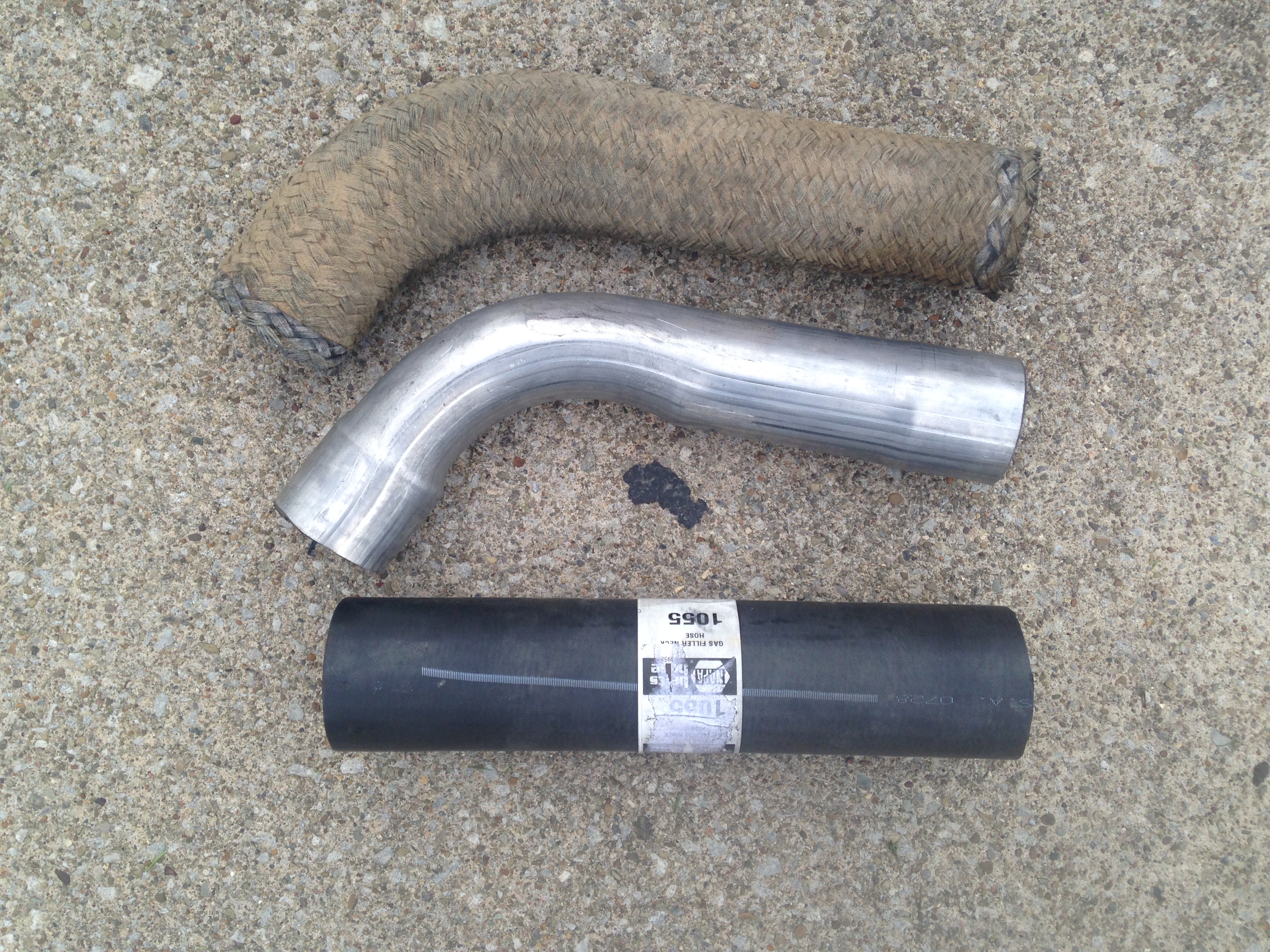

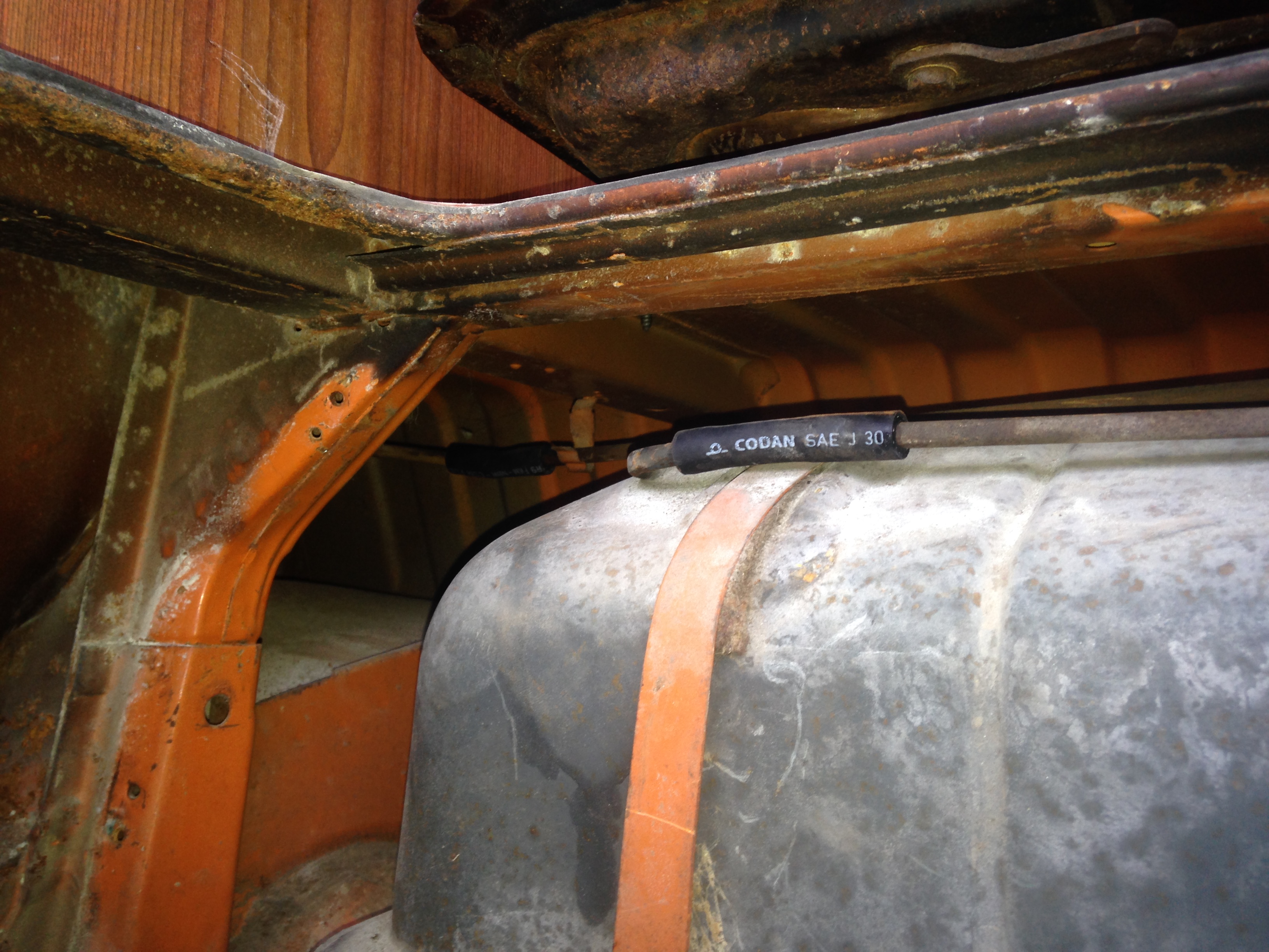

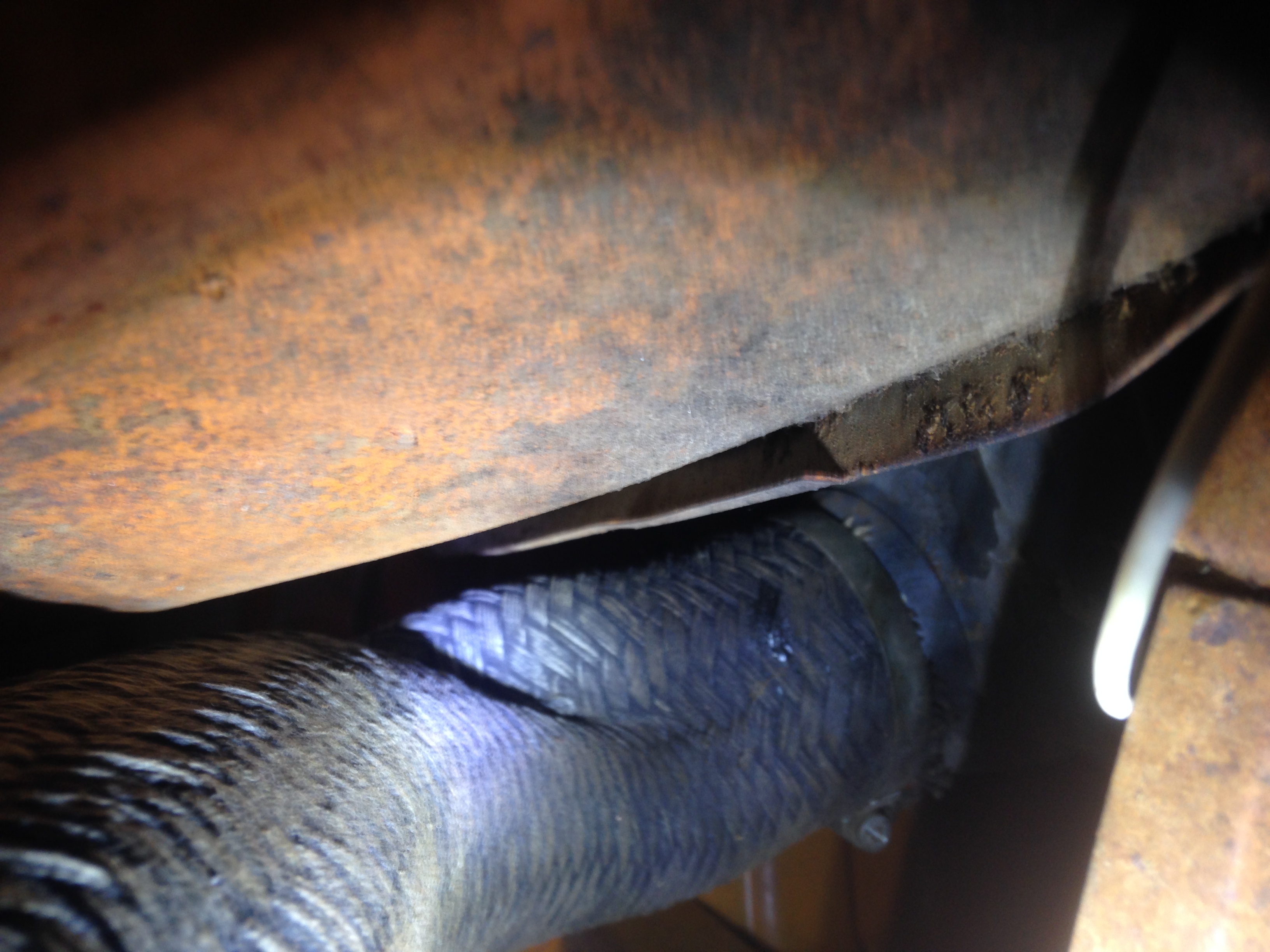

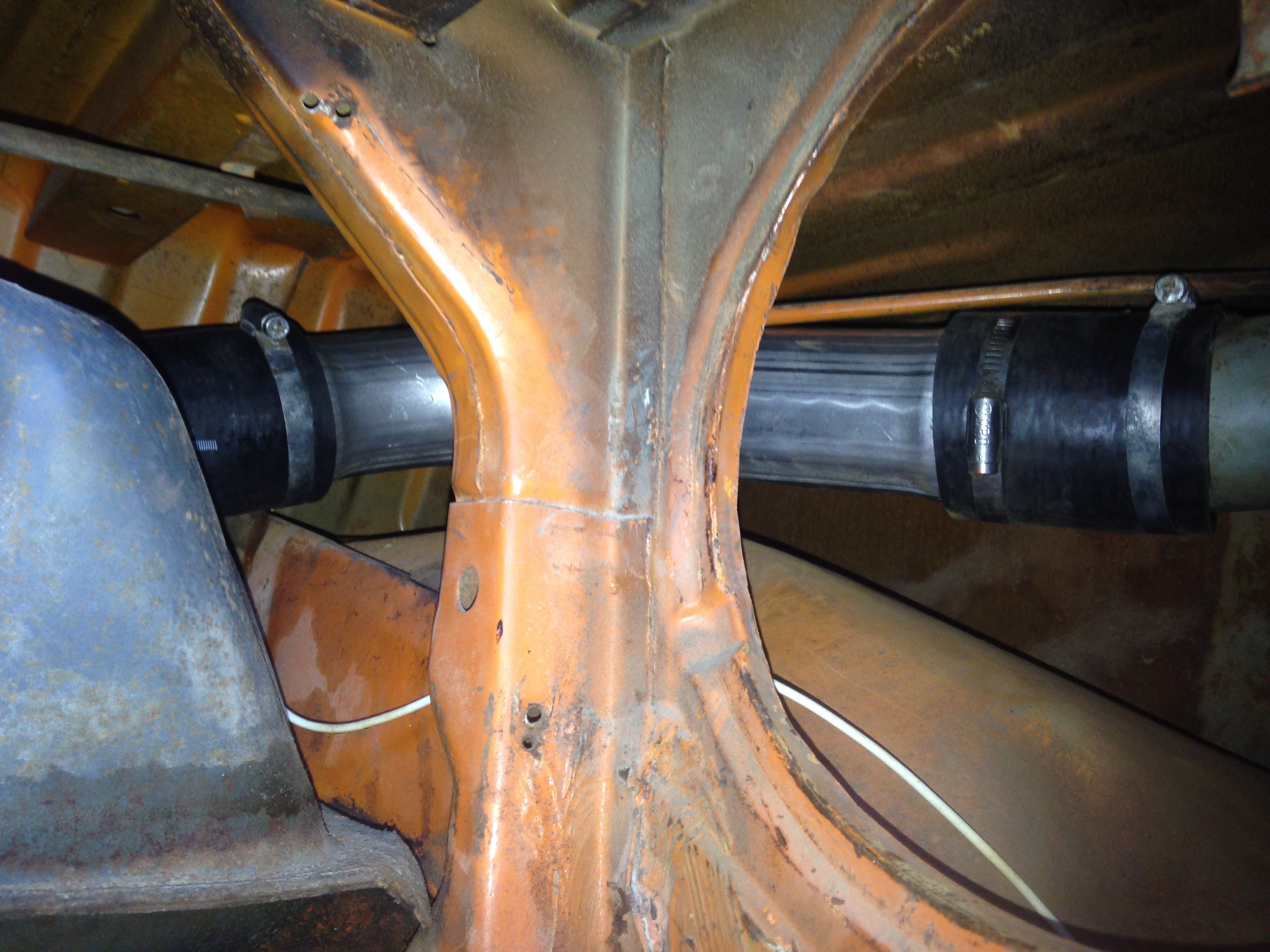

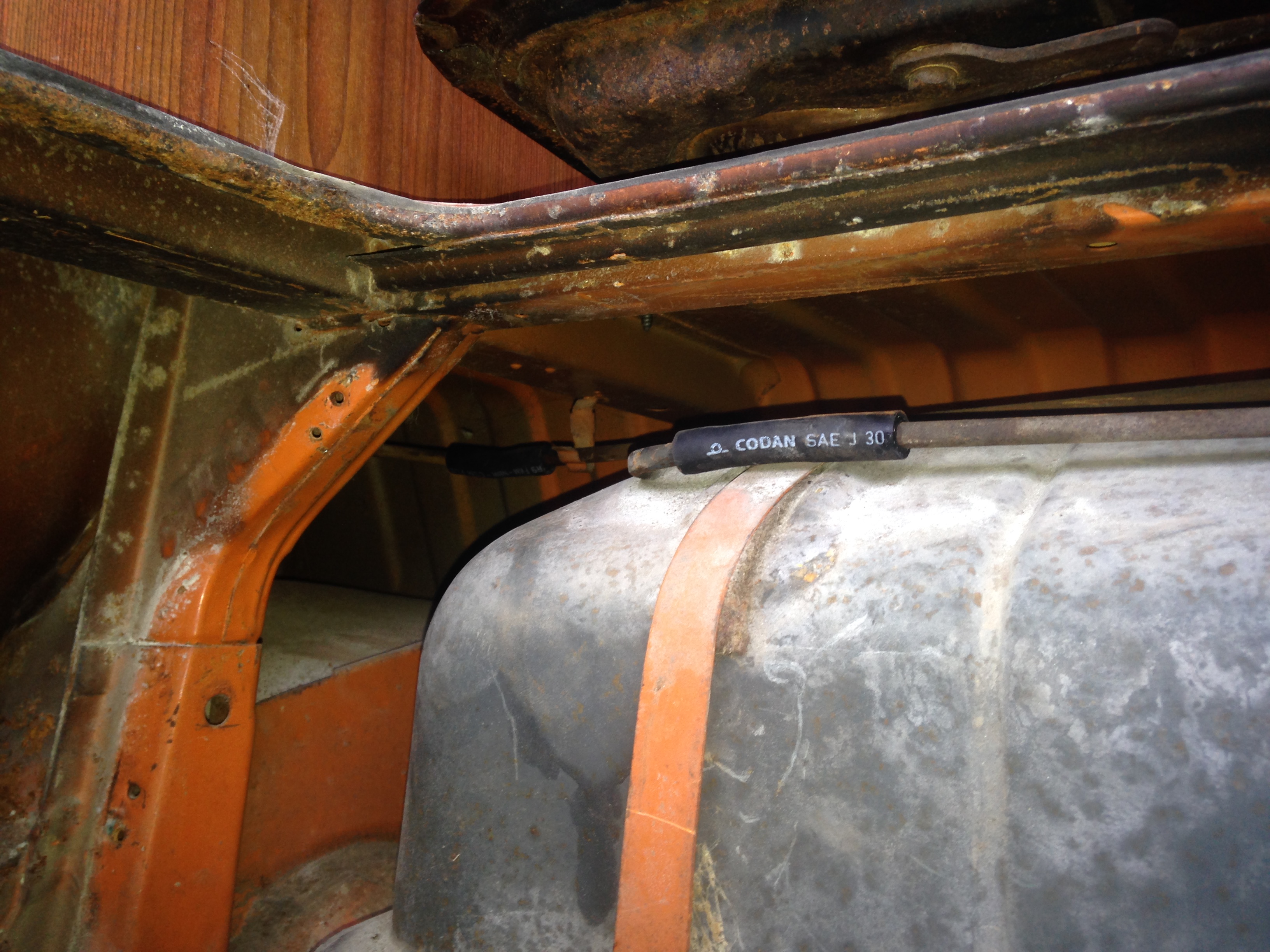

Boogs was gassy
Leaky and kinked filler tube. Ass end was always gassy
2

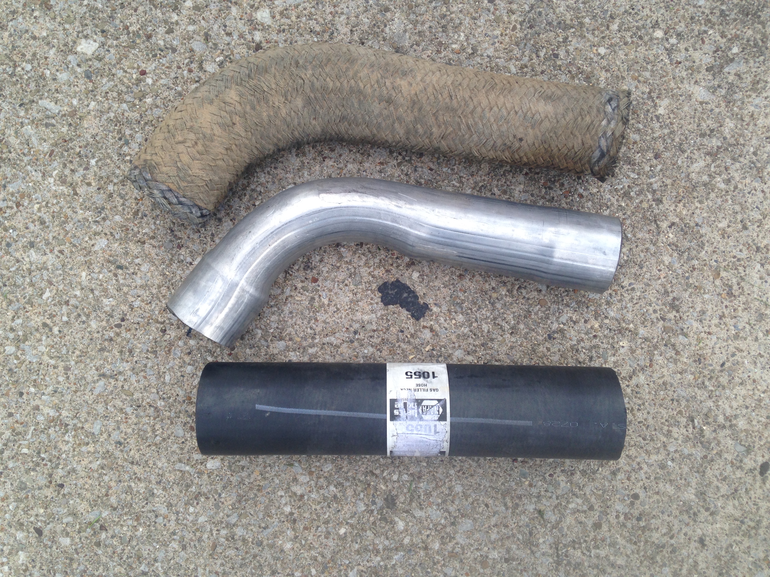

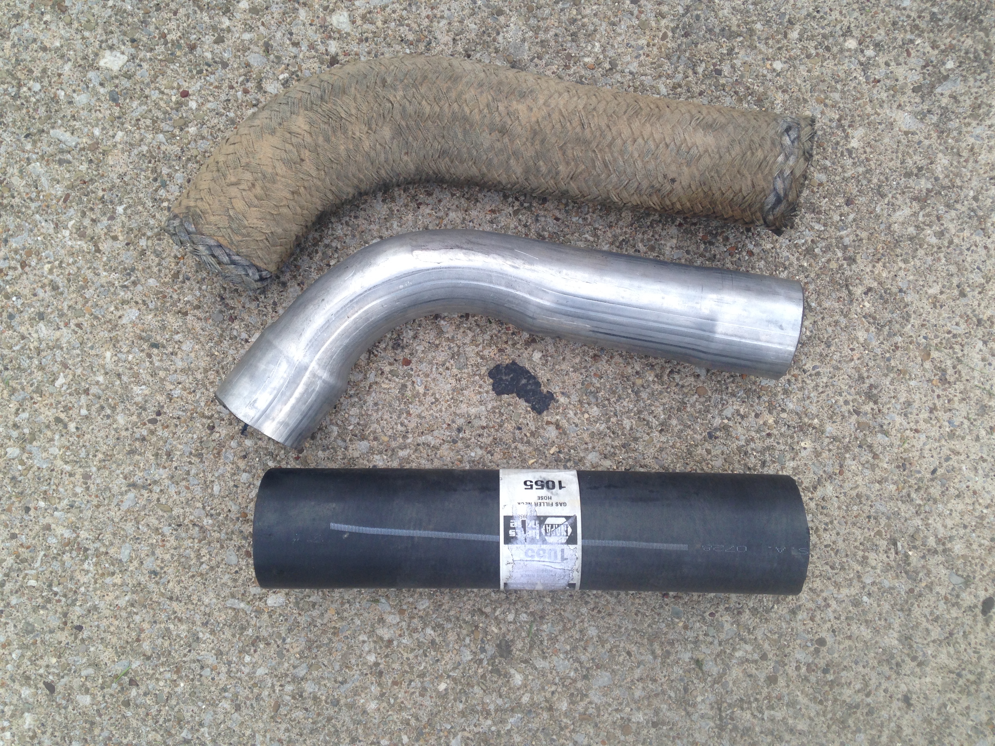

Raw materials. Old filler tube for pattern. New gas filler tube Napa 1055. Custom bent steel tubing

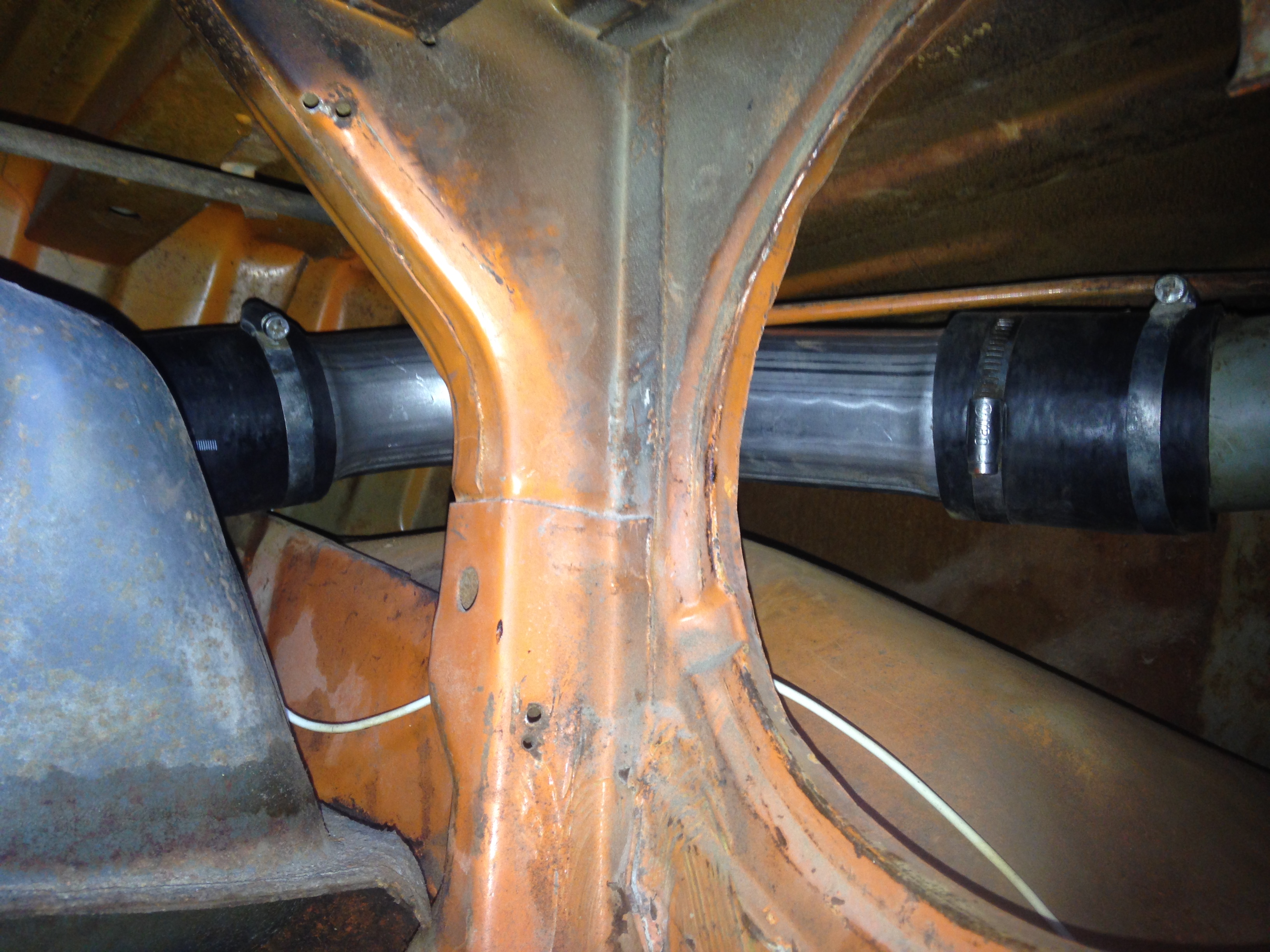

New filler tube in place
Changed the vent lines while here

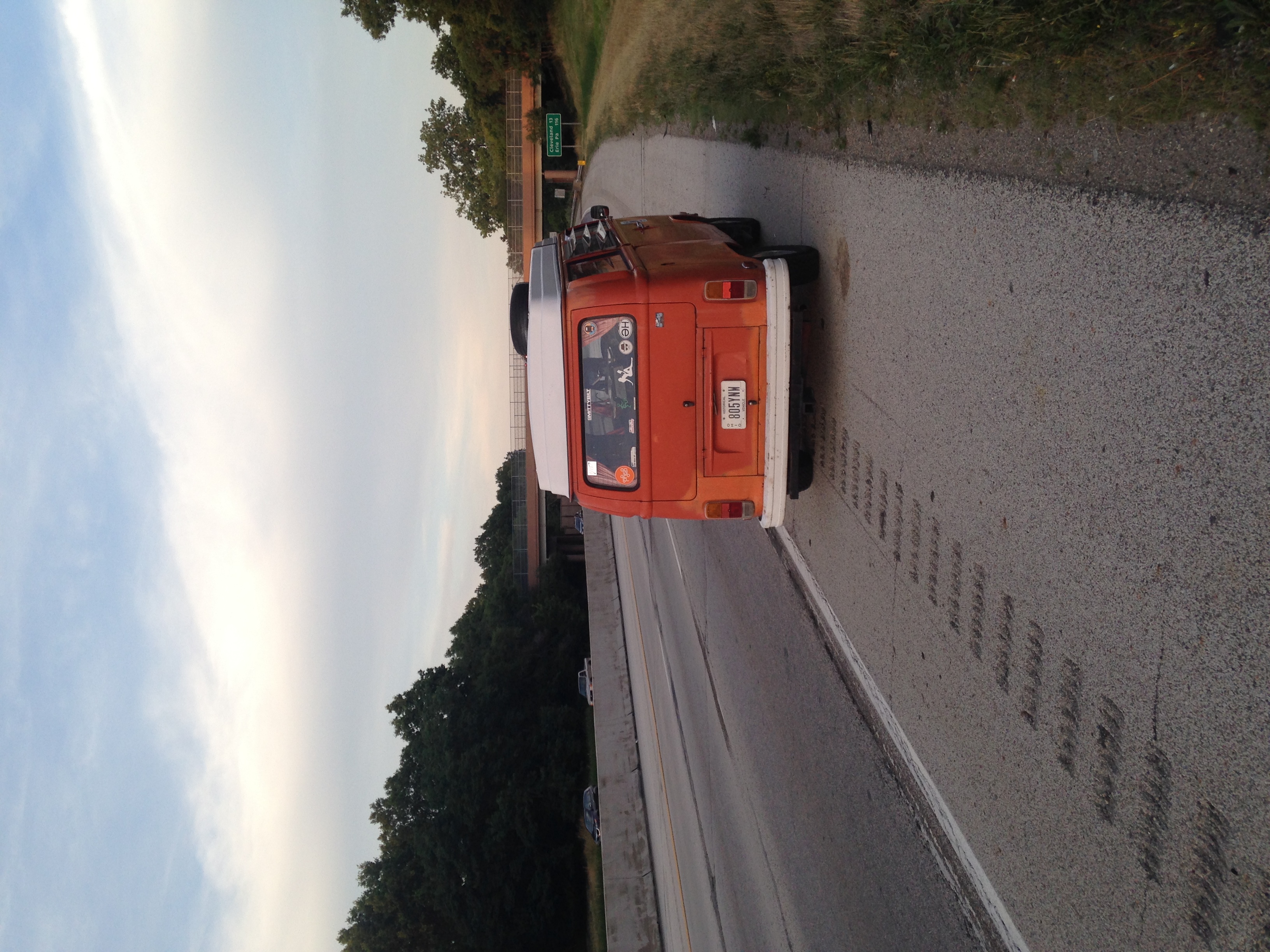

So it started the night of VWs in the vineyard. On the highway the bus started losing power, down to 50, then 30, then down couldn't even keep it at rpm in 2nd. Pull off to shoulder, and it stalls.
Give it a minute and it starts back up, get back up to speed, travel on down the hiway. About 5 miles later, same symptoms. Decide not to push it. Turn around. On way home. Same thing. Try to limp it home on shoulder doing 20. Kaput. Dies. Cannot get it to start. Thinking timing, try to do a little roadside diagnosis. It's hot out. Dog is in bus. Decide I need to get dog taken care of before bus. Call wife to pick up dog, no answer, and AAA to pick up bus.
While waiting a westlake cop shows up, sees dog, gets water for dog, and offers us a ride home. Just as we get in cruiser, Kristen shows up. Ride home with her. Thank cop for offering to take us home. Blue Lives Matter. Not all cops are bad.
On highway waiting for AAA

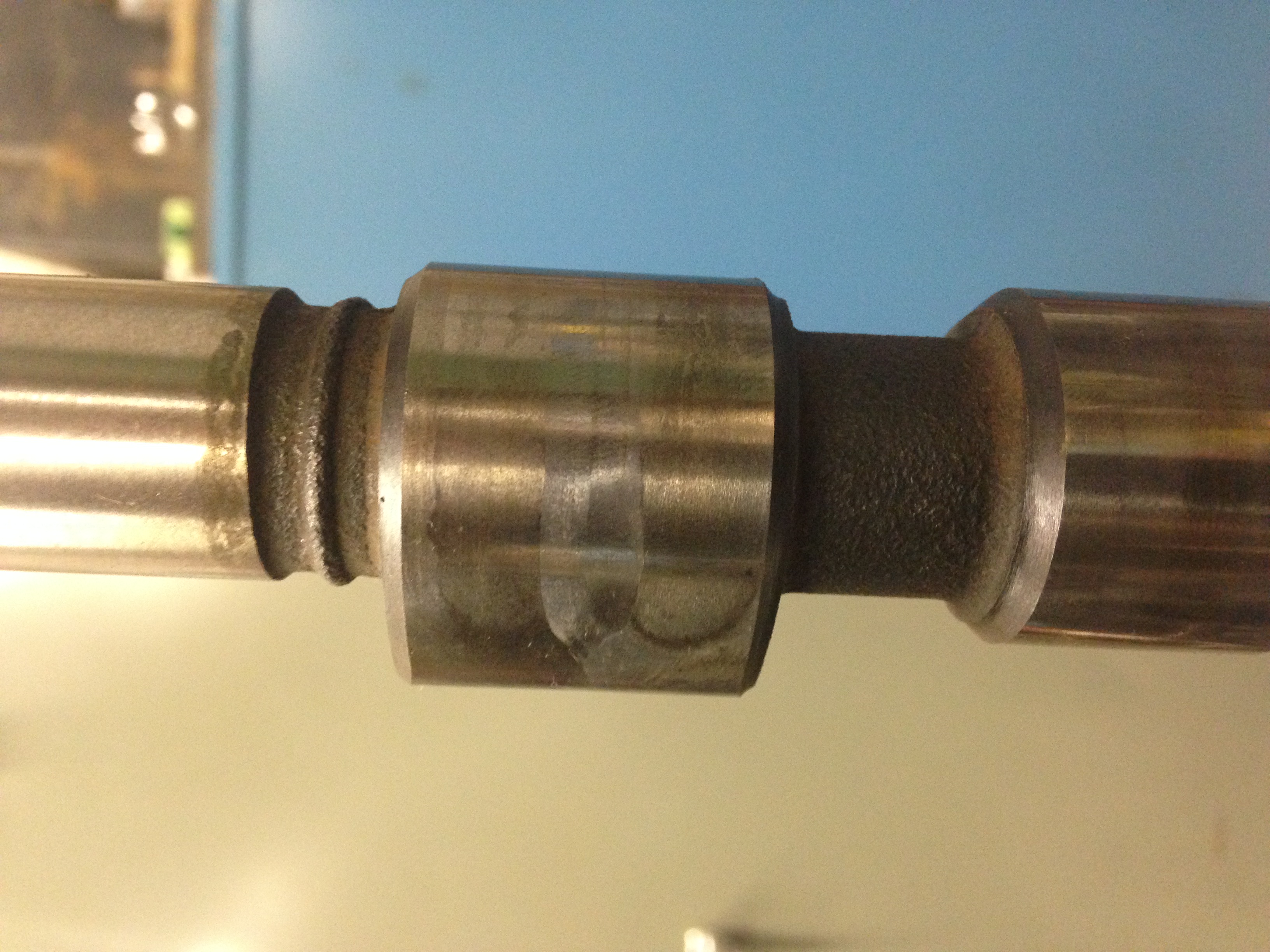

Get everything tore down. Do not find anything glaringly wrong. Lifters are fine, cam looks brand new, pistons, jugs, rod and crank all check out. I do not know what was causing noise, and that is worrisome. Hopefully going fully stock will resolve mystery noise. As long as it works I don't care if I ever know.

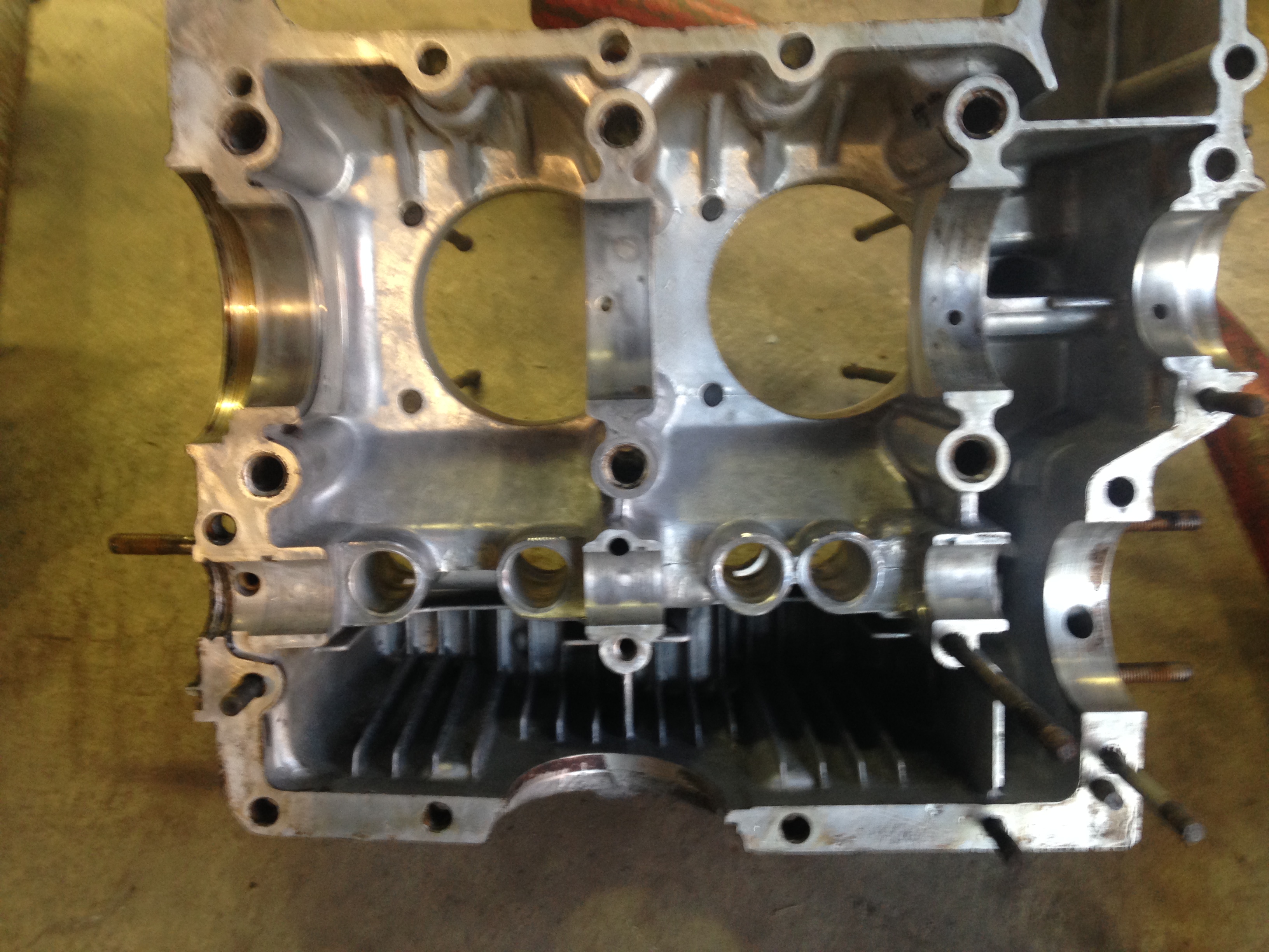

Inside of case. Just rinsed with water. No fancy prep. As clean as the day it was cast. Frequent oil changes help

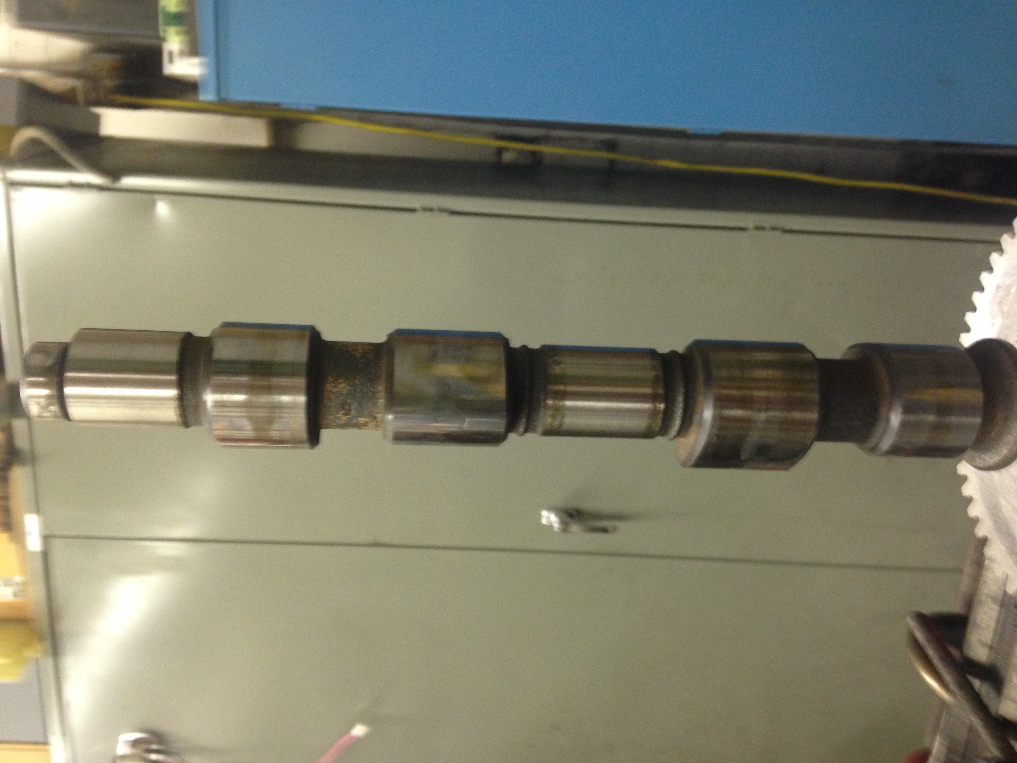

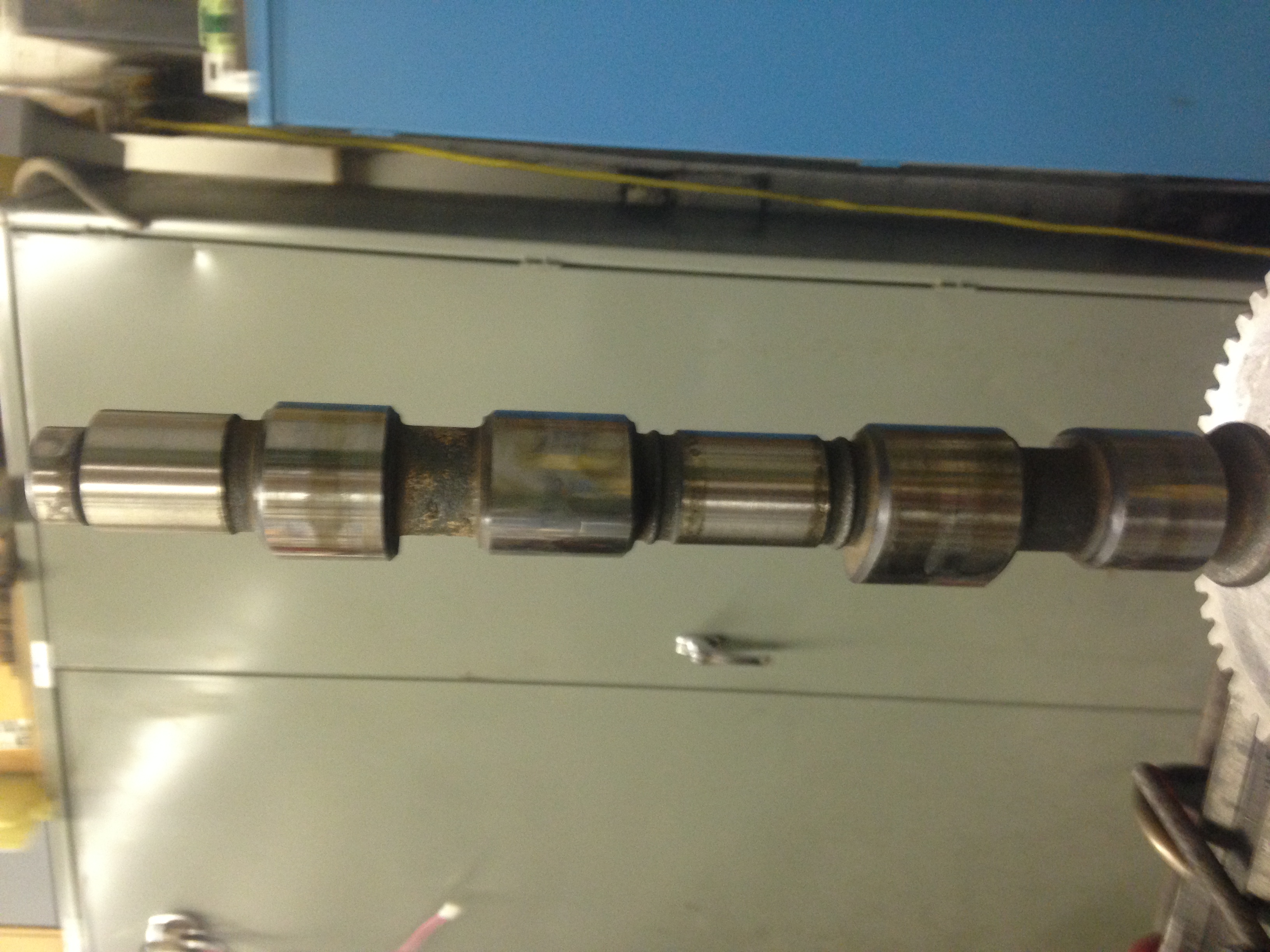

None of the gouges on cam lobes you typically see with hydraulic lifters.
Cam looks brand new
Cam looks brand new

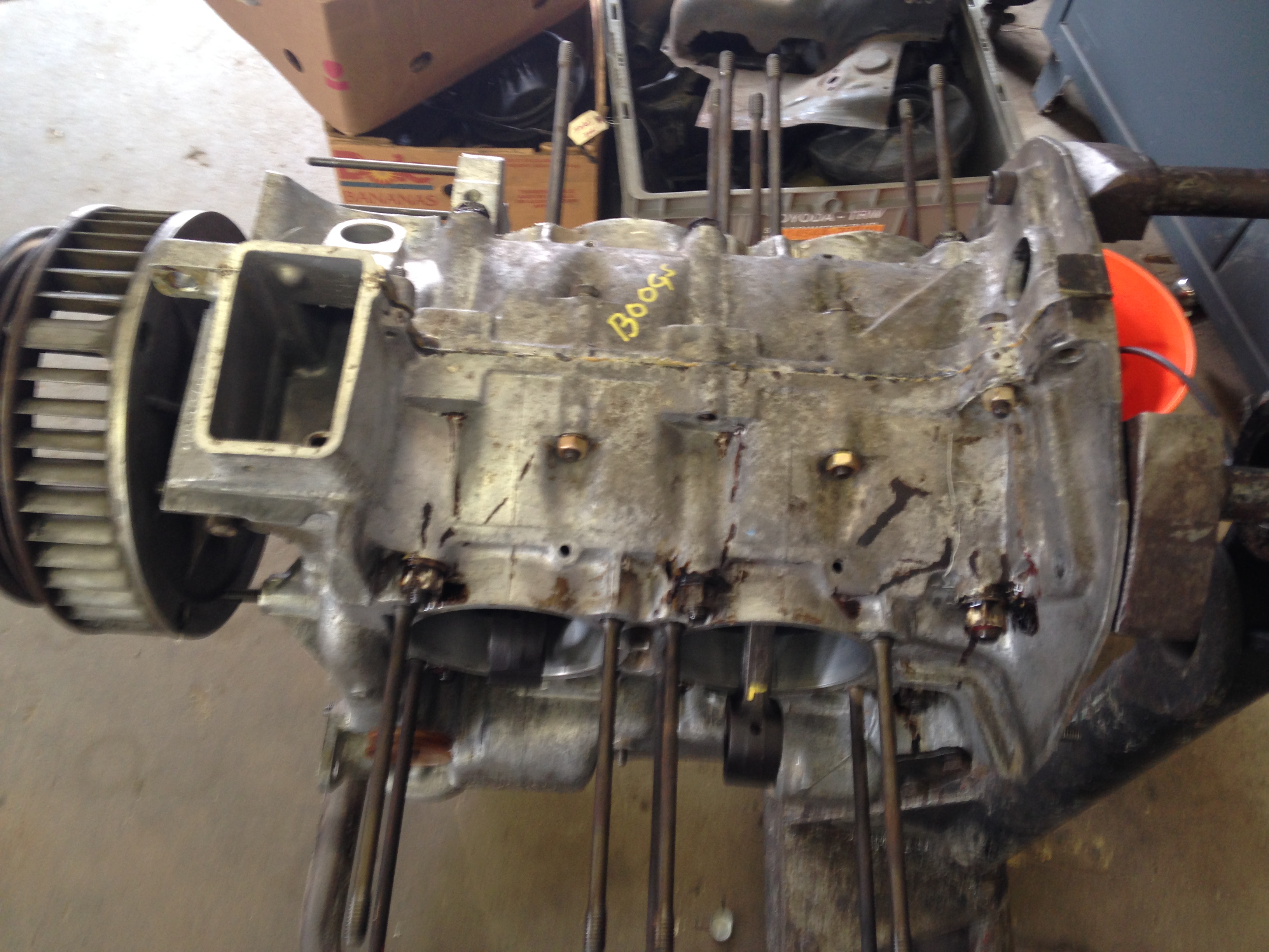

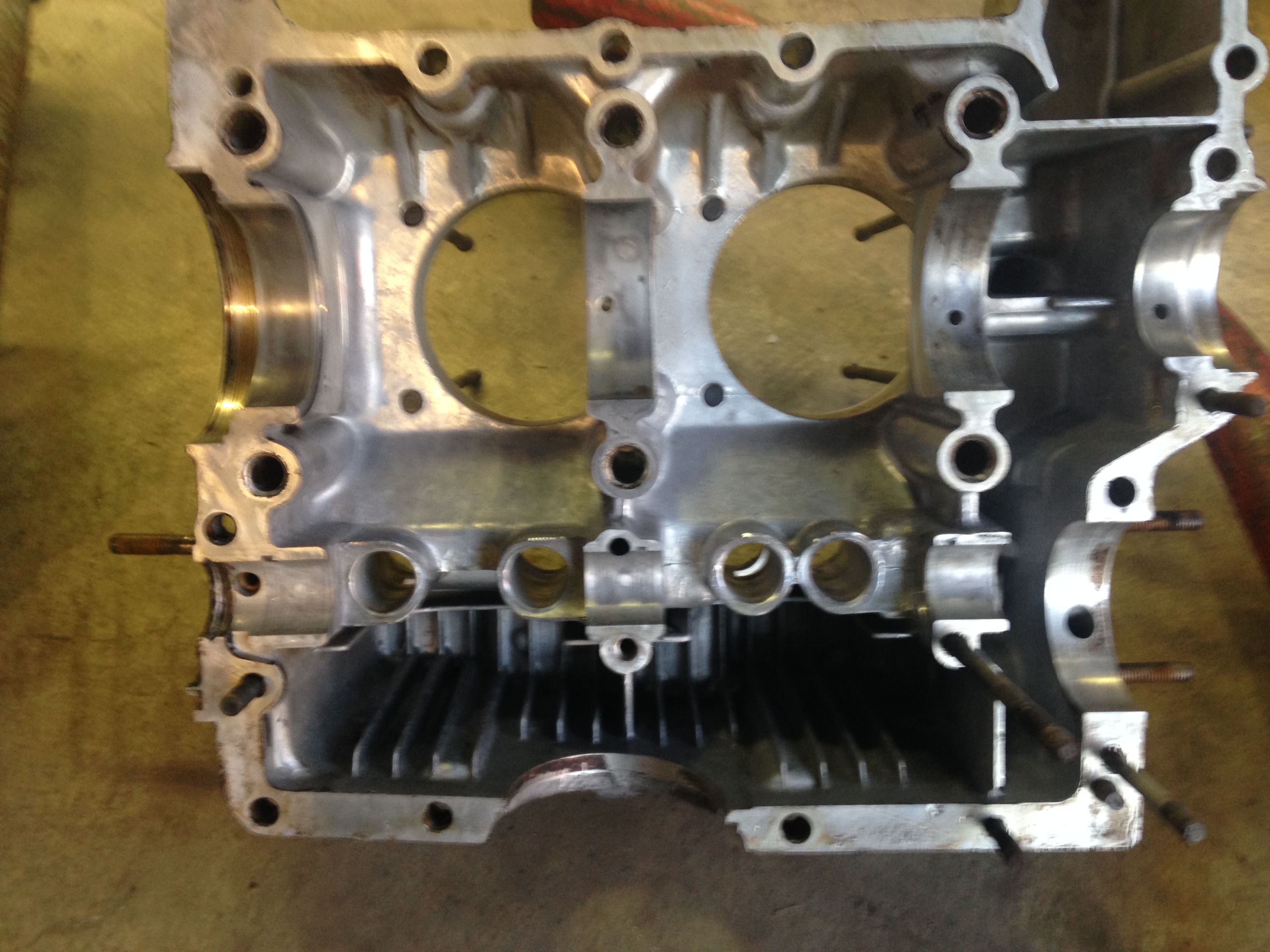

Cam bearings don't fit. This is like the 5th time this has happened lately. Kobleschmidt. Get silver lines. Get the bottom end all together and crank won't spin. Ufck. Call it a night. Most likely cause...thread sealant on through bolts. ;)
Come in next day and crack case. Front (front is front) main bearing got spun somehow. Index mark is still on it, just not lined up on case have. Dowel pin is recessed so far in hole it is as if the pin and case are one. Chuck to the rescue. Applying some 3rd grade science, some 8th grade machine shop tech, and some man sized hammer blows, the pin is successfully extricated from case, without damage to the case. Get everything cleaned back up, and reprep everything. Install new bearings from my stash at home, and get bottom end assembled
Bottom end good to go (hopefully)

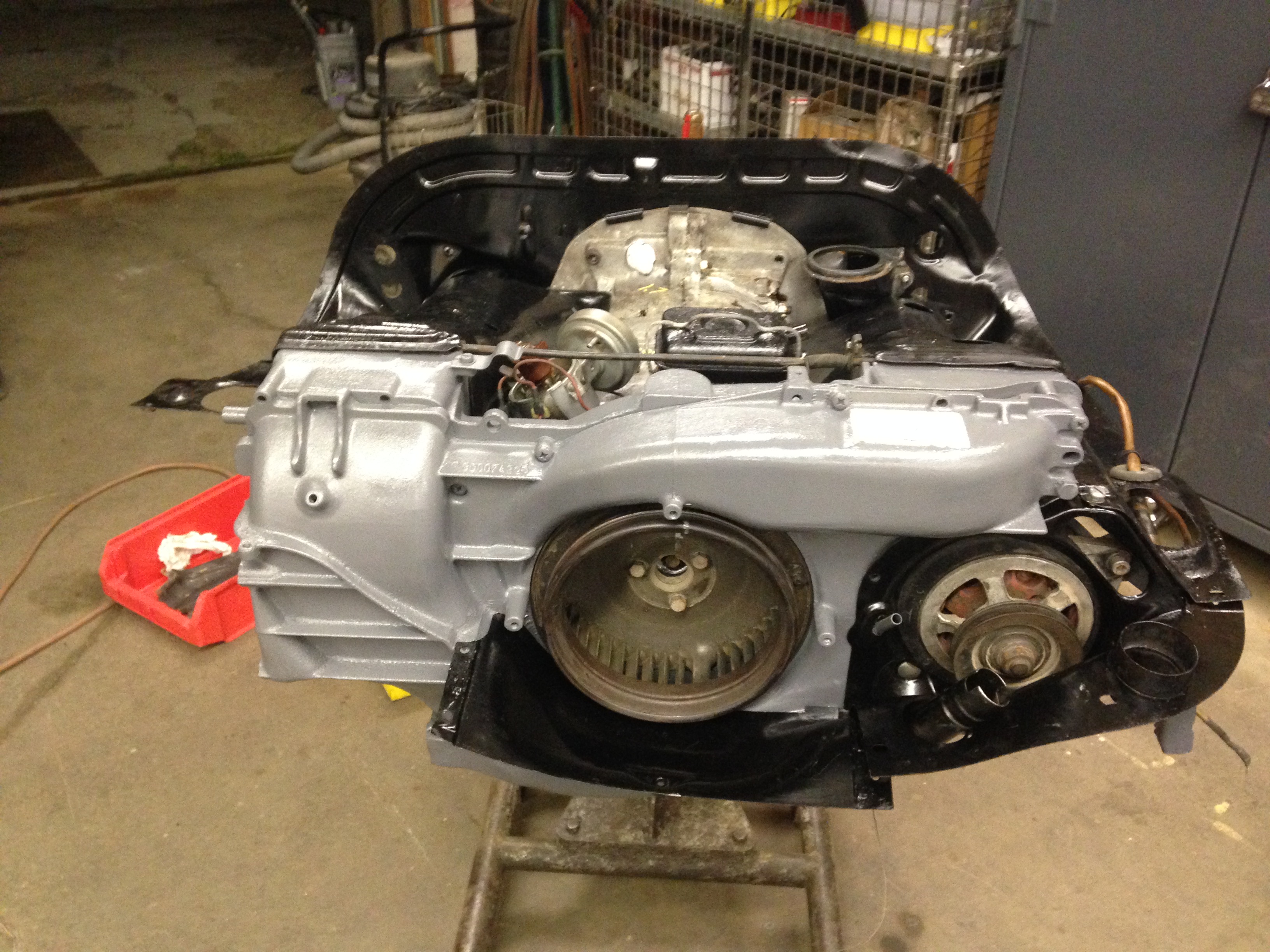

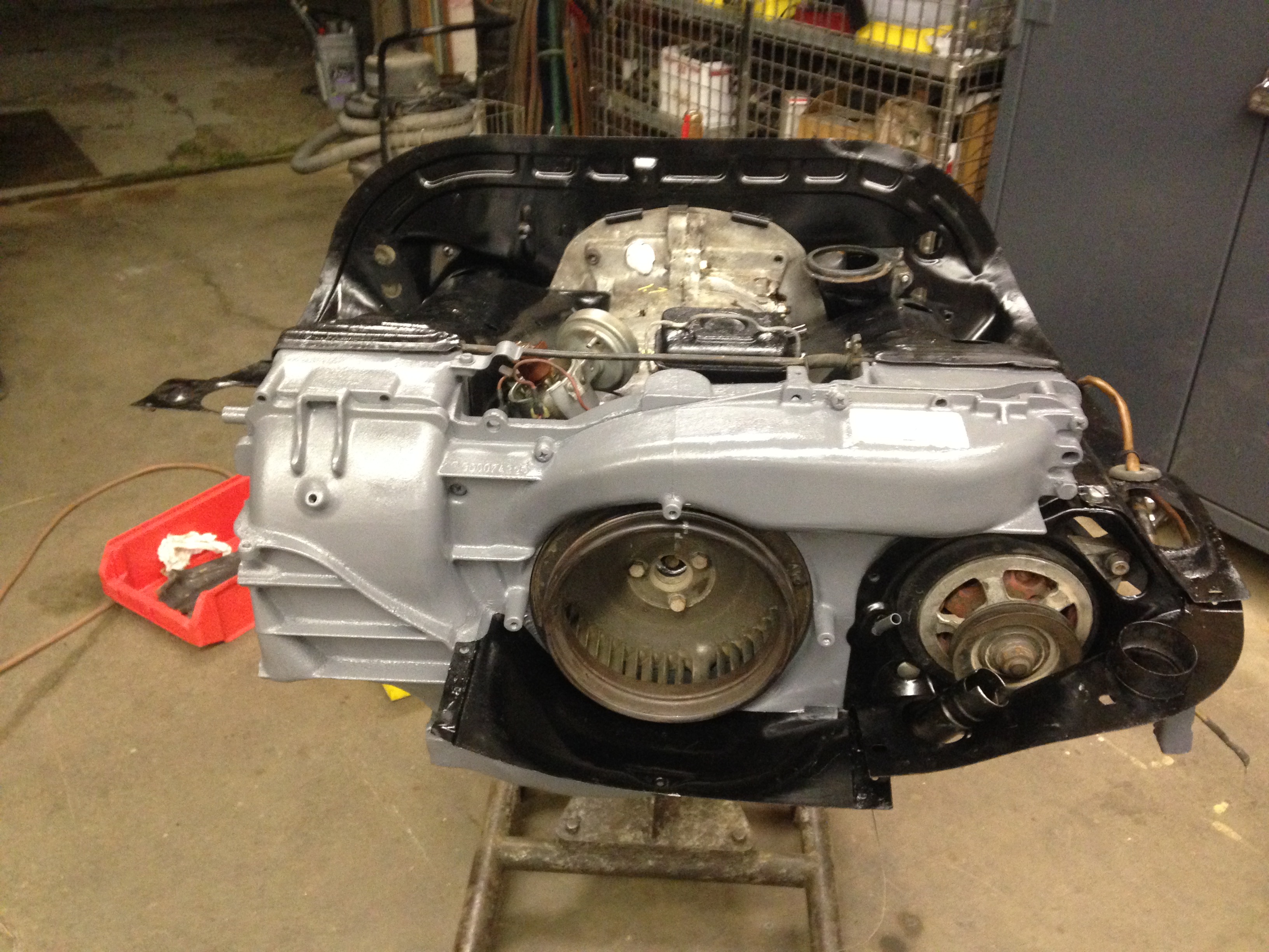

Monday brings with it the start of a new week, and the promise of possibly getting my engine in this week. Taking it a little slower since I missed first goal, but I still need it in and tested before KI. Start off by getting the jugs prepped. Decided against using cylinder gaskets at bottom, and head shims at top. Should see a slight increase in compression, and there are no interference issues. We shall see. The Pistons and cylinders looked fine, were Kobleschmidts, and were reused as is. No reringing, or honing. Just a thourough cleaning, thanks Will, and some assembly lube. Got the top end done, and called it a night.
Started the next day, by adjusting valves. I'm going to miss my hydraulic lifters. After valves it was on to all the little bits and pieces. They always take up so much time. Fan is on (I painted shroud as that is the sign of a quality rebuild) as well as the majority of tin. Next up is manifolds, exhaust, air cleaner stand offs, main seal and end play. Then this bone stock puppy will be ready to go back in, after I do some prep work in engine bay.
As it sits now. Another night after work and it should be ready to go.
