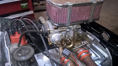

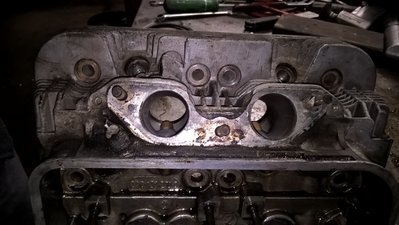

A little bit of history.
bus came with Porsche 914 heads which I had rebuilt at Streetsboro Foreign Auto
also with a progressive Weber carb which I quickly learned that it's a setup that Chuck vehemently despises :)

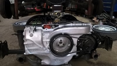

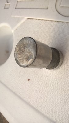

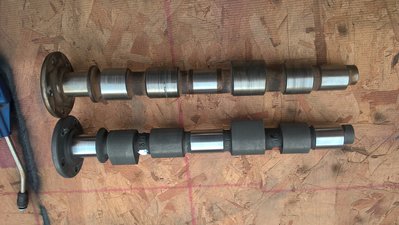

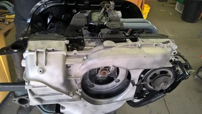

My engine ready to be installed. It lasted 20 miles - half ways home from the shop it broke down and I had to tow it. By then Elmar already left for vacation so I was on my own.
The camshaft got rounded in no time. Here it is next to a new one for comparison
Brand new hydraulic lifters after only 20 miles

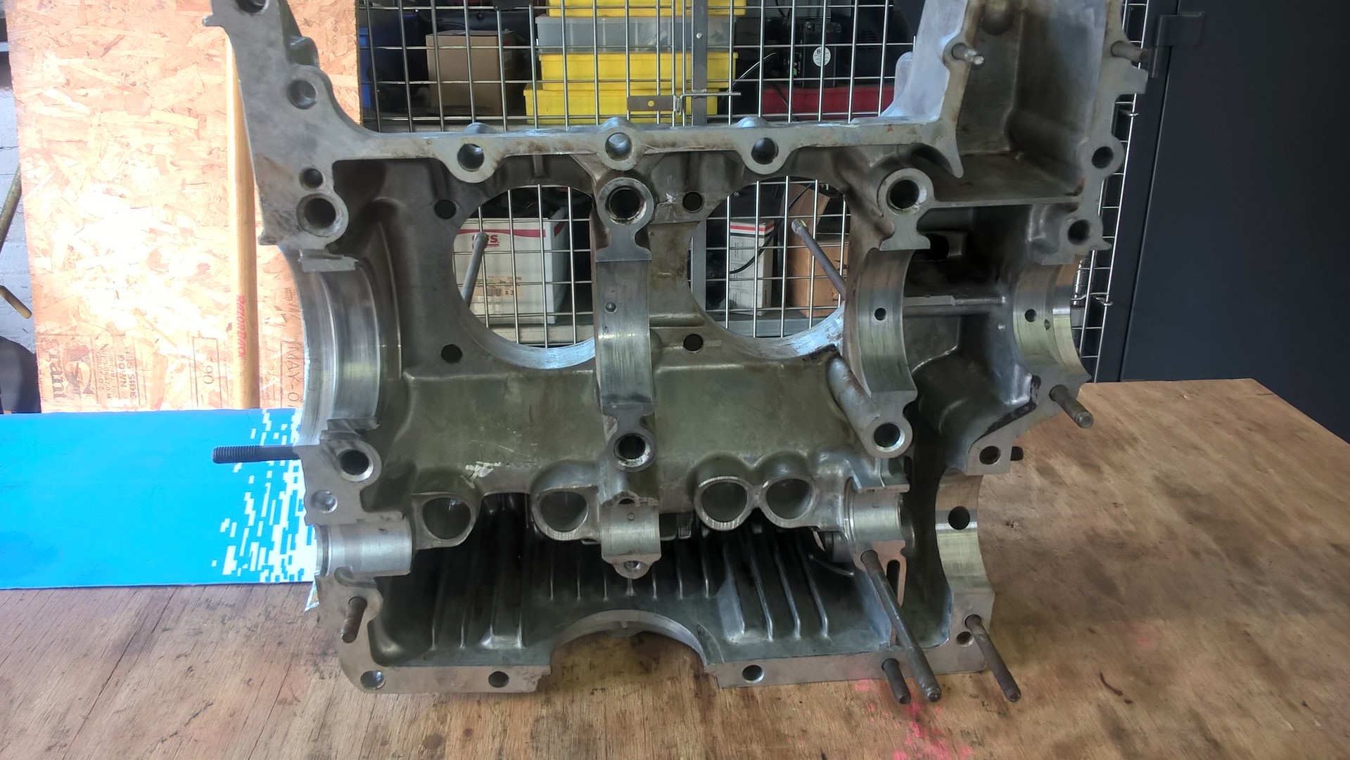

Enter LEAKOIL. I want to express my gratitude again to Bill, Chuck, Mike, Rick, Brandon, Danny and whomever else might have contributed to my engine rebuild while I was not there. It is truly amazing how people of the same interest come together to help.
engine stripped and power washed
case split and cleaned

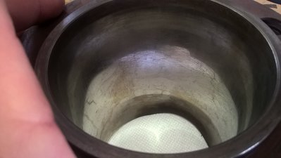

a little cross hatch pattern left on cylinders

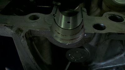

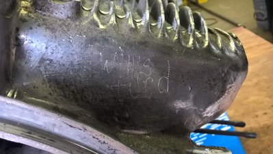

New silverlines. We joke about signing the main bearings
instead I settle on the case. Btw right about now the bus is called the blue turd
Rick lets me install a bearing when Chuck's not looking

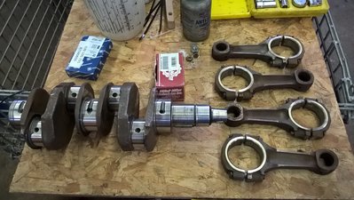

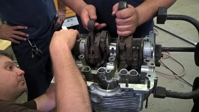

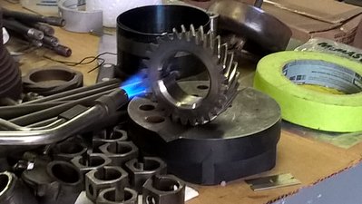

ready for crank shaft work
fitment sorcery
fitment sorcery

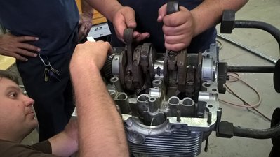

Chuck yelling at Rick for rods touching the case and at Mike for not having the cam gear assembled, I think.

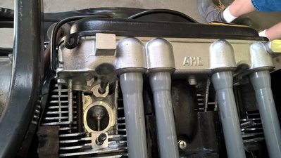

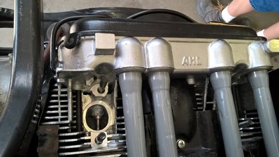

new AMC heads on
new AMC heads on

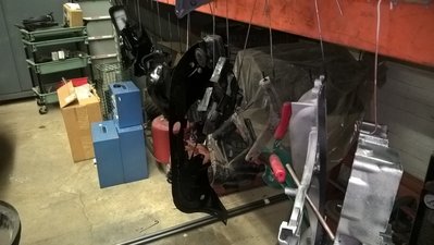

tin parts painted, holes for the porsche plugs capped

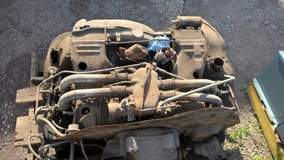

fuel injection donor engine
blower housing blasted nice and clean

Chuck went all out and thoroughly cleaned and painted the push rod tubes

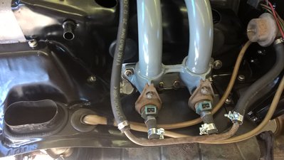

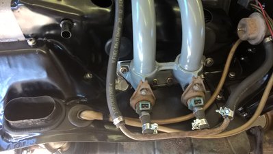

Fuel injection conversion under way
