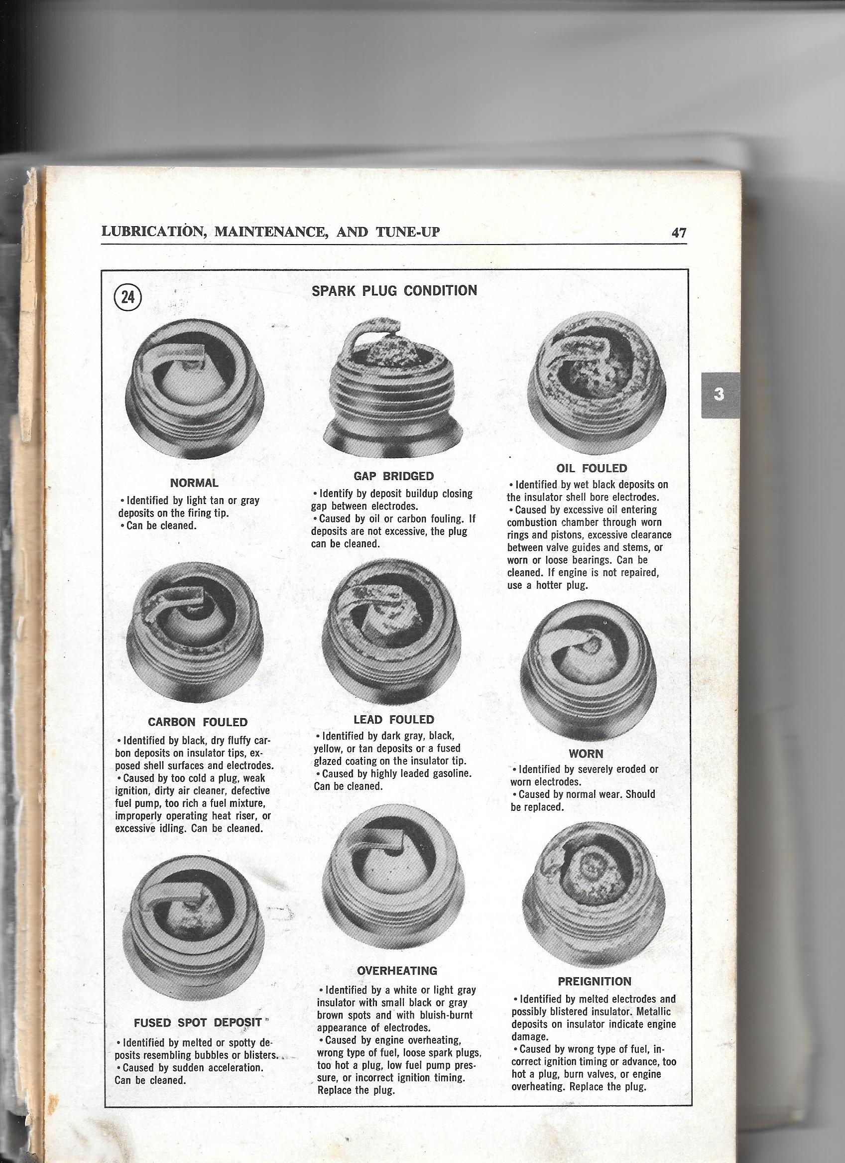

While this is "OLD SCHOOL", pull your spark plugs. Before the days of A/F ratio metering and O2 sensors, this is how you could determine whether you are running rich or lean. the chart below is old stuff,it does not show "rich" of "lean",but is somewhat useful. Rich will be a blackened plug,un burned fuel ,while a white plug tip will indicate a lean condition (hot). In a very lean condition the plug tip may even be deteriorated. I am planning an article on the AFC fuel injection and how to properly tune it,but it may be a while,I have another thread to finish first :lol:

wwebner wrote:While this is "OLD SCHOOL", pull your spark plugs. Before the days of A/F ratio metering and O2 sensors, this is how you could determine whether you are running rich or lean. the chart below is old stuff,it does not show "rich" of "lean",but is somewhat useful. Rich will be a blackened plug,un burned fuel ,while a white plug tip will indicate a lean condition (hot). In a very lean condition the plug tip may even be deteriorated. I am planning an article on the AFC fuel injection and how to properly tune it,but it may be a while,I have another thread to finish first :lol:
Thanks for the great info! I need to get my butt in gear and put some pictures up.

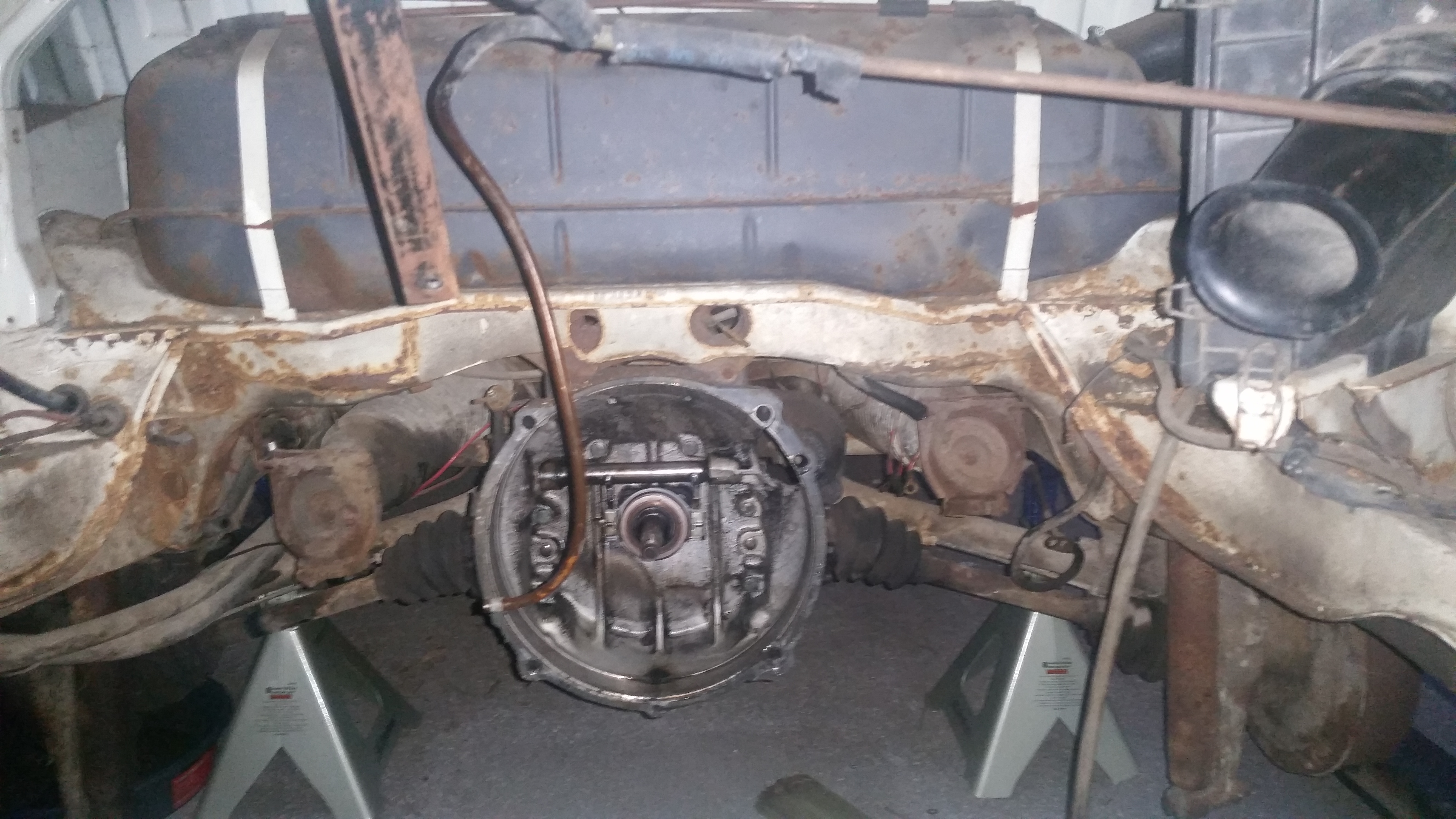

Got my engine out last night, but I managed to bend this bolt...
(Thanks to ratwell for the picture)
It is one of the studs that stay in the engine that your stand/mount can mount to... Runs through the transmission bellhousing.
What is involved in replacing it?
Not uncommon and not a big deal As I recall it is an 80mmx10mm stud. double nut it or use vise grips. as long as the threads in the case are OK,your good to go.

wwebner wrote:Not uncommon and not a big deal As I recall it is an 80mmx10mm stud. double nut it or use vise grips. as long as the threads in the case are OK,your good to go.
So just try to bend it straight again? threads inside the case are good as far as i know.
Also I've added pictures finally to the first and second post.
Sure,just straighten it. BTW,looks pretty solid with minimal rust repair. Now would be a good time to pull the fuel tank and inspect/clean it. Also replace filler hose if needed and especially the vent hoses and the tank fuel lines.Look at the tank outlet and return nipples on the bottom of the tank. 77 they are probably ok. 78 and 79 they packed insulation in this area causing them to rot.

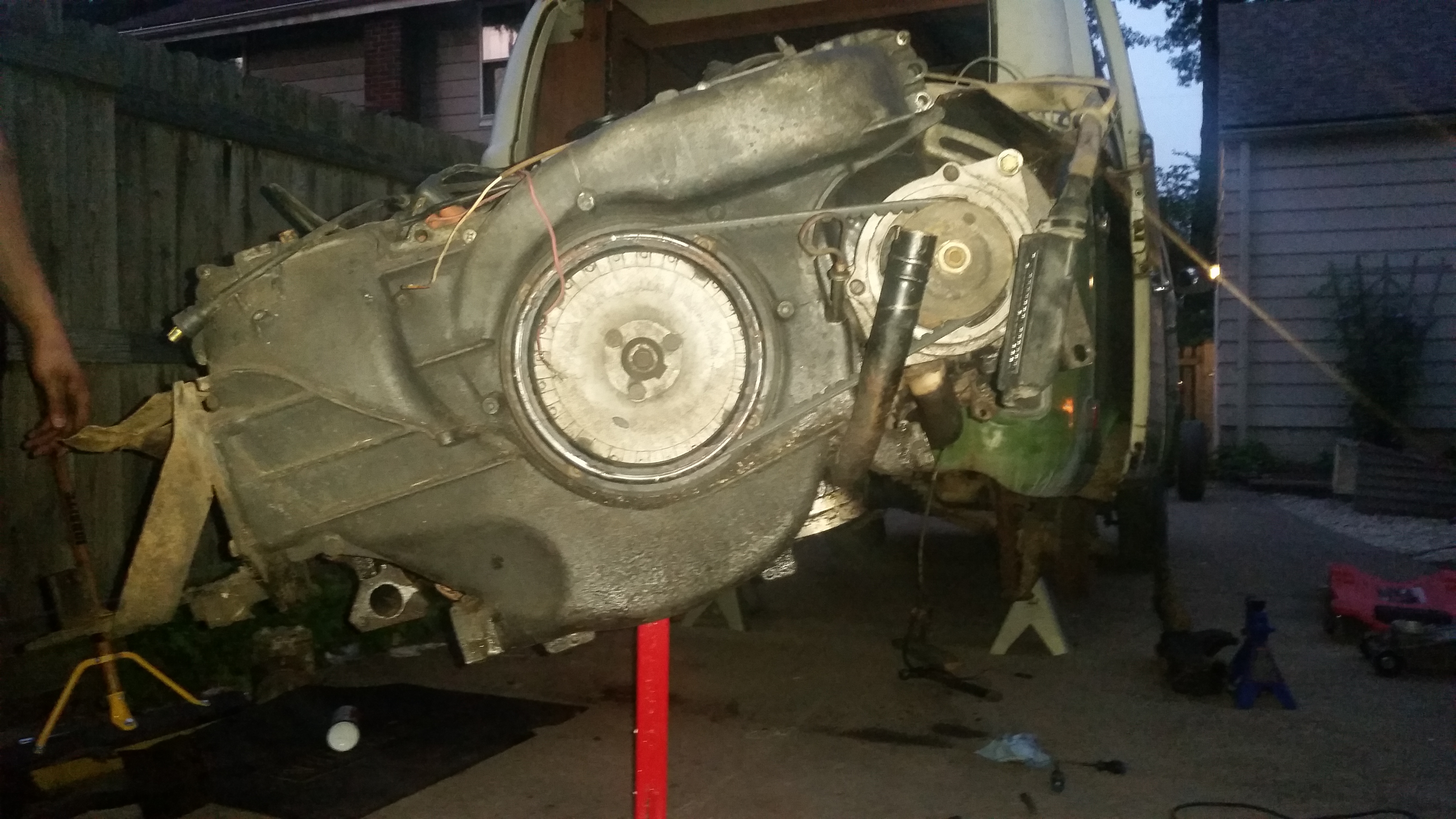

Getting that engine out was a pain! So many frozen/rusted bolts. On top of that I had to remove the AC compressor and the trailer hitch. I had to cut out my heater boxes, too.
