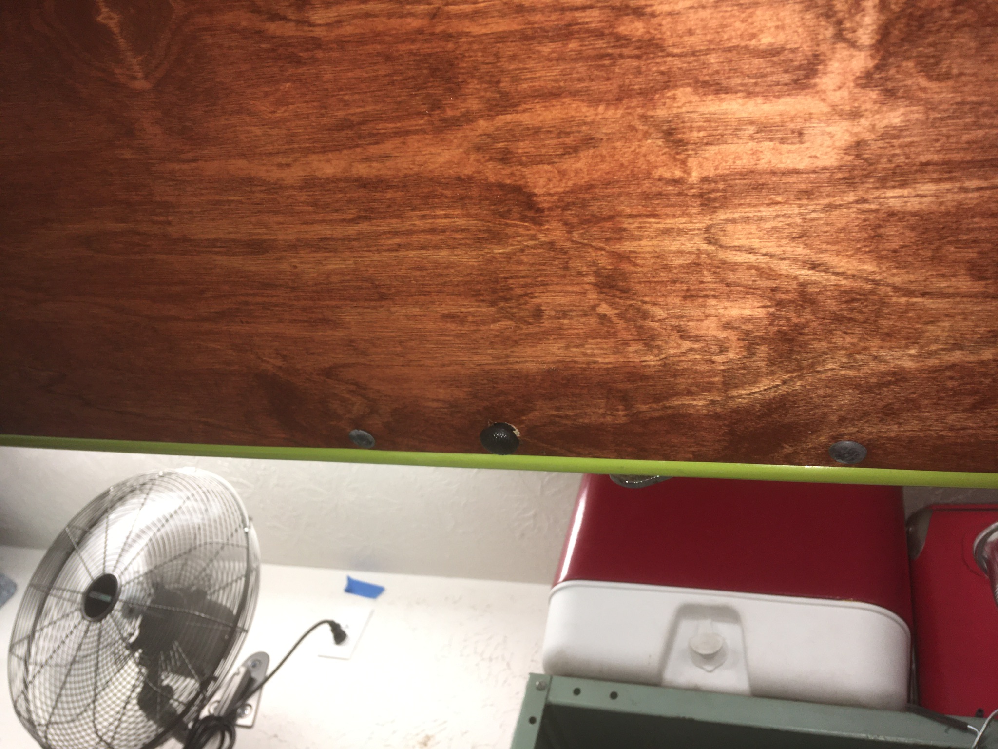

Got the panel back in. I think it turned out pretty good, almost factory.
Re: 76 Westfalia Sweet Pickle
Posted: Thu Apr 30, 2020 10:00 am
by Dual Port
That's pretty cool. I drilled a hole in my panel so I can stick my finger through and trip the catch, but yours is more finished.

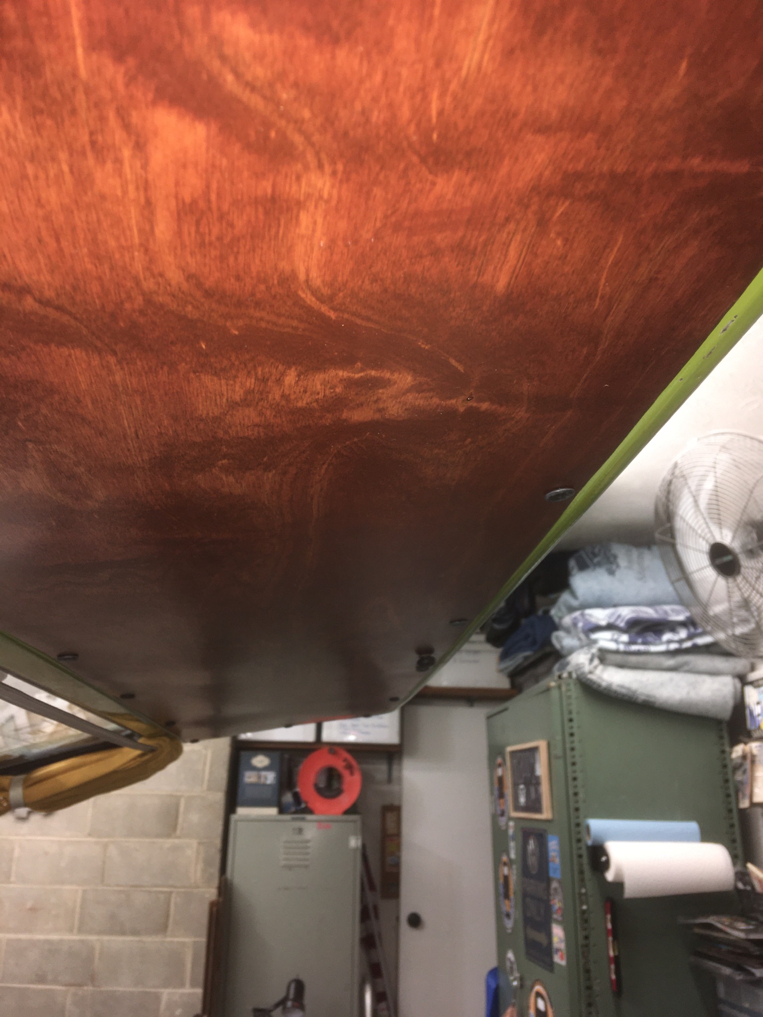

I finished the tailgate panel, the side panels in the luggage area and put back in the closet. Then they made the panel on the passenger side of the seat look shabby. So out came the back seat/bed.
