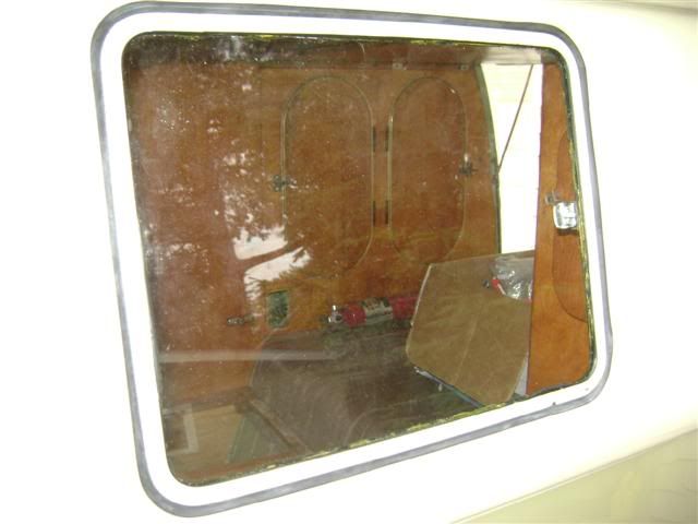

I got the last pop out window in and went with a non-correct big spoon latch for mazimum air. I have the original for the stock nazis down the road
Re: CKWA/KWHA Part II
westy66 wrote:cant help you with the tap issue... wheres Ted when you need him :lol: changing diapers!
screw the vintage nazis i like the spoons!
Thanks Bob! I'm all about the increased air flow the spoons bring! :lol:

I tried my best to assemble those windows in a timely fashion they took way longer than anticipated sorry I am glad your happy but sorry for the incorrect installation of one of the parts I will fix it if you like I tried my best to get them perfect for you oh yea keep the sticker too and try to track a match for the other window lol I couldn't get over it when I saw it on there and you told me you wanted to keep it I thought rock on haha and I think if my boss ever works on amother vw he is goin to go insane so luckly any one else's items will be worked on by me from now on and be a little quicker on return I love the fact that all of you guys trust me with you valuables and are happy with the final product I am still new to this stuff considering your guys experience over the years and I appreciate all that has been done for me by the leak oil crew thank you.. Dan
