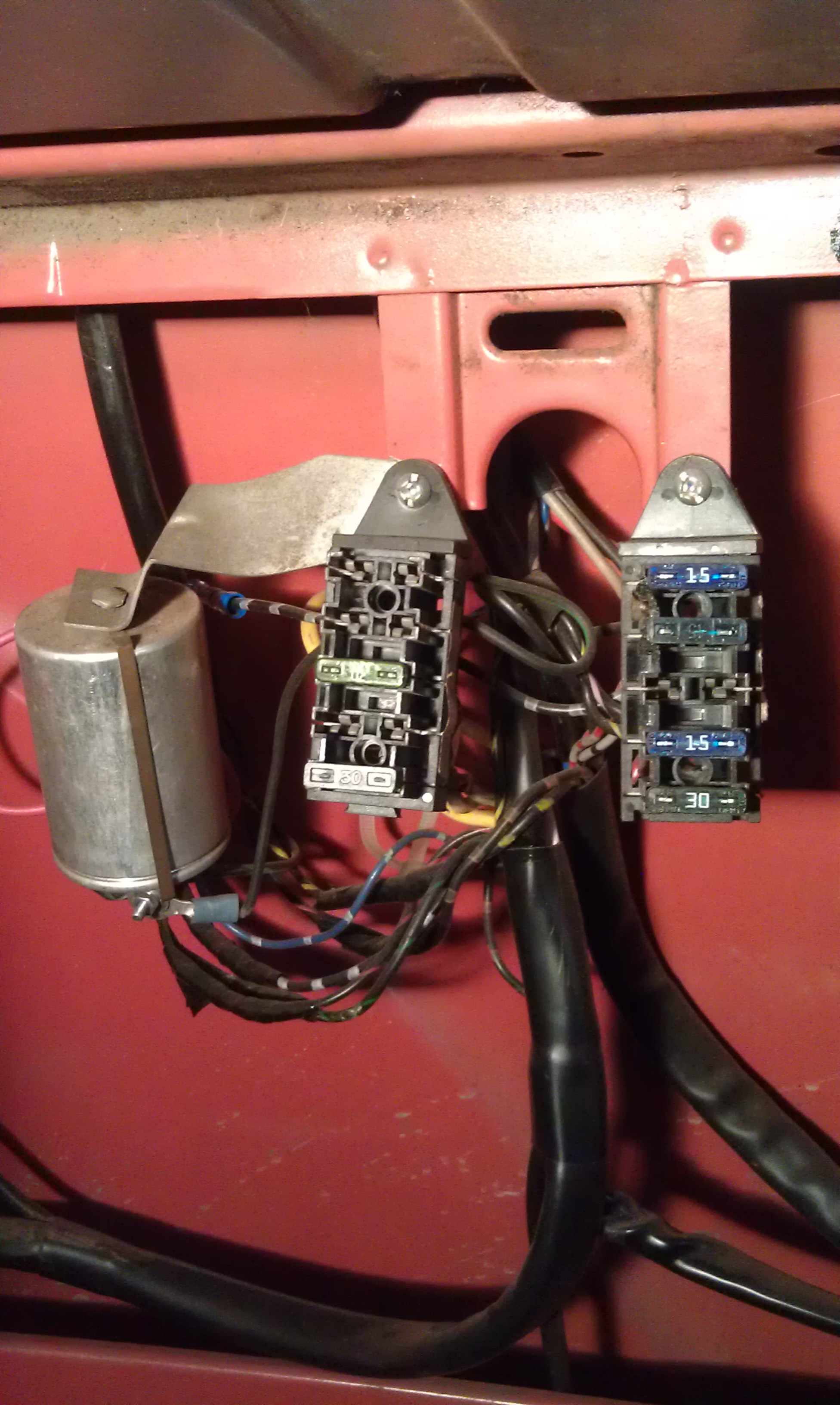

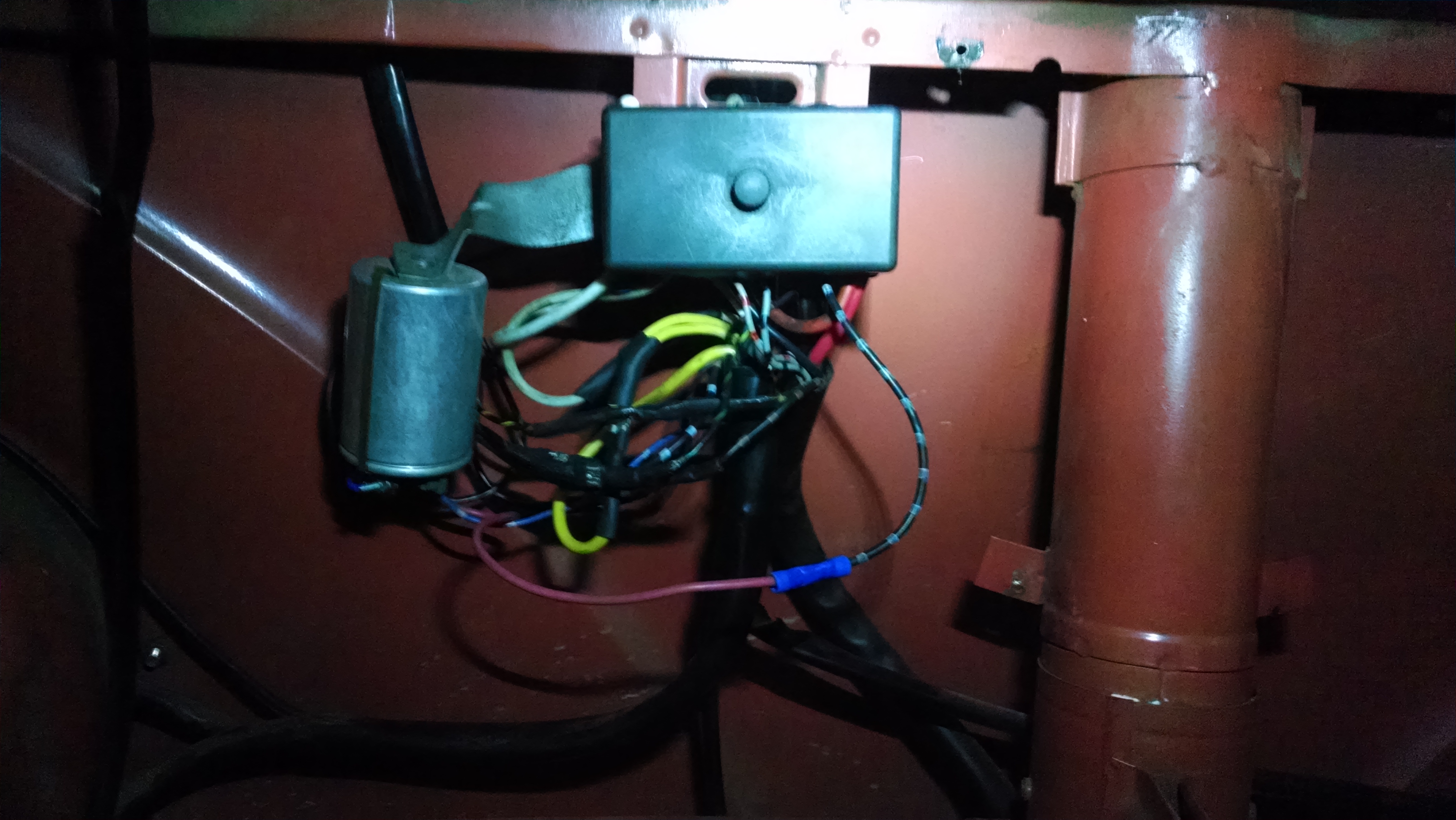

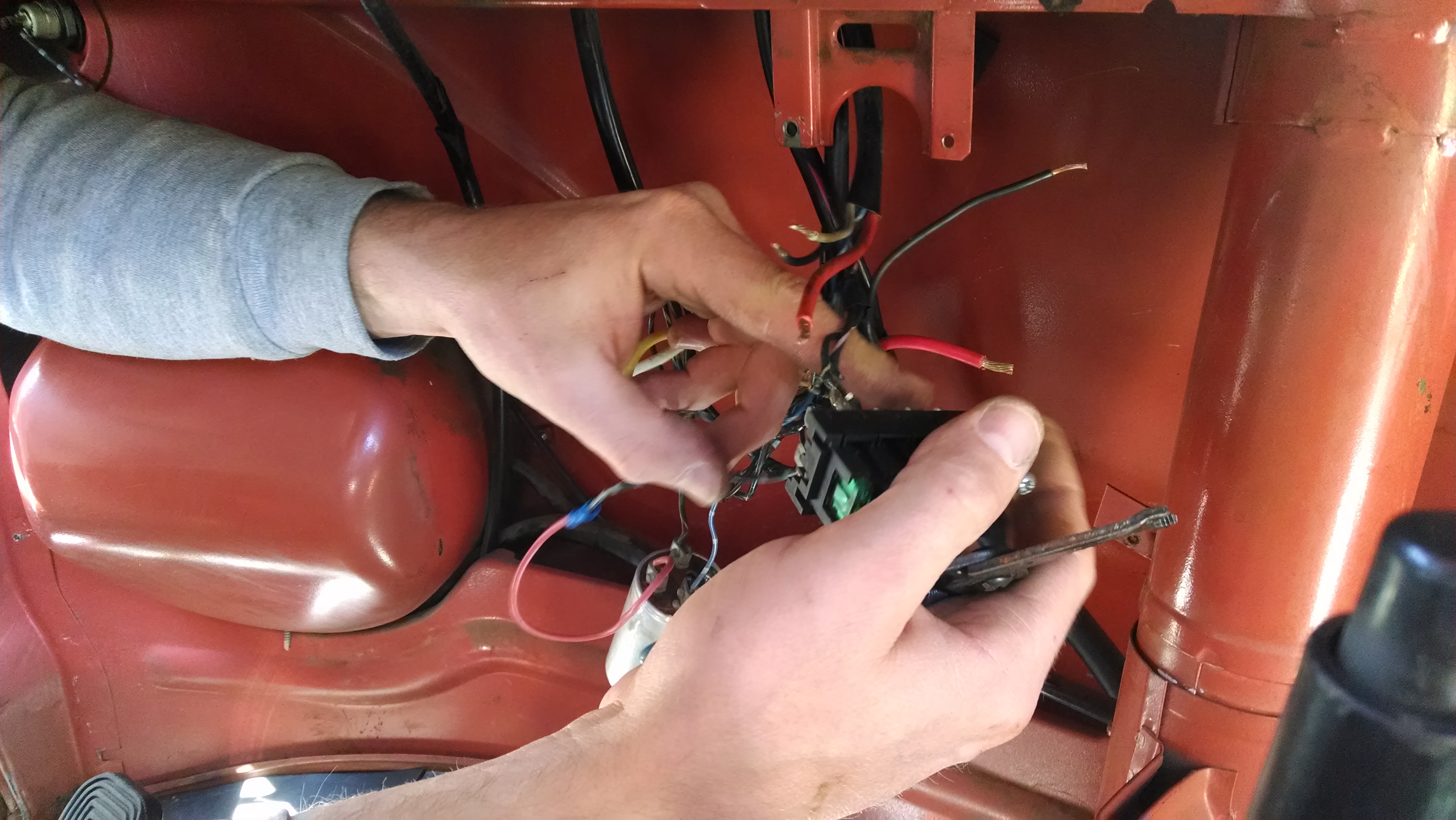

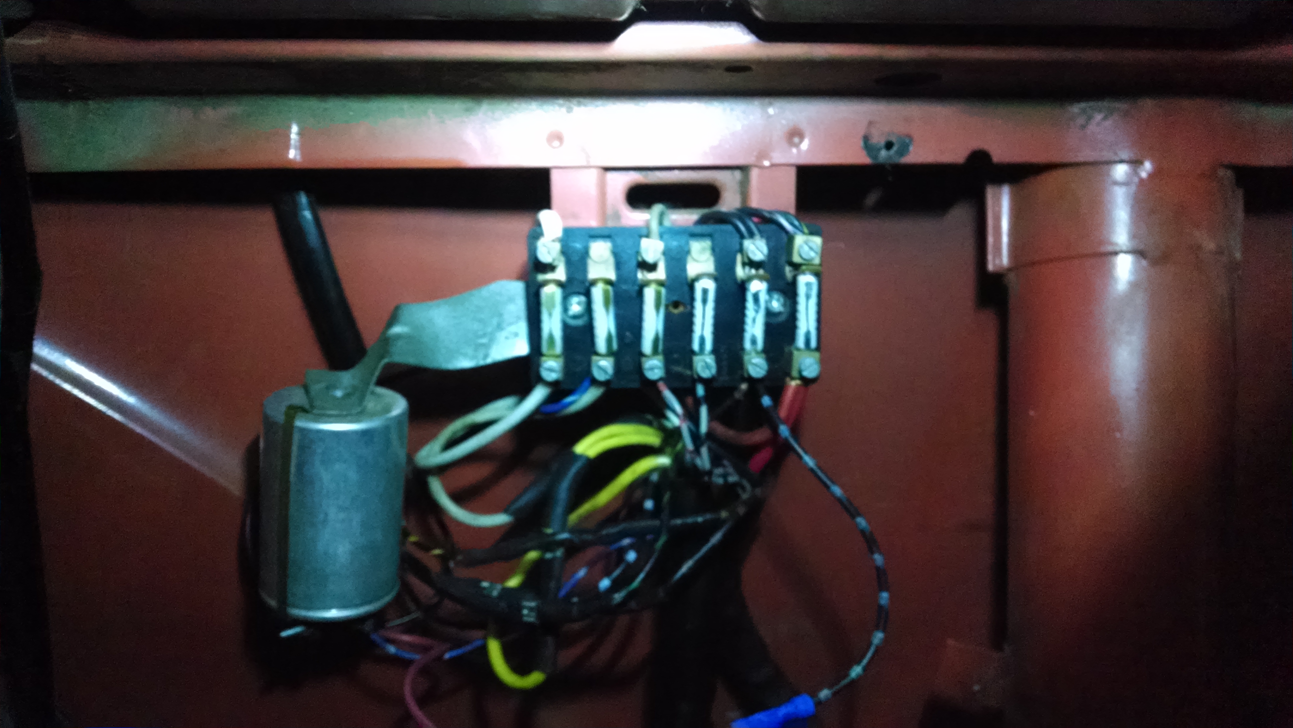

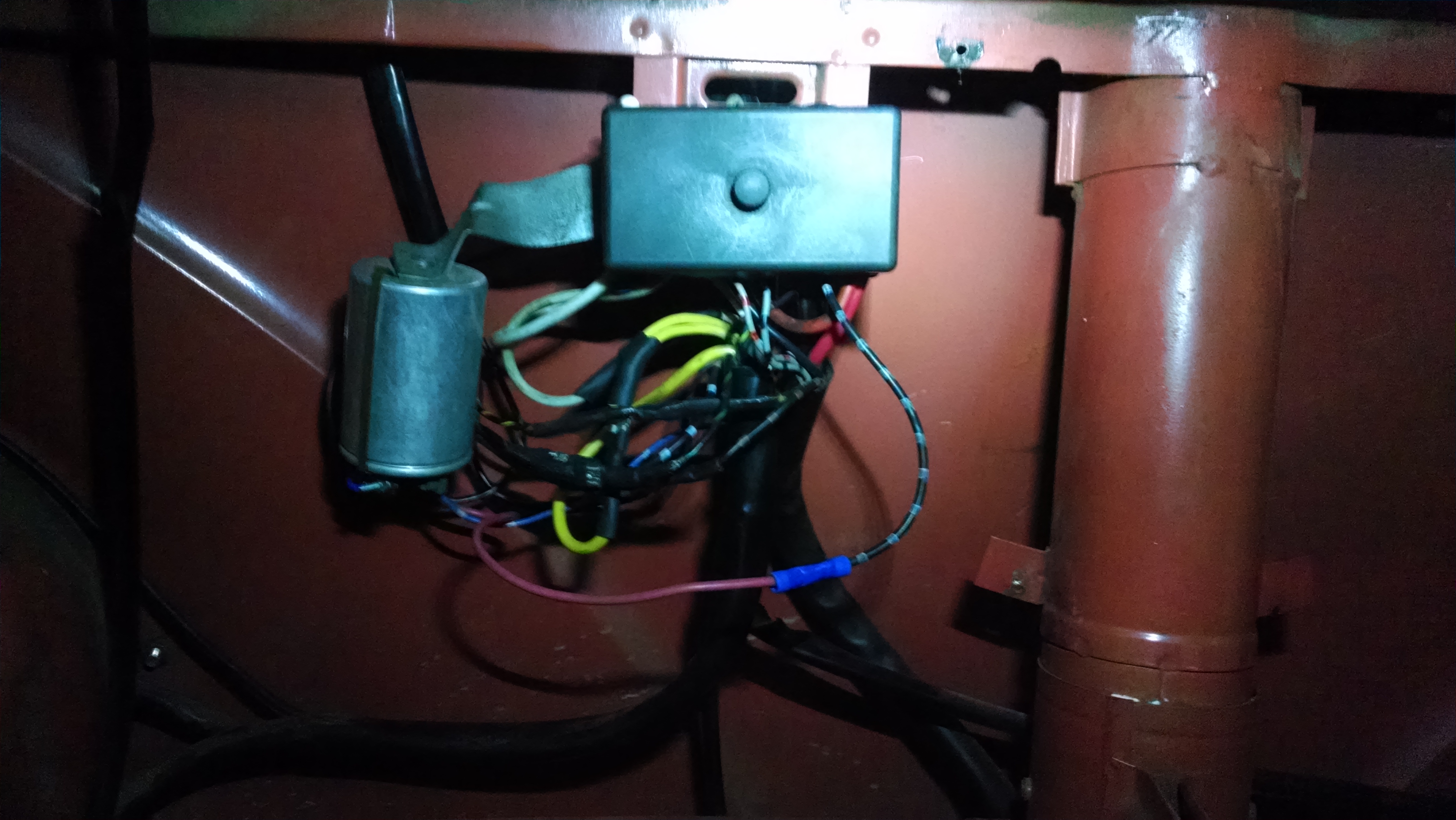

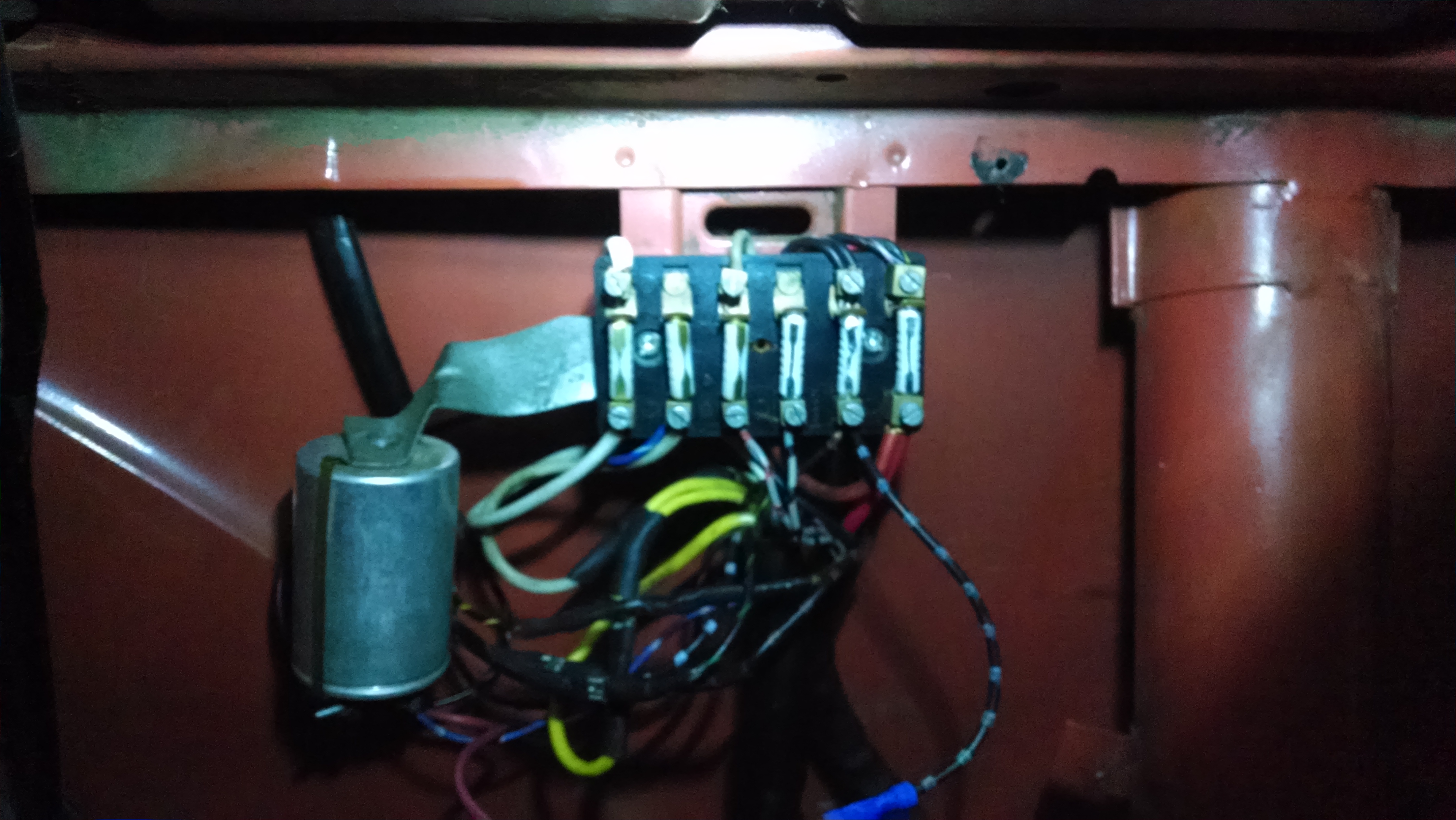

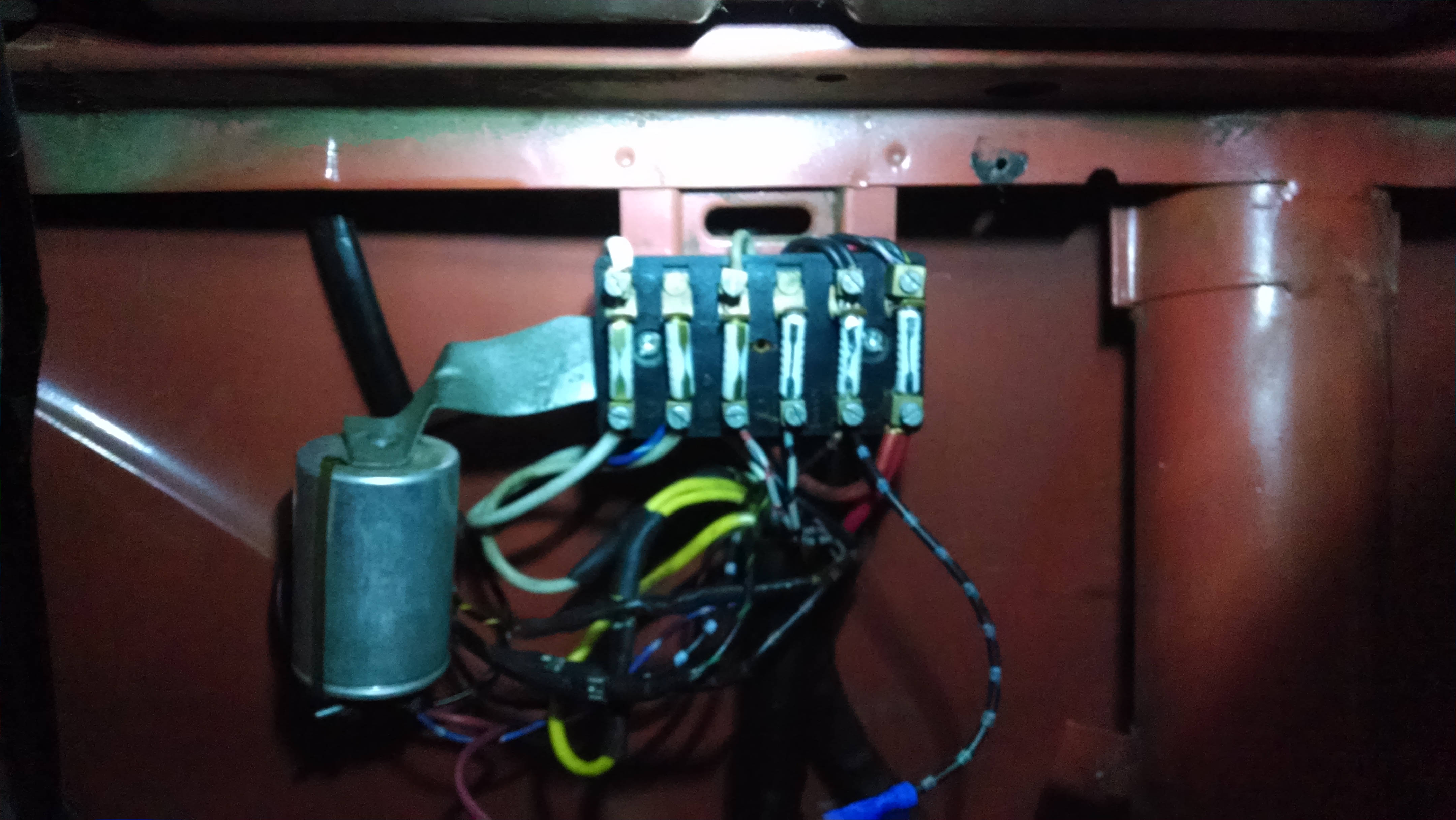

Mike came over and helped me out with some electrical work last weekend. We replaced the double fuse panel and flat fuses from the previous owner, with an original 6 fuse panel (according to owner's manual). We followed the wiring diagram and re-did all of the connections. I still have an issue with my right rear turn signal, nithing I can't trace down with some time. But, I now have brake lights that work the correct way! ;)
I learned a lot by doing this. Mike was a huge help - Thanks Mike!
Here are some before, during and after photos....
Before...
Before...
Without the cover
Without the cover
With the cover on
With the cover on

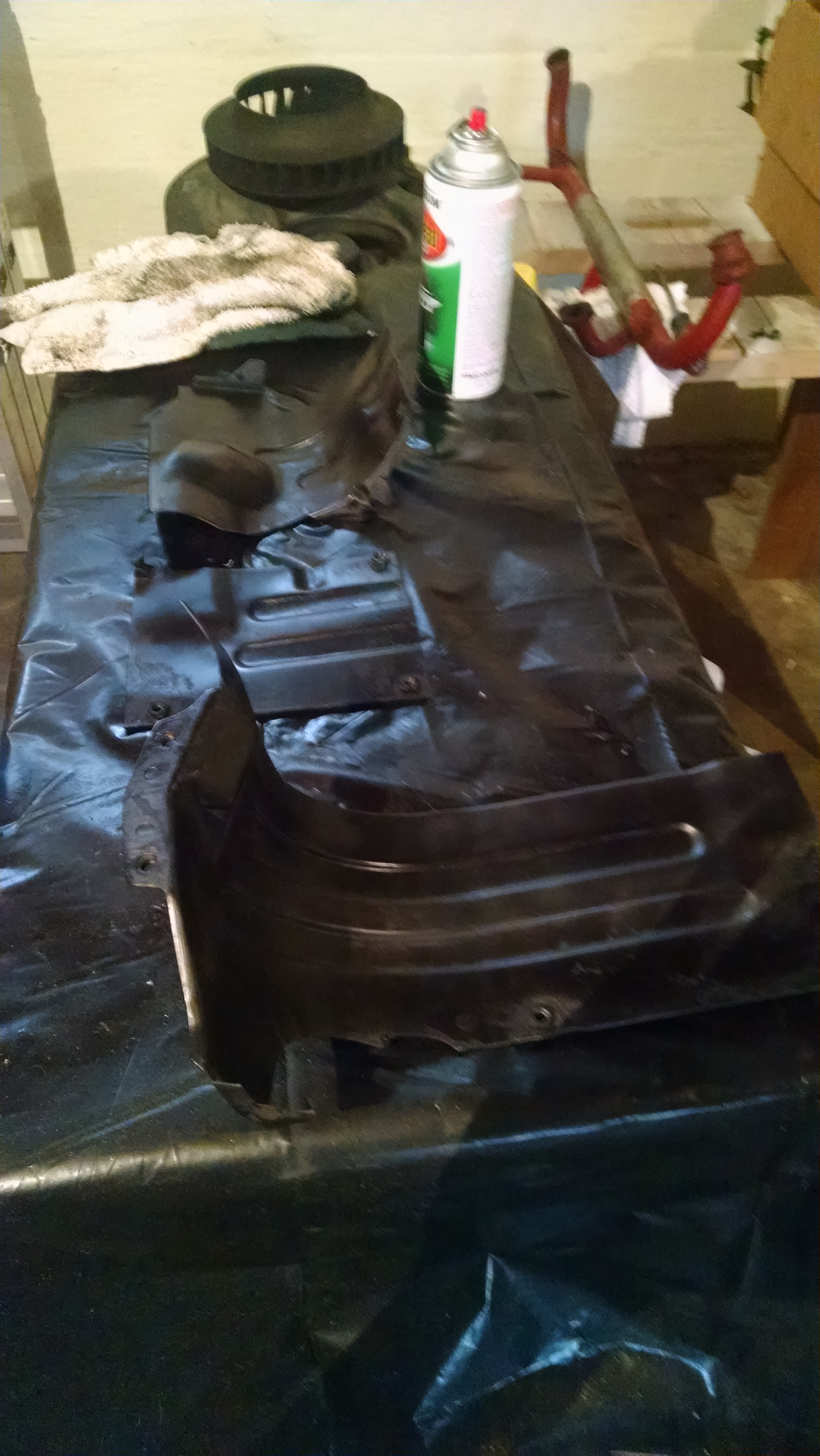

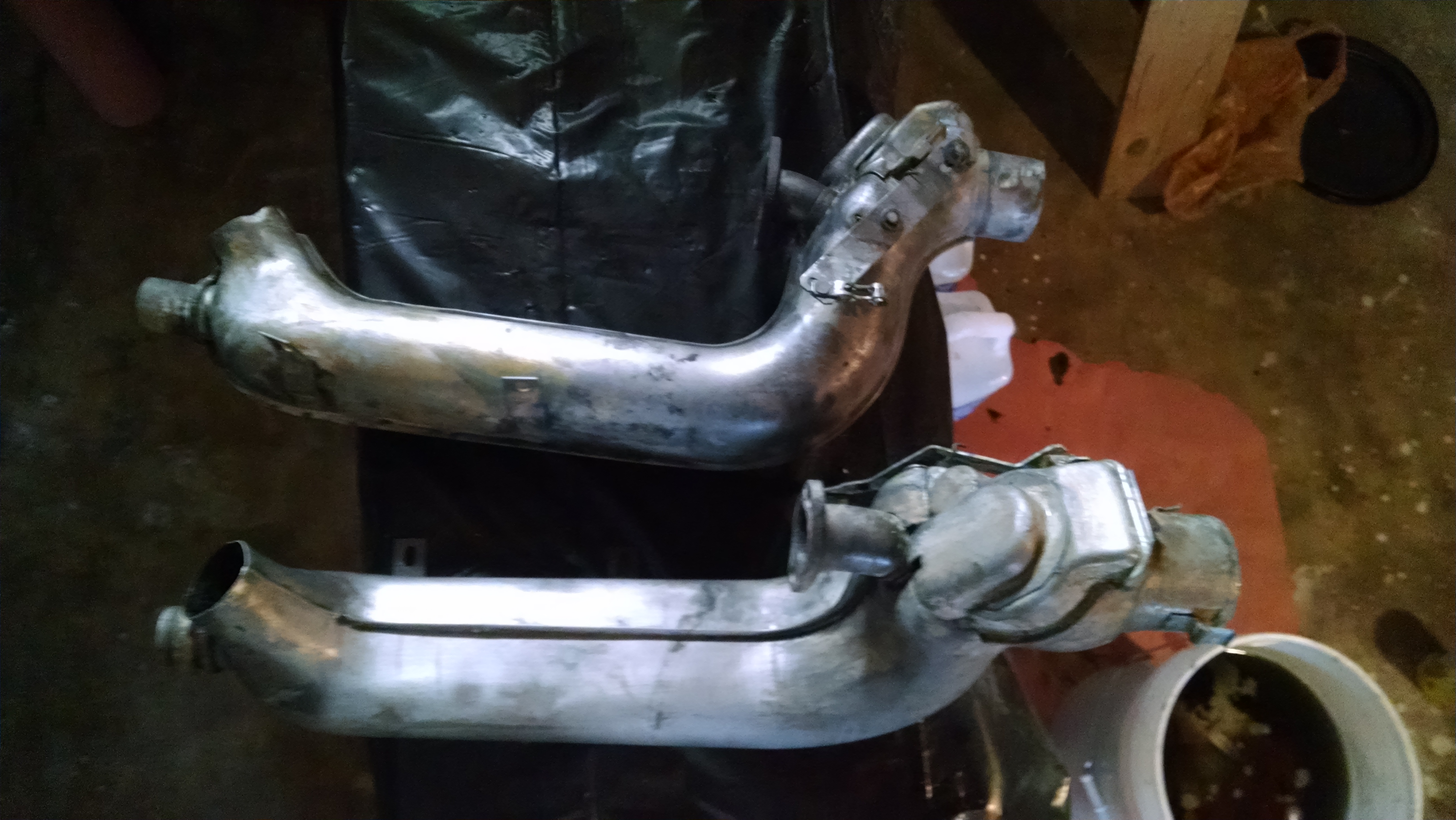

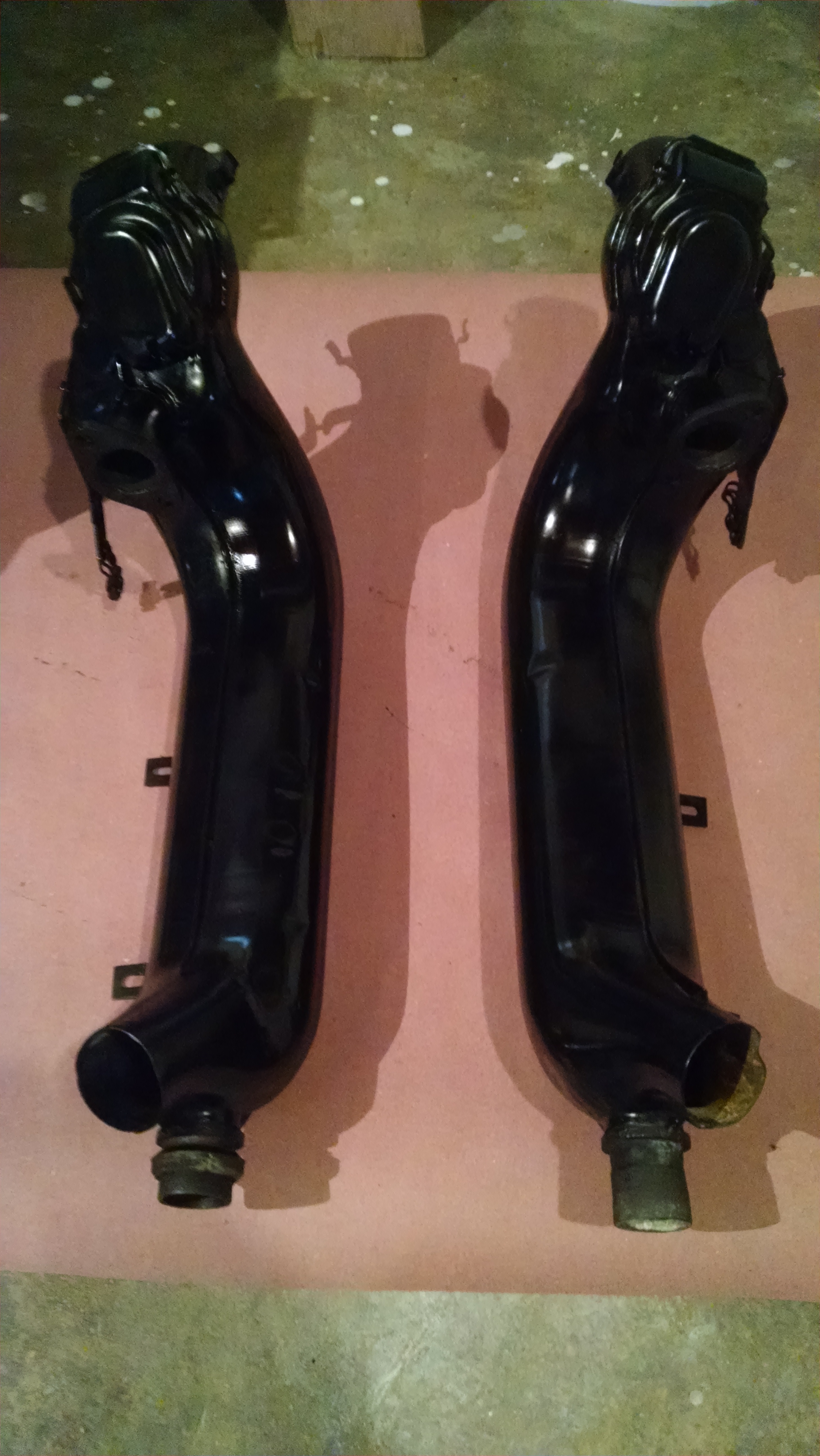

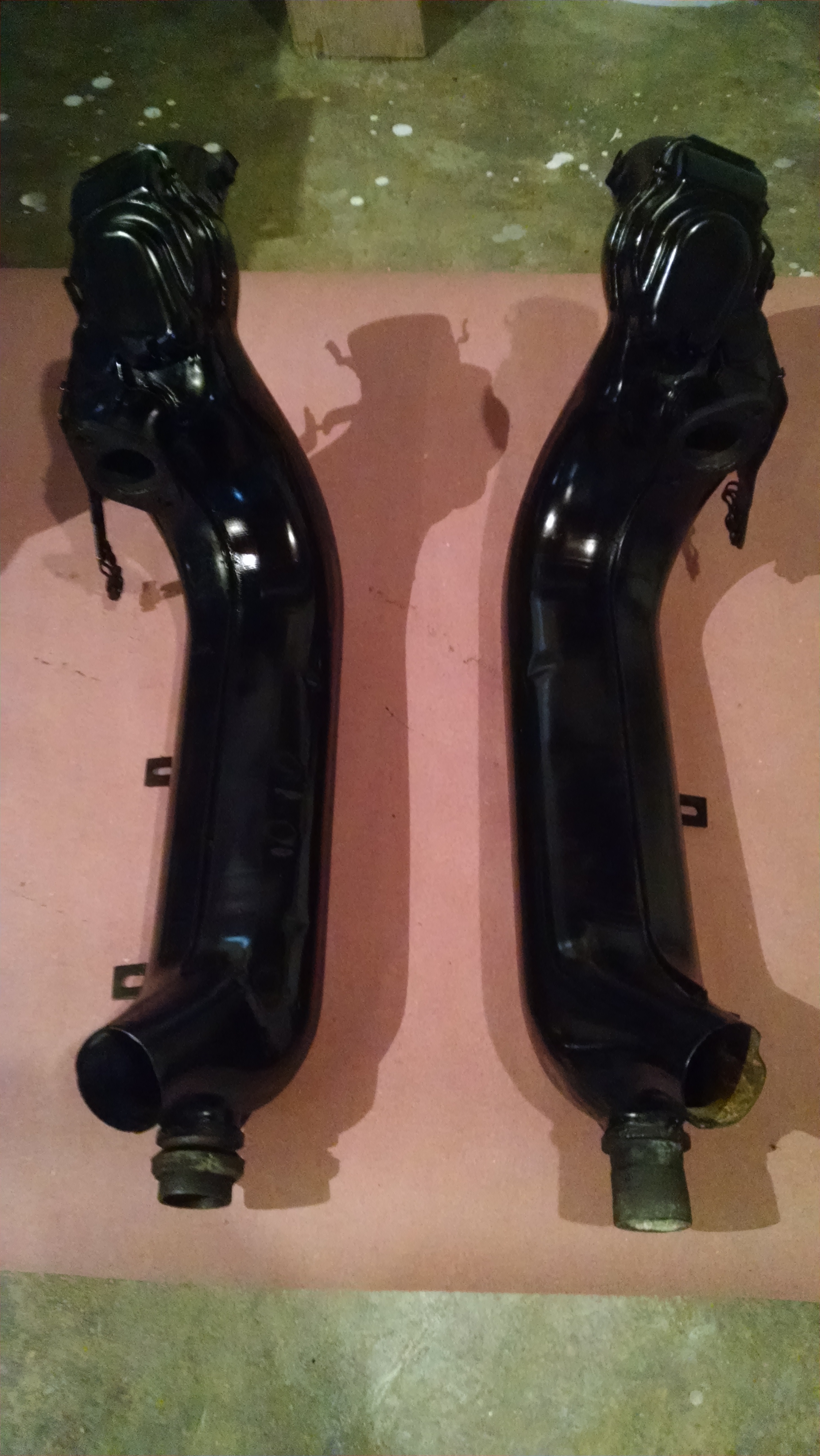

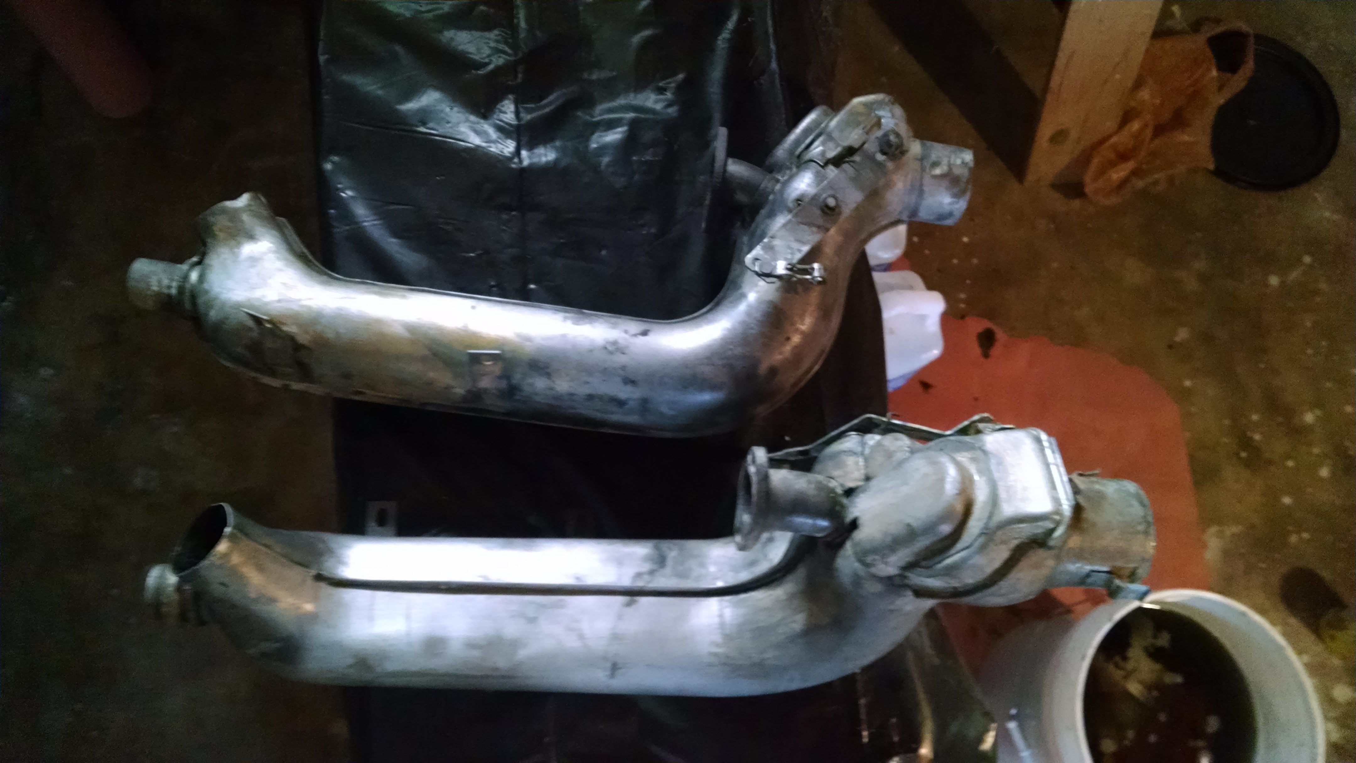

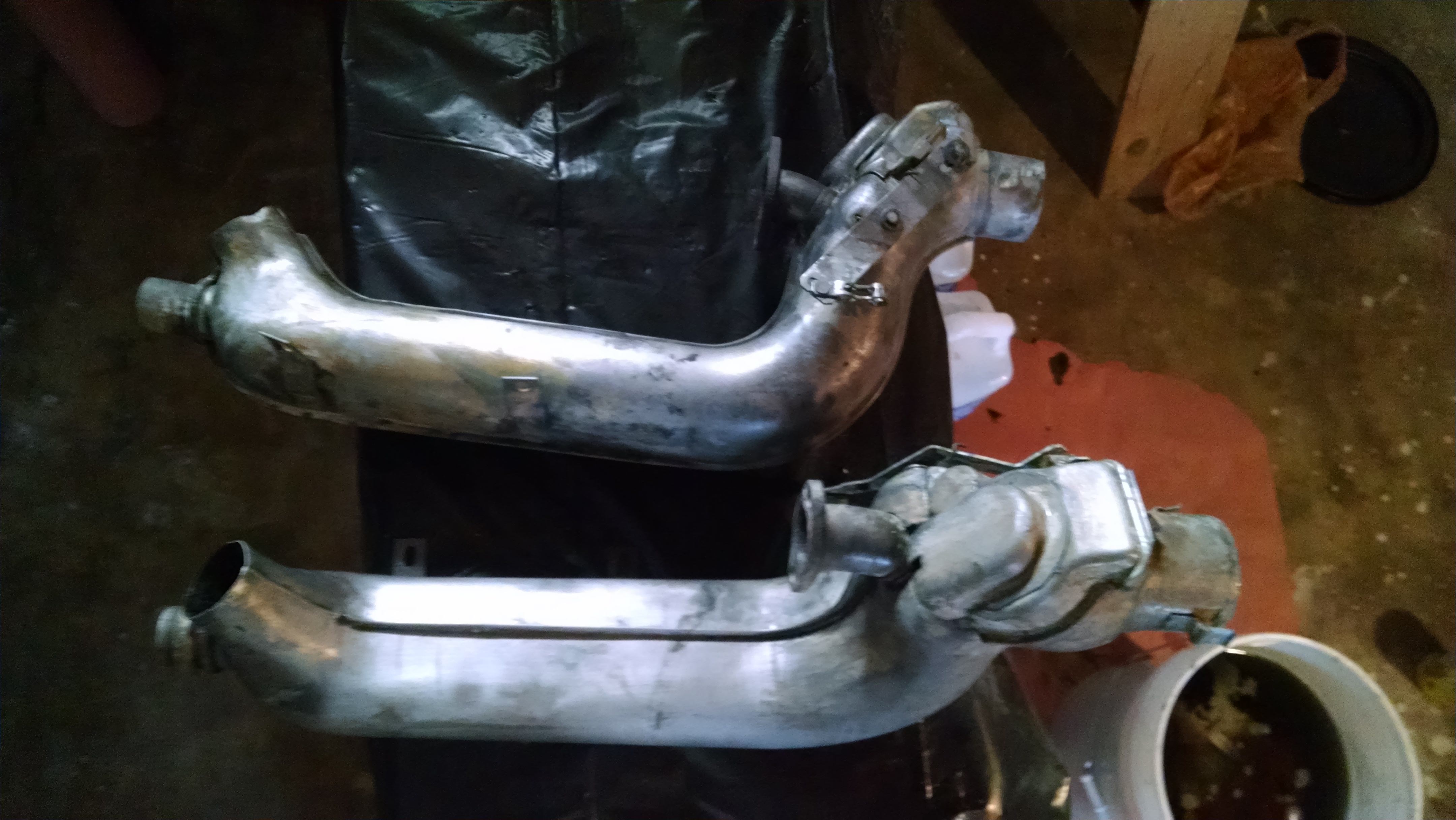

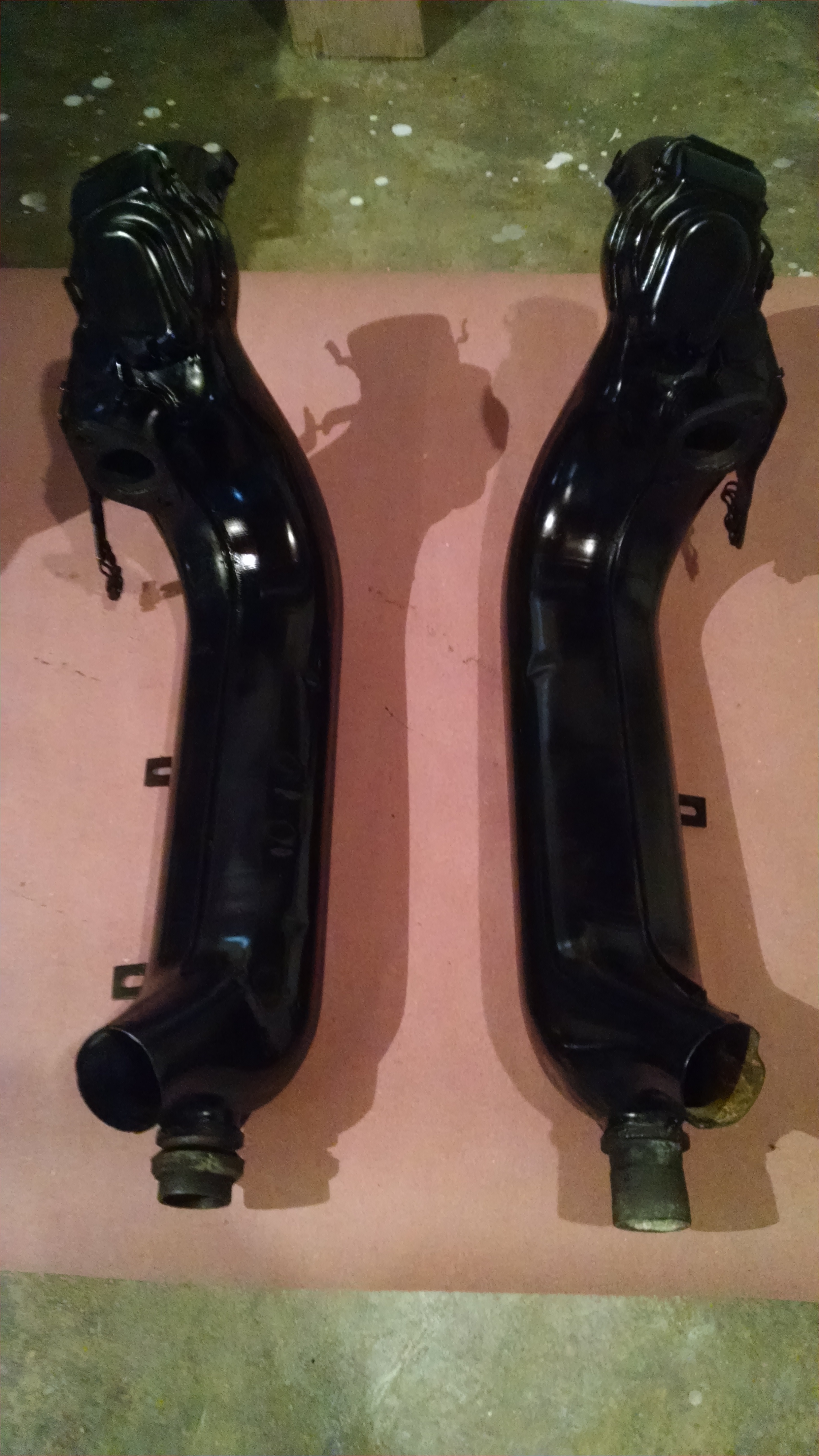

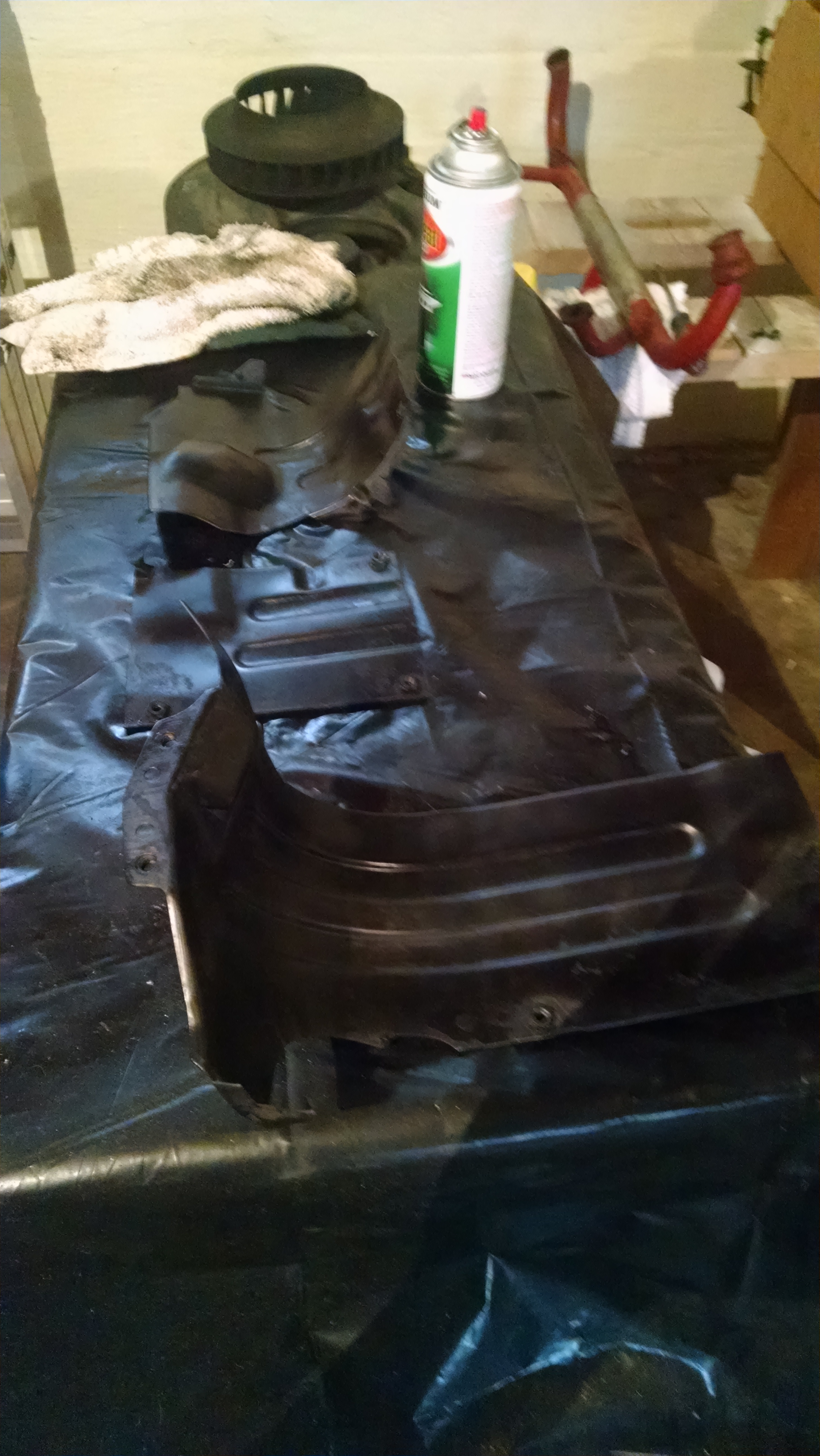

On my list of things to do was to clean and paint the heater boxes that I bought in Columbiana. My personal shopper picked them out and said for $60 bucks they were a pretty good deal. I was skeptical, they looked like crap... all gummed up with grease, dirt falling out of them when you tilted them.... But I put my faith in him and I am pleasantly surprised by how nice they turned out. Thanks again Mike!
First step was to soak them with Easy Off oven cleaner for a couple of nights in plastic bags, hot water rinse and scrub. Then sprayed them down with degreaser, rinse and scrub.... Once I had them fairly clean, I soaked them in Prep and Etch (Phosophoric Acid) over night in a bucket. Let them dry really good and then painted them with a high temp paint...
I wish I had before pictures...here are a few pictures in progress and all painted up. The pans still need a few more coats of paint.
After the Prep and Etch Soak

Heater Boxes Complete
Pans getting painted
