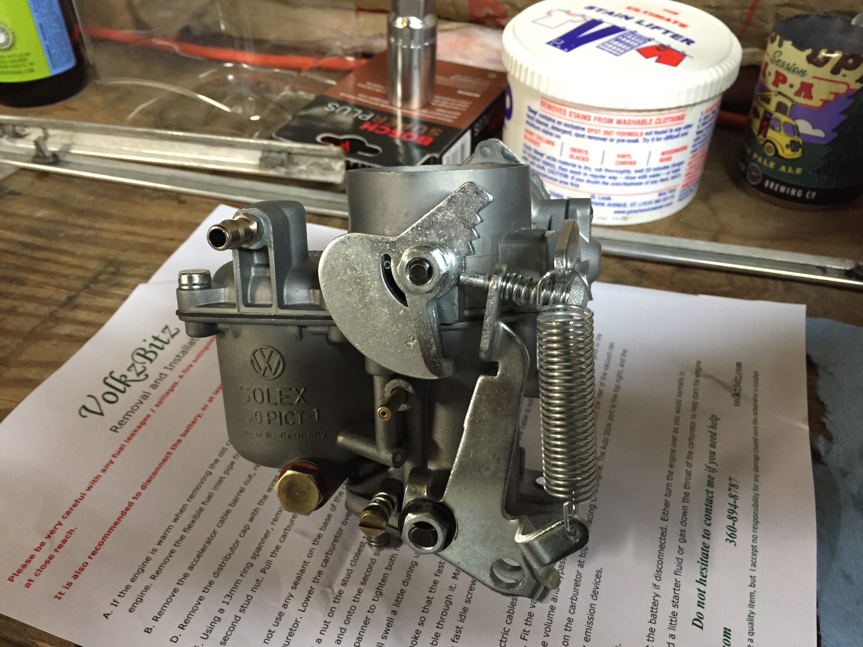

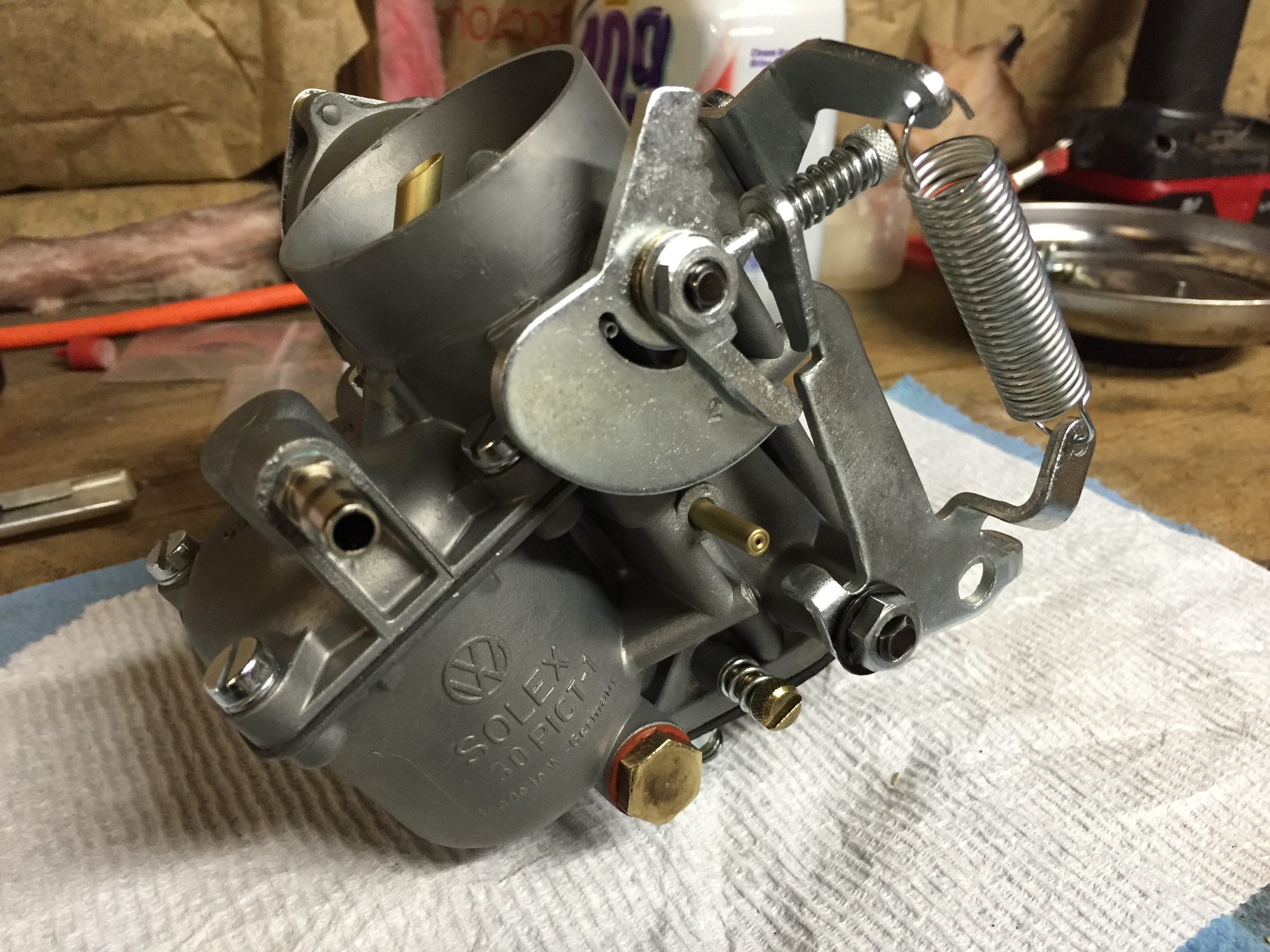

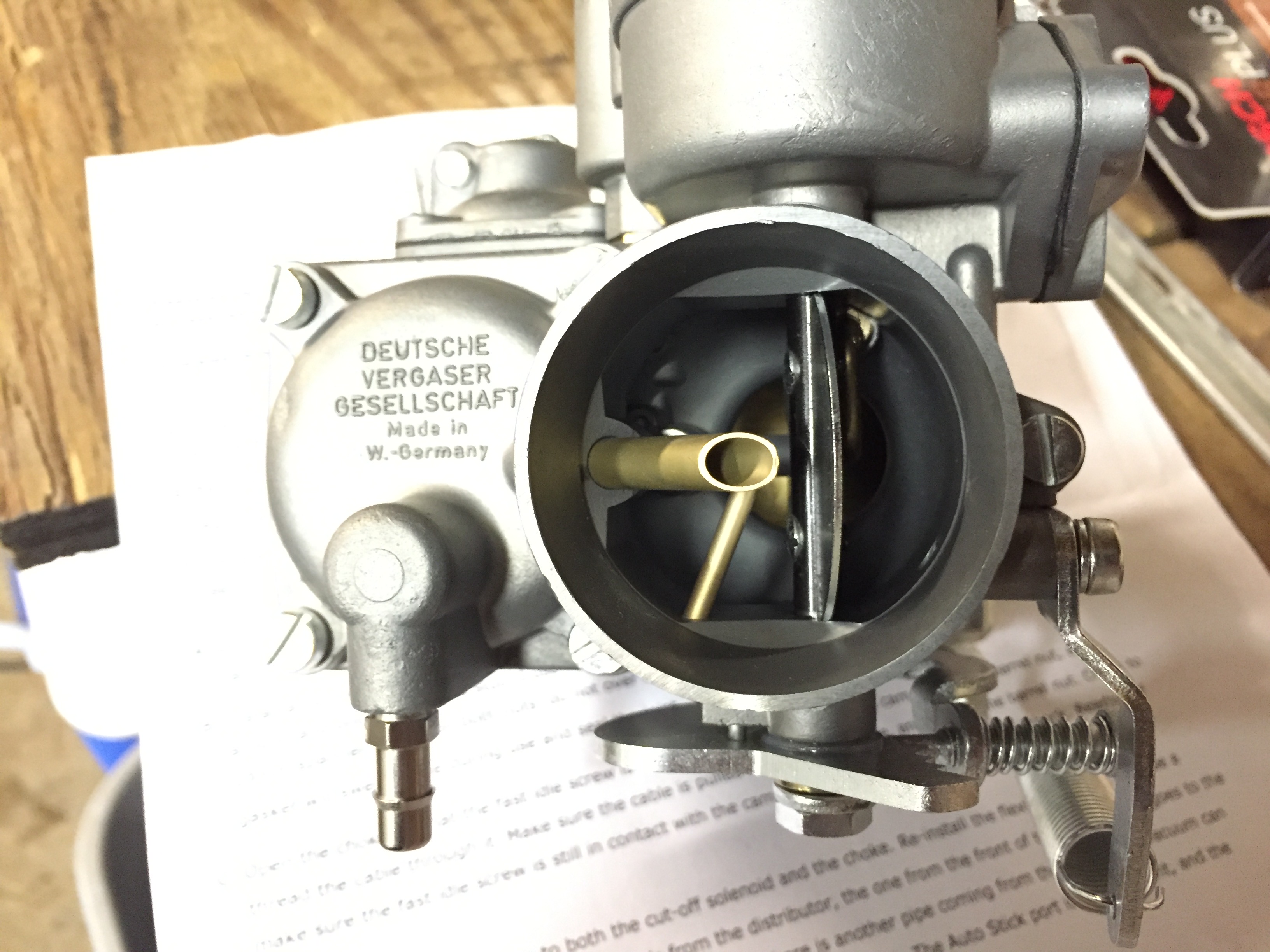

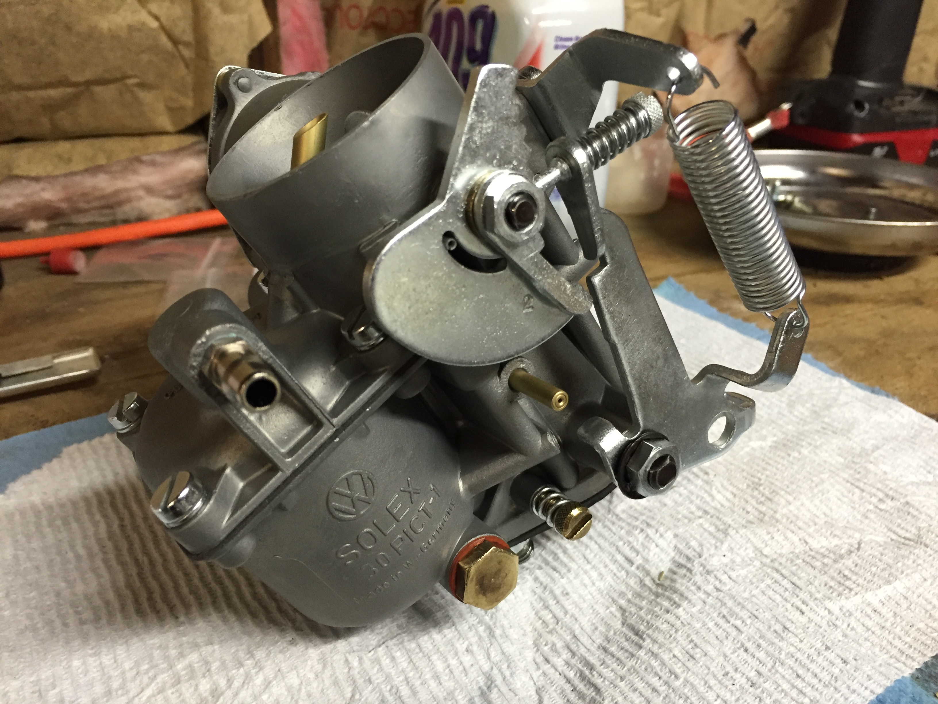

Volkzbitz fresh!

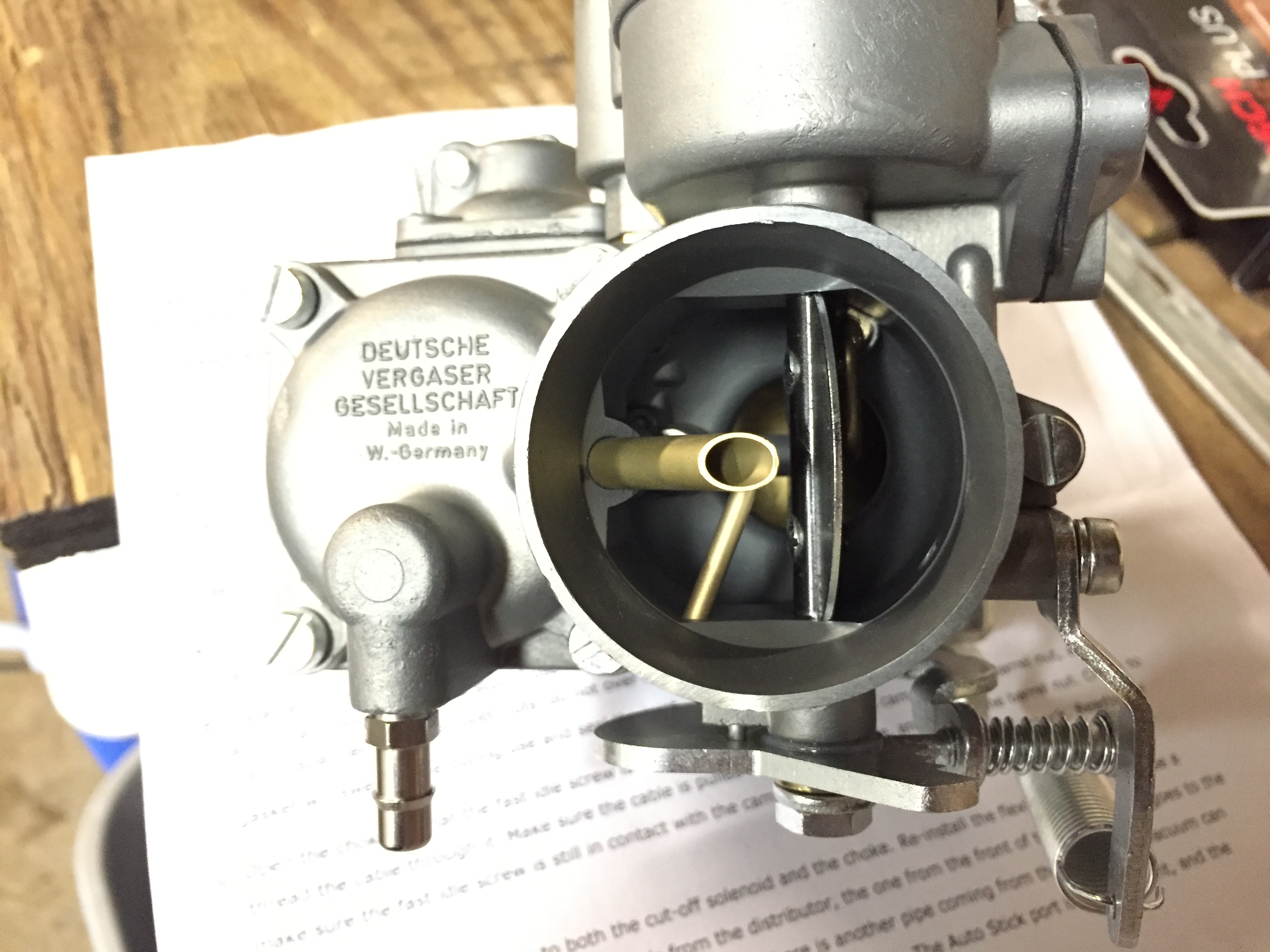

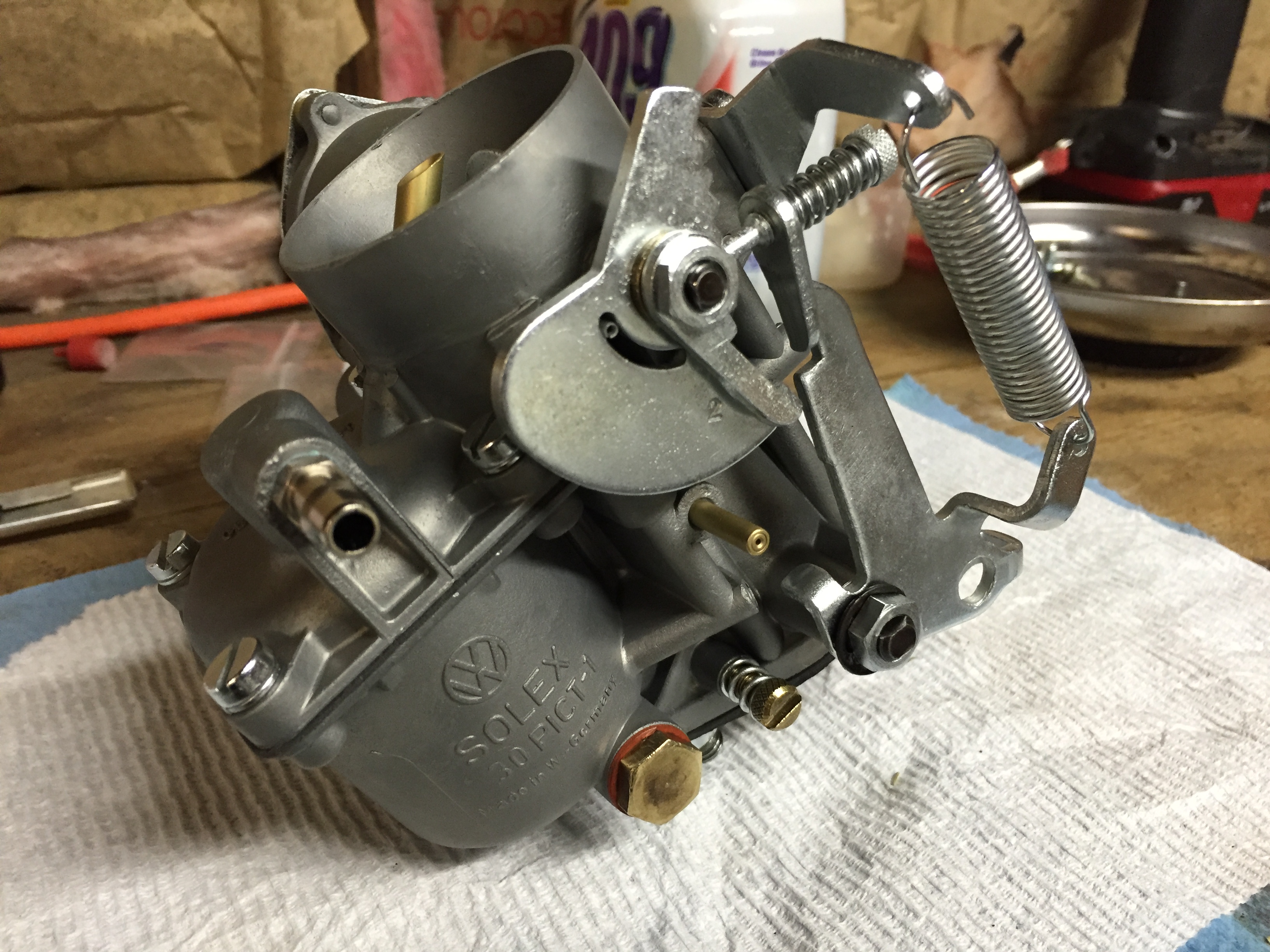

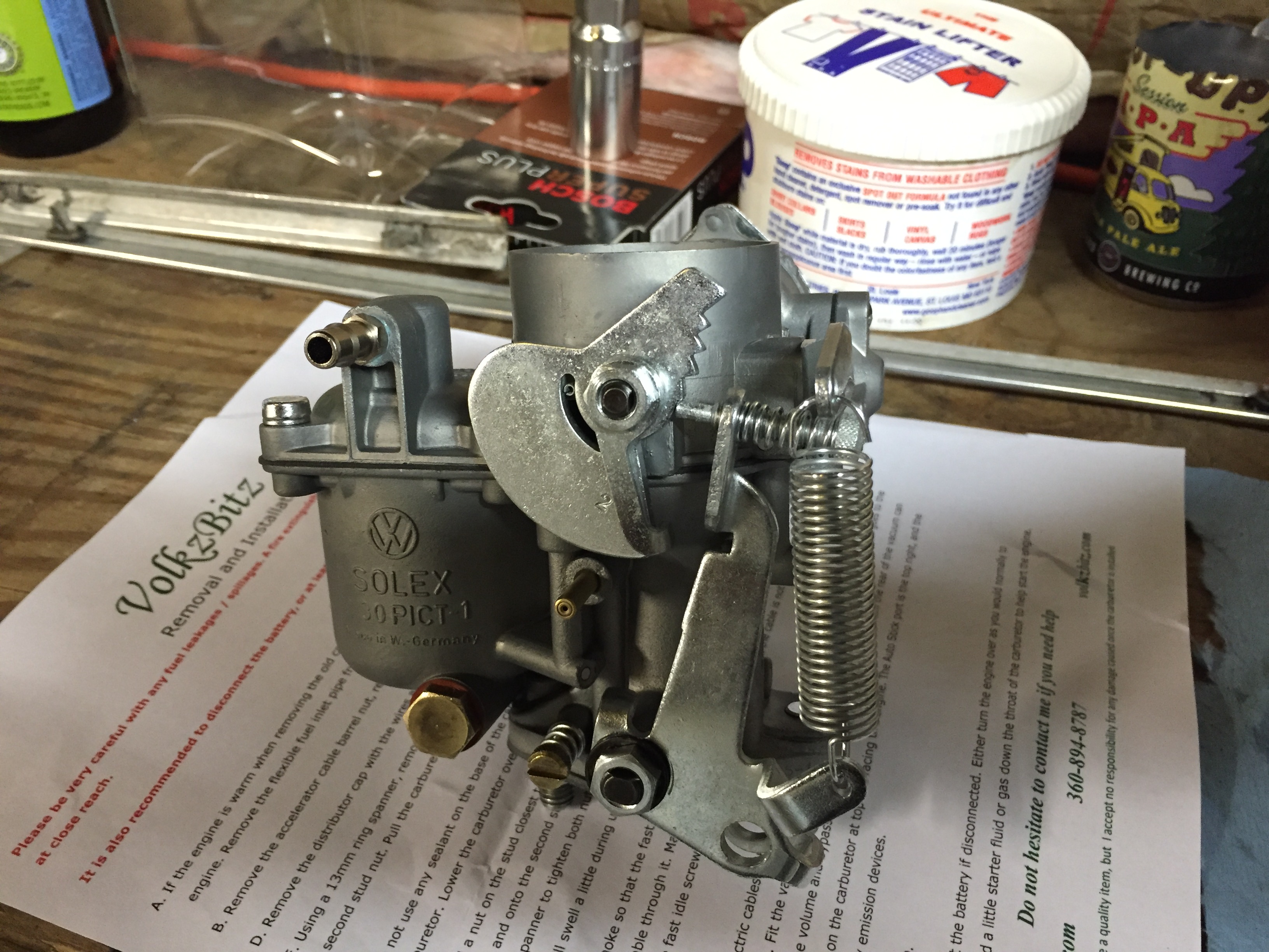

Posts: 1391
Re: Trailmix Beetle
Cool! Did you send yours out or buy one off the shelf?
trailmix
Posts: 84
Re: Trailmix Beetle
Post by trailmix »
I bought one off the shelf. The carb that is currently on the car is a 28PICT 1, I purchased the 30 PICT 1. I have learned that it's not a bad idea to have a back up. And it will give me a chance to go through the old one. It really looks great, Tim does a nice job.

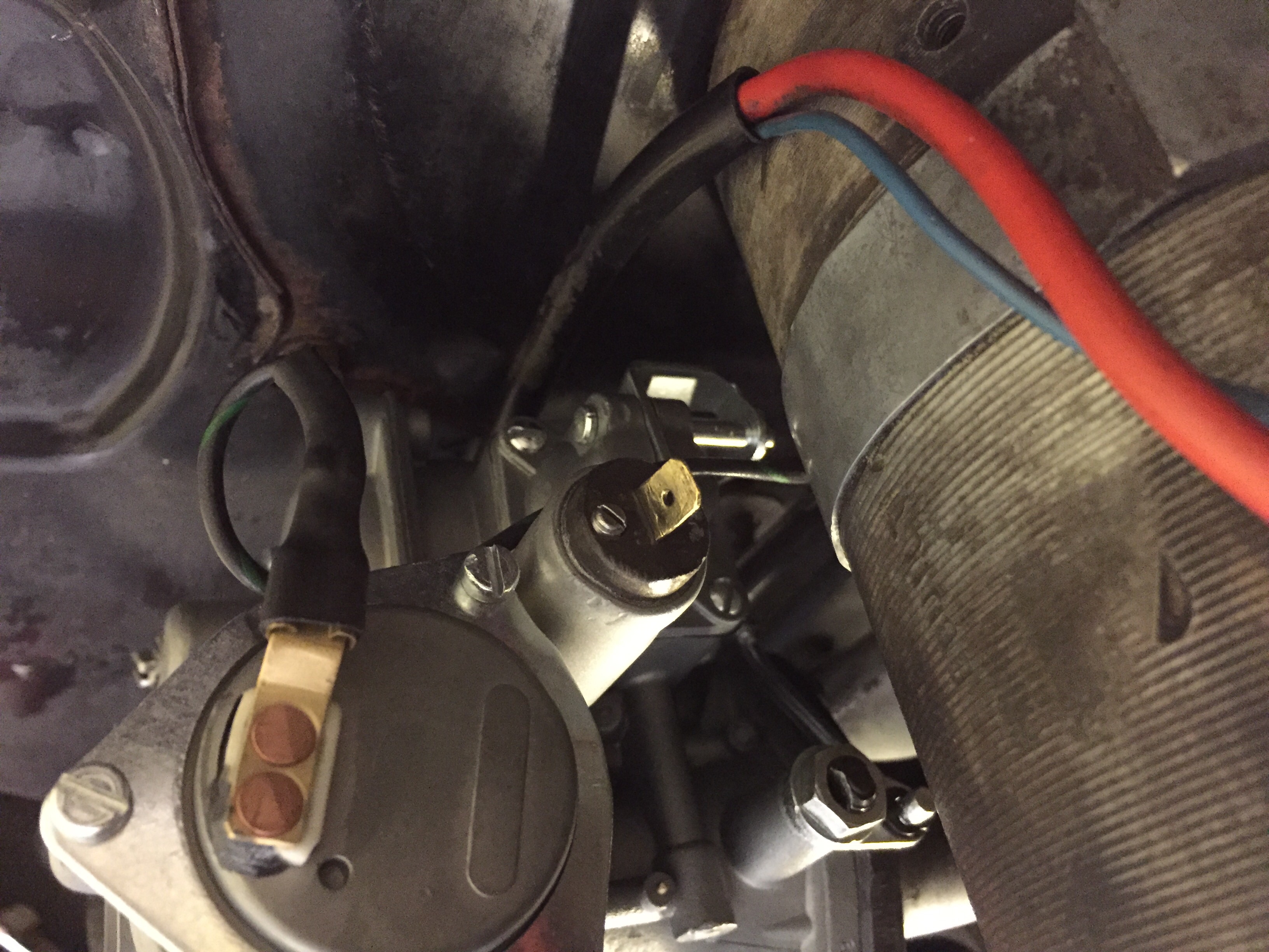

With the new carb, there is a new connection that I didn't have before. I remember Tim suggesting a power circuit because of the engine being a 1500 and a late 66. Is this just a simple wire from the coil to the power circuit that I need to assemble and plug in?
Posts: 1391
Re: Trailmix Beetle
Yes, that's an idle solenoid that cuts fuel so the car won't "run on" or diesel after the key is turned off. Run a wire from the hot side of the coil to it. On OEG setups it's a "Y" shaped wire that comes from the coil, to the solenoid, and to the choke coil heater.
