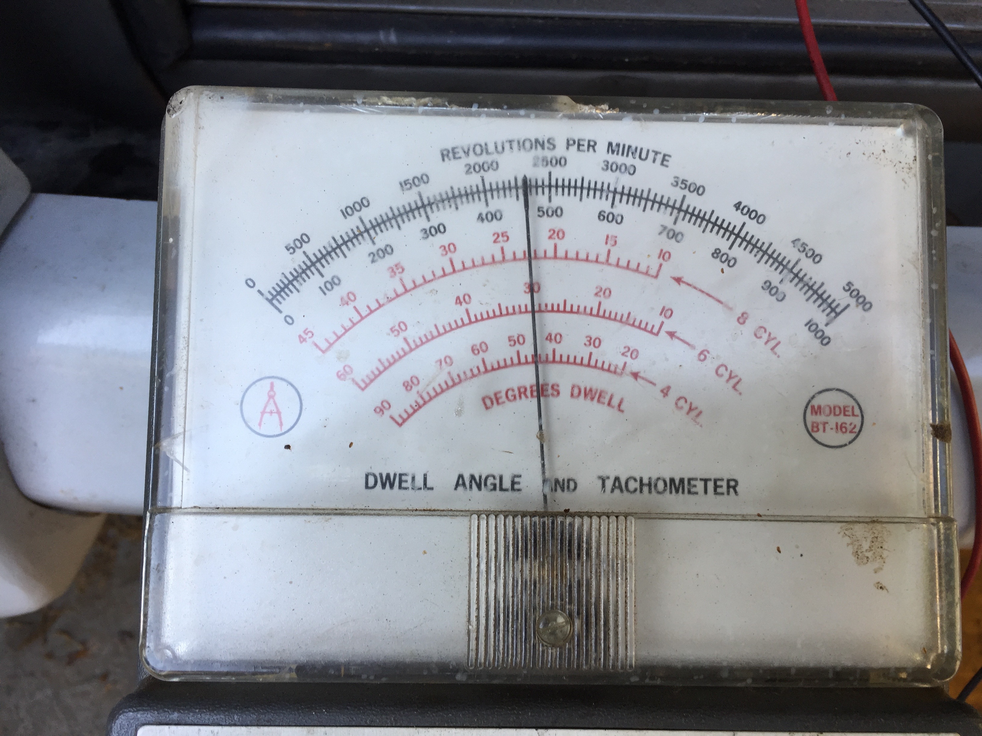

I checked the valves today and the adjustment at 006 was good. Dwell is at 41 so that could use a slight adjustment. Haven't messed with the timing yet or the carb setting. That will have to wait until later in the week. At least I'm back to starting, going and stopping.

As inept as I am as a mechanic, I find timing to be a comforting, relaxing, calming and stress releasing diversion. I still need to switch the idiot light wires, but for now the oil light is out and I've got the right fuel pressure. The valves are good and the points are now pretty good at 46 and the full advance comes in at 28-30 degrees at 3400rpm's. I run a vacuum only distrubutor. They run nice with the 30/31 carb. It still needs a good freeway run to see where the oil pressure is at at high heat, but it won't matter as I'll soon migrate to a 1600 once Bruce can evalute my pieces/parts. Here's my dwell
