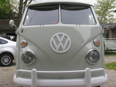

Took the Westy over today to the doctor for a nose job. Hope to have it done in time for the cruise on May 5th.
Craig
