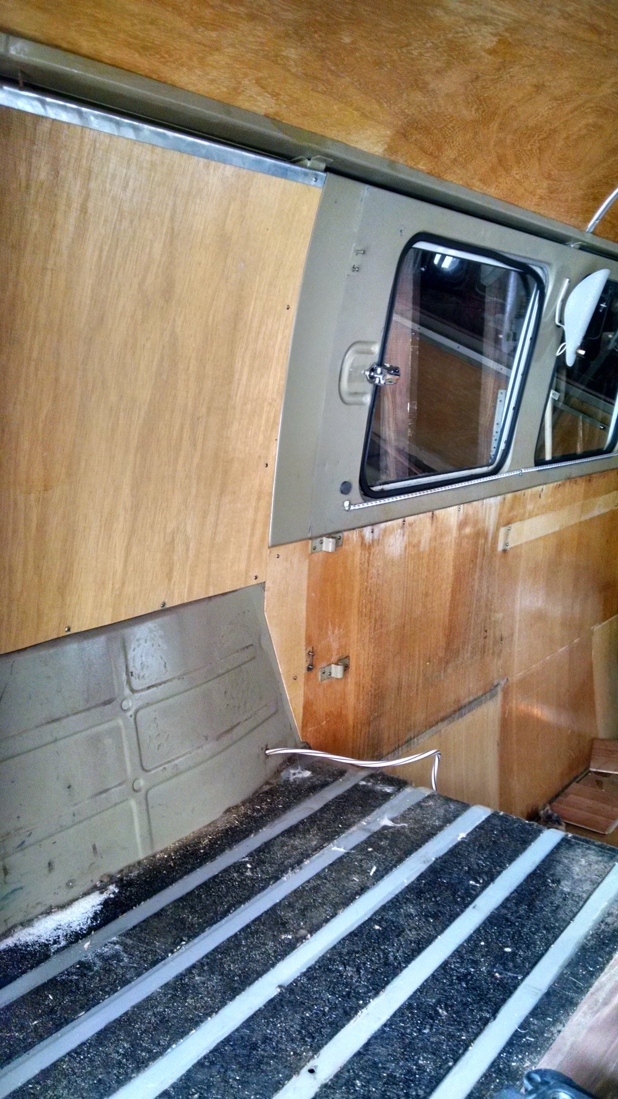

Empty bus... so much room! Notice color difference in clear coat where it is exposed and where it is concealed

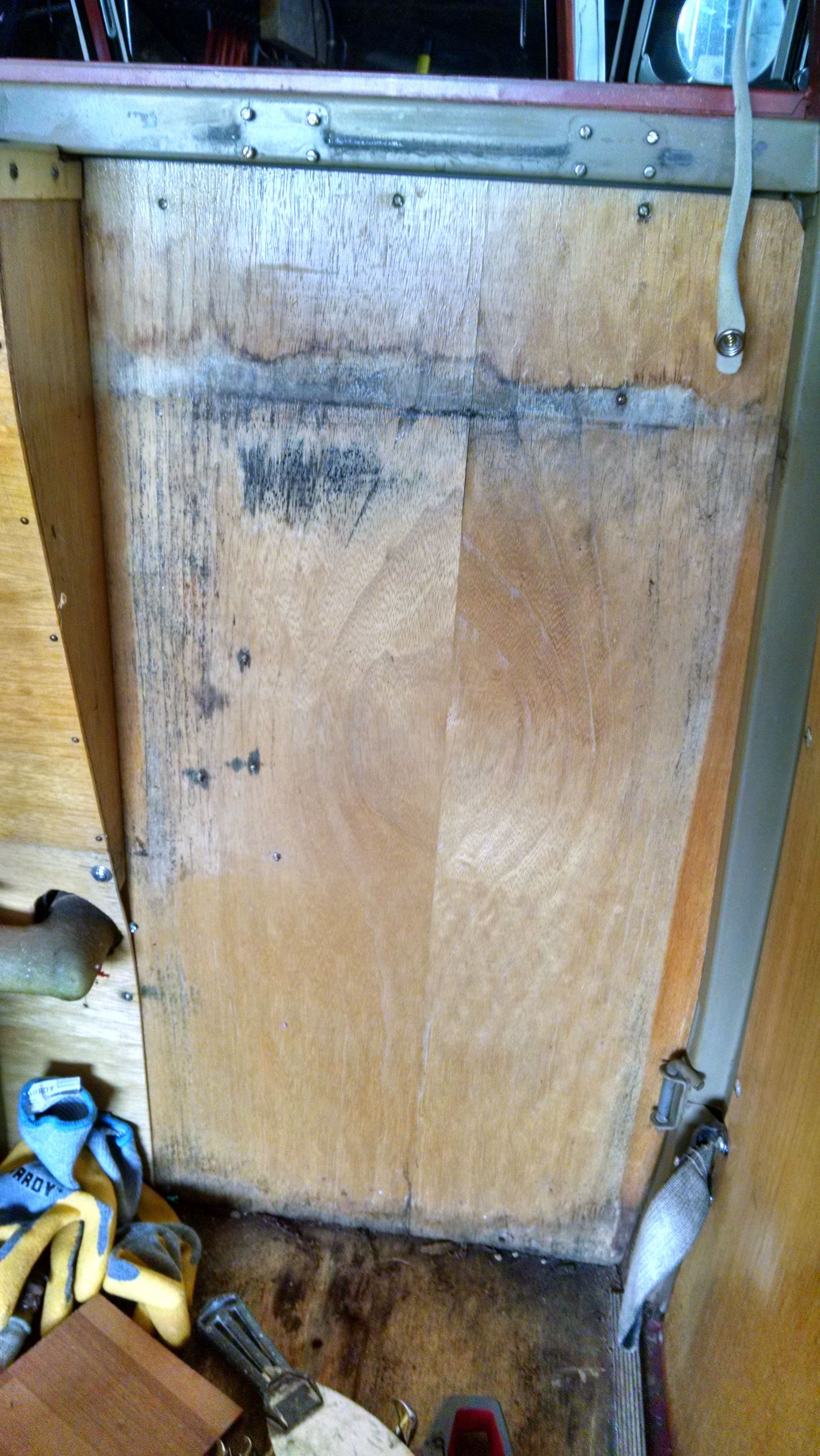

Behind the wash basin cabinet a lot of old mold and stains

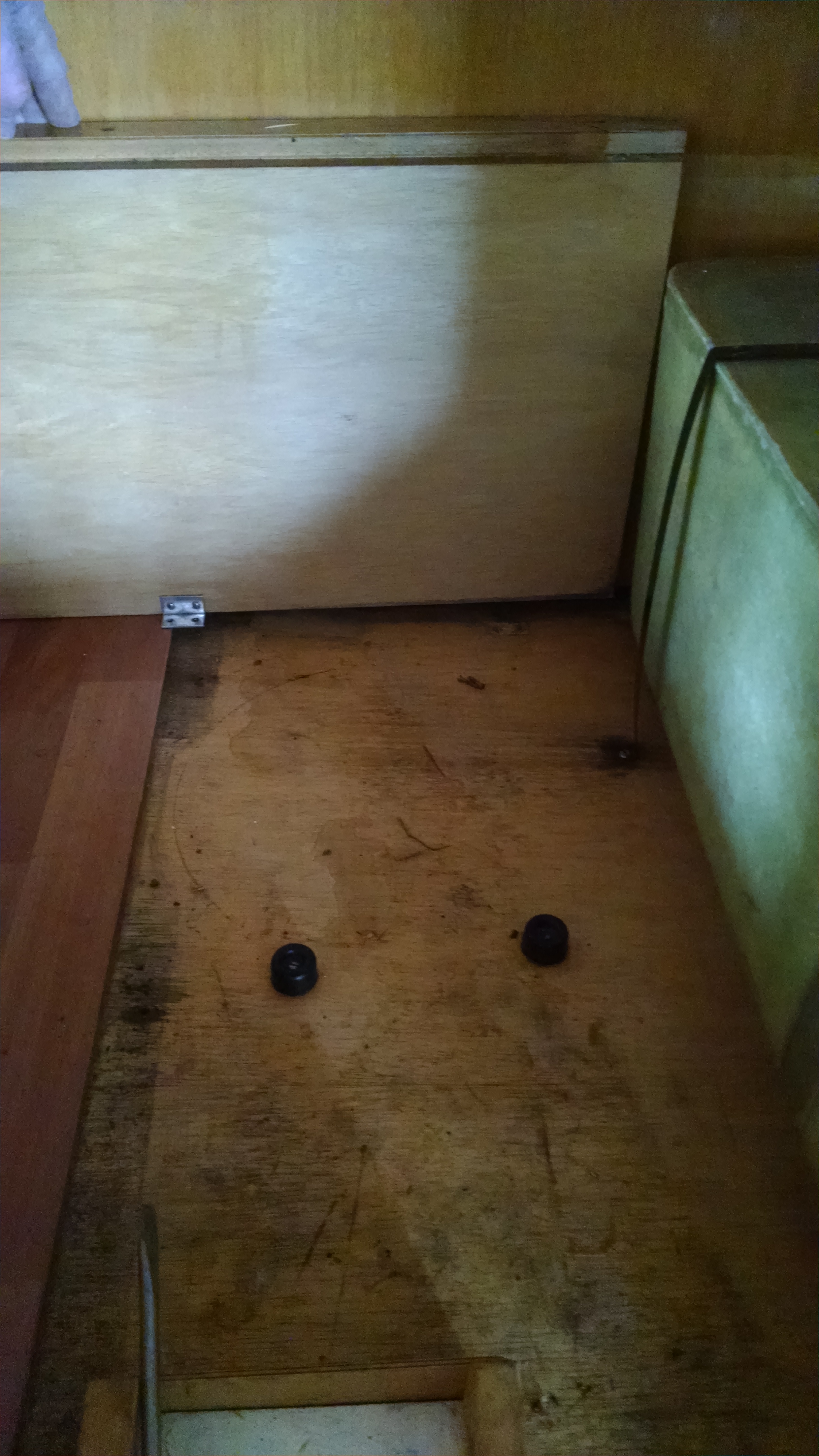

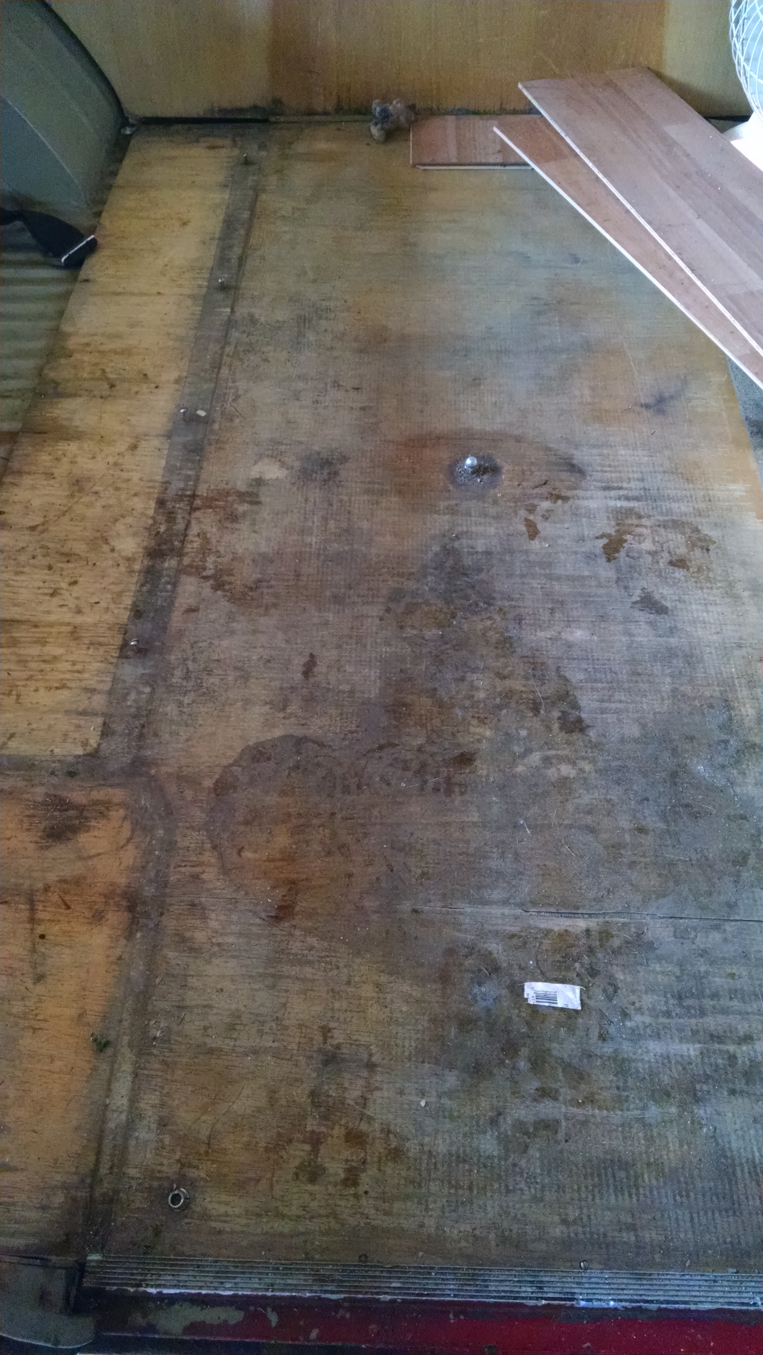

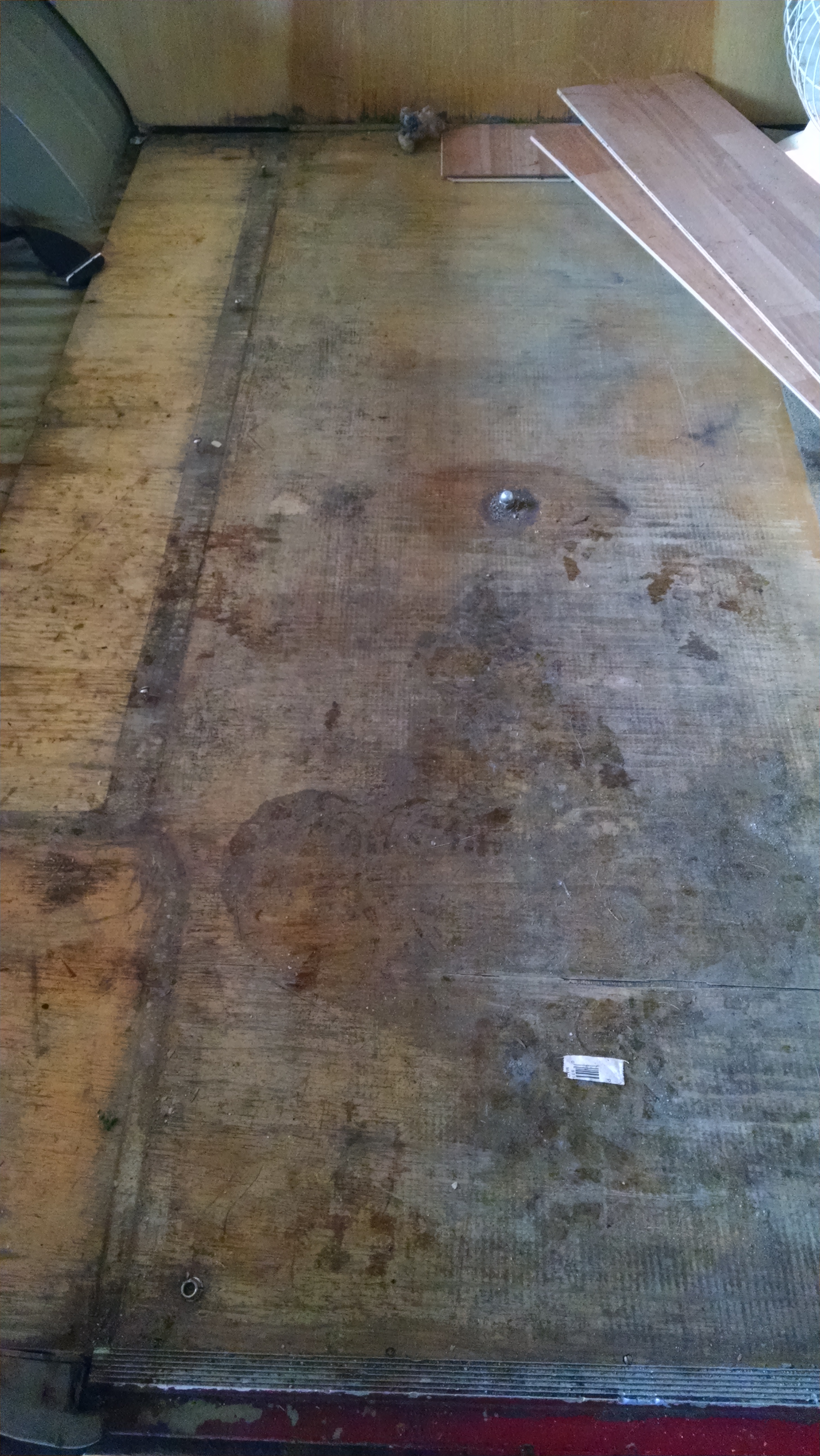

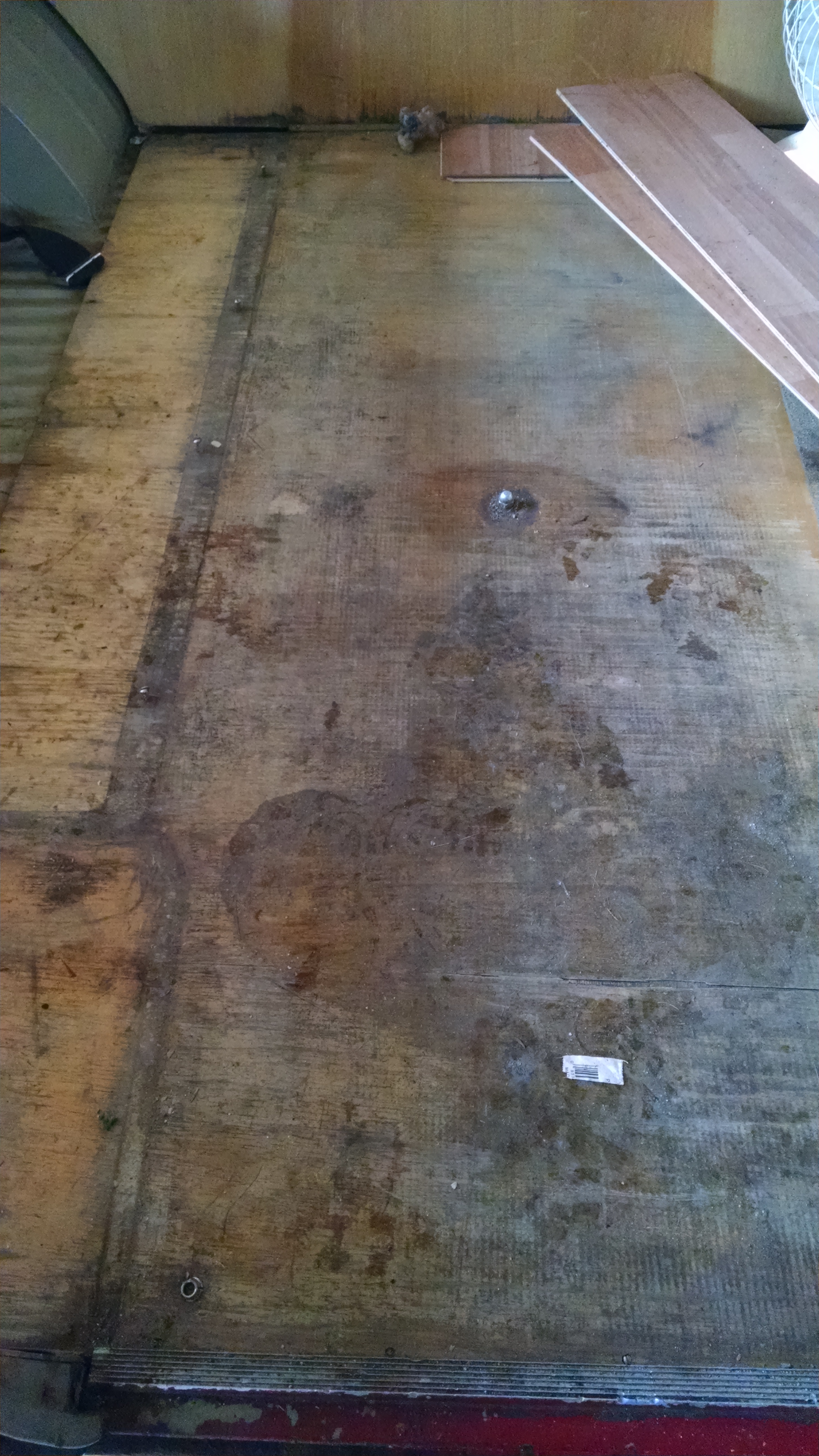

The original flooring still in tact and not in awful shape. i think I can get it looking nice again. I will tackle that when I get to rest of the interior panels.

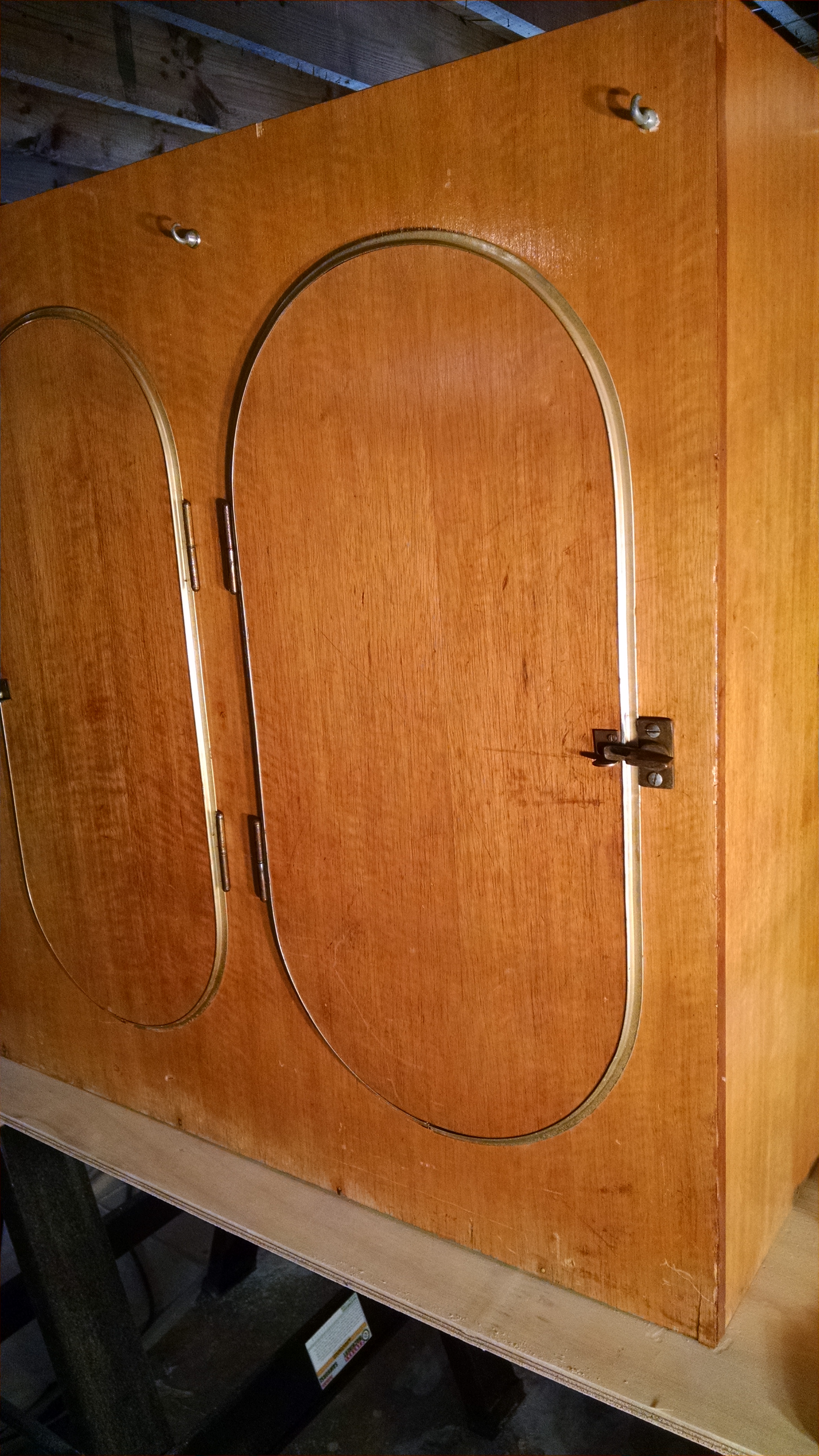

Cabinets staged and waiting to be done
You can see the difference in color. With the clear coat and natural wood.

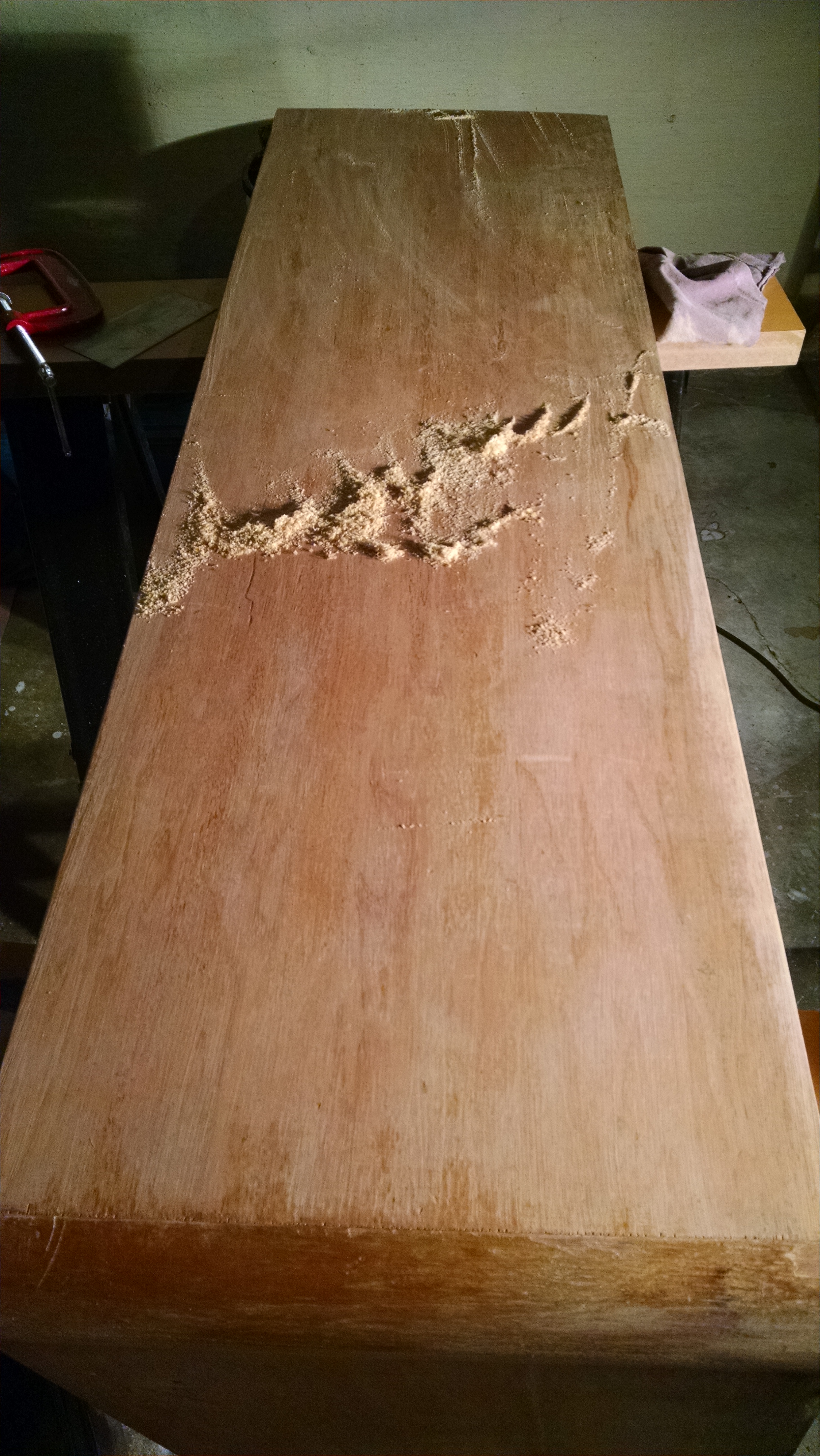

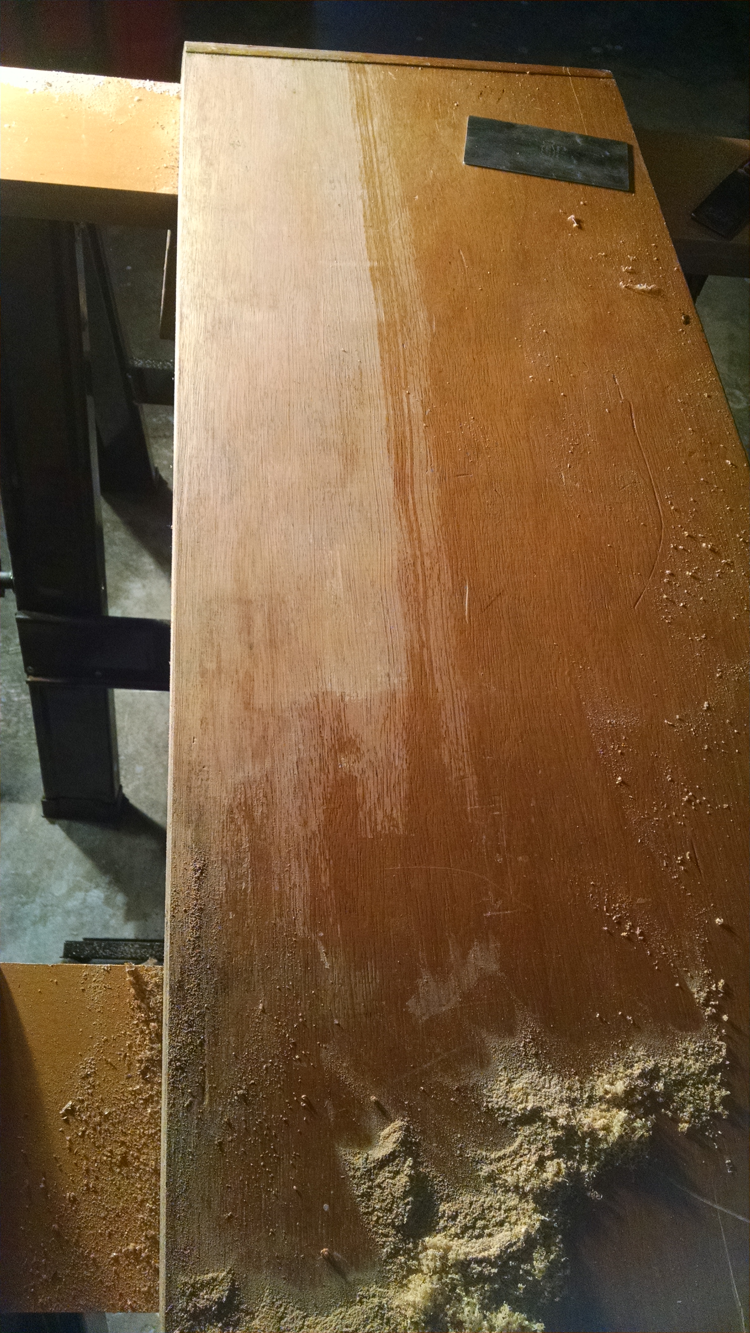

Front face of rear seat base stripped

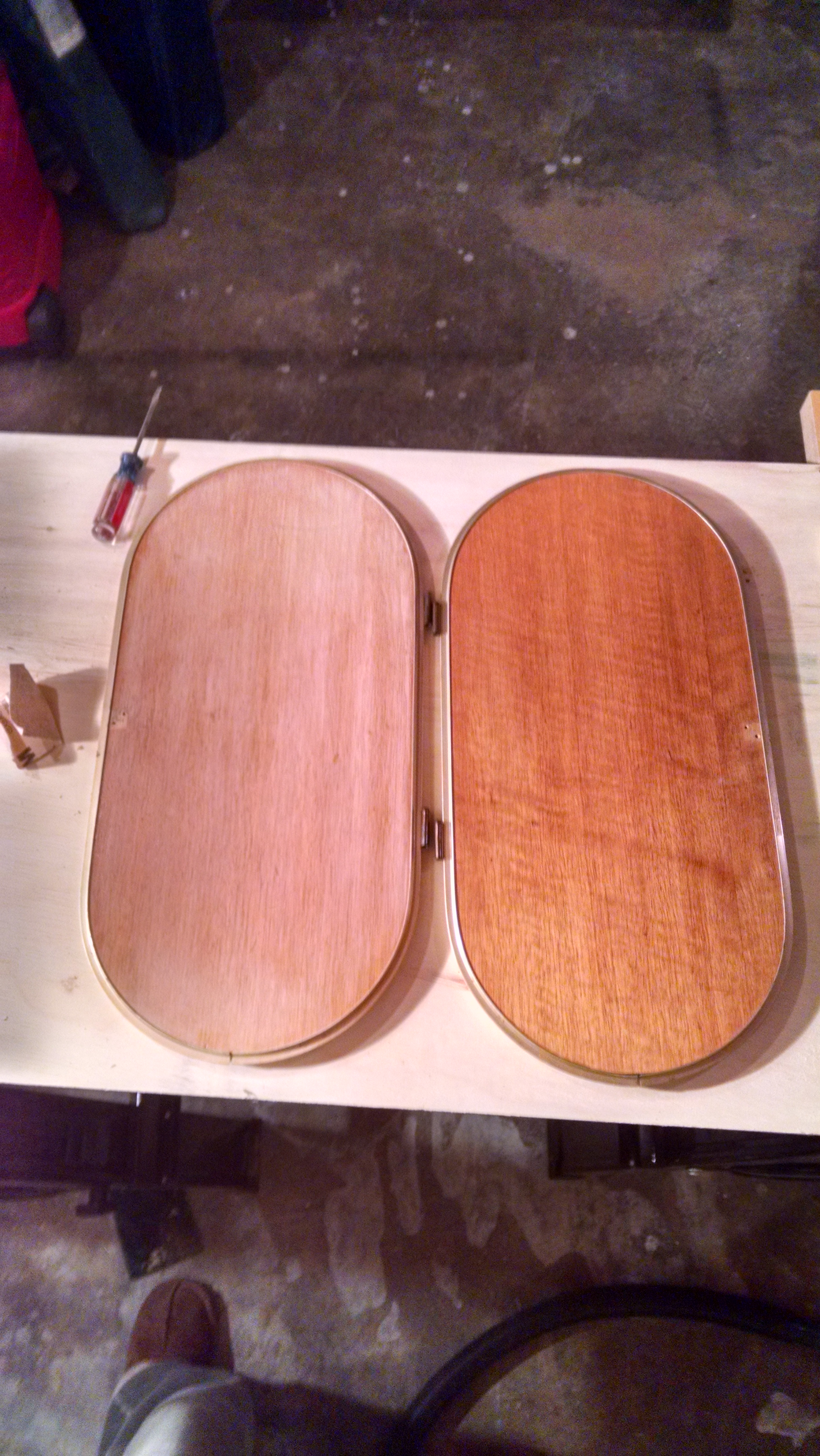

Cabinet Door One on Right = Before one on Left = After

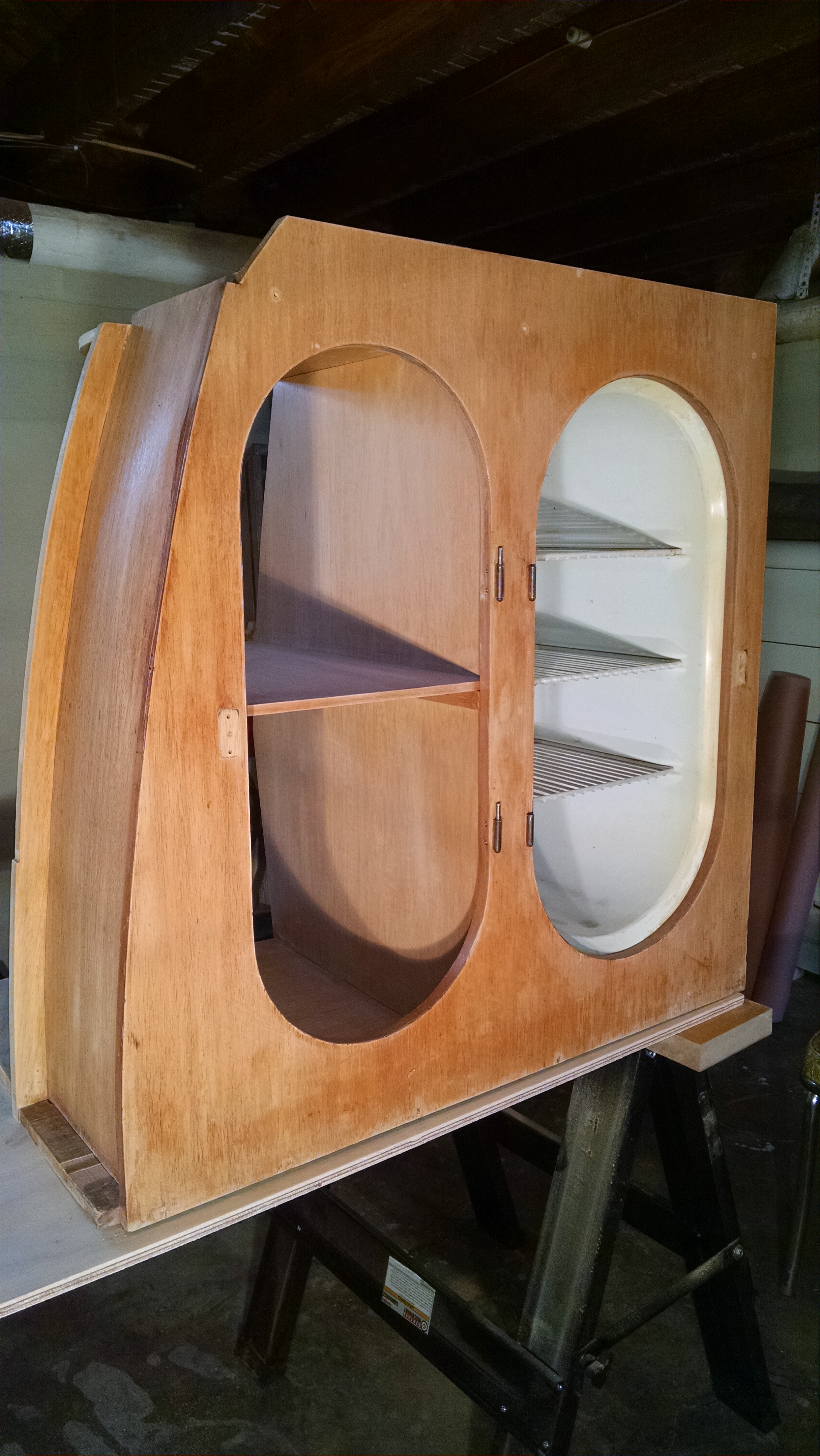

Ice Box Cabinet stripped
