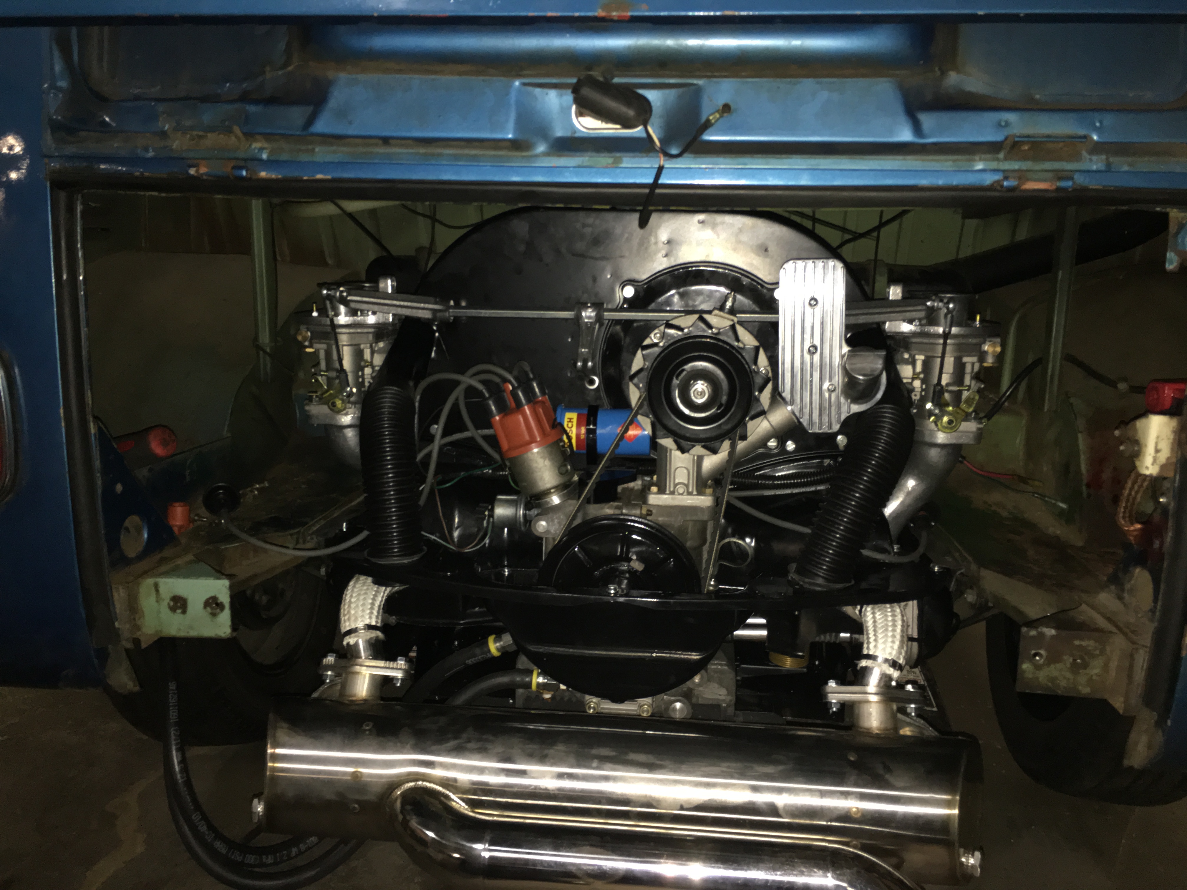

Great job Rick!
Great job Rick! And cudos to Chuck for all his handiwork!

That looks awesome! Looking forward to hearing it run.

Wow Rick, that engine looks like a showroom piece! You should encase it in a glass box so it doesn't get dirty :D

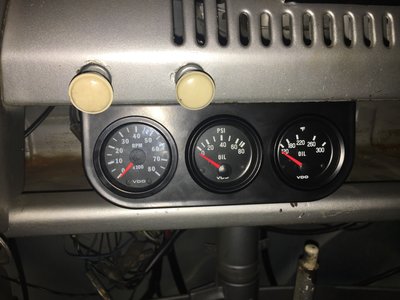

Been busy prepping the bus for the motor. I started by running a 6 wire cable from front to back of the bus. The safety fuel pump relay needed 2 wires, and the gauges needed 3 wires so the cable worked out great. I wired up the relay and I installed the 3 gauge cluster with a mini tach, oil pressure, and oil temp gauges. The gauges fit nicely between the bottom of the dash and the parcel tray. I used the mounts for the headlight and hazard light switches to hold the cluster up and only had to drill 1 little hole. Then in the back I mounted up the Carter rotary electric fuel pump with some rubber isolators. I put the pump on top of the transmisson and as close to the fuel tap as I could. These pump dont really pull fuel like a stock mechanical pump does. They just push fuel so they need to be mounted close to the tank.
VDO Gauge cluster
VDO Gauge cluster
