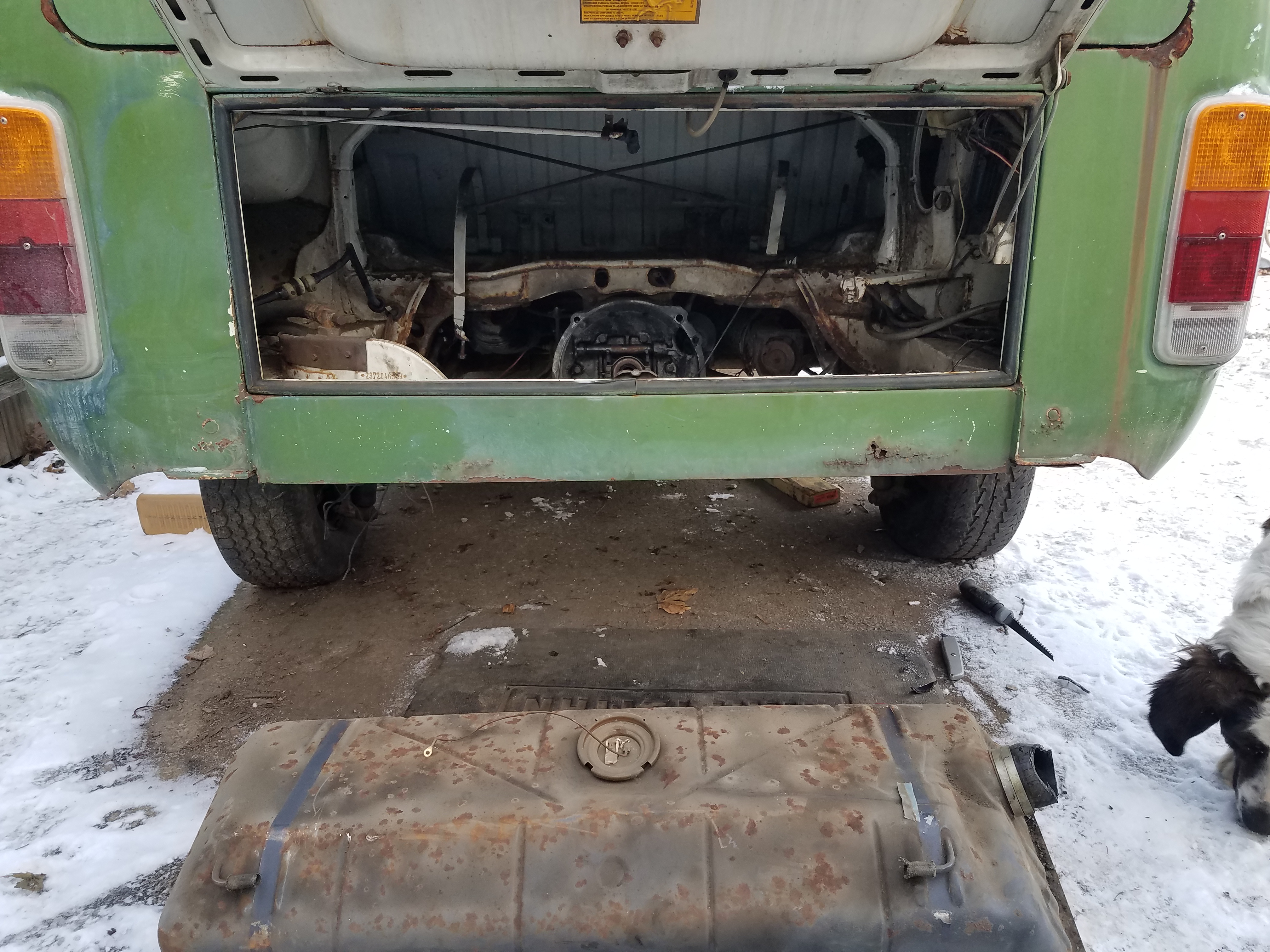

Cut it. Replace with a tank to neck hose off of a Dodge Sprinter van, about $15 and good for today's fuel blends.Kooper271 wrote: Mon Feb 06, 2017 12:25 pm
Having a really tough time getting the gas tank out, the filler hose coming off the tank is stuck
I don't know the size ID you need, but Napa and FLAPS sell fuel filler neck hose in various diameters.

Thank you for the tips on the fuel filler neck. I will have to get in there with a utility knife, the cut off wheel I tried didn't work.

Made some progress today.
Removed the gas tank. Looks really clean inside, minimal rusting and no sludge.

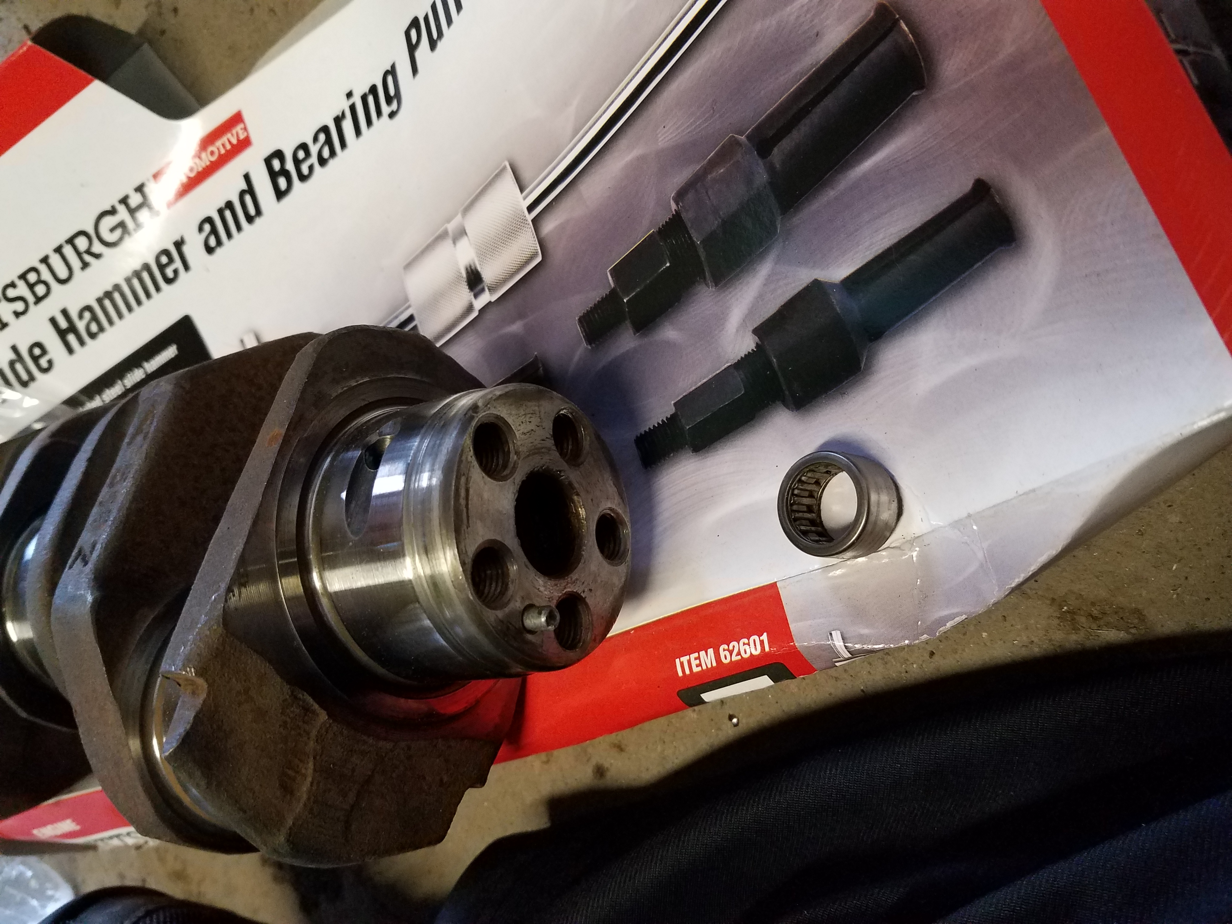

Bought a slide hammer/bearing puller kit from Harbor Freight and pulled the pilot bearing out of the end of the crankshaft

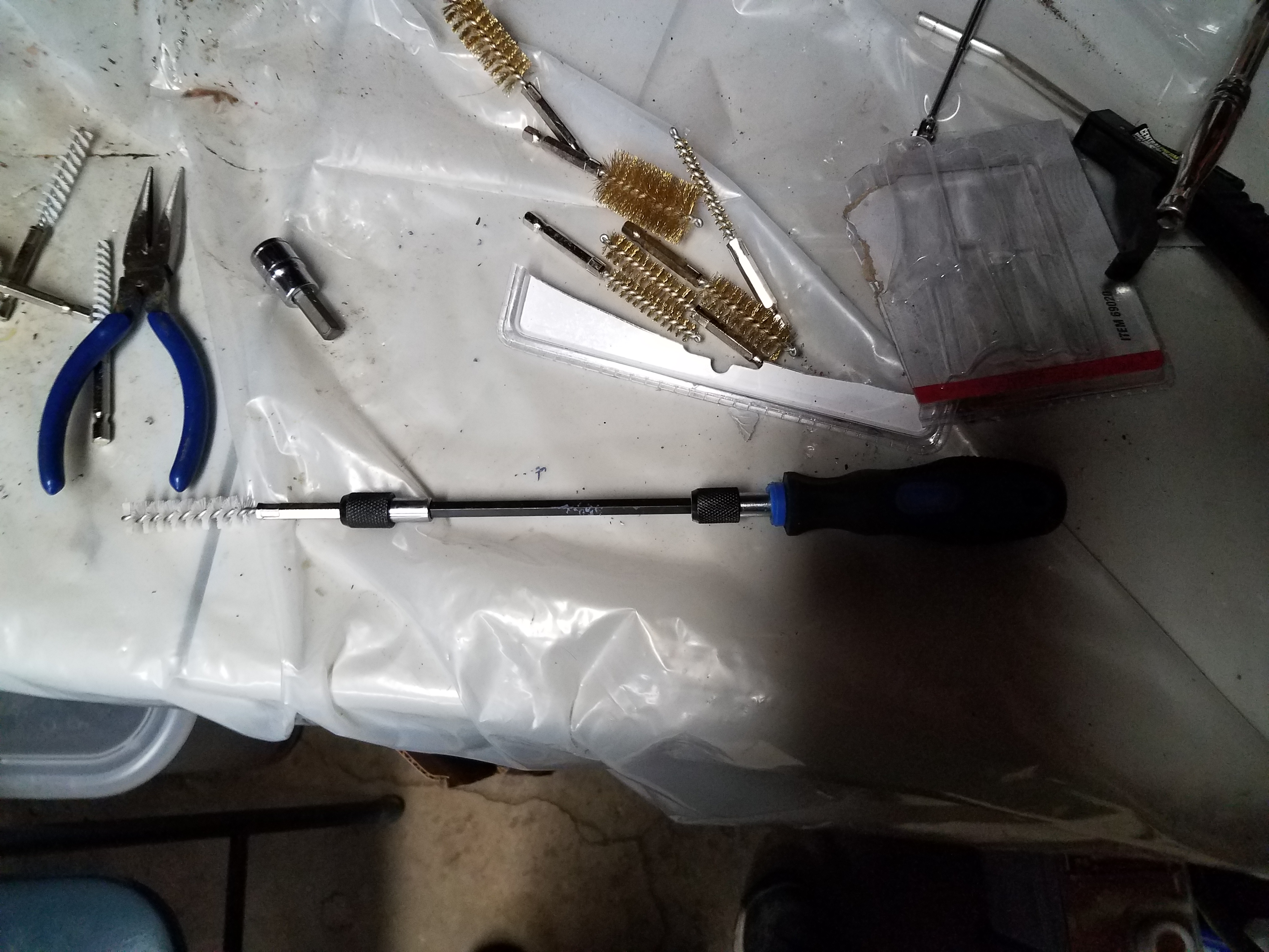

Used nylon brushes in this brush kit (also from HF) to clean out the oil gallerys

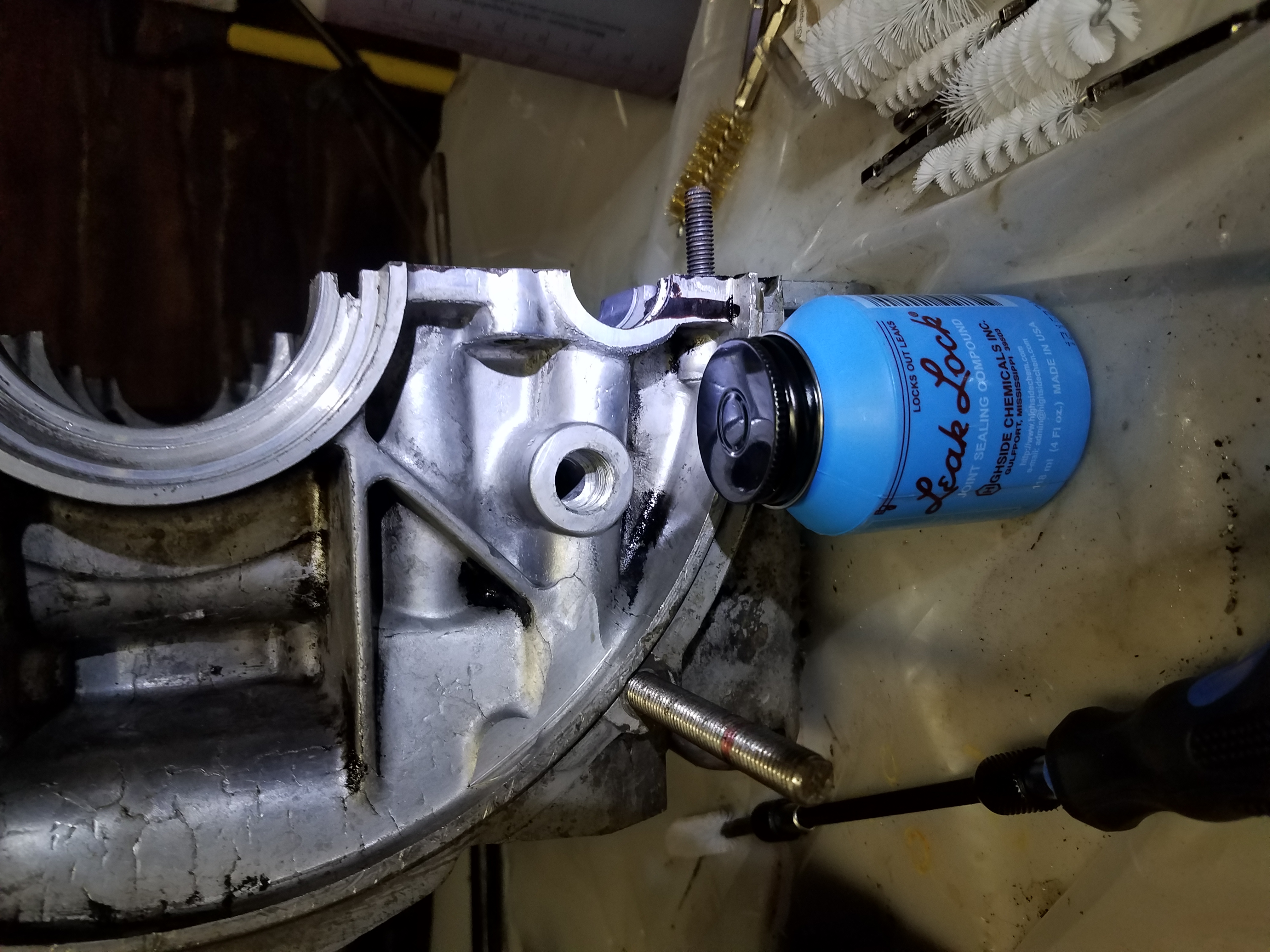

Sealed all the oil gallery plugs with Leak Lock.
Cleaned up the case some more.
