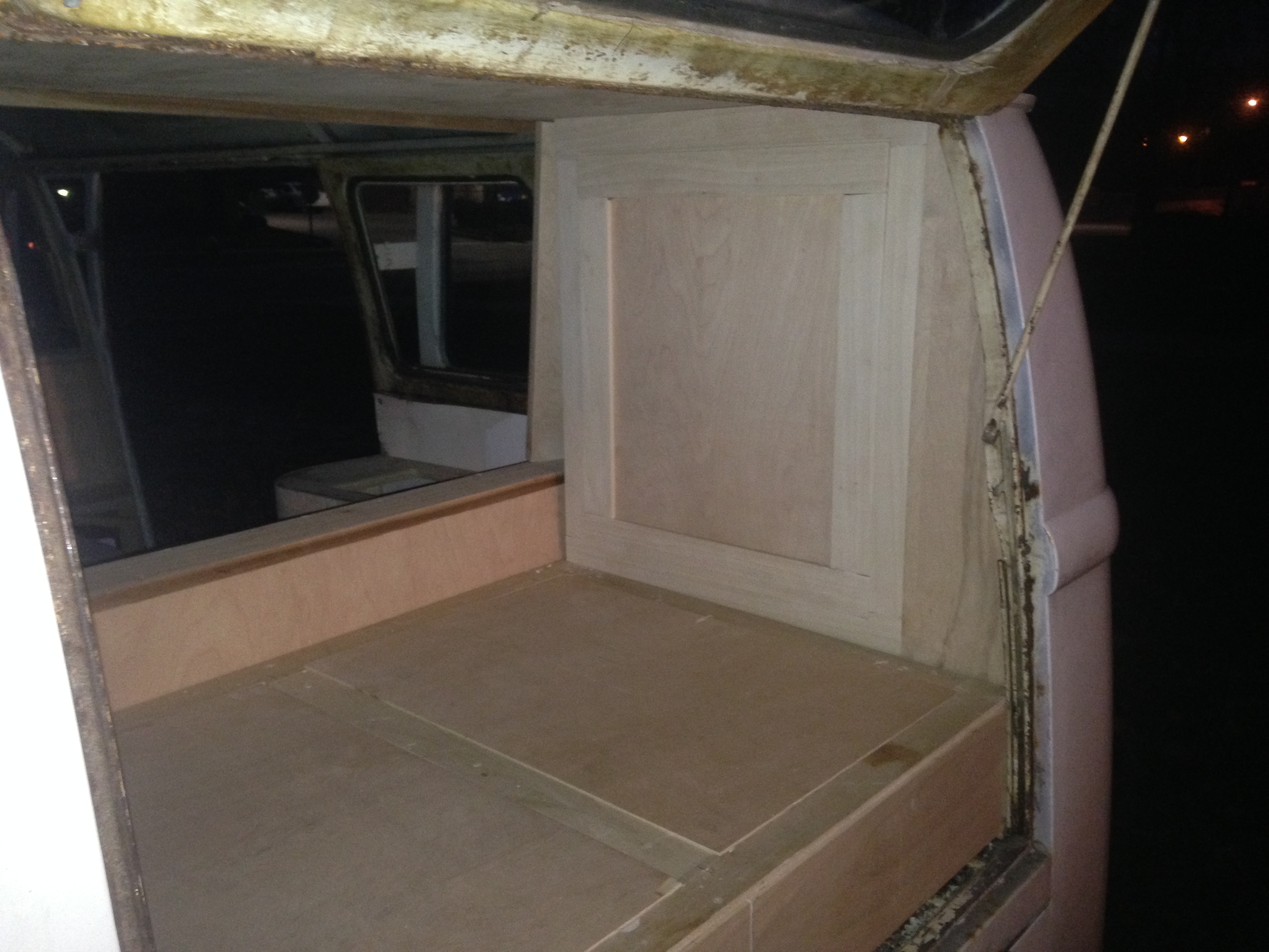

Looking good Mike!
Is that the kegerator cabinet?

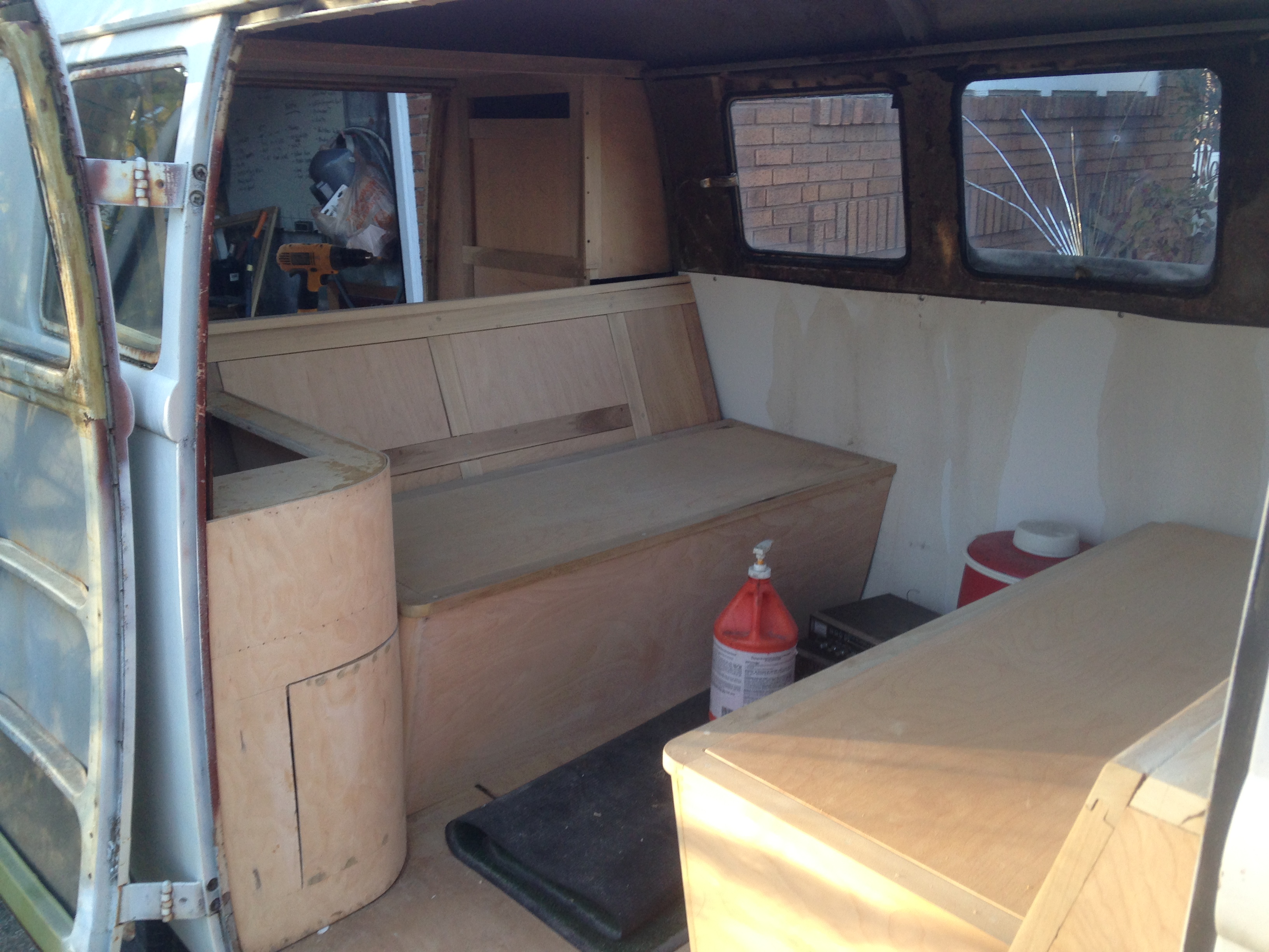

Nice wood work. What type of wood did you use for the wrap around section?
Re: 1961 Microbus
Posted: Thu Nov 19, 2015 10:20 am
by Mike Kever Kombi
1/8" Baltic birch soaked in water over night, then glued and layered.
