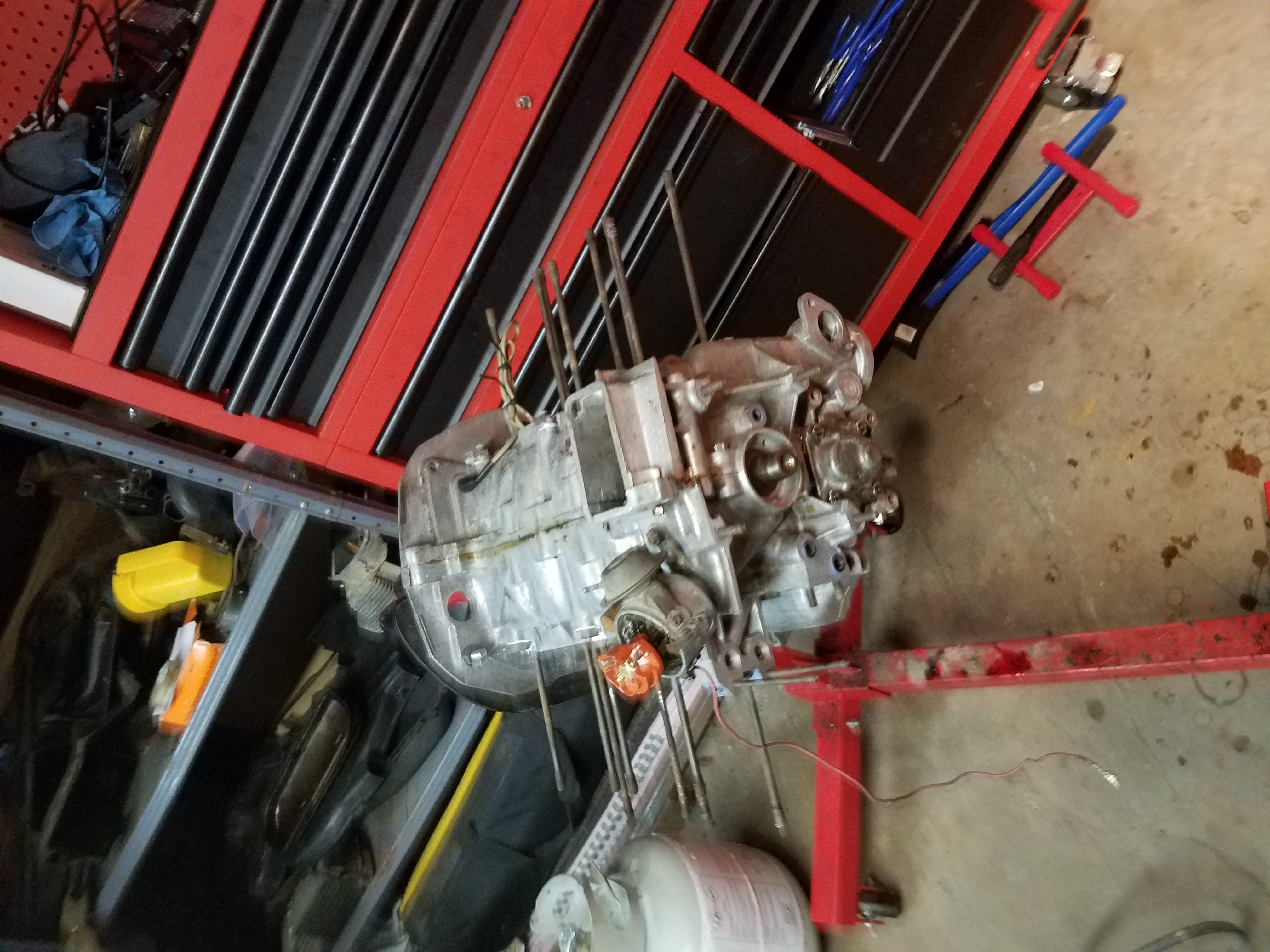

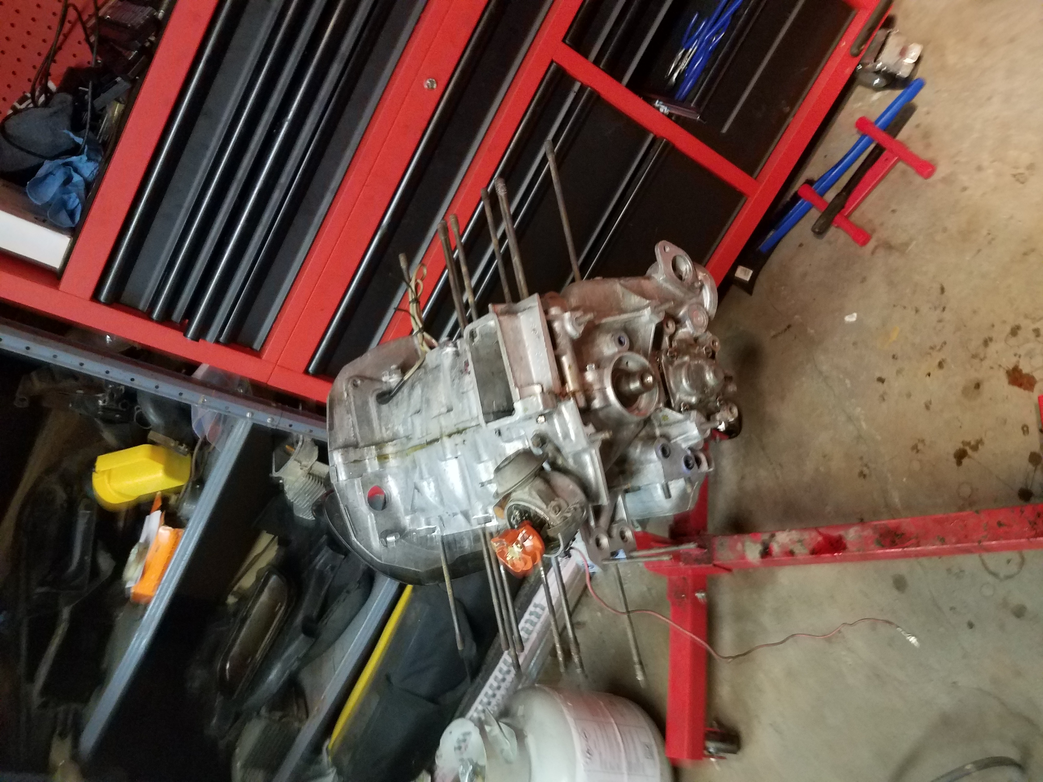

Starting to look like an engine... hope to get the heads on tonight
Got 1 piston installed. Deck height measured .018" so with no shims I will be at ~7.8:1 compression. I am kind of confused on how my deck height is so low, though. I don't think I could have messed it up, I used feeler gauges and a machinist's edge
I think a cheap digital caliper may be more accurate than the feeler gauges.
Double check and then check again .018 does not seem correct.
Also,another hint. Polish the snout of the fan hub where it protrudes thru the seal and wipe a thin film of assembly lube or oil on the snout.
Also,if you consistently get .018 for deck HT and your are certain that that is correct,you will need to shim the cylinders at the case. What did you end up with for head cc? I have a feeling there is something wrong with a measurement somewhere.
I measured 59cc for the head. I used 69cc in the calculation because the dished pistons are ~10cc.

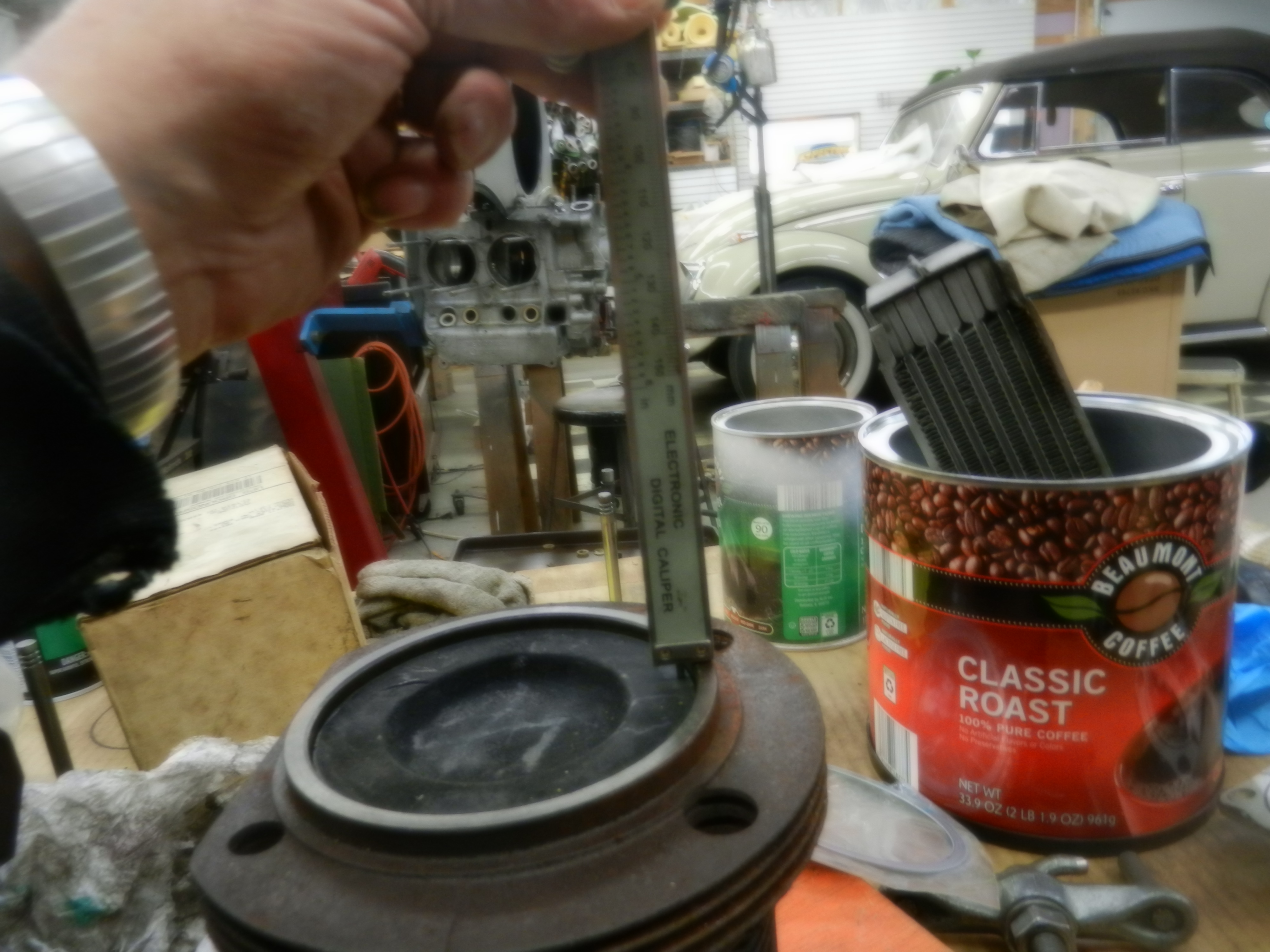

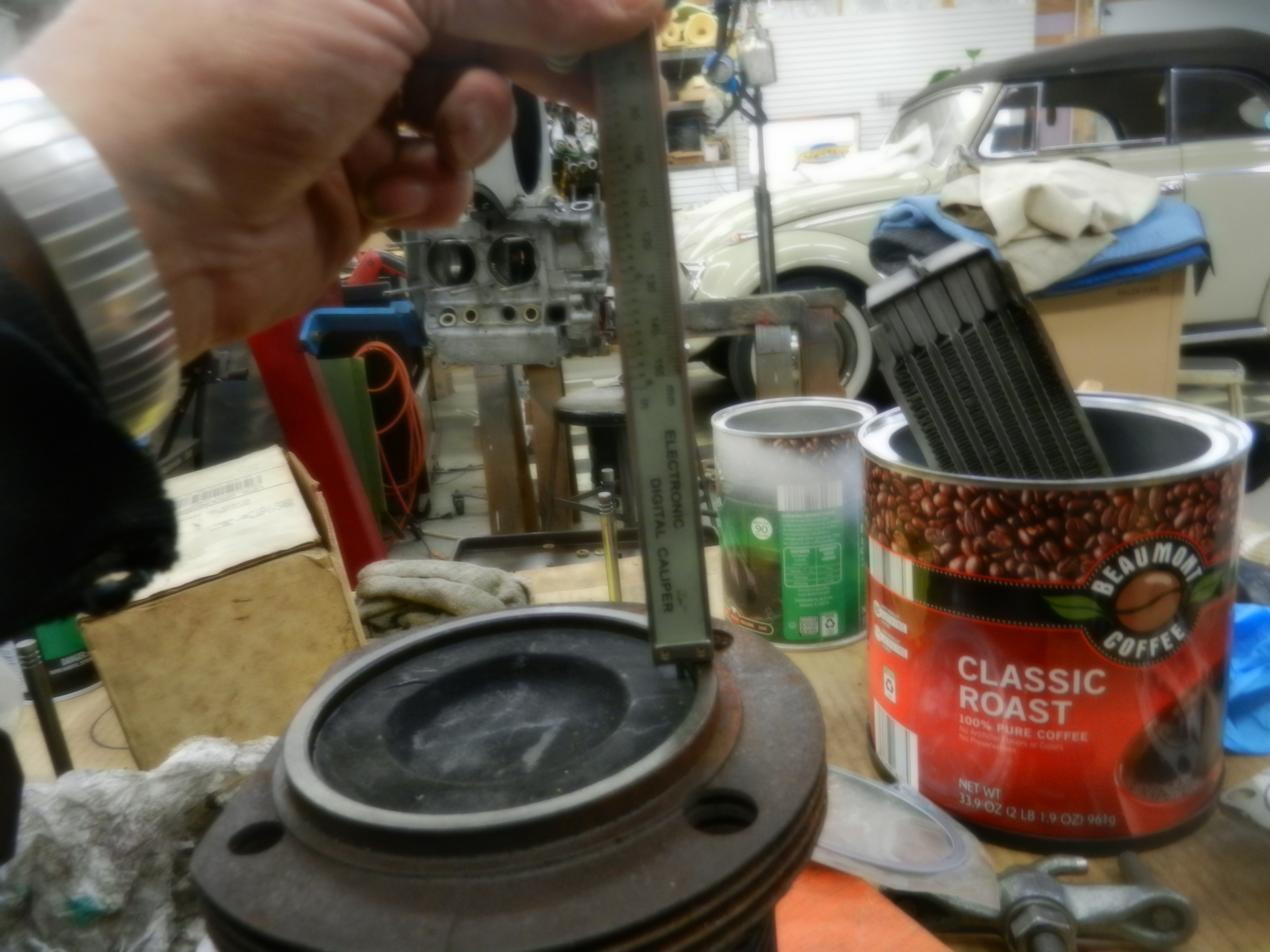

Here's what I came up with. Try measuring your deck ht with the digital calipers like this. This should confirm or correct your deck ht. measurement.
Now it gets a little confusing.
Ratwell claims the step in the AMC heads is .080. But I noticed he is using metric scale, but that would be .031in.I don't have a stepped head to measure,but you can,using the same method for measuring deck ht. Measure it.
That would make your actual deck ht. .018 + .031 = .049 which is ok.
If I measure the spacer that the AMC step is replacing, I get .030 so we're close.
You have already taken into your formula the volume of the step.when you cc'd the head. SO,I am sorry for the confusion. Damn stepped heads.
I am assuming,and will verify with Jonathan at AA,that their pistons are a bit taller to compensate for the step in the AMC heads.
That's why I would prefer machining the step out of the AMC head and setting the DESIRED deck ht with shims at the cylinder base. But that is more of an anal blueprinting issue.
I think you are going to be just fine.
