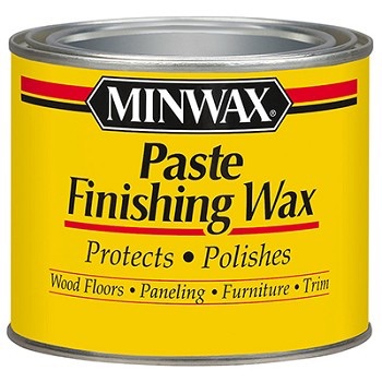

obsoleteman wrote:If it is not just sitting on the surface (and toxic plastic), can it really protect the wood?
Well...Probably...yes... The Minwax will make a deep protective bond. And yes, My grandmother would have used it (but are we old enough to not be embarrassed by that fact ?).
I do not think anyone is embarrassed about waxing their wood, hence the lengthy discussion.
obsoleteman wrote: "Stabilize, protect and preserve"...I think it will be a sound choice(and besides, you will have my Grandmothers approval).
It is very important to use the proper protection on your wood
