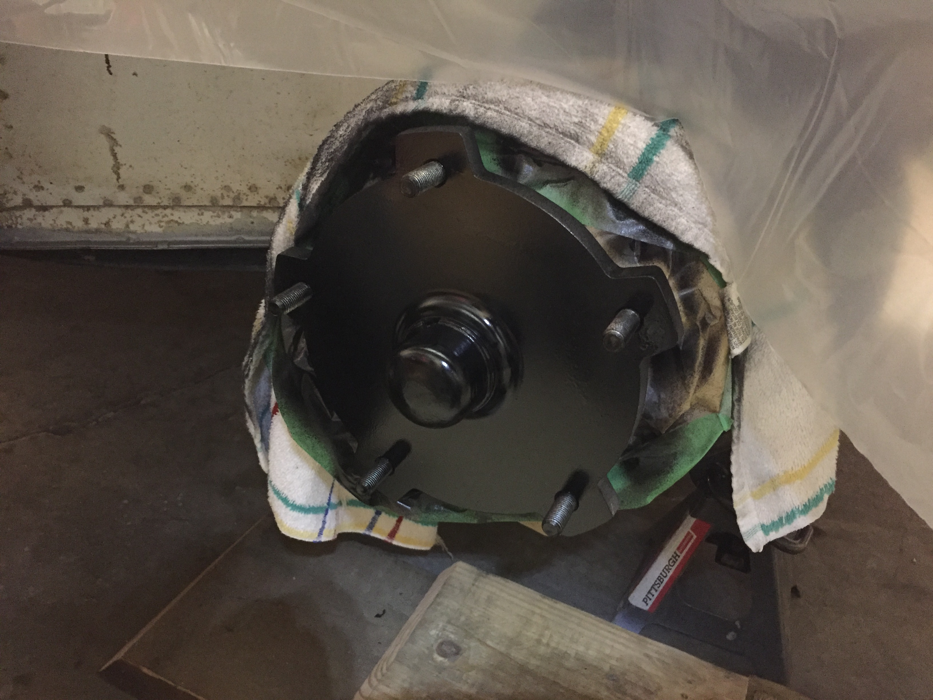

Keith brought me a disc brake setup to install on the ’66 Beetle.
At glance it looks pretty good- new spindles, calipers, brackets, a separate rotor/hub assy, bearings, hoses, dual MC, T3 reservoir, etc. Let’s see how it goes.
The cal mounts are symmetrical, not left and right.
First clean the paint from the spindles, I don’t want BJs and tie rod tapered ends riding in paint, they’ll loosen up. I have a large variety of wire brushes that I chuck up in a drill to clean nasty holes out.
Keith helped. (Really, he did!)
Drop the old spindles off,
Drive the bearing races into the rotor, pack the bearings, install the seals. One seal doesn’t want to cooperate.
Mount the spindles and rotors. What’s this wobble when I spin the rotor????
Let’s figure this one out- the rotor has .022” runout, not good. This will cause a low pedal, noise from the cal slides, but not pulsation like most people think. That’s caused by parallelism.

Runout on the hub is .010”, the problem is in the hub and the rotor is probably OK. I’ll let Keith take that off and send it back.

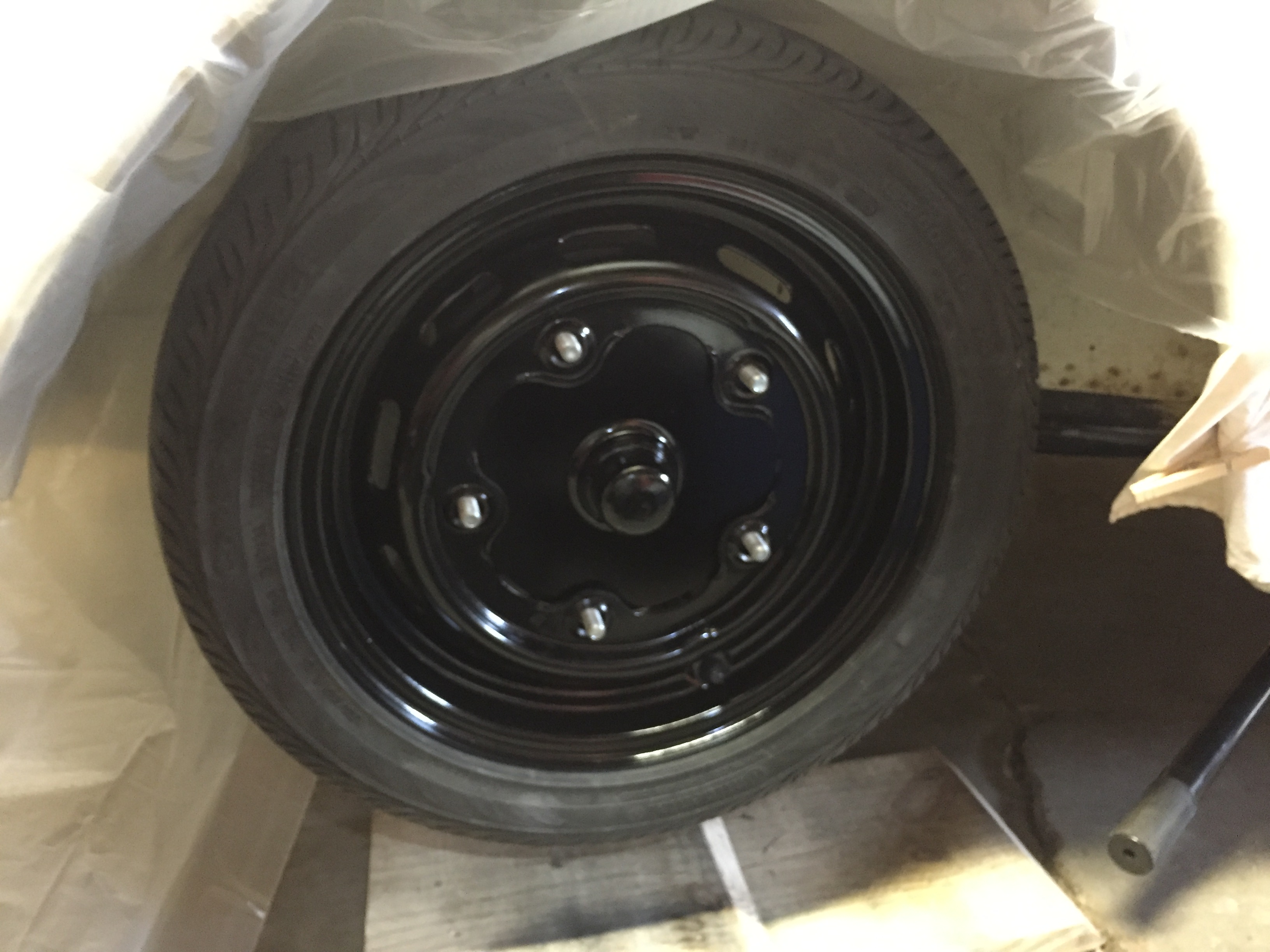

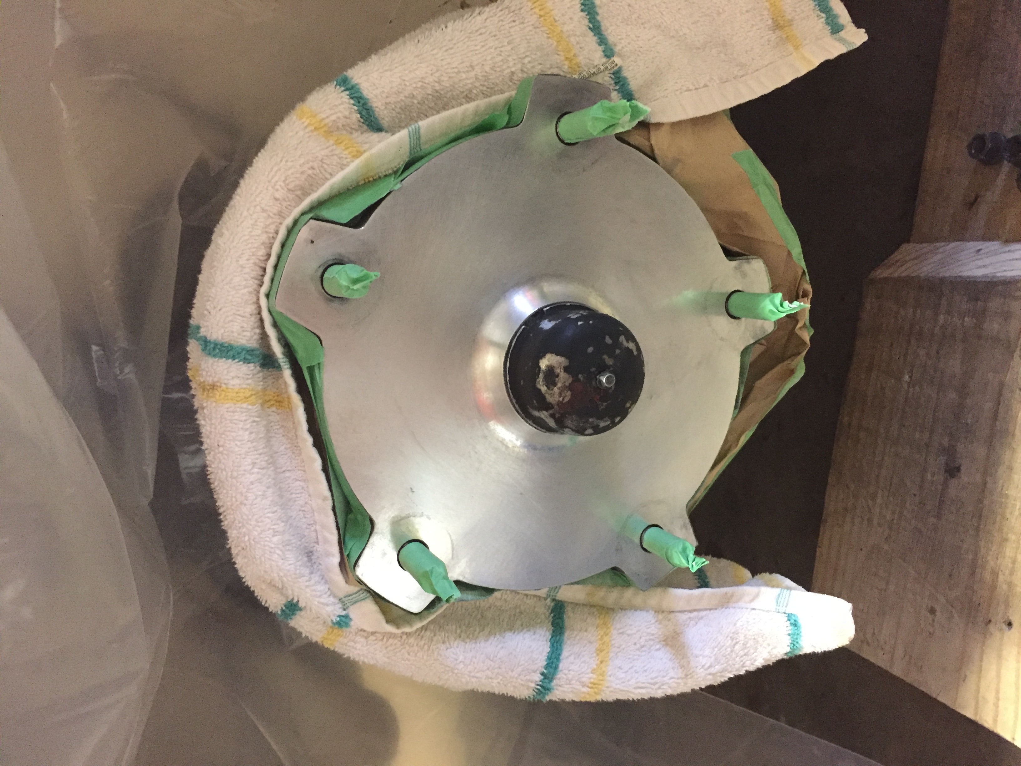

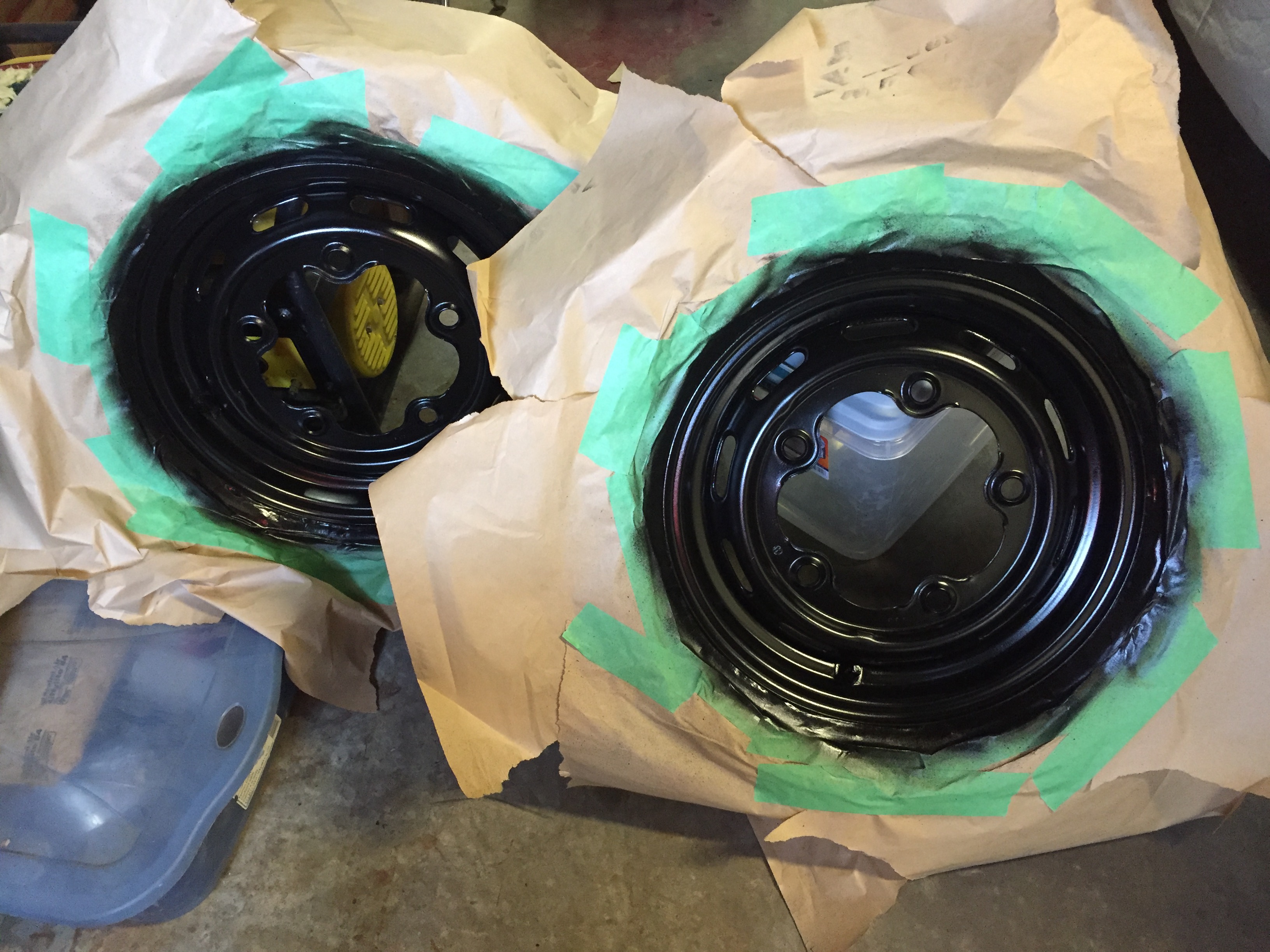

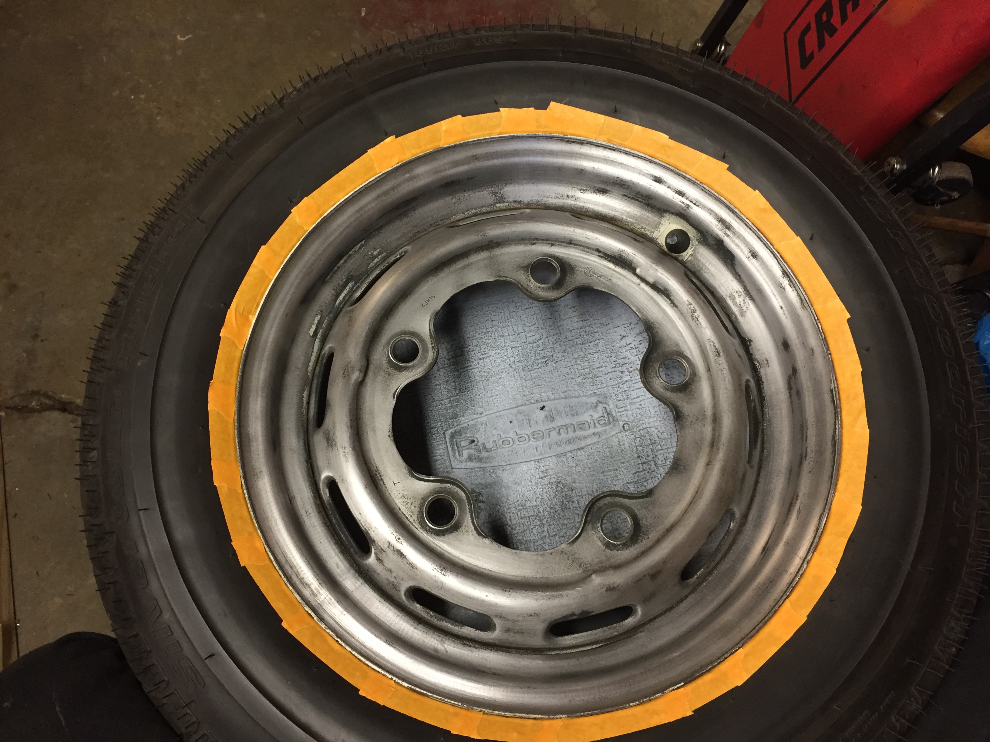

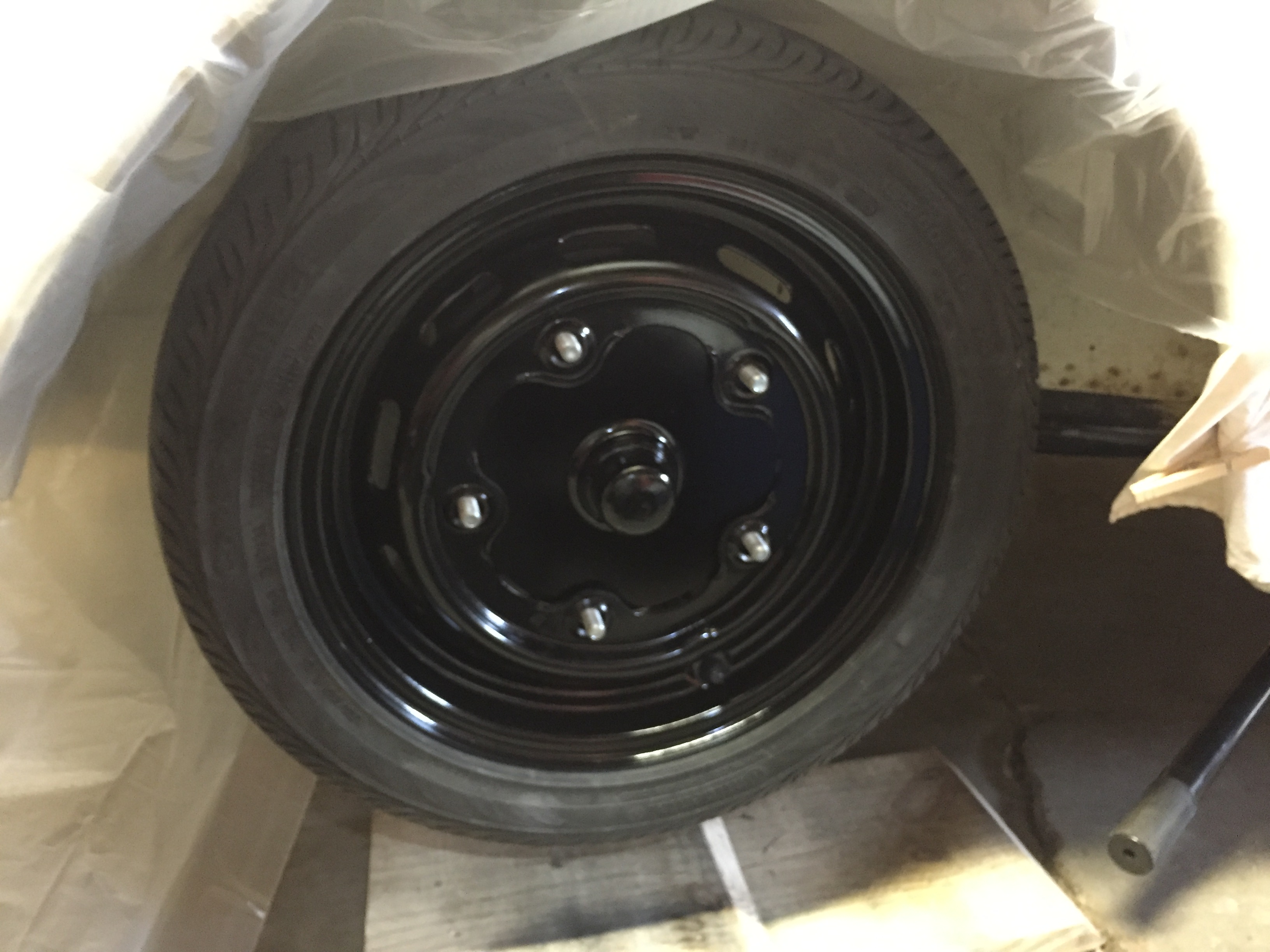

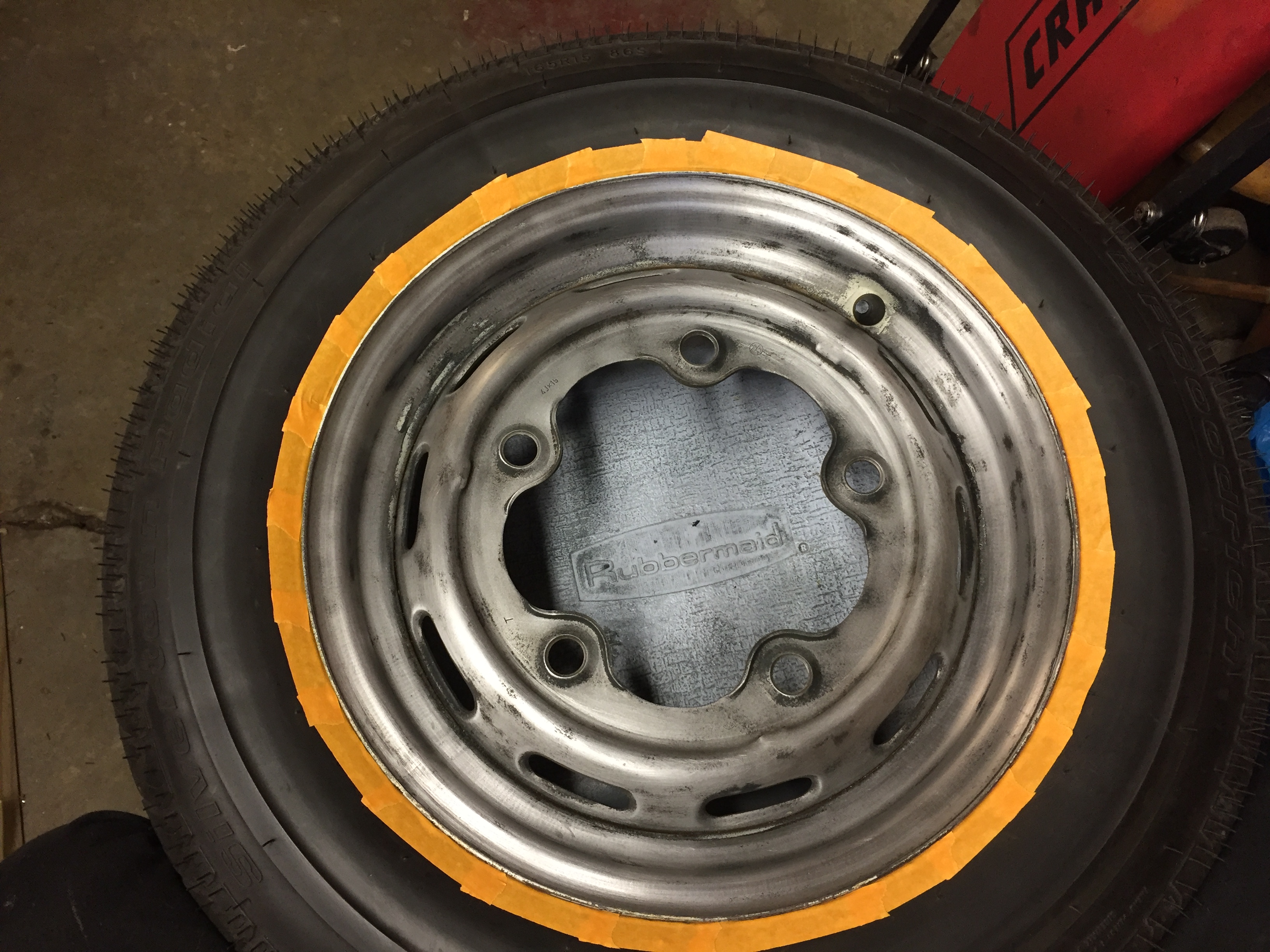

After Bruce installed the new CB Performance disc brake kit for the front, I decided that I wanted to find out what the car would look like with all black wheels. This is something I've struggled with because the wheels still had the original paint and I liked the way it looked. With new smoothie wheels on the wish list, I had been looking at what color to paint them. Now was a good time to figure that out and sacrifice the stock color or the original wheels. I have to say that I'm very happy with how they came out. Now the chrome hubcaps really stand out.
I prepped the wheels with a simple speed-blast gun from Eastwood using sand for the abrasive material. The old paint was gone in no time. I also used 220 grit to get the rest, then scotch brite to prep them for paint. I was not happy with the Eastwood primer paint at all. It didn't cover like I thought it should and took both cans back. I really think it was a bad batch. Two cans of Krylon gloss black and here they are. Two portable heaters in the garage to get the wheel surface somewhat warm on a frigid day in the garage. Since my garage barely fits the car, I covered the car with everything I could get my hands on to keep any overspray off. There was just enough room to set a wheel on the floor beside the car to paint. Plus a fan propped up at the doggie door on the garage door helped with ventilation. It actually works pretty well.
