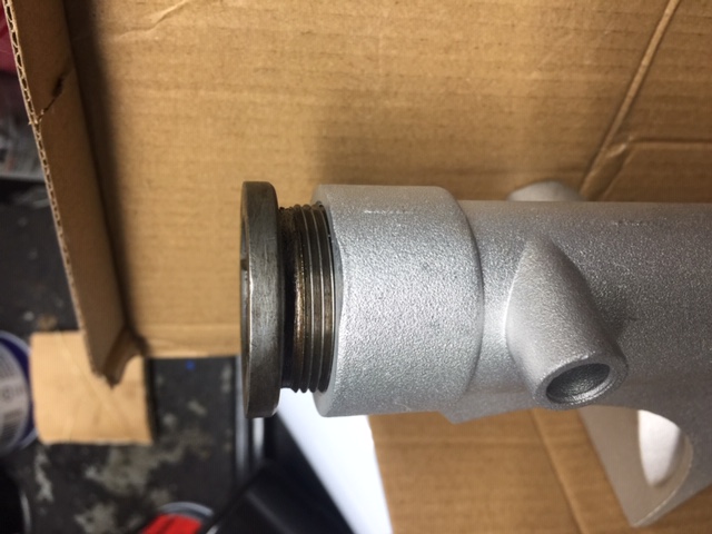

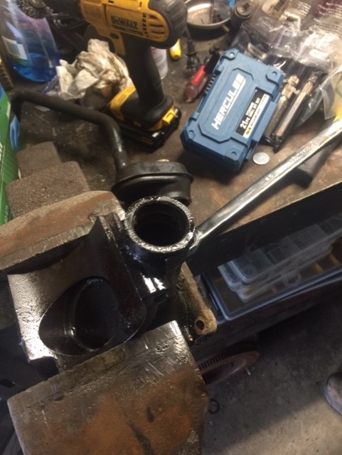

There is a cheap tool that fits the slots in that nut. But it is a POS and doesn't work. An internal pipe wrench is what works. I have one. stop out and we will get it off.
Re: Sean's '59 Panel
I used an old door hinge and notched the edges out so it fit in there, then used a crescent wrench to turn it out... Only worked on some of them, the others were destroyed trying :lol:

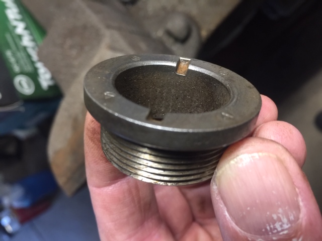

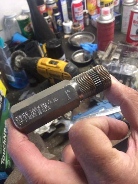

Chuck stopped by and brought me a present. In the course of his flea market excursions he came acoross a set of the plumber sockets that can be used to remove difficult attachemnts like oil filler nuts on gen/alt stands. He scored a set of four for a whopping $3. How does he find this stuff?
Anyway, he had the nut out in under 20 seconds and I was able to clean it up and its aperfect match for the new alt stand.

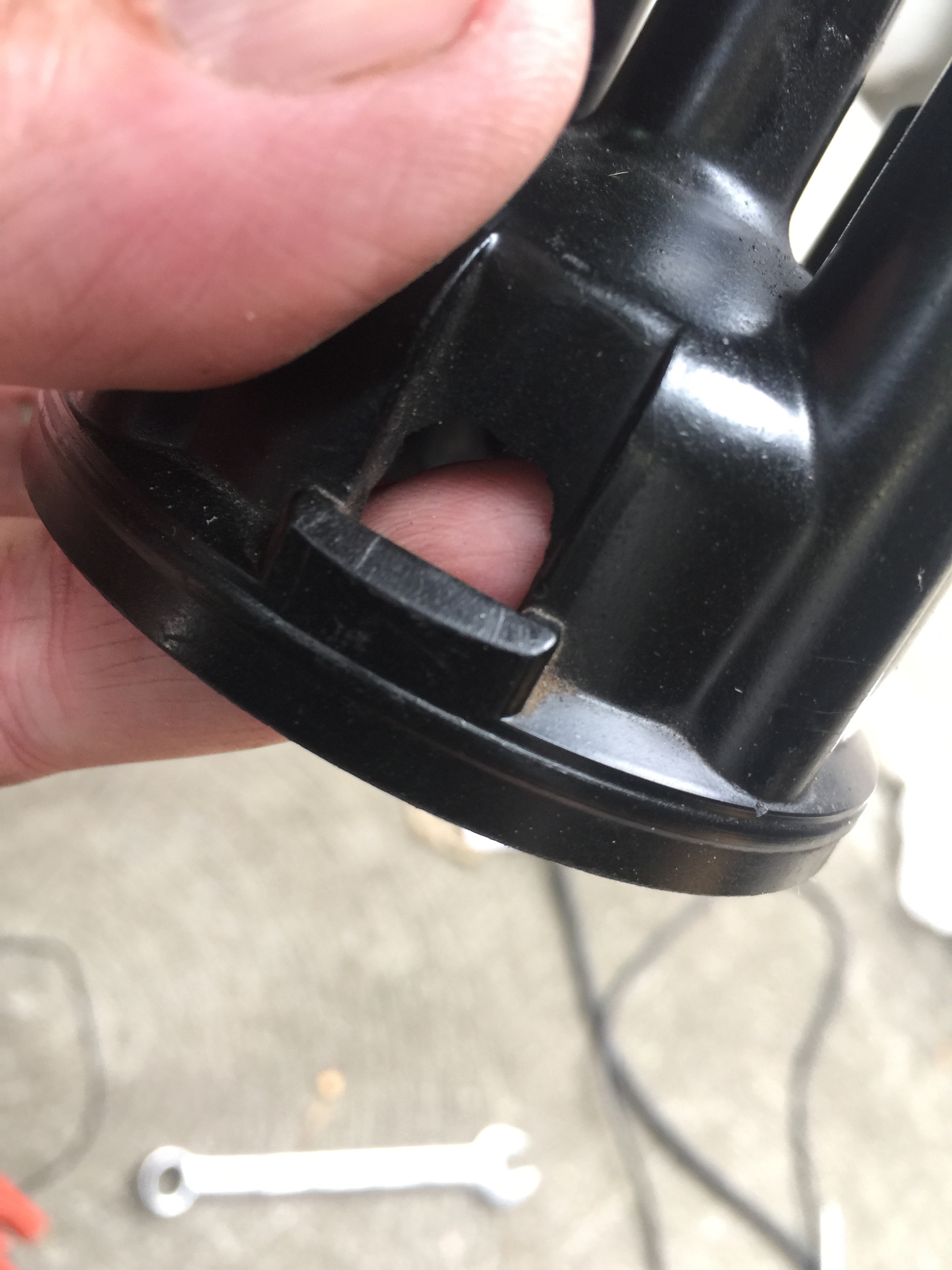

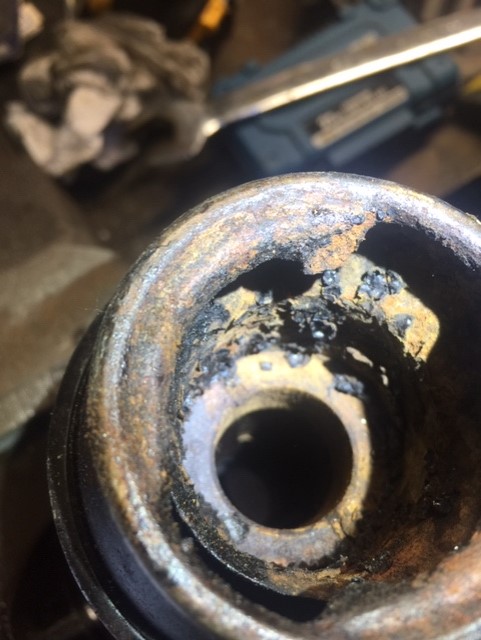

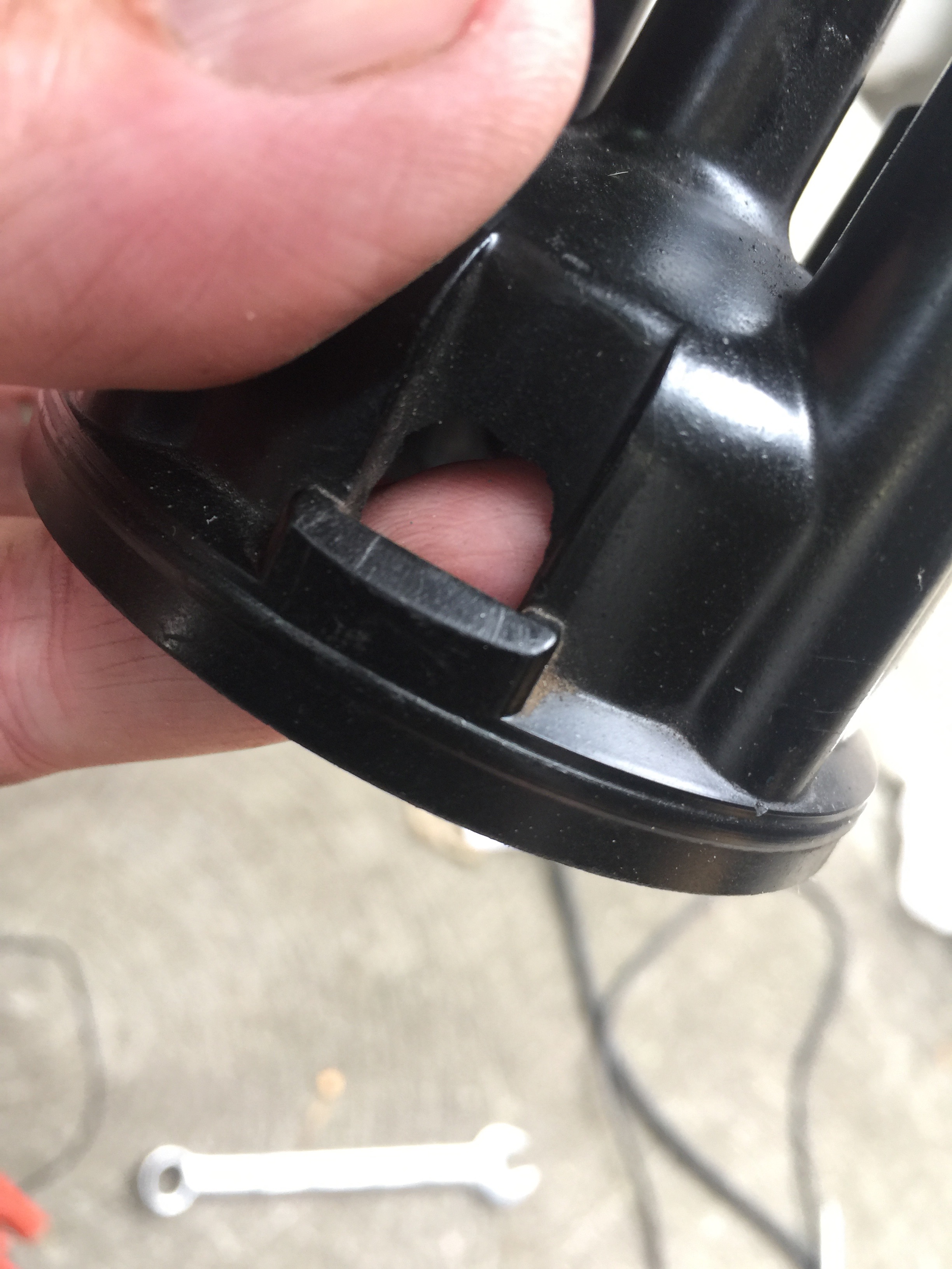

So I got the distributor out and walla! Once I got the cap off I saw what was likely my problem. A cracked cap that I couldn't see with the clips on.
I did swap out distributors and for the life of me I can't figure out what's up wih the distributor the PO put into this bus. Its the craziest thing. You get the bus to TDC on #1, but the rotor is pointing to where #3 is normally located. You put another distributor in and the rotor with that distributor is pointing to where #1 is or should be. I thought someone put the distributor drvie gear in 180 degrees off, but I'm wondering if the gear is right, but this one distributor I have is just out of whack somehow? Can someone rebuild a distributor backwards :?

It's not that someone built it backwards, it's that on some distributors the pin hole at the bottom (where the drive is attached) is at 90* from where most distributors are. This puts the rotor 90* off from most distributors. If the rotor is 180* off, yes, maybe someone put the drive on backwards on the bottom of the shaft.

Anyway, I swapped distributors out because when the cap cracked it sent shards of plastic into the vacuum only distributor body gumming up the innards. Not pretty. So I was going to use one of my 36HP cast iron distributors I have, but there was a scary noise coming from the engine so I just popped on a 009 to get it running.
