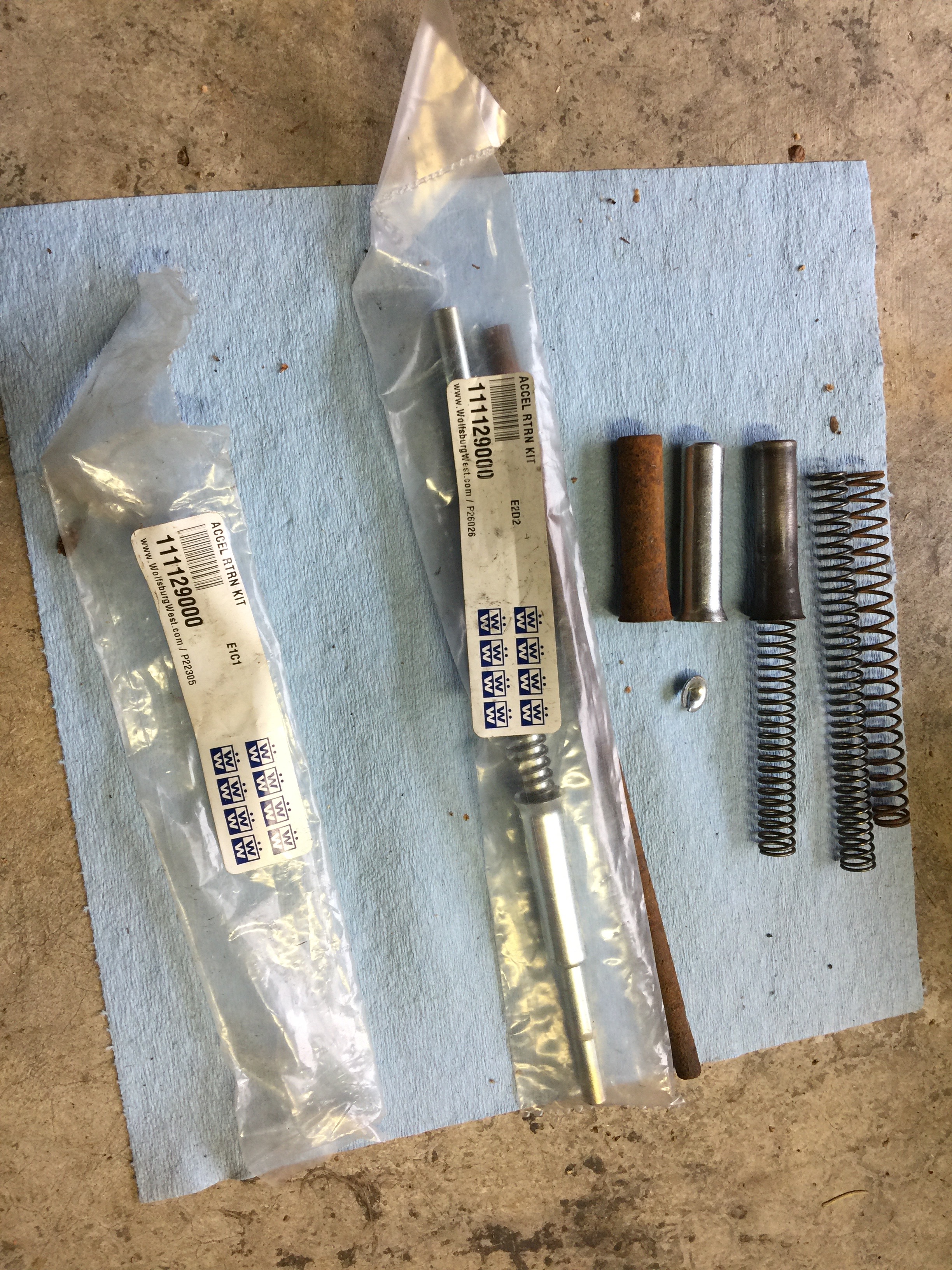

Bruce, no idea what would cause the brake fluid to look like that. Might be leaching whatever was in the reservoir last time.
Here is how the throttle tube and return spring should be.

toolbox wrote: Sun Aug 06, 2017 6:52 pm Bruce, no idea what would cause the brake fluid to look like that. Might be leaching whatever was in the reservoir last time.
Thanks Ted. But that reservoir was a new replacement for the replacement dual master. It was brand new right out of the box. I never even took the cover off. More reason to drive a car and not let it sit.
As for the carb linkage, that's on me. I don't know how much Bruce has been around the 36HP or 40HP set ups, but its all I've ever been around so no excuse for me. Besides, I never left Bruce the linkage parts. He can't install what he doesn't have. That will change when I bring over my stash.

I know about the early style return spring, but your replacement carb has an external (late model style) return spring, so maybe the cable-mounted spring is not needed.
If it had no spring it would not have been driveable....... ;)

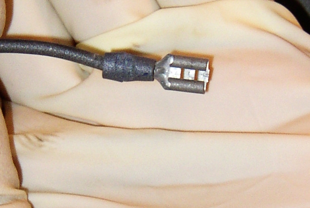

This is going to be a multi-part posting, I'm about halfway through the wiring process. The wiring was not up to the standards that I hold and the car would not have been reliable in the condition it was in. The harness was new but numerous other things must be done at the same time a harness is put in, this is the difference between doing a job, and doing a job right.

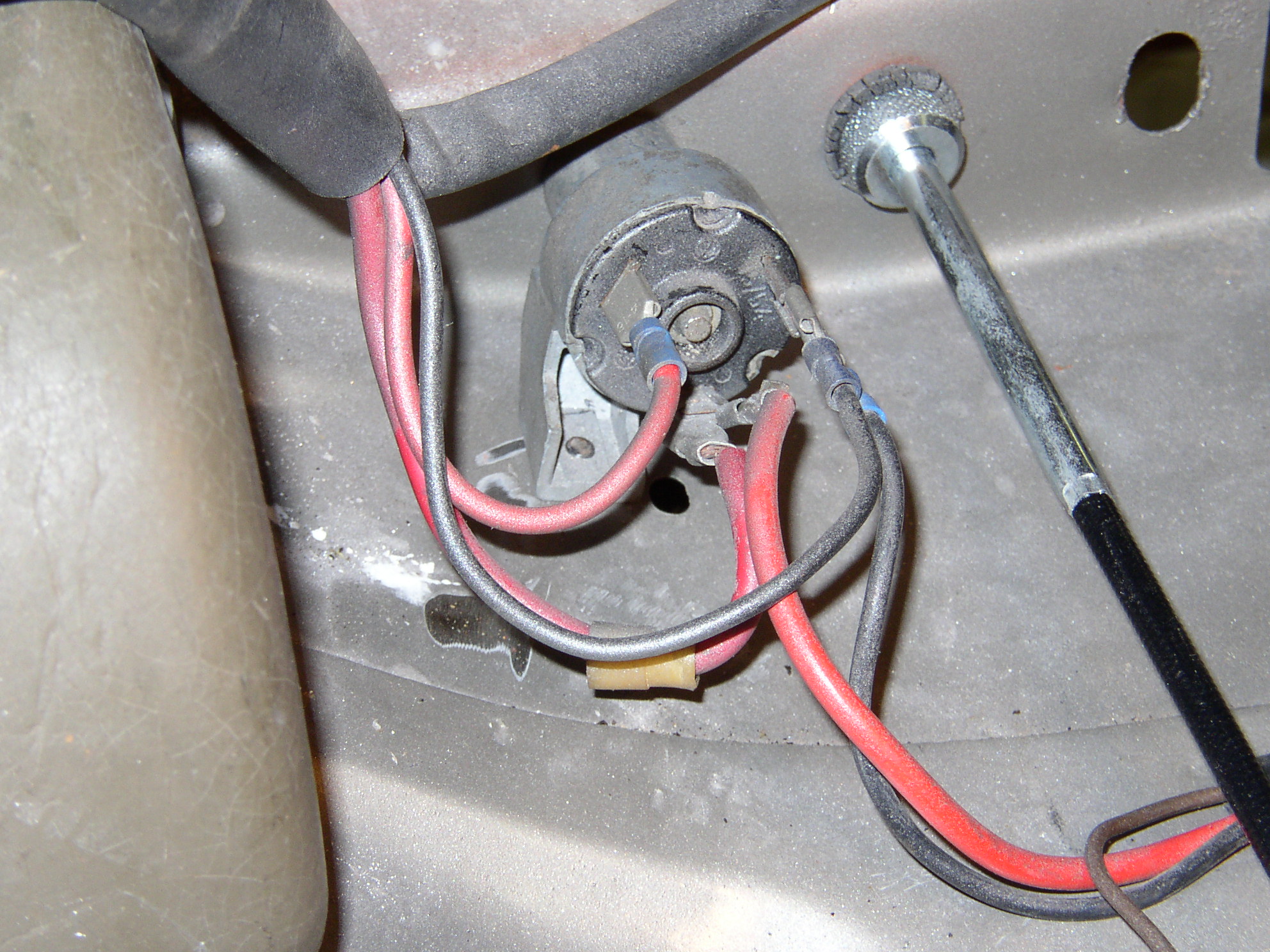

Let's start with the ignition switch: The main feed power from the rear of the car comes here and branches off to the headlight switch and fusebox.
This is the main power feed wire from the battery as it came to me:

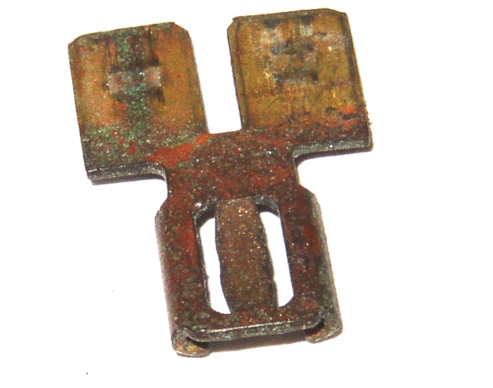

Which attaches to one of these stupid piggyback connectors
Onto the ignition switch.
I've already changed this power feed arrangement around but I don't have pictures of it yet, they will come later this week. Instead of piggybacking heavy amperage wires I made a 4 way soldered splice where the main power branches into 3 separate feeds- the ignition switch, headlight switch, and fusebox. You'll see later.
Here's the piggyback coming off the ignition switch, the left wire is the coil feed, the right wire feeds the fusebox. Yech.

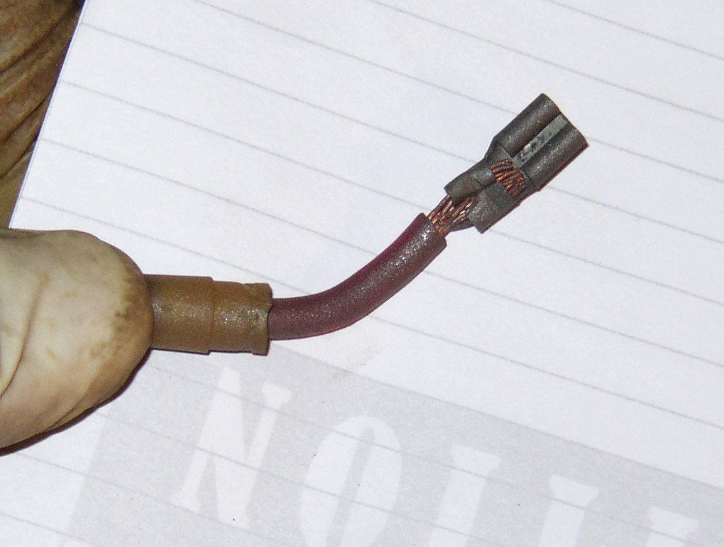

This is the coil feed wire, the crimp terminal was actually loose and the wire could be pulled in and out of the terminal by about 1/16" . This would have caused an intermittent stall condition where the car shuts off on bumps if it was not corrected.

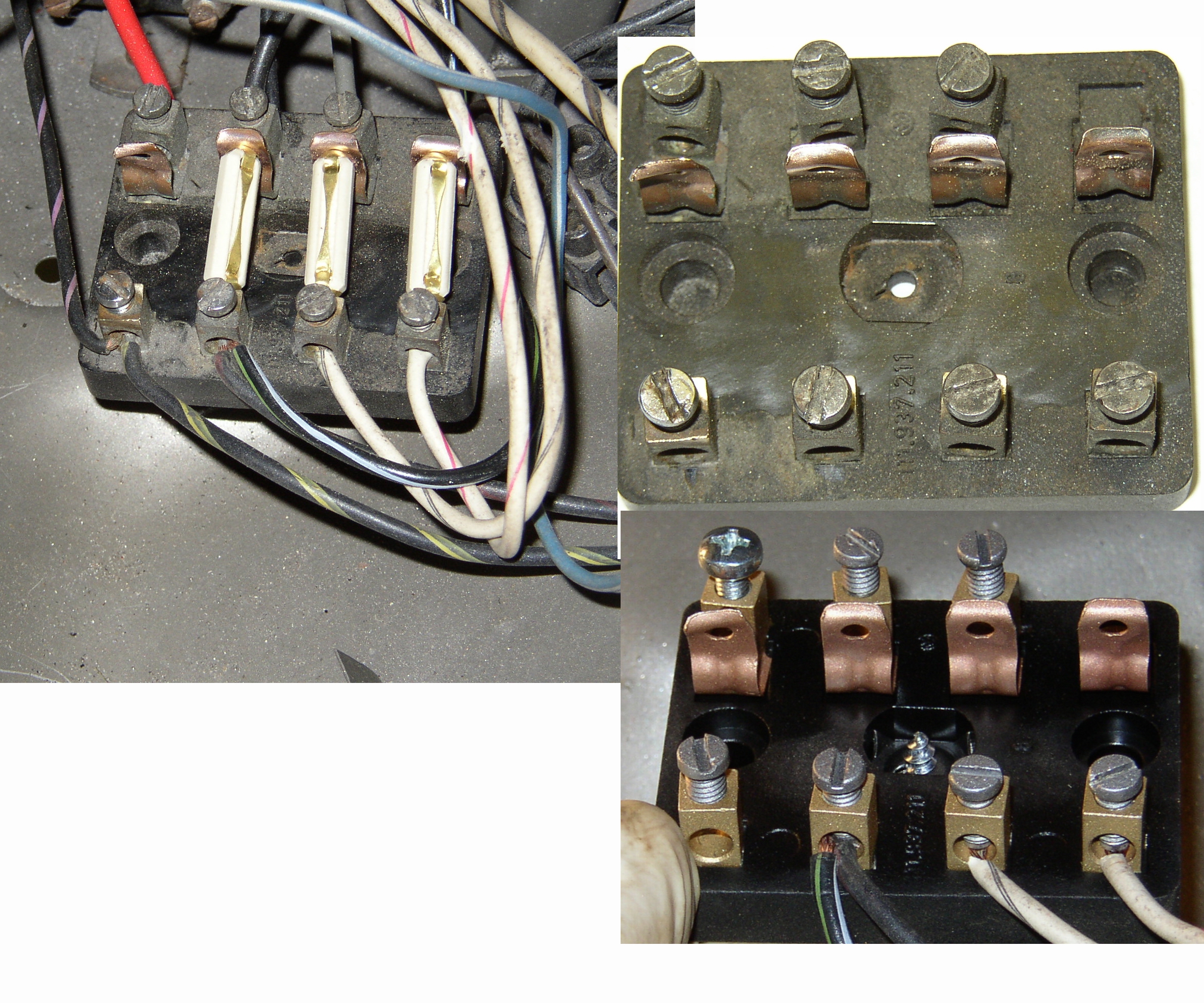

From there the power goes to the fuseblock. I had already cleaned the terminals with my tiny wire wheel when I decided that wasn't good enough and it needed a ride in the blast cabinet also. Here are before and after pictures of that:

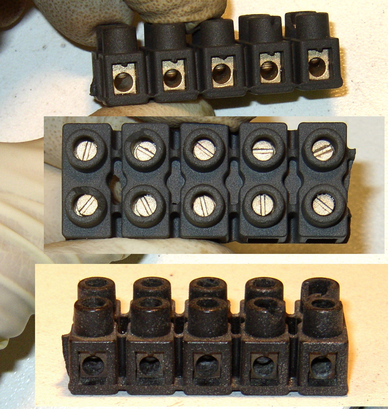

This is a junction block for the turn signal switch, before and after blasting:
All of these corroded surfaces would have stacked up to create considerable voltage drop in every circuit on the car and when you have only 6v to start with you're already at a big disadvantage. :)

Note the red/white wire in the fuseblock picture above. For some odd reason, VW wired this car with only 4 fuses and uses two of them for the taillights which are fused individually. I wonder if this is why the left taillight didn't work? :mrgreen:
