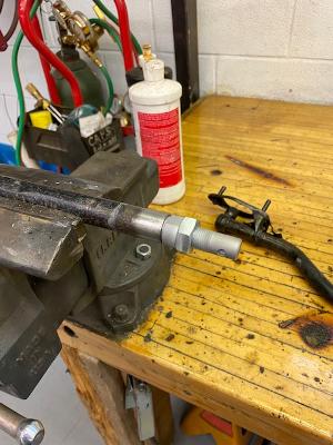

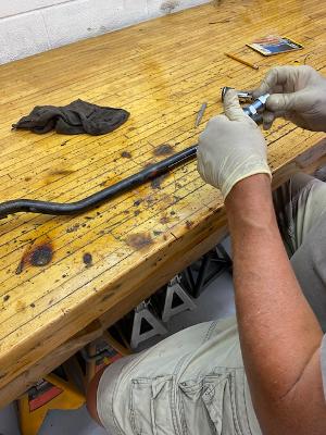

One problem area that I never addressed was my front shift rod which was FUBAR. Twisted and bent resulting in the H shift pattern being all out of whack. I realized a complete fix might require me to pull the engine and trans if the real problem required me to get to the center rod (if that might be the problem) and really didn't want to go down that road.

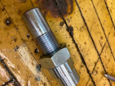

Bruce, however, had an option for me to consider given his extensive experience with dune buggies. He suggested putting an adjustment bolt and nut in the rod that would allow the rod to be slightly turned to create the original H configuration at the shifter. I figured why not? The rod was pretty beat up as is so it couldn't hurt. I brought the bus out to Bruce's and in less than two hours he had it all worked out.
Now the bus "works" like it should. I'm amazed at how people like Bruce can "fab" things up or work around problems to find solutions.
