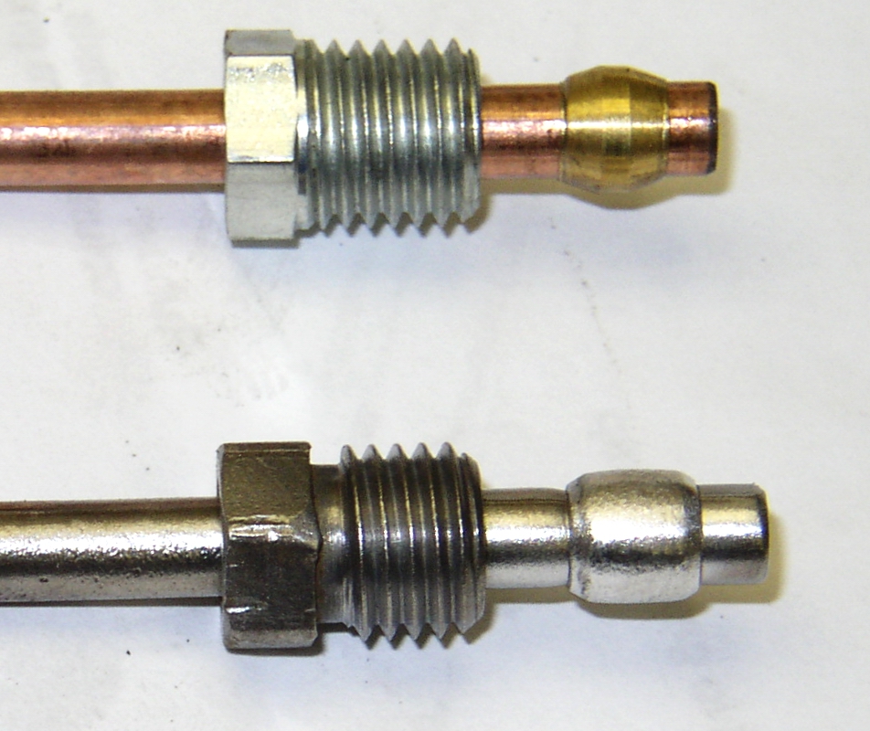

Here's part of the reason the fuel pump outlet fitting was leaking repeatedly: the OEG ferrule has a taller height than the replacement WW fitting. This would obviously cut down on the clamp pressure the nut applies. Once we changed from a new fitting to a used German fitting the leakage stopped. :?: The upper is the replacement.

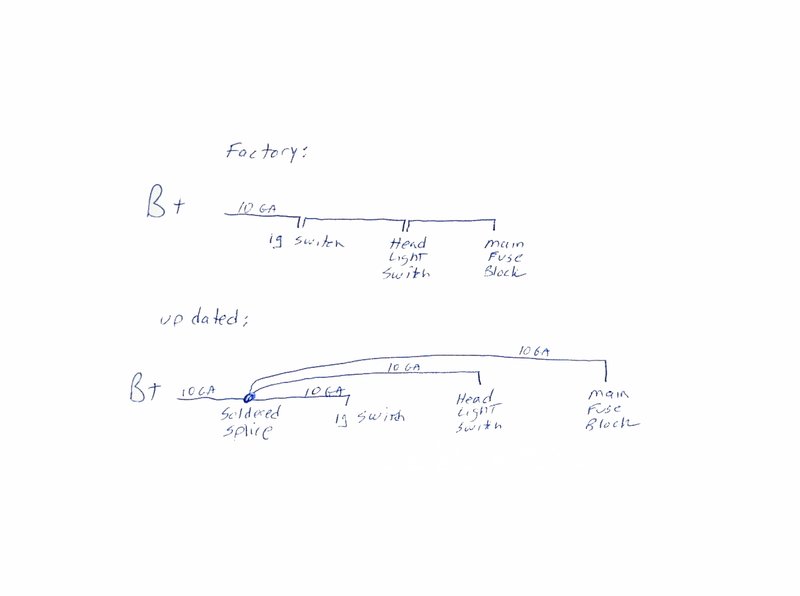

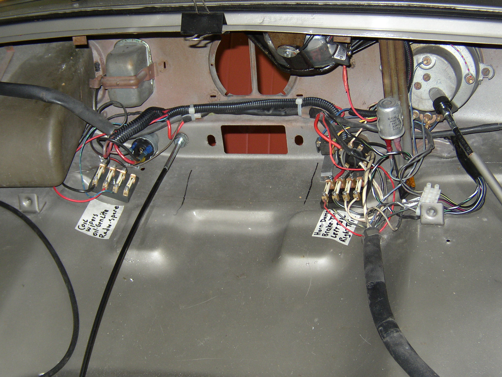

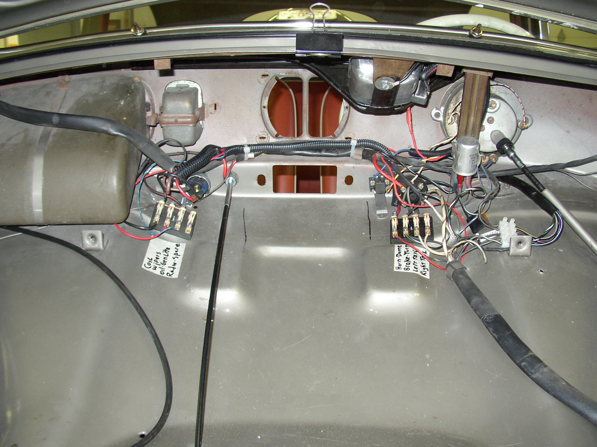

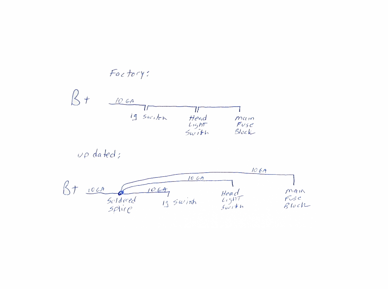

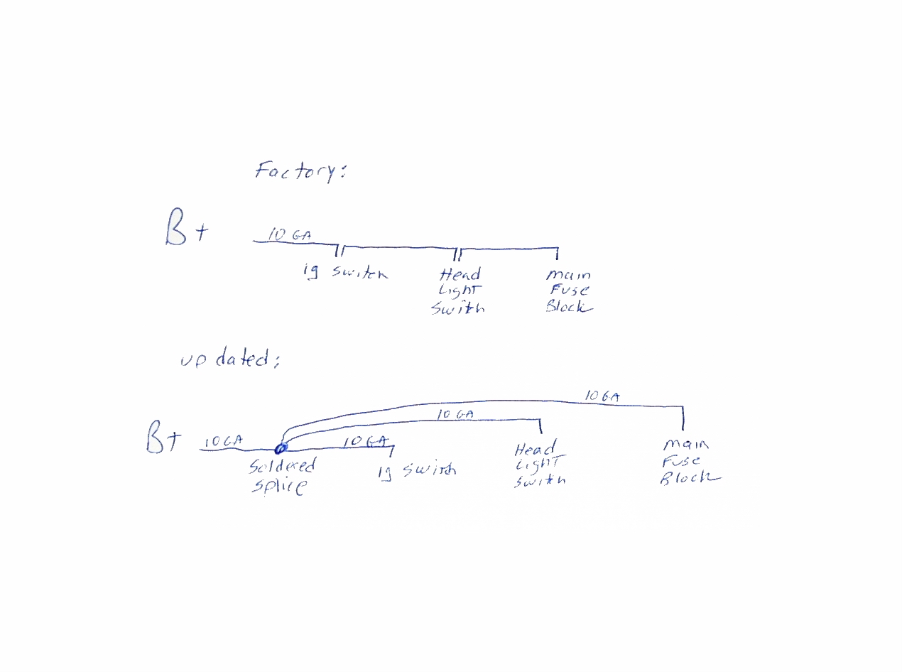

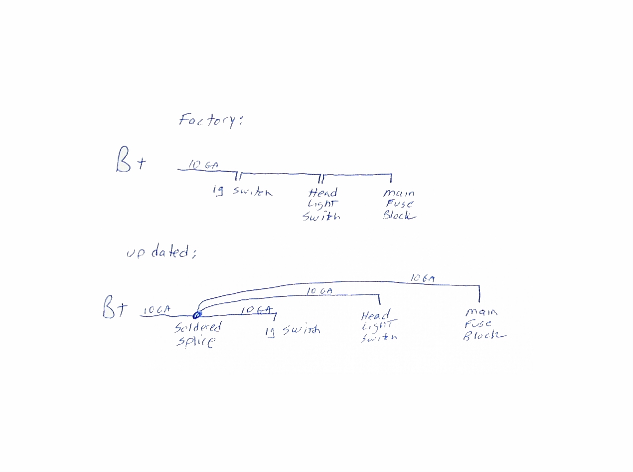

The way these are wired from the factory has the power feed from the battery coming to the dashboard, then piggybacked off the ignition switch to the headlight switch, then piggybacked from that to the fuseblock. This created multiple points for bad connections. My update for this is to make a 4 way solder joint where the 10ga input splits off into 3 10ga outputs, each feeding a component. Obviously this eliminated several potential spots for problems. It's covered with shrink tubing and Polyloom for double protection.

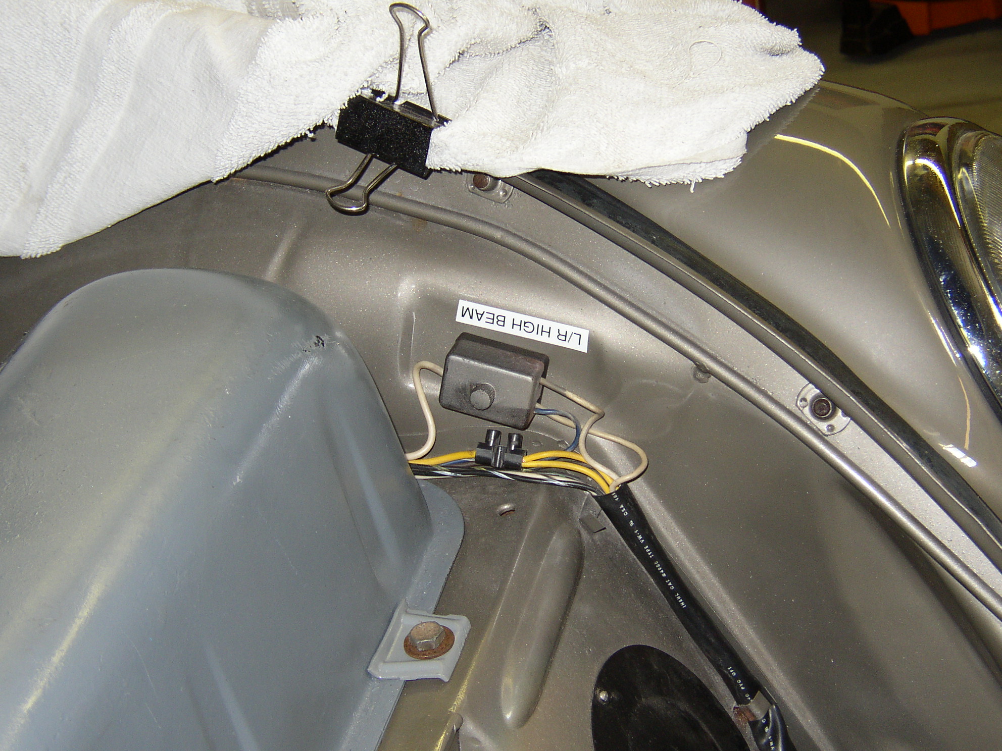

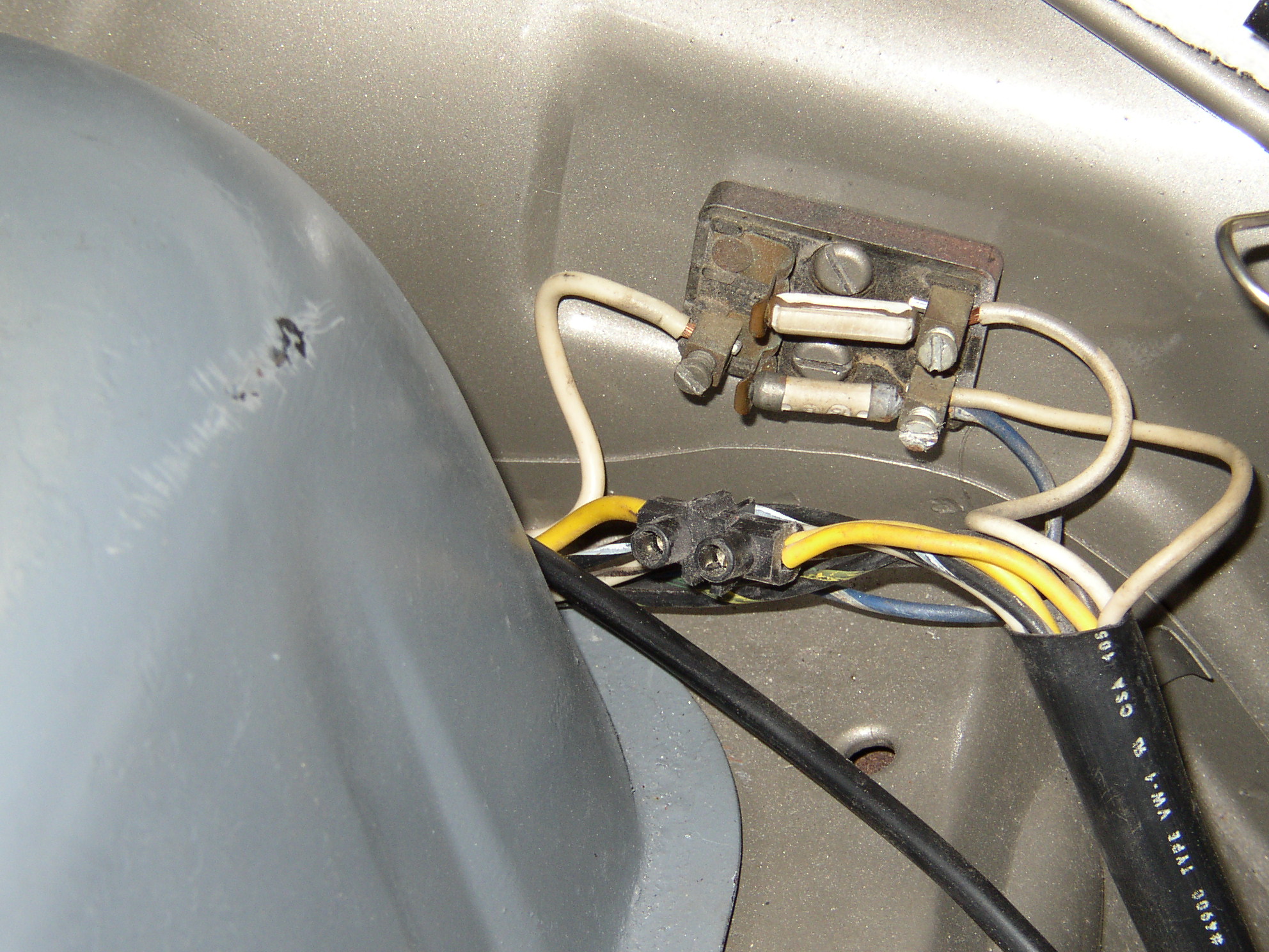

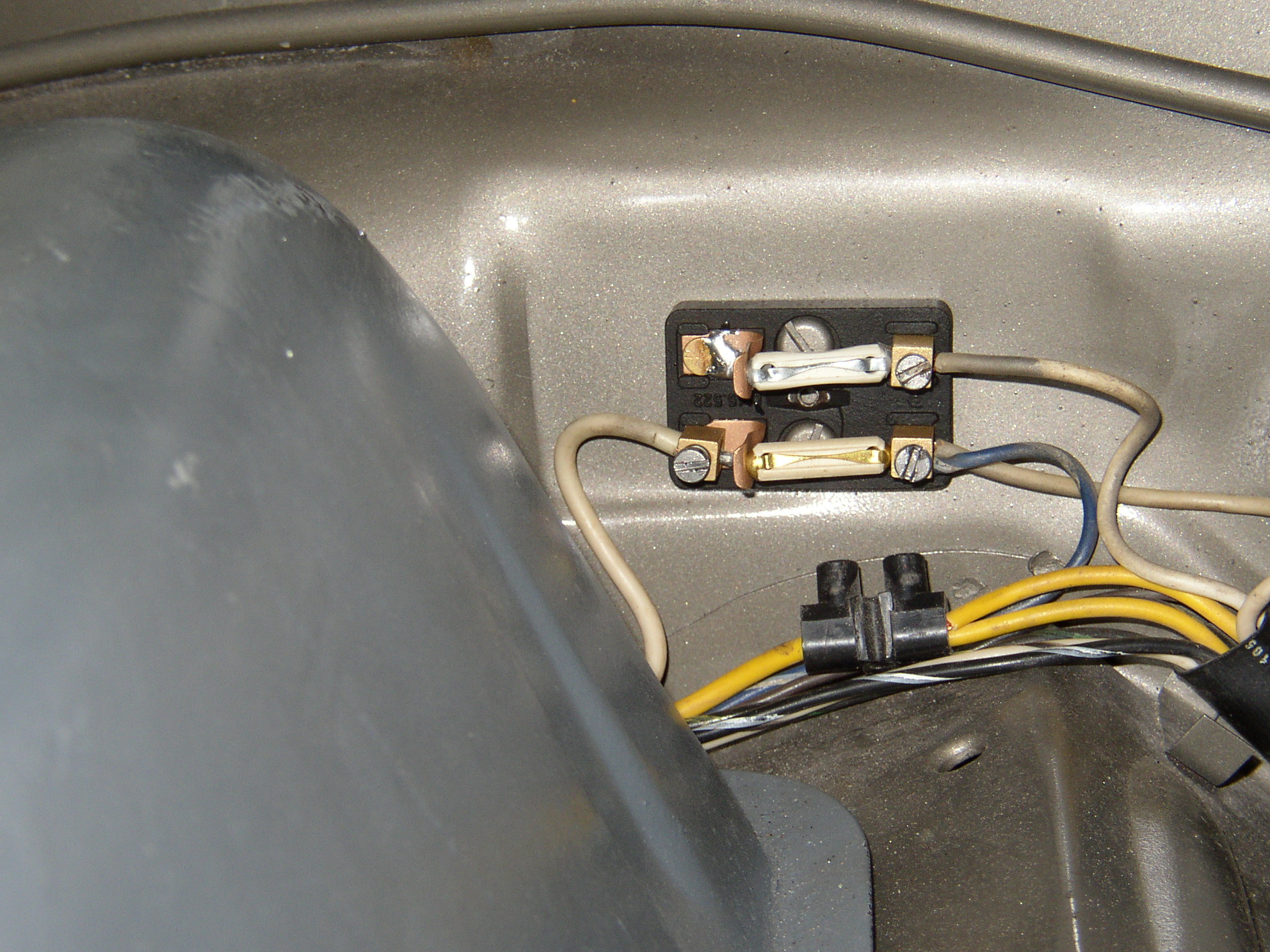

Here is the headlight fusebox that's mounted on the LF wheelwell. Like everything else, it needs attention, a quick ride through the beadblaster should take care of it, right?
Until:
https://youtu.be/2s7oOX-PTL8
Here's the finished repair:

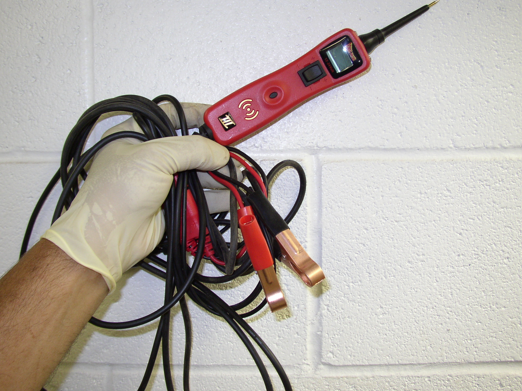

A Power Probe is a pretty cool tool to use if you understand electricity and a WMD if you don't understand electricity. You probably won't do a lot of damage working on a non-computerized vehicle like an ACVW but if you're working on a modern car you can blow up modules if you push the button at the wrong time. I tell my students to steer clear of them unless they understand what they're doing.

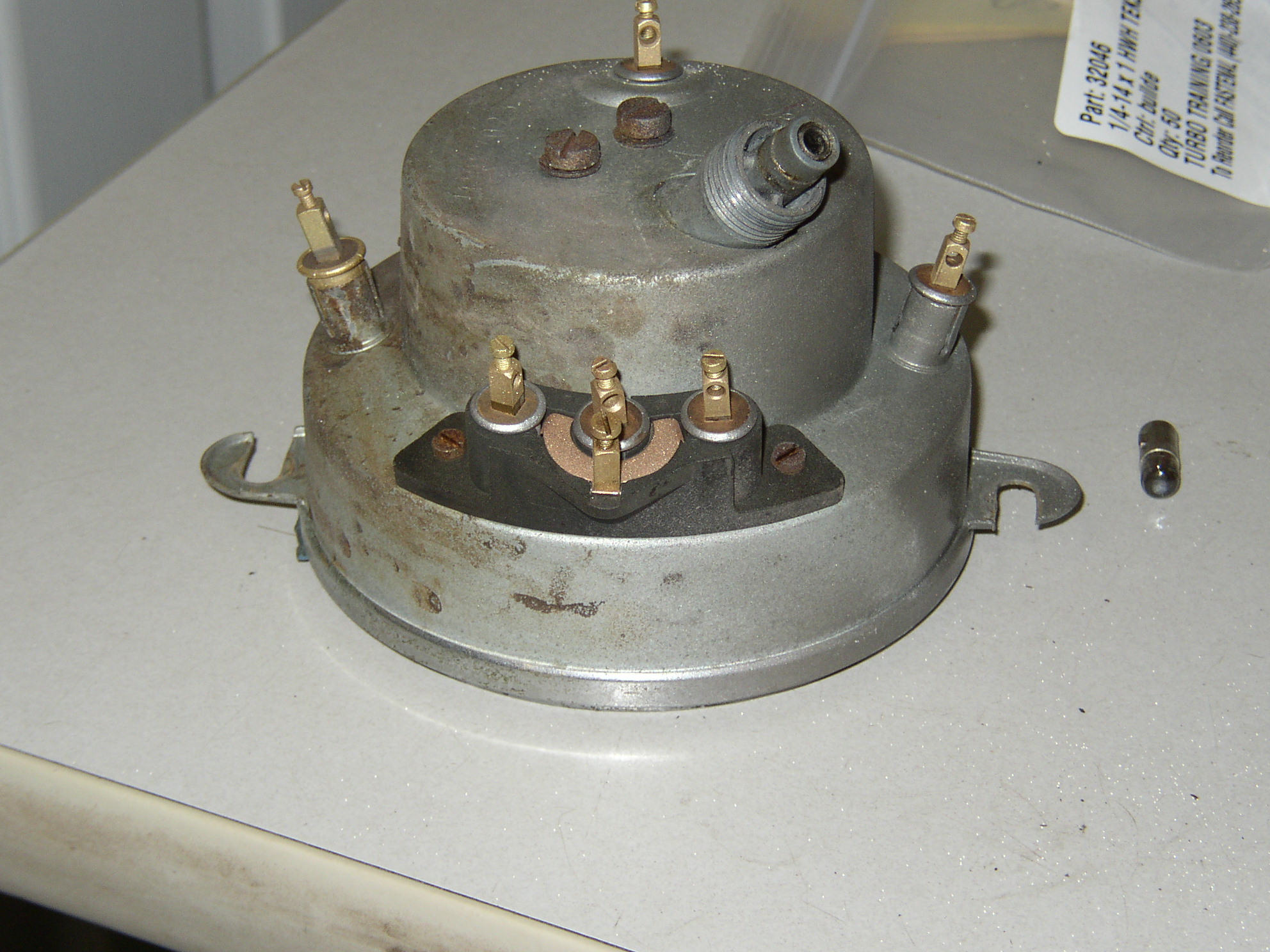

I took the speedo out to clean up stuff so I figured pics would help.

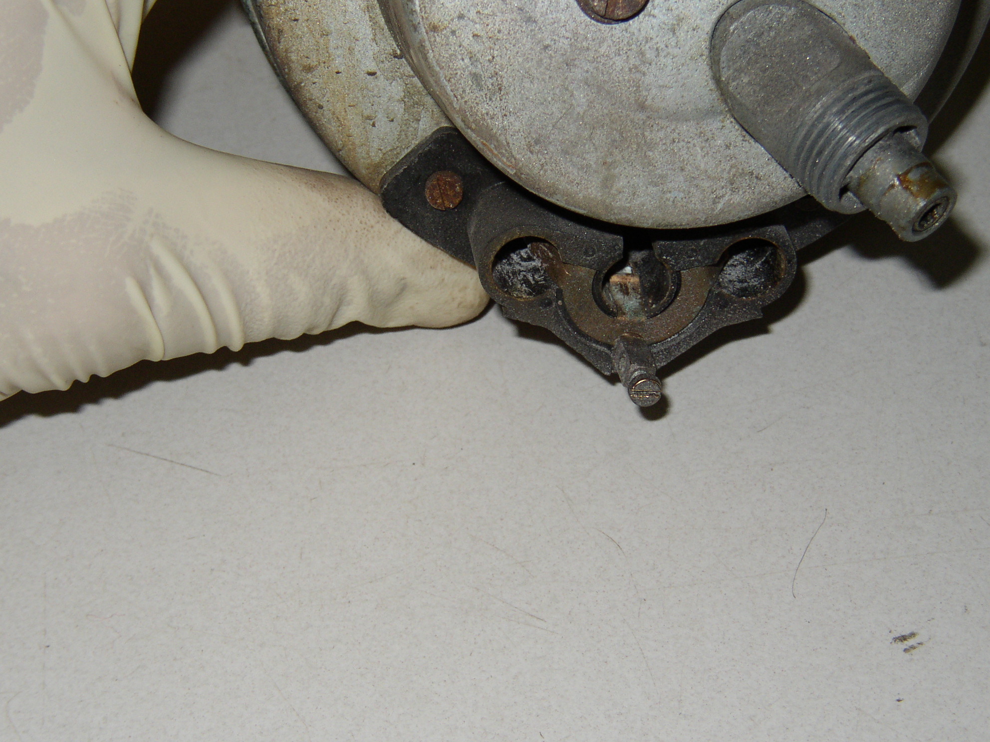

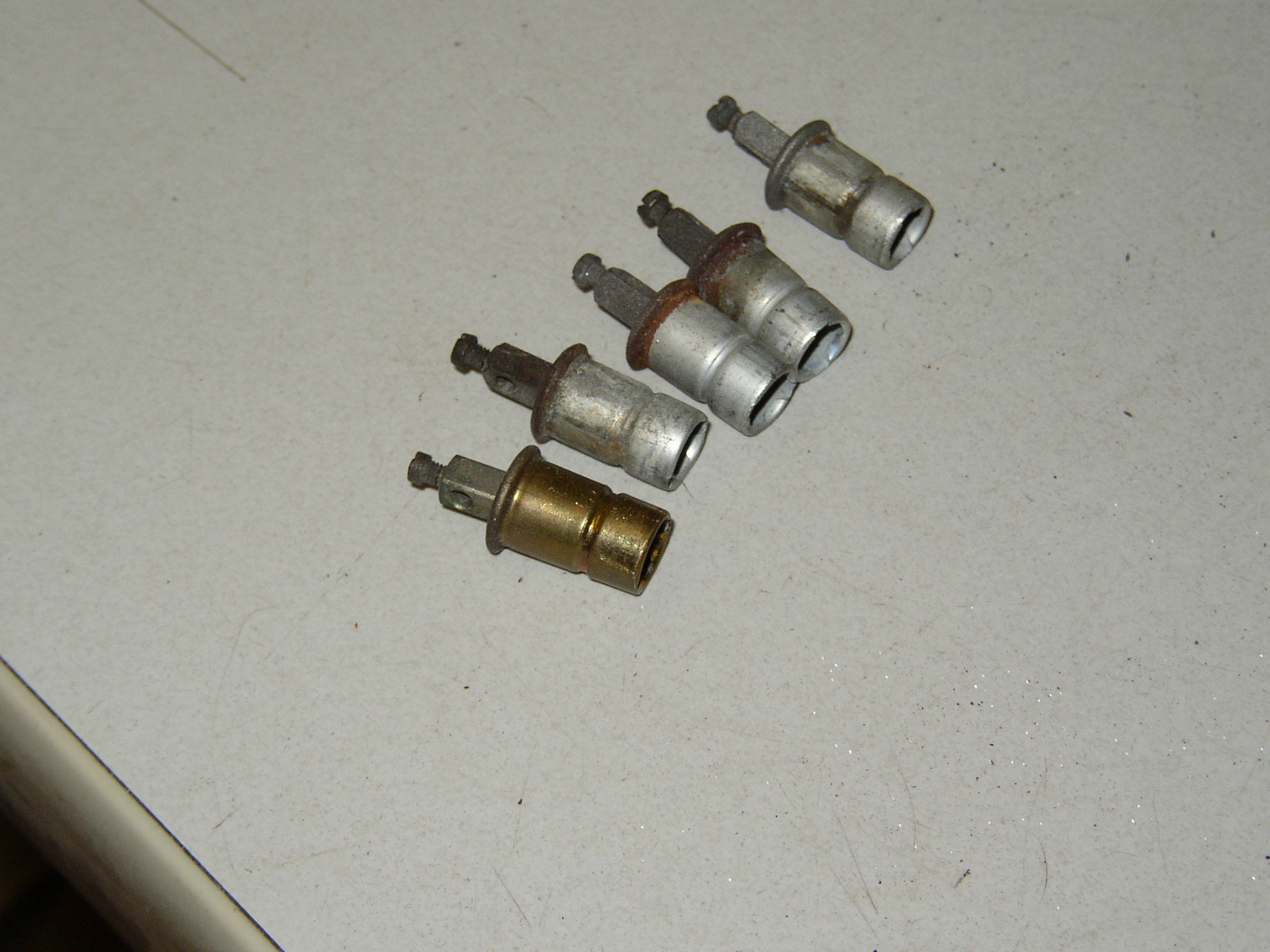

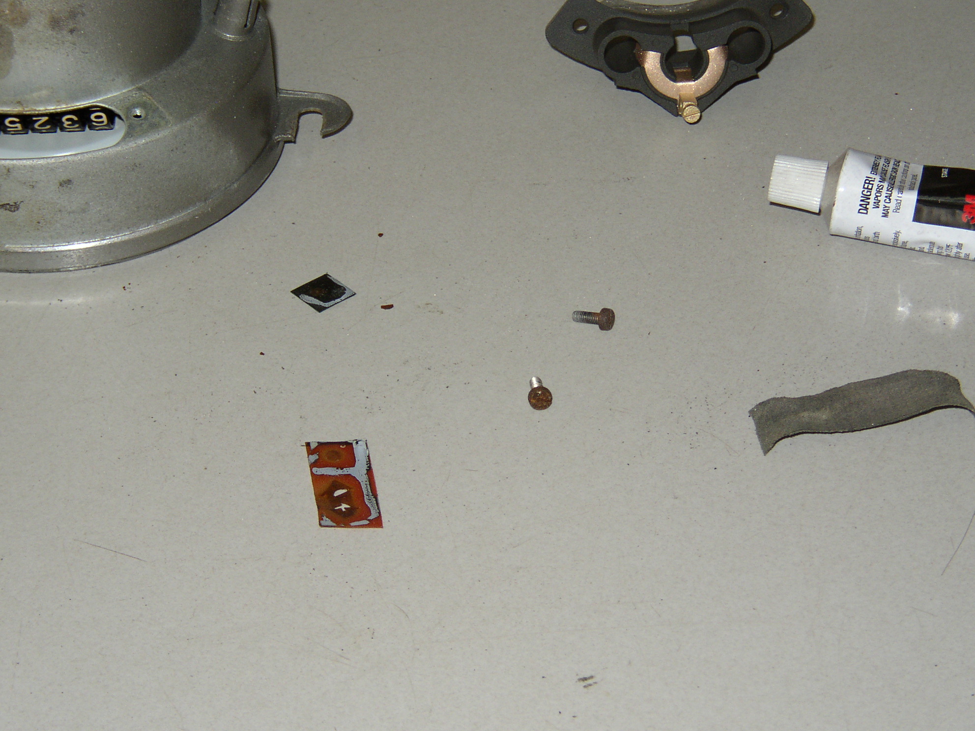

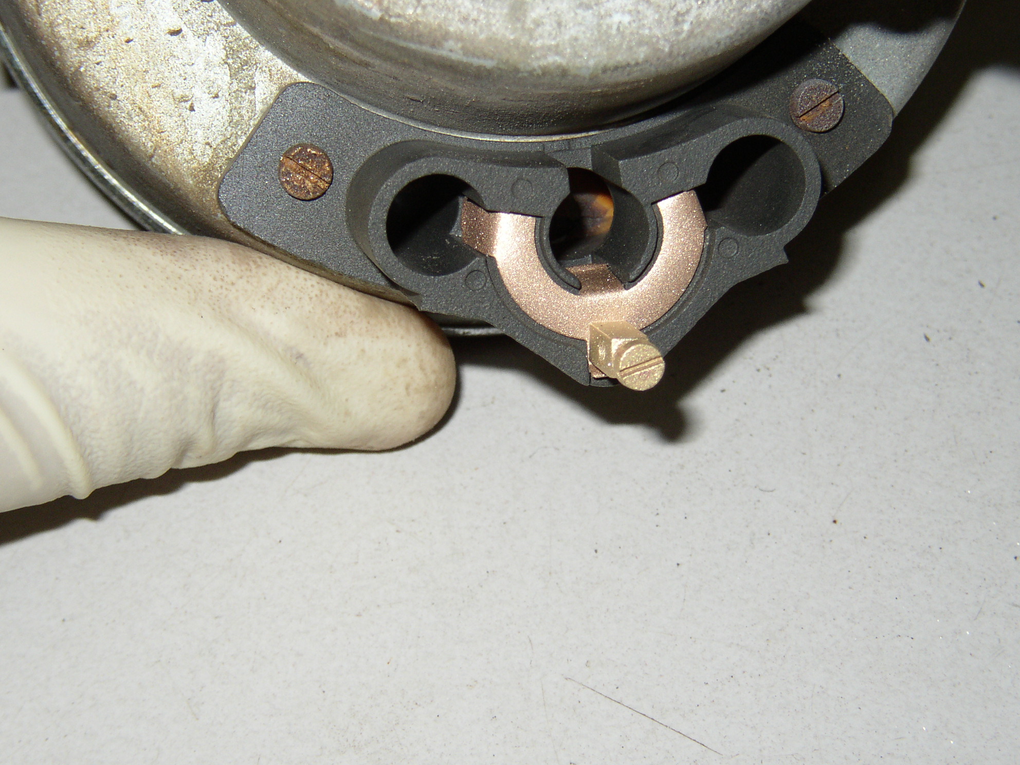

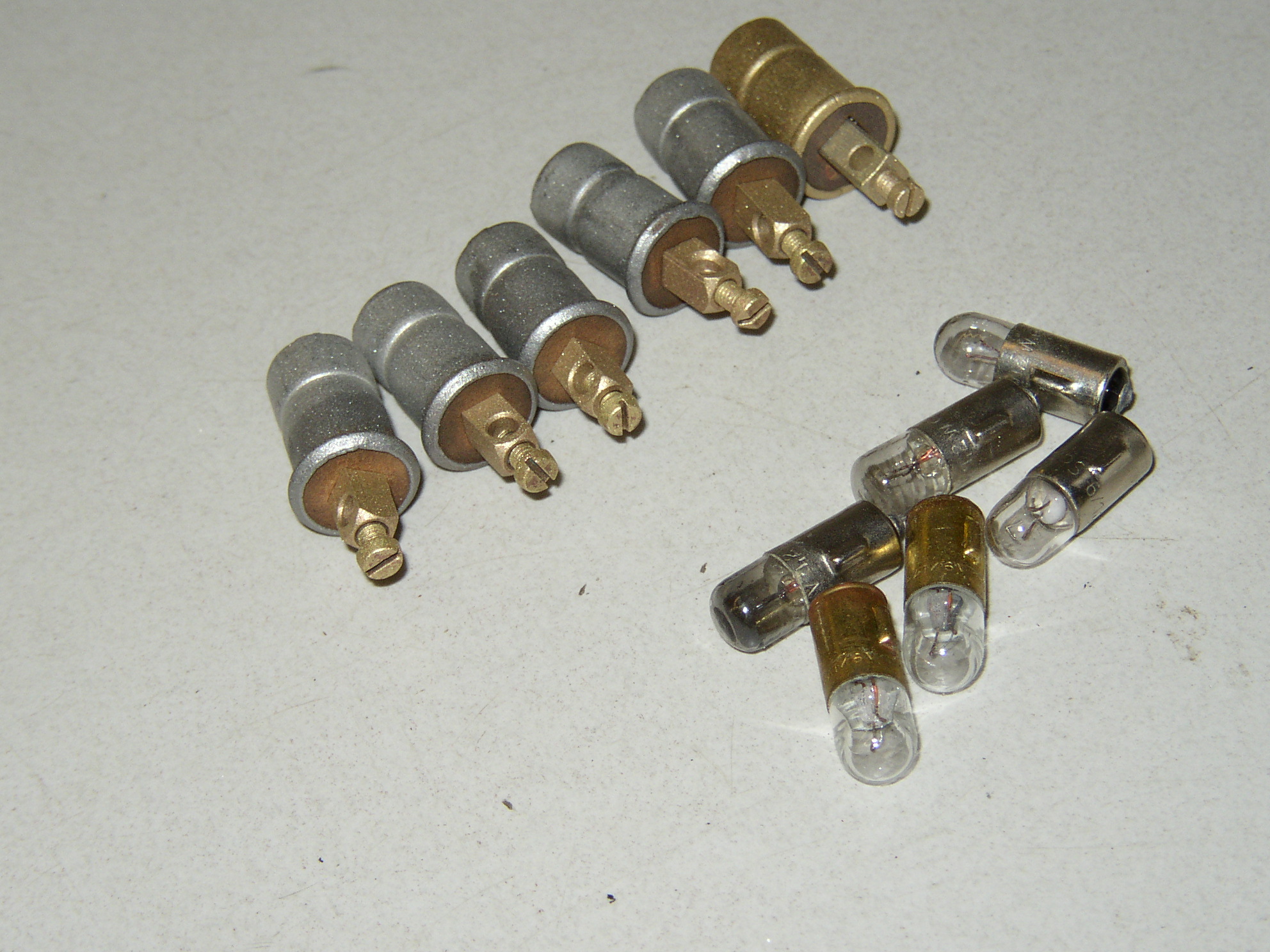

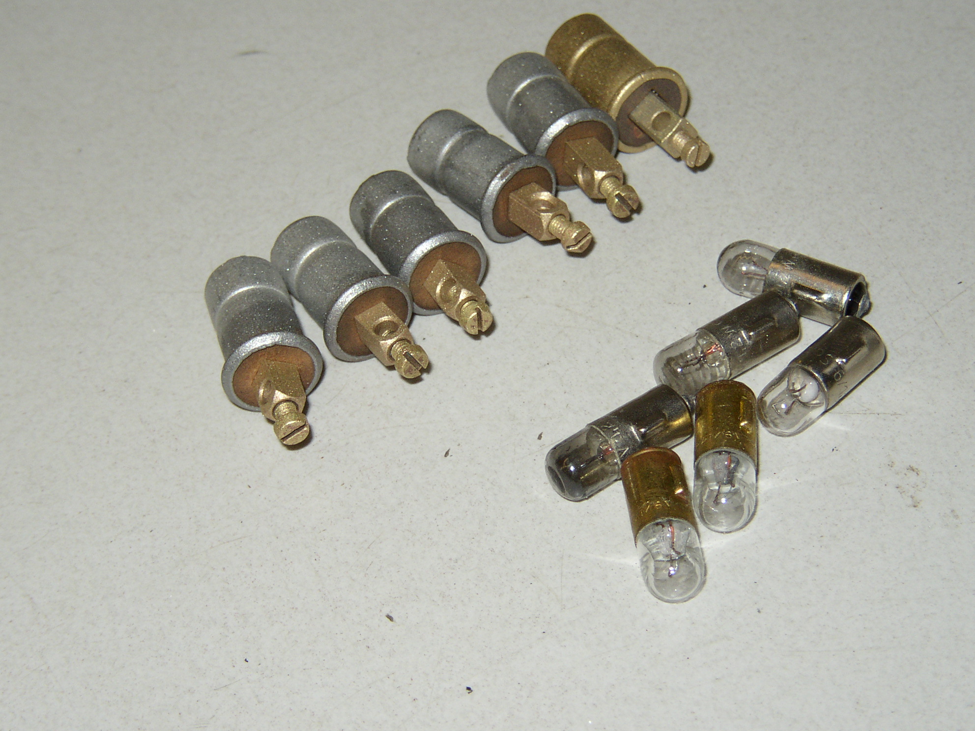

Here it is before servicing, the brass tabs would not have provided a good connection.

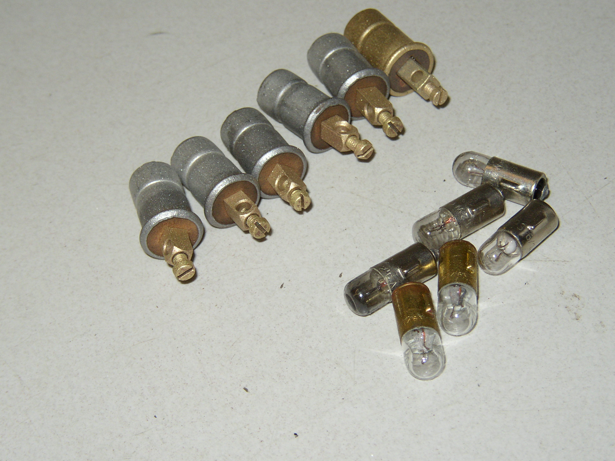

Take the plastic thing off, bead blast it, and the colored gels fall out. Unfortunately I didn't have them on hand :( so I just reglued the old ones. I put them on my WW wishlist.
Cleaned:
Ditto with the bulbholders.
I didn't use the bulb on the left which was mostly done.
Here's the final product:

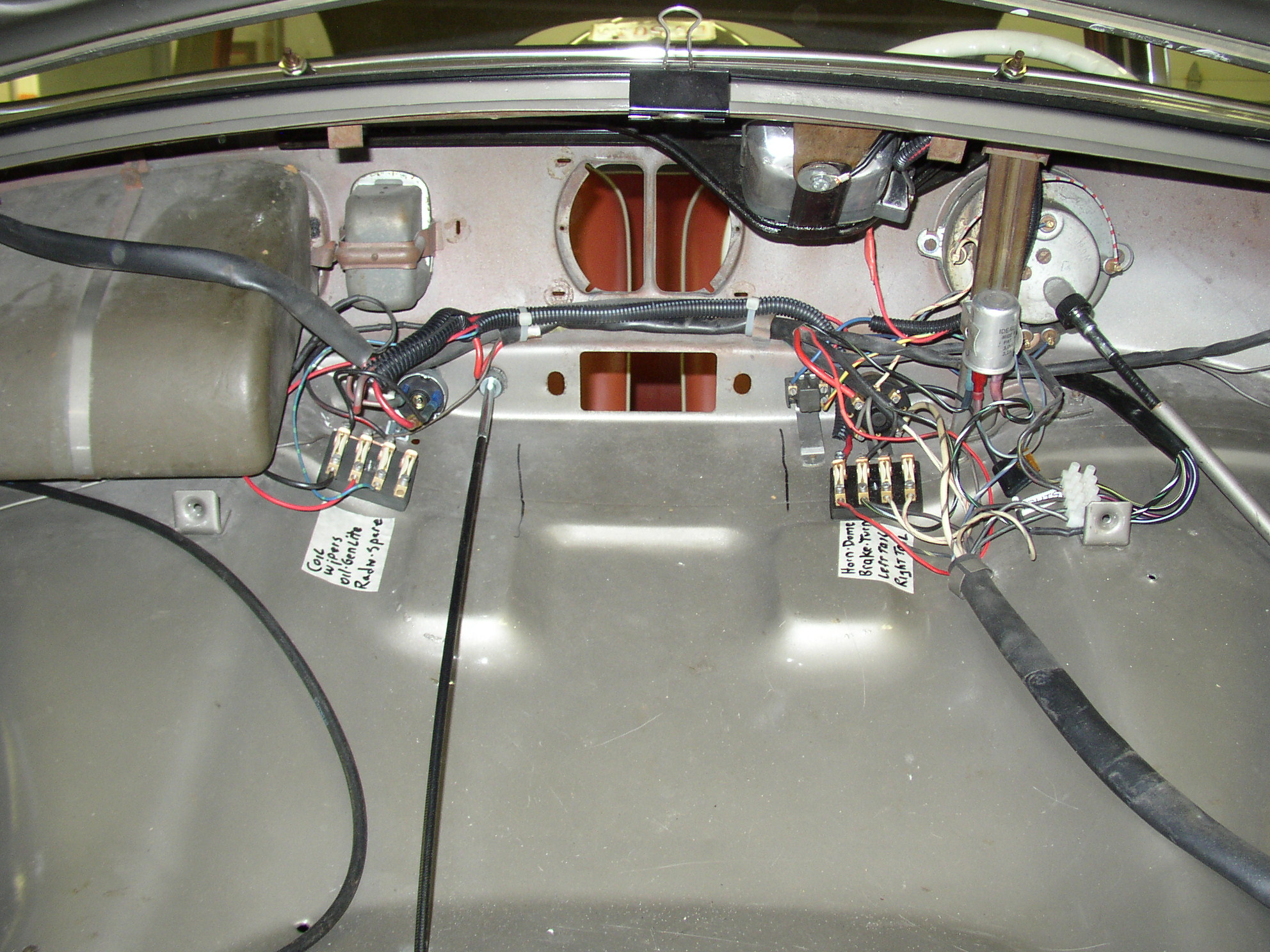

The big solder splice is on the left above the ignition switch. Everything is labeled, ty-wrapped or secured and covered with Polyloom. The auxiliary fuseblock on the left came from Columbus last week and makes the job look a little more "period correct" than a replacement blade-style fuseblock. I made a bunch of notes and modified schematics for Sean to put in his big book so the next guy knows what I did. Even without it it's not hard to figure out what changes were made.

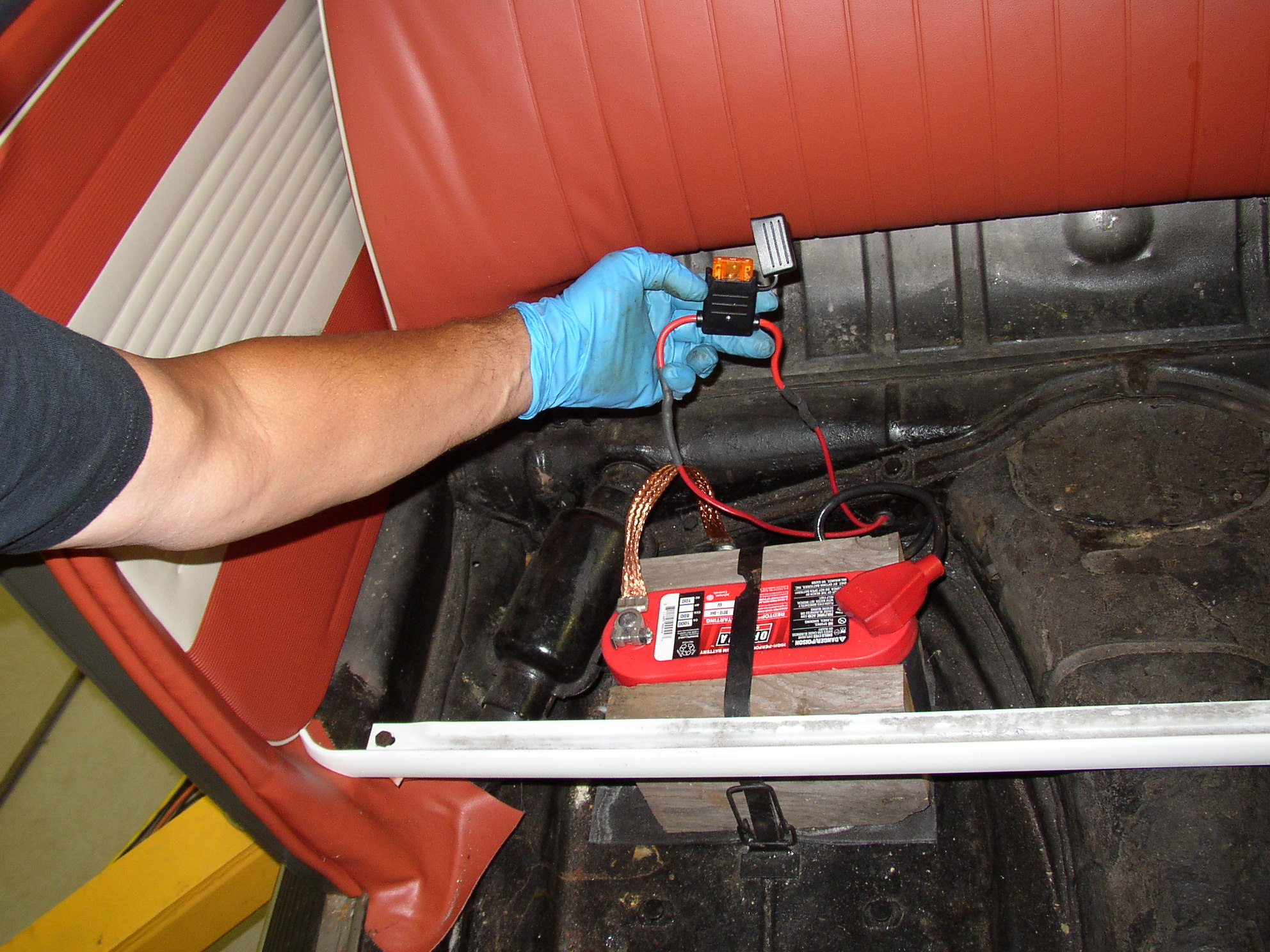

I put a big Maxifuse in the fat power lead that feeds the dashboard. All mfr's do this for the last 30-40 years but VW did not. It prevents burning of the harness if something major goes wrong up front.

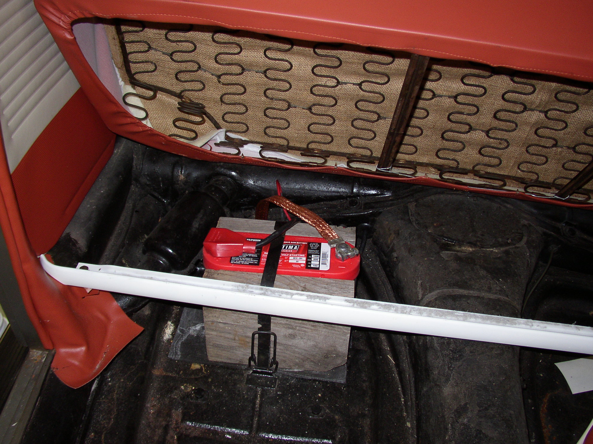

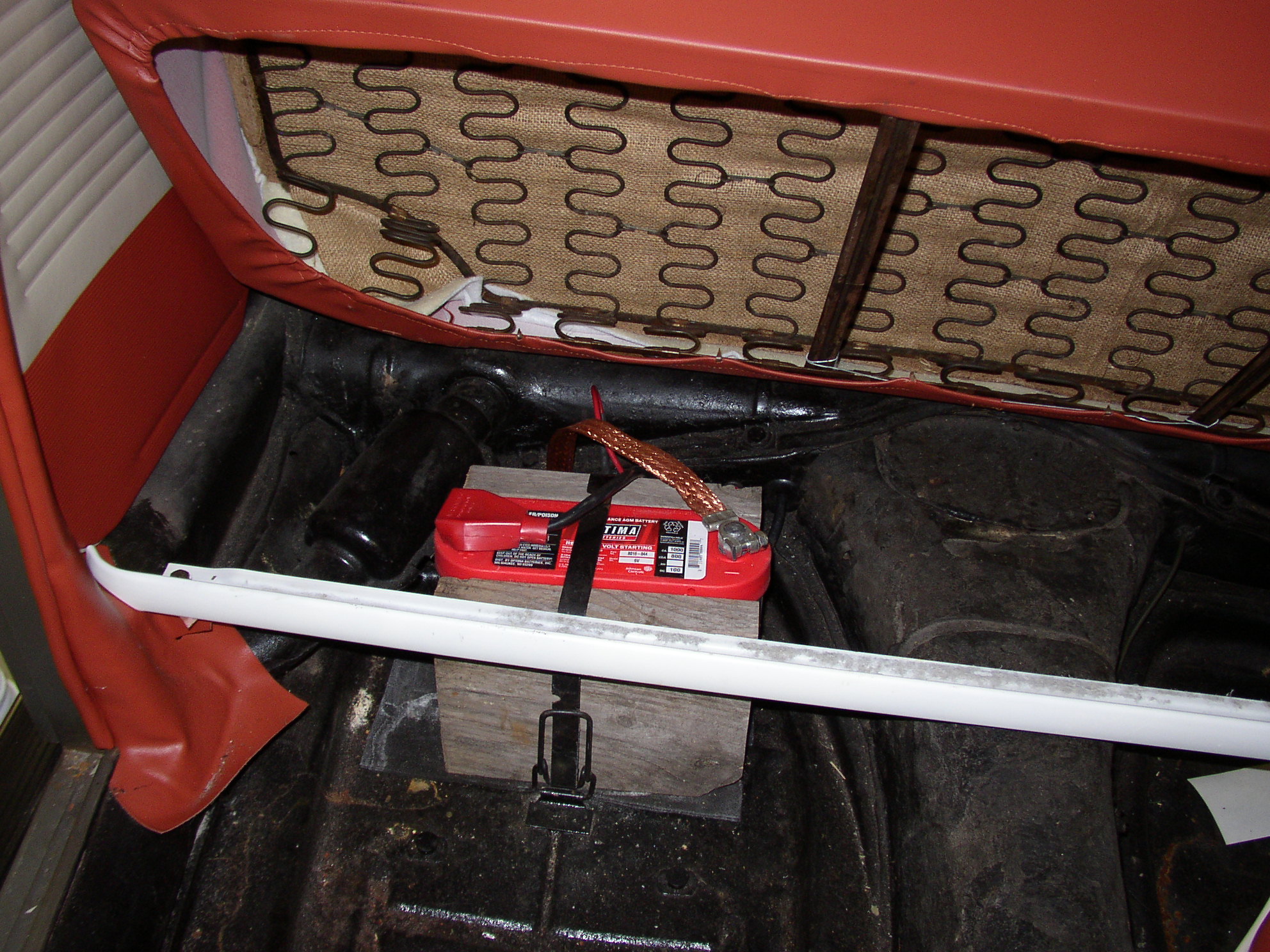

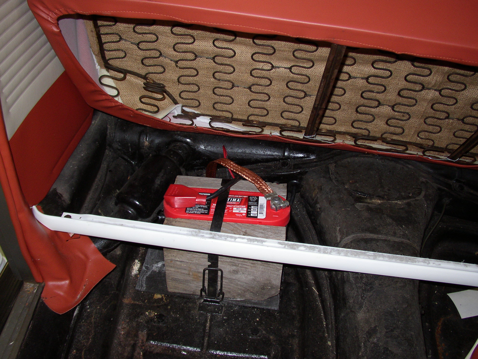

Then I went to set the rear seat and saw the positive terminal would have been a little too friendly with the seat strap so I flipped the battery around. How do you like those blocks of wood? Pretty hillbilly, eh?

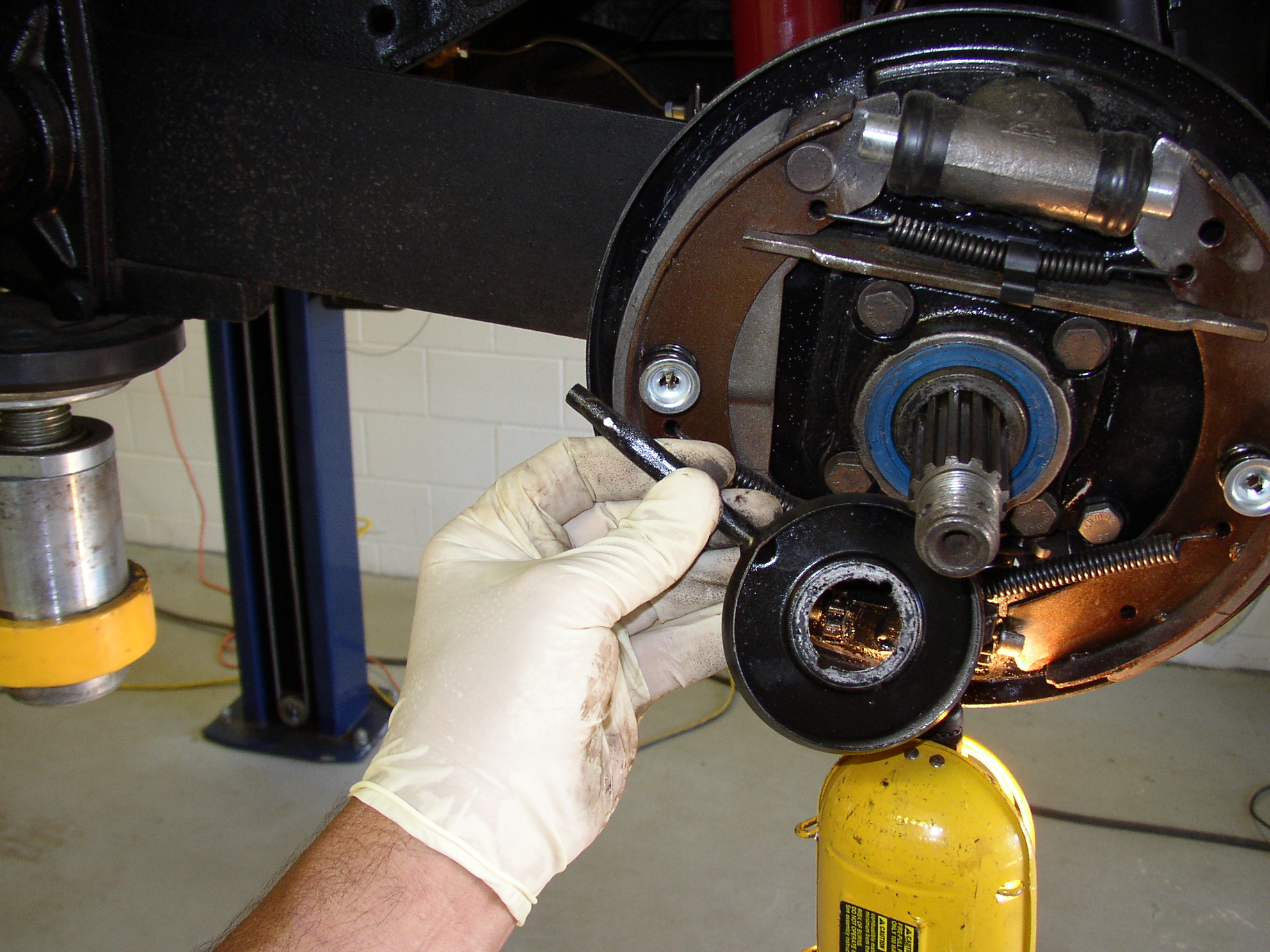

I went for a ride and heard a clicking noise which turned out to be the oil slinger thing hitting on the shoe holddown. No sweat, easy fix.

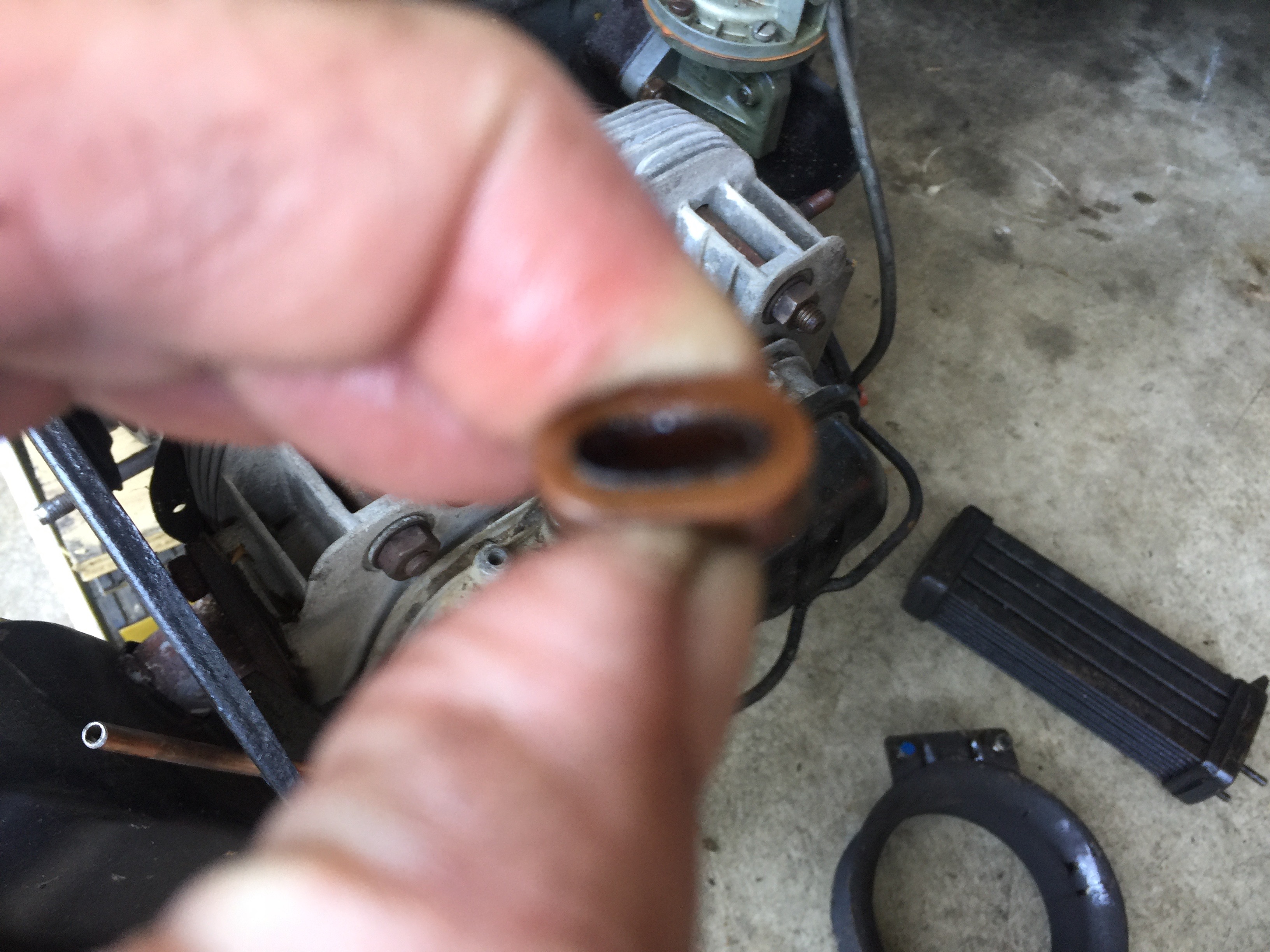

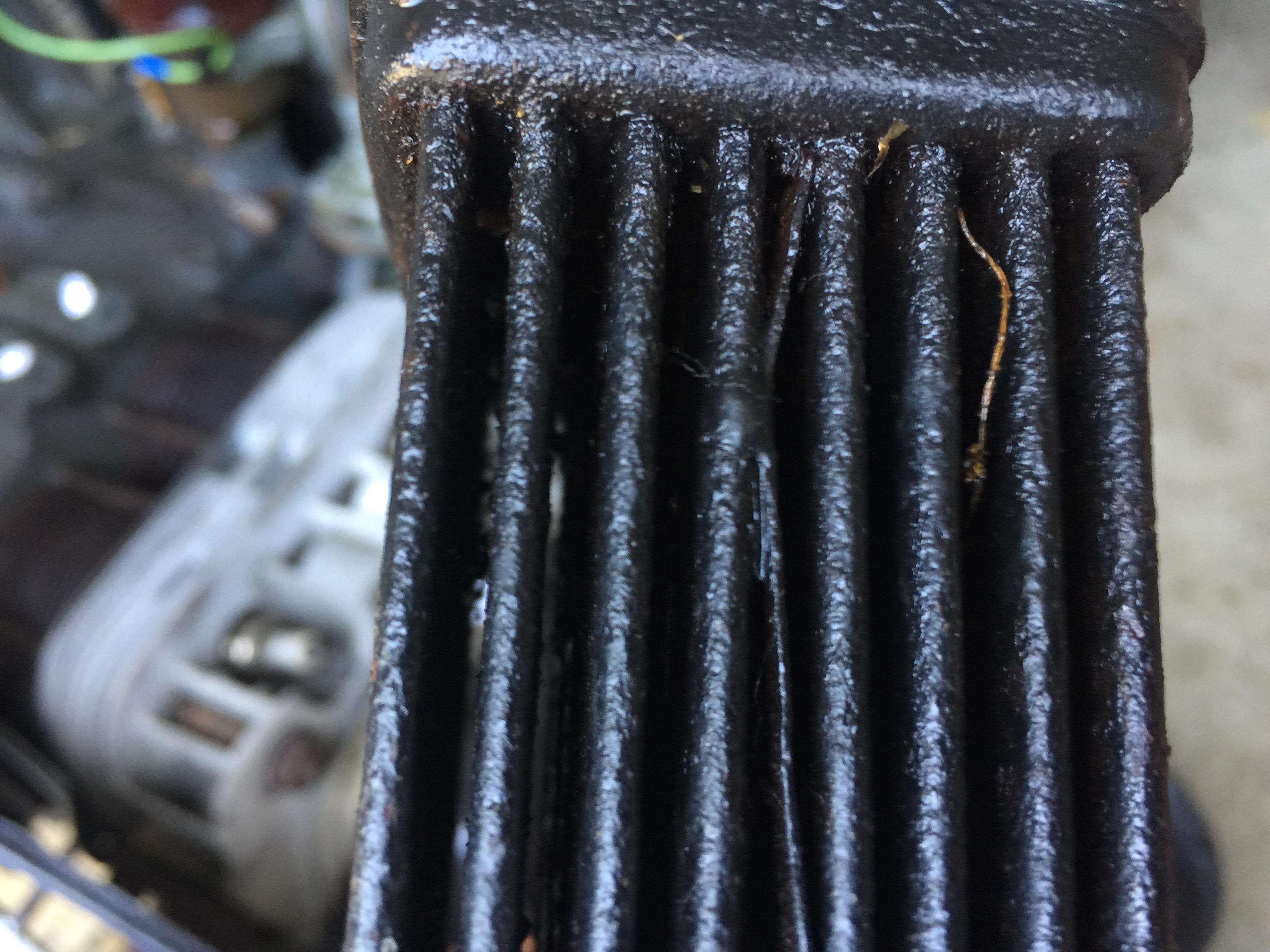

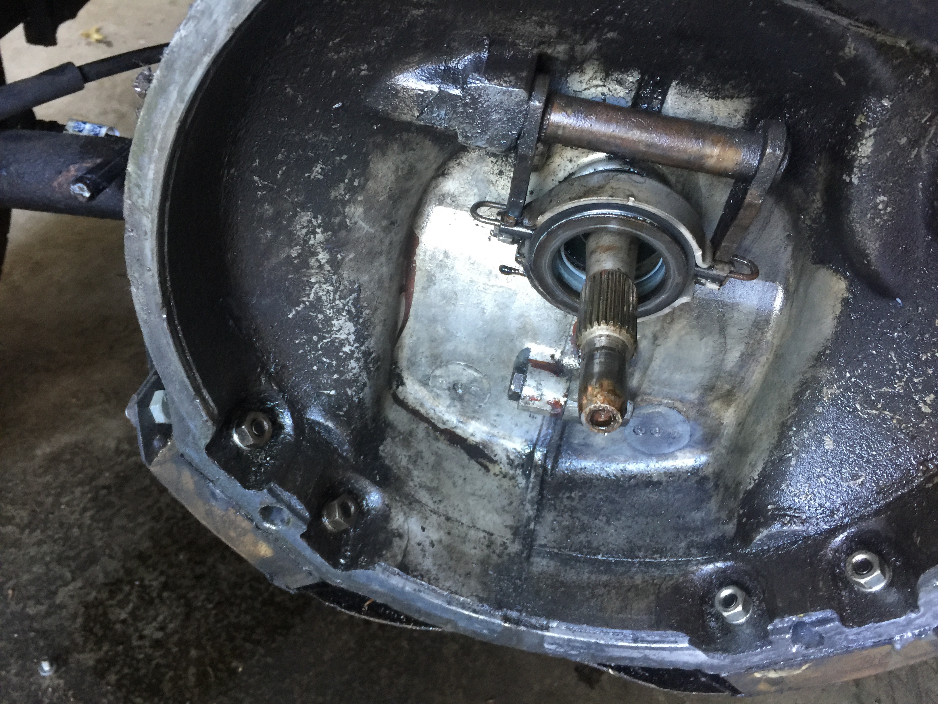

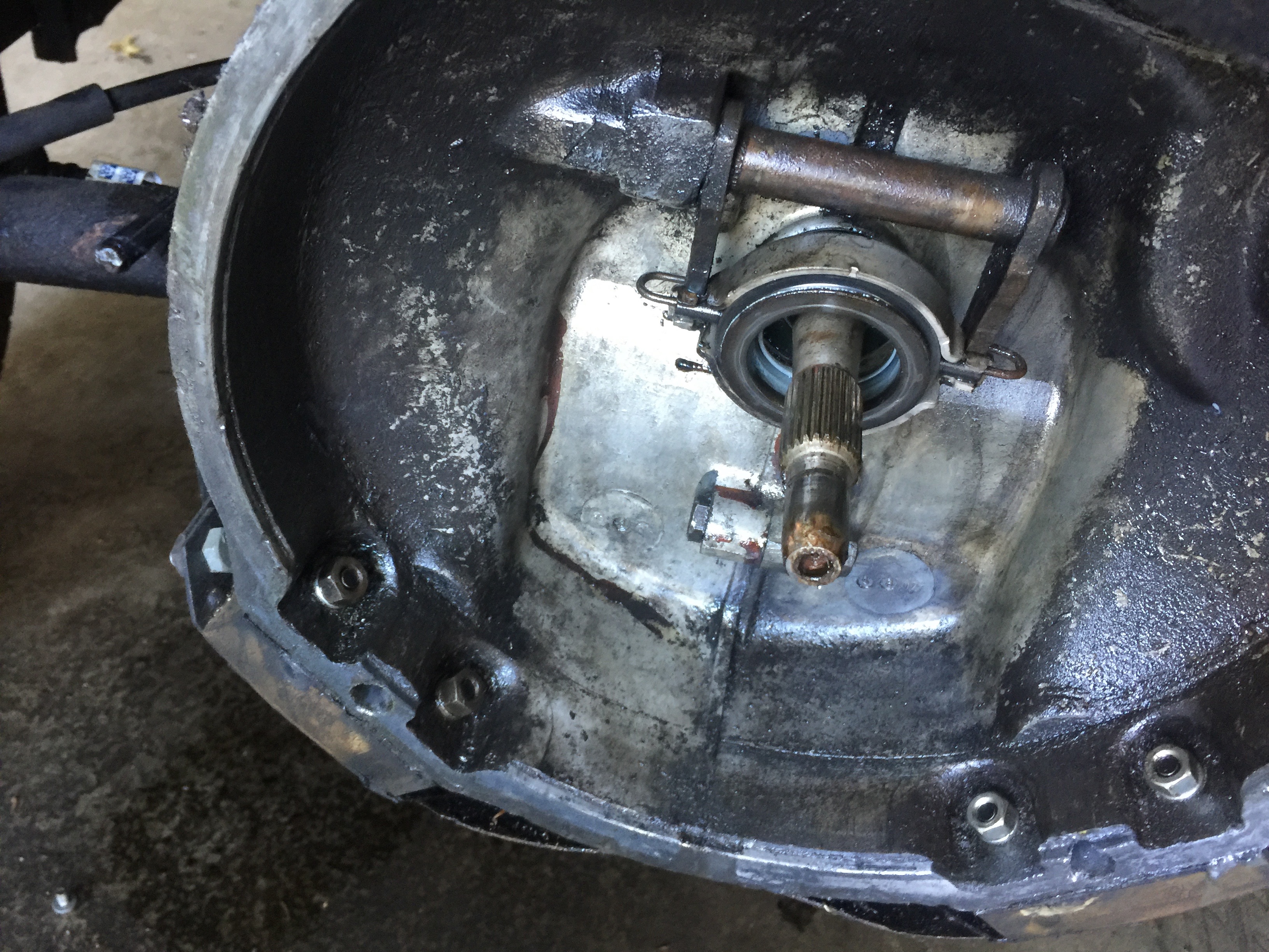

I've been driving the heck out of this thing for the past 3 years with no issues until a couple weeks ago. I pulled it out of the garage to get something and noticed a trail of fresh oil along the driveway to where I stopped it. I fired it back up and crawled underneath and sure enough a stream of oil was coming down between the pushrod tubes below the oil cooler. Oh well, at least I didn't drill a hole in the oil cooler this time! :lol:
I immediately ordered new seals from WW and they arrived this week.

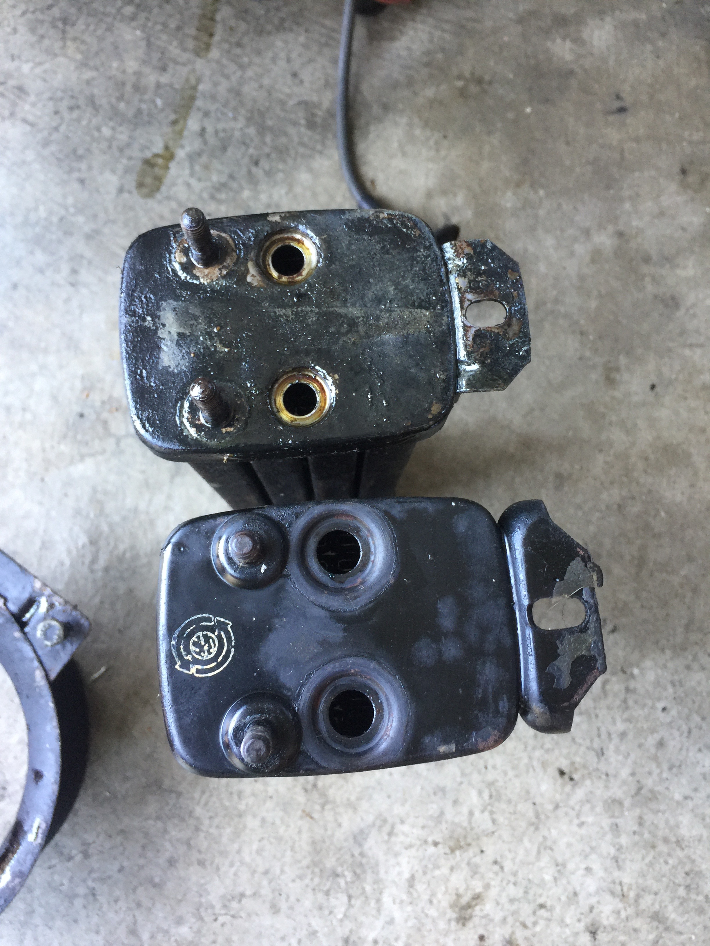

Anyway, these little 36HPers have the old 8mm oil cooler inlets. You can use the later 10mm coolers, but you need to use the right adapter seals.

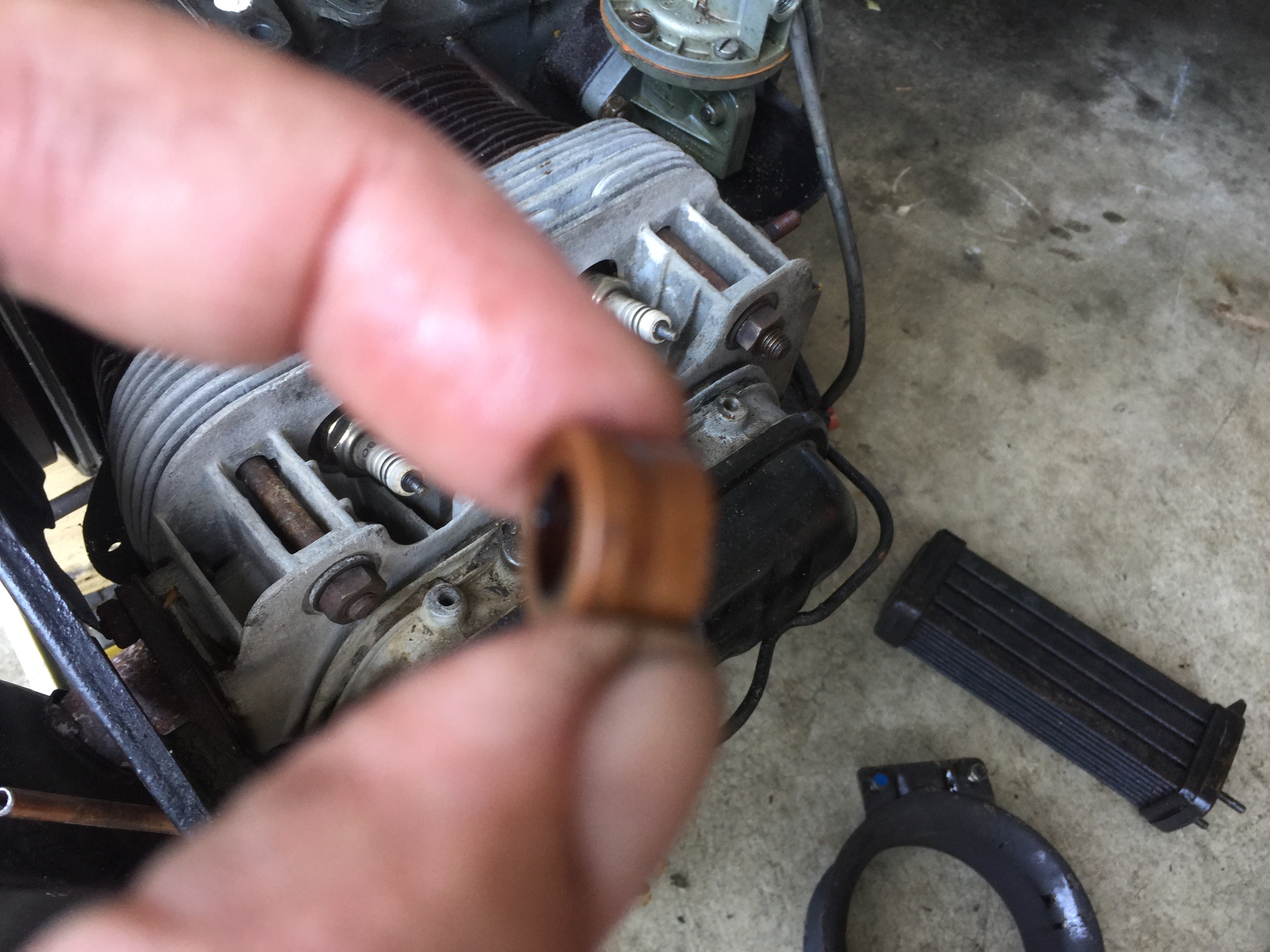

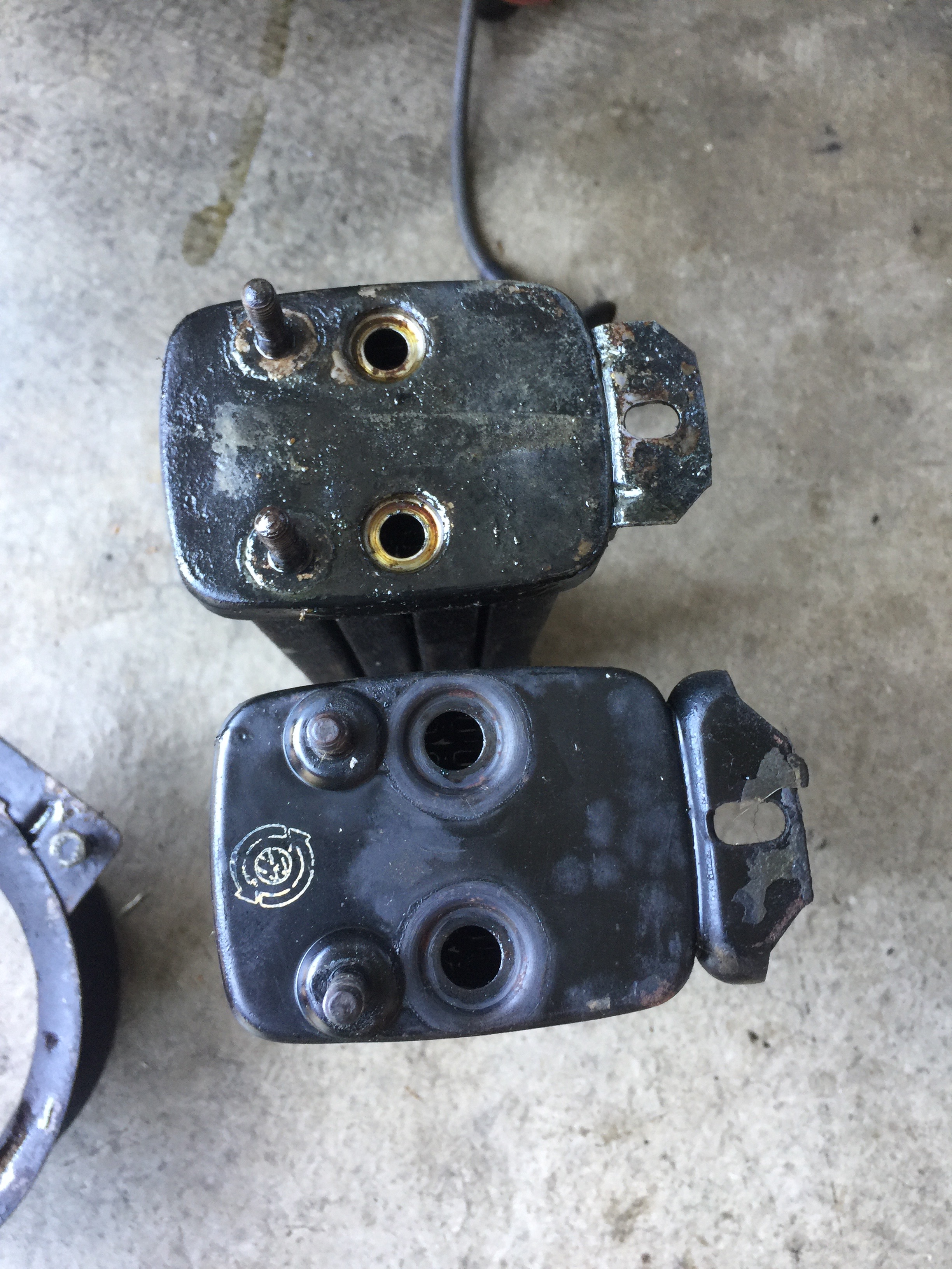

So I pulled the motor on this enjoyable 4th of July and got into what I thought would be a cracked or compromised oil cooler seal(s). But to my surprise both seals looked good and were plyable. The nuts seemd to be the right tightness and I had no issues prior to the sudden leak. Could it be the oil cooler itself? The block?
Anyway, the case looks ok around the mounting location but I don't have a torch to check it. Maybe thats a good thing! :lol: The bottom of the cooler was wet with fresh oil, so it could be the seals were loose? Or maybe the cooler itself s bad. How often does a cooler go bad? I have many of these early coolers, but don't really remember which ones are, or were, any good.
Is there an easy way to check them? Can you just plug the inlets and drop them in water? Do you need to pressure test them? How do I do that?

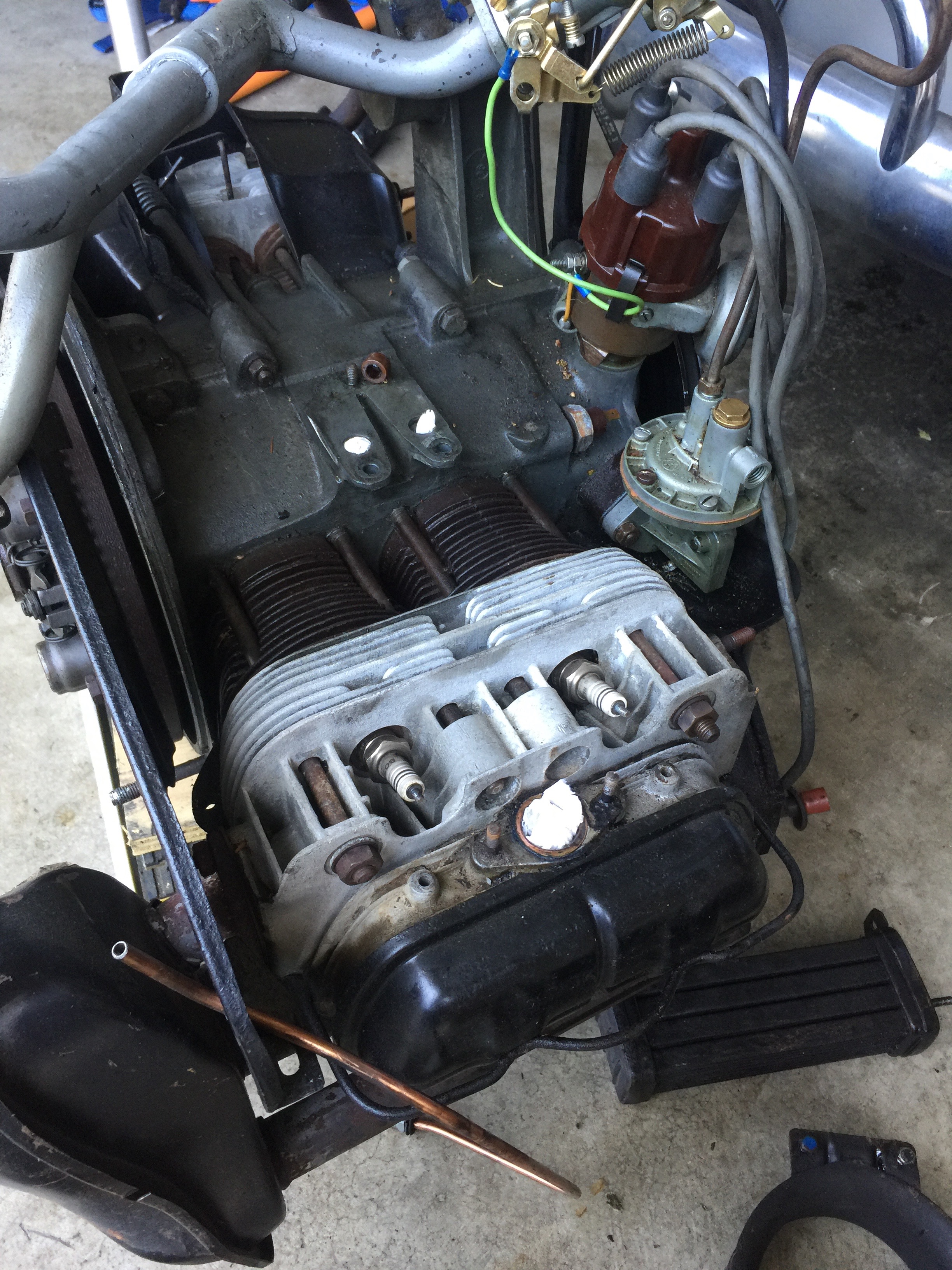

Motor out
You can see how #3 and #4 cylinder were getting soaked.
Seals semed to be ok and were still plyable
Bottom 1/4 of cooler was soaked.
You can see the difference between a 8mm cooler and a 10mm cooler here.

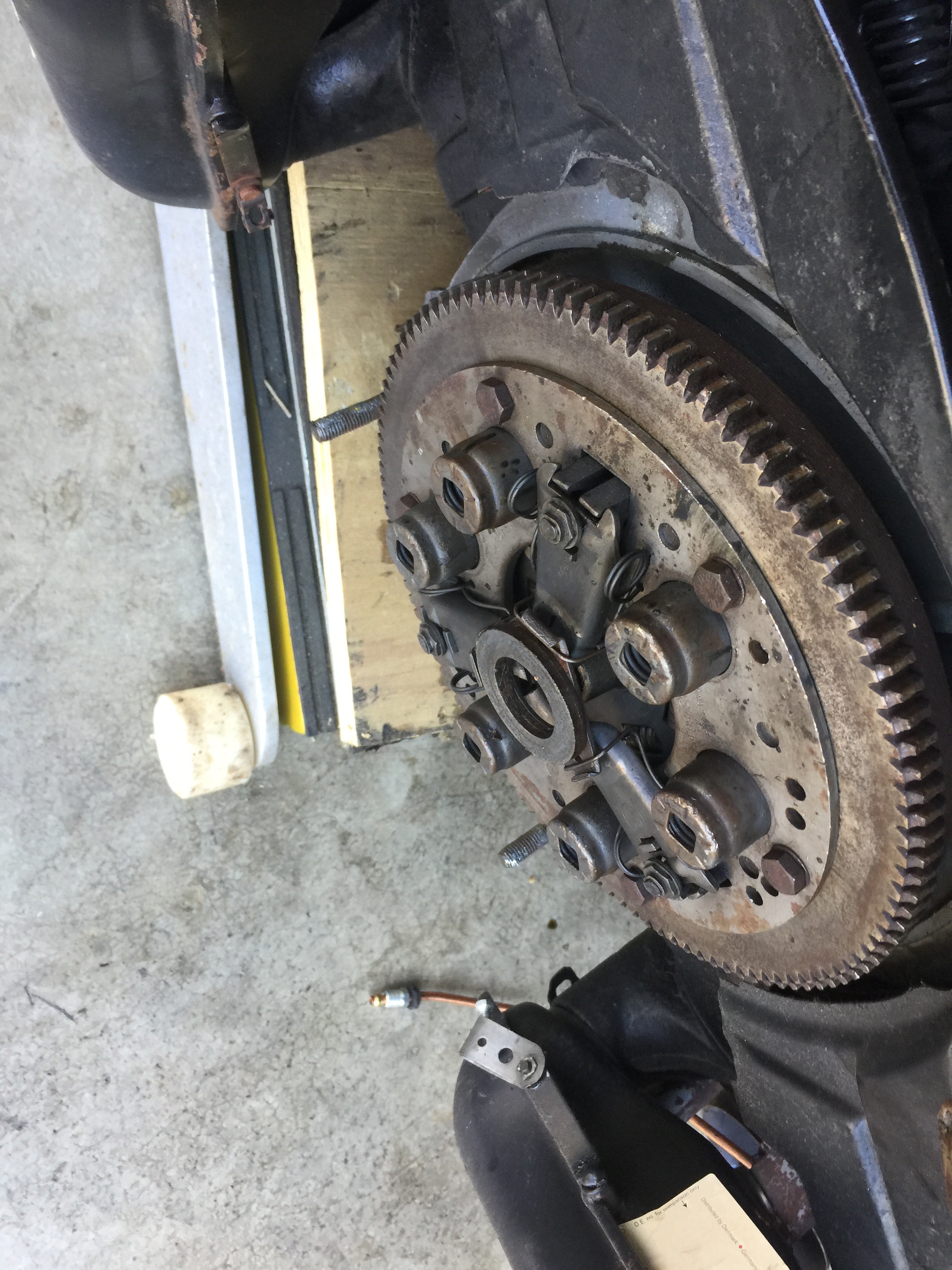

Pressure plate isn't wet
But I've got something going on in bellhousing. Tranny fluid? or oil?

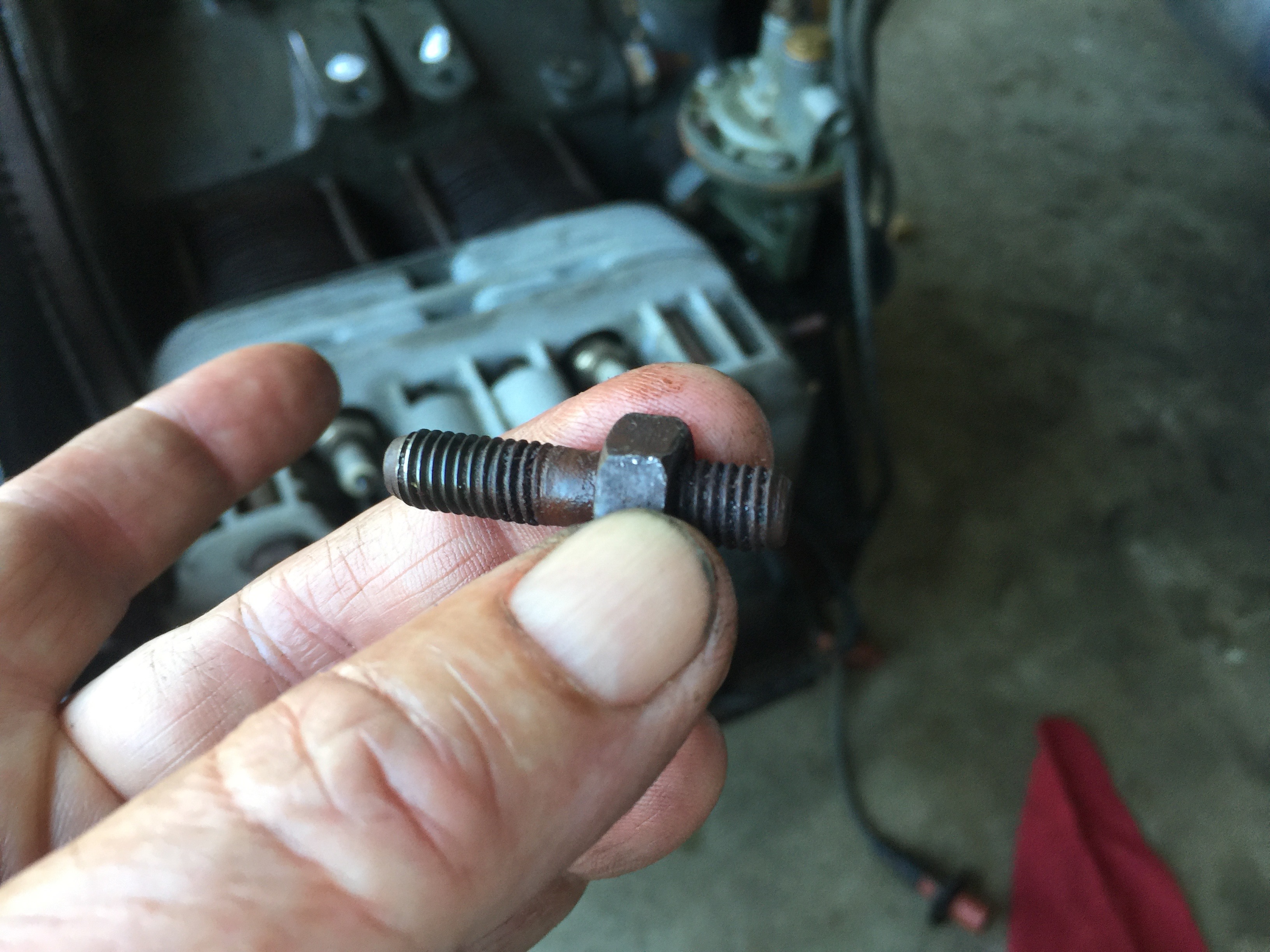

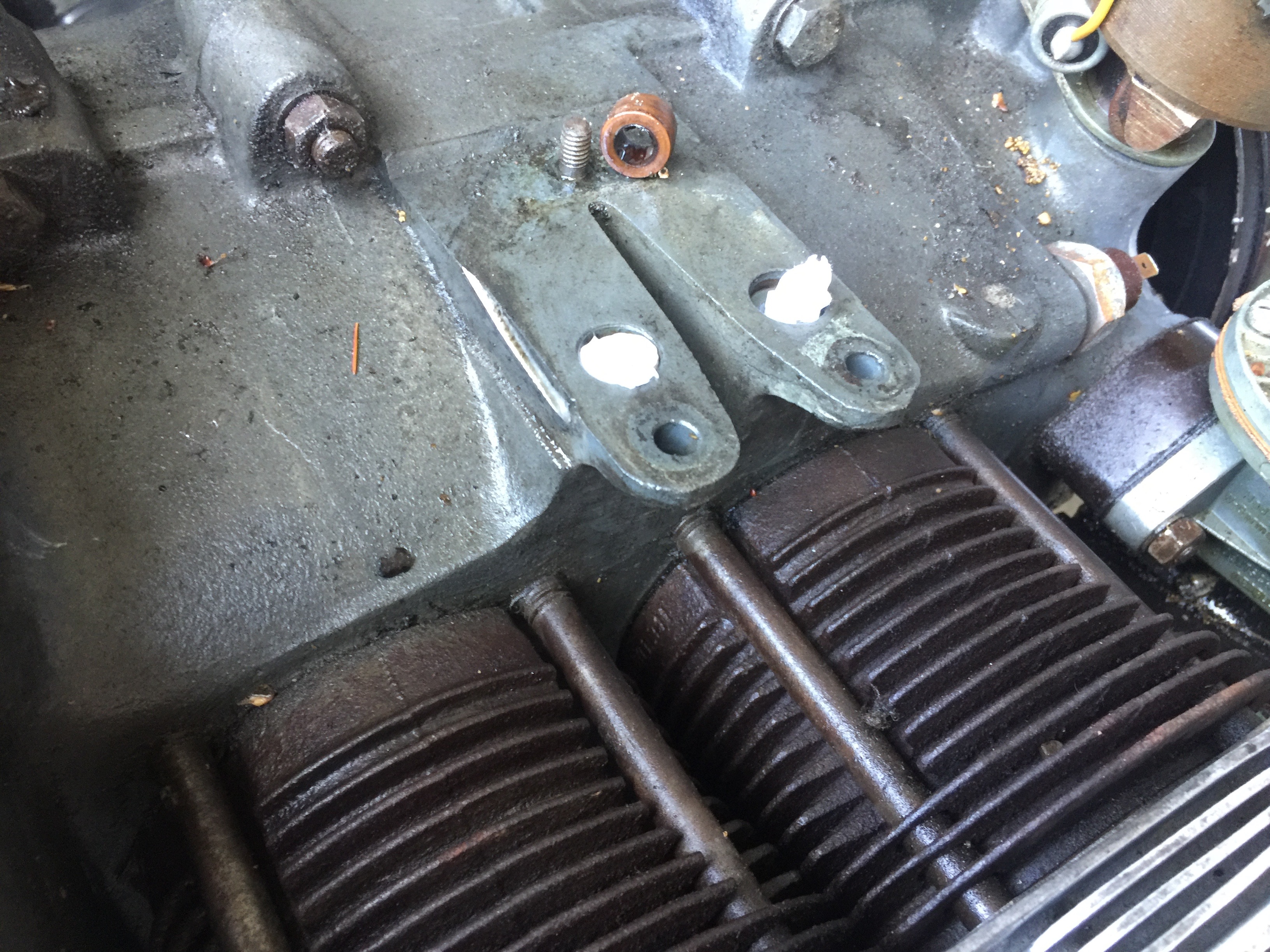

I had one exhaust stud pull out. Gonna need Chuck or Bruce in that! :D

In my experience, if the cooler is wet it's the cooler as airflow won't bring oil upwards if the seals are leaking. If you want to bring it out we can do a hillbilly pressure test of it. I'd change the cooler and probably the tranny shaft seal too. If it's the same as later trannies I should have it.
