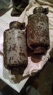

Do you know what diameter heater box outlets you new engine will have? 50mm or 60mm, this will make a difference when trying to install the exchanger to body heat tube. Your body side should be 50mm and depending on the exchanger used it is probably 60mm, you will need to make a reducer to have the heat work. I had some made at a muffler shop for a few bucks, we just found a pipe that the heater tube fit and expanded the other side to fit the exchanger outlet. Even if you don't drive in the real cold weather heat is a good thing to have working if needed.
Posted: Fri Jan 01, 2016 4:29 pm
by wwebner
I get quite good pricing on these. In fact,I think I was supposed to get you a pair(Marla)
http://www.airheadparts.com/vintage-vw- ... dy-ducting
these will no longer fit for you,unless you do something like toolbox mentioned and get an adapter to mate them to the 1600 heater box outlet.
