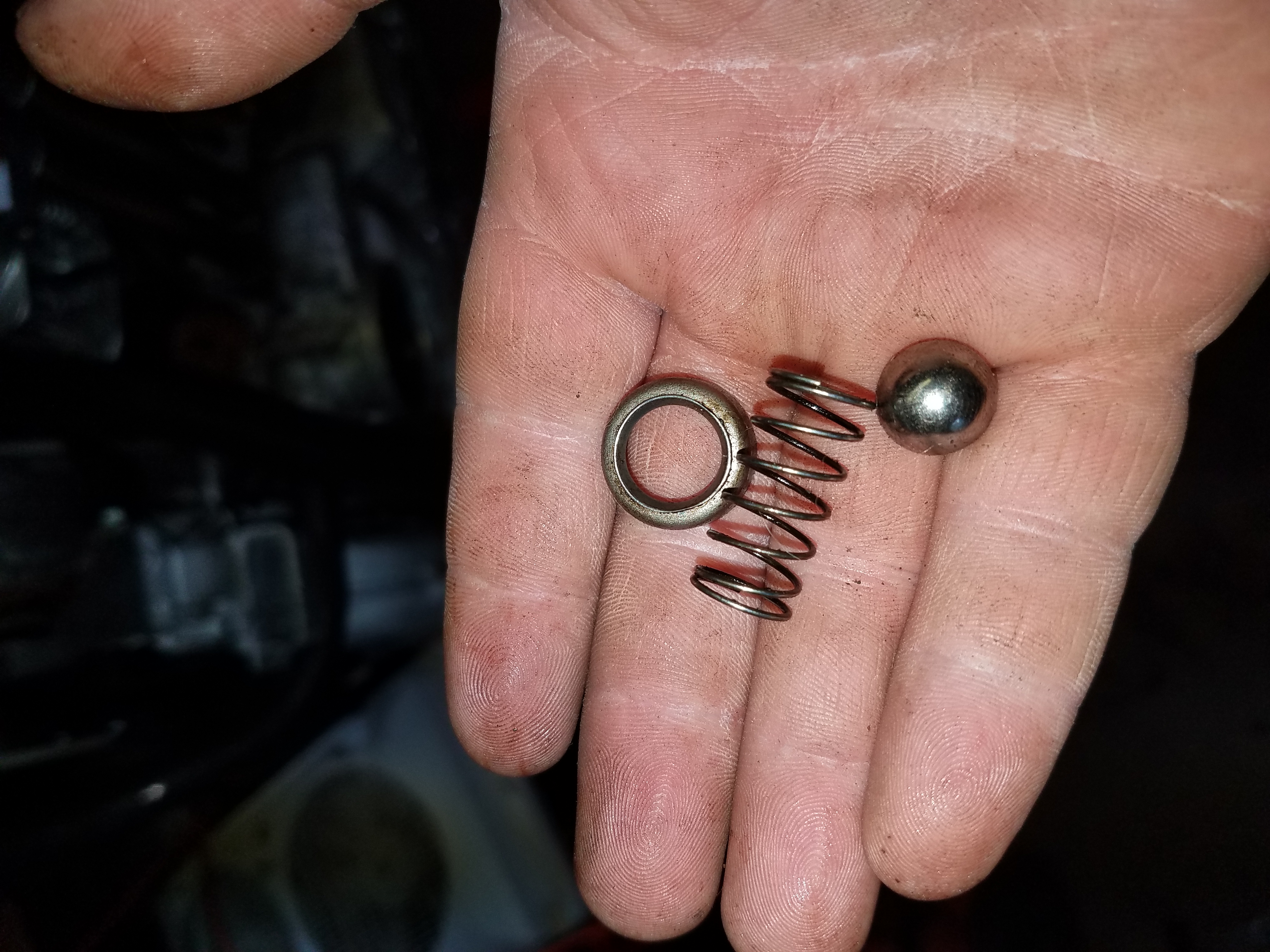

Where does this belong? I checked the oil pressure relief valve and everything was happy there...
- Posts: 309
That is your oil filter bypass valve/relief it's part of the spin on oil filter mount (or it used to be) kinda important if you want your oil filtered,it shouldn't have come loose, you may be able to reinstall it and stake it in with a chisel/center punch or you can replace the oil filter mount (you know where to get one if you need another)

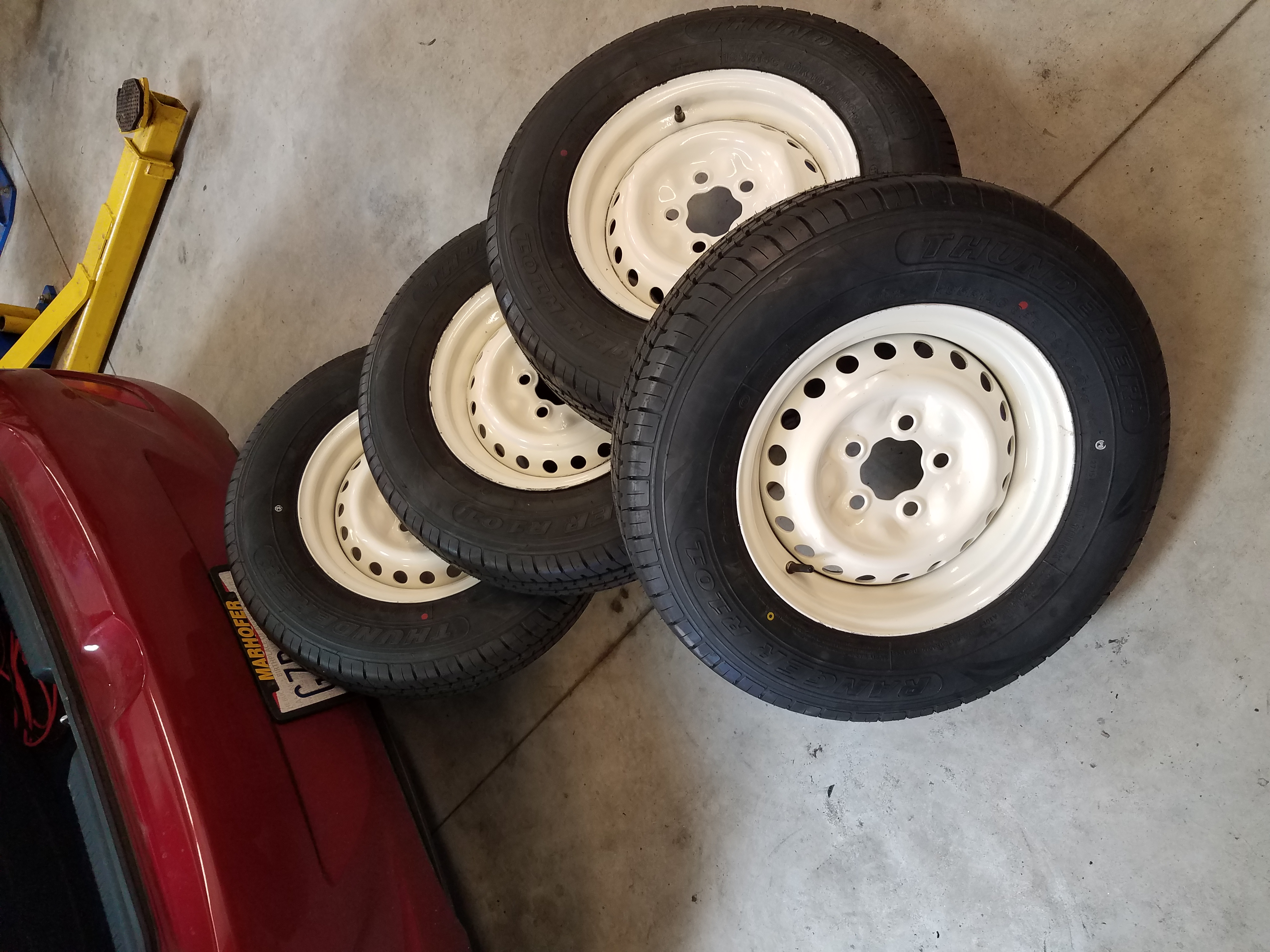

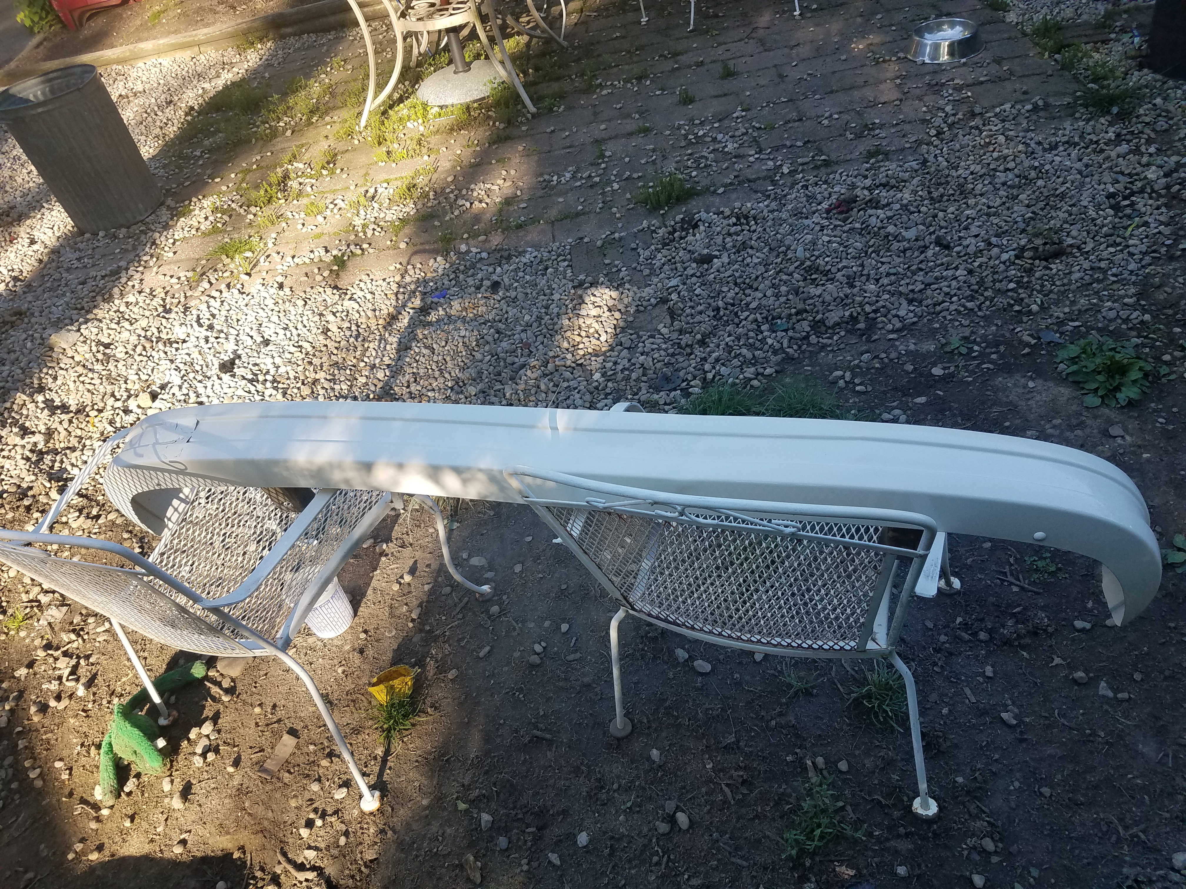

Threw a really crappy coat of rustoleum primer, then paint and clear coat on my wheels and rear bumper because i was bored one day. Hardly any prep work and no sanding between coats but it looks alright from 30 feet away at 30 miles per hour.
mounted my cheapo tires today. Thunderer ranger r101. Seem to get decent reviews and it was $308 for 5 of them with tax and next day delivery

Ugh... white rims on a bay... really?

They were already painted white. Just really rusty and crappy looking. Eventually I'll have them painted or powdercoated the correct L91 paint but I had the white paint just laying around.

I think they look great Austin. Nice shiny white paint, how can you go wrong?
