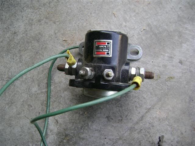

Keith wrote: The old 6V Ford solenoid trick, explained in rich detail with a Peter Aschwanden graphic in the John Miur "Idiot Book", will help, too.
Ditch the Ford solenoid, it takes almost as much current to trigger as the stock unit. Use a Ghia 6V horn relay or find a 40A 6V foglight relay.

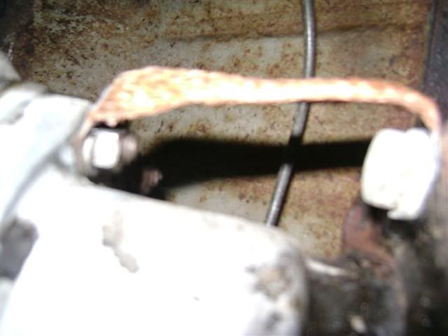

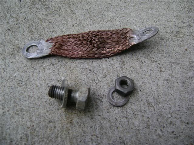

Here's the update. Cleaned tranny ground strap. Problem not happening as much. Tried to start it about 6 or 7 times it only did it once. It's probably the starter. In any event, here are some pics for newbie's like me to help with finding and cleaning your tranny ground strap.
Very dirty...
Even the Cat said it was bad...
They clean up nicely with some elbow grease...
It's important to clean up the area they connect to on the body and tranny...

KYLE wrote:That ground strap looks alot ahorter than 9". If someone could get me the exact length (center of eyelet to center of eyelet) I could see if I can get some that are an exact match.
Kyle, that strap is only about 5", but I'll measure it this week and let you know on Thursday.

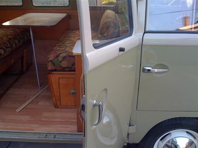

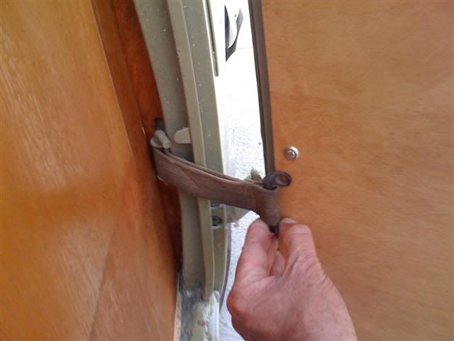

Since we're talkin' about straps, what about the cargo door ones? I found a bag of them, but they seem too small to work right. I'd like to think they would allow the cargo door to be open 90 degrees, or staight out. The straps I have seem to only let the door open partially. You can see the last photo shows the maximum amount "open" I can get the door if I mount the bracket in the most generous location on the door. Will they stretch? Am I using the wrong ones?

I think your straps have shirnkage...they must have been swimming in a cold pool!
Honestly though, those are the correct straps for the doors...no one really seems to use them. They do seem to shirnk up sometimes.
They seem to be meant to keep the front door from whacking the front cargo door when passengers get in or out at same time.

Thanks for the info Todd. I want to use a strap on the right cargo door becasue I have those elephant mirrors on the front cab doors that the cargo door hits when opened fully. Maybe they'll stretch back with a litle use.

Sean, I checked on my buses today and the straps seem to stop the door in about the same place as yours but if you put some pressure on the strap or toss that door open (which I think folks used to do) the strap stretches and seems to about 90 degrees which JUST keeps it from hitting the front door if it is opened up at the same time.

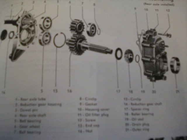

Yea, its time. I've now got leaky RGB's, but who doesn't? :lol: I'll fix them this winter. Just keep adding GL-4, (or was it GL-5 ;) ), in the meantime! :lol: I'm hopefull someone can 'coach me up' on the rgb seal replacement at Thursday's gathering.
When you're ready to change those RGB seals I'll be glad to coach you. I've done them before and I have a 250 ft-lb torque wrench to tighten the axle nuts. You can also use the lift at Meister Rd. which will make the job a 'piece of cake'. You can actually do this job in a couple of hours while sitting in a padded chair. Maybe we can do a mini tune-up day if others would like to see it done. :D
