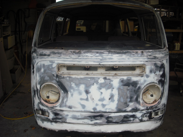

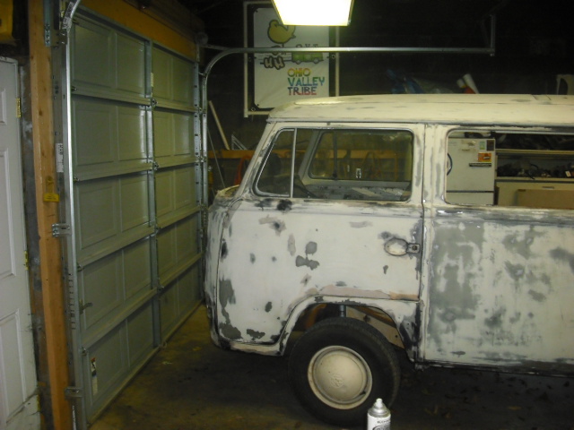

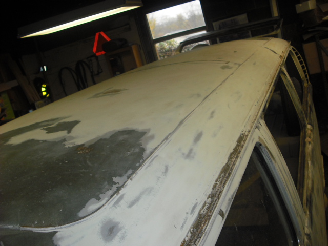

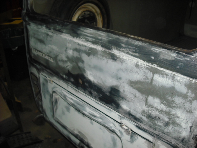

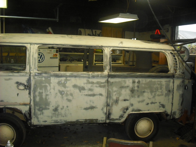

Pictures of stripping process.

I think I finally got the sanding and filling done today. Brad is coming over Sunday and get it primed. I was going to paint it back to lotus white but leaning towards neptune blue right now. The only white on it is the inside of the cab and engine compartment. Since it is going to be a daily driver and not a resto, it wouldn't matter that much.
