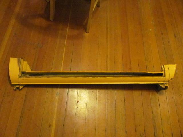

Nice OG rocker. :D I can only speculate as to what happened to the bus that was able to offer that as a donor piece. :lol:
Re: Emily, my 1968 Colorado Westy
Six Volt wrote:Nice OG rocker. :D I can only speculate as to what happened to the bus that was able to offer that as a donor piece. :lol:
Thanks Sean. I was happy as hell to find it. The 76/77 donor bus was cut up ~15yrs ago in AZ. This is going to save me a ton of money on new metal. Plus it will save Dave countless hours of trying to put ill fitting new inner rocker, slider track, outer lower rocker, and B pillars together.

Wow, what a find!
