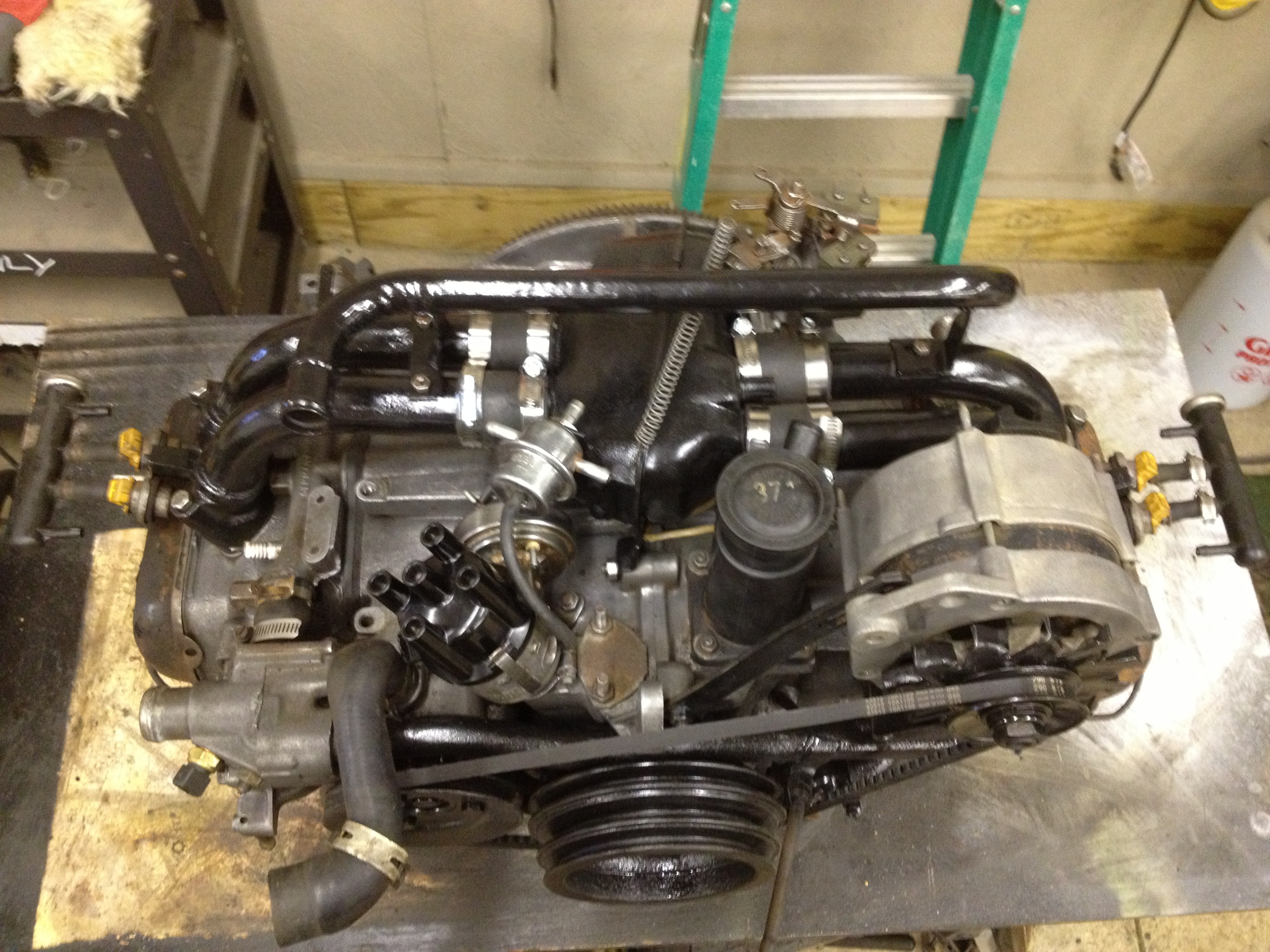

Ok so another memeber had trouble with his engine, bought a new engine(which i tracked down thanks to patrick) from another memeber. So i had the Vanagon hauled to my place and did a engine swap. You can see the engine(old) sitting on the dolly to the left. After that bus was returned to its owner i began working on the old core. Tore it down, put new rings on it, swapped the og heads for some newer ones in better shape. Replaced all the seals all the vaccume lines all the gas lines, polished all the nuts and bolts and now i have me a nice engine :-). Tossed it in my 84 and it went. So my vanagon is currently my daily driver. Welded flex plate and all. Daily driver... I even adjusted the afm to squeak alittle more mpg out of it. Im getting about 19 highway 17 city. I think its capable of closer to 20-22 mpg, but fine tuning will prevail that in time i suppose..... Now, back to the splitty. Also i should mention the day i got this vanagon running again the turbo went on my car. It was godsent :-)
