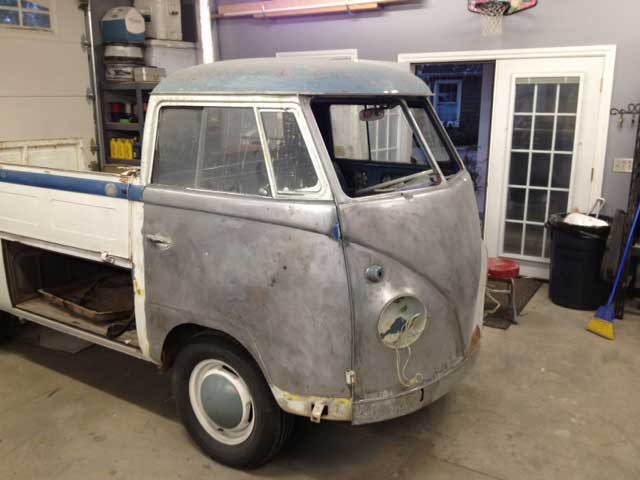

Re: SC
I cant wait until all this stripping and sanding is over. UGHH
