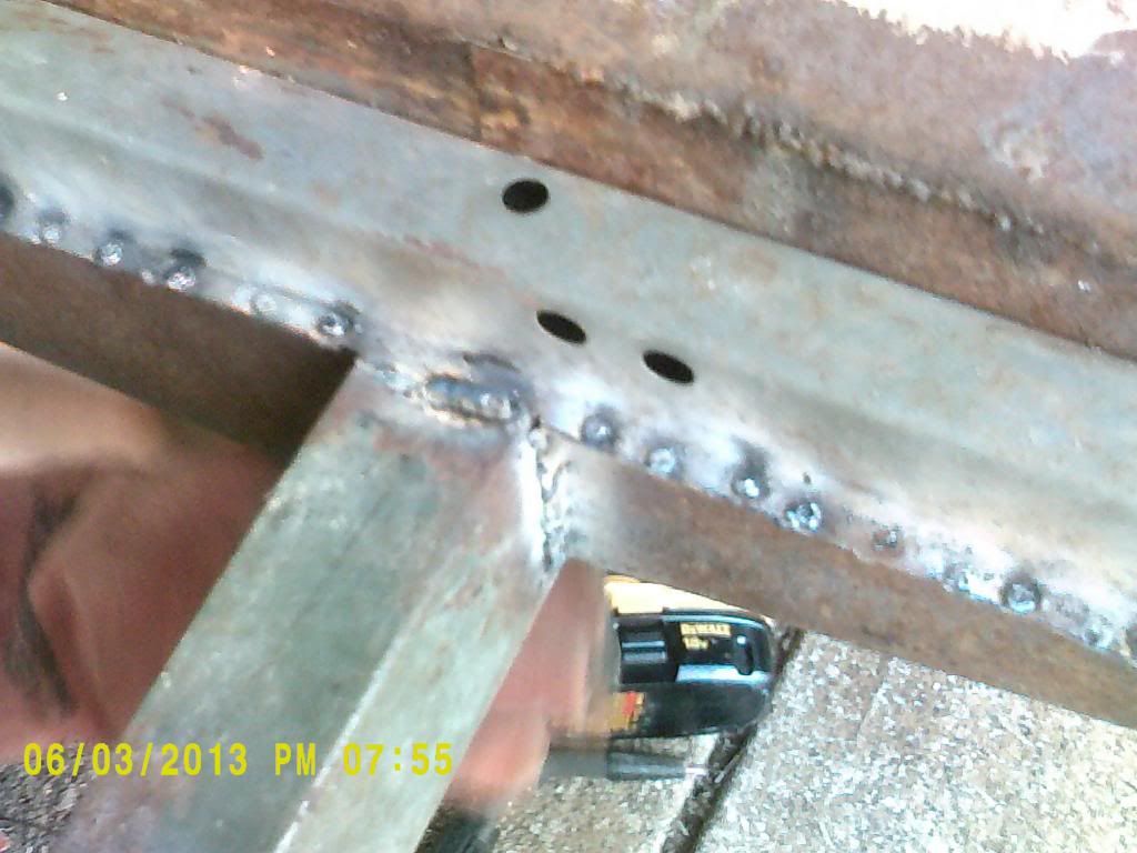

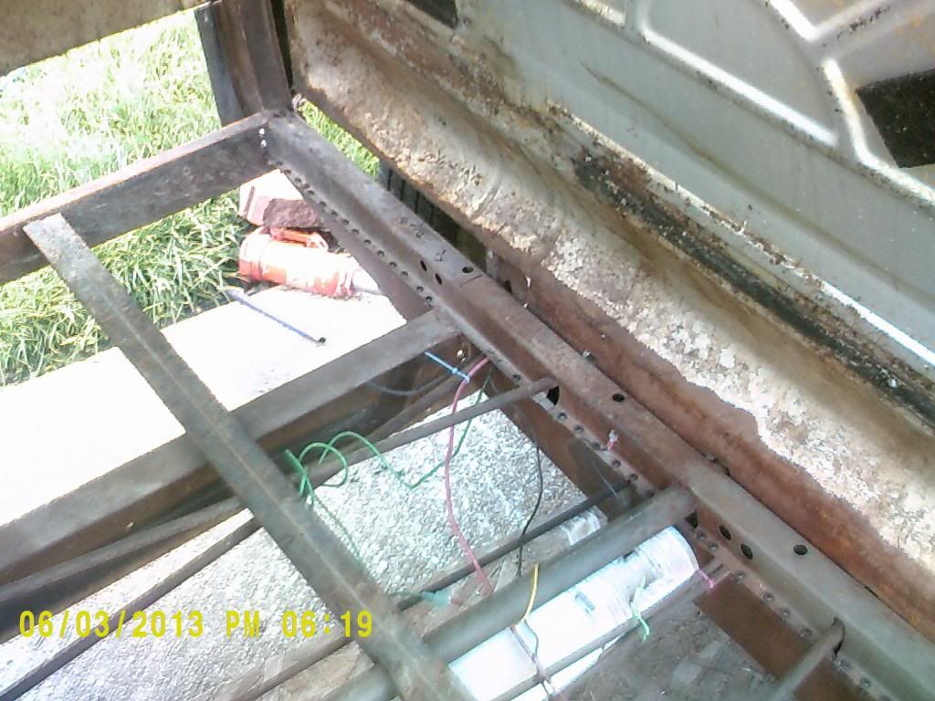

First off, hours. I put in 4 hours after work, and my brother 3. for a total of 7 man hours. That puts the total at 103 hours

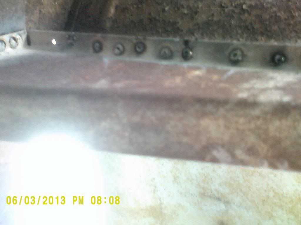

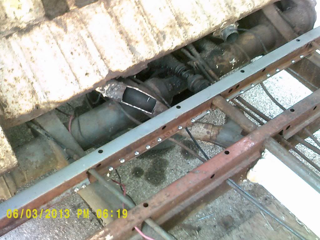

Today was a little bit more productive than yesterday, I started off by screwing around

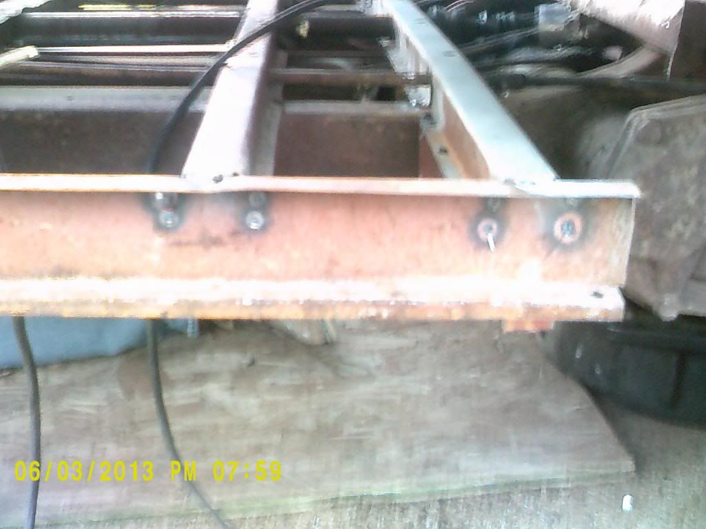

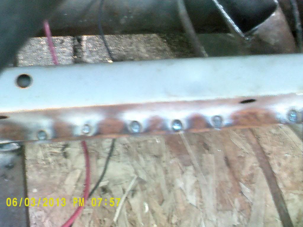

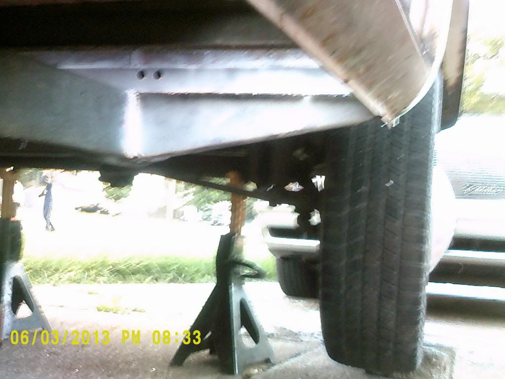

I screwed the top hat sections together from where I had to split them to fit. Then I pulled to screws and plug welded the holes to join the 2 separate sections together
While I was under the van, I discovered that the cross member that runs under the front bulk head was not welded. I was simply just shoved up there, and the heater tube was holding it in place. So that got welded up also

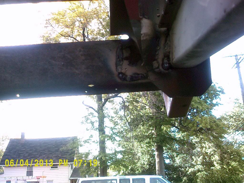

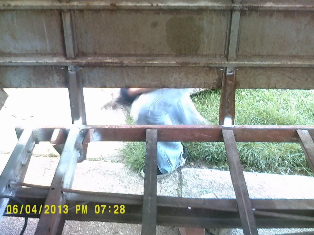

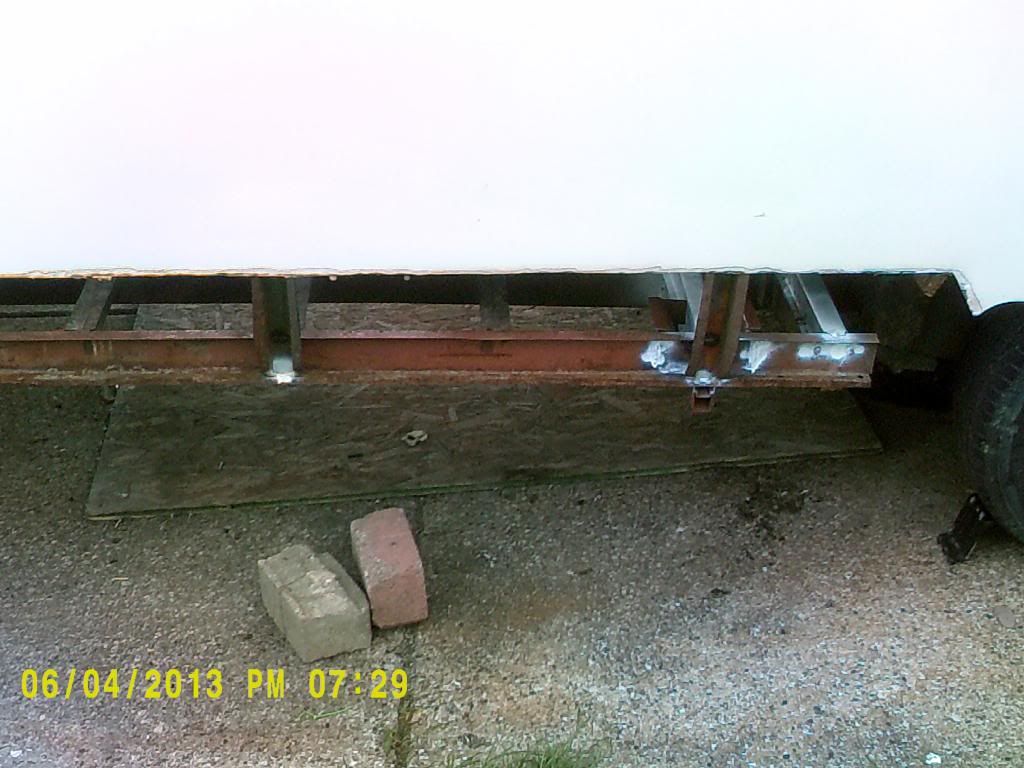

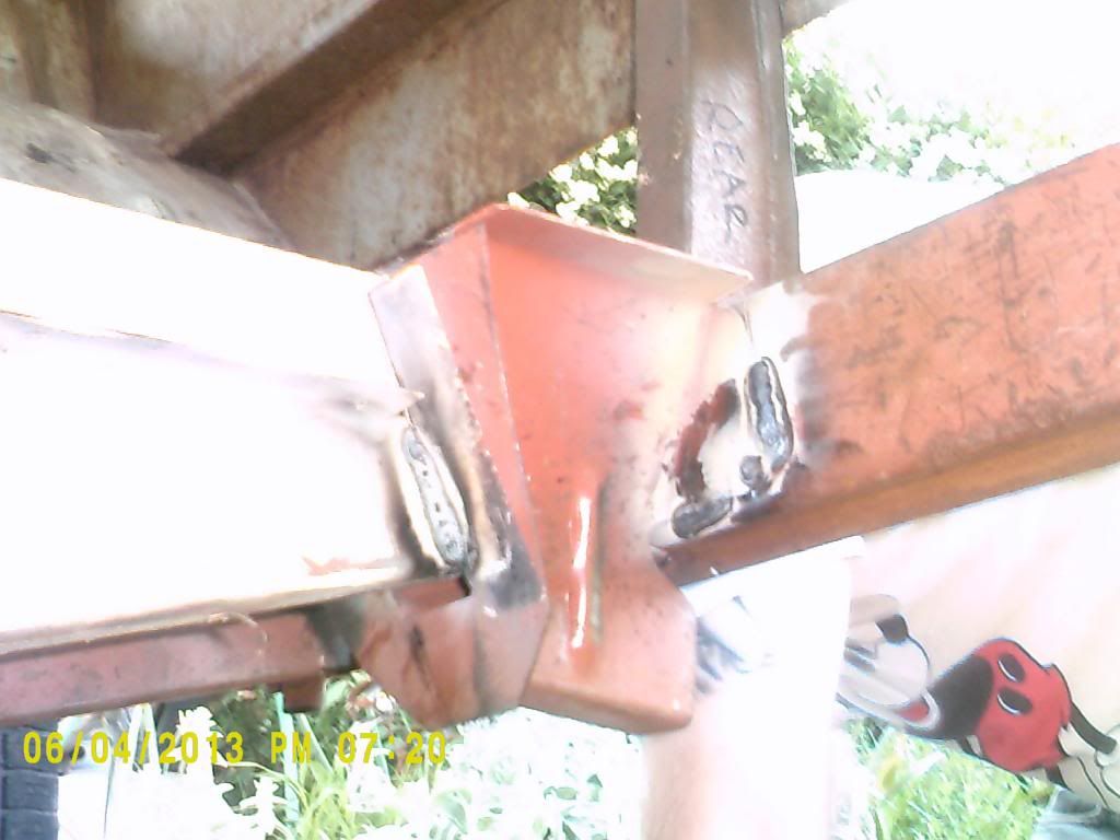

Re: 1961 Microbus
Cross member welded up
4 outriggers installed
Since I had to cut rear most hat channel, and since I had 2 extra outriggers, I decided to cut outriggers down some so the would fit the rear most hat channel.
I know its not factory, and I know I "probably" would be fine now that the channel is welded back together, but I wanted that extra bit of assurance
My plan for tomorrow is to get the 4 jack points installed, and if that goes easy and quick, I will start on the long side c pillar bottoms.

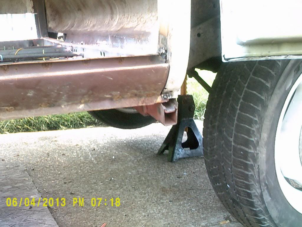

Started out today by installing the 4 jack points

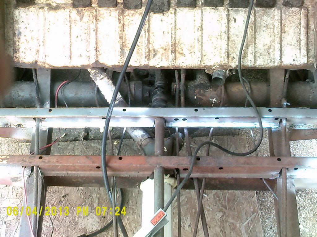

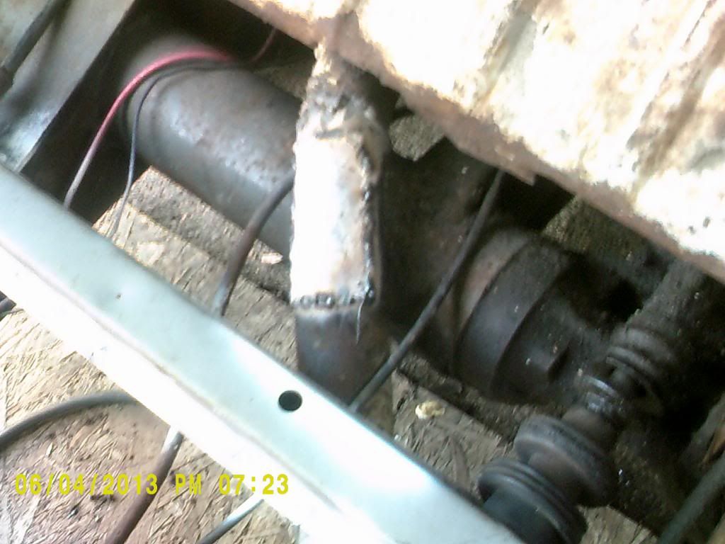

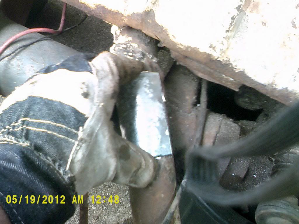

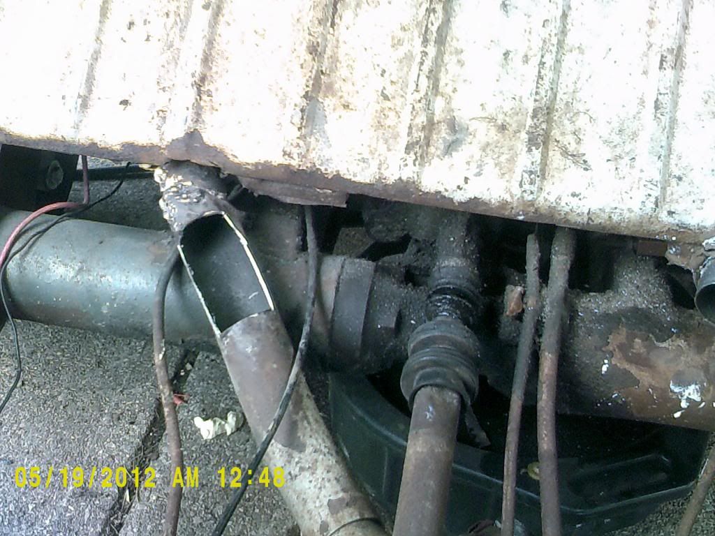

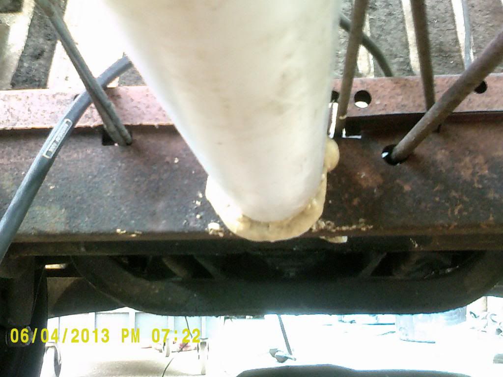

Then I patched the hole in the heater tube
Still need to replace this stupid PVC pipe with metal tubing
And have to figure out how to run my heater log. I assume that I will need some sort of "Y" or "T" to branch off of. If anyone knows the proper way, or has a good photo of how it is "plumbed" I would appreciate it.

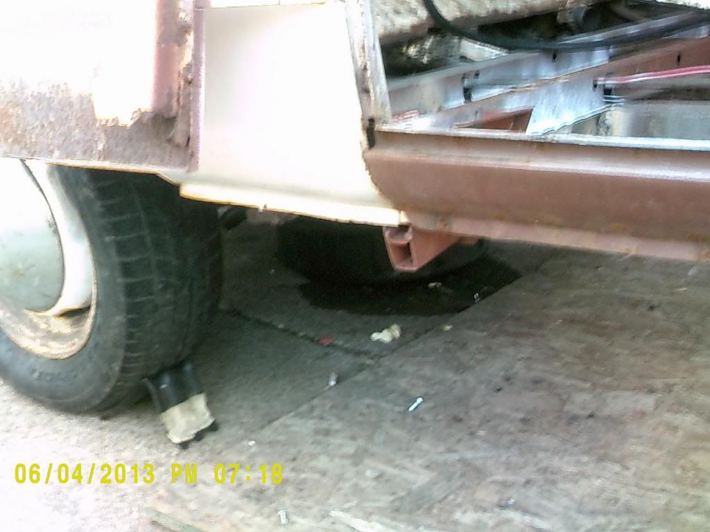

Finally I finished the night off by tacking in the bottom "c" pillars on driver side
Image.
I still need to get a bottom inner for the rear cargo door, and bottom door skin, and finish up the areas around the rear wheel wells, then I will be ready for a floor.

Re: 1961 Microbus
Nice work.
Here's a couple of pics that might help on your heater setup:
http://www.leakoil.net/forum/viewtopic. ... 8&start=20
You're missing a piece that curves and goes through the floor to connect with the log, which is welded to the floor under the rear seat. The patch you put on the heater pipe is actually exposed inside the cabin as it sticks through the floor like a "bump".
Here's the best pics I have handy:
My heater log setup is supposed to be just like yours, they come several ways depending on whether you have rear seats and etc. I'm missing my heater log and looking for one. I eliminated my rear heater "Y" as it's not used (like yours is also not used) and put a simple 2 1/2" bent pipe in place, along with a 2 3/4" long pipe from Napa.
http://www.leakoil.net/forum/viewtopic. ... &start=140
Re: 1961 Microbus
Bruce,
Thanks for the reply, I have been keeping up with your build, but do not know how I missed that photo of the log on page 3, it is exactly what I was looking for. As far as the patched heat tube, and coming through the hole, it was my understanding that the floor panel fit "around" the tube and not over it. I was nicked, rotted, and filled with foam. I did the repair now, so when the floor goes in I would not have to monkey around with it.
I plan on replacing the PVC with a straight exhaust pipe, just have not got to it yet, wanted to do it and log at same time. I have the original (?) log that came with van. Its just a tube with ends and legs welded on it, and vent strips cut in, I can post some photos and measurements if you are interested in making one (if you cannot find).

The heat log is run off the left side heat exchanger. the L & R heat exchangers do not connect together anywhere on a Standard or Deluxe Bus, the Y is capped on the left side. Panels, Kombis, SC and DC send all the heat up front.
Re: 1961 Microbus
Toolbox,
I think I understand what you are saying. The "Y" in the rear crossmember is not used on my standard. It should be capped off at left side inlet. The heater log connect to the left side outlet (coming from engine bay). The right side heat channel (the one I patched) flows through to the cabin outlet at the front of the van. Left is seperate from right, and they never connect (only on sc/dc do they utilize "Y" @ crossmember).
Is my understanding correct?
