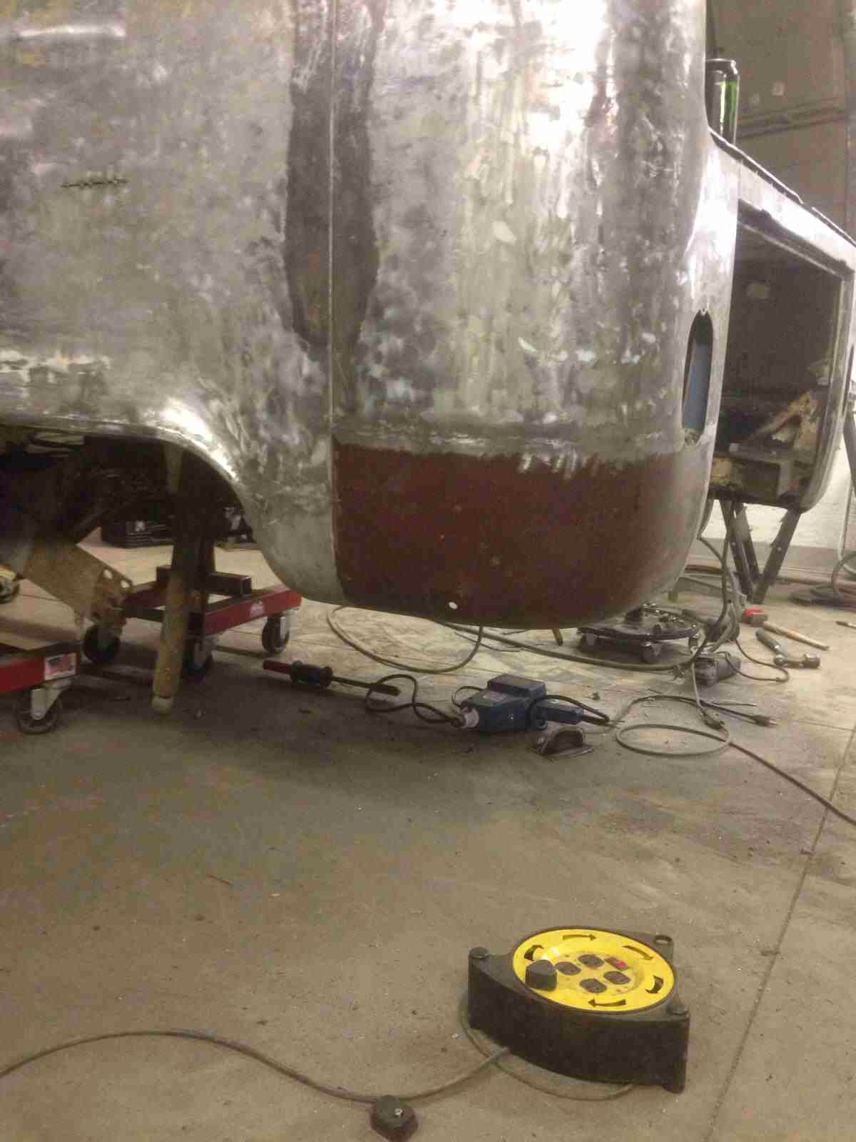

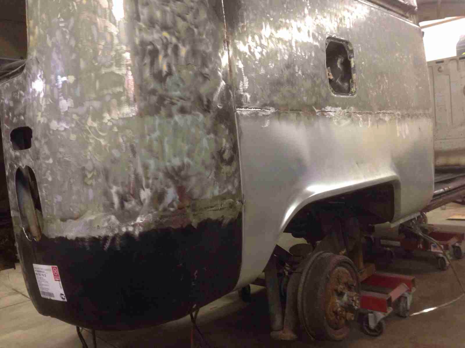

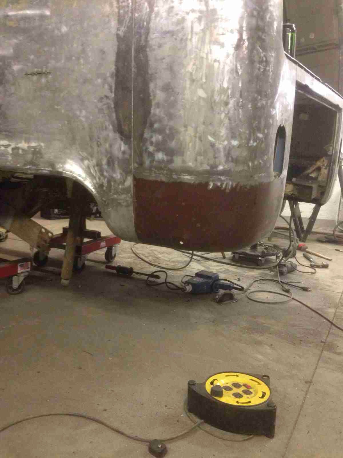

Made a useable seam out of the corner. Klokkerholm boo yay!!
Re: 1971 Early Bay Panel

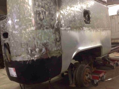

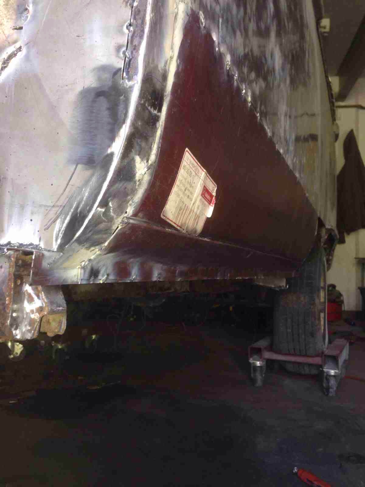

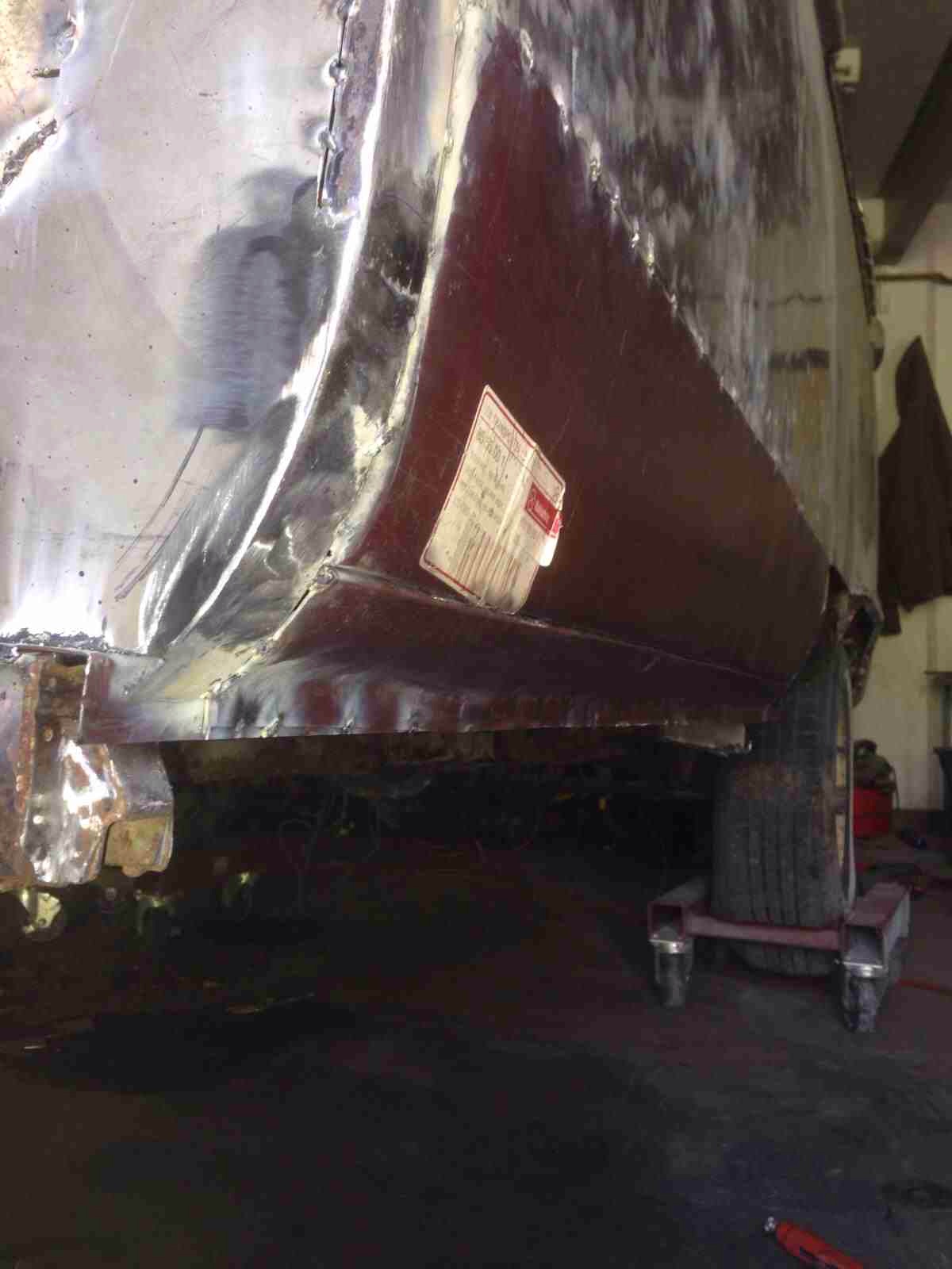

Corners in and i replaced that wall while i was at it.

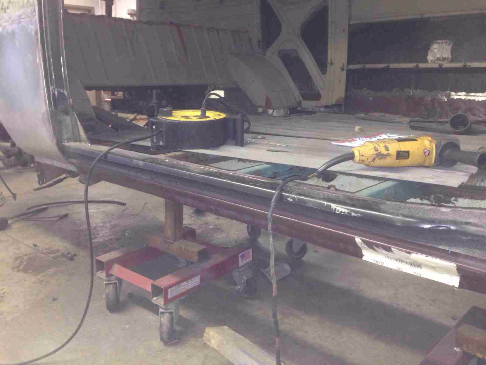

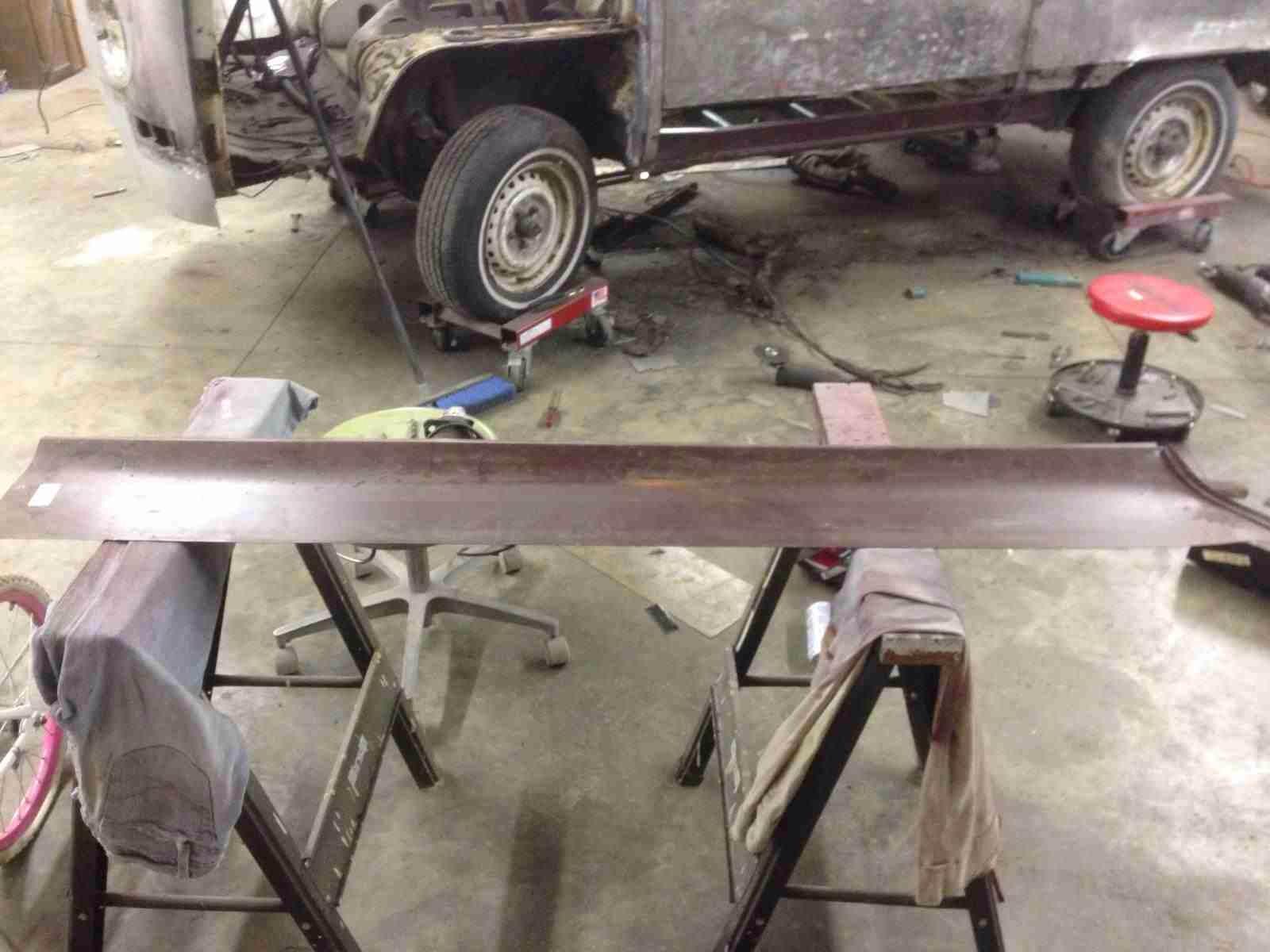

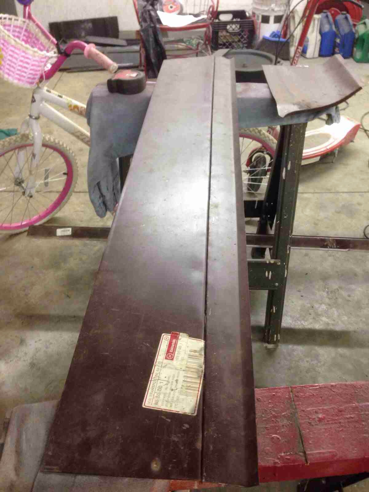

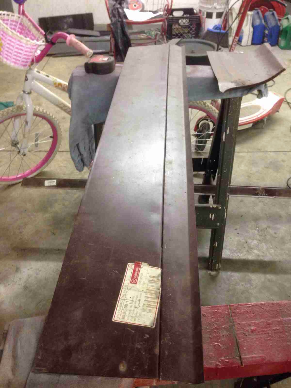

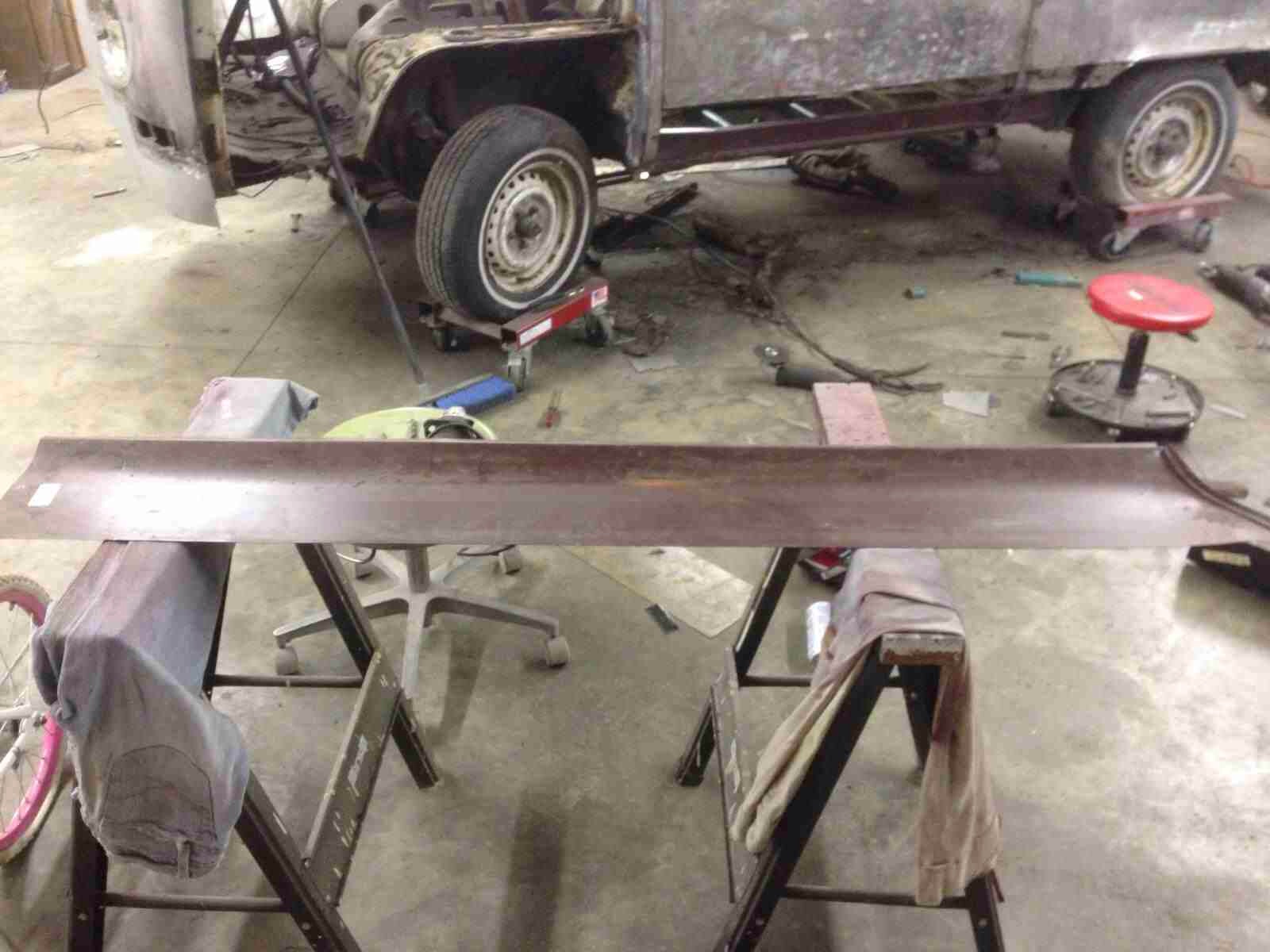

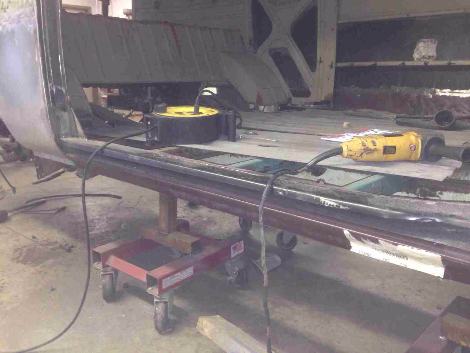

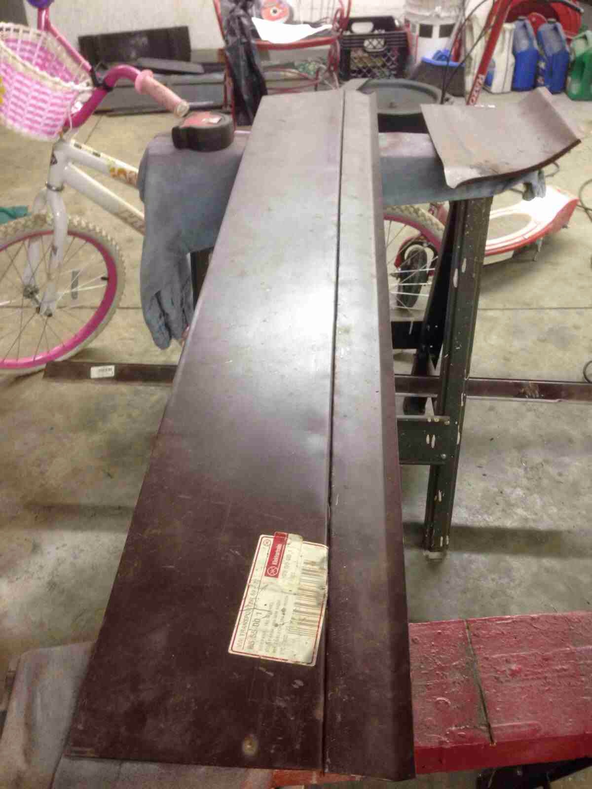

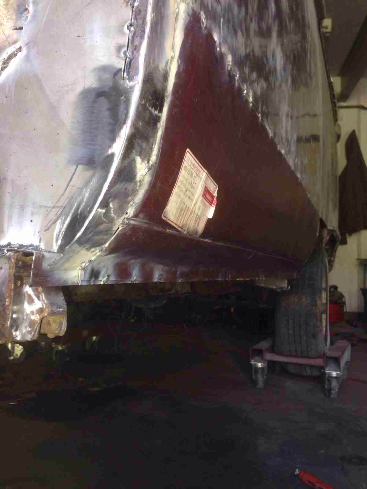

Then i did the long side rocker. The cheap panels do not have the seam in them so i made it by hand.

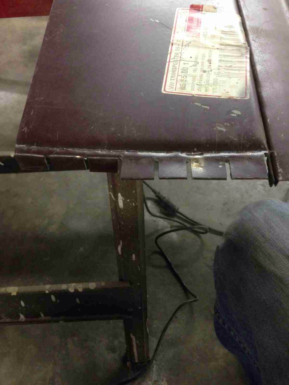

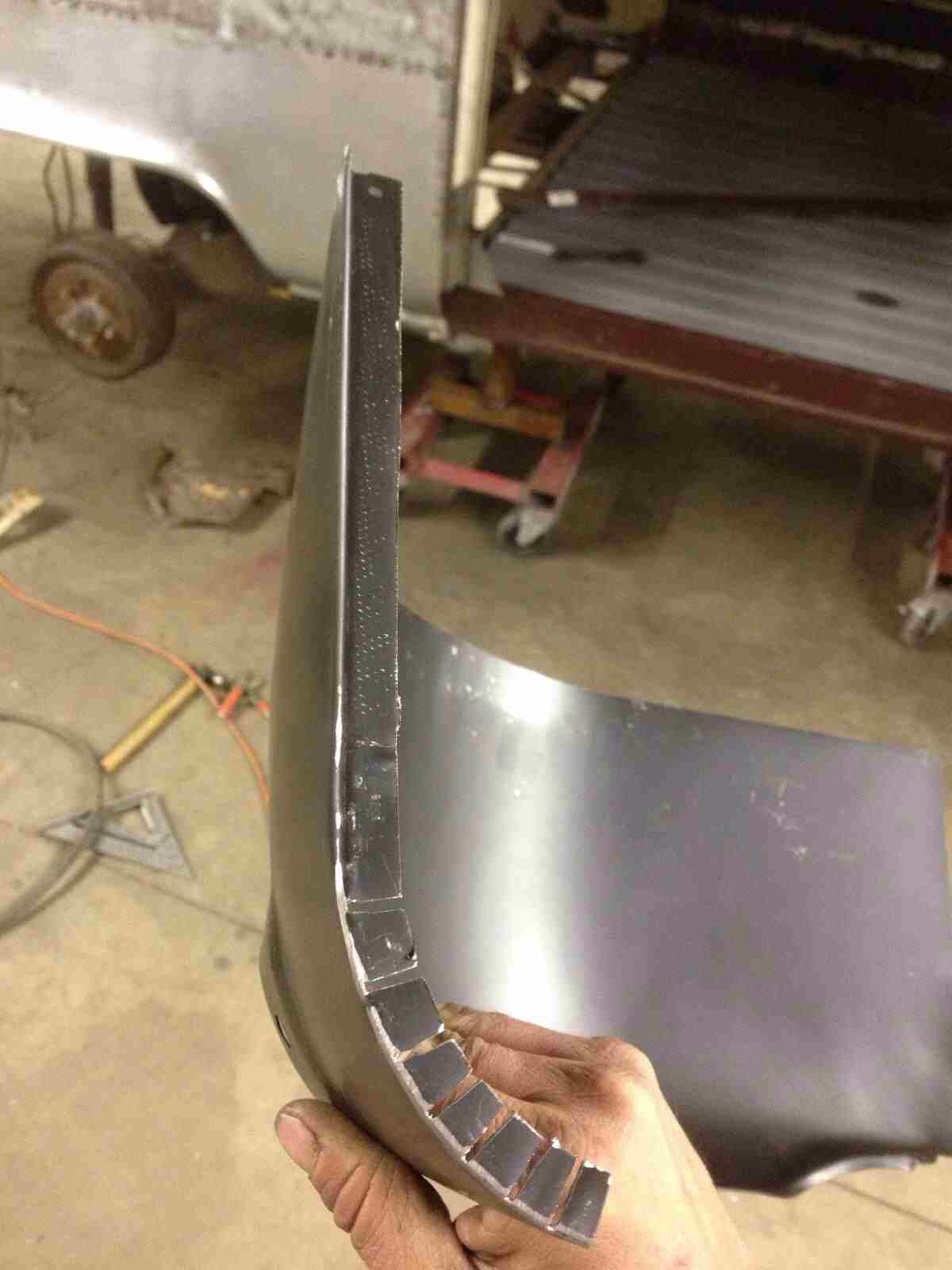

I cut it into two pieces and made 90 degree bends in it to create the seam.

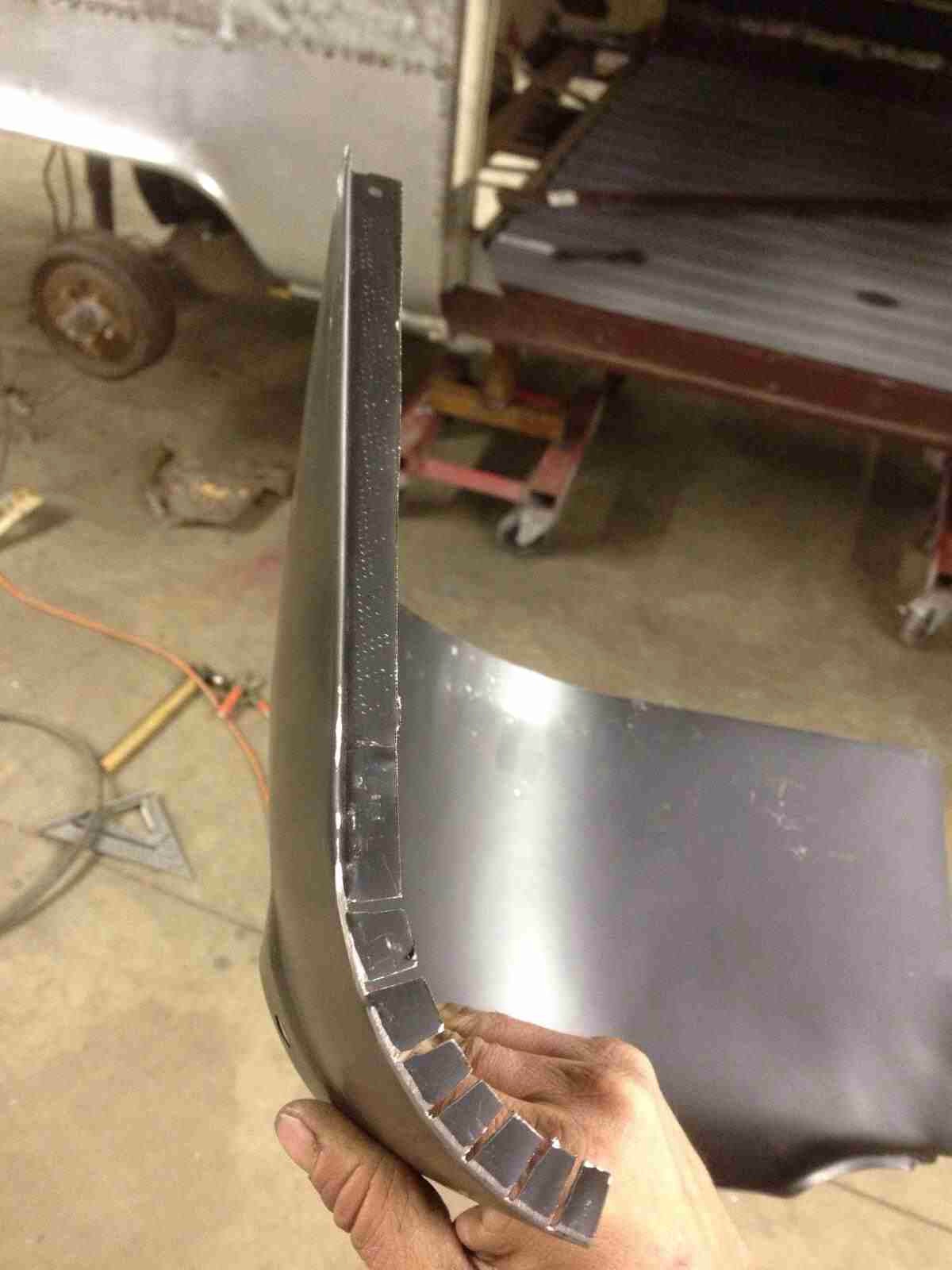

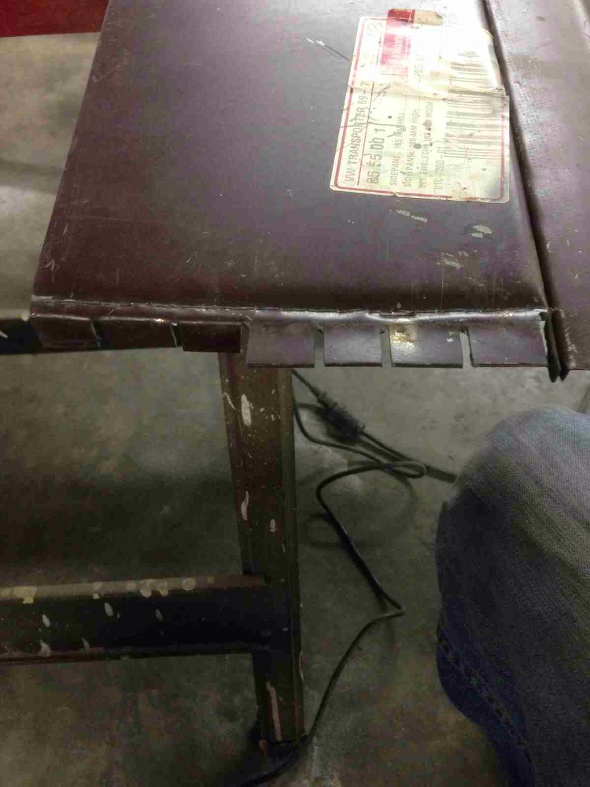

Then i recreated the panel wall seams by using a chisel to offset the sheet steel. I cut those slots in it so it wouldn't bind when i bent the radius.

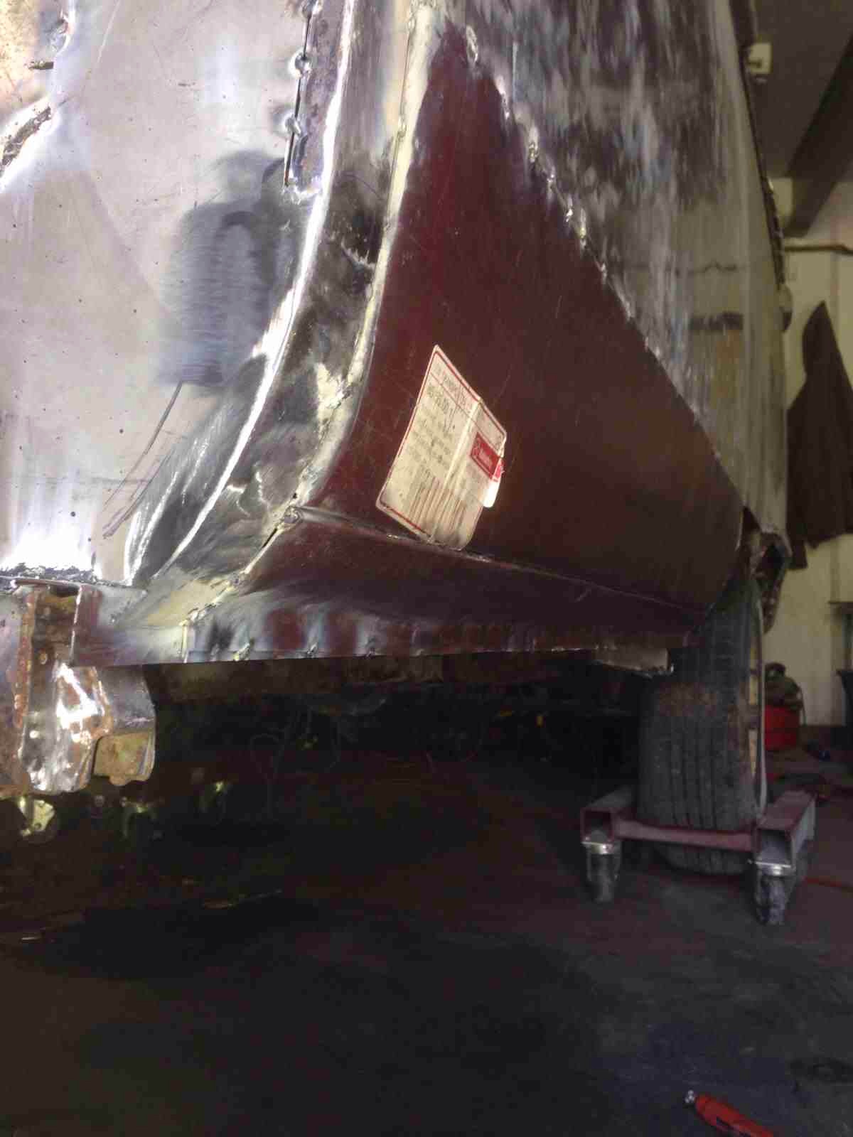

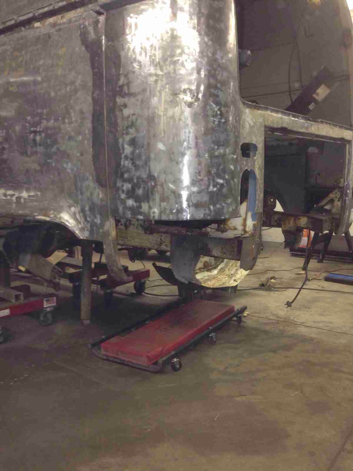

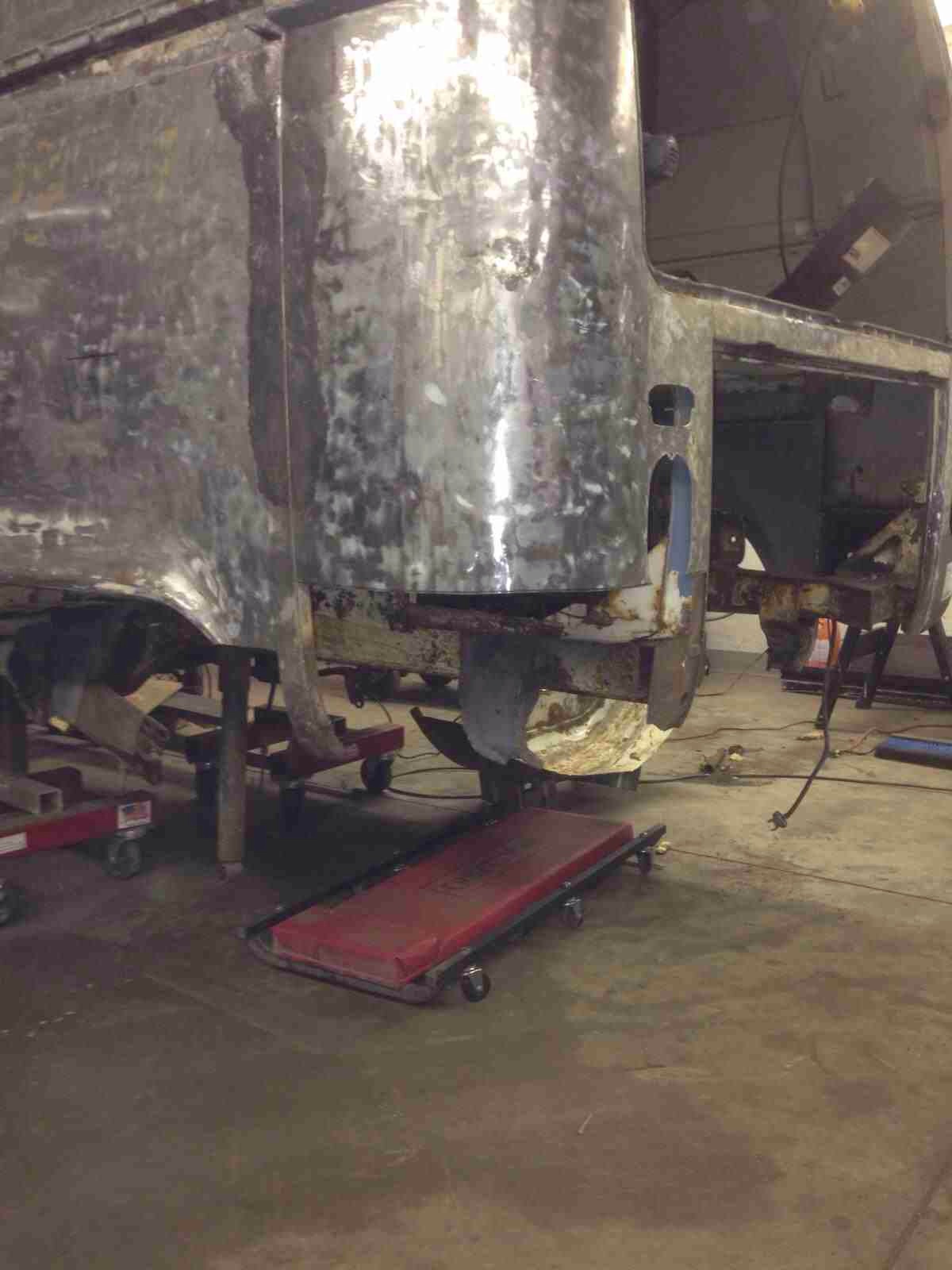

I rebuilt that B pillar by hand too. Here it was all fitted in. Looks alot better now that finished it up. This was done awhile back.

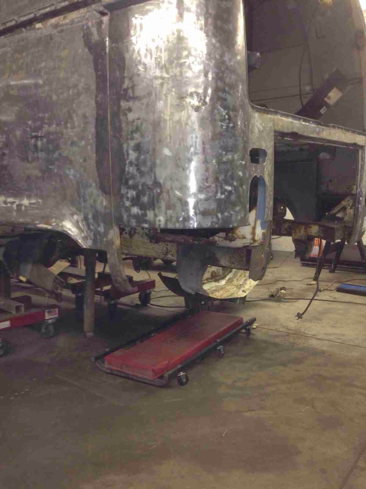

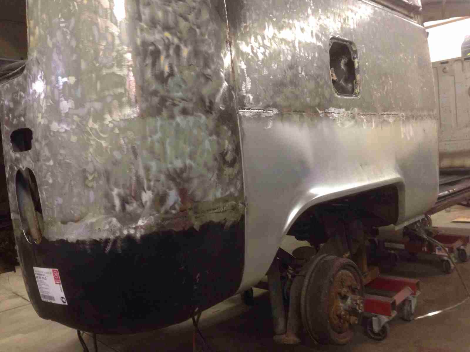

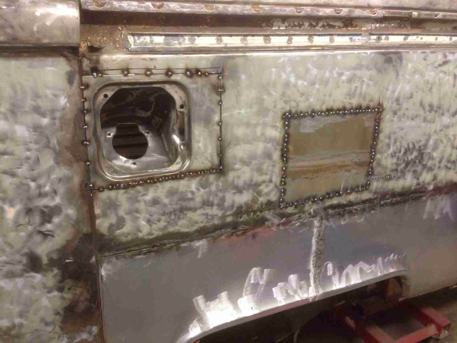

Go the driver side corner removed and the rear wheel well area. I made that corner the same way as the other side.

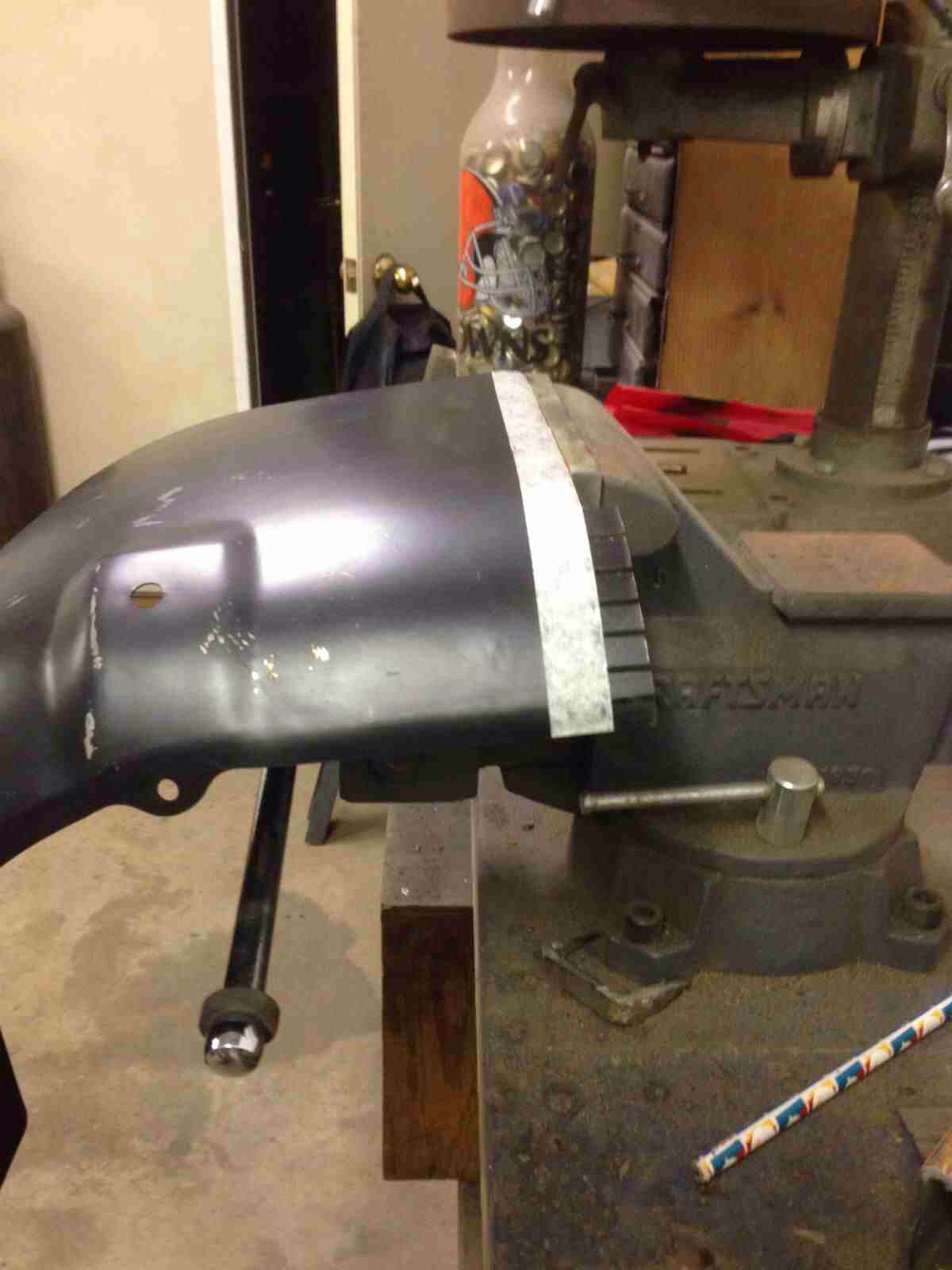

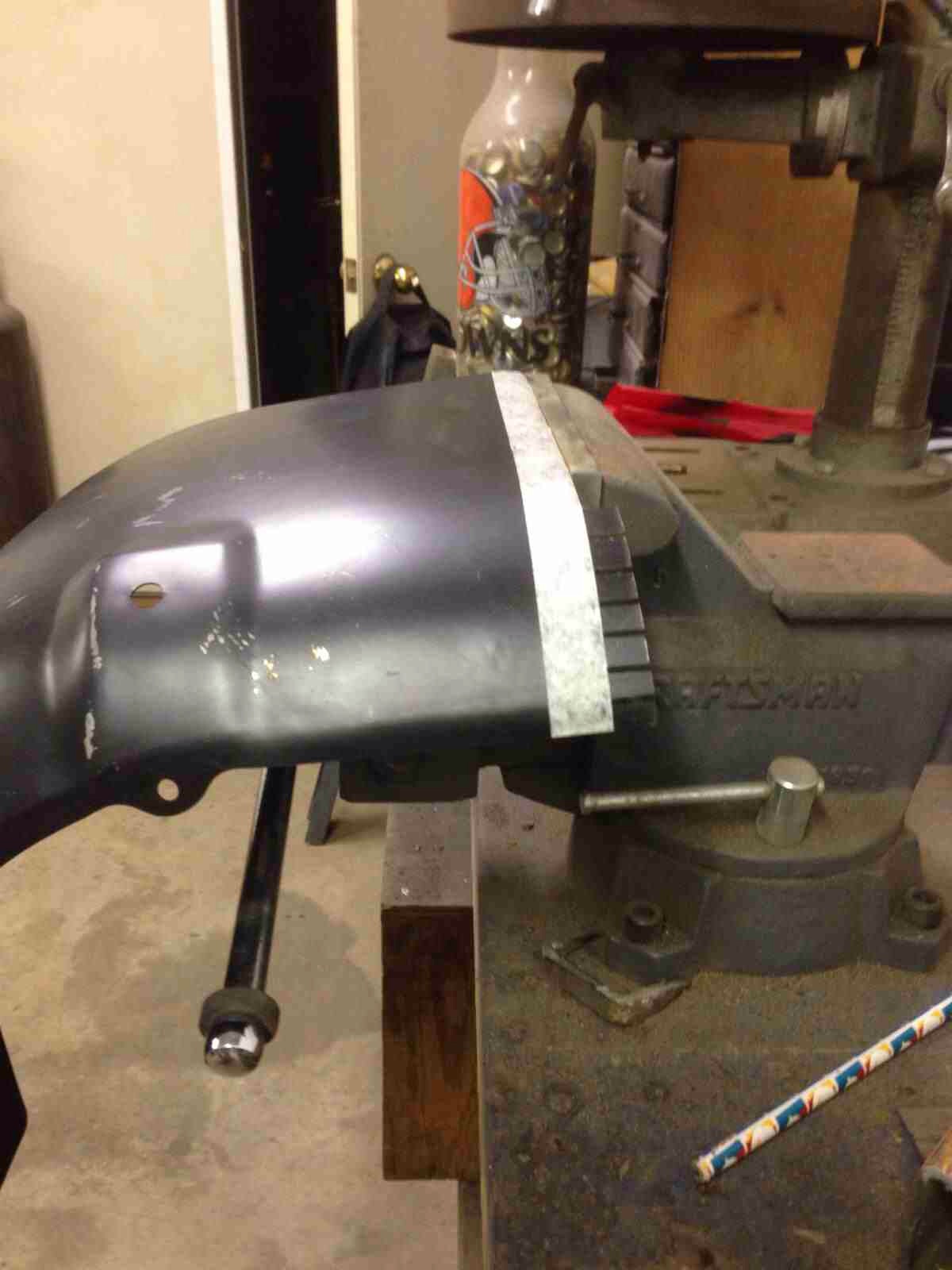

I made that lower fender piece by hand. Re-werked klokkerholm corner. I also deleted the reverse lights.

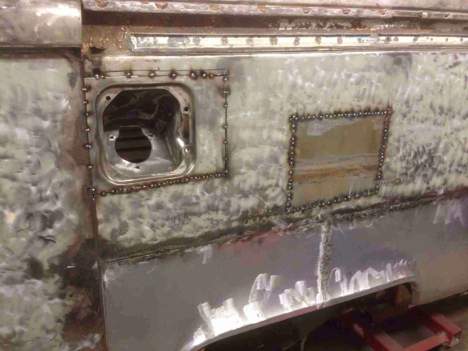

I decided to slam the piss out this thing. So i had to tub the rear wheel wells. Well the gas tank was in the way so i had to move it to the upper left hand corner.
