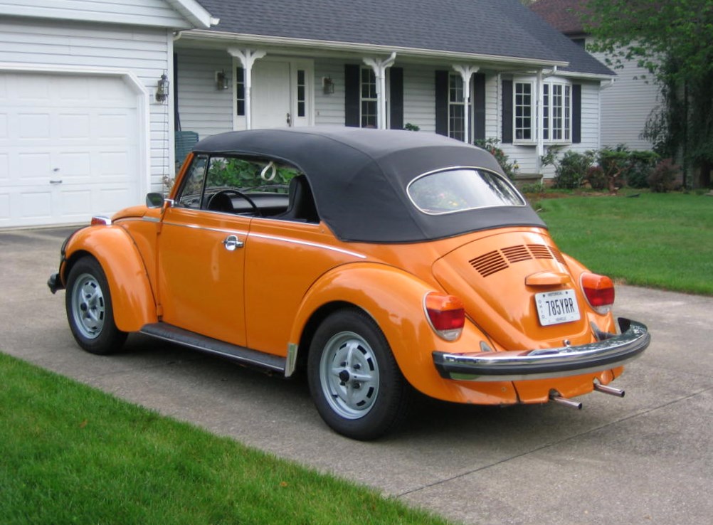

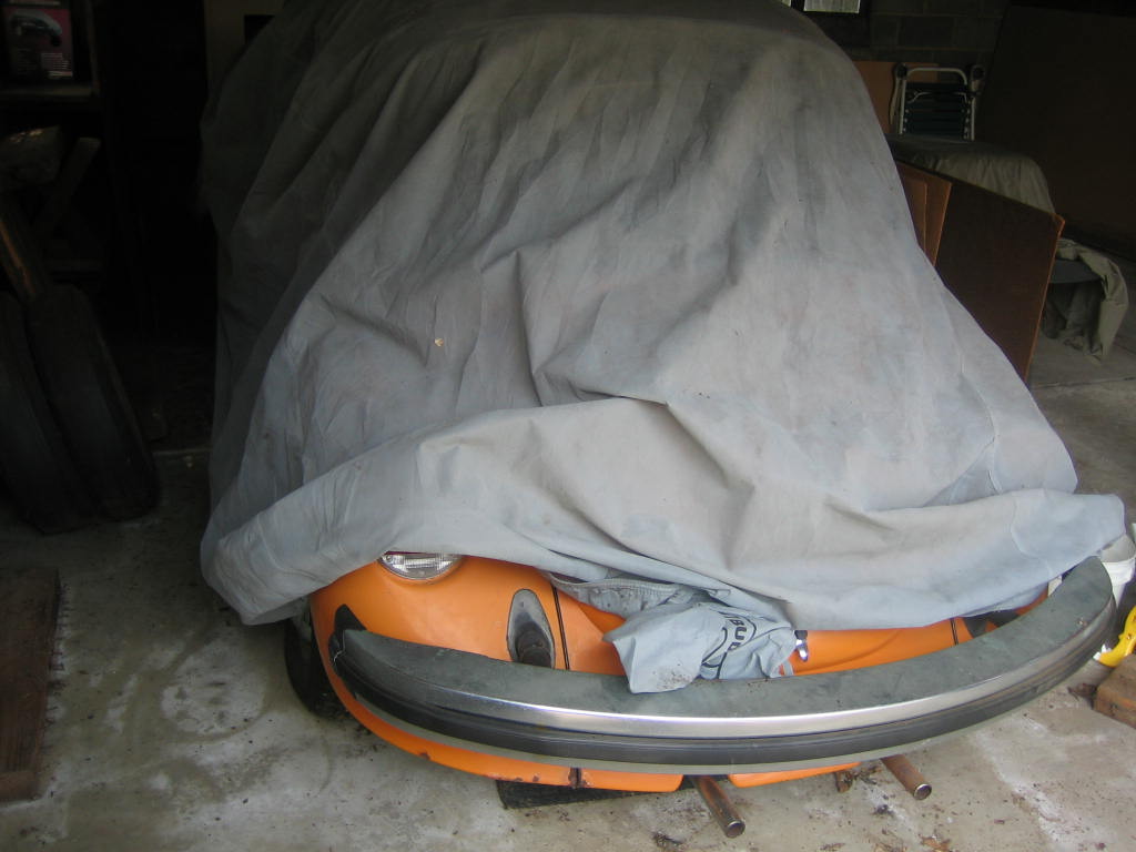

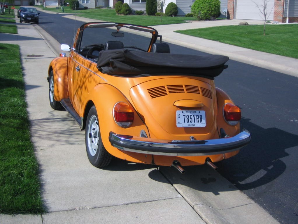

HARD TO THINK ITS BEEN ALMOST ONE YEAR GONE BY AND THE VW HAS GONE FROM THIS

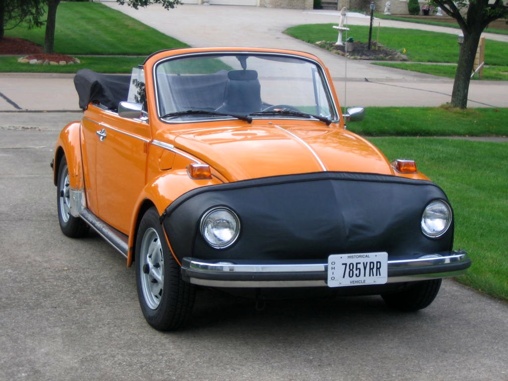

TO THIS
THANK YOU AGAIN TO DUEL PORT FOR ALL HIS HELP AND THANK YOU TO ALL THE LEAK OIL MEMBERS WHO I'VE BEEN ABLE TO MEET AND SPEAK WITH SO FAR. HOPE TO SEE YOU ALL AT THE NEXT EVENTS.
