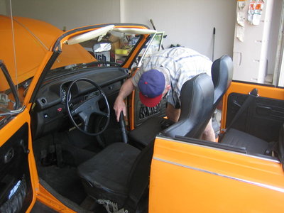

I PUT ON MY NEW RIMS AND TIRES LAST WEEK AND HAVE BEEN DRIVING WHEN ITS BEEN WARM ENOUGH TO HAVE THE TOP DOWN. THE CAR HAS REALLY BEEN A BLESSING FOR ME NOW THAT I HAVE TIME TO ENJOY IT. DUEL PORT GOT THE VW RUNNING HOW I REMEMBER IT (LIKE NEW). TODAY MY FRIEND BOB AND I GAVE IT A BASIC CLEAN UP AND IT LOOKS PRETTY GOOD. I'M STILL TRYING TO FIGURE OUT WHAT TO DO WITH BODY AND PAINT WORK, STARTING TO TALK TO MORE PEOPLE, ASKING FOR ADVISE AND LEARNING ABOUT THE DIFFERENT WAYS OF GOING ABOUT THINGS. I'M GOING TO GO ON MY FIRST CRUISE (METRO PARKS) AND HOPE TO SEE A LOT OF YOU AND YOUR CARS AND BUSES THEN.

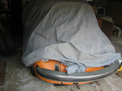

HARD TO THINK ITS BEEN ALMOST ONE YEAR GONE BY AND THE VW HAS GONE FROM THIS

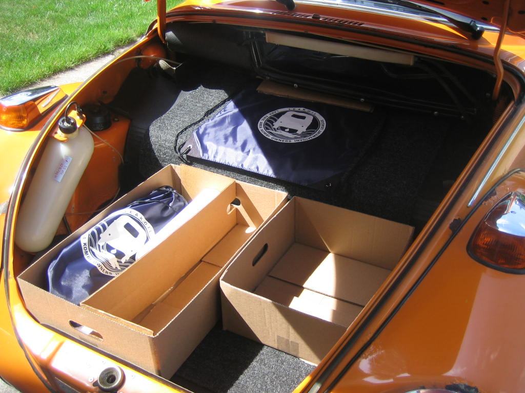

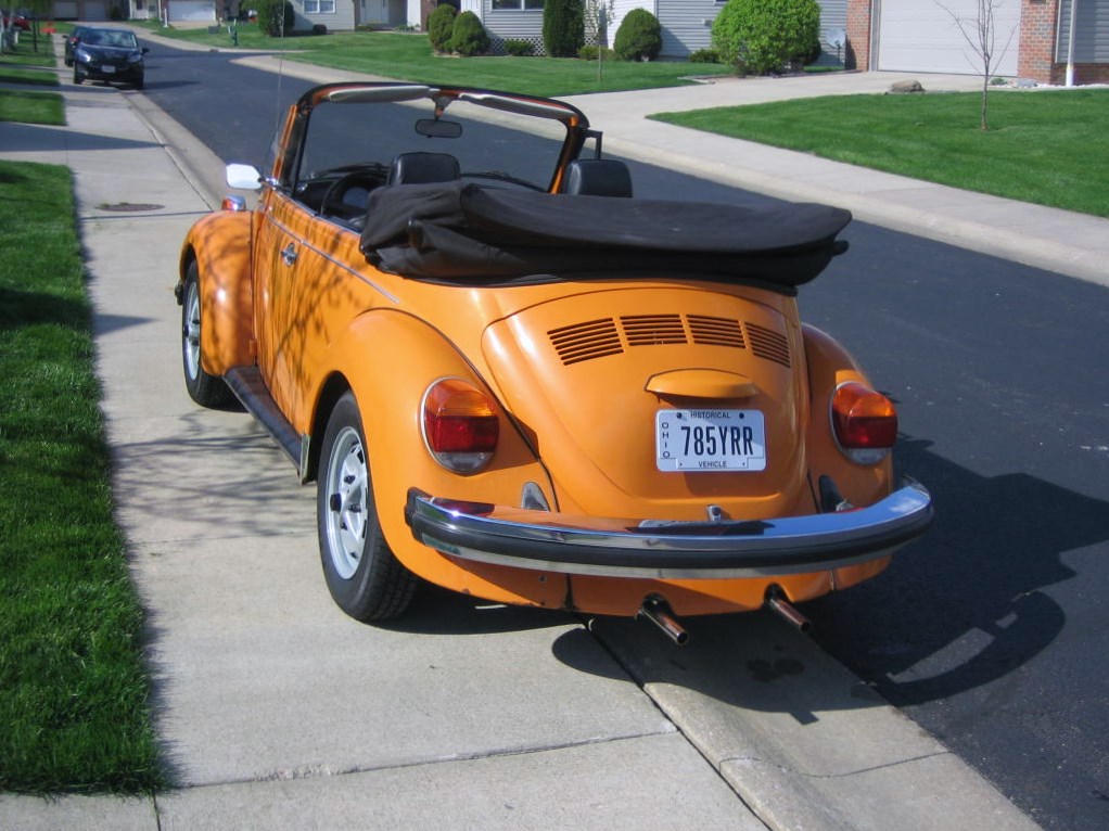

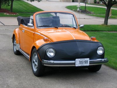

TO THIS
THANK YOU AGAIN TO DUEL PORT FOR ALL HIS HELP AND THANK YOU TO ALL THE LEAK OIL MEMBERS WHO I'VE BEEN ABLE TO MEET AND SPEAK WITH SO FAR. HOPE TO SEE YOU ALL AT THE NEXT EVENTS.
