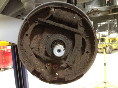

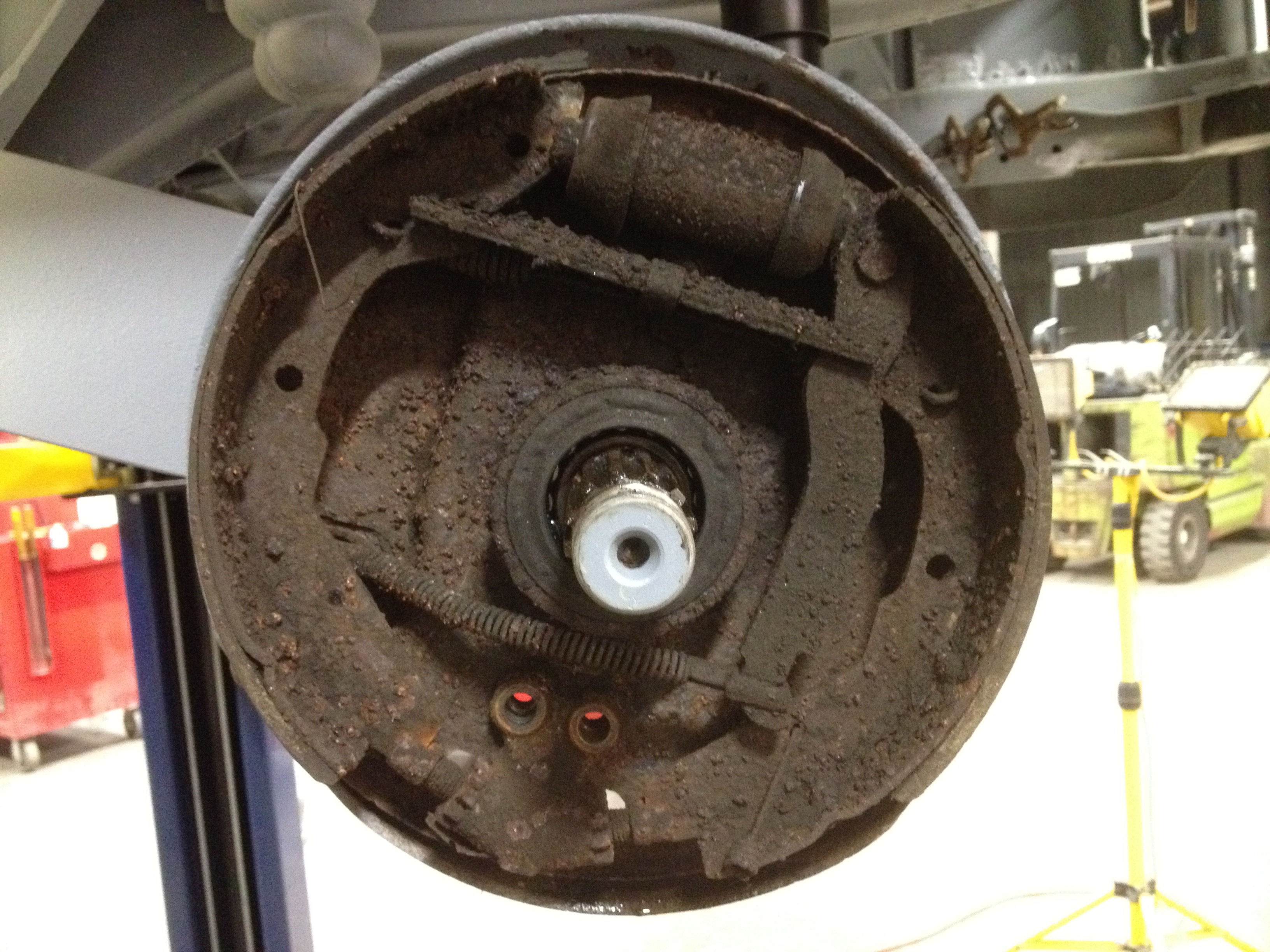

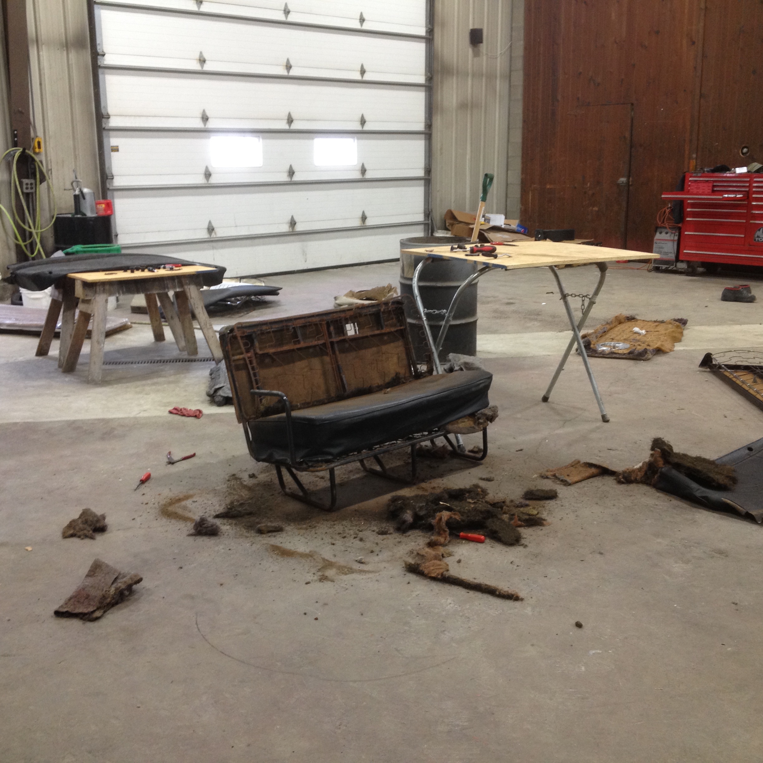

when thru the complete brake system. Re upholstery the seats. That was a pain in the rear!
Original rear brakes?

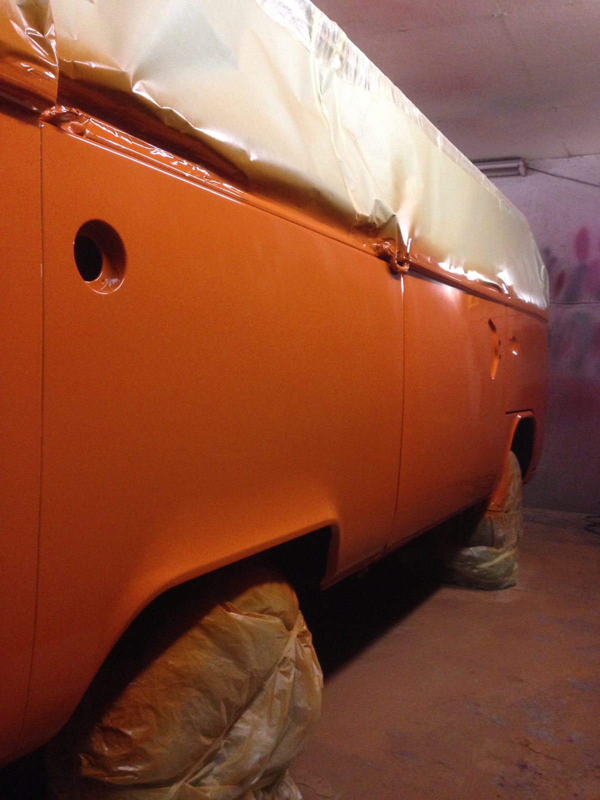

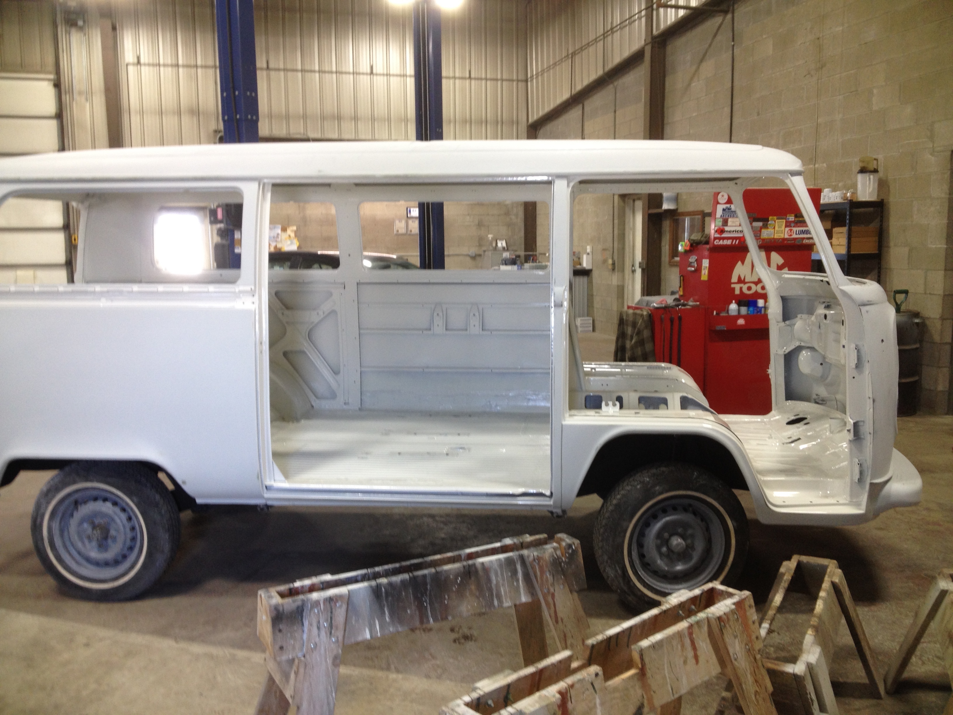

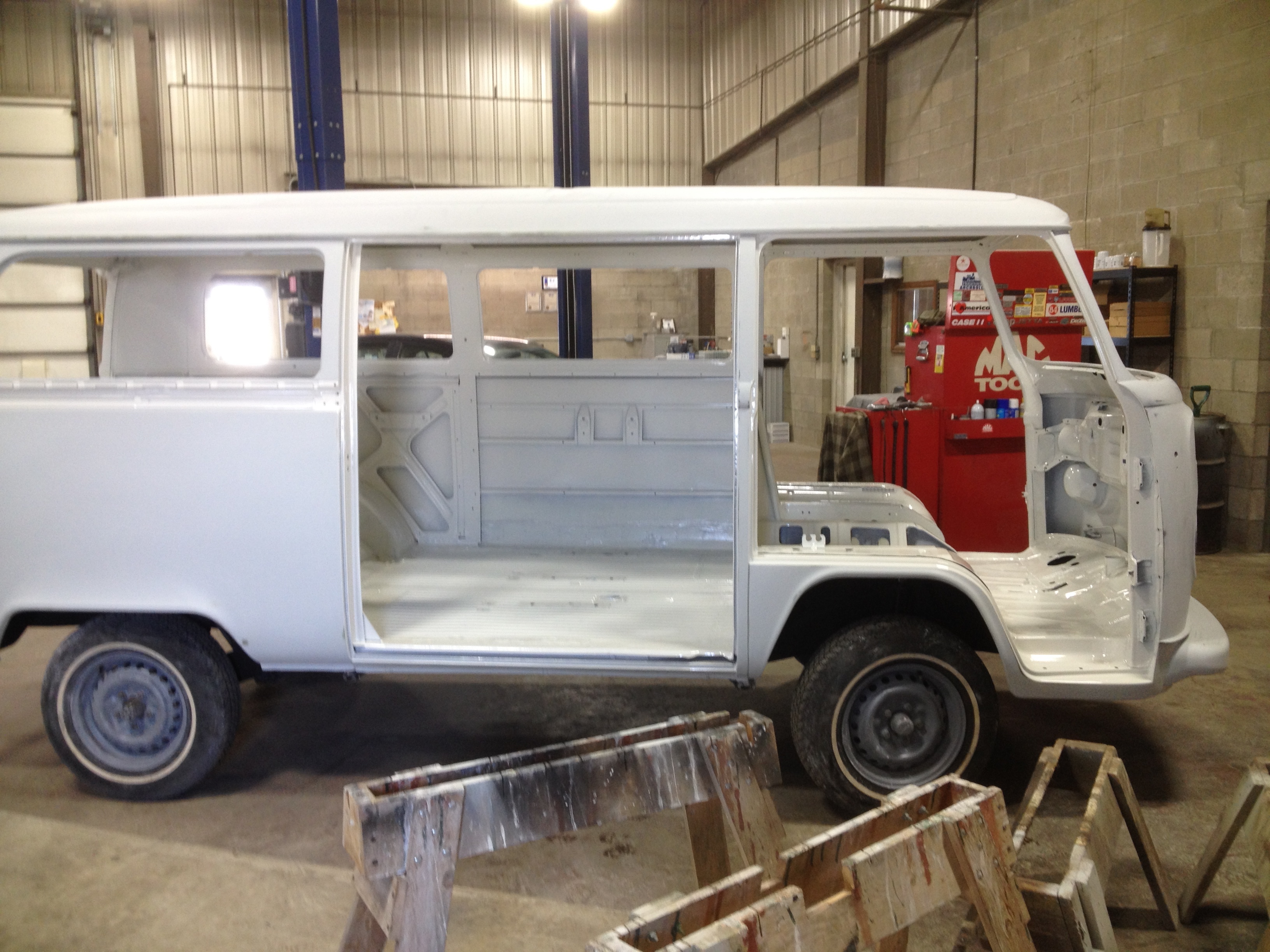

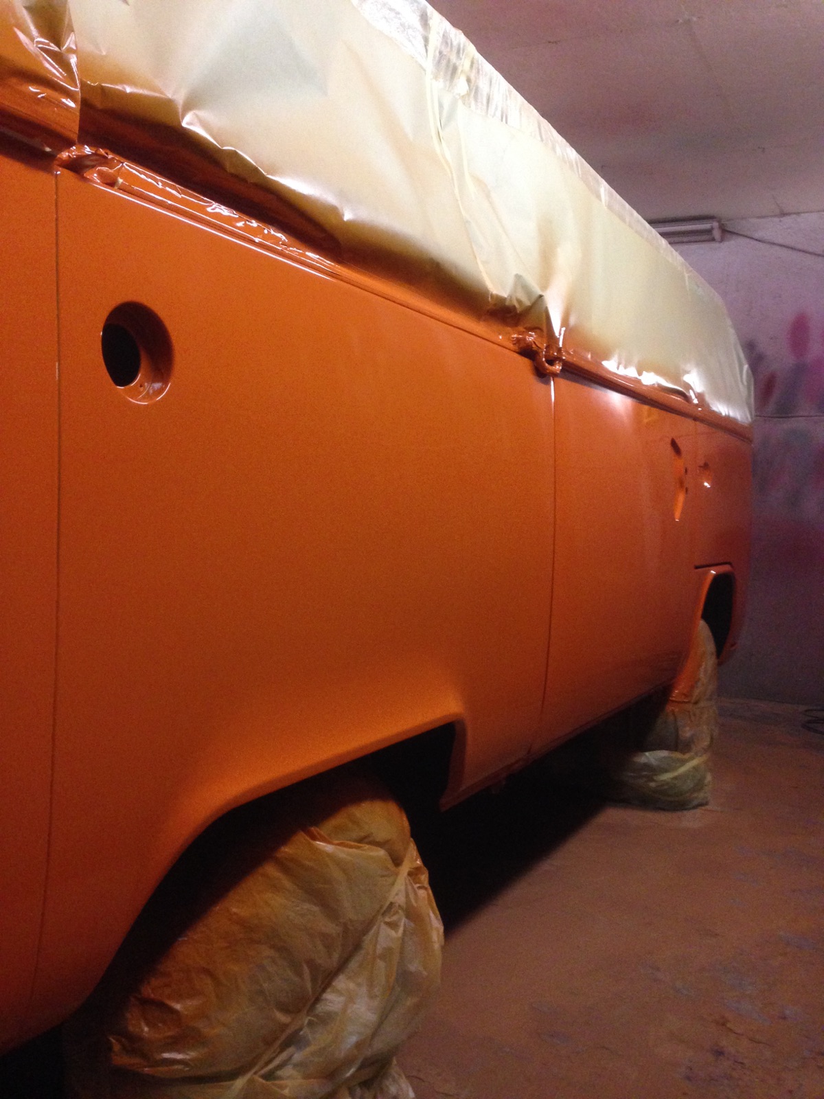

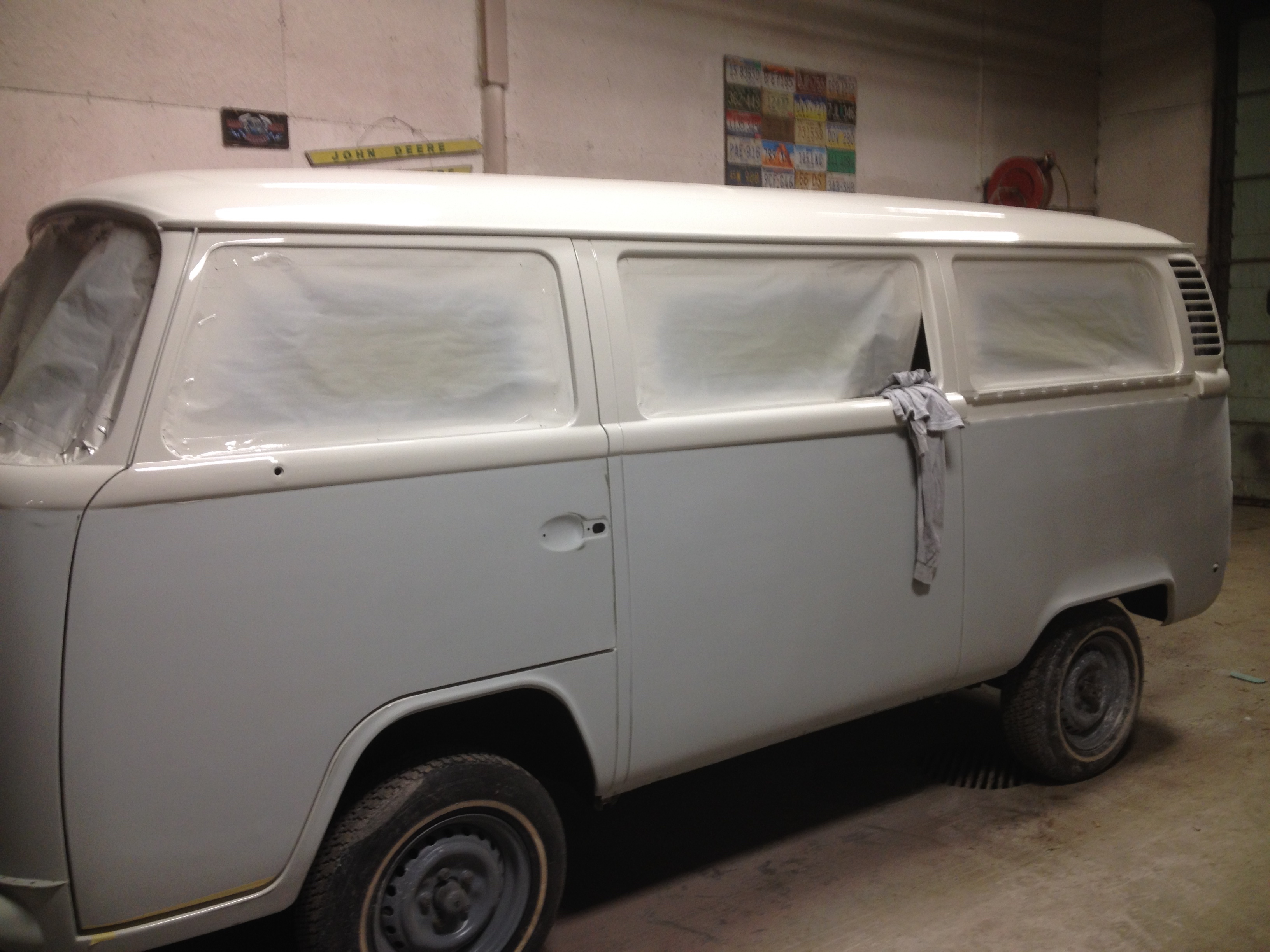

Painted. Now the fun part of remembering how stuff goes back together. I took it apart in 2010 :shock:
February 14th
February 14th
February 13th
February 13th
Painted Interior Jan 31st

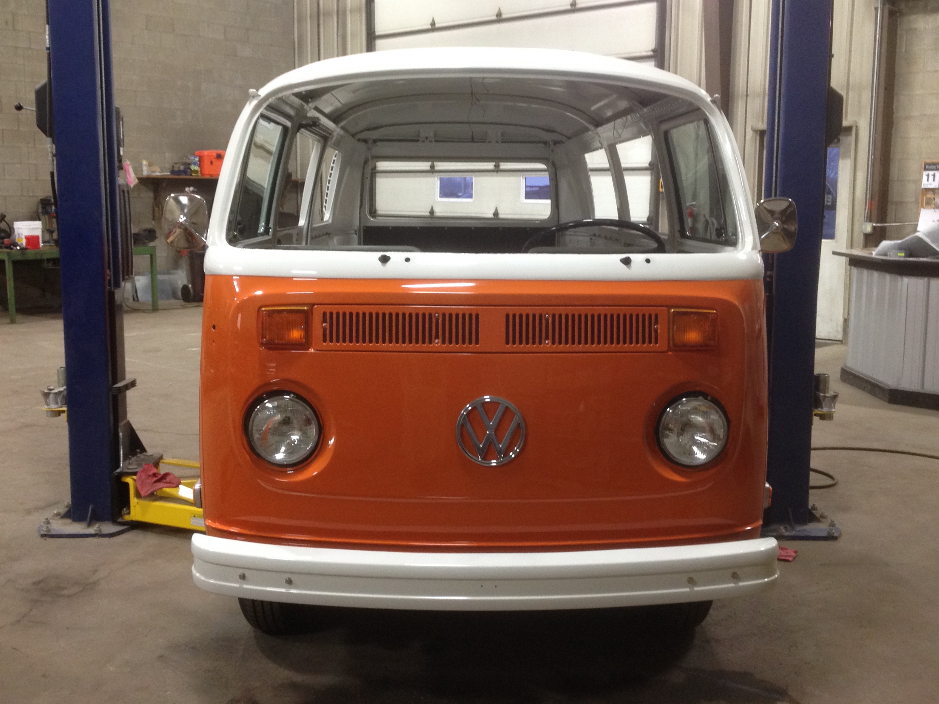

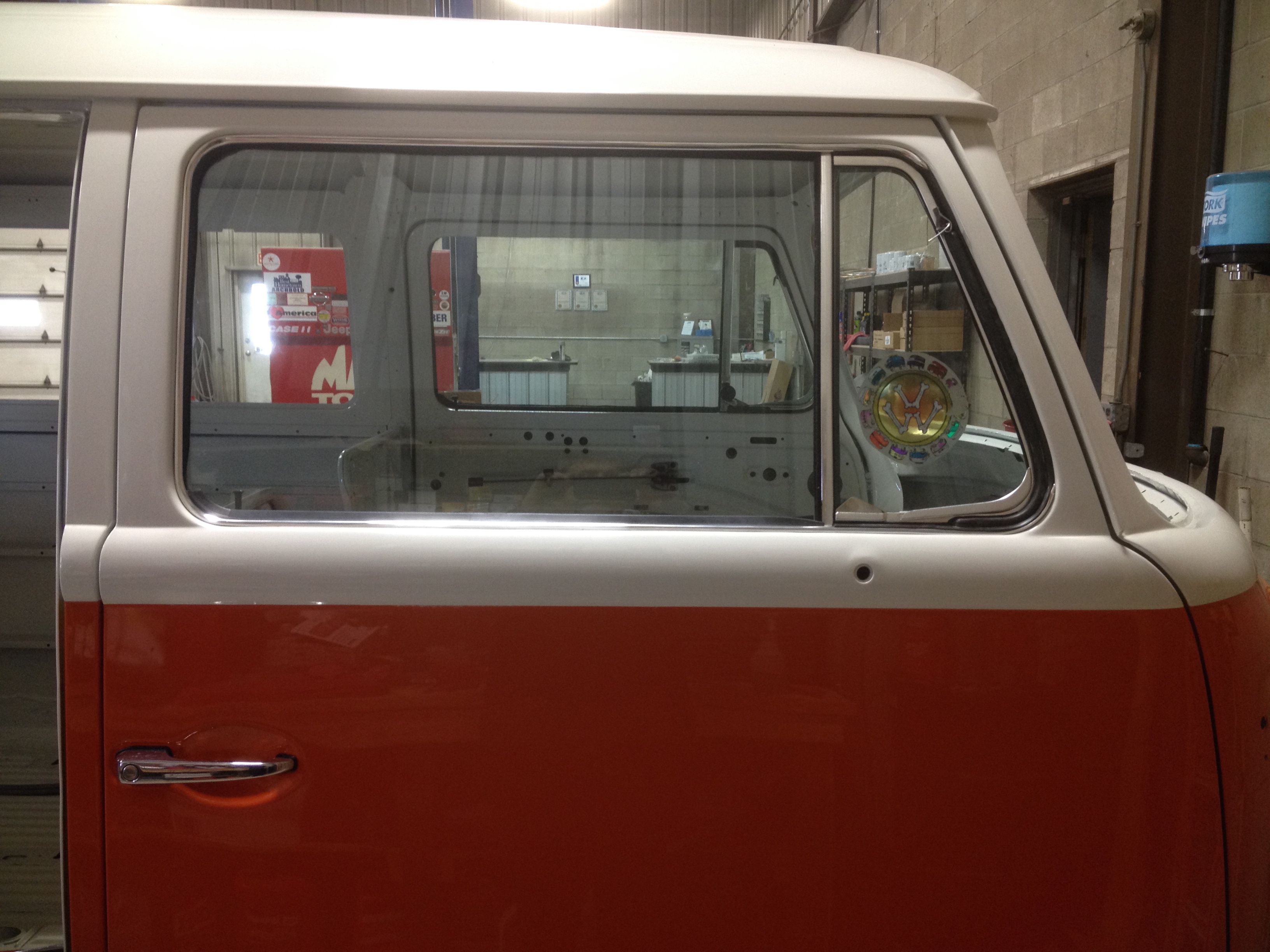

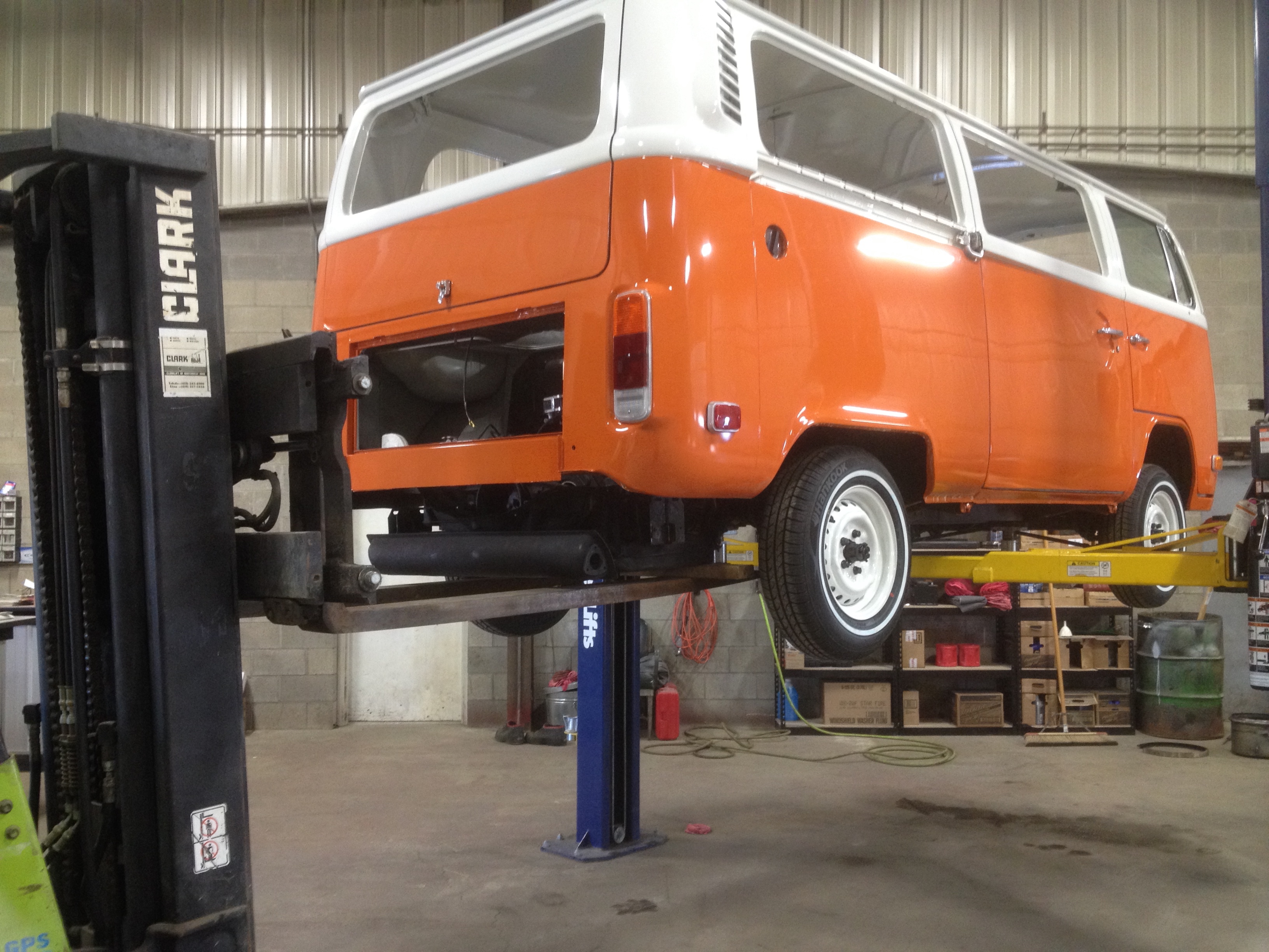

Installed the front door windows last month with new trim. Had the rims blasted and painted. Finally got to put the engine back where it belongs!

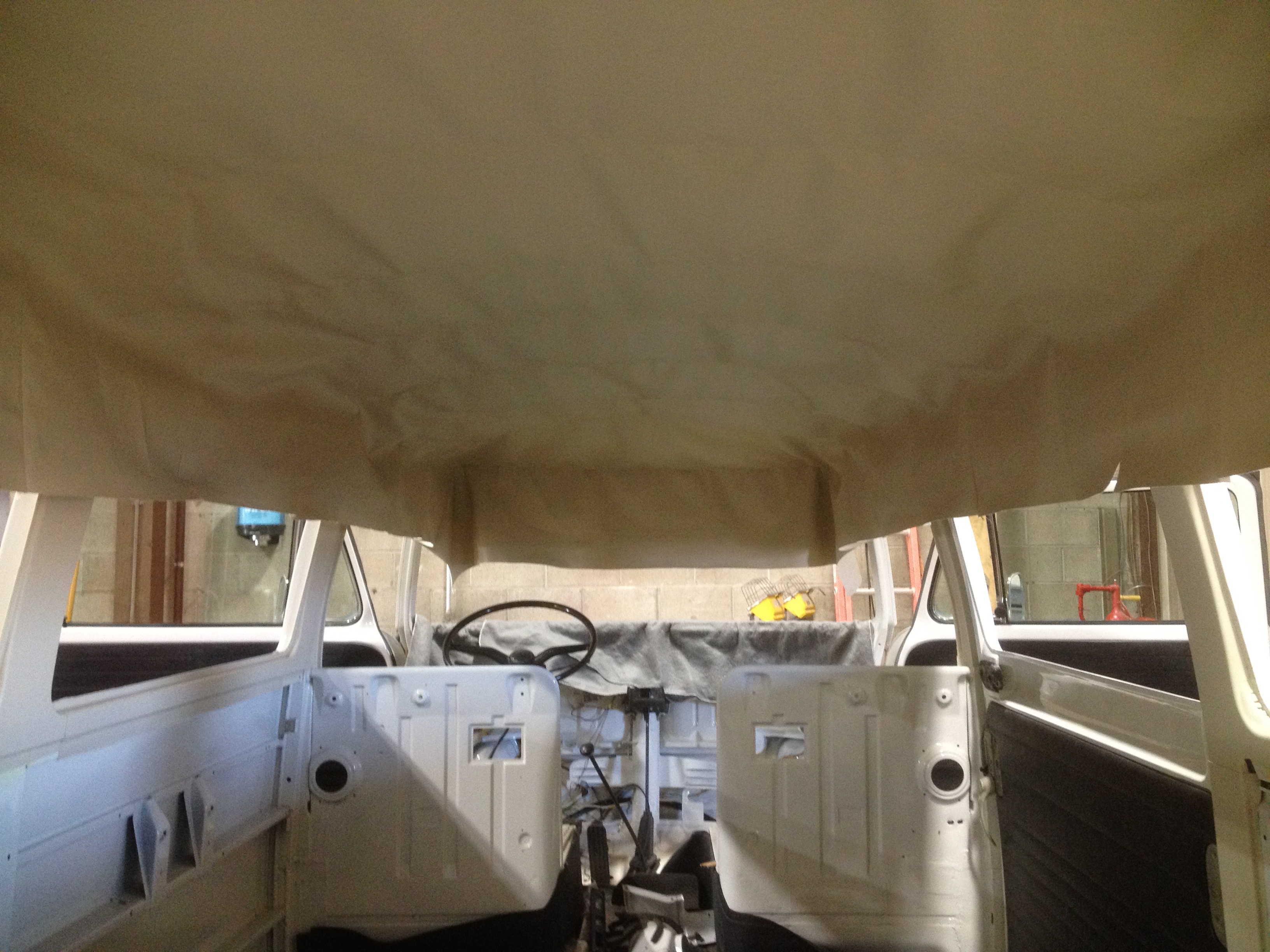

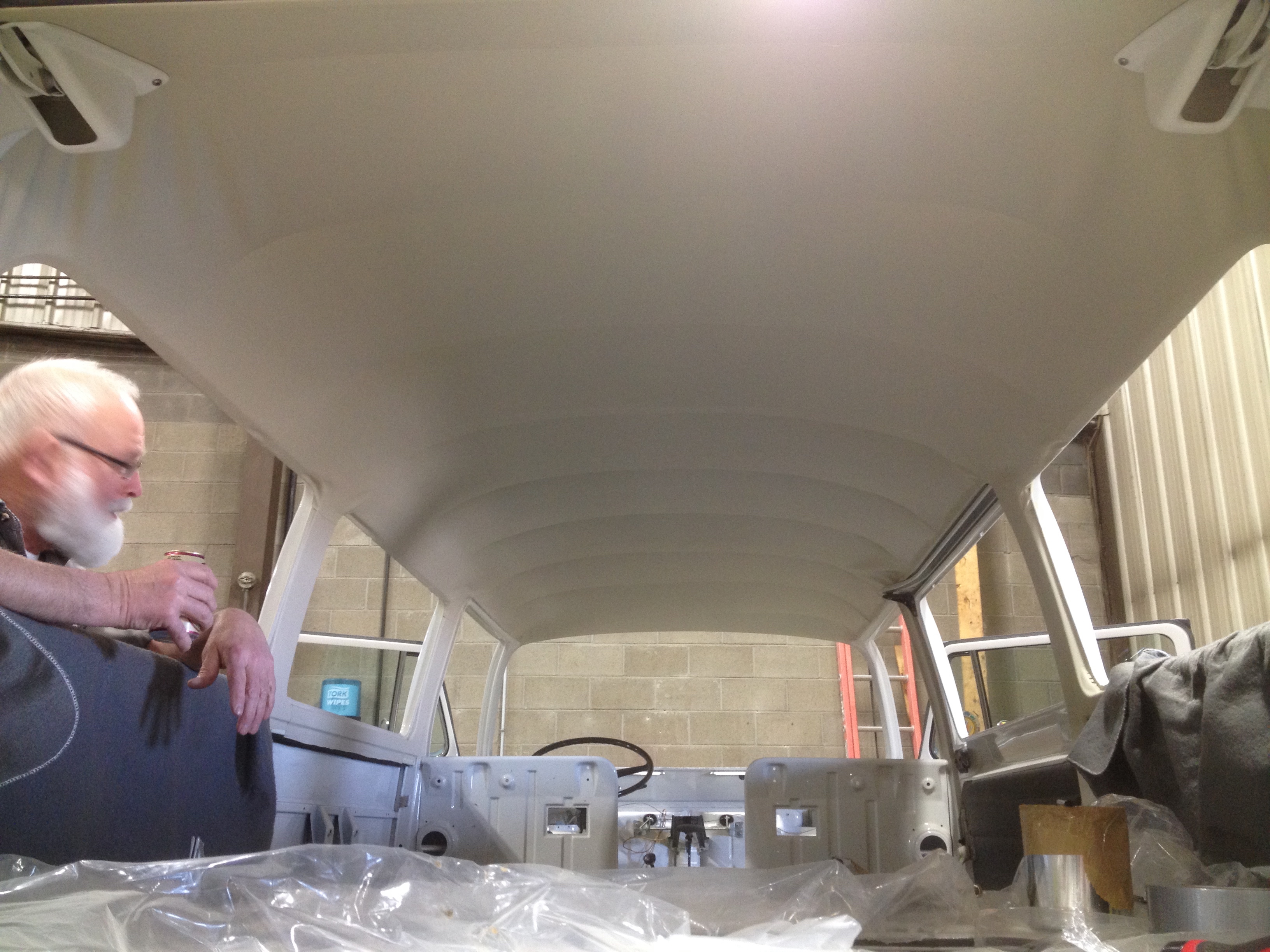

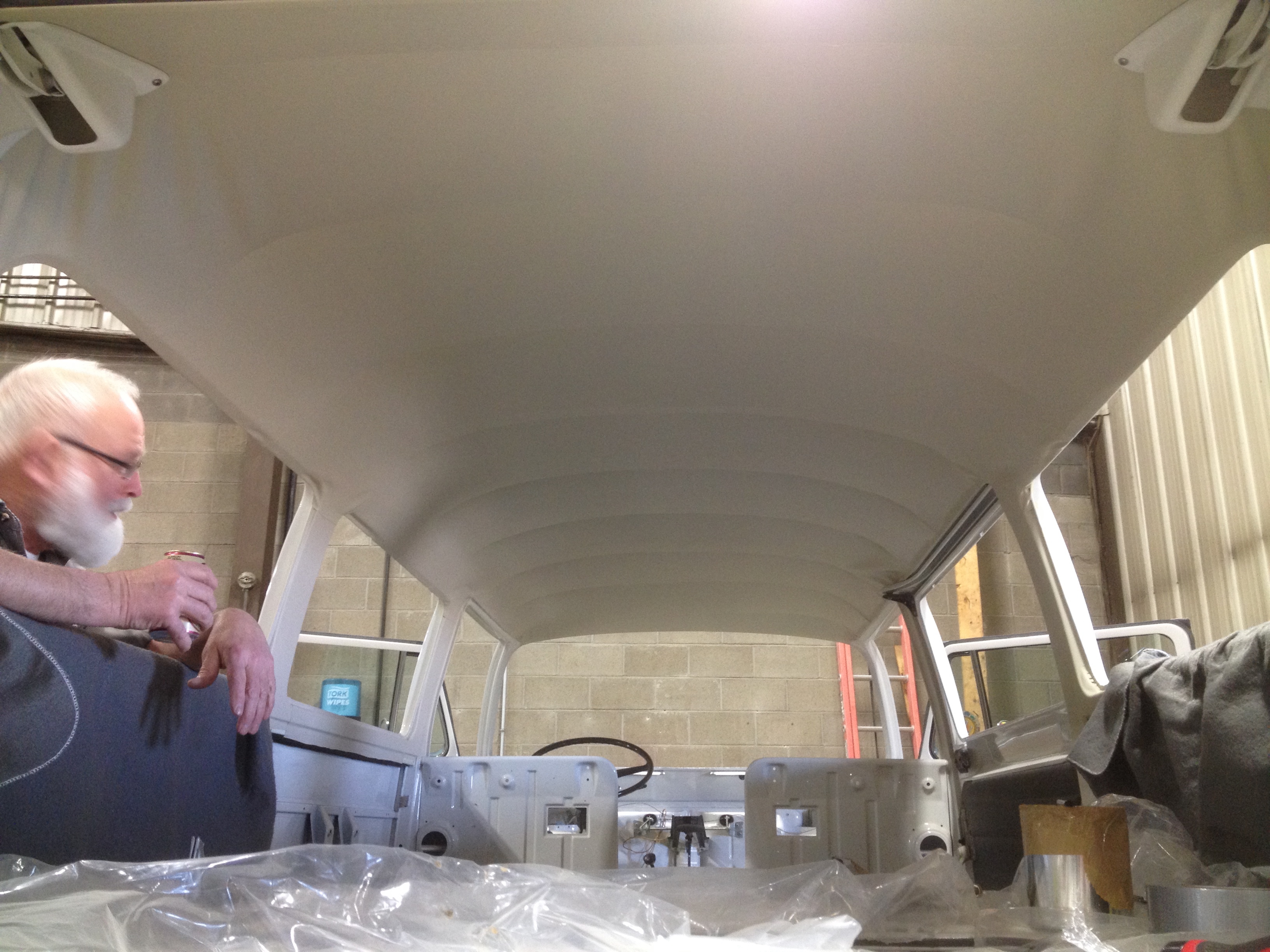

Headliners are fun :evil: Not!

Re: 1974 Transporter
Be glad it's not a split ;)
