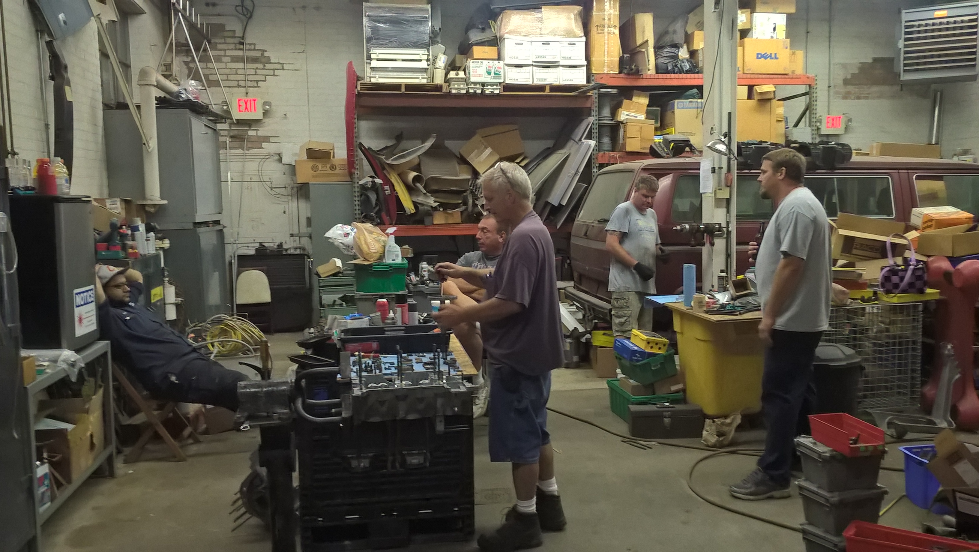

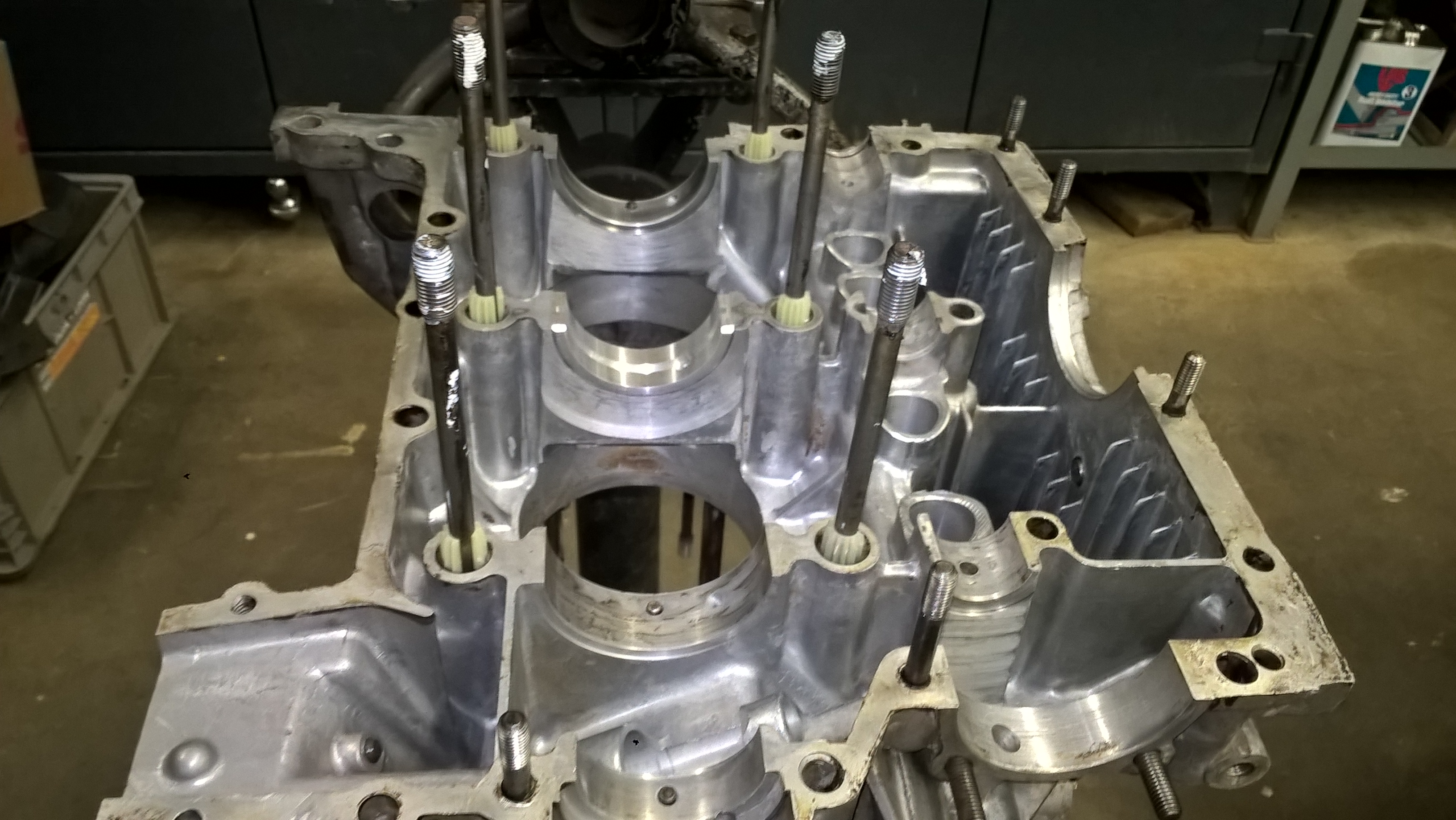

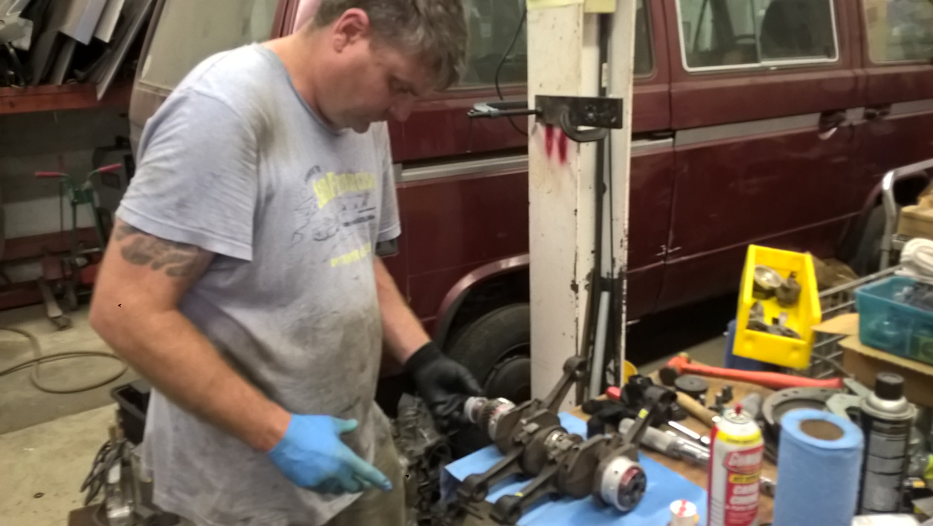

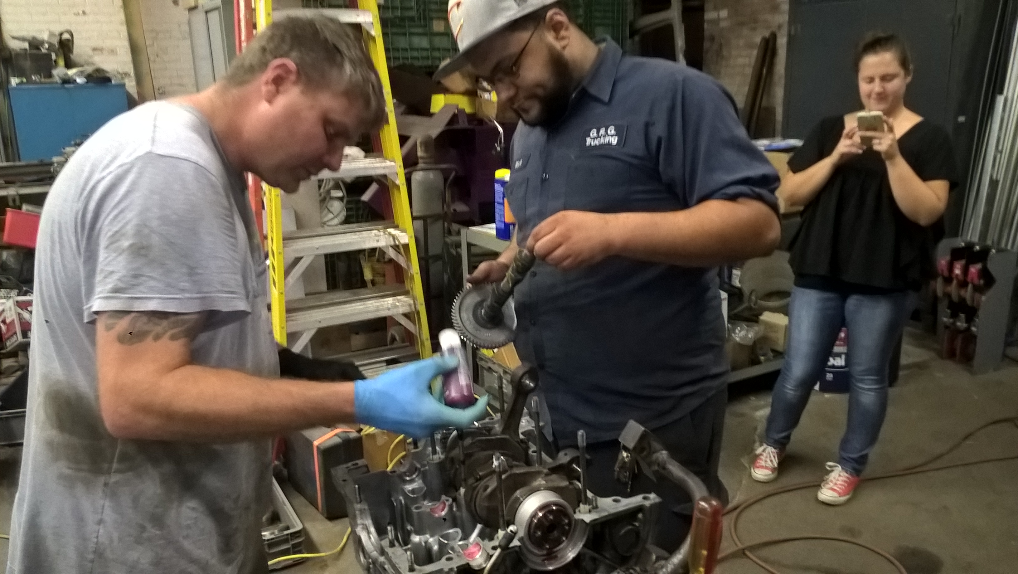

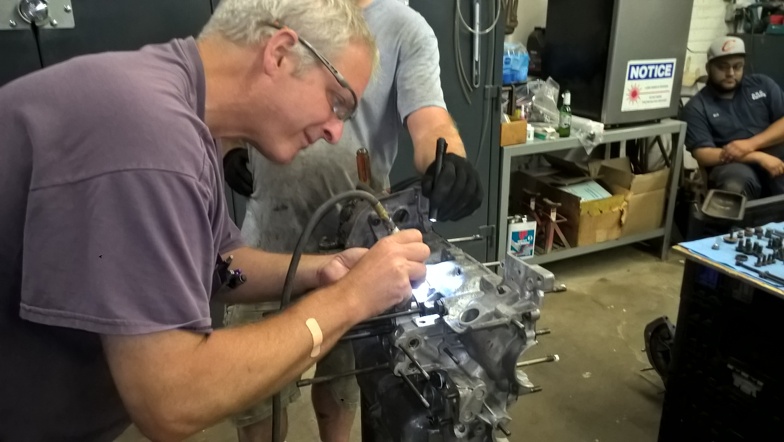

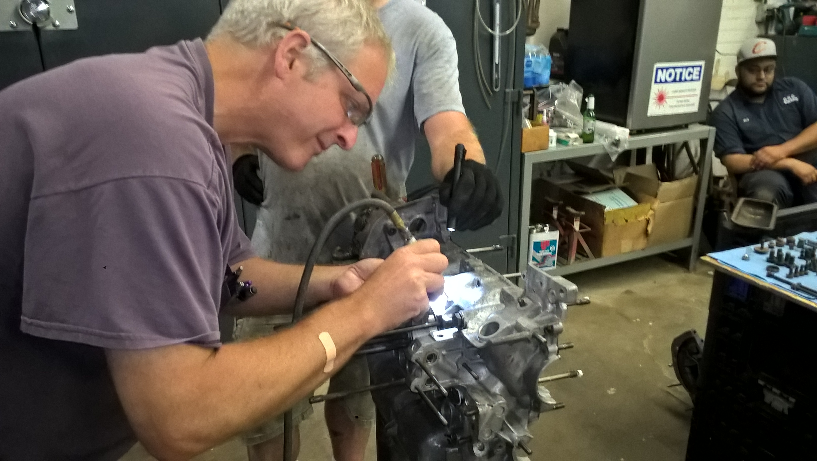

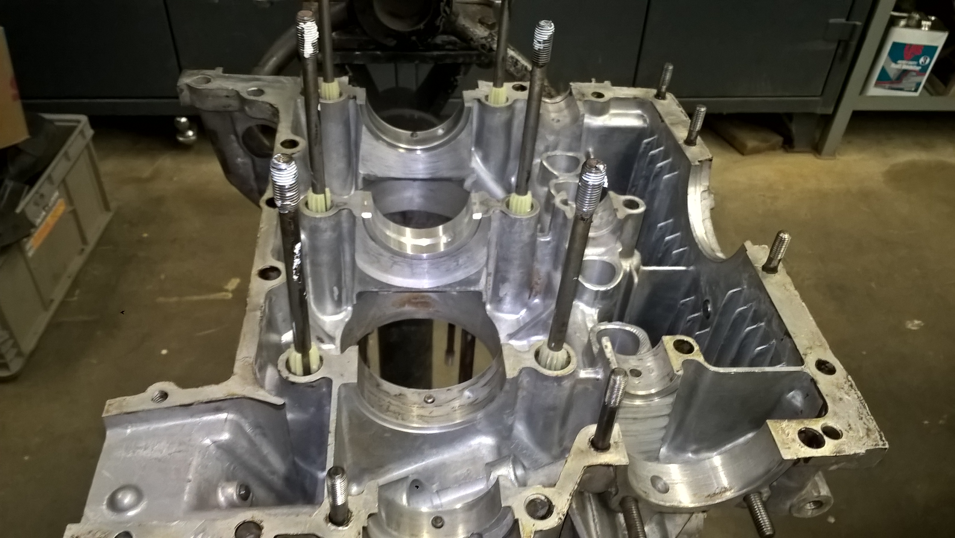

Pics with Boogs's heart and humans. Engine surgery by Chuck. Well, more like dentistry
