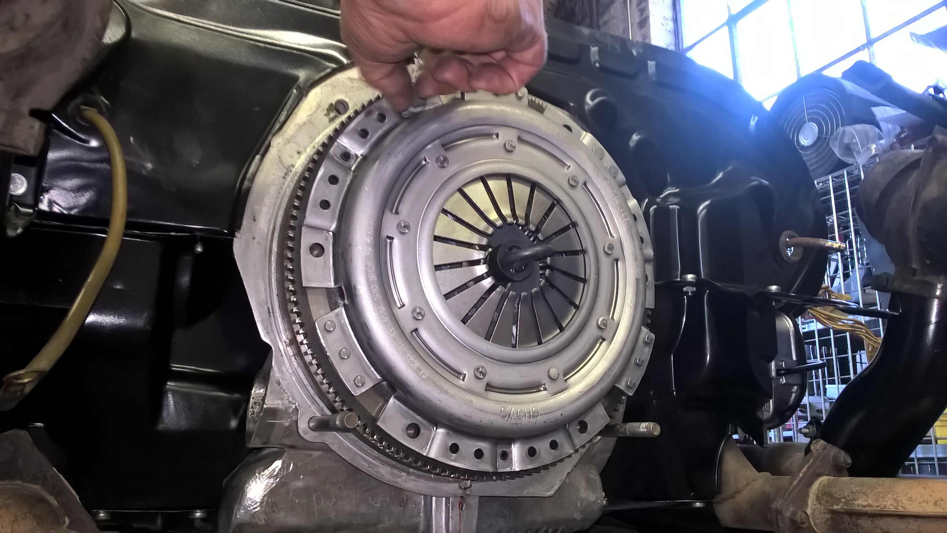

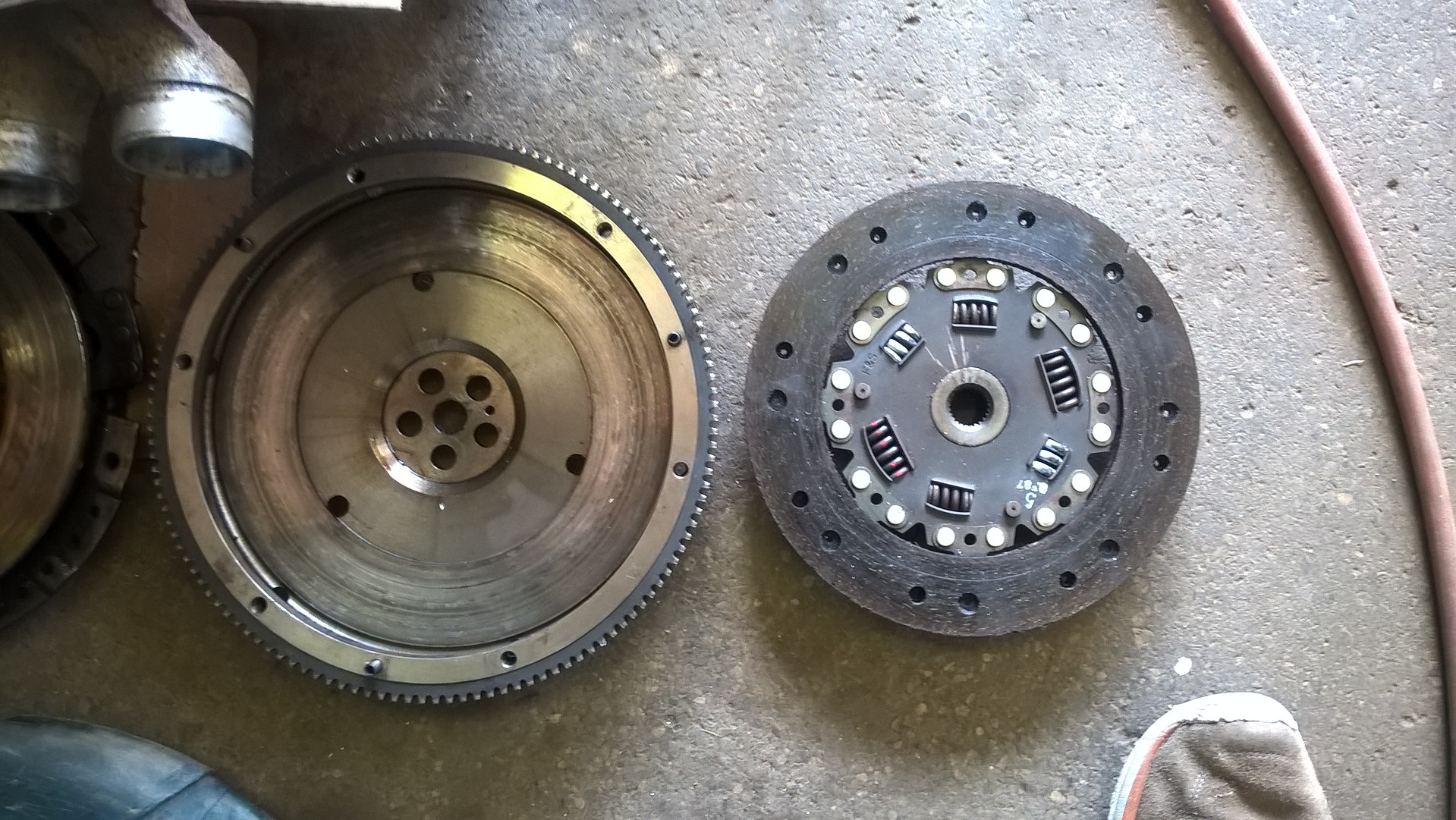

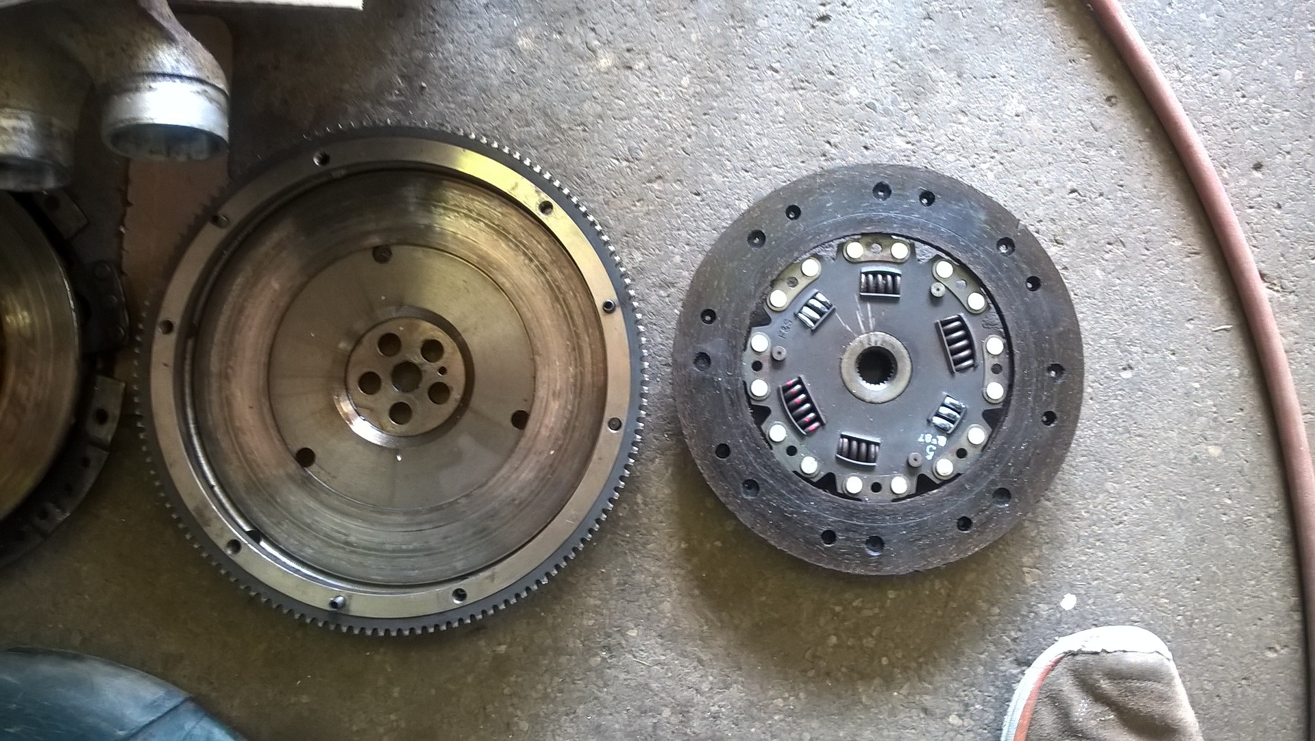

bus came with a weird clutch disk with continuous facing

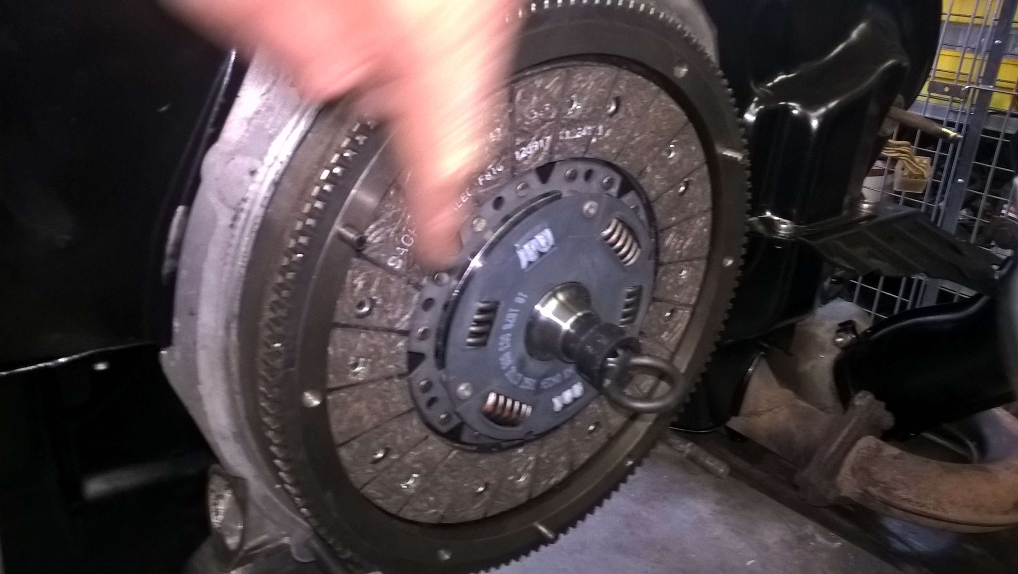

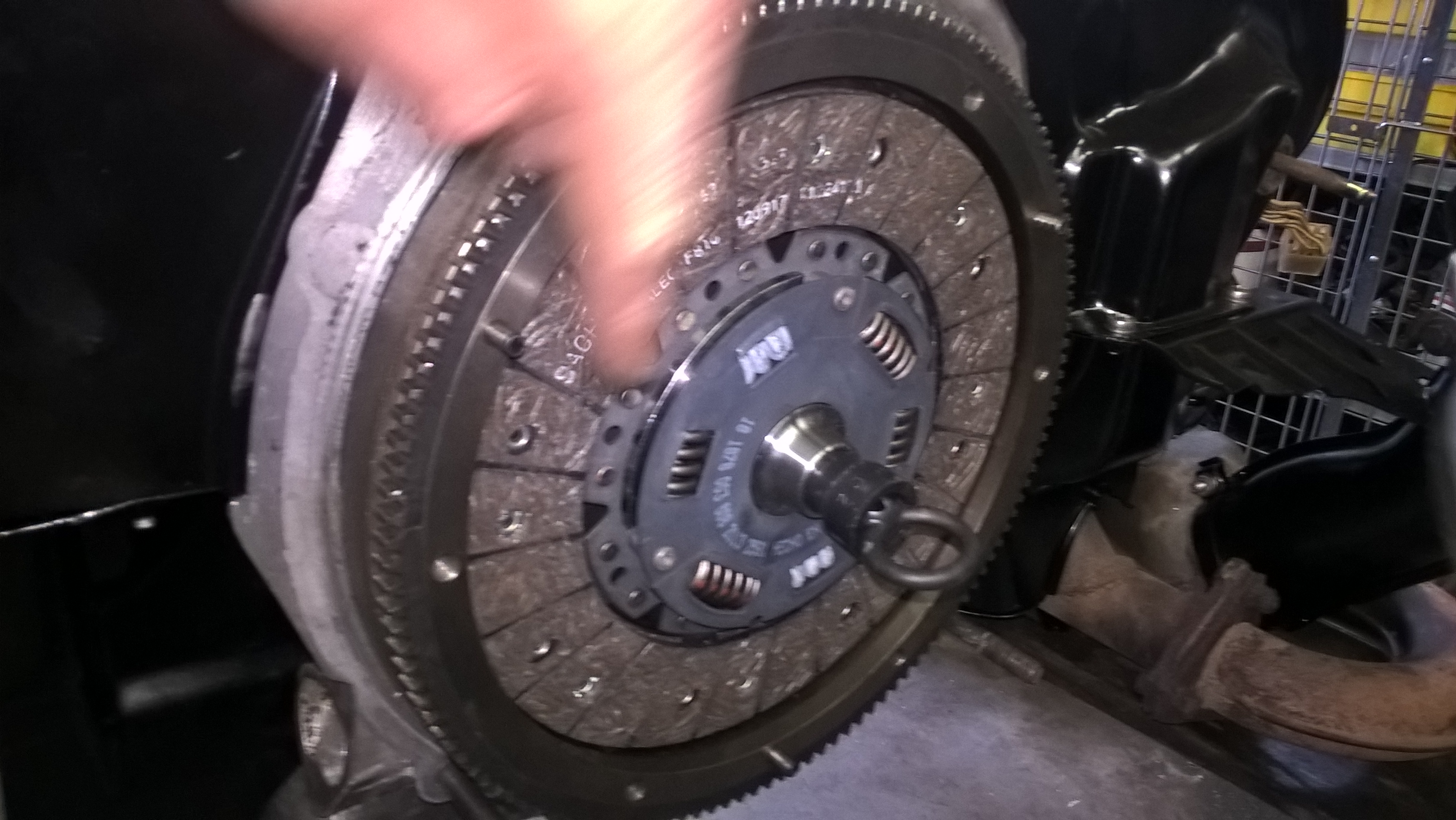

got replaced with a proper one

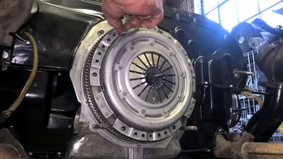

and new pressure plate

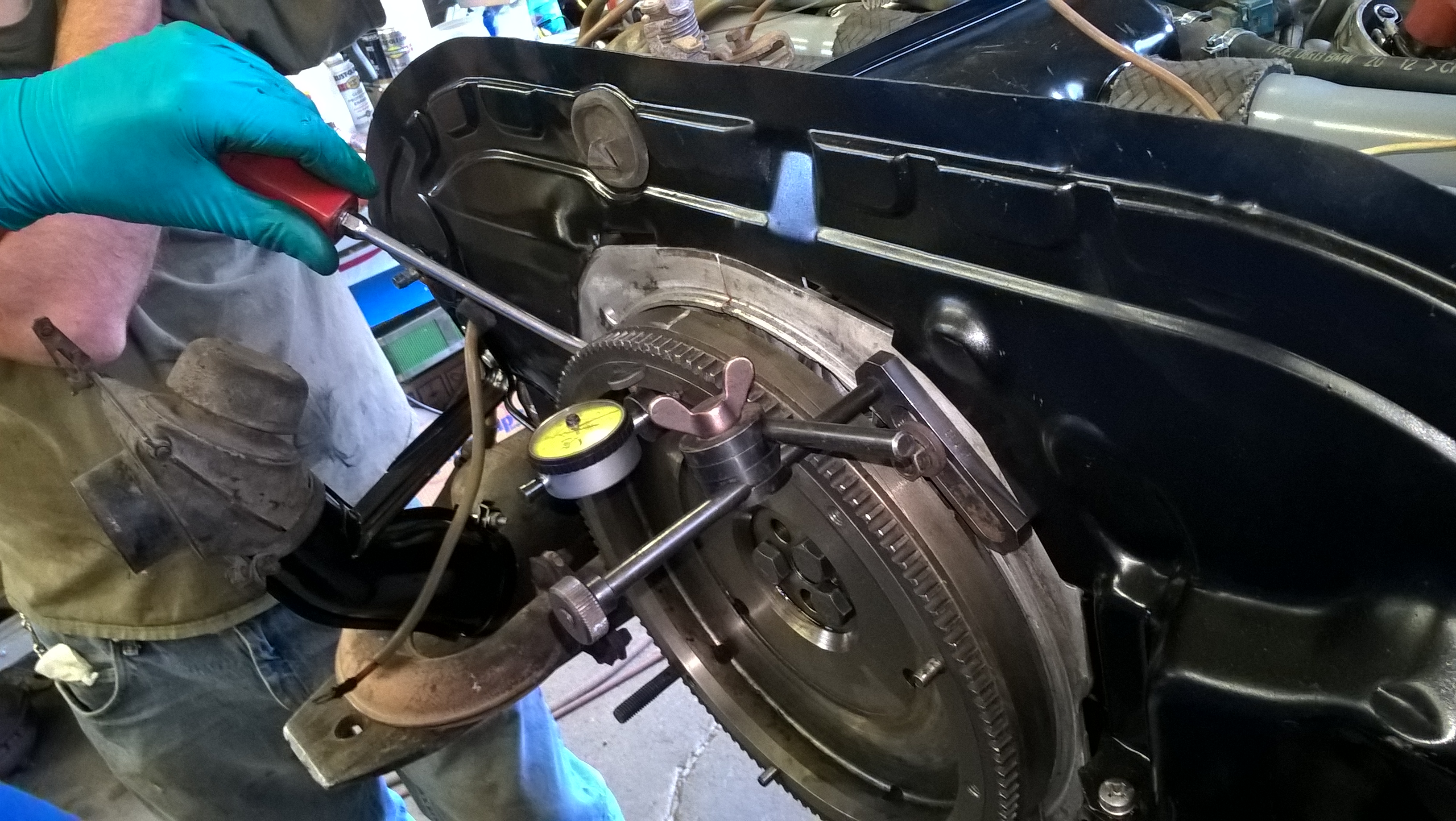

Mike and me get to measure crankshaft end play while Chuck picks the shims

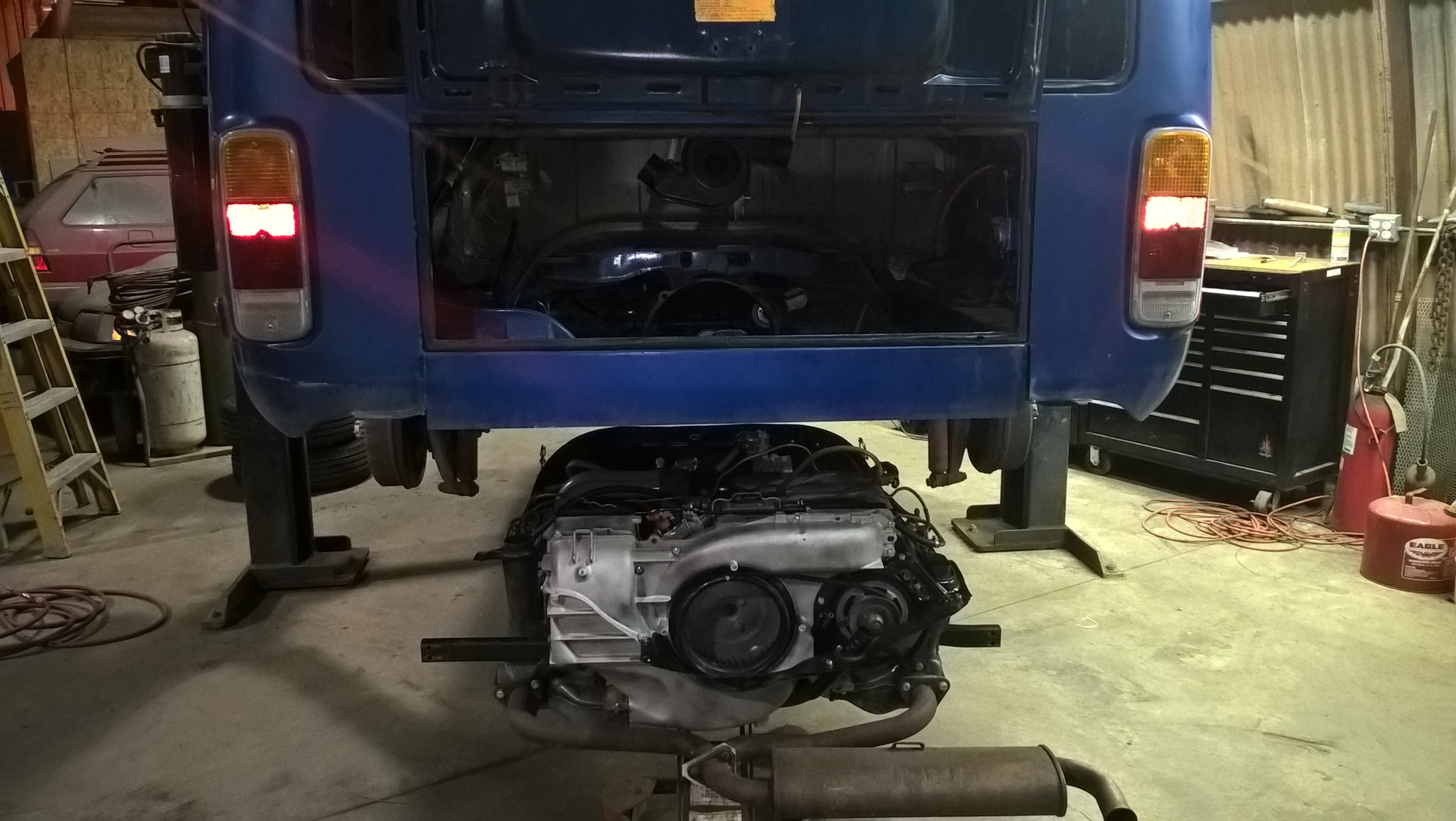

engine ready to go up

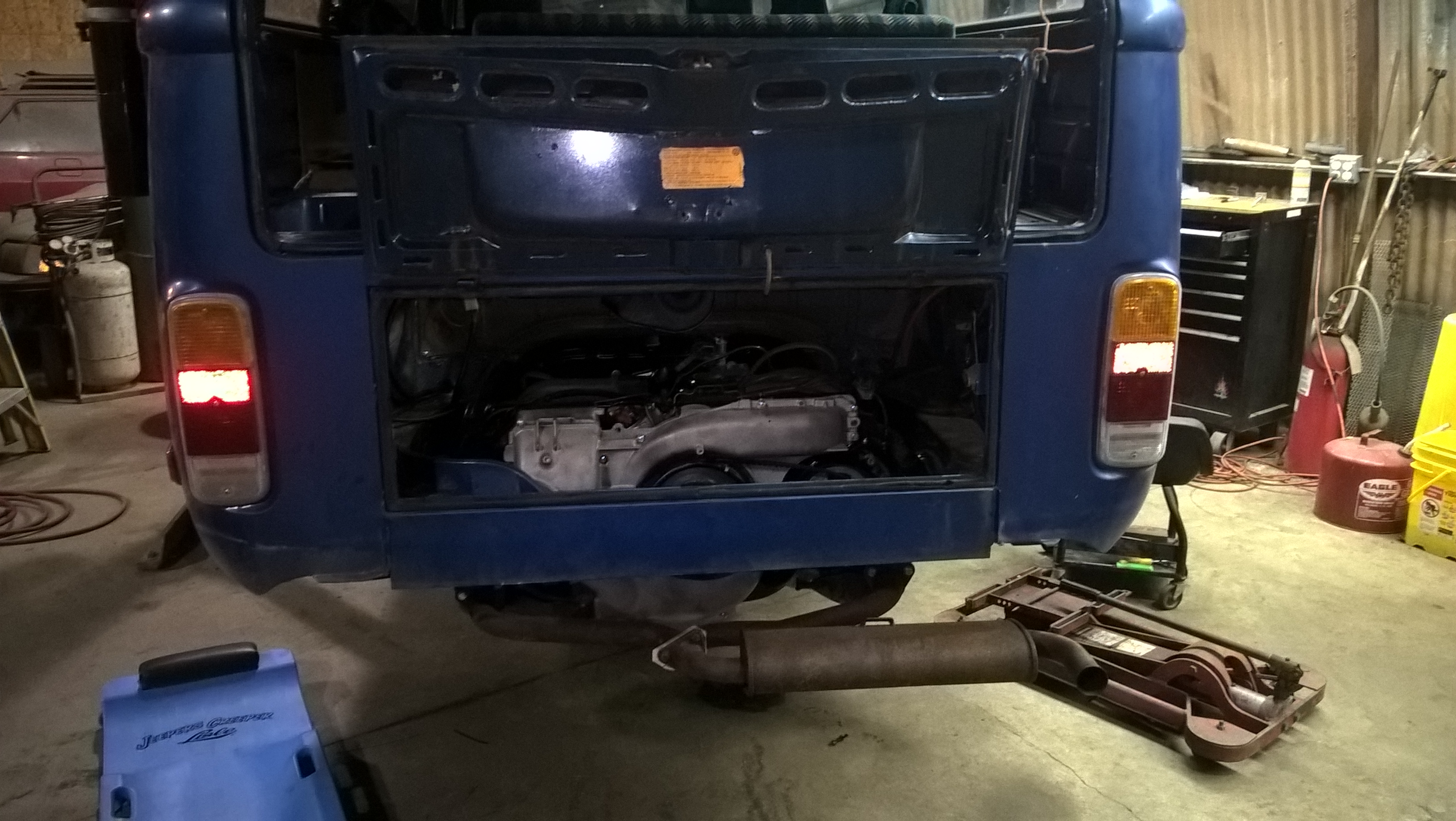

the bus puts up a fight but eventually takes the engine :)

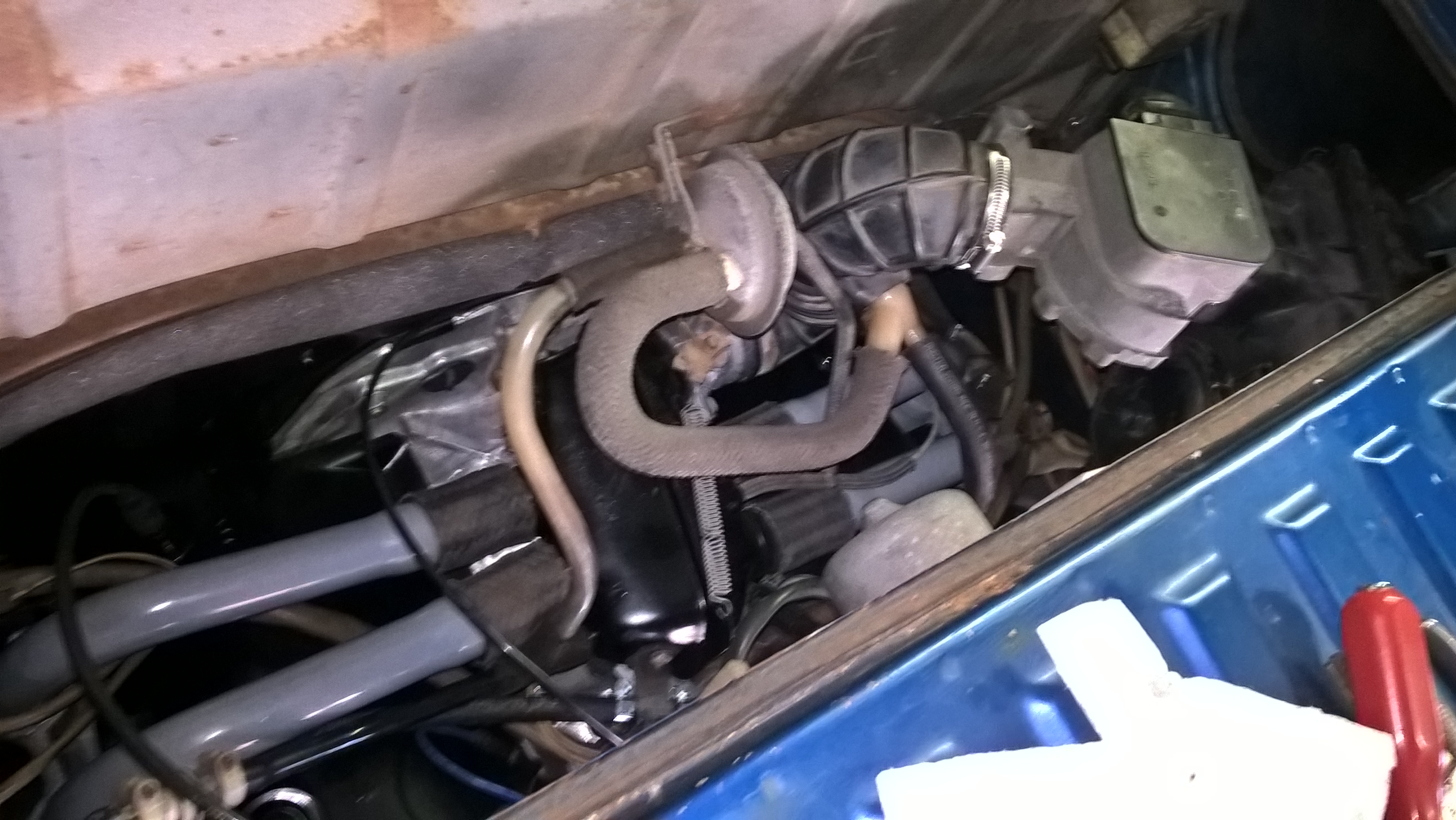

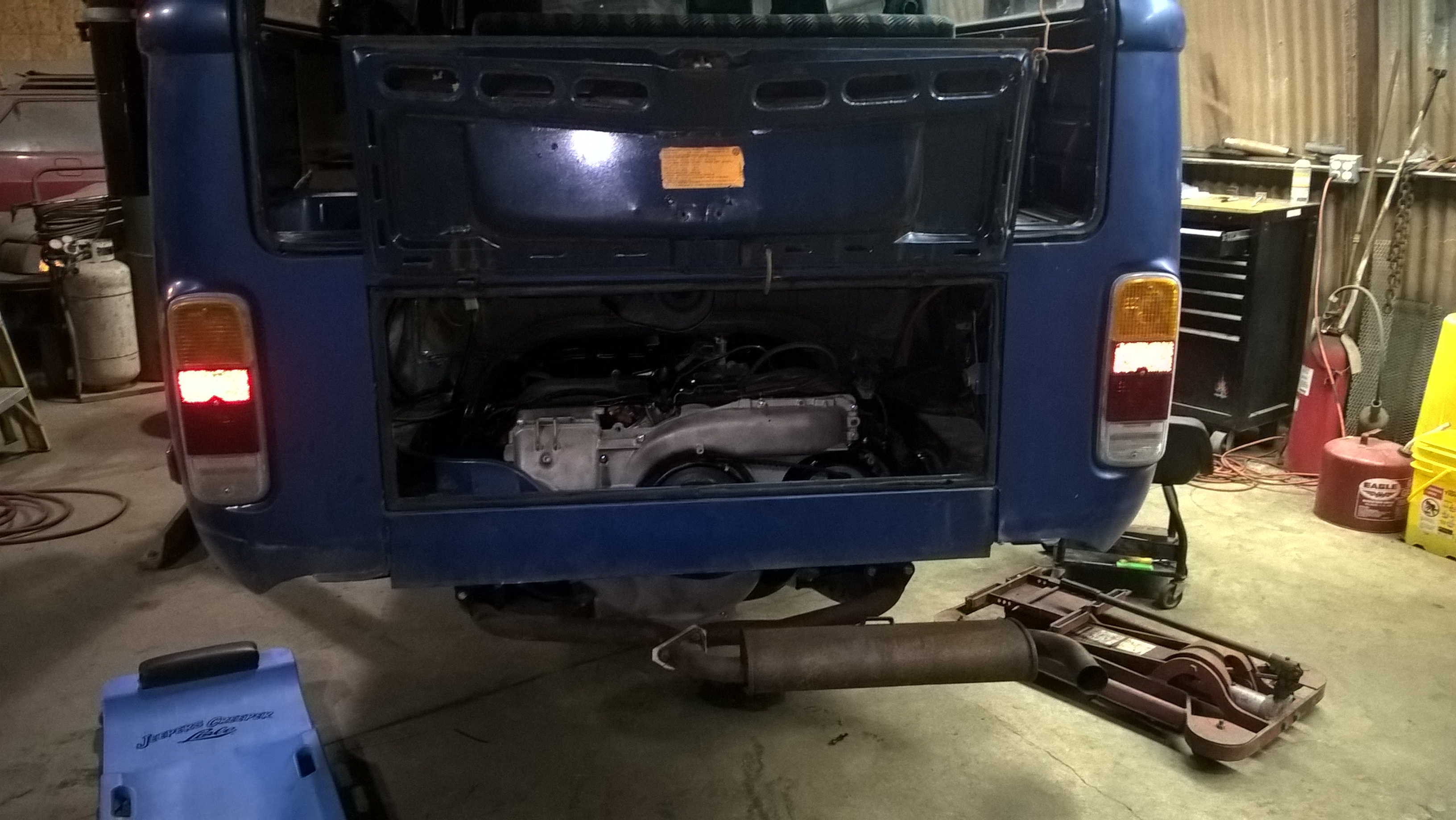

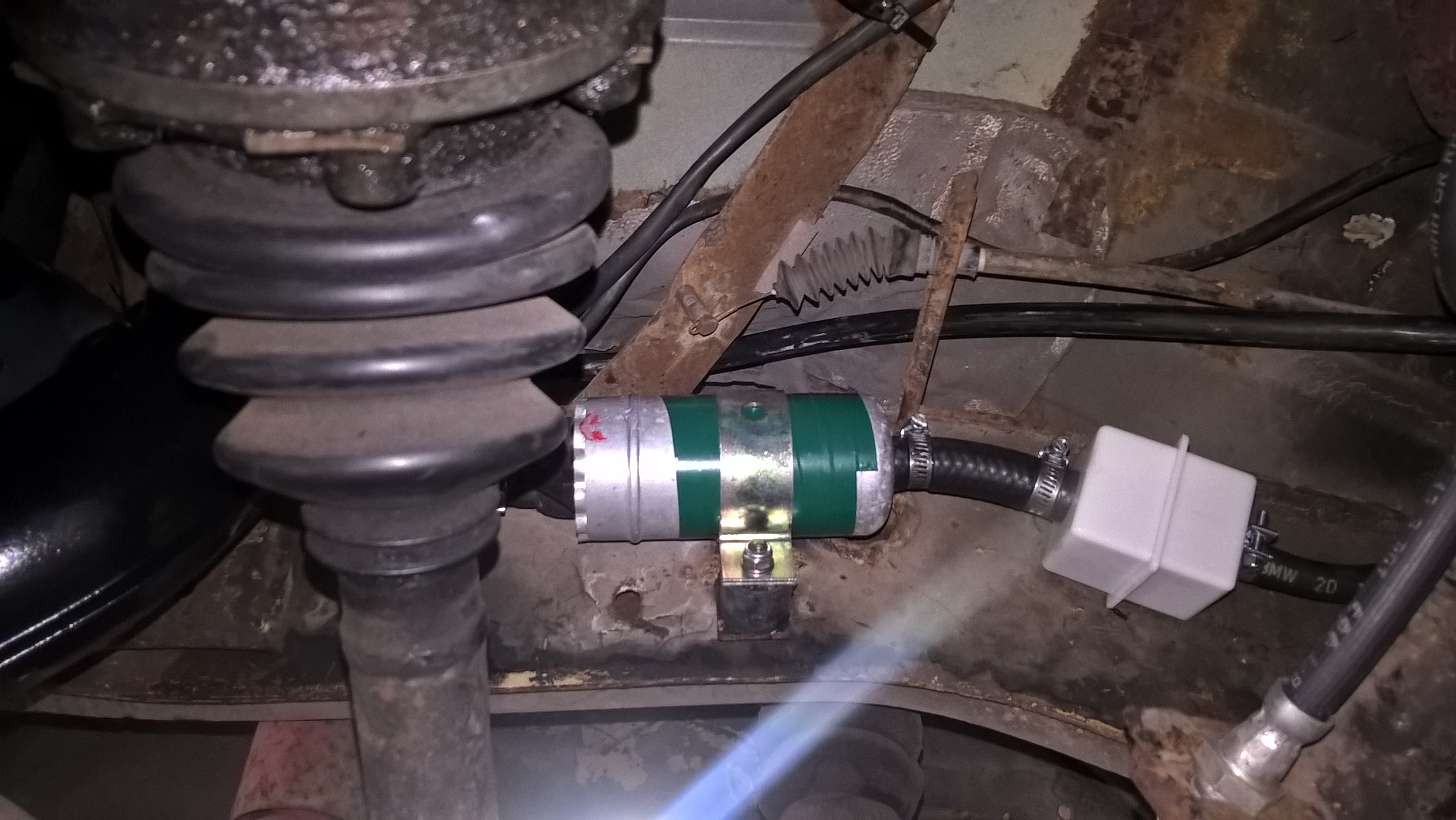

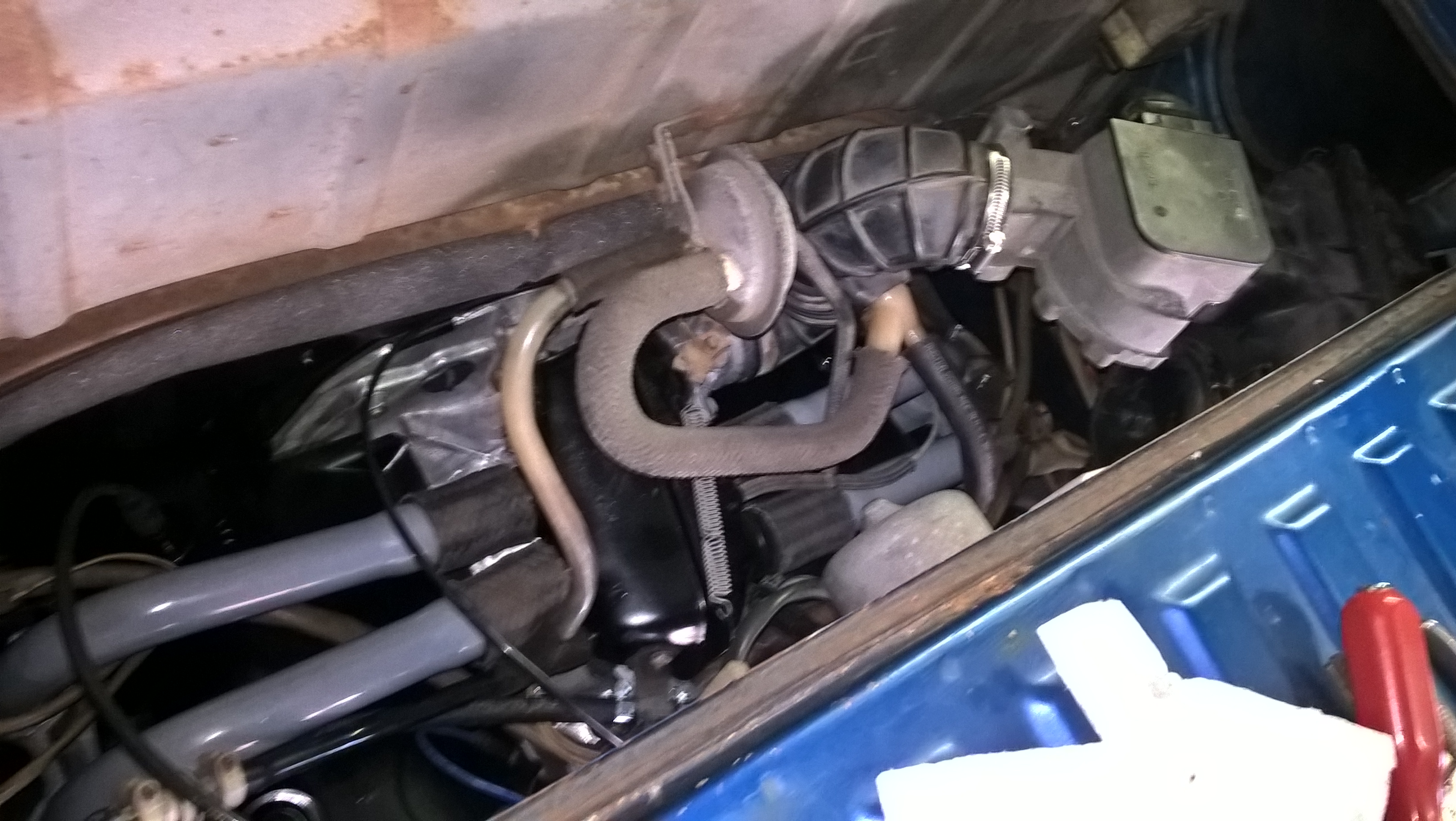

This turned out to be one fussy bus!
at first key, fuel pump leaked . Good thing Chuck had a new one at hand

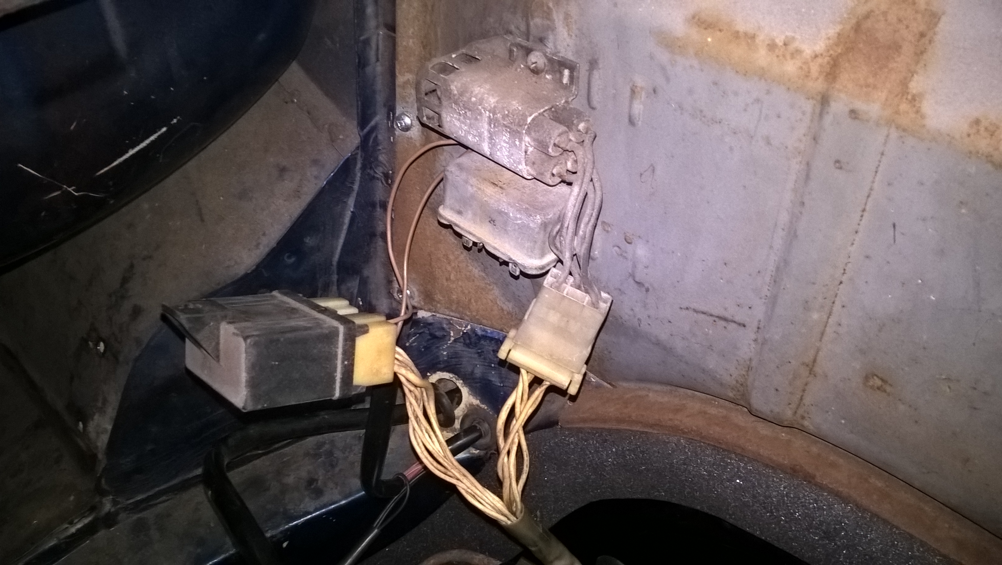

since it would not start, the double relay was swapped to no avail
then the ECU. same thing, no go. Turned out to be a ground wire.

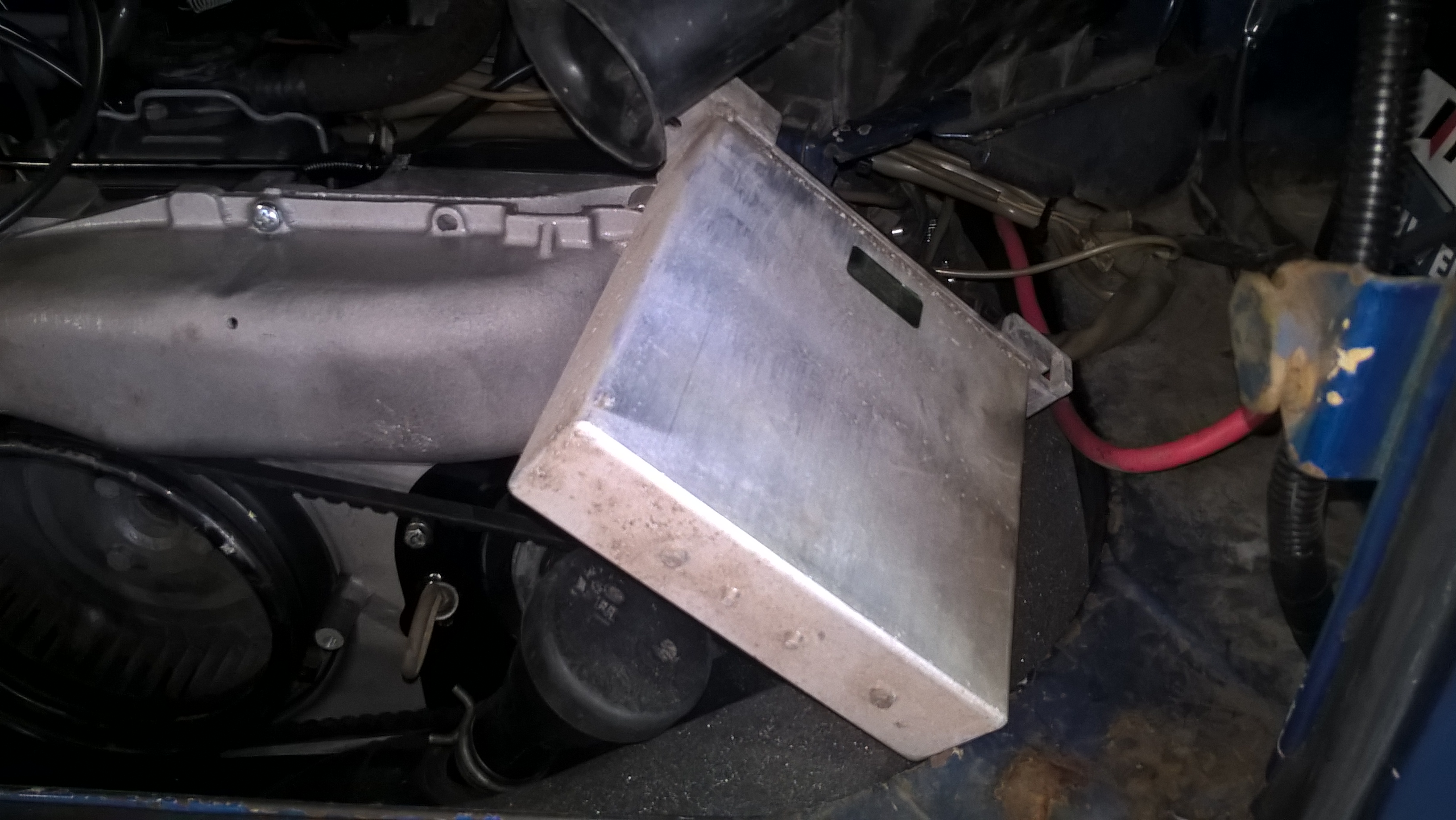

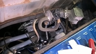

Chuck also swapped several air boxes to test different air flow sensors. Finally, success!

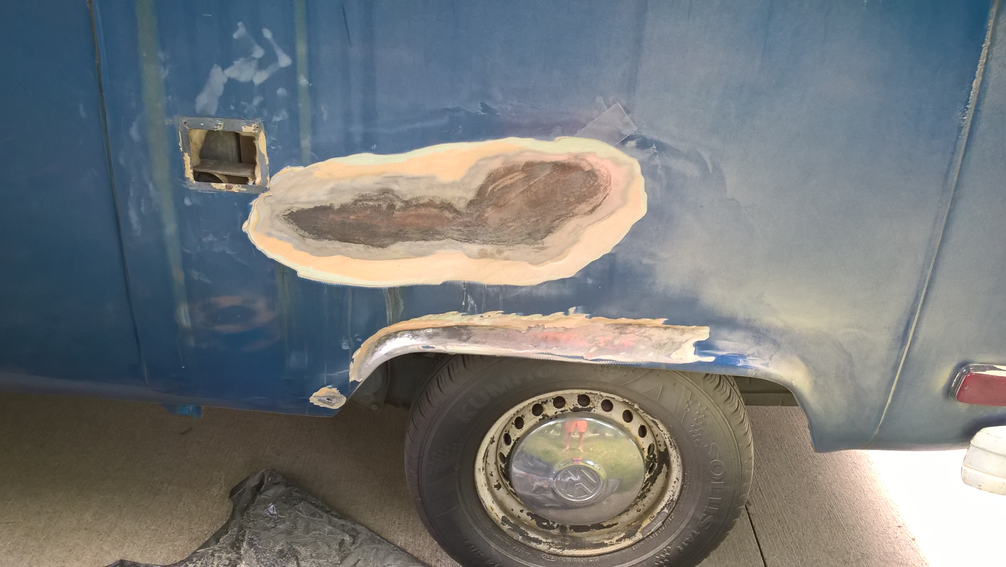

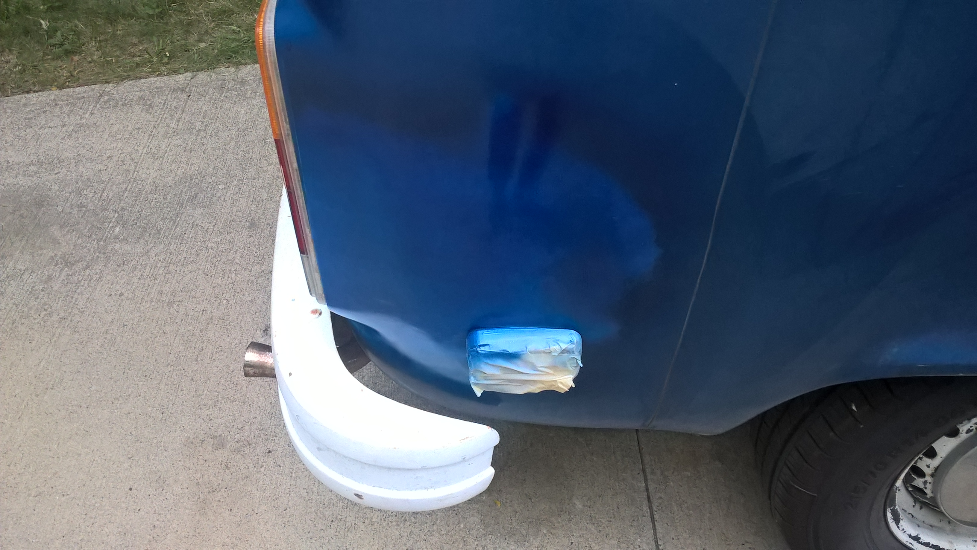

Although this is my engine build thread, I am gonna pretend that it's for everything.

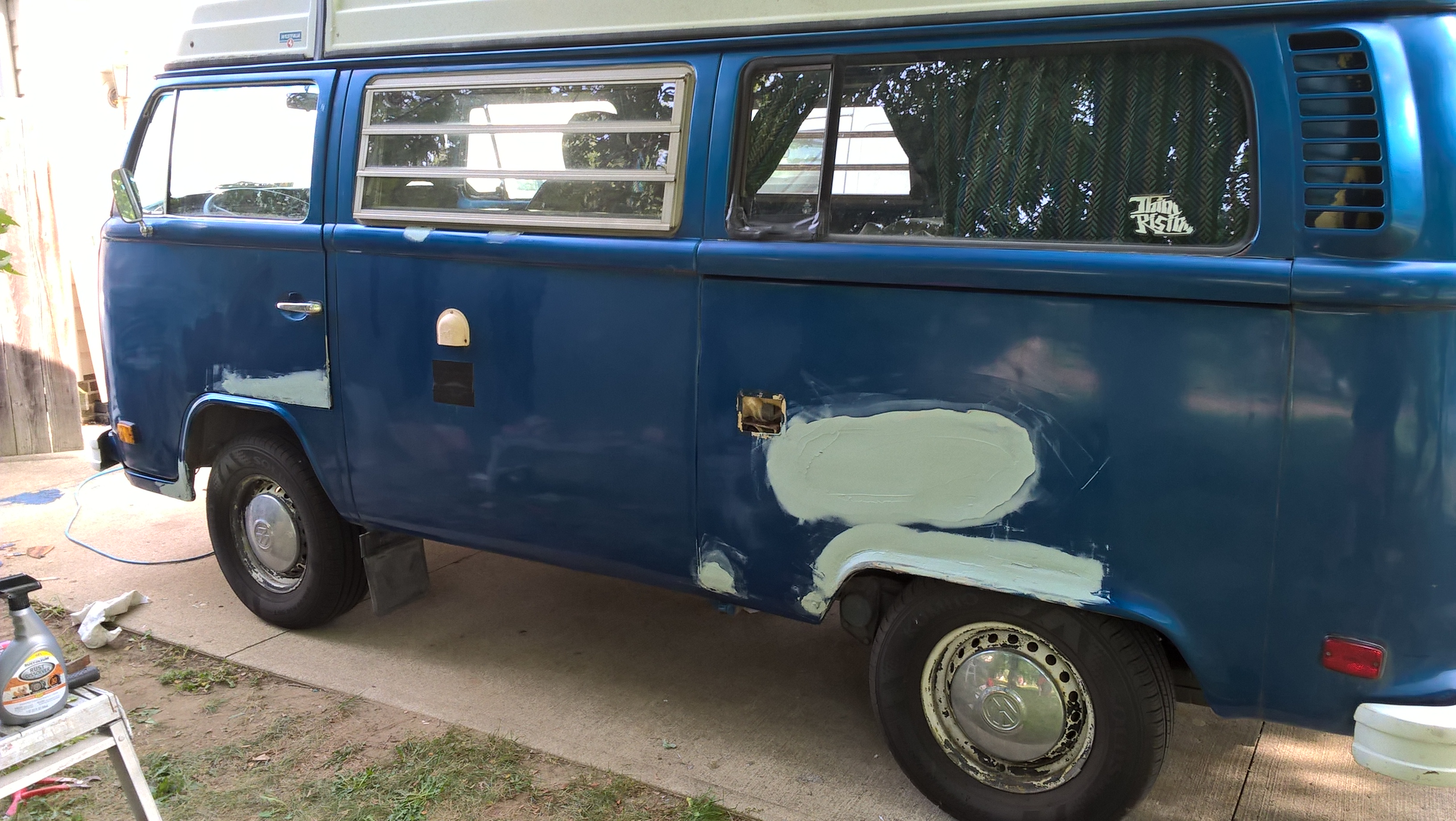

In an effort to make my bus less ratty for Oktoberfest, I decided to try my hand at bodywork.
This huge bondo crack hides a water pocket. My bus is a camel.
Bondo was 1/2"-3/4" thick in some areas. Rad!
I had obscene rust bubbles in other areas, forgot to take before pics

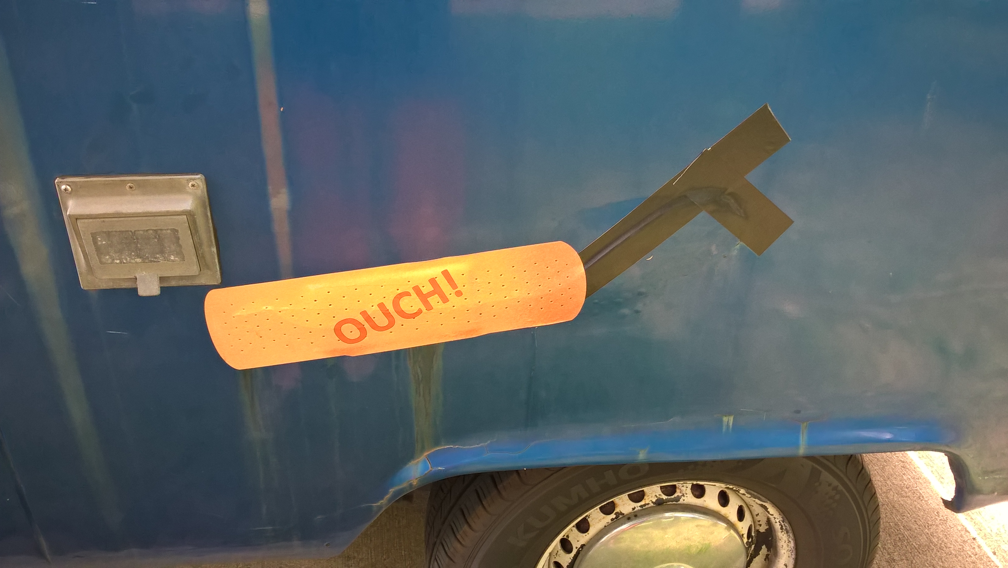

I will have Carlos replace the rusted metal under the windshield, and for now I will cover it again with black tape - or maybe a mac and cheese print for a change. Note to myself: pester Mike enough to teach me how to weld so I can replace bad metal myself, instead of ghettoing it with bondo.

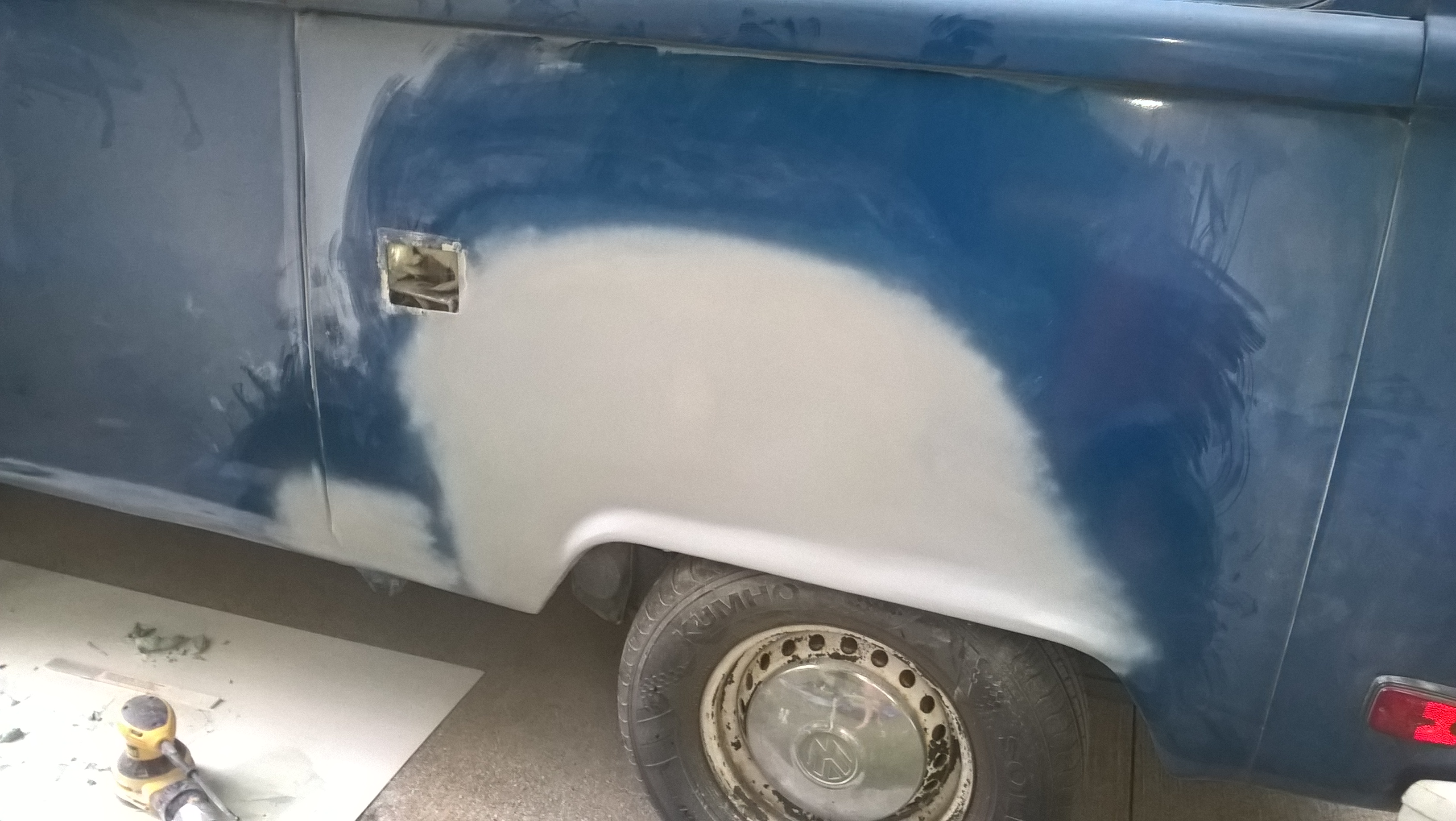

good thing I can do drywall. Did not have a long block so I used a 16" taping blade to try and spread evenly and minimize sanding

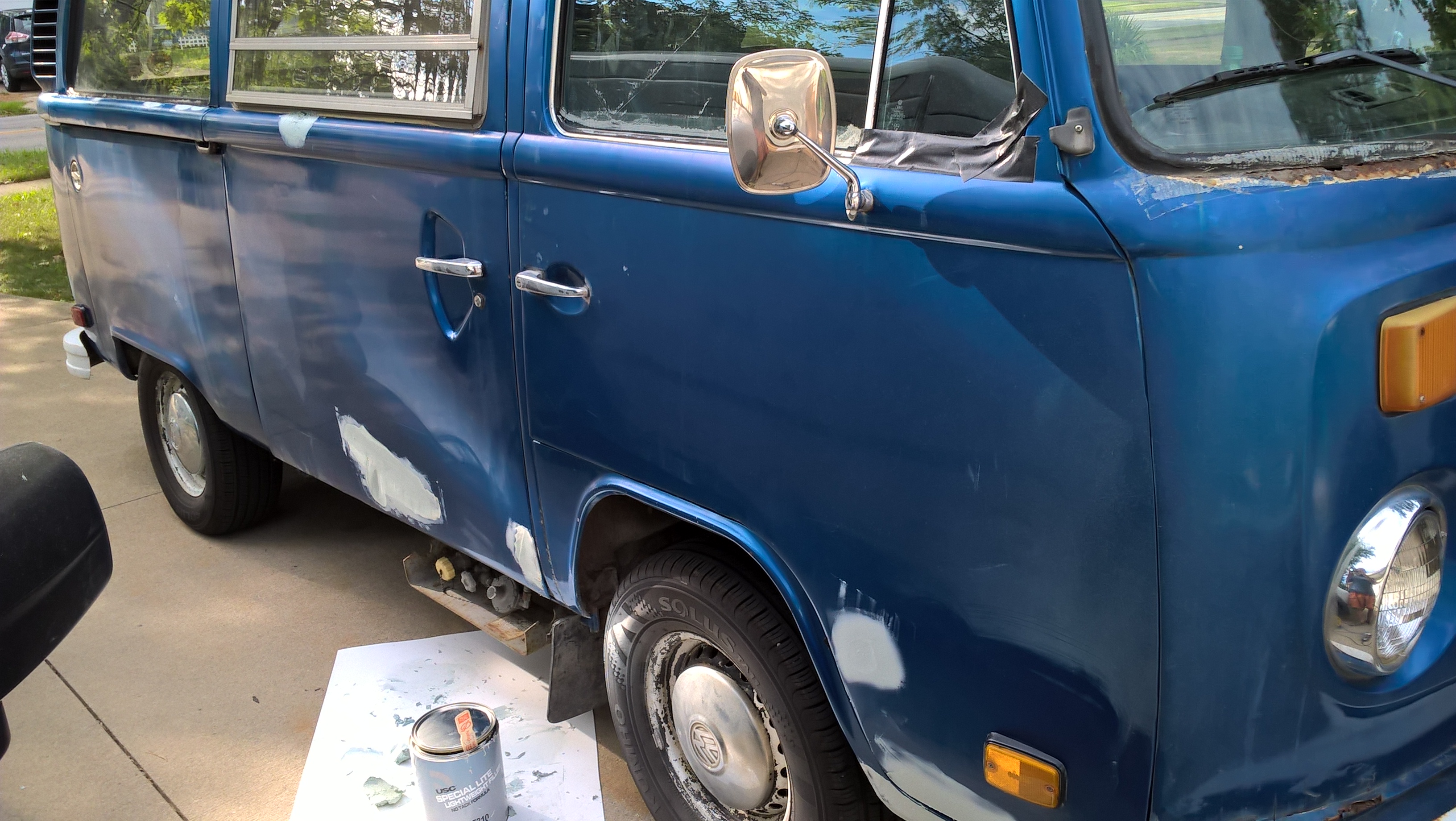

Armstrong Paint Supply scanned the color and matched it in spray can form. Fail.
big hole under window gone. good thing the rubber seal is baked rock hard.

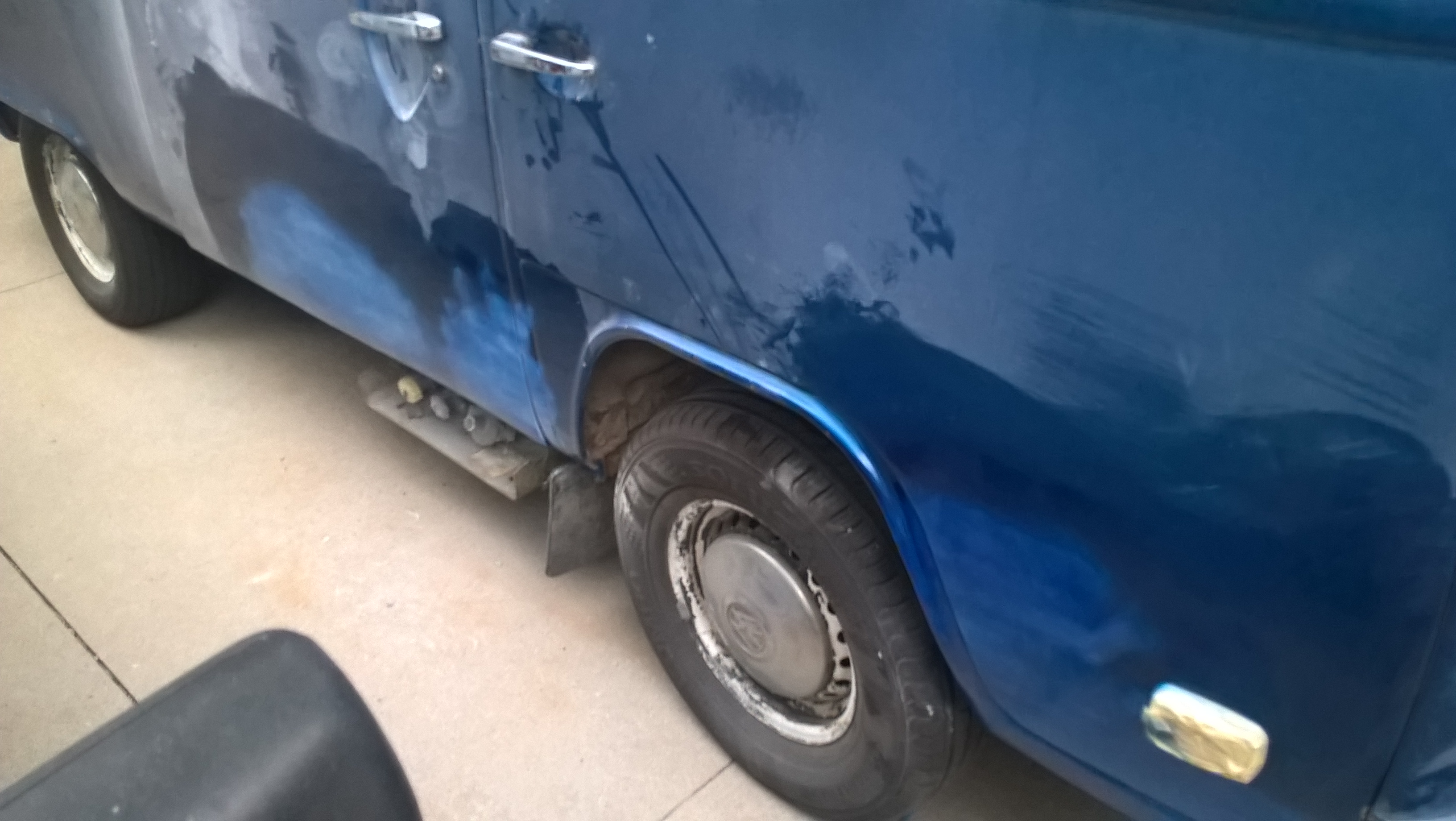

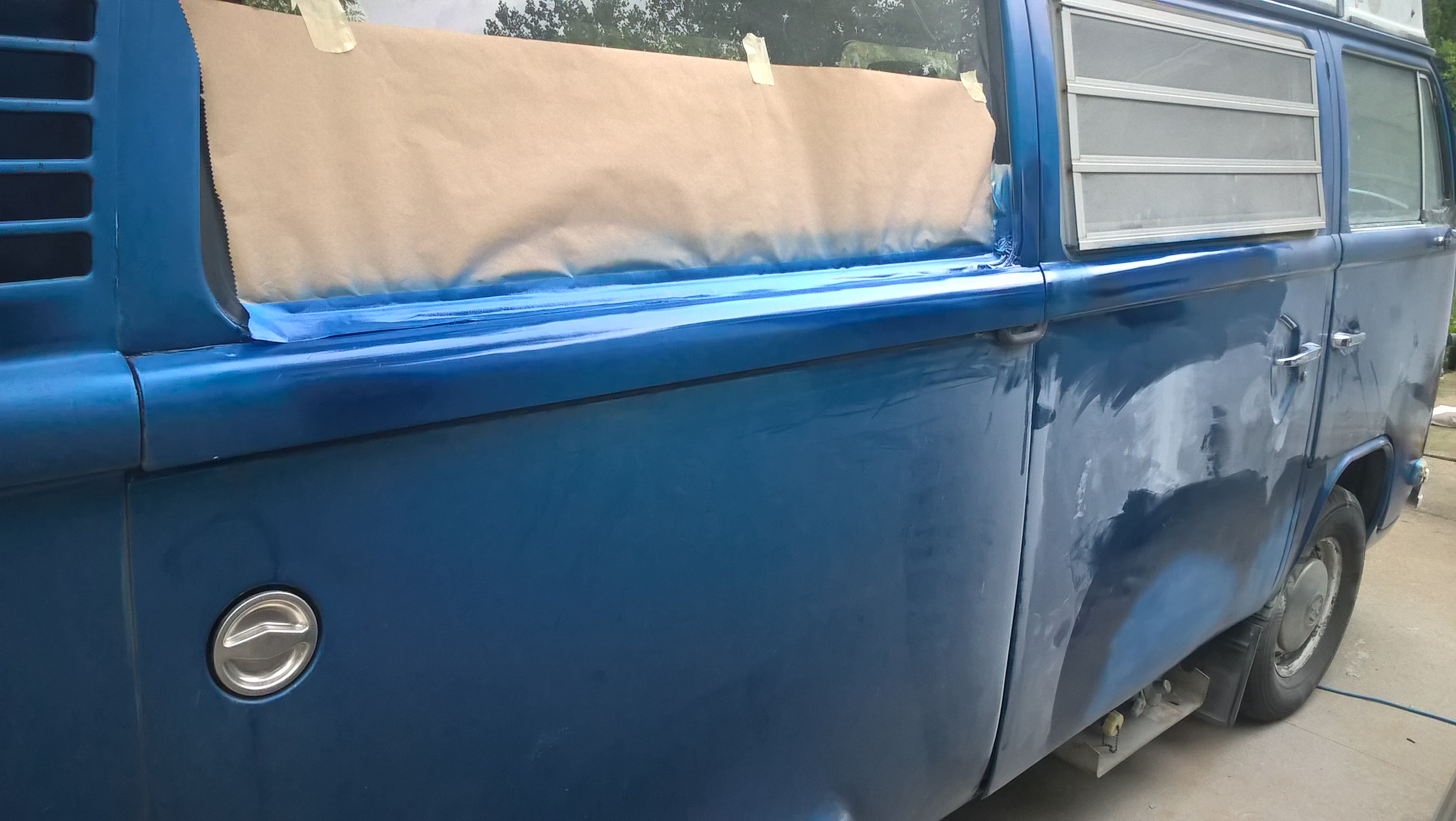

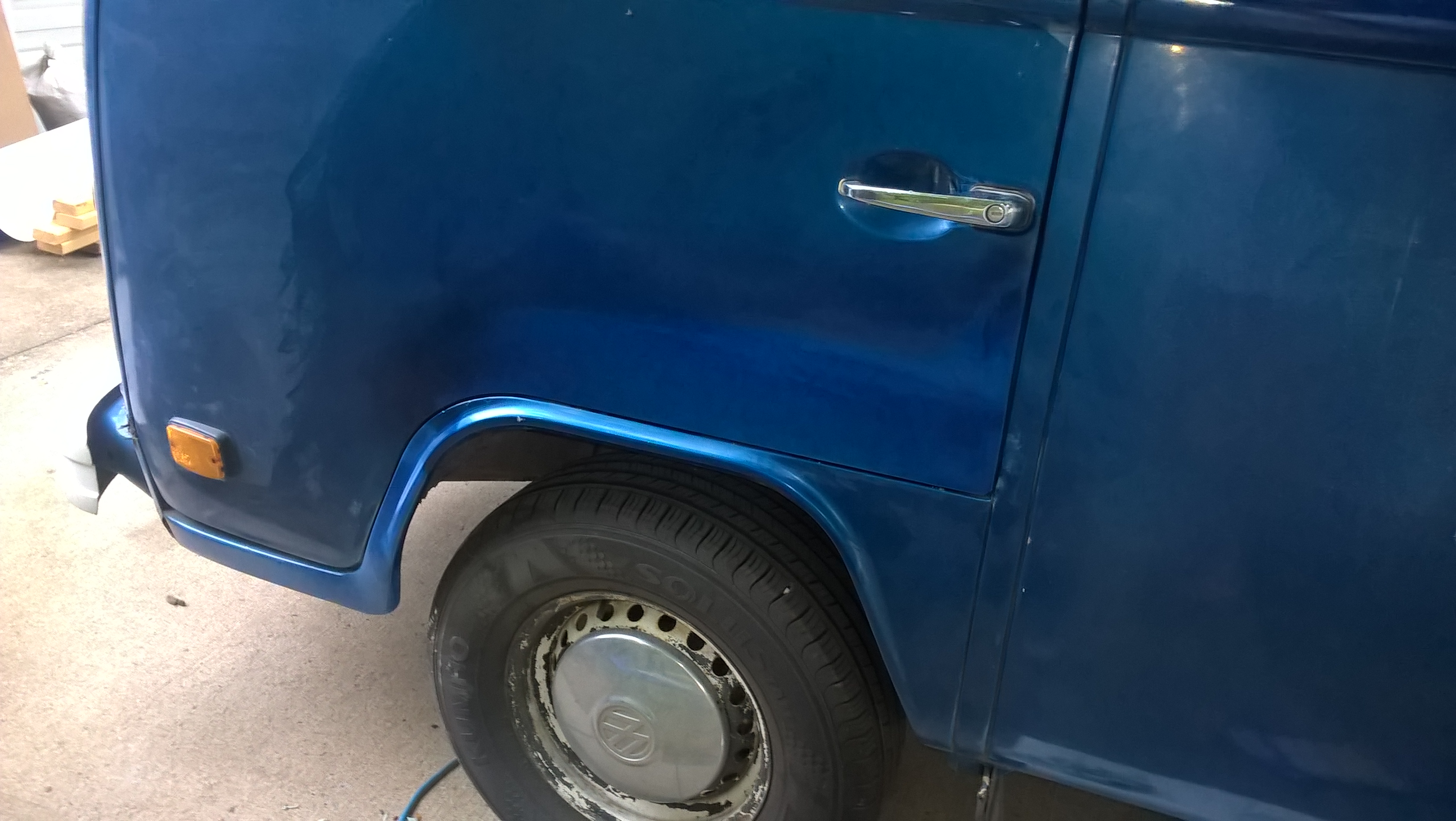

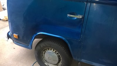

I also ran out of paint
The end result: the sides look infinitely better, but because of the color mismatch, the bus is still ratty, just on another level. Win.
