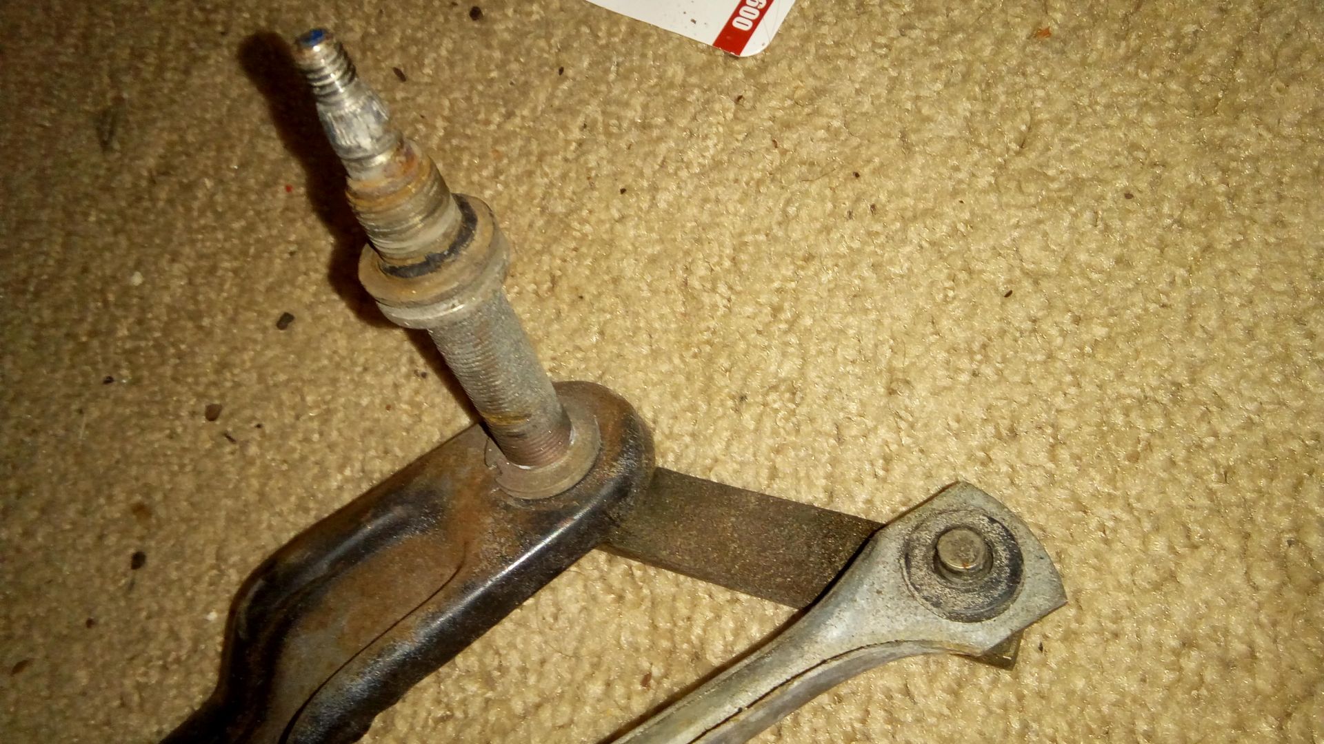

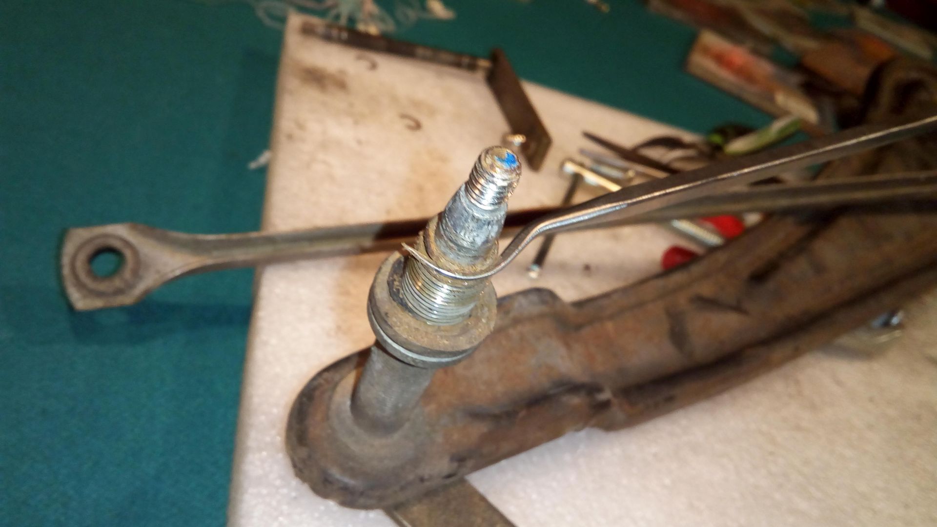

Next step is taking linkages apart, and removal of wiper shafts for inspection, clean and lube.

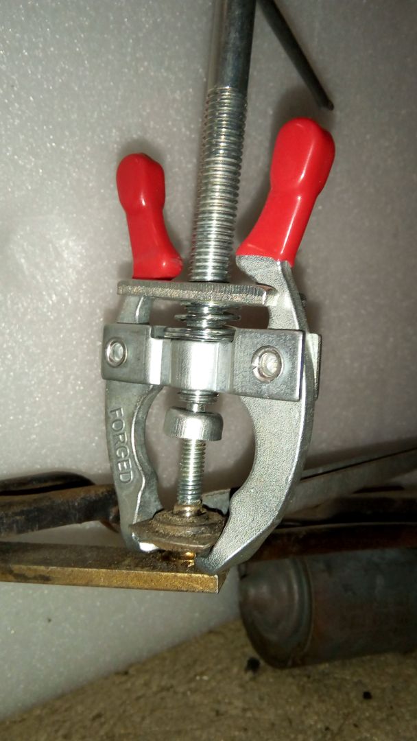

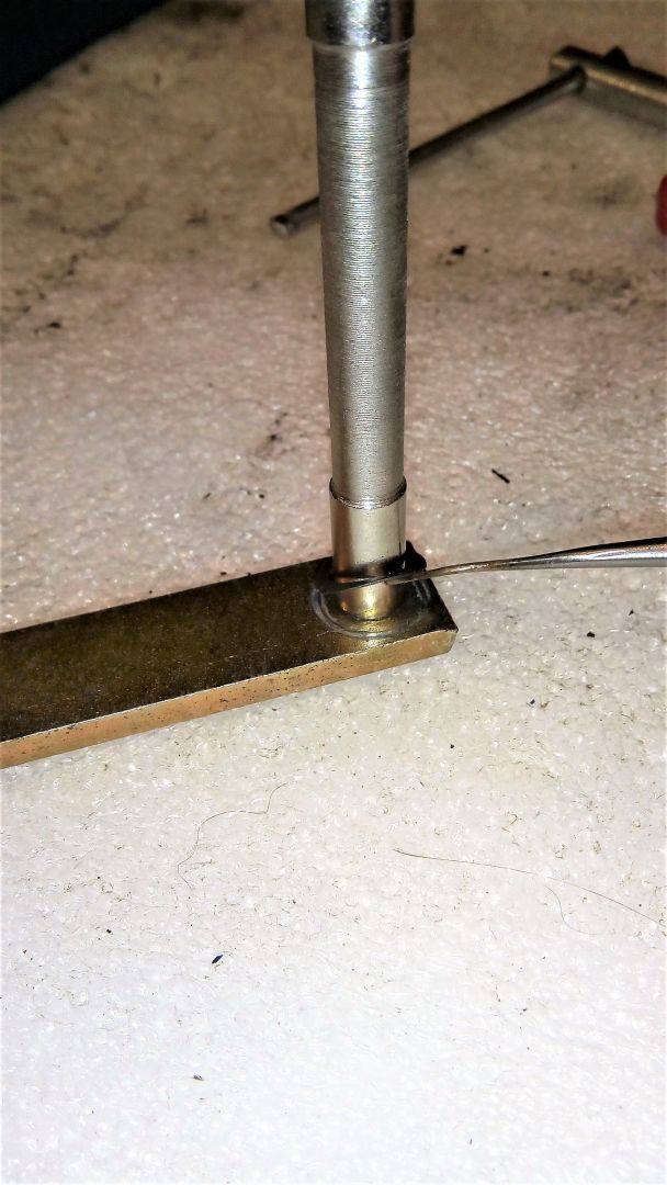

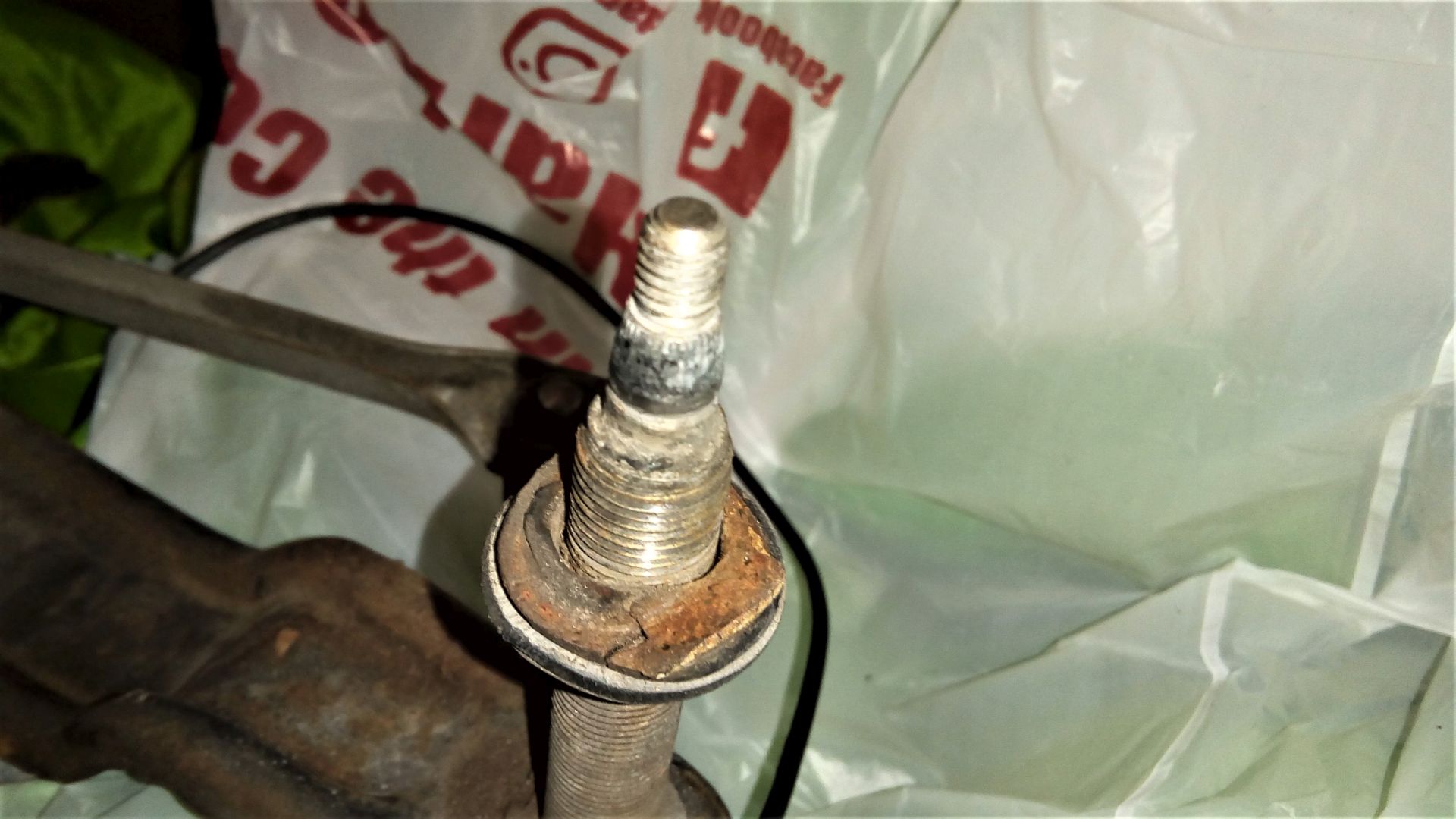

Linkage arms are kind of bendy, so I refrained from prying them apart. A battery terminal puller will do the trick. The cup at the end of the puller is too big so I inserted a bolt in between the cup and the linkage/articulation.

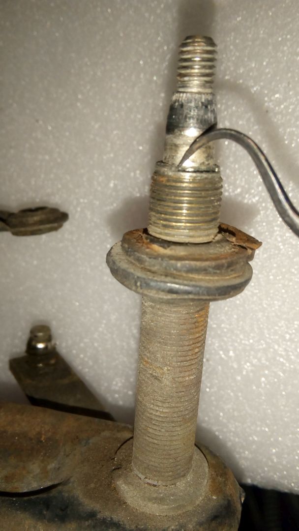

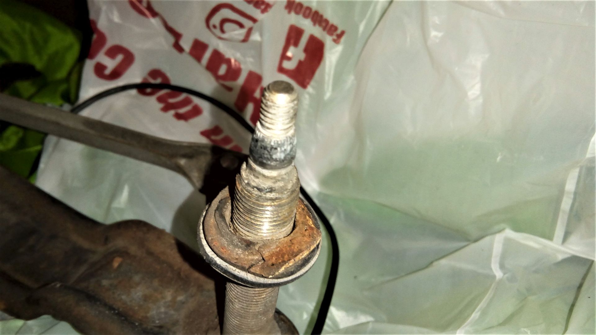

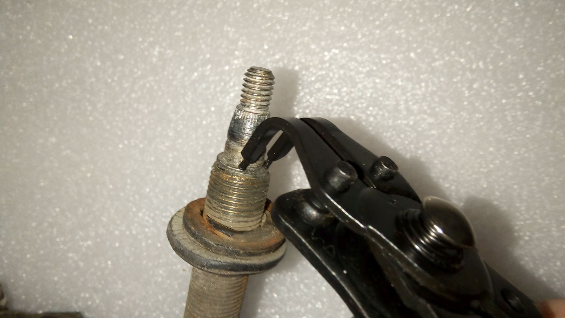

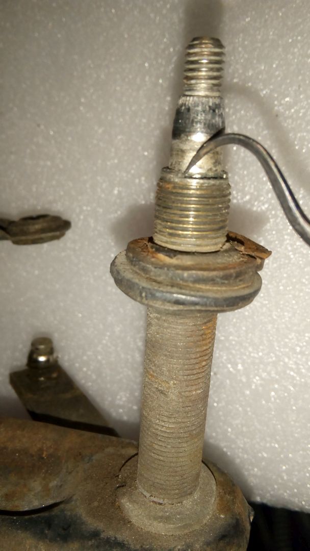

somewhere under this grime there's a circlip that prevents the wiper shaft from pulling out

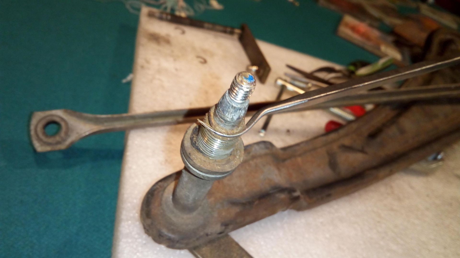

After poking around with a pointy thingy, I found the groove; you can see one end of the circlip right by the tip of the pick
Earlier in the day, I had a 20% off superbowl HF coupon and I got me a set of snap ring pliers for 5 bucks, and got a free multimeter with it.
Yeah, I know they are not for this kind of clip, but they worked

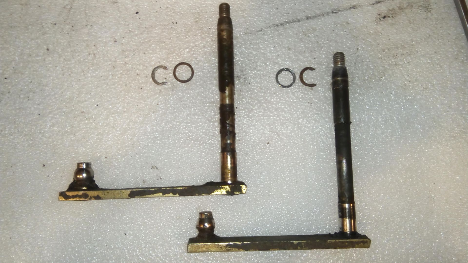

after removing the clip, I found a washer underneath
one shaft slid out with ease, the other was really caked. I sprayed it on both ends with brake cleaner and worked it for a few minuted until it came out
While cleaning the parts I discovered another washer, buried in grime at the base of the shaft
It's a wavy little thing

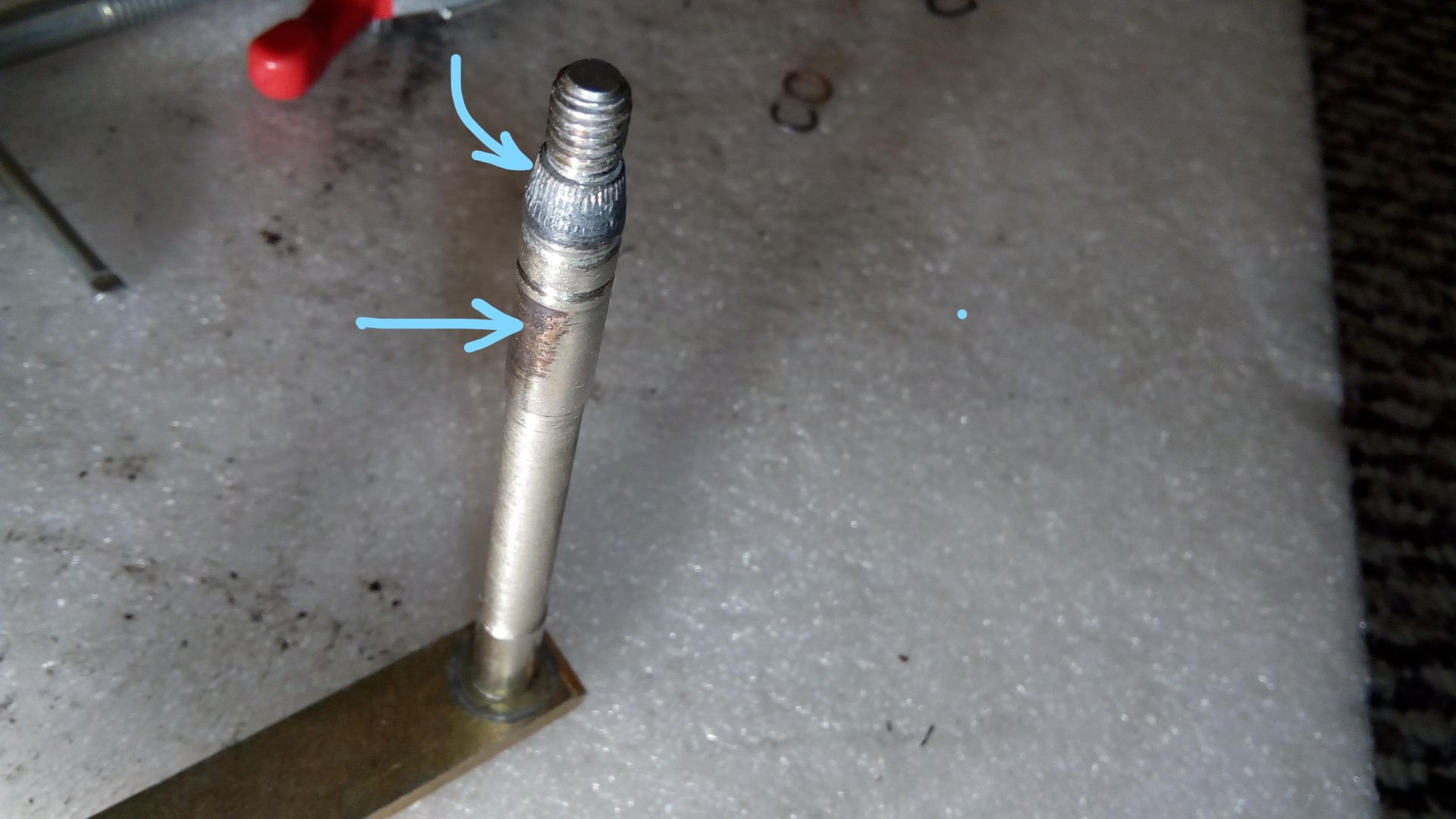

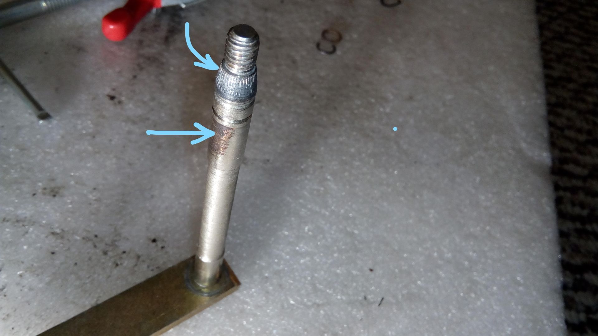

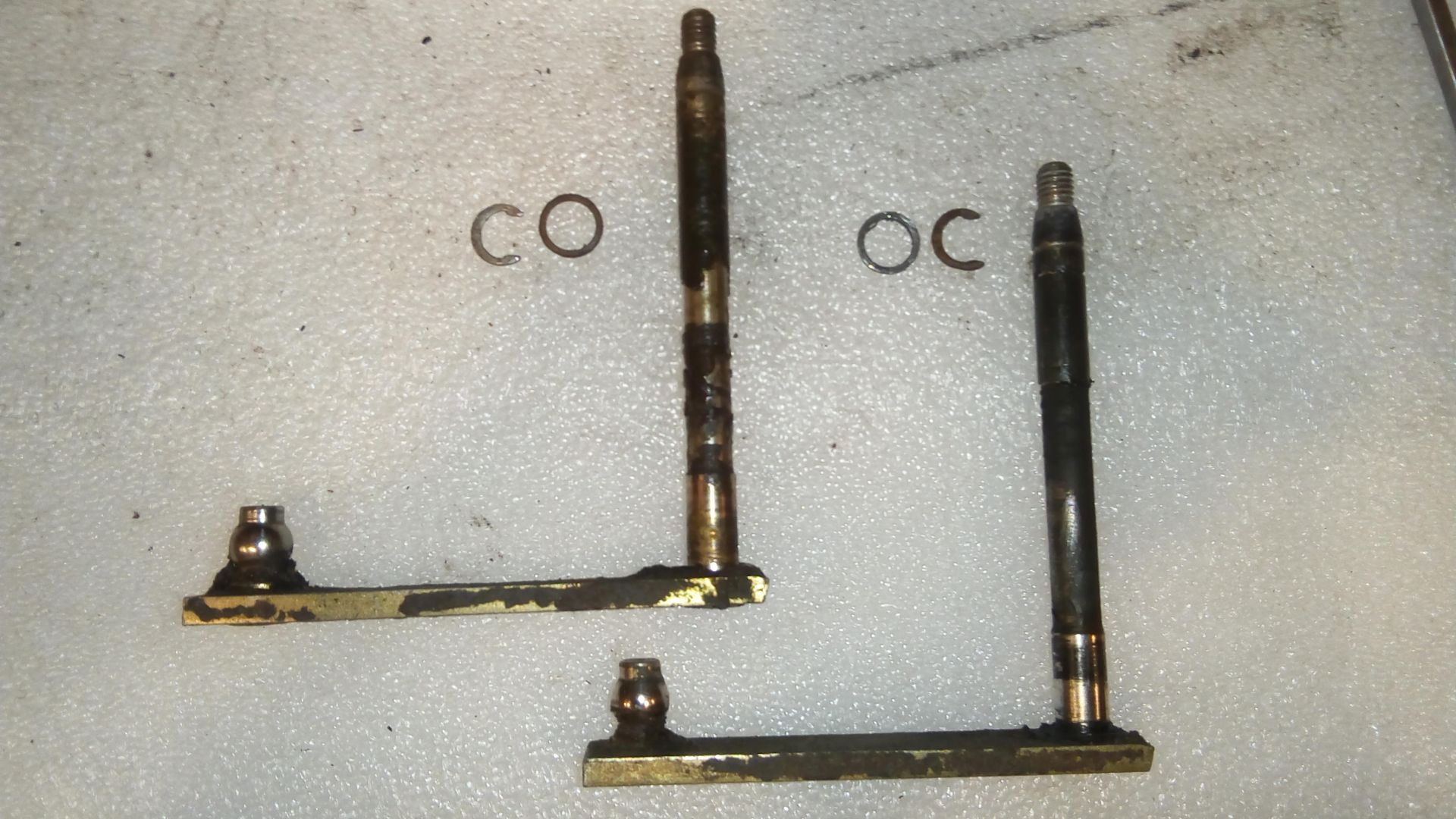

Notice the worn out splines below the threads; and the rusty area below the clip groove is actually slightly recessed from wear

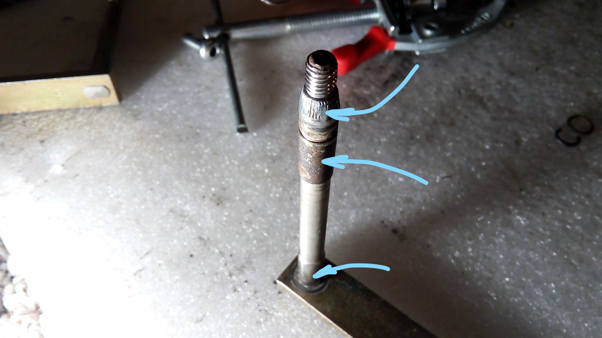

The other shaft was the stuck one; splines are also damaged, and there is evidence that water infiltrated all the way to the bottom
I can gently sand down the rusty areas and pack everything tight, but there will be slop; my main concern is the damaged splines, which will cause the wiper arms to eventually skip.
IMO these shafts are shot and due for replacement. What do you think? Can I make these original ones work, or should I just get some crappy after market ones http://vwparts.aircooled.net/Wiper-Shaf ... m?CartID=1 ?

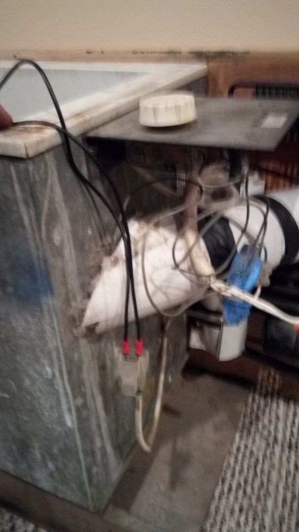

I also worked on the fridge. I never had a chance to try it out because the control panel wiring harness is missing. It's a simple unit that has no moving parts except the thermostat knob; the ammonia solution cycles through the tubes by gravity. I can hear the liquid sloshing through the lines; at least it's not crystallized! The fridge should draw over 5 amps so it will deplete the aux battery within hours, but it may be ok on shorepower.
The plan is to check each component, figure out the wiring, and then test the whole unit, rigged to a house outlet.

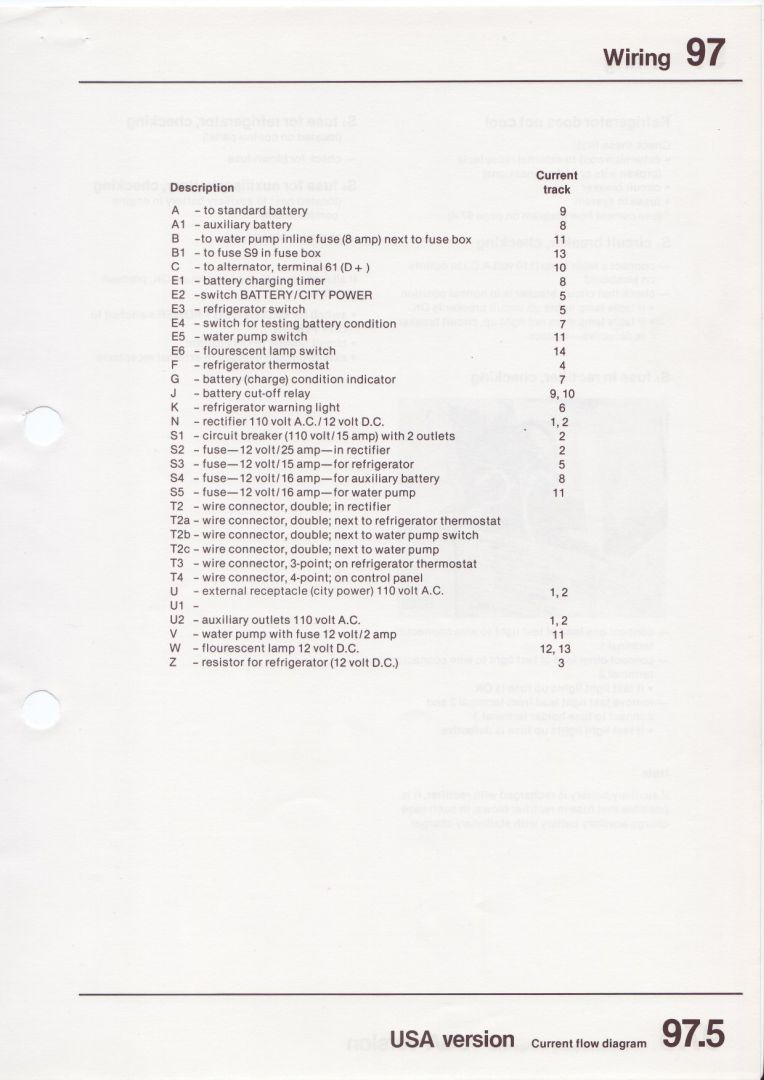

As a reference, I am using the refrigerator section in the 78 Westfalia troubleshooting manual. https://www.thesamba.com/vw/archives/ma ... manual.php

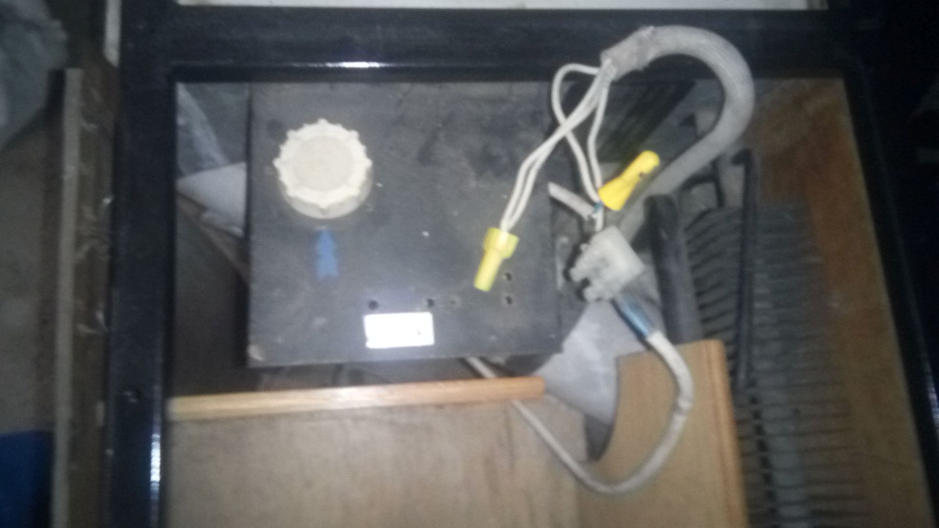

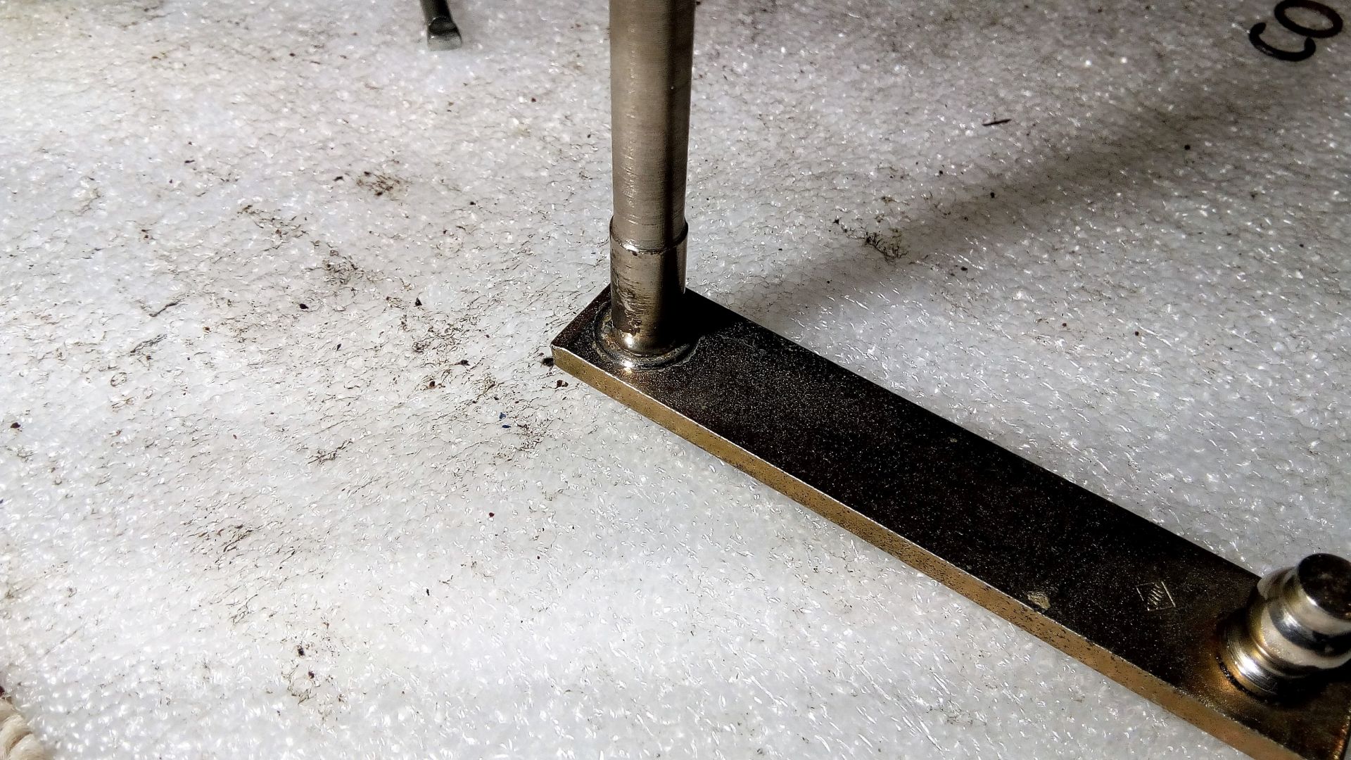

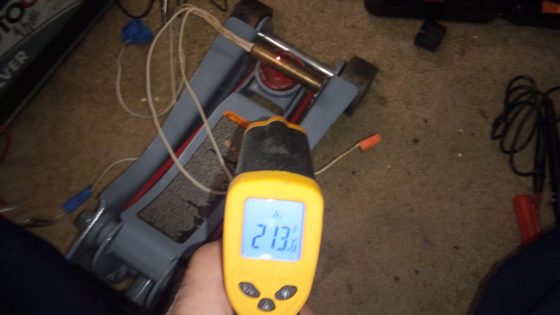

Testing the heating element.

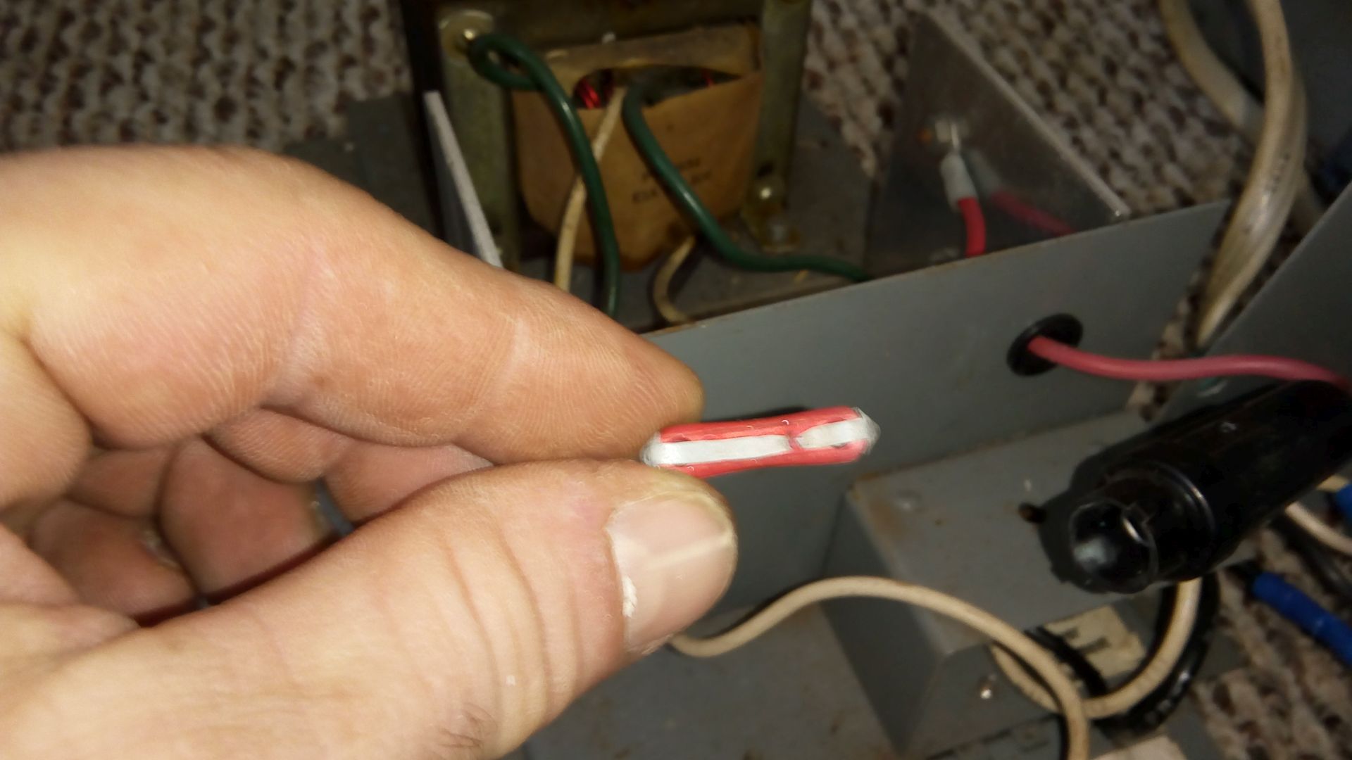

The yellow wire nuts and the electrical tape on the insulation mean that a PO messed with the unit.

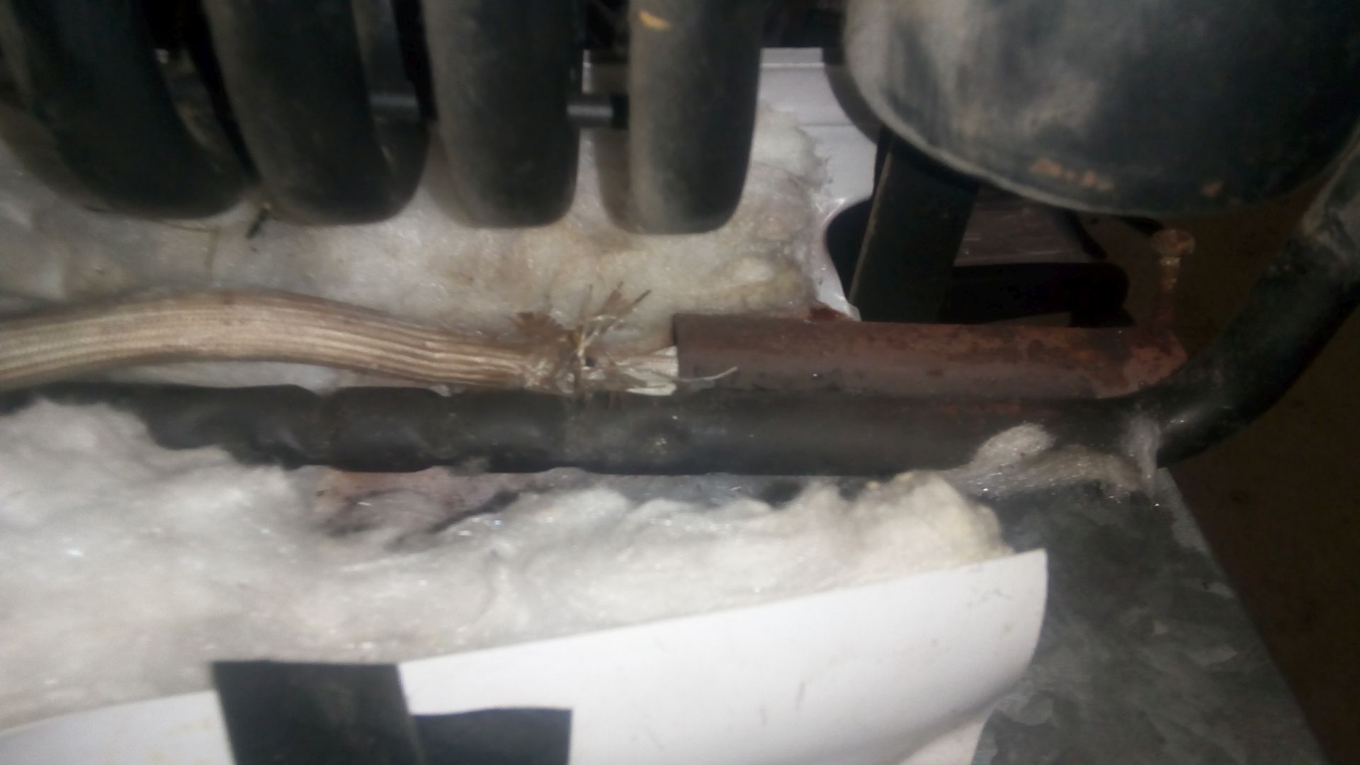

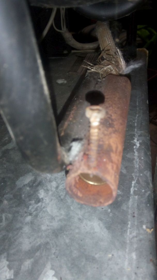

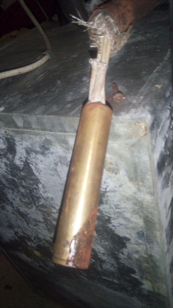

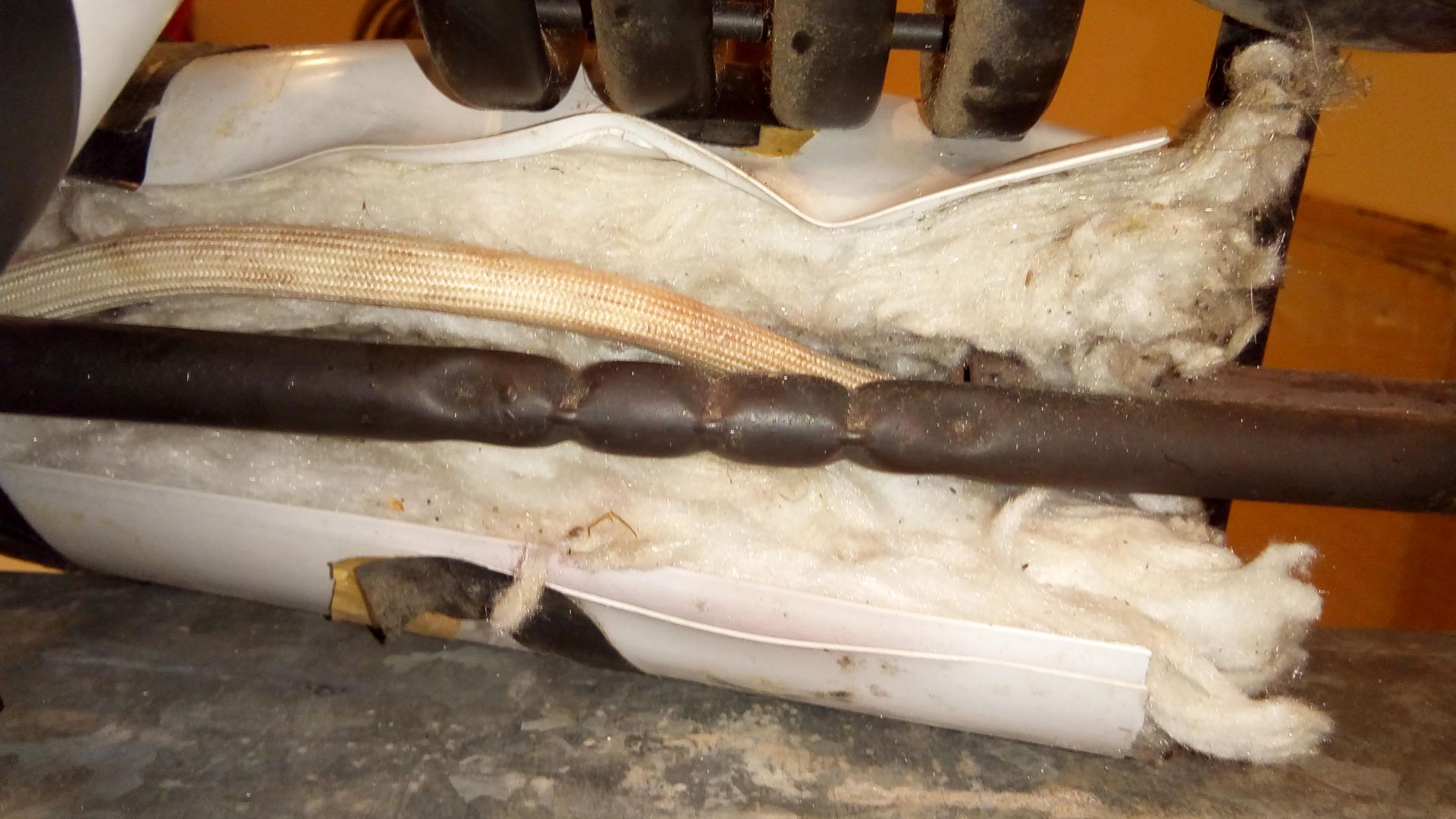

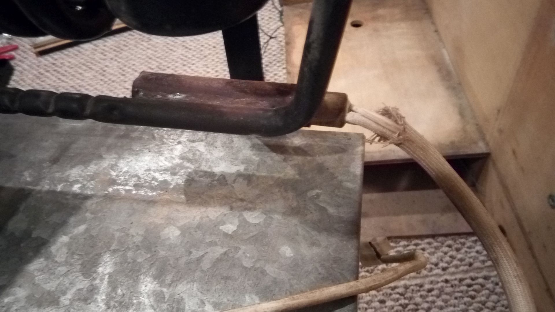

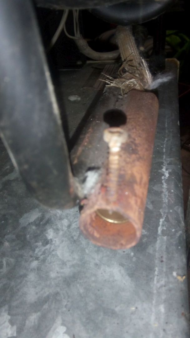

Removal of the bottom insulation reveals the heating element, hidden inside a tube welded to the coolant line

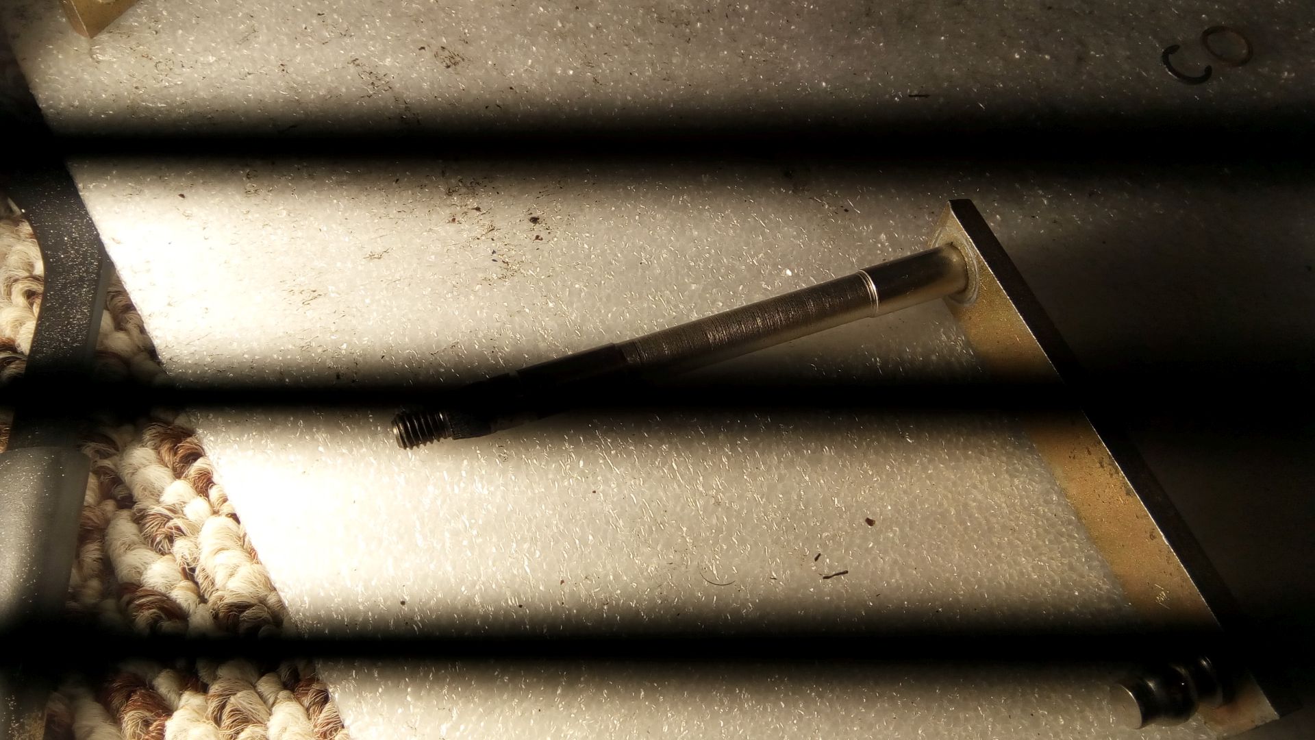

you can see the tip of it inside the tube; admire the ghetto clamping screw!

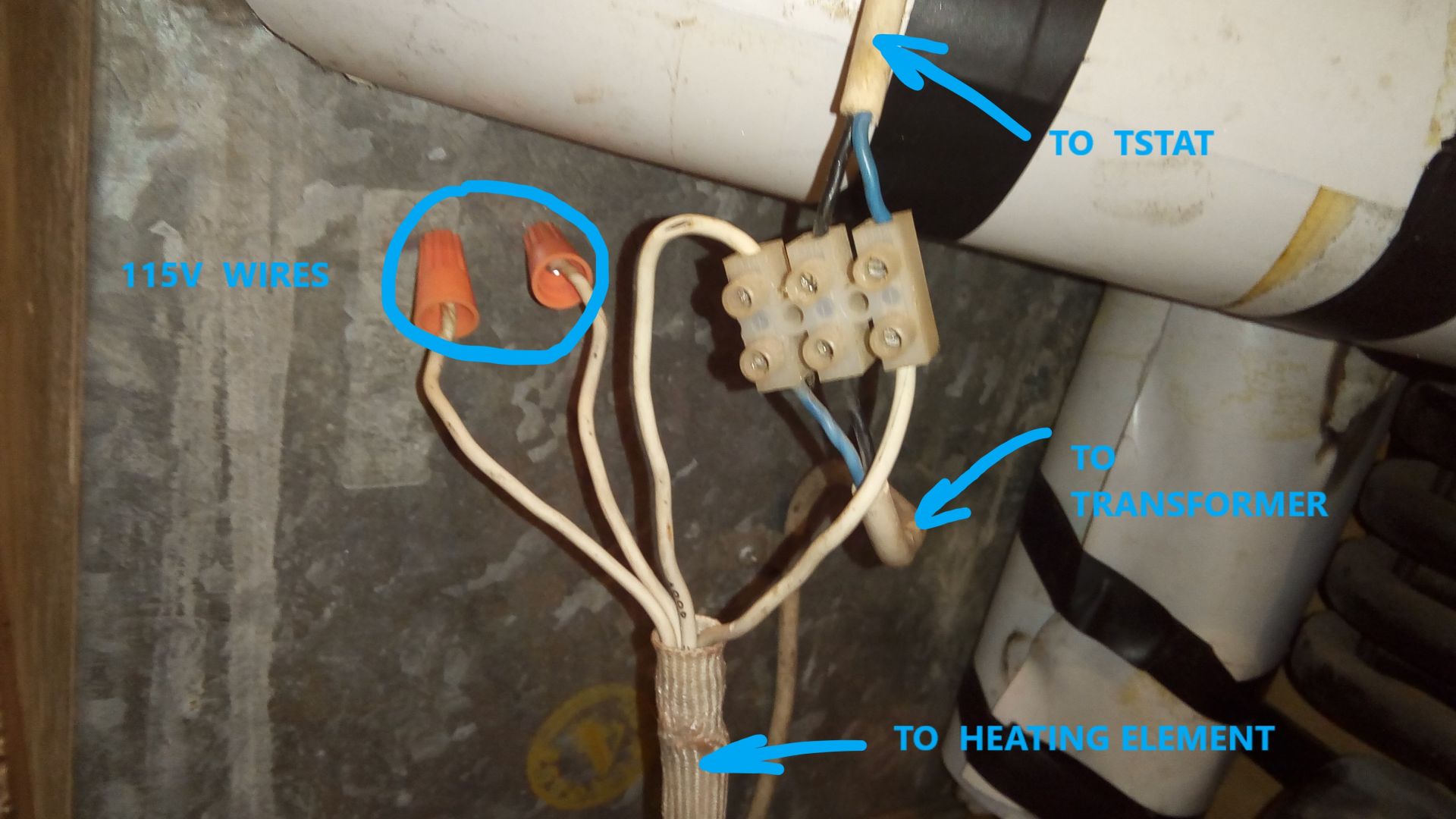

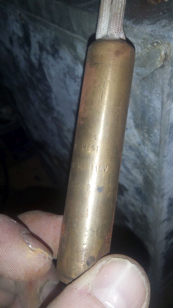

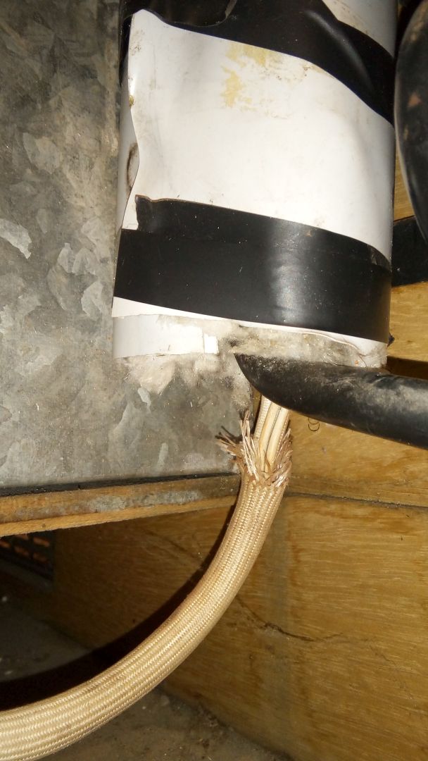

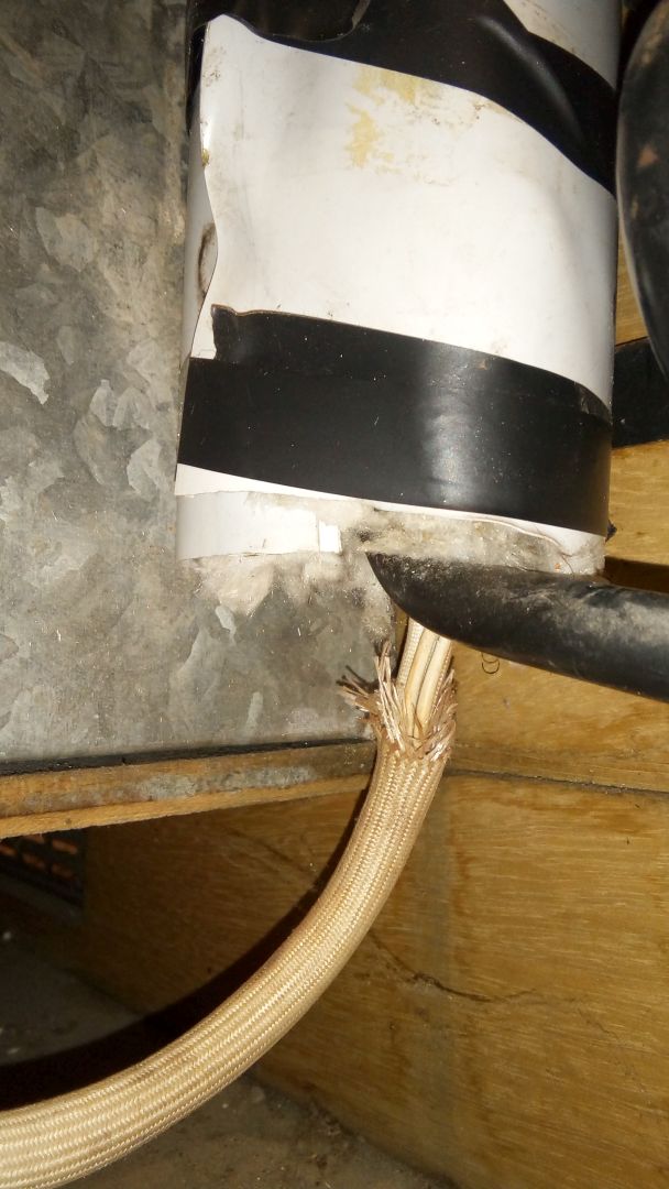

The heating element slides out easily; the first problem is that there are four wires coming out of it, instead of two
Notice the stamping for both 12v and 115v, which means that it belonged to a canadian model - with separate circuits for battery and shore power.

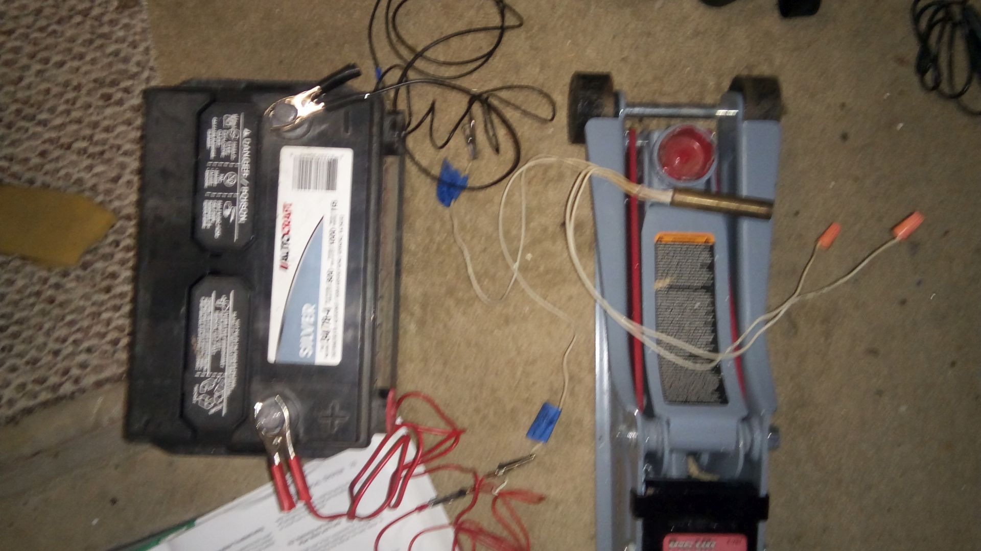

Next I removed the fabric insulation to expose the entire length of the wires, so I can separate the 12v pair from the 112v pair. I assumed that the 12v pair was the one initially hooked to the blue and black wires on the socket; I actually lucked out on it.Testing is easy - just hook up the wire pair to the battery terminal - I don't think polarity matters
the element started immediately, and was piping hot within 20 seconds
So the heating element is good!

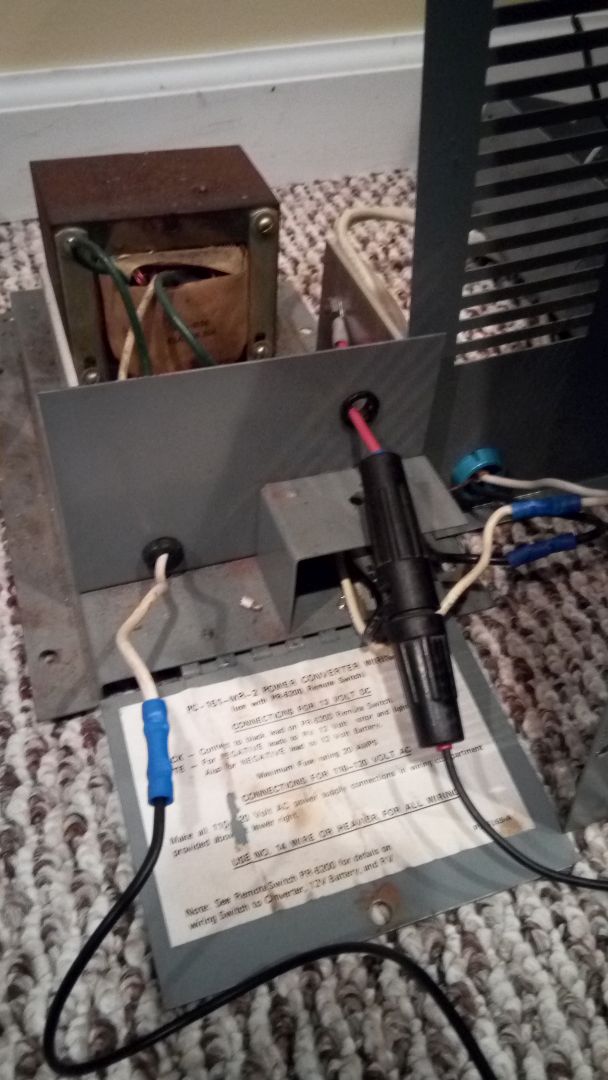

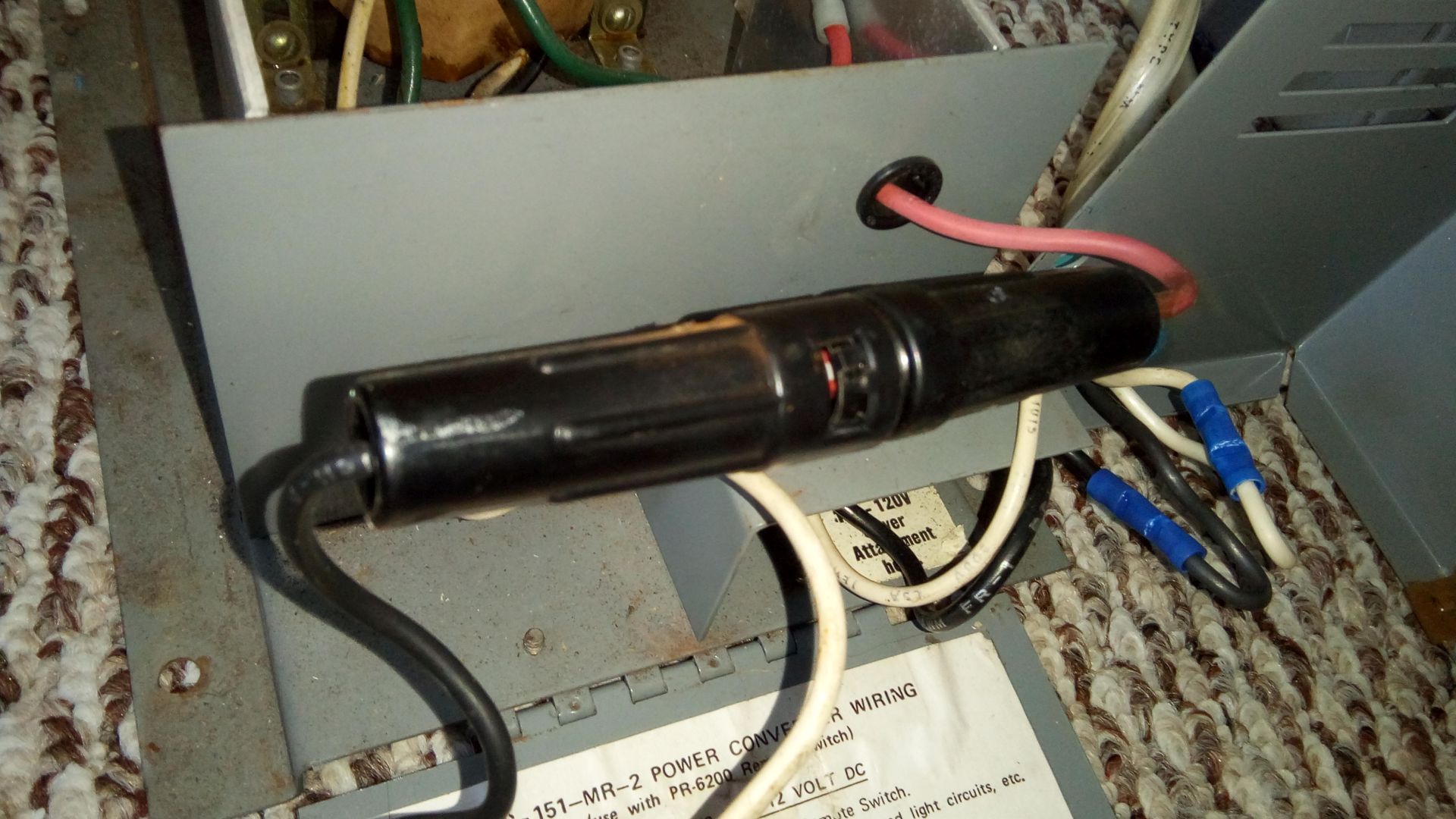

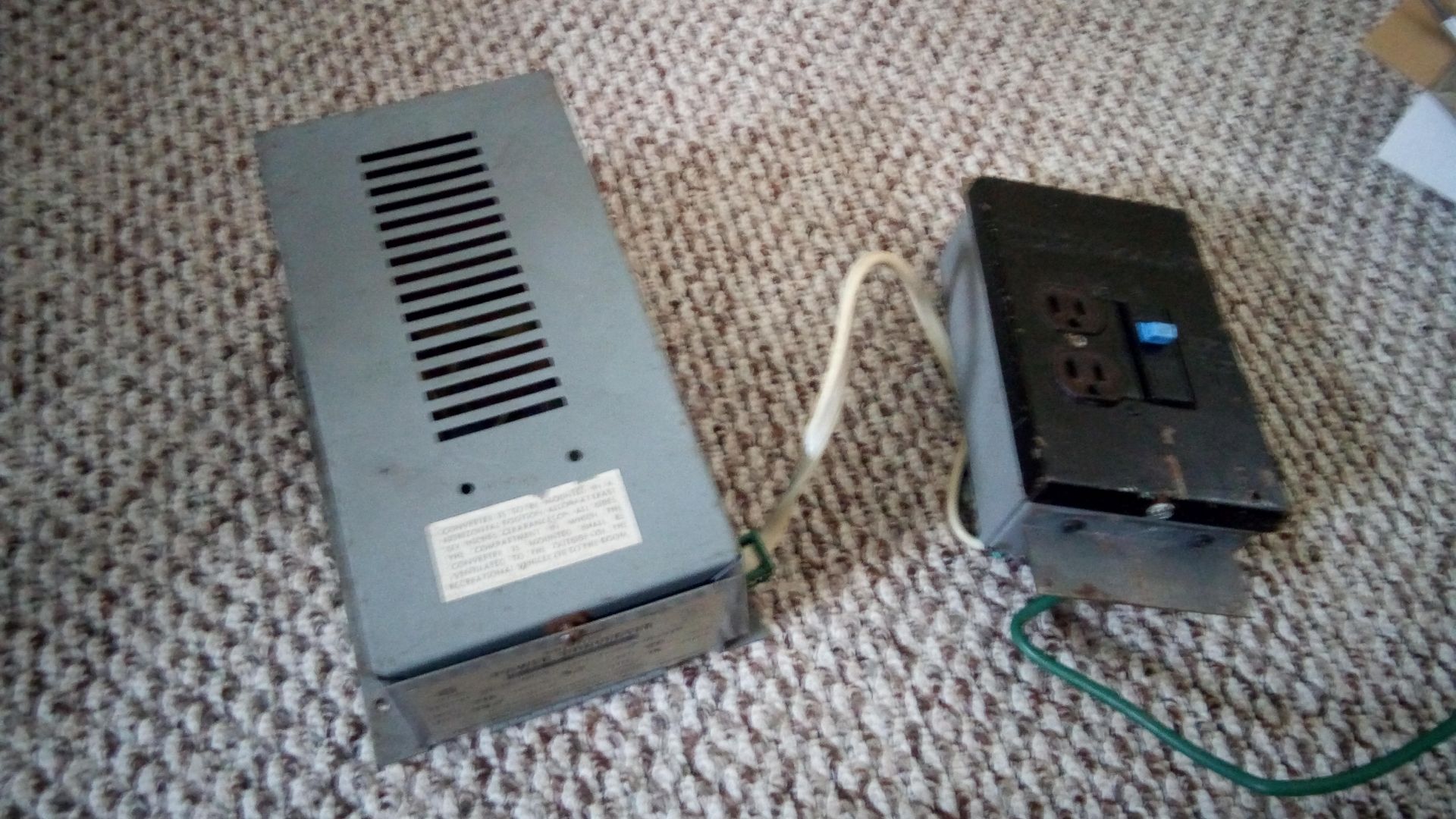

Testing the 12V power supply

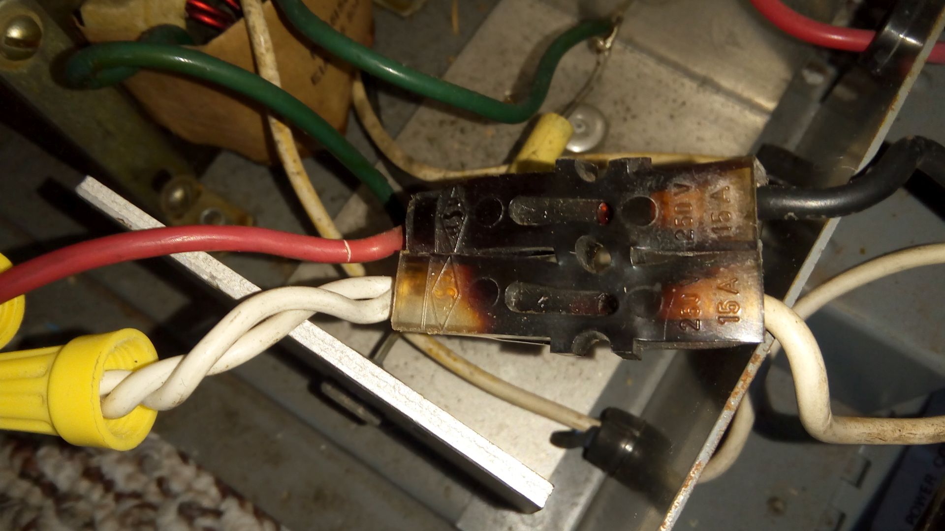

remove the transformer cover
it's supposed to look like this

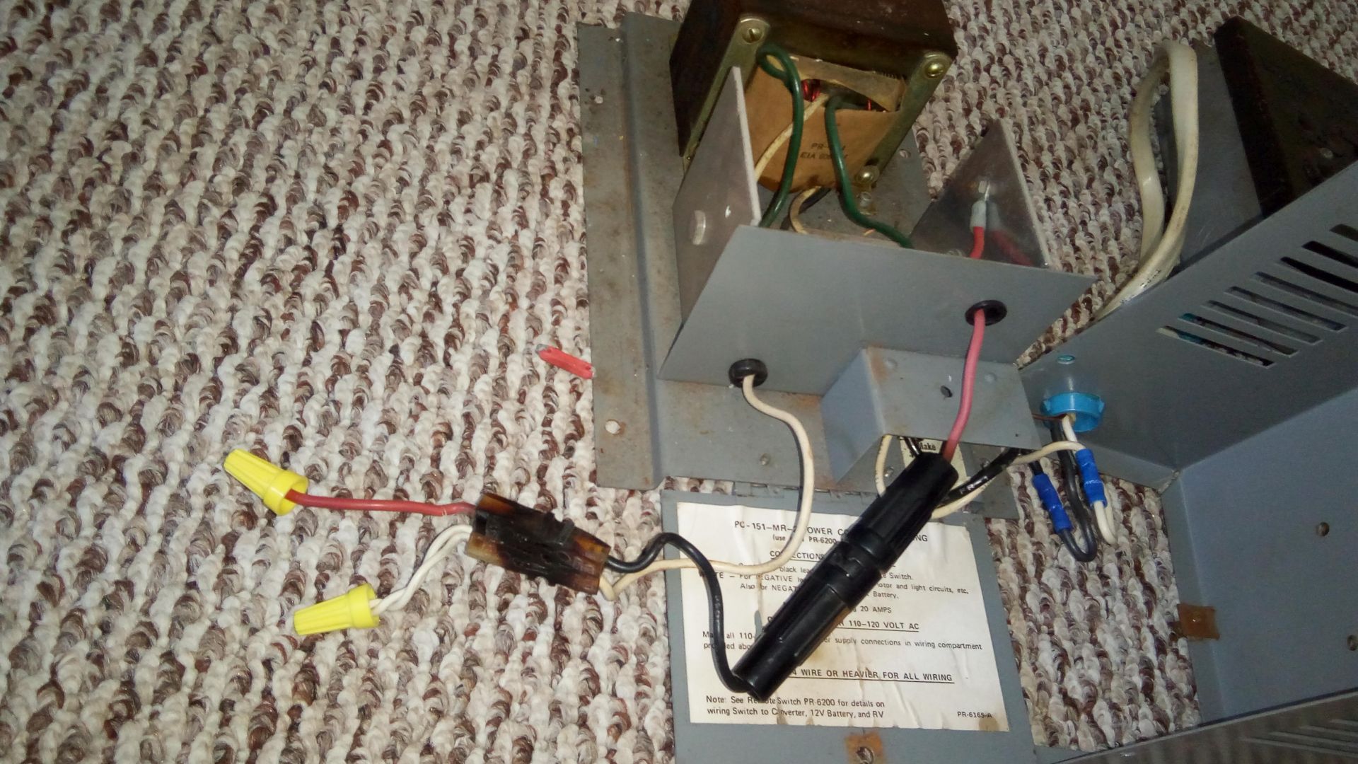

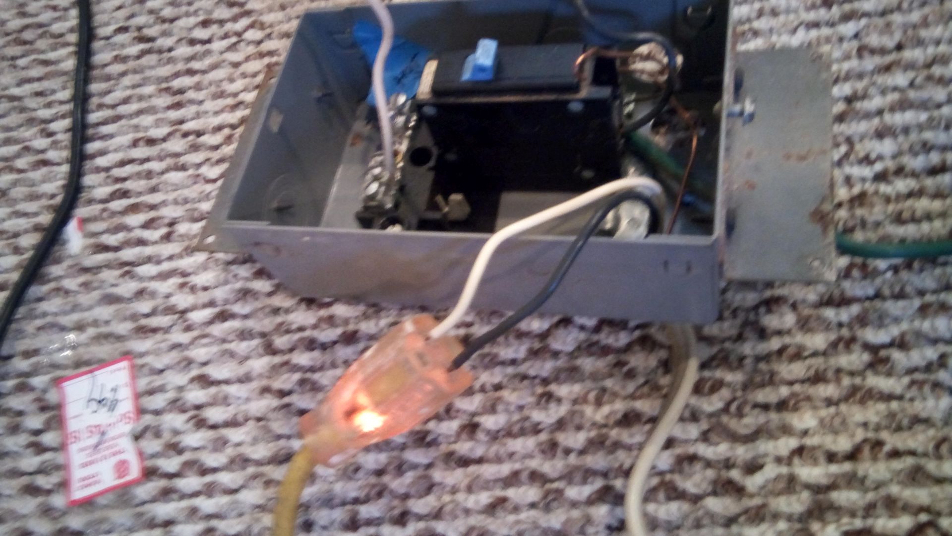

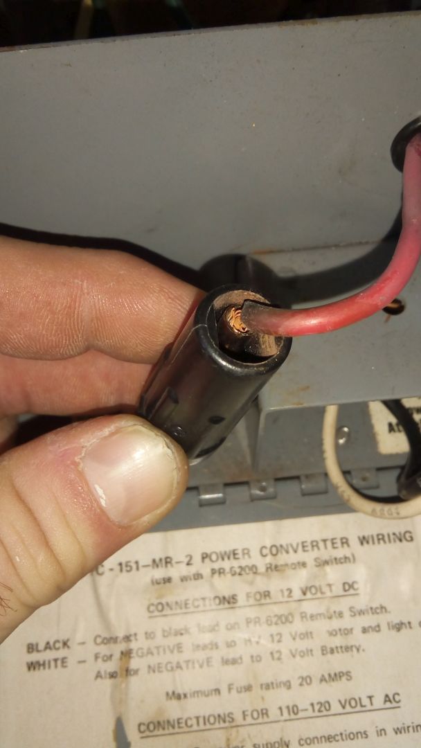

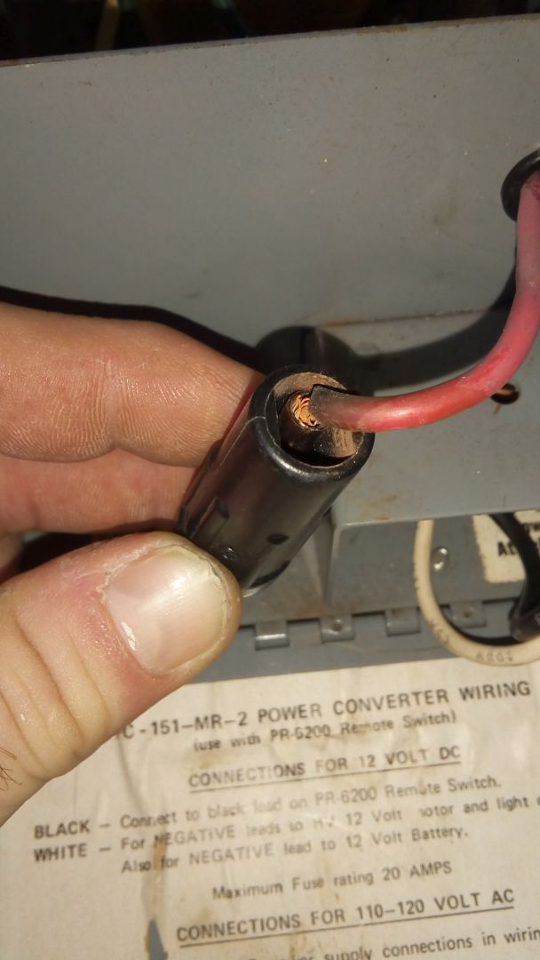

instead, I got this mess - see below - so I snipped both 12v wires

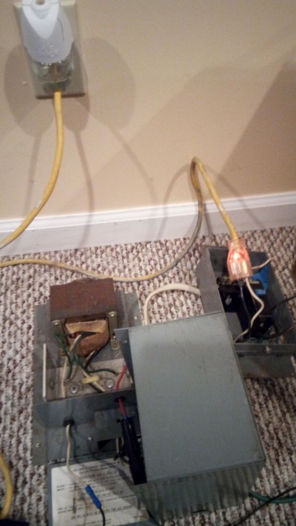

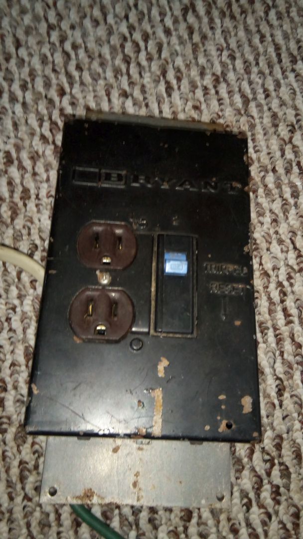

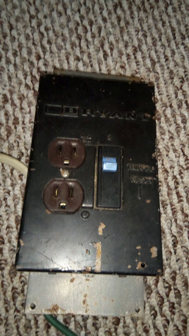

The breaker box supplies power to the transformer.

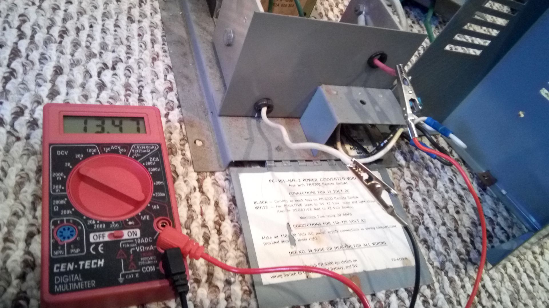

I removed the cover and inspected everything; the outlet turned out to be garbage - with wobbly connections even after tightening down the screws. I then powered the transformer by rigging the black and white input lines to a wall outlet, via an extension cord
set the multimeter on 20v DC and checked for 12 volts across the freshly cleaned up red and white wires coming out of the transformer; It's good!

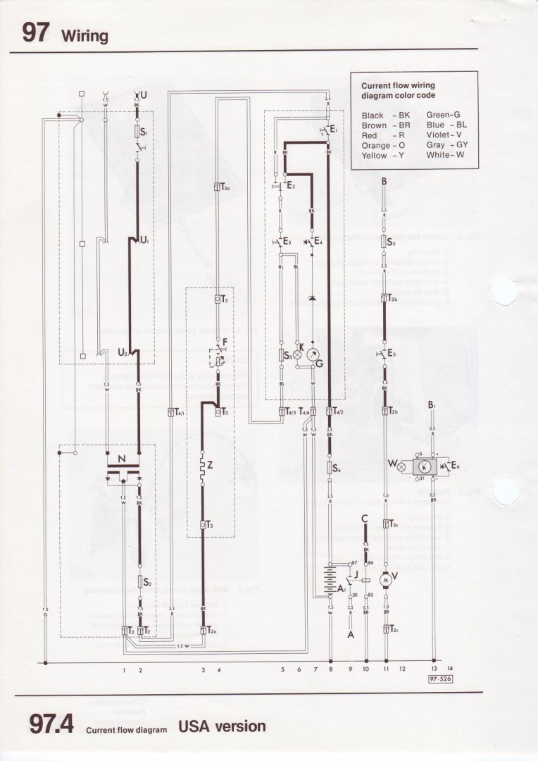

Here is the diagram, the fridge wiring is the rectangle in the middle
and here my hookups at the triple connector under the Tstat

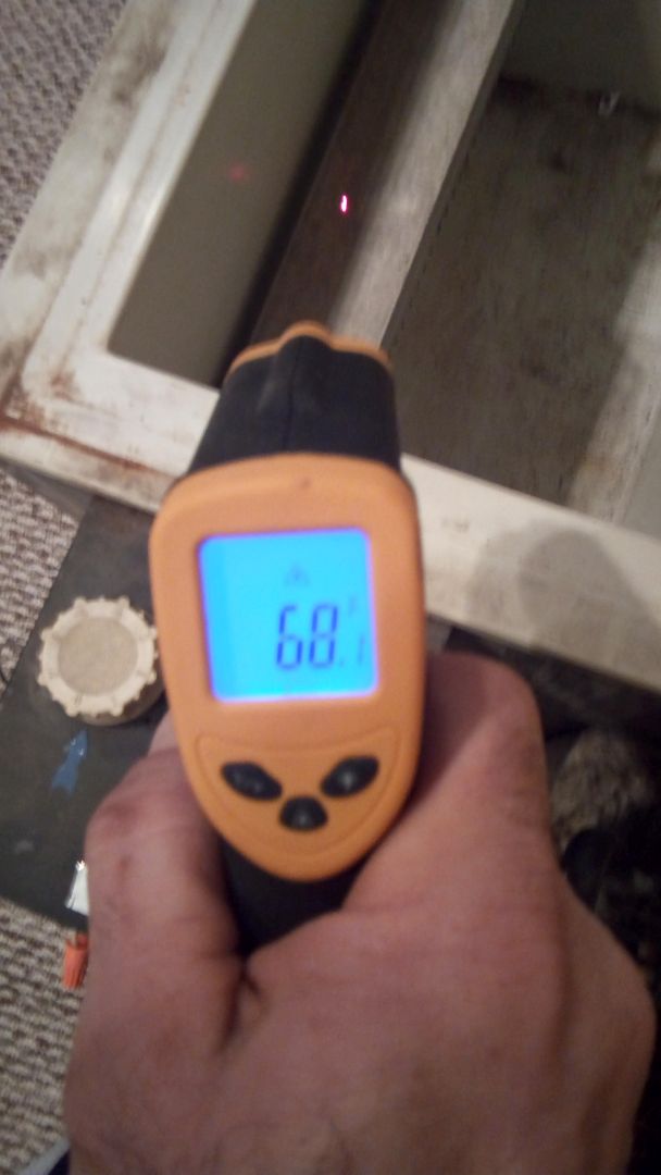

temperature at start of test

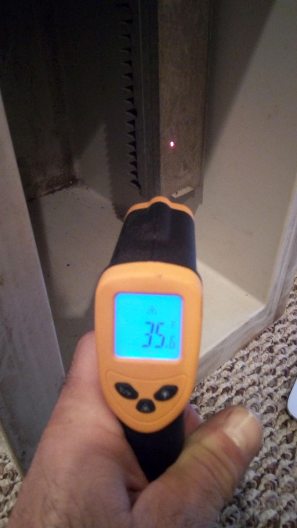

temperature after 20 minutes

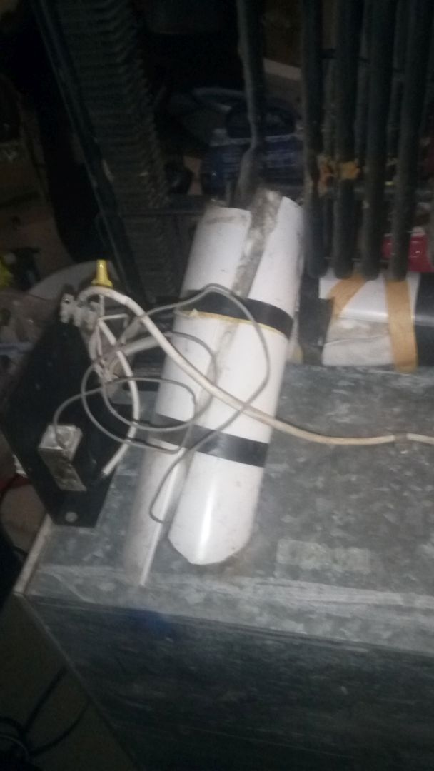

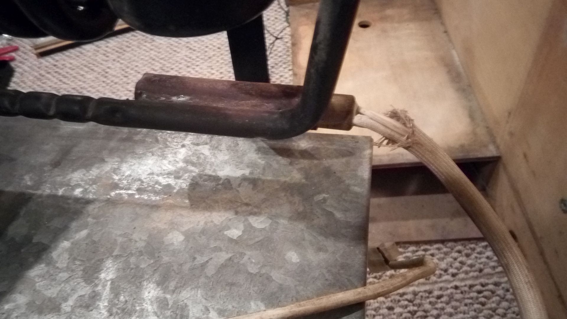

right about now I had an epiphany and realized that I might burn my basement down, so I quickly unplugged the fridge.

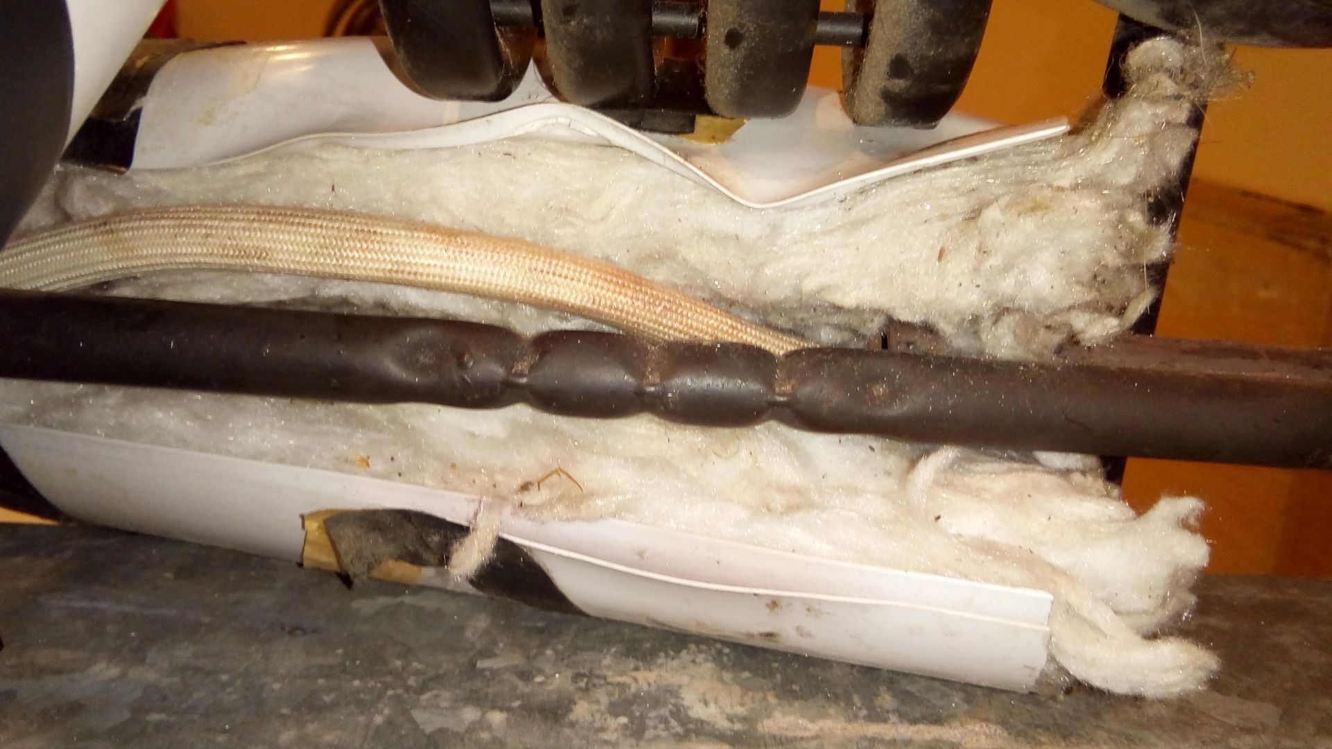

this is how the heating element wire was routed by the PO, so I reinstalled it the same way: inside the insulation sleeve, along the piping hot line. the wires could melt and cause a fire..
so I pulled out the heating element and installed the other way - with the wires opposite to the lines, and not touching a thing

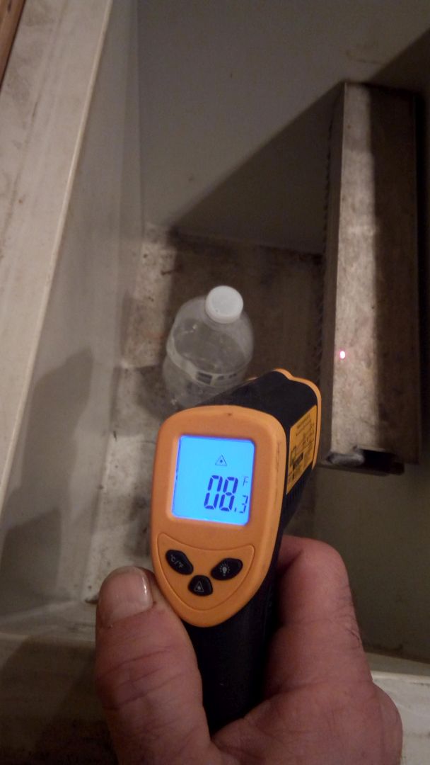

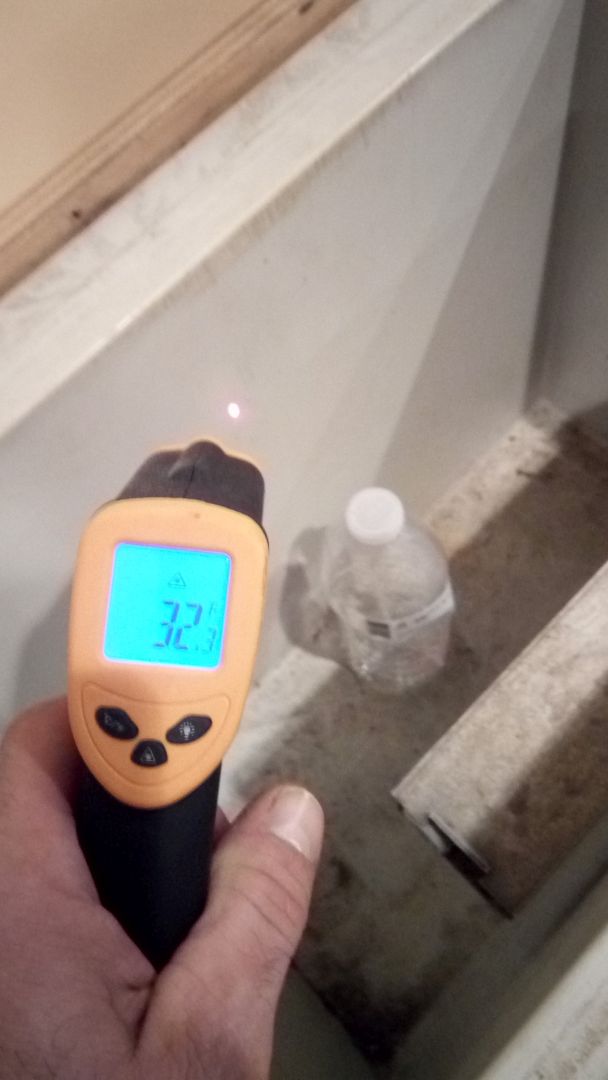

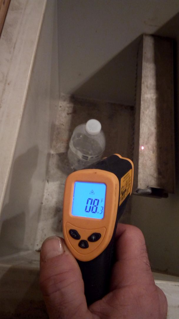

after an hour, dial on max setting: condenser is super cold and there is a film of ice on the side of it

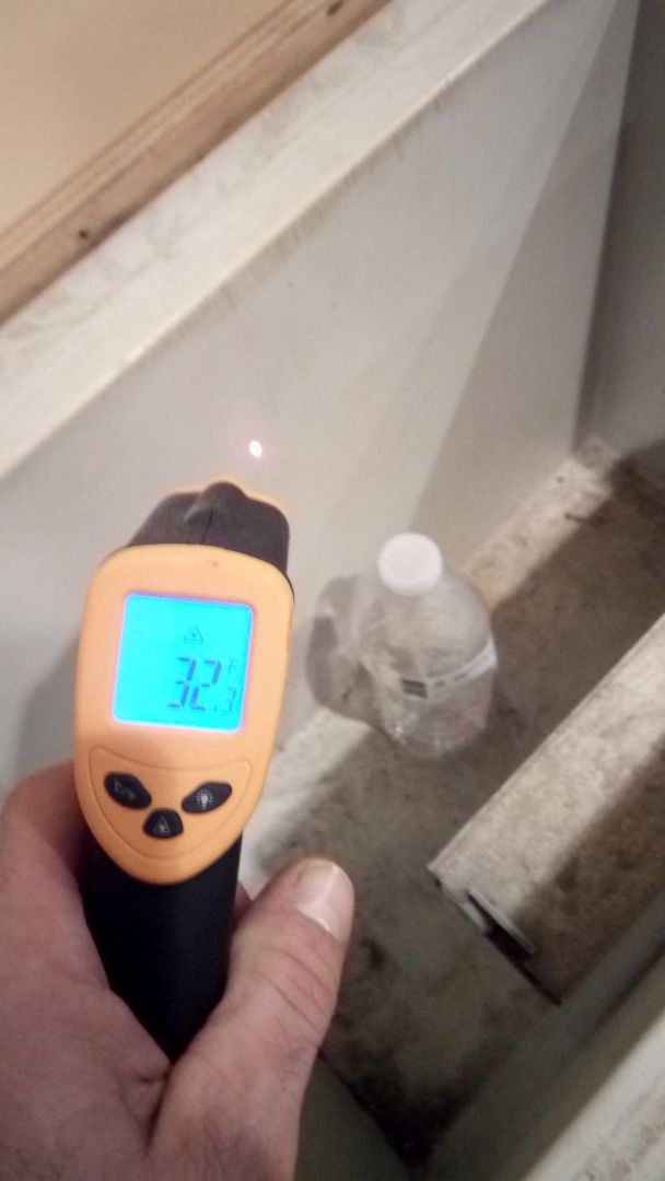

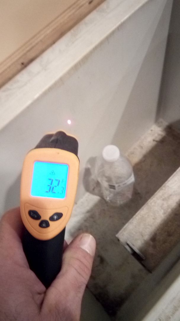

after two hours, temperature of the inner walls is 32
Verdict: overall I am pleasantly surprised by how fast this little fridge starts cooling; I think that with intermittent battery use, and with a bag of ice in it, it will work just fine for a few days of camping. And with shore power it's great.
