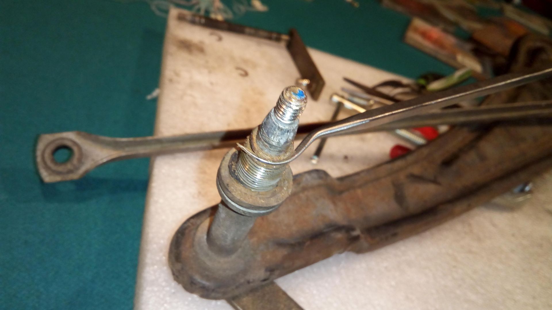

Next step is taking linkages apart, and removal of wiper shafts for inspection, clean and lube.
Linkage arms are kind of bendy, so I refrained from prying them apart. A battery terminal puller will do the trick. The cup at the end of the puller is too big so I inserted a bolt in between the cup and the linkage/articulation.
somewhere under this grime there's a circlip that prevents the wiper shaft from pulling out
After poking around with a pointy thingy, I found the groove; you can see one end of the circlip right by the tip of the pick
Earlier in the day, I had a 20% off superbowl HF coupon and I got me a set of snap ring pliers for 5 bucks, and got a free multimeter with it.
Yeah, I know they are not for this kind of clip, but they worked

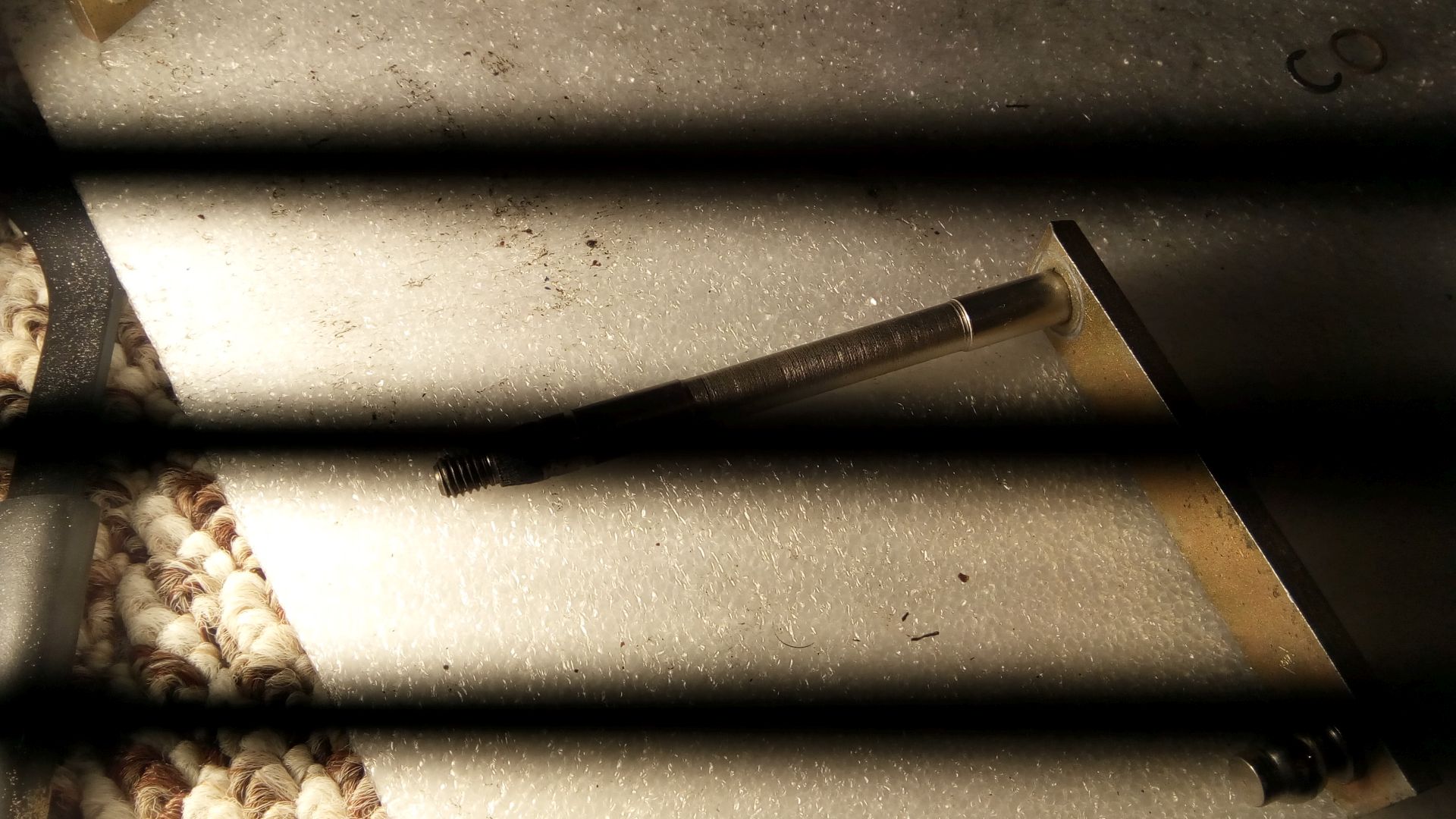

after removing the clip, I found a washer underneath
one shaft slid out with ease, the other was really caked. I sprayed it on both ends with brake cleaner and worked it for a few minuted until it came out
While cleaning the parts I discovered another washer, buried in grime at the base of the shaft
It's a wavy little thing
As a side note, I tried using an LED light to take better macro shots with my potato camera phone. My cat is not impressed...
The camera detects the pulsation of the LED, and while focusing on a shot, I see black lines slowly scrolling down the phone screen; the lines come out in the pics too

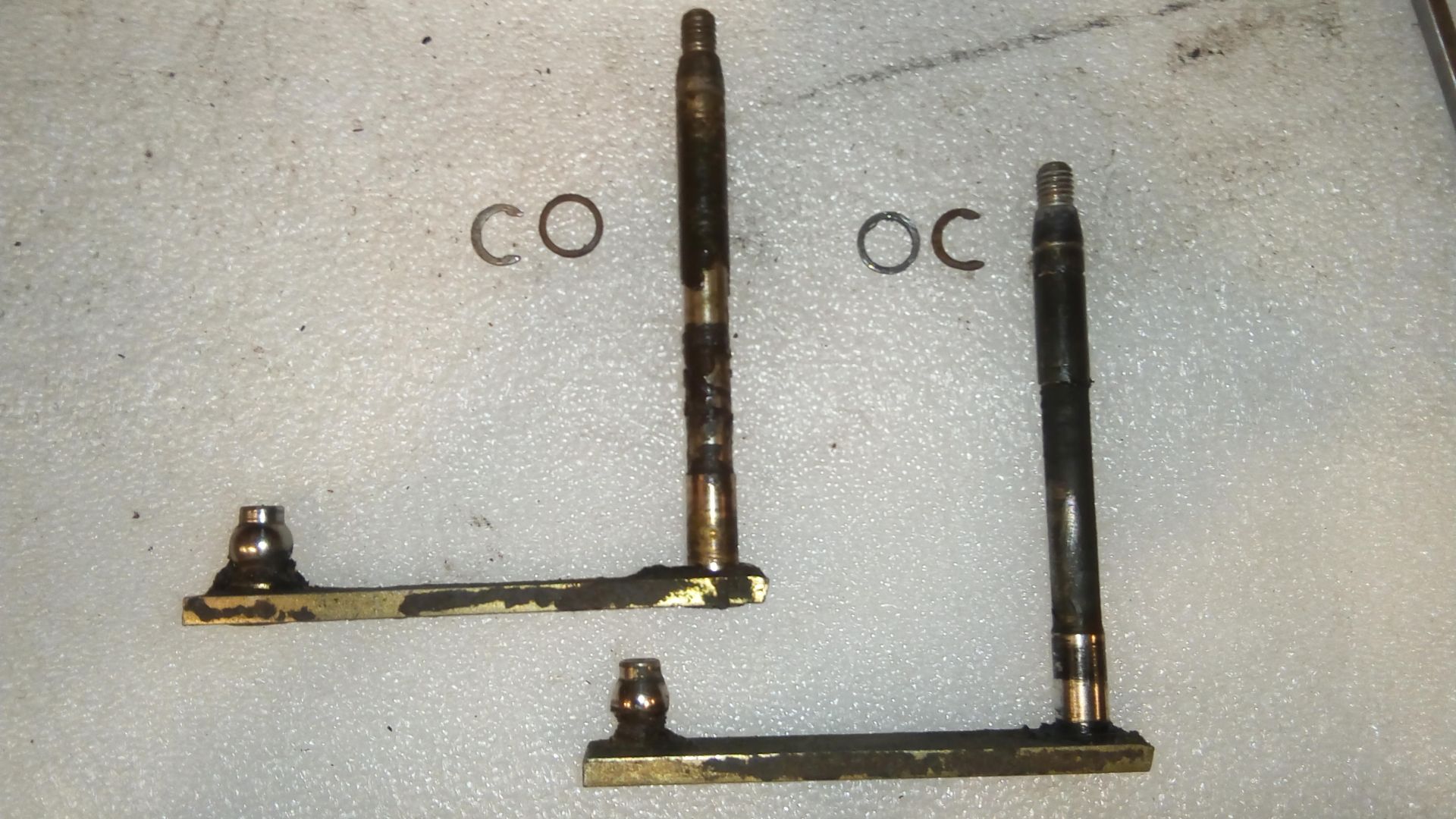

Notice the worn out splines below the threads; and the rusty area below the clip groove is actually slightly recessed from wear
The other shaft was the stuck one; splines are also damaged, and there is evidence that water infiltrated all the way to the bottom
I can gently sand down the rusty areas and pack everything tight, but there will be slop; my main concern is the damaged splines, which will cause the wiper arms to eventually skip.
IMO these shafts are shot and due for replacement. What do you think? Can I make these original ones work, or should I just get some crappy after market ones

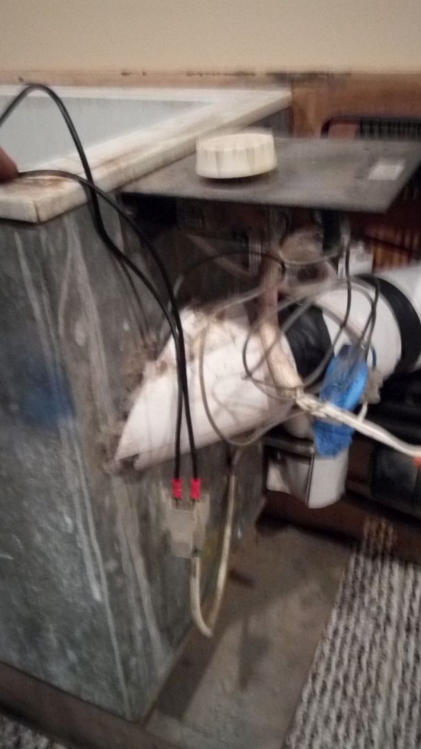

I also worked on the fridge. I never had a chance to try it out because the control panel wiring harness is missing. It's a simple unit that has no moving parts except the thermostat knob; the ammonia solution cycles through the tubes by gravity. I can hear the liquid sloshing through the lines; at least it's not crystallized! The fridge should draw over 5 amps so it will deplete the aux battery within hours, but it may be ok on shorepower.
The plan is to check each component, figure out the wiring, and then test the whole unit, rigged to a house outlet.

Testing the heating element.
The yellow wire nuts and the electrical tape on the insulation mean that a PO messed with the unit.
Removal of the bottom insulation reveals the heating element, hidden inside a tube welded to the coolant line
you can see the tip of it inside the tube; admire the ghetto clamping screw!
The heating element slides out easily; the first problem is that there are four wires coming out of it, instead of two
Notice the stamping for both 12v and 115v, which means that it belonged to a canadian model - with separate circuits for battery and shore power.
Next I removed the fabric insulation to expose the entire length of the wires, so I can separate the 12v pair from the 112v pair. I assumed that the 12v pair was the one initially hooked to the blue and black wires on the socket; I actually lucked out on it.Testing is easy - just hook up the wire pair to the battery terminal - I don't think polarity matters
the element started immediately, and was piping hot within 20 seconds
So the heating element is good!

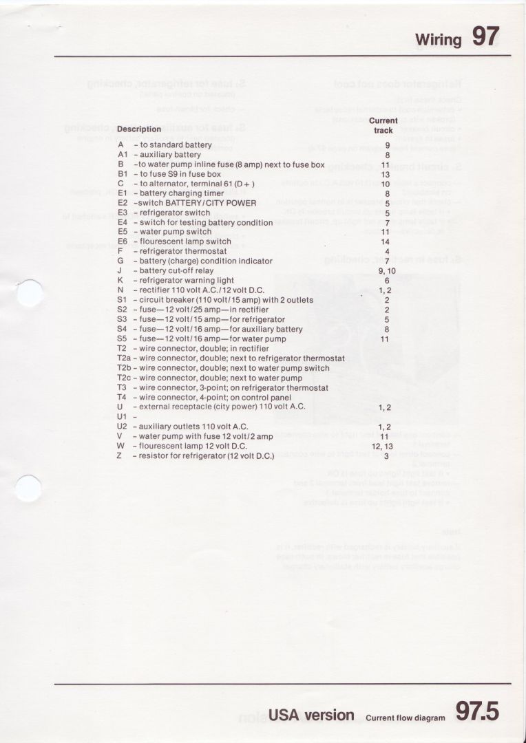

Next is wire cleanup.
I installed a 20 amp inline fuse and extended the temporary test lines to the fridge.
Figuring out the rat's next under the thermostat took a while; I could have hooked up the heating element directly to the transformer and call it a day, but I wanted test the dial knob too.
Here is the diagram, the fridge wiring is the rectangle in the middle
and here my hookups at the triple connector under the Tstat
