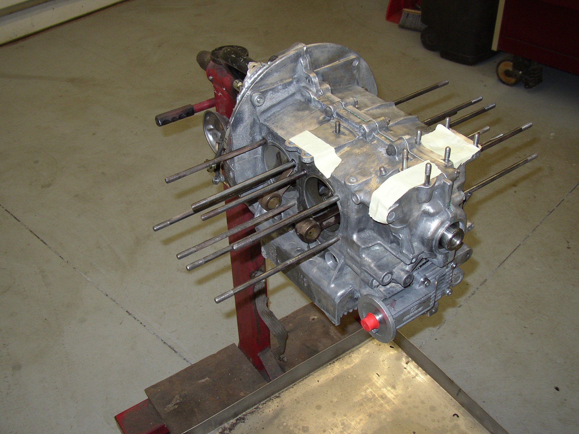

The 1600SP went smoothly, here's the case ready to mate together. The crank looked great to begin with but I polished it using a drill to spin it and 1000 grit, it looked like a mirror when done. The bearings are marked and "lined" to make sure they're seated correctly on the dowels, the case flanges are cleaned and gooped with sealer and it's already been dry-fit to make sure everything spins free.
Here's the short block done, it spins freely with zero effort.

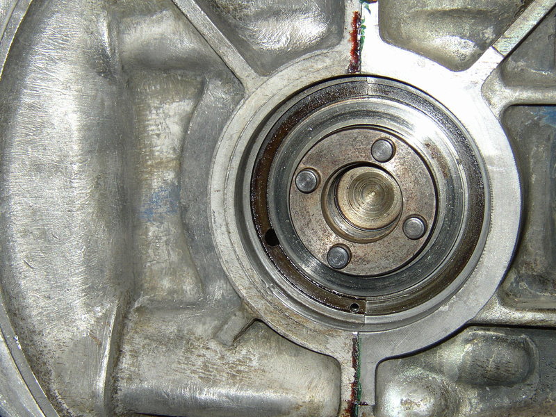

I've been drilling an extra drain hole in the case to relieve pressure on the rear seal, the hole should be at 6 o'clock and the Germans put it at 8 o'clock for some reason. This leaves an ounce of oil against the lip of the seal when the car is parked and sometimes ends up on the driveway.

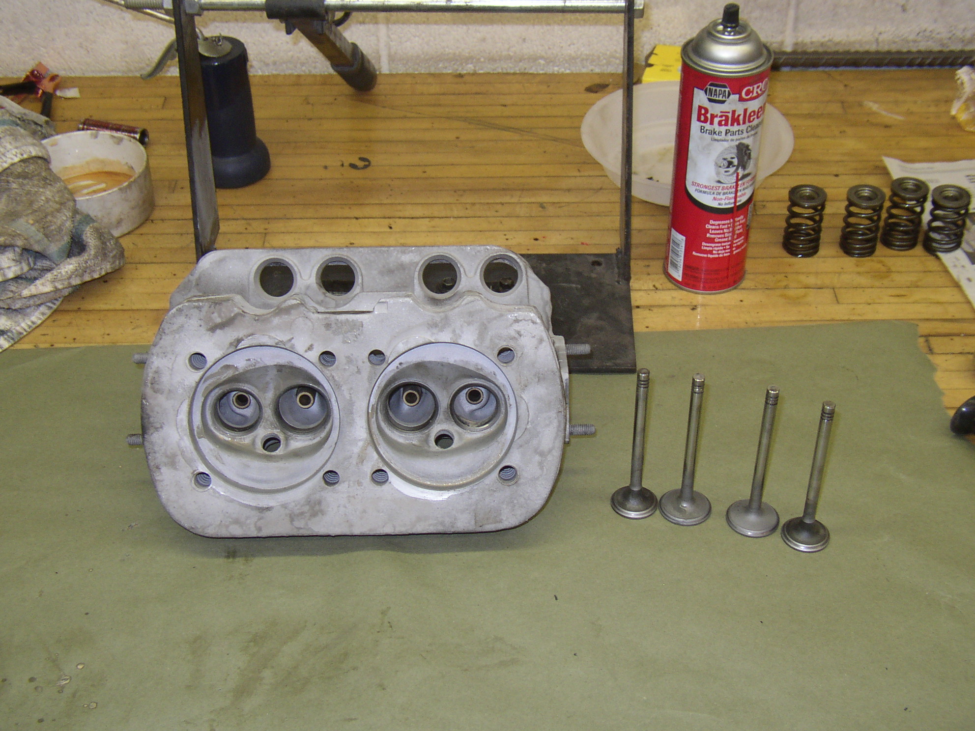

The heads had less than 1000 miles since last ground, I disassembled them.....

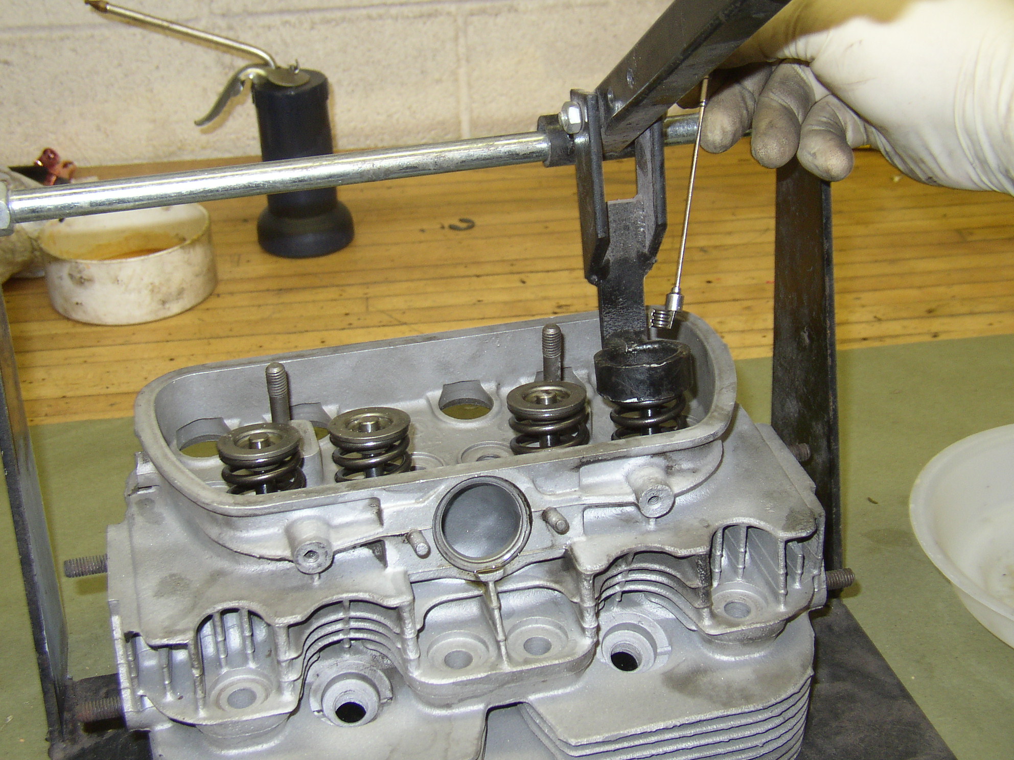

And blasted everything. I don't like the "valve grinding compounds" sold lately for lapping as they're too coarse and make little grooves in the valve face and seat, it's like sand in a paste carrier. I tried using rubbing compound this time and it worked great. (you can see a bit of it in the tub in the left background) I used a power drill running really slow and reversed directions a lot, maybe 2-3 seconds at a time and refreshed the compound.
Parts done and ready to assemble, German jugs ball honed and checked, no wear or out-of-round measurable. Pistons soda blasted and re-ringed. Heads assembled and ready to go.
I always air check heads as soon as they go on to make sure everything is air tight. The compound must have worked well as there was not a bit of leakage.

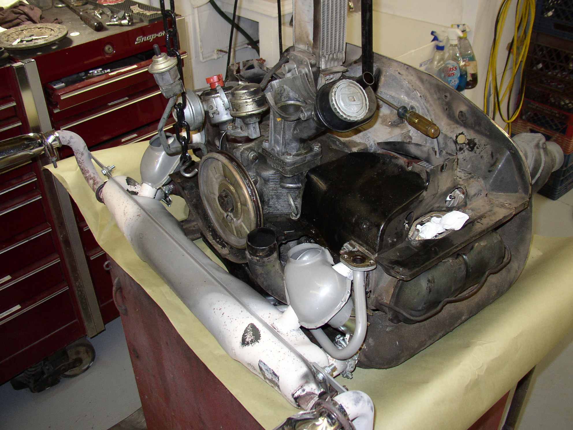

I found the fuel odor issue to be the right side intake manifold boot seeping fuel. Normally the intake manifold supplies a vaporized air/fuel mixture to the cylinders, but there can be some liquid fuel separation when the engine is cold which settles on the bottom of the intake manifold. Things must have a pattern failure here as both of the boots were rotted on this Thing, and Rob's Thing a couple of years ago had the same problem, except his escalated into a perforated boot which upset his idle obviously.

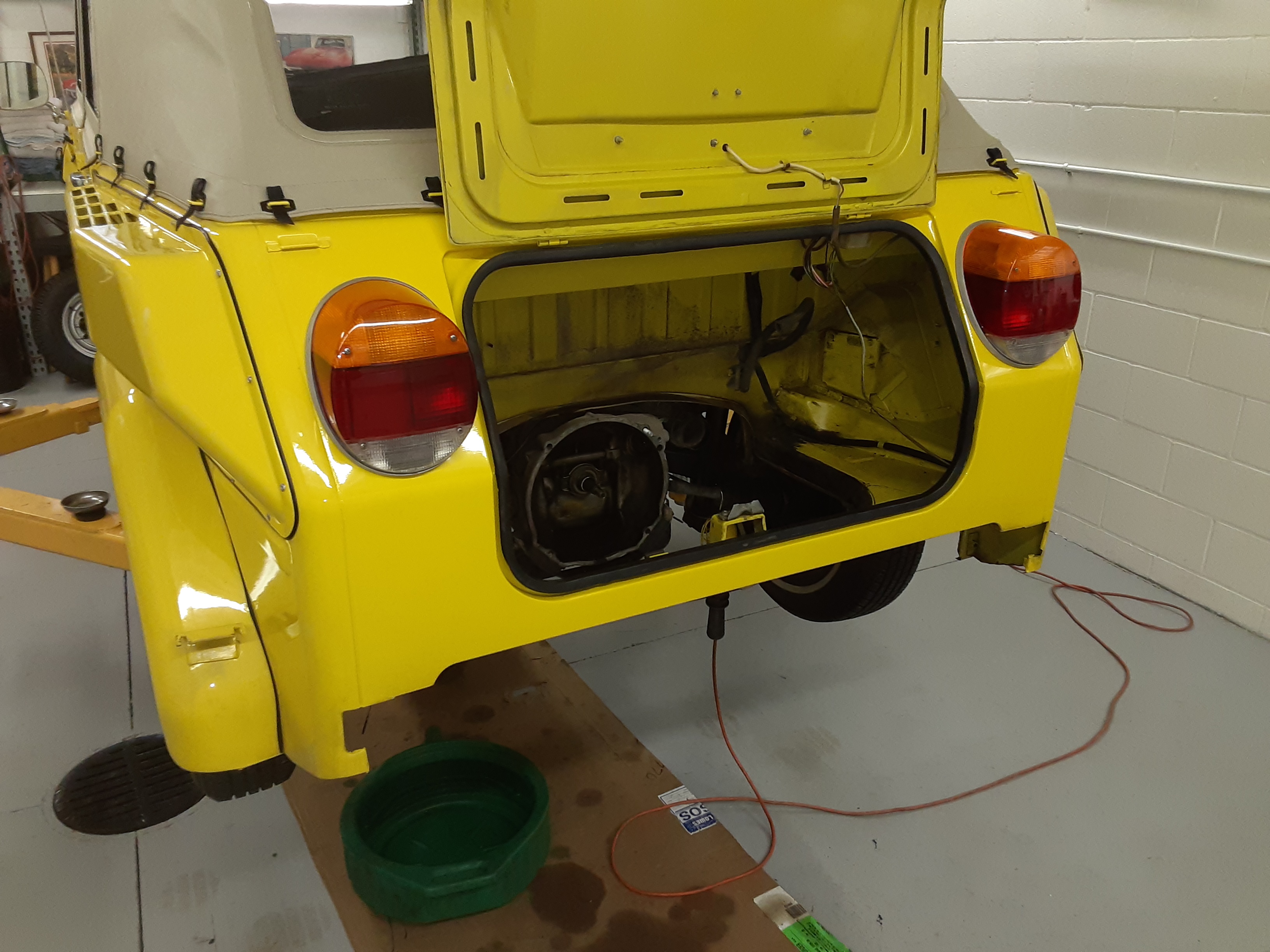

Step 1, yank the engine and strip the top of it to get to the intake boots.
The boots look like shit and are dry rotted to the point of being porous. OEG boots commonly look different and many times feel like brand new when removed.

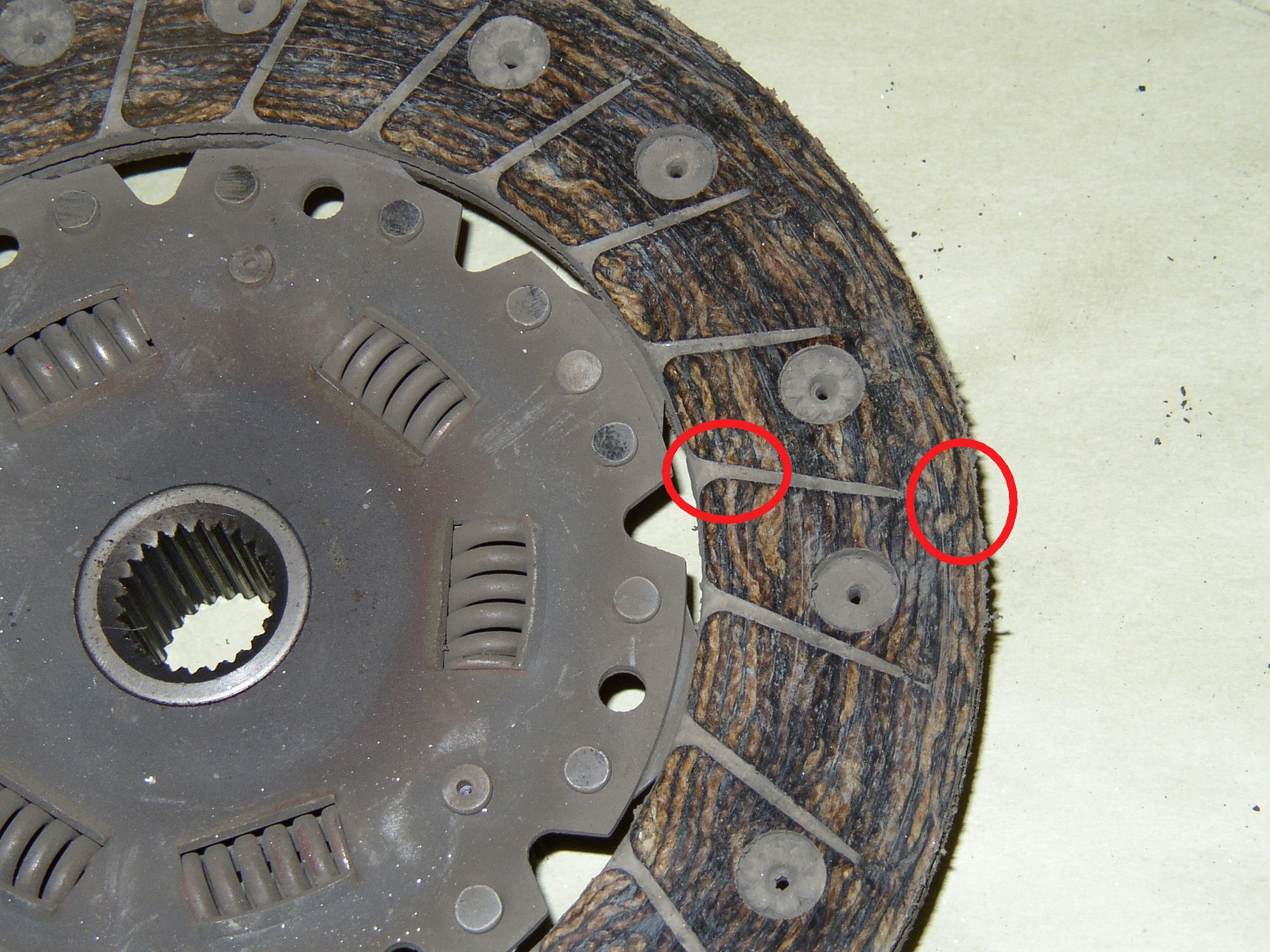

Might as well look at the clutch and stuff to find the disc wearing unevenly and the rear seal leaking. I cleaned up the back of the case and put in a new seal. I also bead blasted the flywheel to give the new clutch a nice surface to wear into.

The clutch on this Thing was kind of grabby, and other Things I've driven were the same way so once again I wonder if it's a Mexican motor issue or just a 45 year old clutch issue. Anyway, I ordered a new Sachs clutch assy hoping it was German. Well, the TOB was German but the disc and PP were Korean. Oh well. It works great so no complaints I guess.

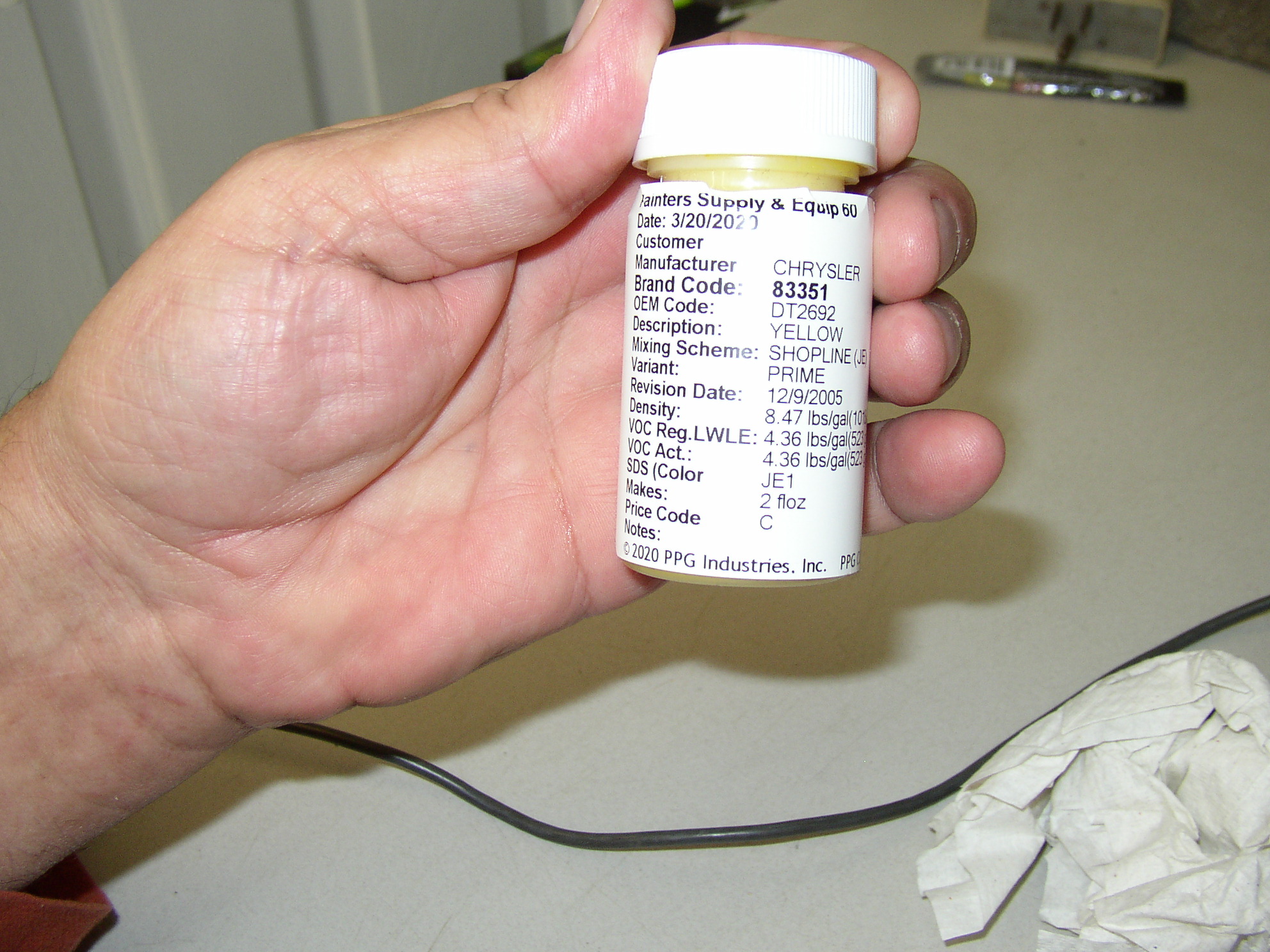

The owner got some pretty good sized stone chips in the paint and wanted them touched up, so I took one of the doors to the body supply shop where they used their camera to ID the color of the paint.
The match is pretty good, oddly it comes up as a Chrysler color. I was going to buy a quart in case I need to shoot something but they offered me a $15 touch up bottle so I got that.

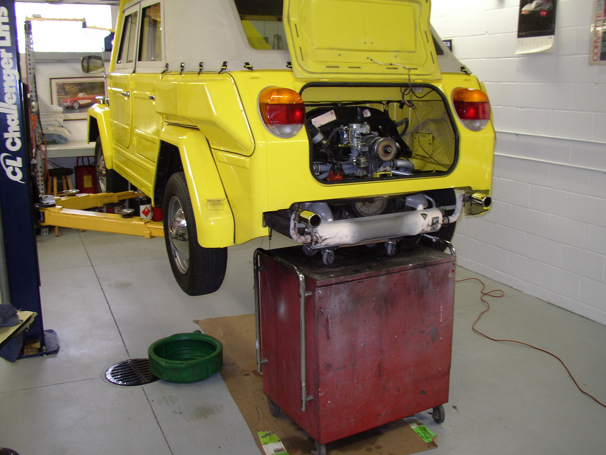

Here the engine is back together and ready to go in, I rotated the generator 1/4 turn to put it where it's supposed to be. The prior tech had it spun to the left. When pulling the engine the dist, EGR tube and fan belt were hitting the engine rubber seal and making it hard to get out so I pulled the dist and left the EGR and belt off while installing the engine. It made a big difference, it went in easier than it came out which is odd.

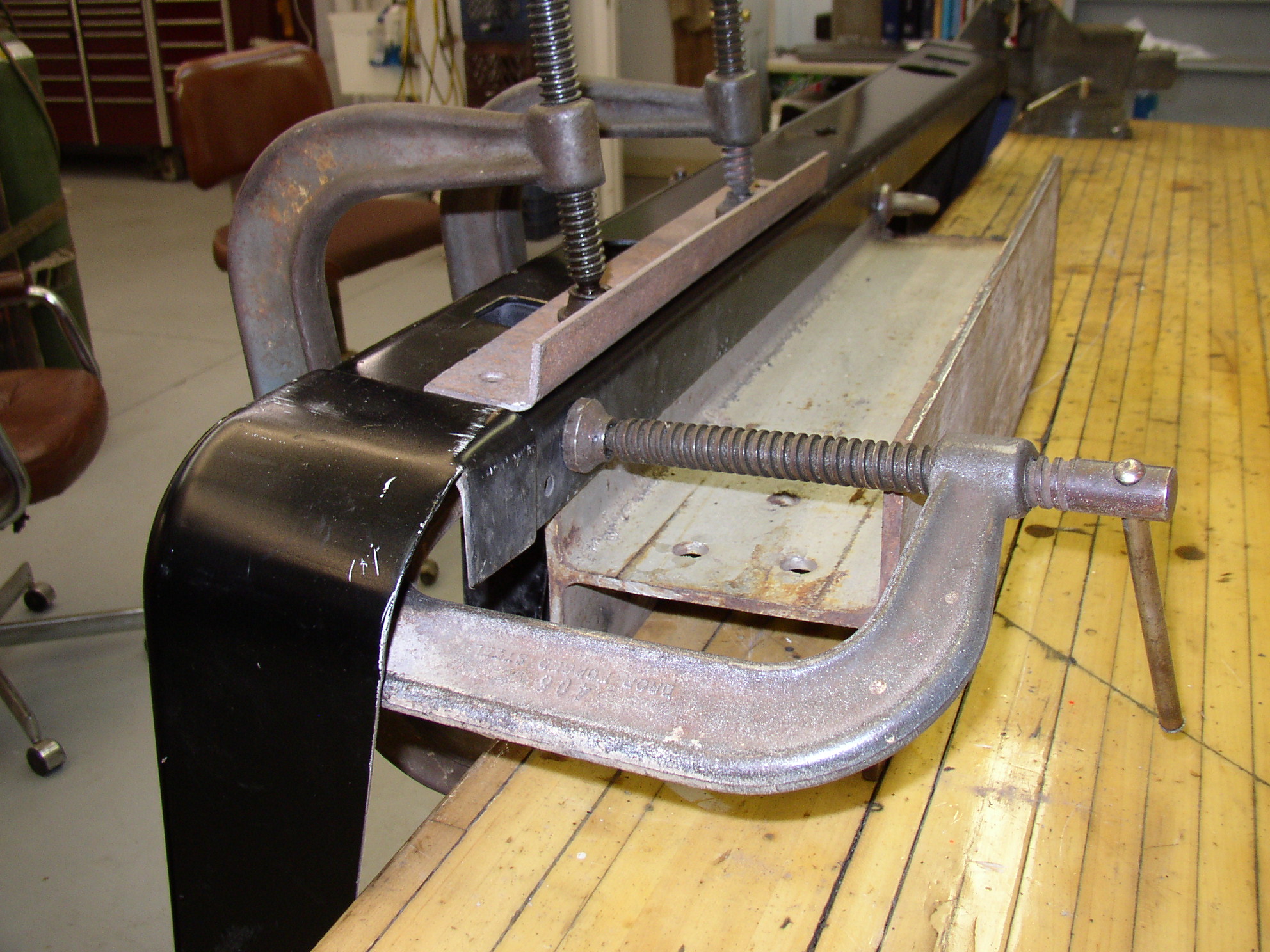

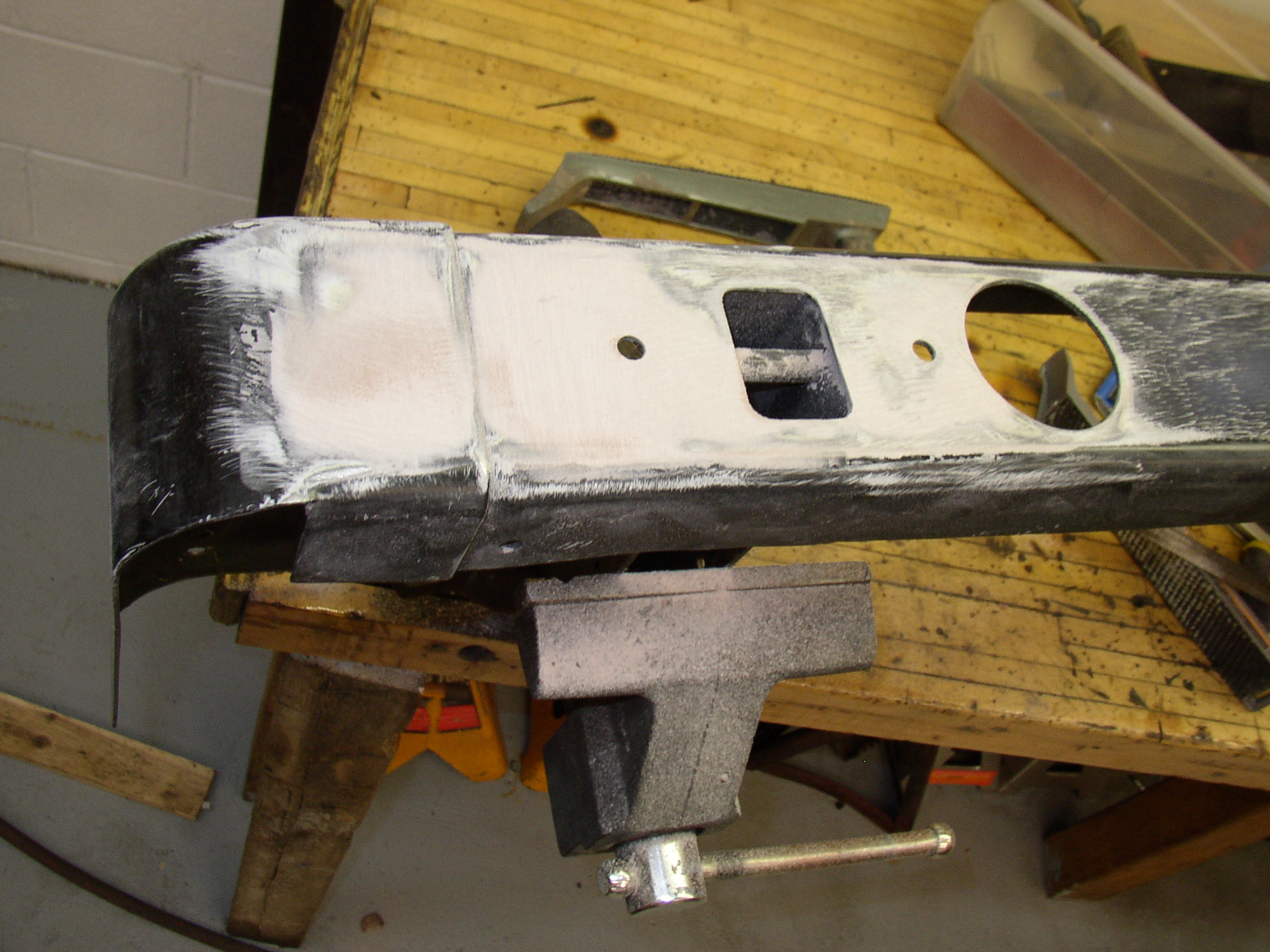

The PO painted the car but did a shitty job on the bumpers. Between that and damage from shipping they needed to be removed, straightened and painted. The damage was weird- not impact damage but "pulling" damage from either being dragged around the bodyshop/museum or loaded onto the car carrier with a strap. Anyway I straightened them as good as could be.
I still have giant C-clamps from my truck days, those aren't Chinese cheapies but forged-in-USA clamps. I bet they're $200 each these days or more. I used a piece of 6" I beam for a jig.
I filled in some low spots and electric weld divots to make them smooth. Note how many layers of paint there are!
They're in primer right now and will get black satin shortly. Yes, that's my primer gun, the HF cheapie. I can't believe how good those guns work, it seems like you can't kill them. For $10 they're barely worth cleaning, maybe just throw them away after each use. I shot a riding mower red last month with this one.
